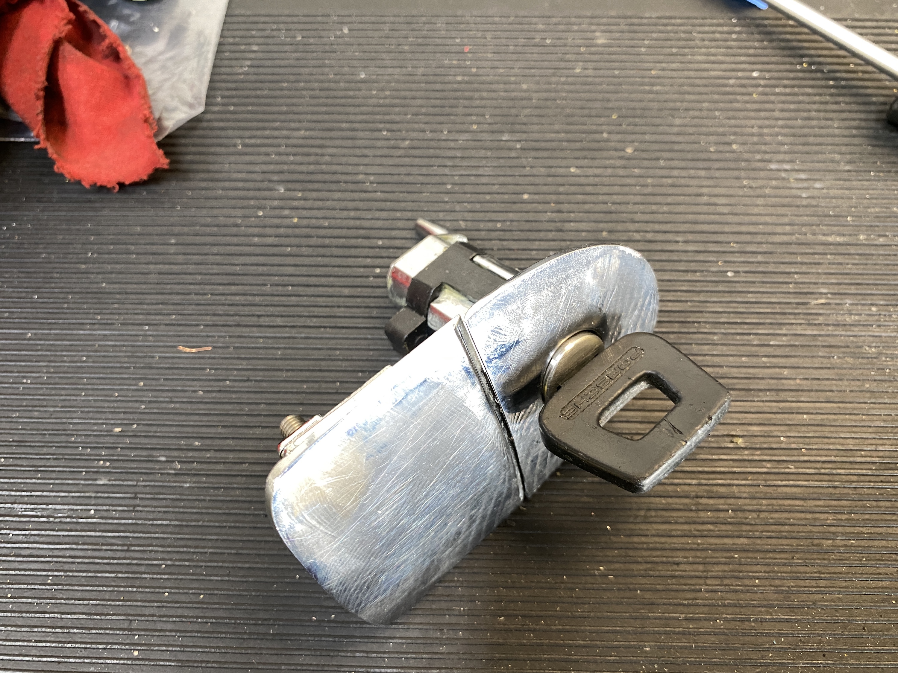

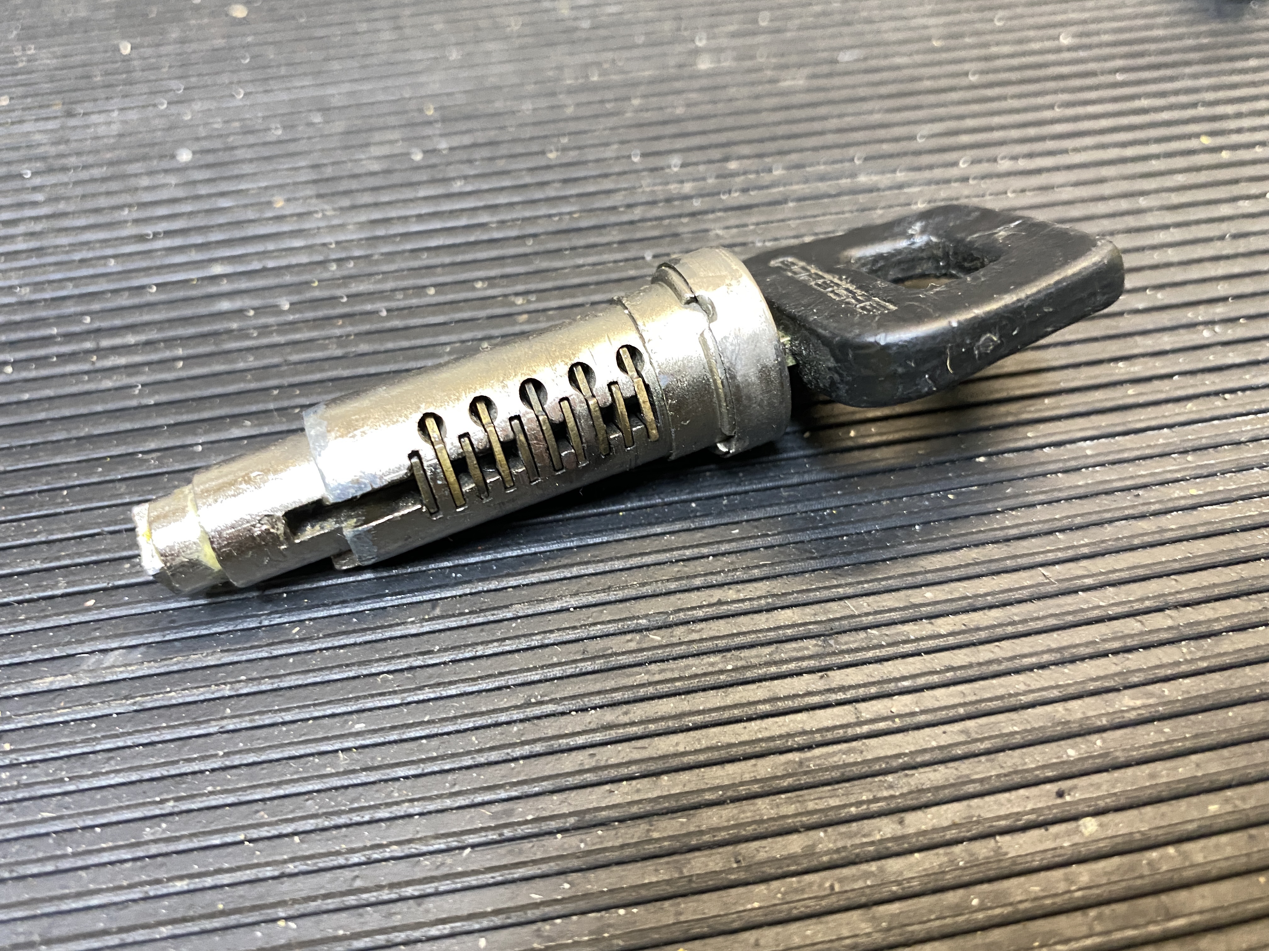

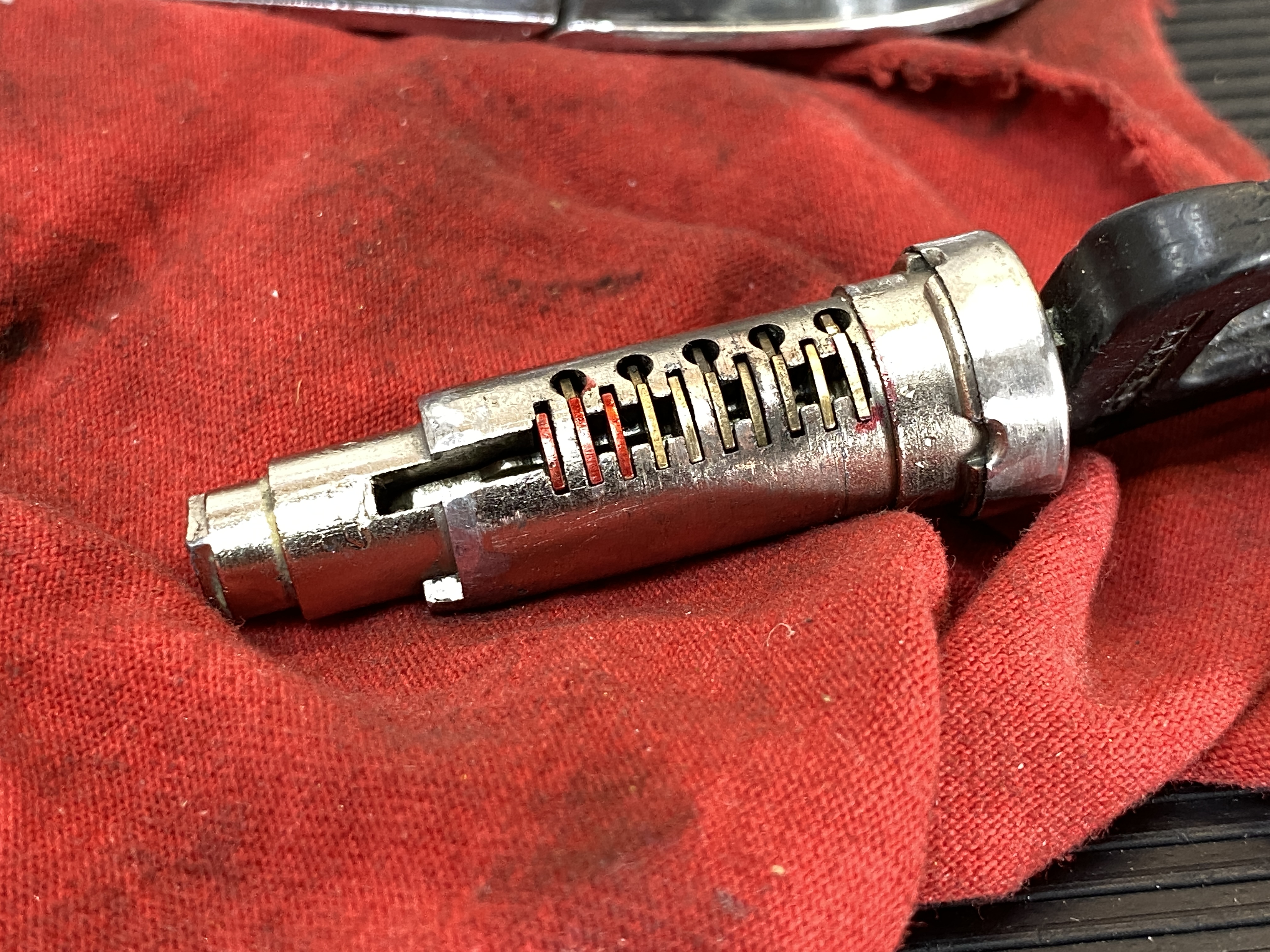

Final(?) tweak of the left door lock cylinder.

Member No.: 23,343
Seems to work 99% of the time, with just occasional resistance if the key is not straight.
bkrantz
post Feb 4 2023, 09:03 PM
Post #6146
Posts: 8,342
Joined: 3-August 19
From: SW Colorado
Member No.: 23,343

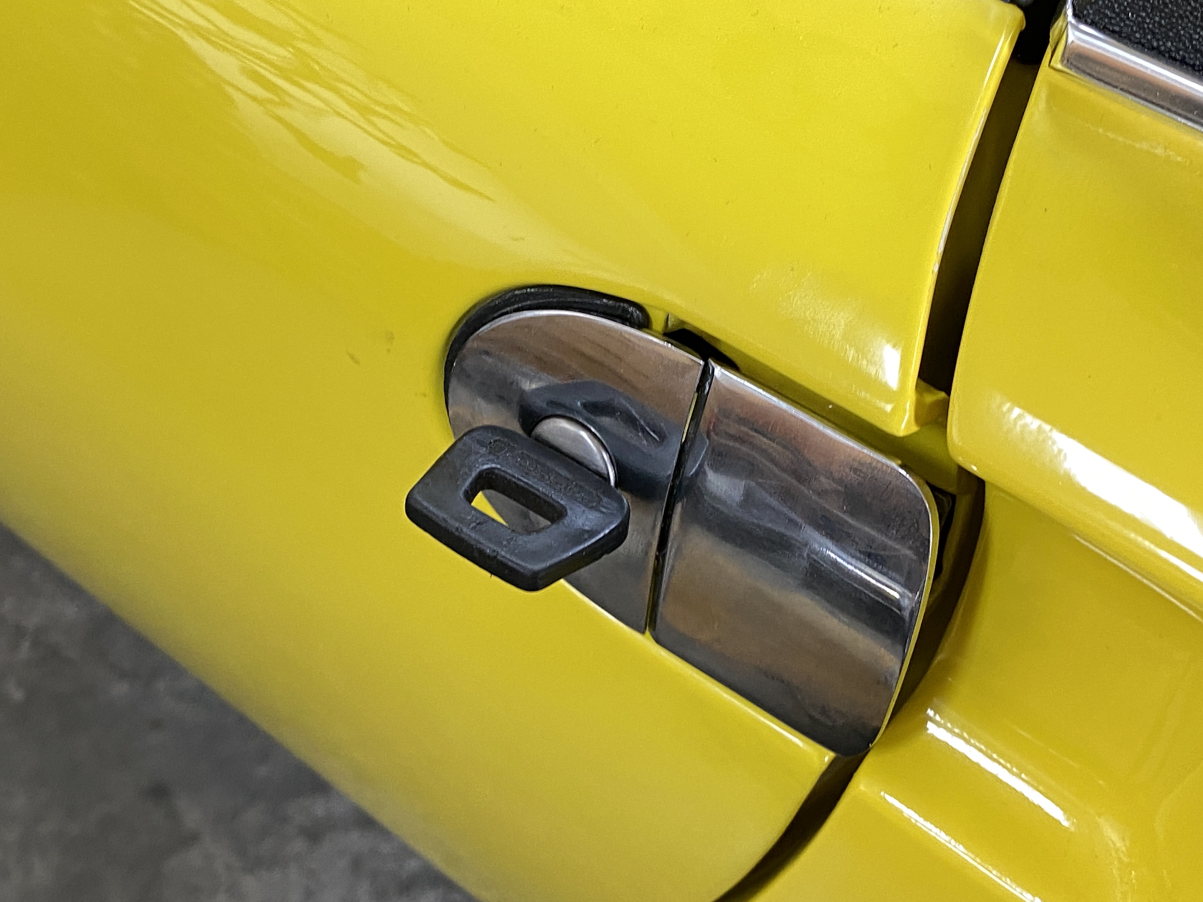

Door lock re-installed. Once I get some duplicate keys made and check them, I will complete the door interiors.

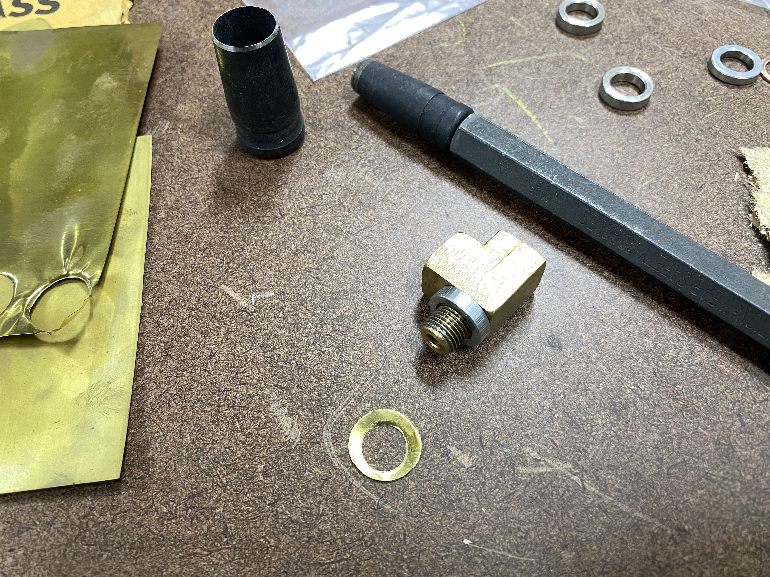

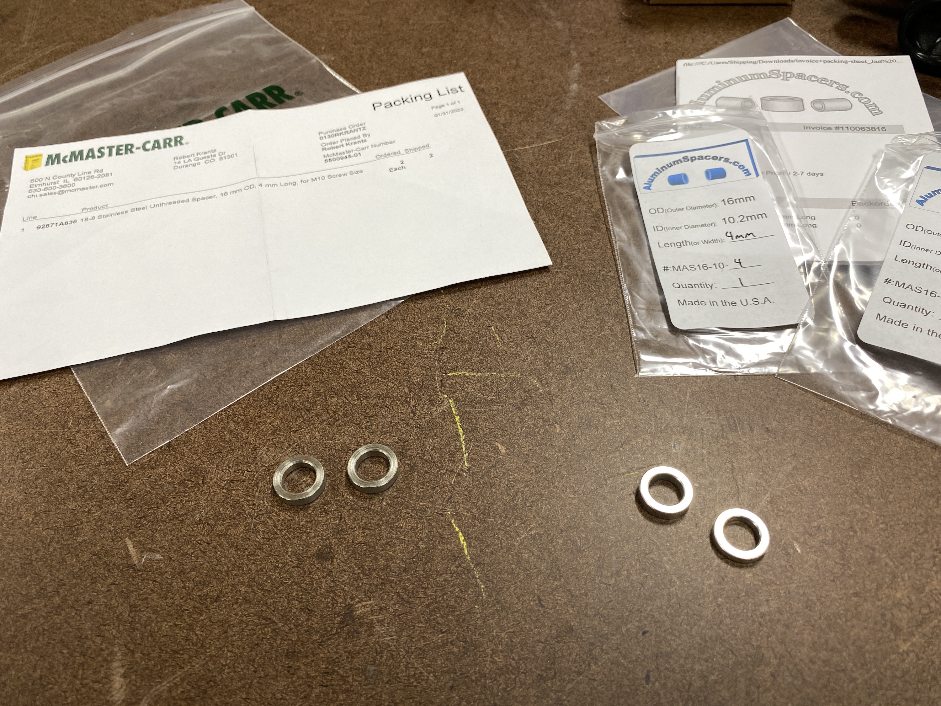

Time to get my "new" dual oil pressure system installed. I got some M10 spacers in steel and aluminum, in different thicknesses. Since I can't screw the brass T-fitting in all the way (and keep clearance for the stock sensor in the side hole) I need to use a spacer so I can get a tight and rigid connection with some stand-off.
bkrantz
post Feb 5 2023, 10:28 PM
Post #6148
Posts: 8,342
Joined: 3-August 19
From: SW Colorado
Member No.: 23,343

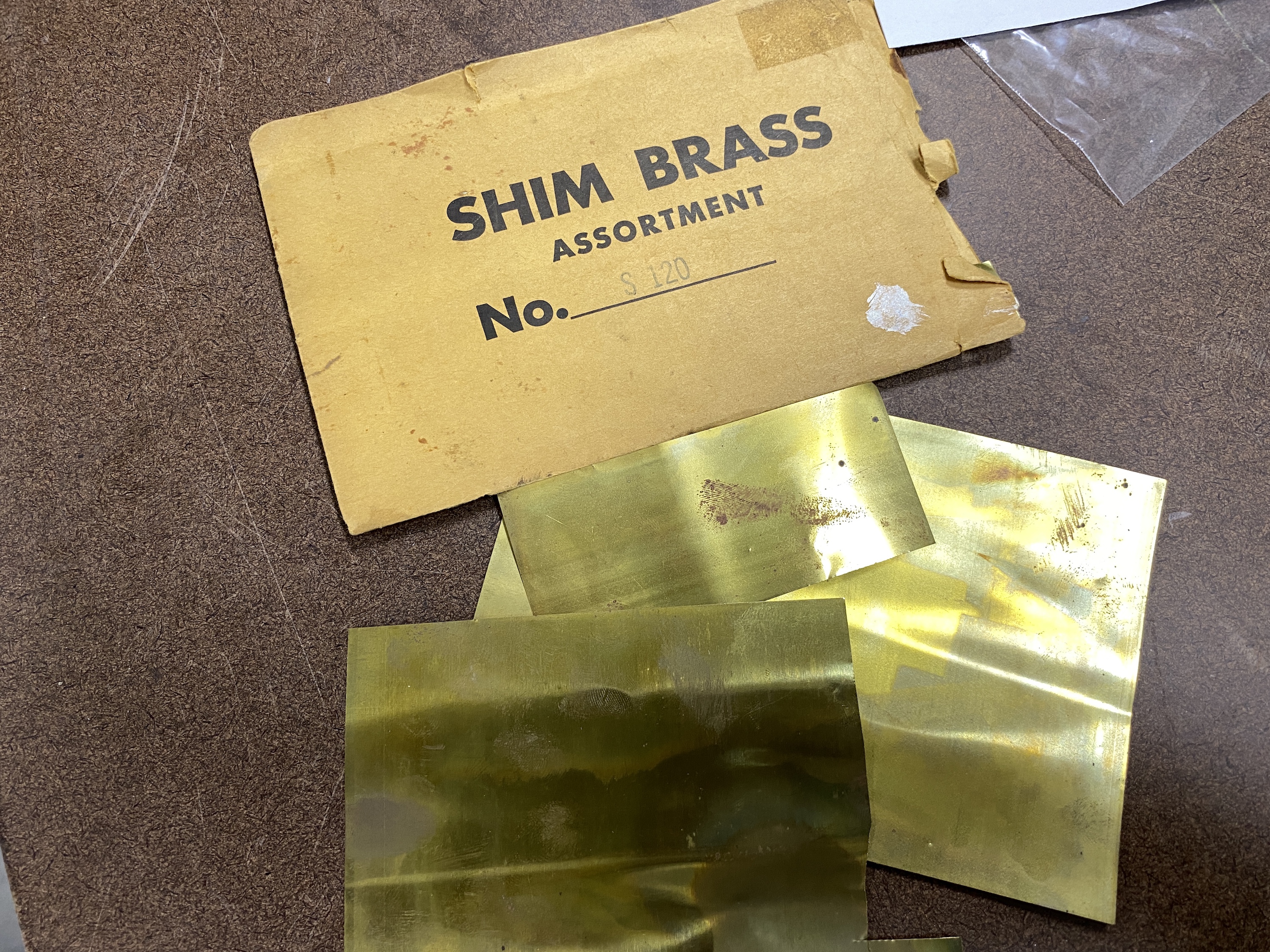

After some test fits, including with copper washer seals, I decided I needed a thinner washer. I got out my ancient supply of brass shim stock.
bkrantz
post Feb 5 2023, 10:29 PM
Post #6149
Posts: 8,342
Joined: 3-August 19
From: SW Colorado
Member No.: 23,343

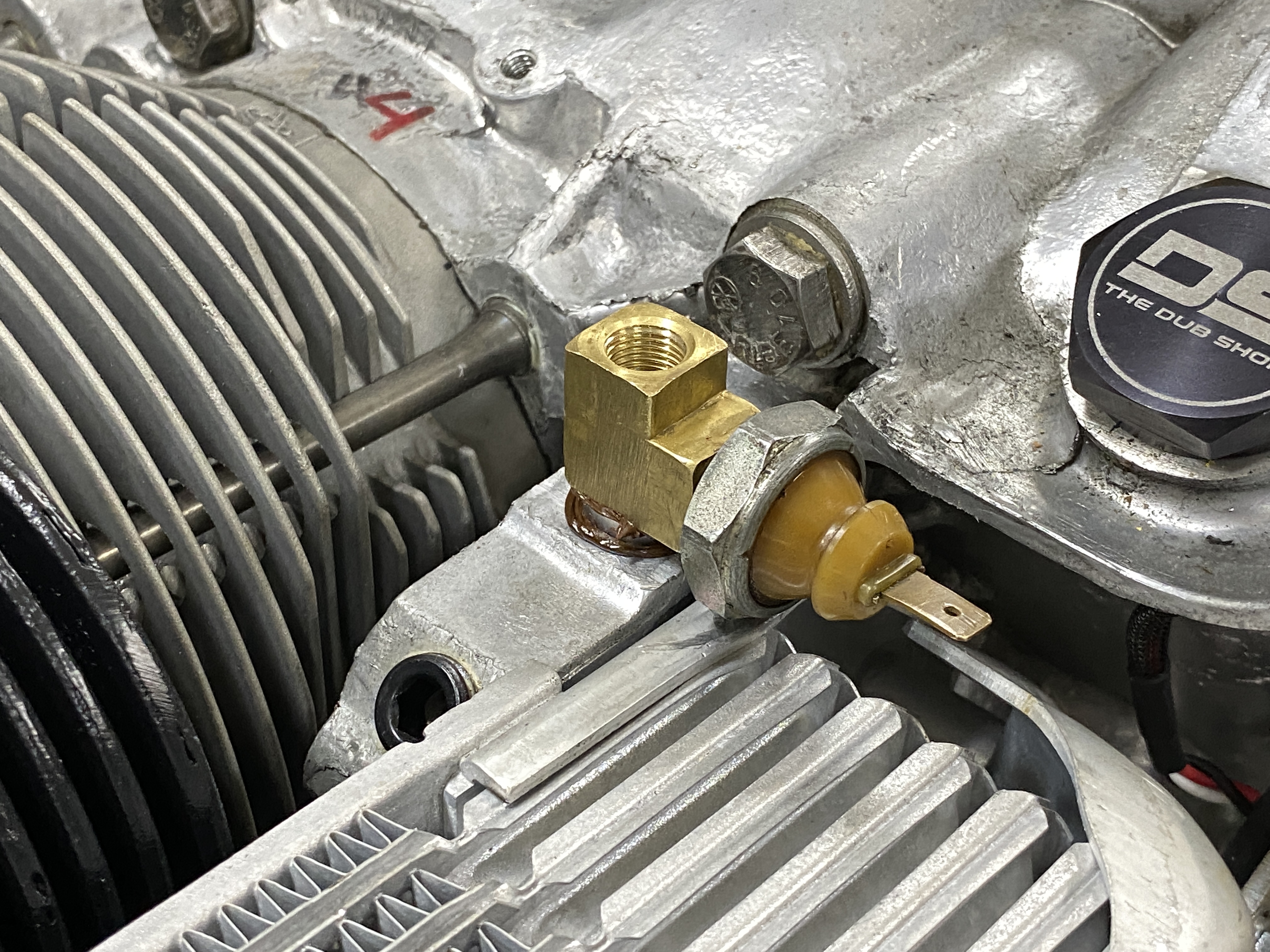

Here's my thin brass seal washer. That goes on the T-fitting, along with a 4mm aluminum spacer.

With some Permatex #1 on all surfaces, I was able to get the T-fitting tight facing the right direction. And then I installed the stock sender with another dab of Permatex.

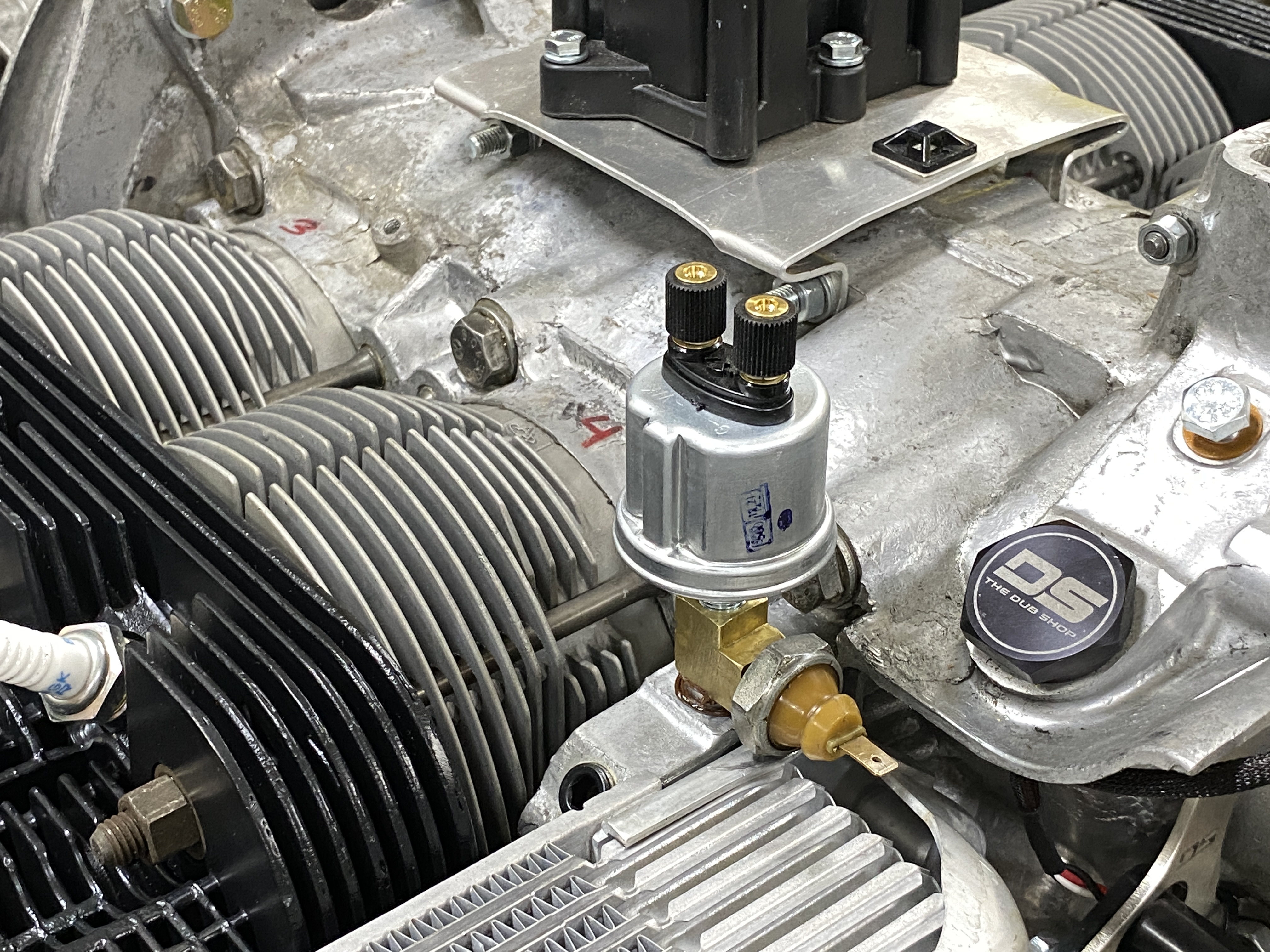

bkrantz
post Feb 5 2023, 10:35 PM
Post #6152
Posts: 8,342
Joined: 3-August 19
From: SW Colorado
Member No.: 23,343

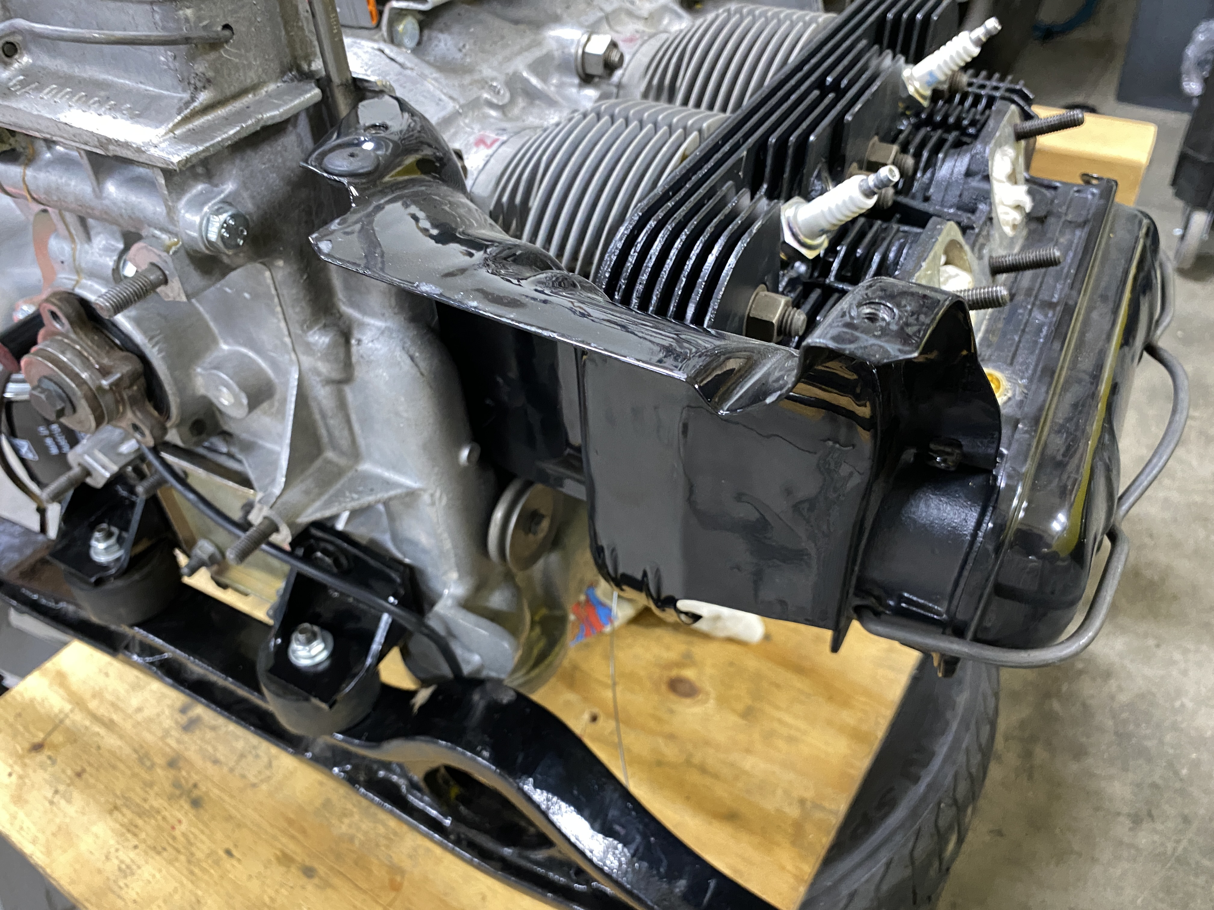

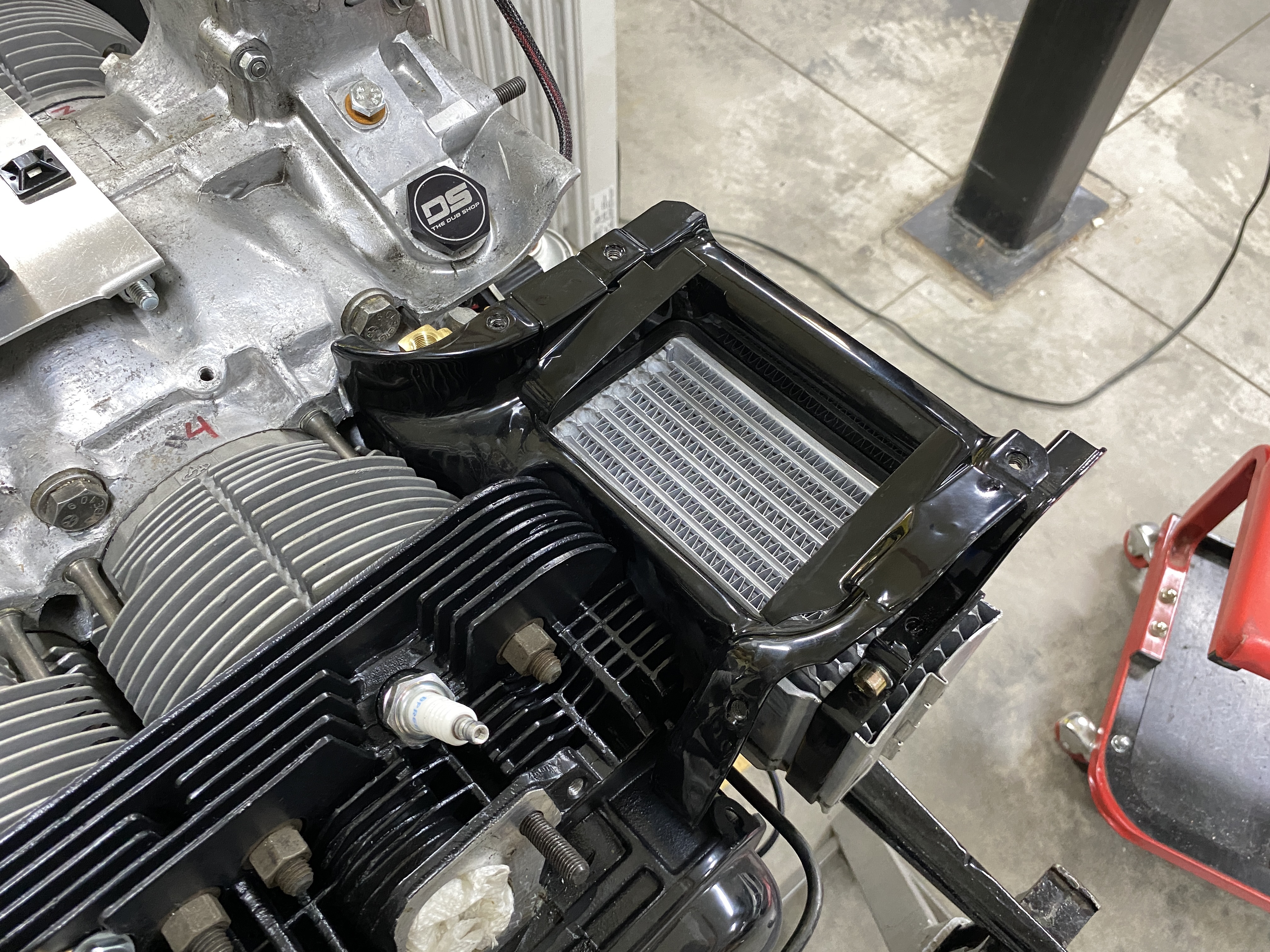

Everything looks good, so time to start putting the engine topsides together. Here's the front right sheet metal duct.

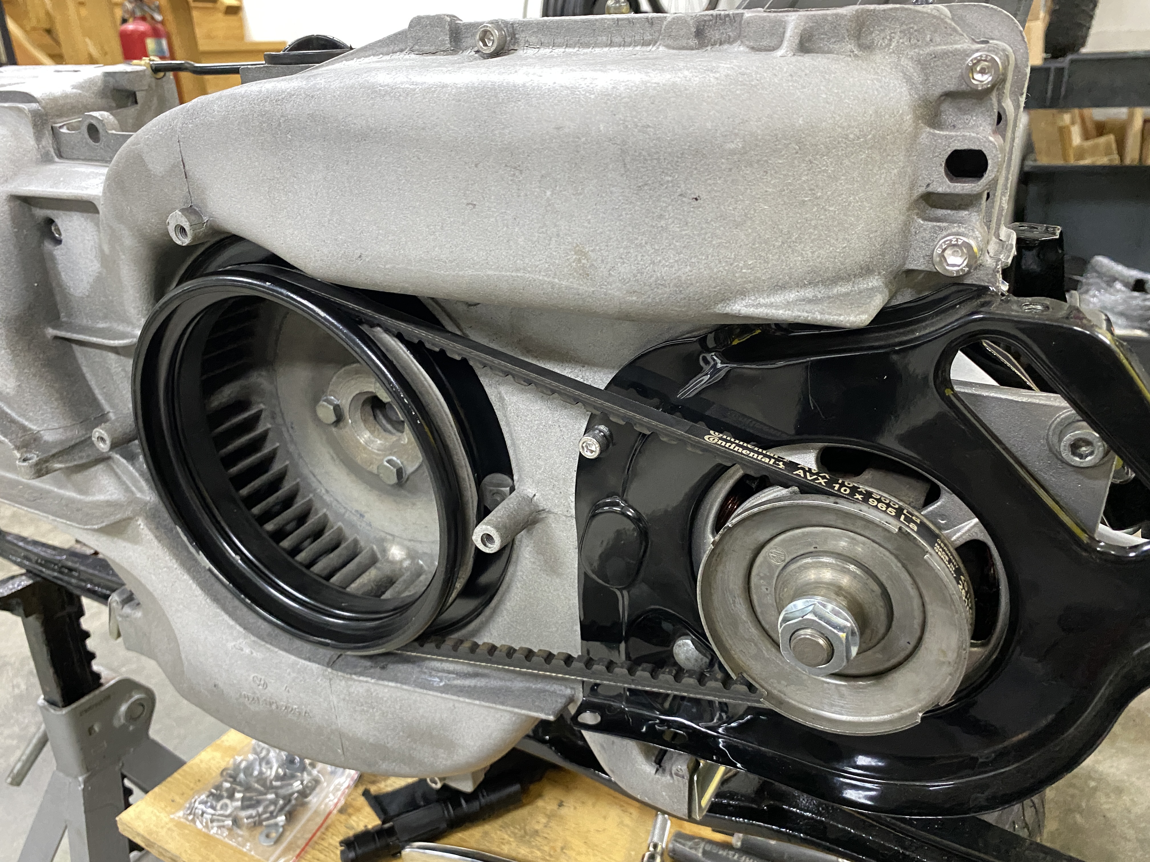

bkrantz
post Feb 5 2023, 10:36 PM
Post #6153
Posts: 8,342
Joined: 3-August 19
From: SW Colorado
Member No.: 23,343
And the left front duct.
bkrantz
Post #6154
Posts: 8,342
Joined: 3-August 19
From: SW Colorado
Member No.: 23,343
And finished up today with the inner blower housing.

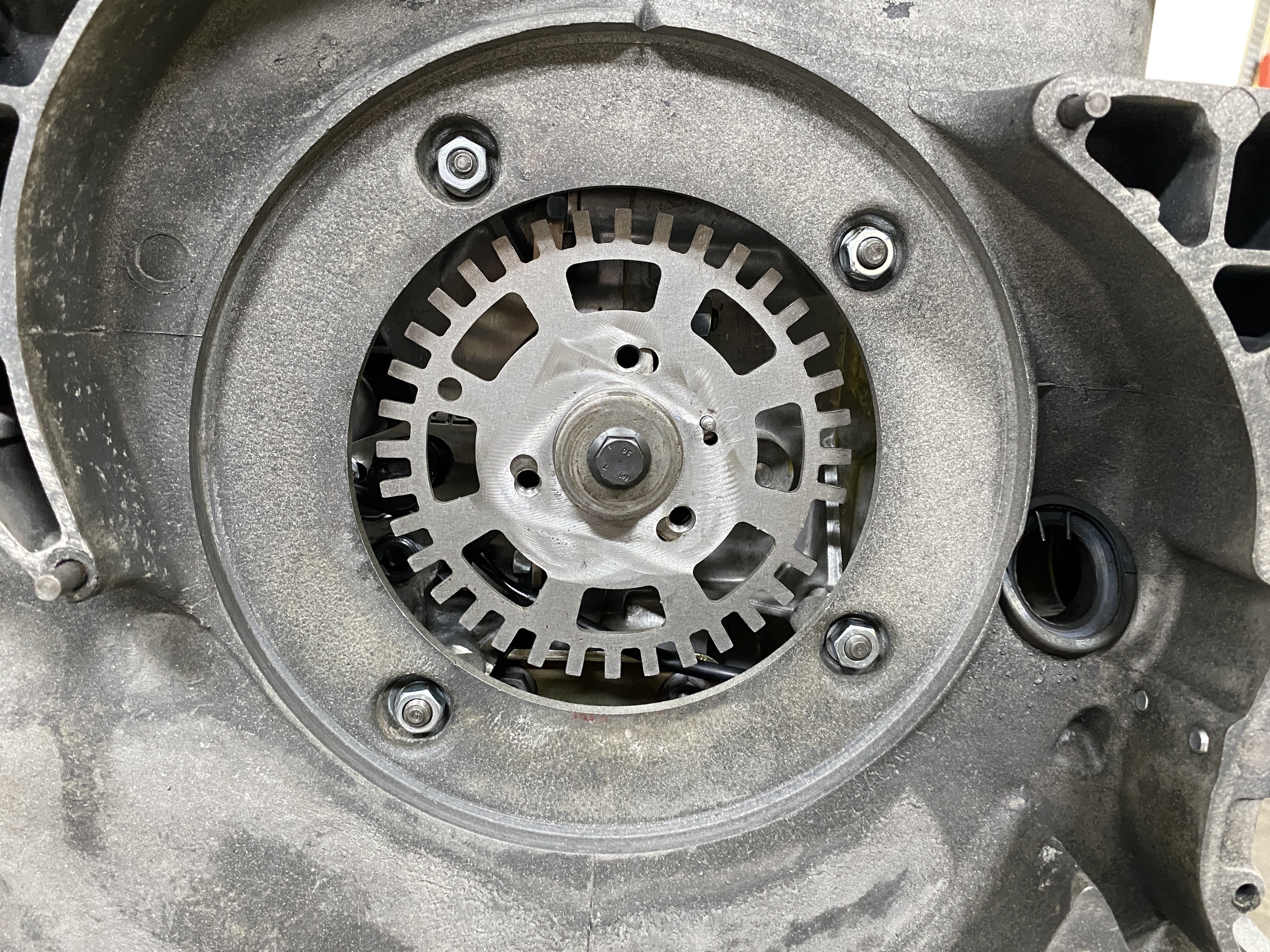

bkrantz
post Feb 6 2023, 08:10 PM
Post #6155
Posts: 8,342
Joined: 3-August 19
From: SW Colorado
Member No.: 23,343
Hall sensor tooth gear.

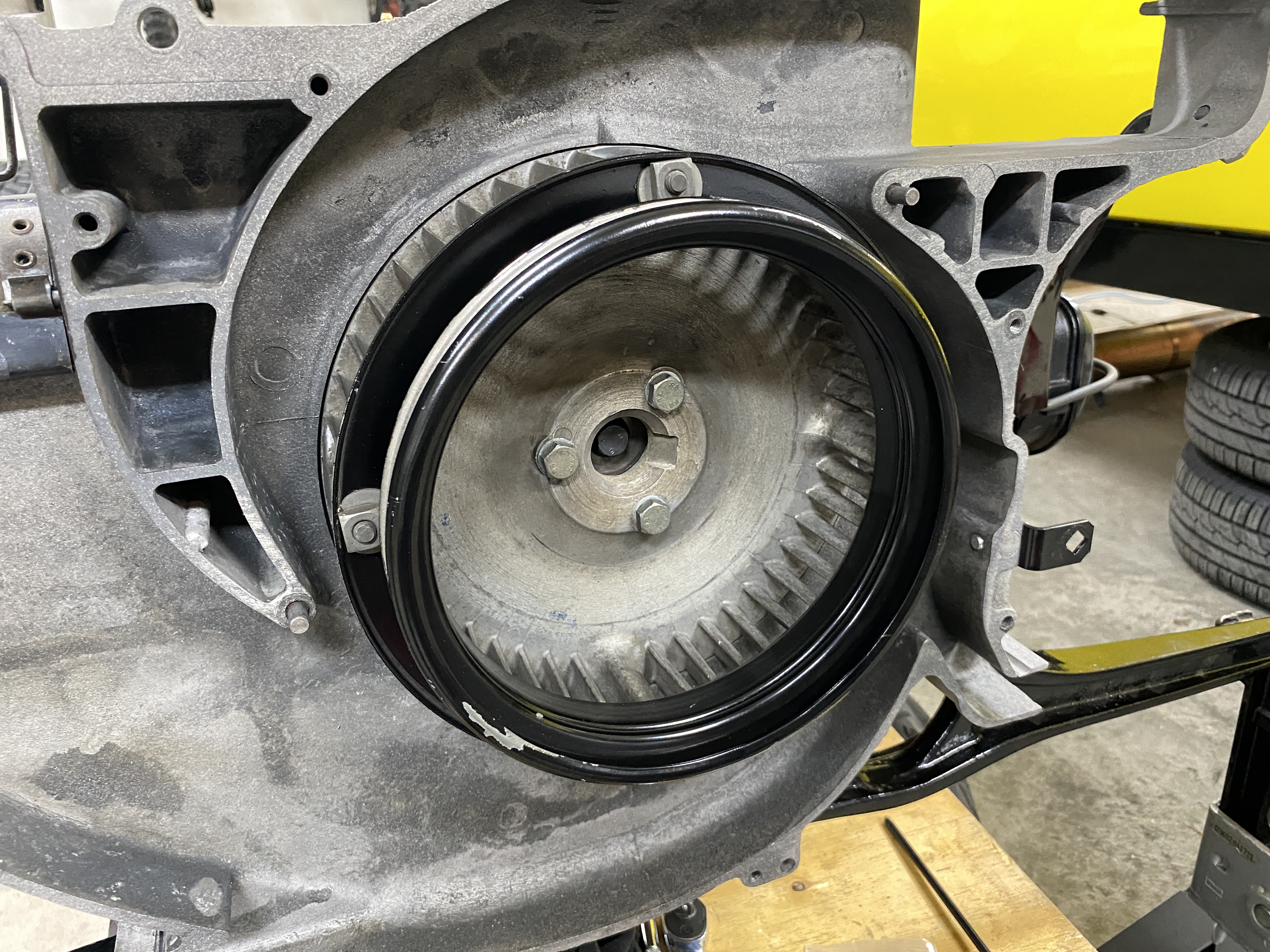

Blower cage.

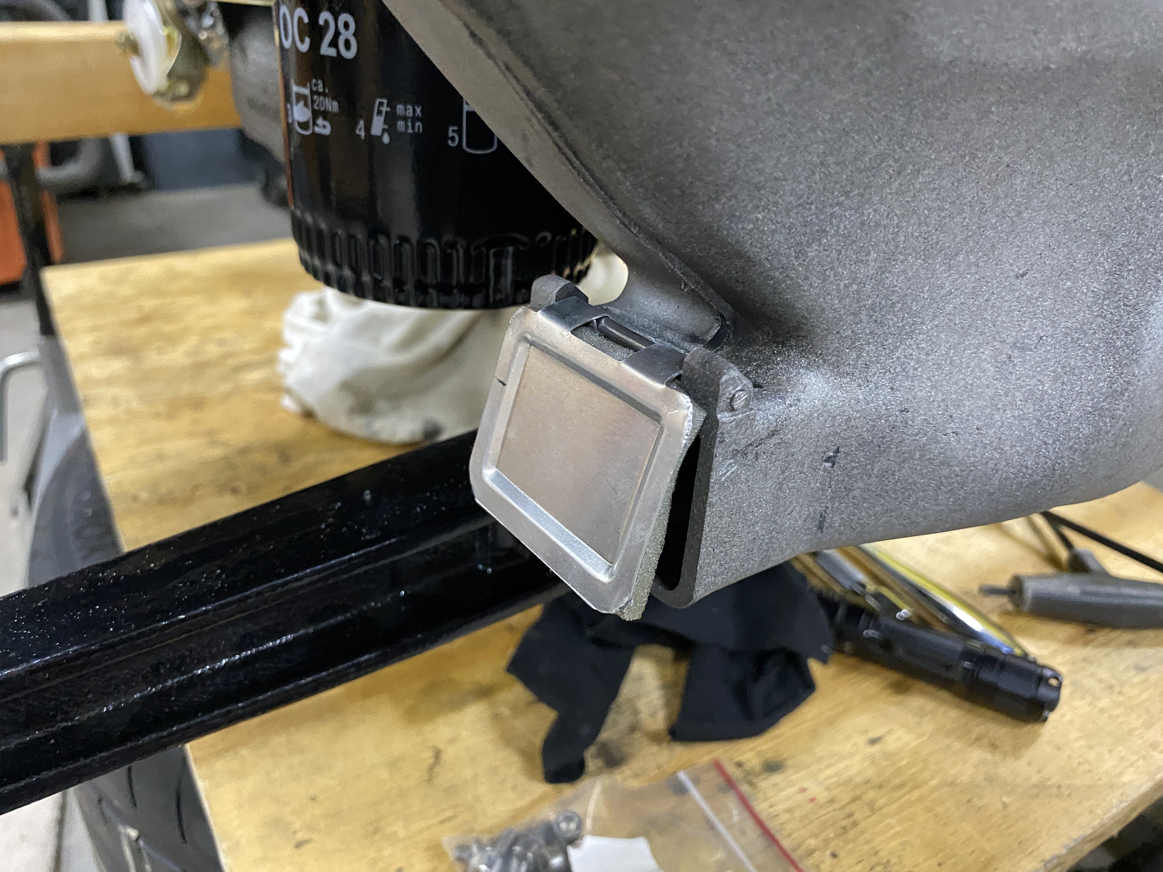

bkrantz
post Feb 6 2023, 08:12 PM
Post #6157
Posts: 8,342
Joined: 3-August 19
From: SW Colorado
Member No.: 23,343
Blow-back vent flappers.

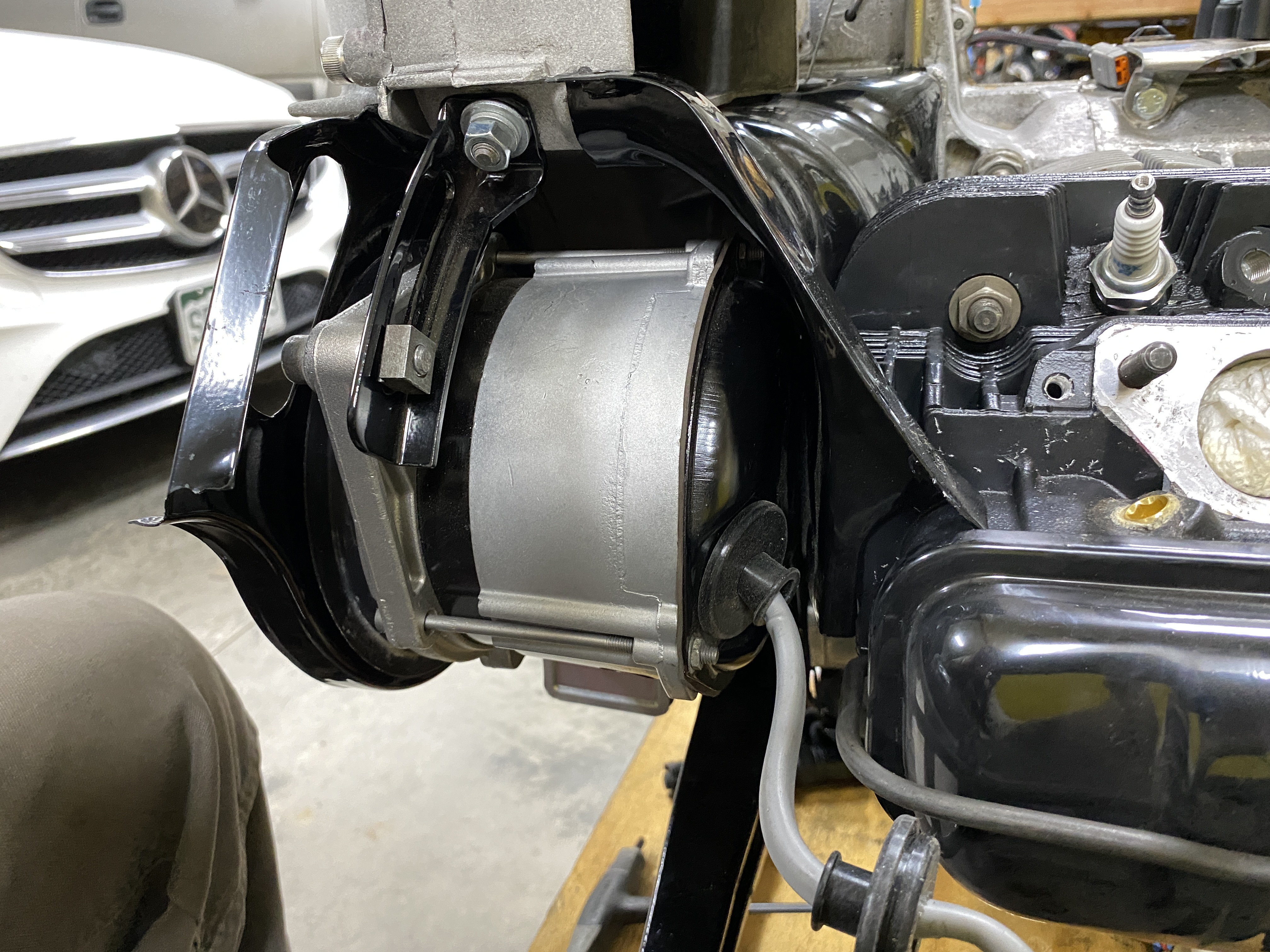

Alternator.

Front blower housing and alternator sheet metal. I even remembered the plastic baffle ring.

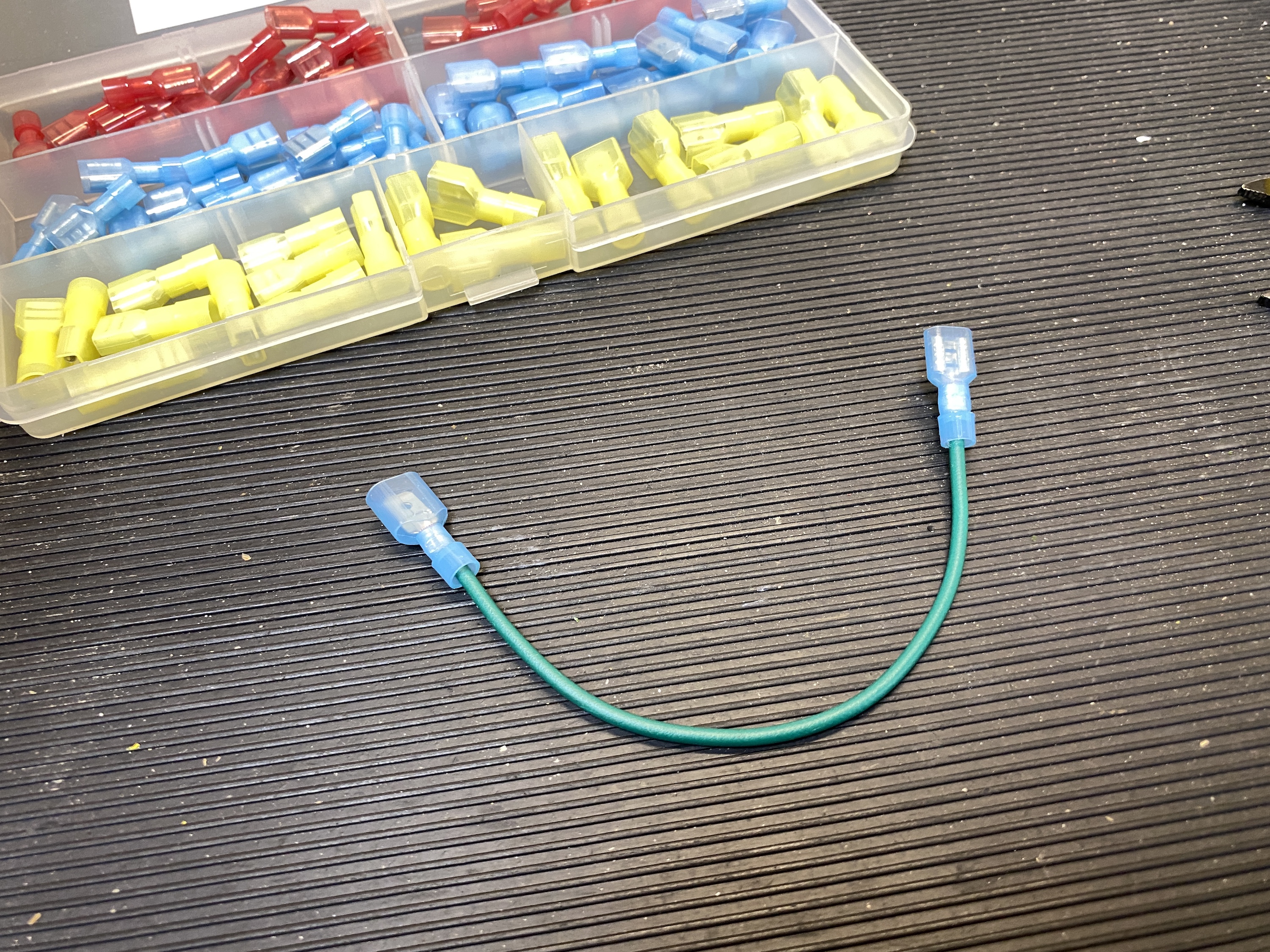

I made a shorter jumper cable for the stock oil pressure sensor.
