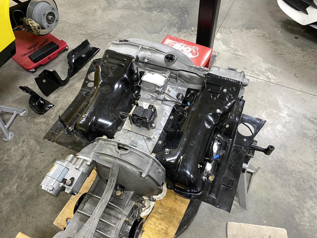

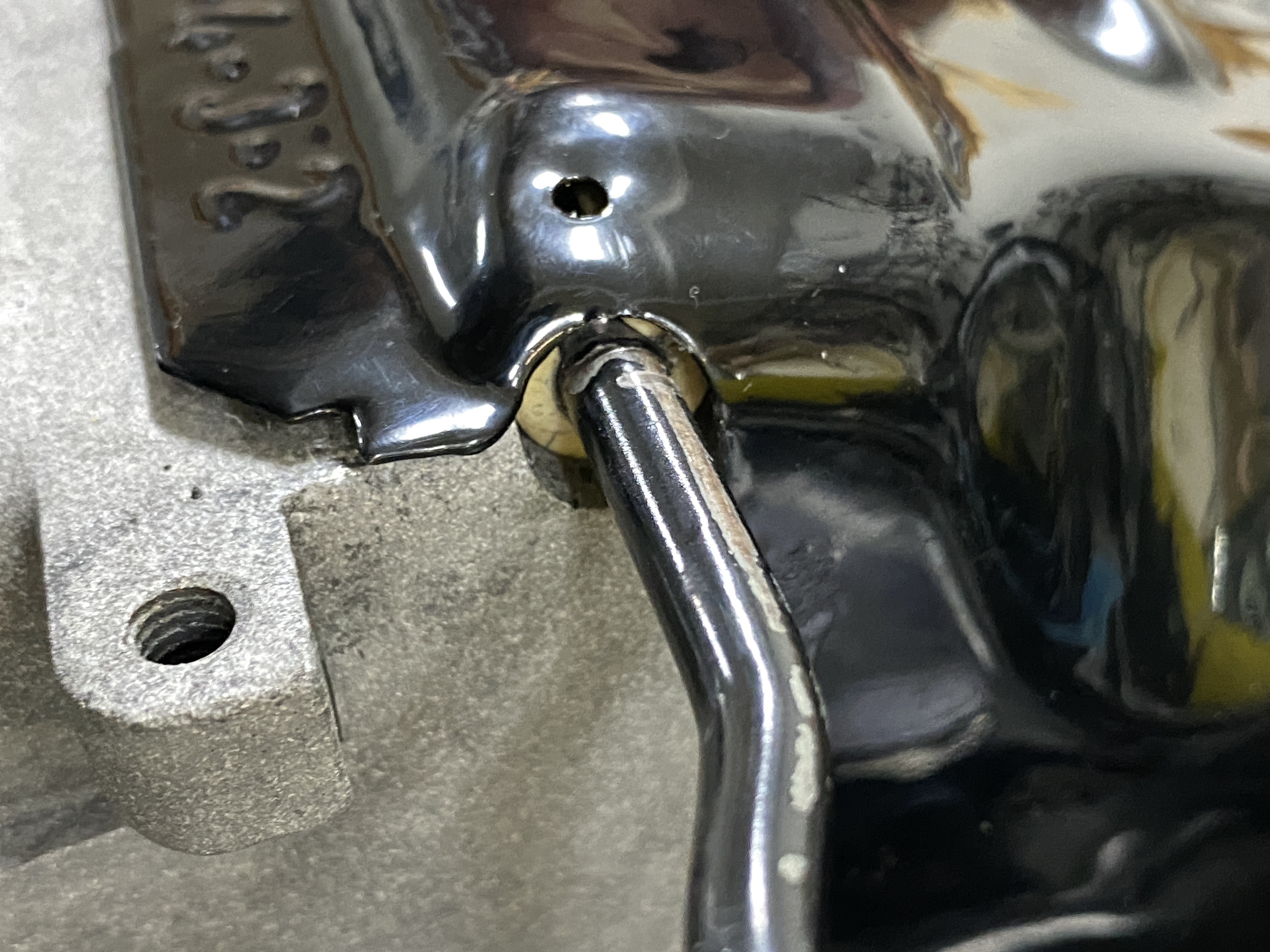

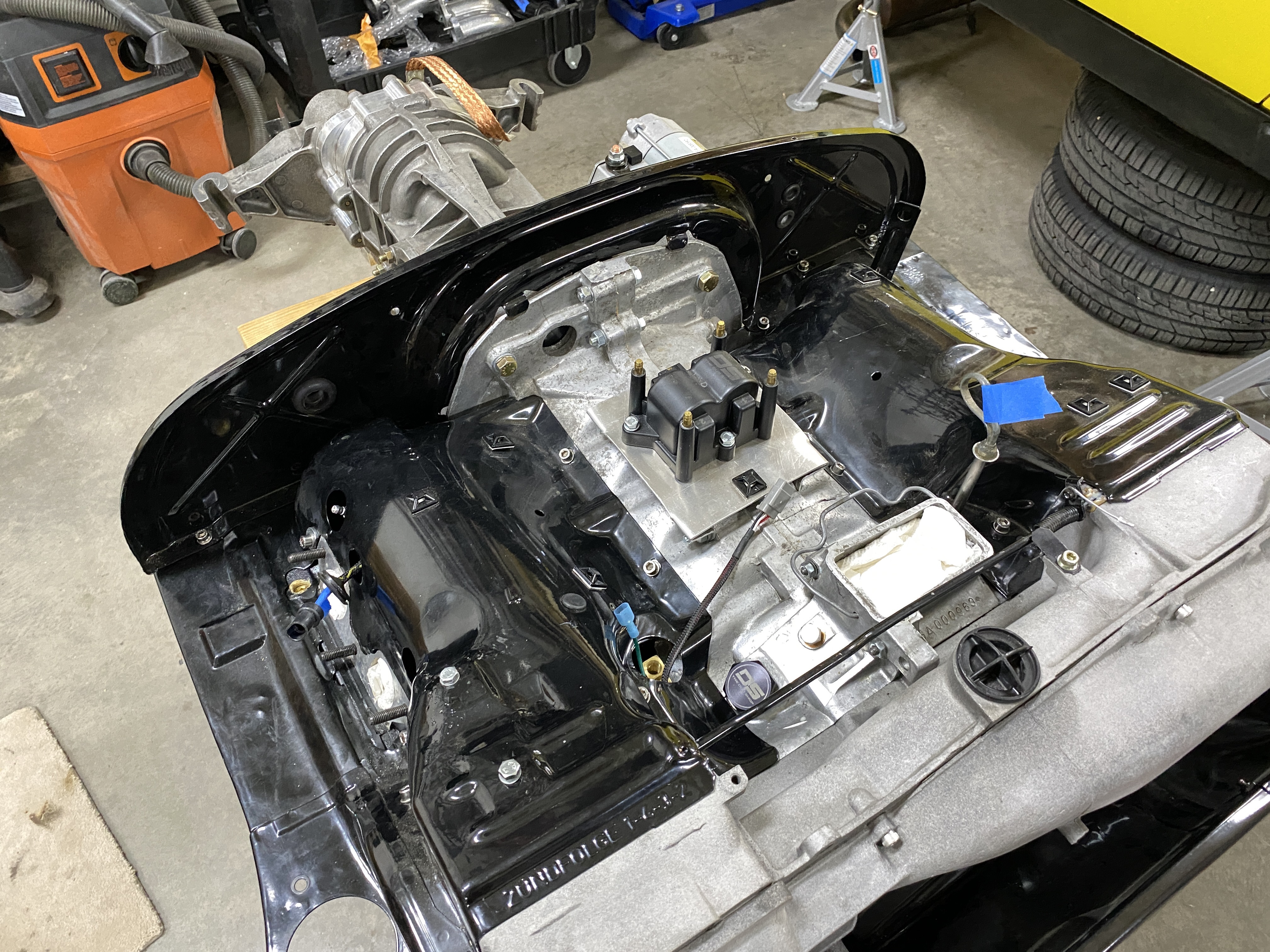

Roughly how it fits.

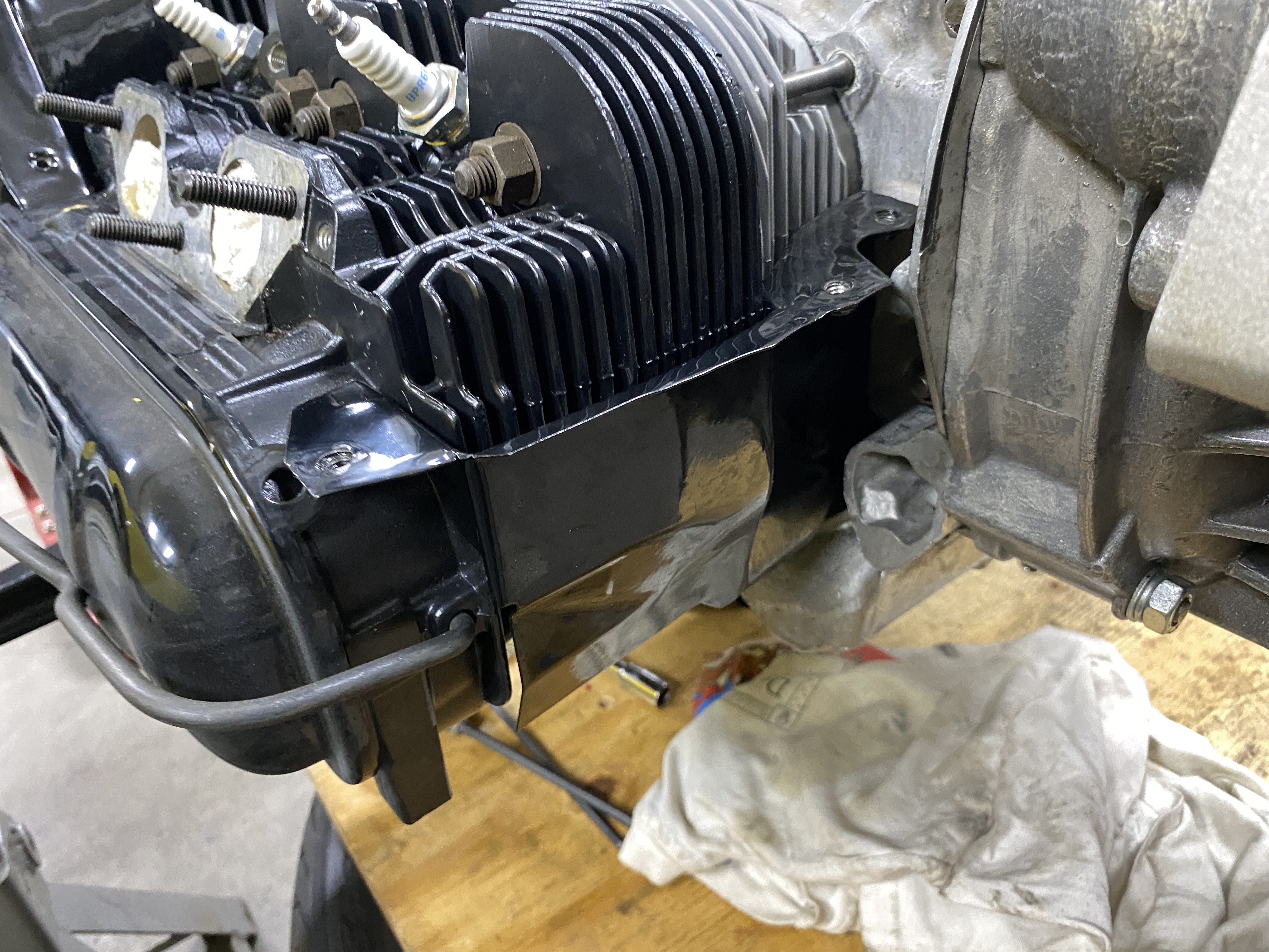

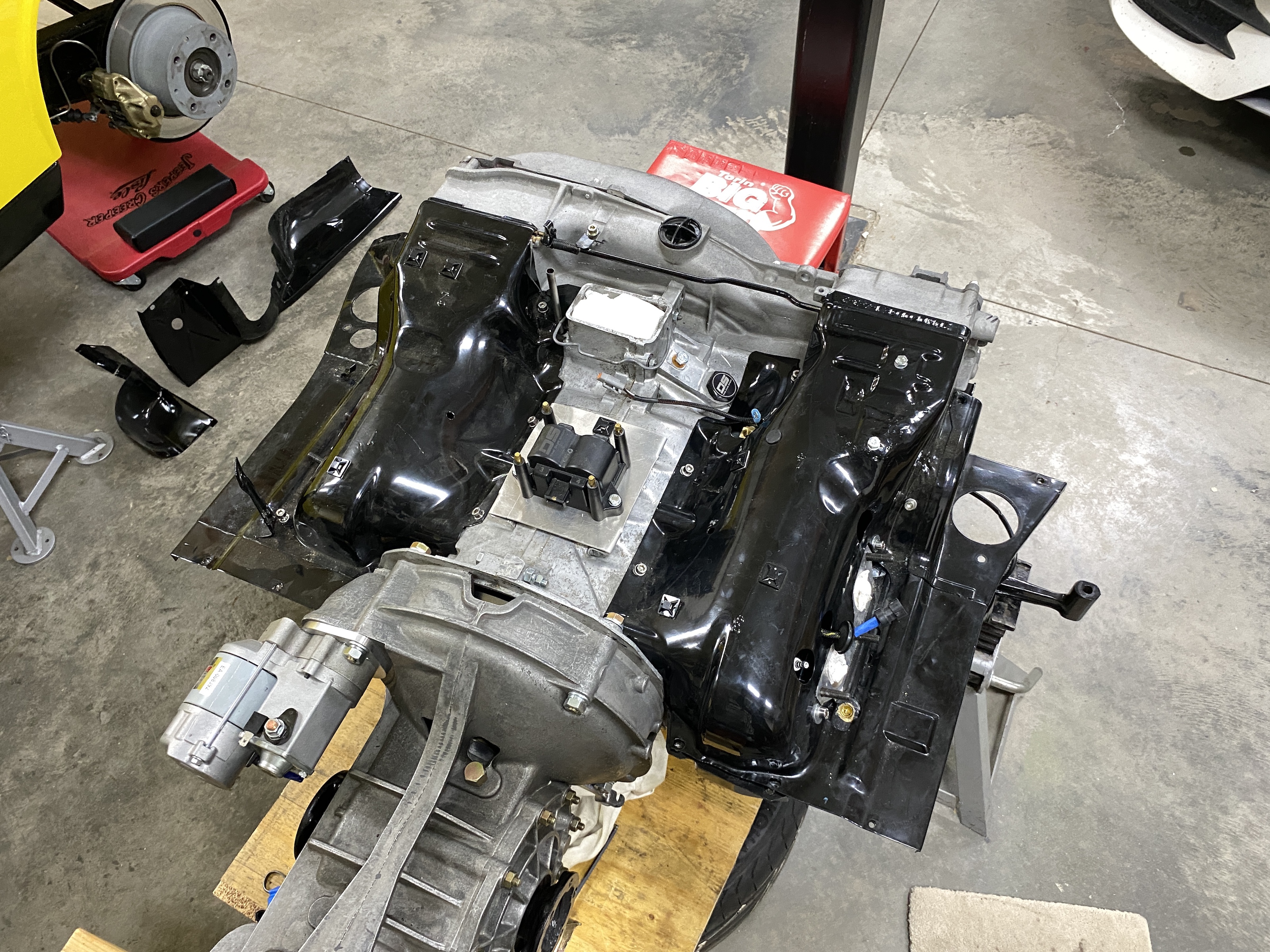

Rear sheet metal pieces, left and right.
bkrantz
post Feb 6 2023, 08:18 PM
Post #6163
Posts: 8,342
Joined: 3-August 19
From: SW Colorado
Member No.: 23,343
Side sheet metal pieces.
bkrantz
post Feb 6 2023, 08:19 PM
Post #6164
Posts: 8,342
Joined: 3-August 19
From: SW Colorado
Member No.: 23,343
Front sheet metal.

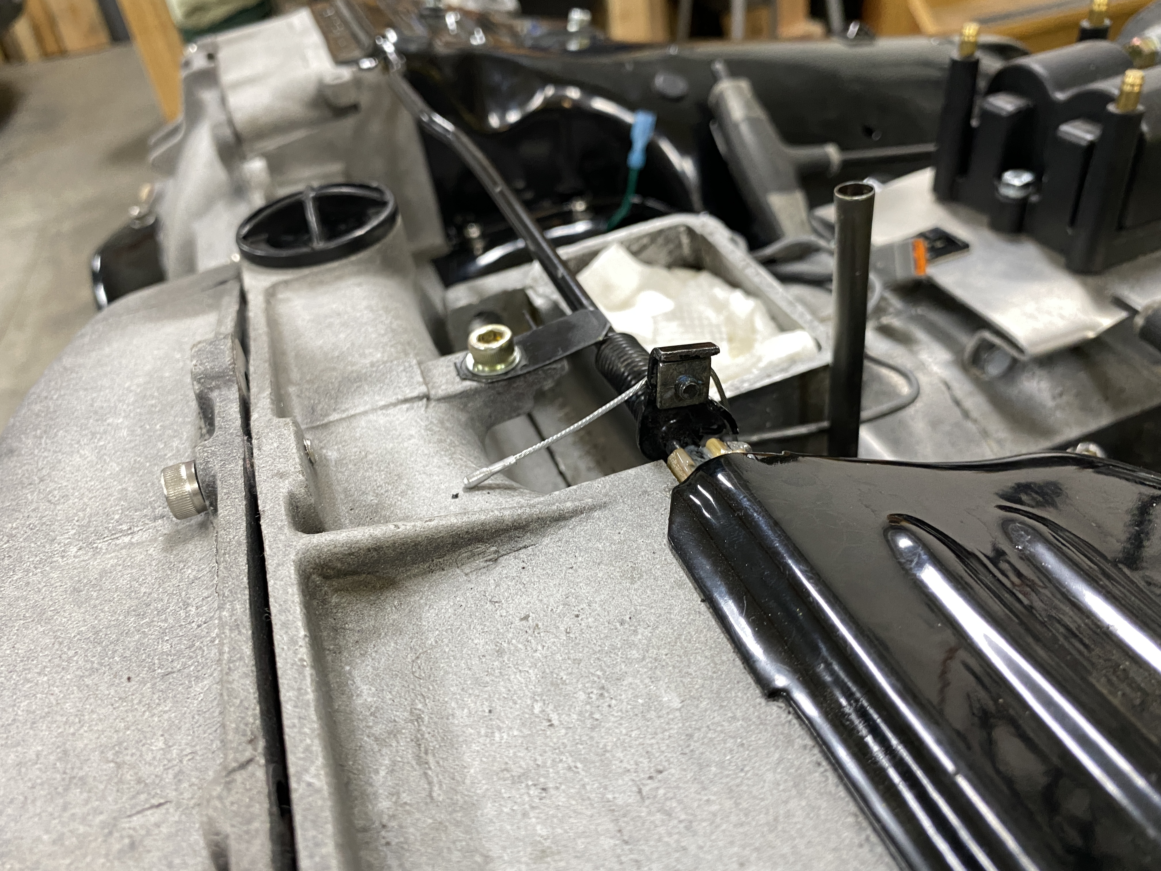

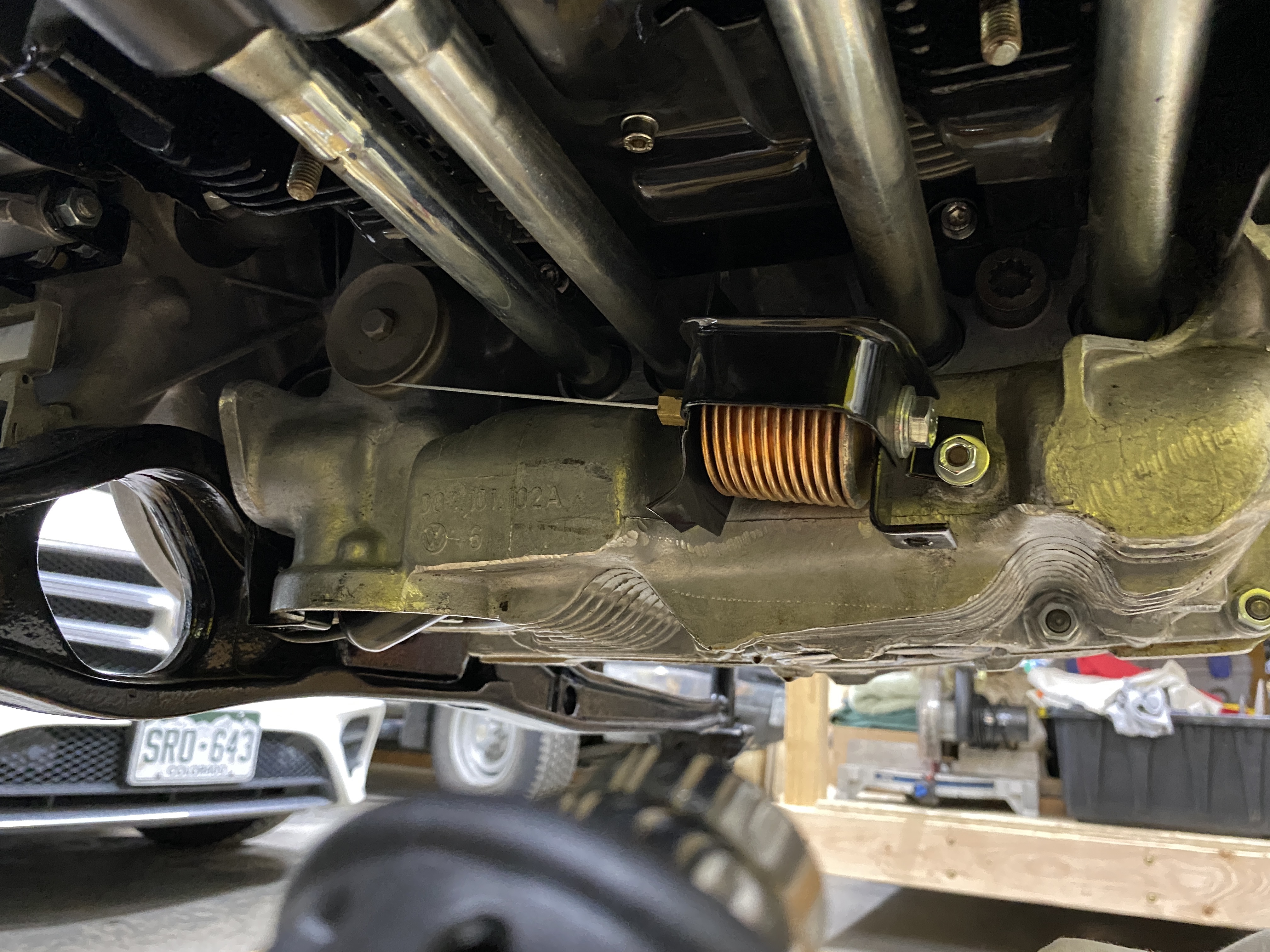

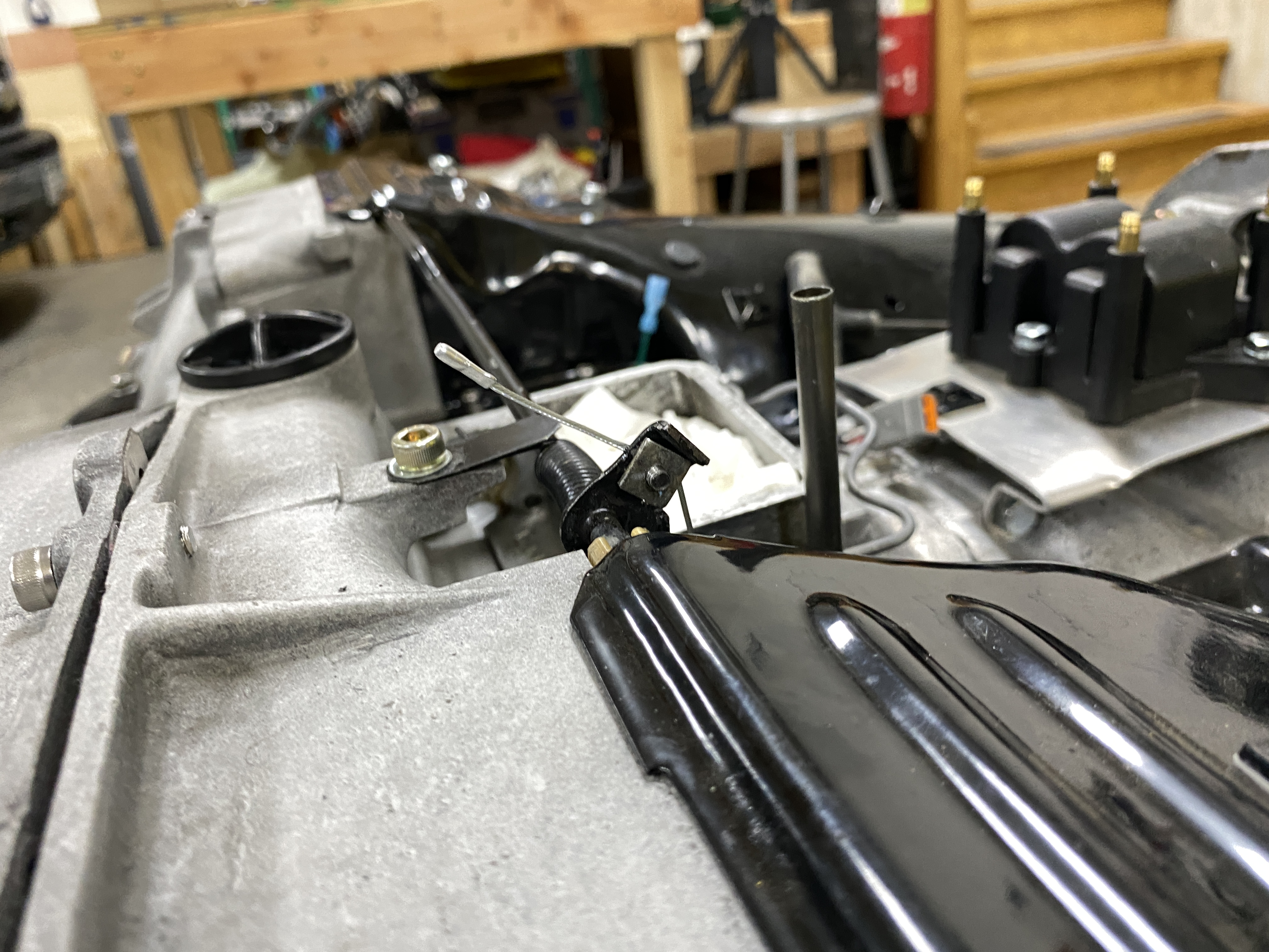

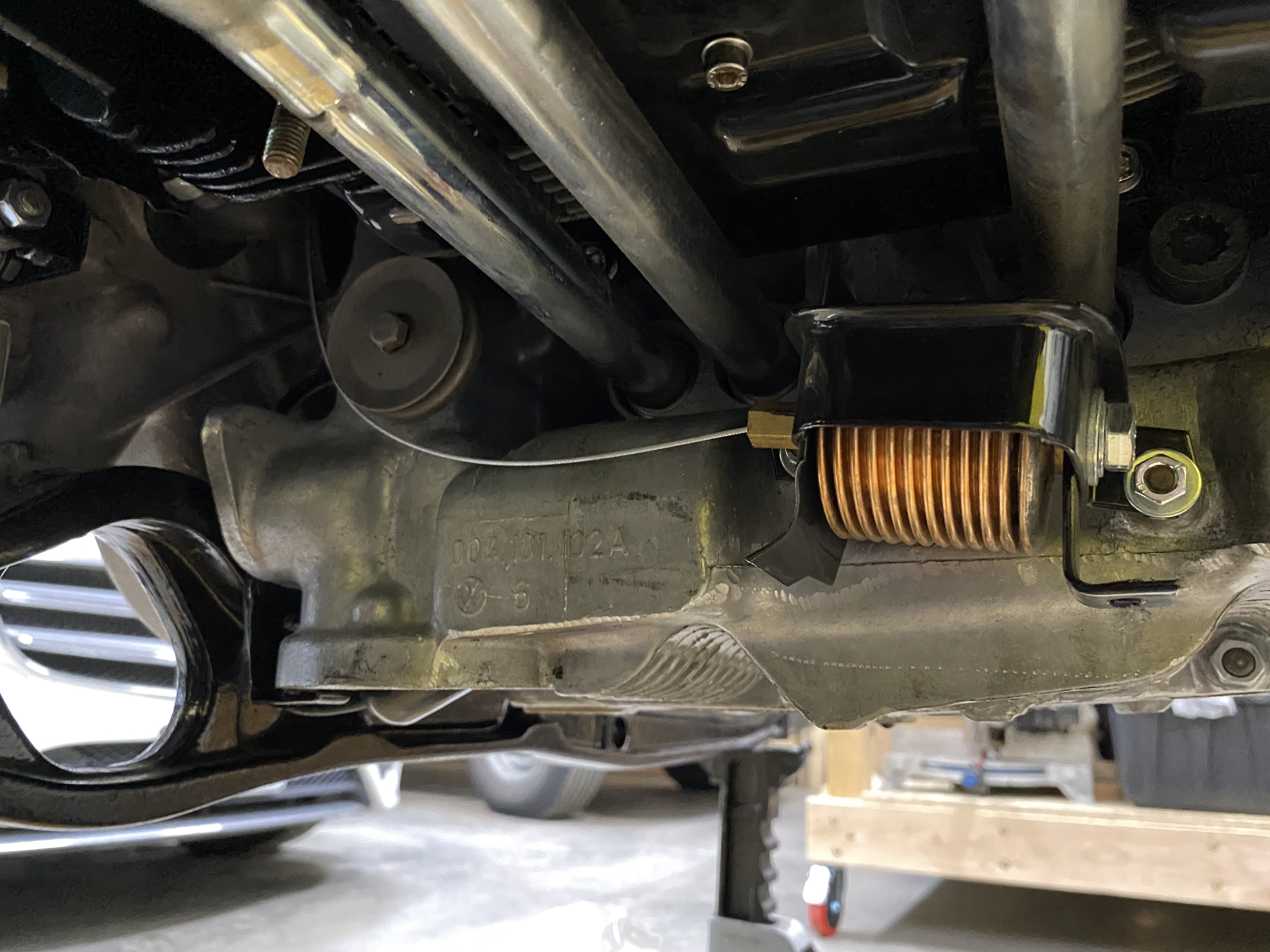

I attached the thermostat cable to the flap pivot.
bkrantz
post Feb 6 2023, 08:21 PM
Post #6166
Posts: 8,342
Joined: 3-August 19
From: SW Colorado
Member No.: 23,343

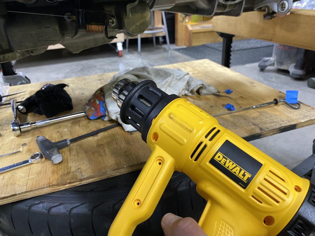

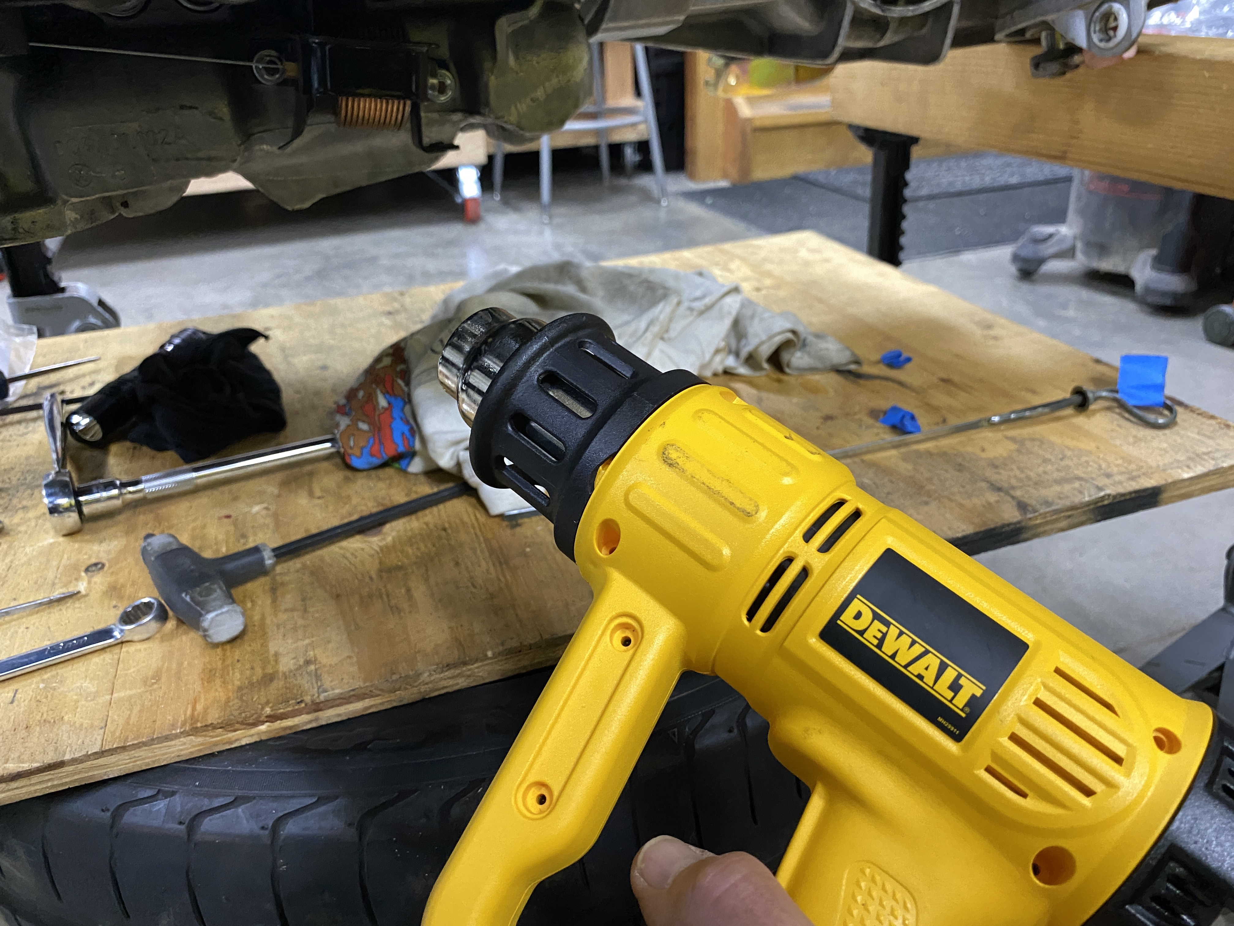

A little voice told me to test it, so I got out my heat gun.
bkrantz
post Feb 6 2023, 08:22 PM
Post #6167
Posts: 8,342
Joined: 3-August 19
From: SW Colorado
Member No.: 23,343
The thermostat bellows expanded, but the cable went slack.
bkrantz
post Feb 6 2023, 08:23 PM
Post #6168
Posts: 8,342
Joined: 3-August 19
From: SW Colorado
Member No.: 23,343

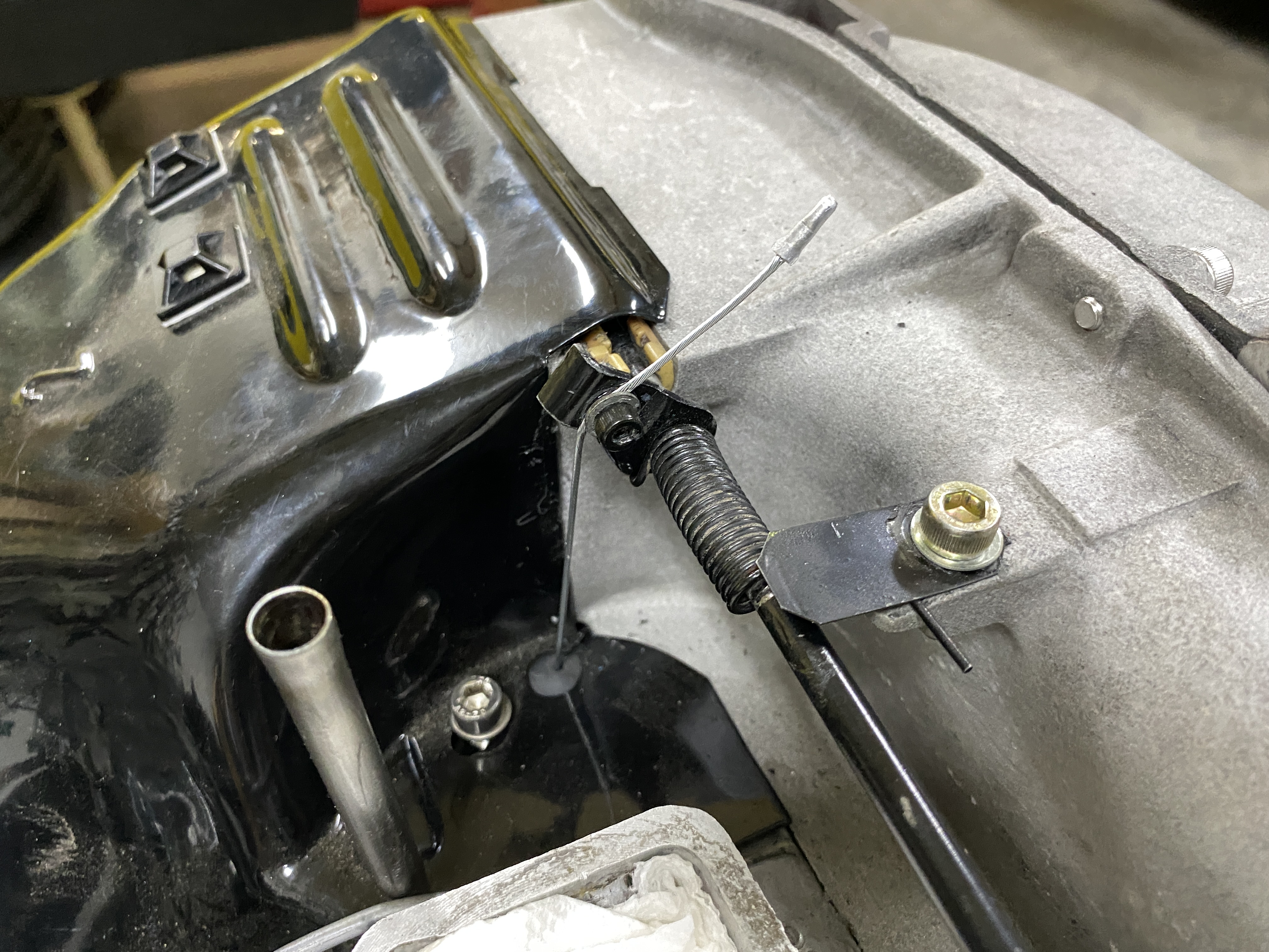

And the flap pivot did not rotate much. I could move it by hand, but it was binding.
bkrantz
post Feb 6 2023, 08:24 PM
Post #6169
Posts: 8,342
Joined: 3-August 19
From: SW Colorado
Member No.: 23,343
Turns out the plastic bushing on the right side was not seated properly. I loosened the sheet metal and fixed that.
bkrantz
post Feb 6 2023, 08:25 PM
Post #6170
Posts: 8,342
Joined: 3-August 19
From: SW Colorado
Member No.: 23,343
I hit the bellows with the heat gun again, and this time the cable stayed tight.
bkrantz
post Feb 6 2023, 08:26 PM
Post #6171
Posts: 8,342
Joined: 3-August 19
From: SW Colorado
Member No.: 23,343
And the pivot and flaps rotated as specified.

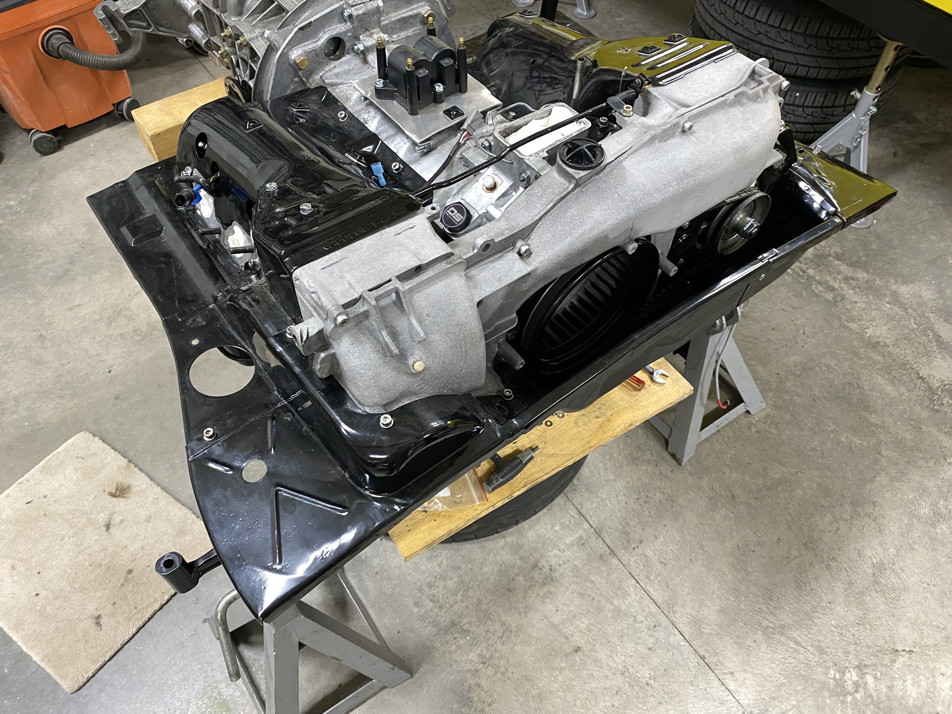

With the rear piece, I have all the top sheet metal on again.

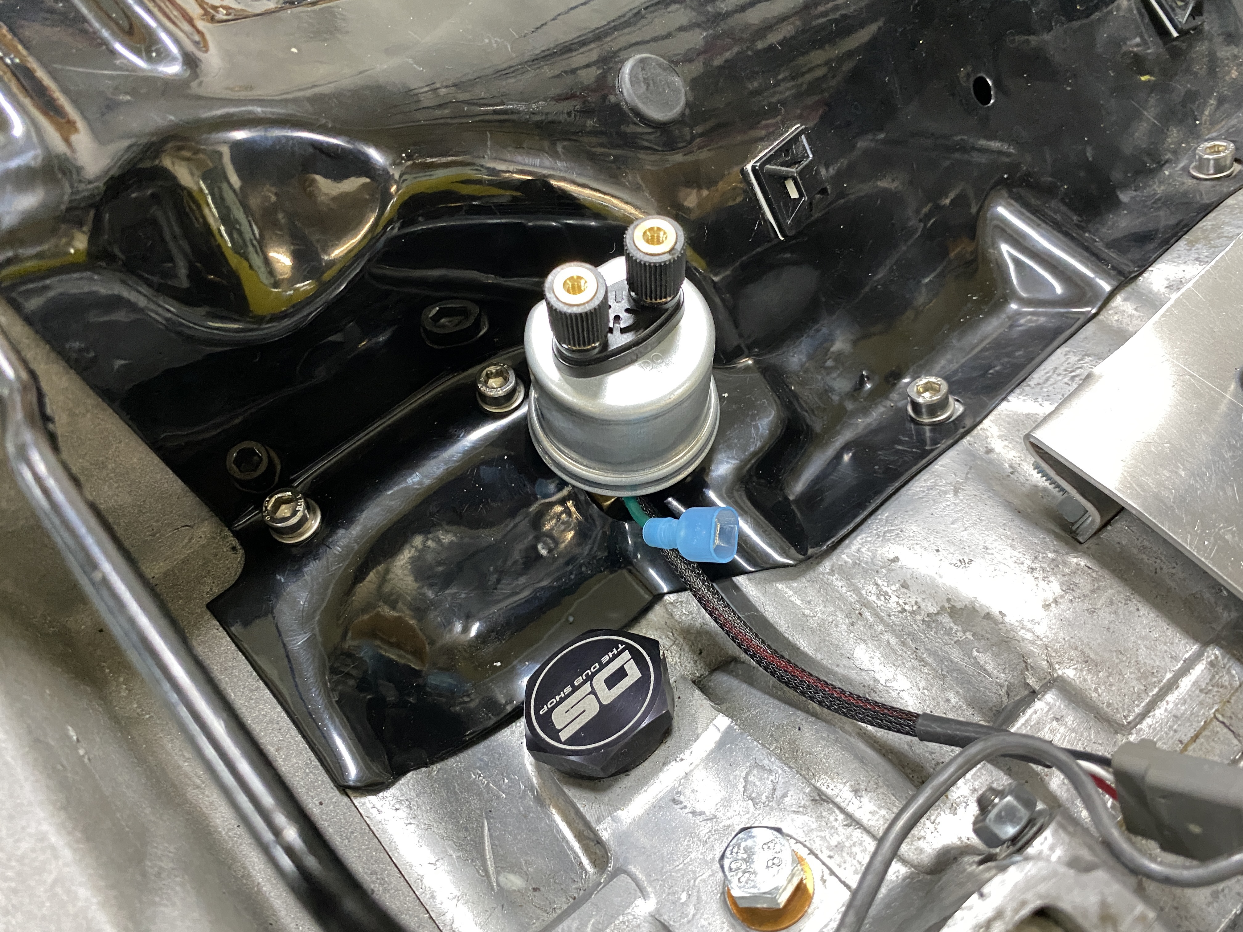

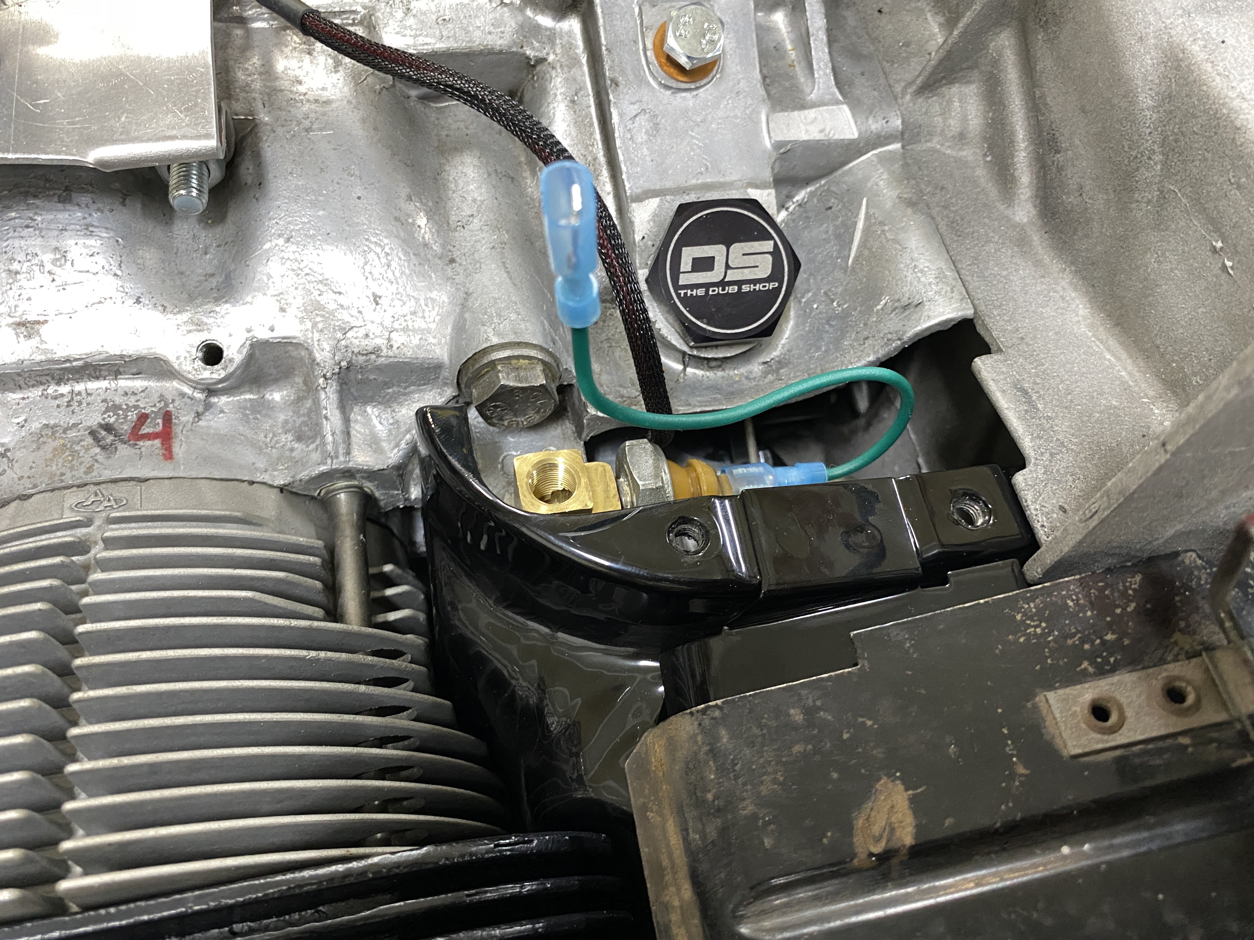

Last thing today: the new VDO sensor.

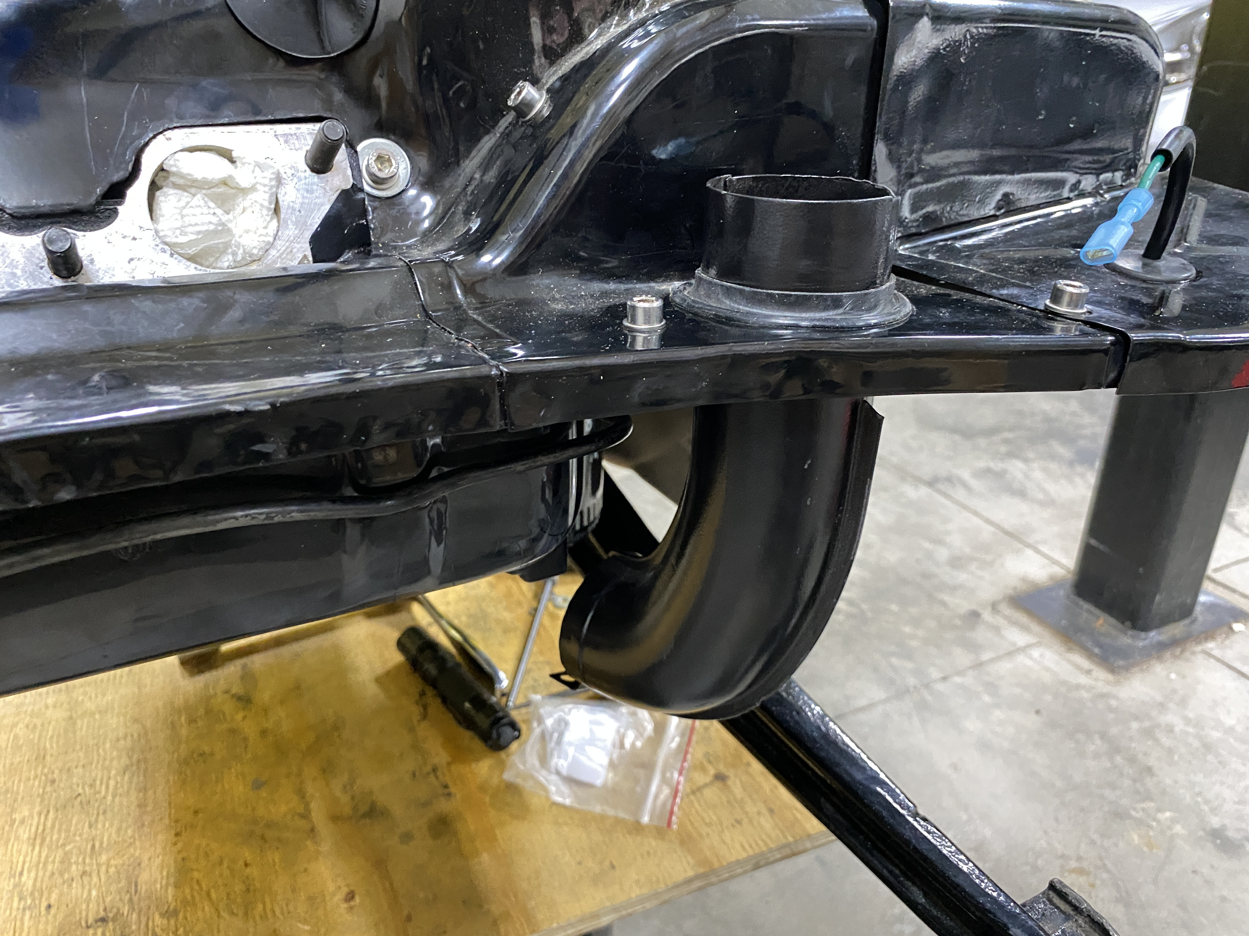

A few more bits today. Spark plug wires.
bkrantz
post Feb 9 2023, 08:24 PM
Post #6175
Posts: 8,342
Joined: 3-August 19
From: SW Colorado
Member No.: 23,343
J-tubes.

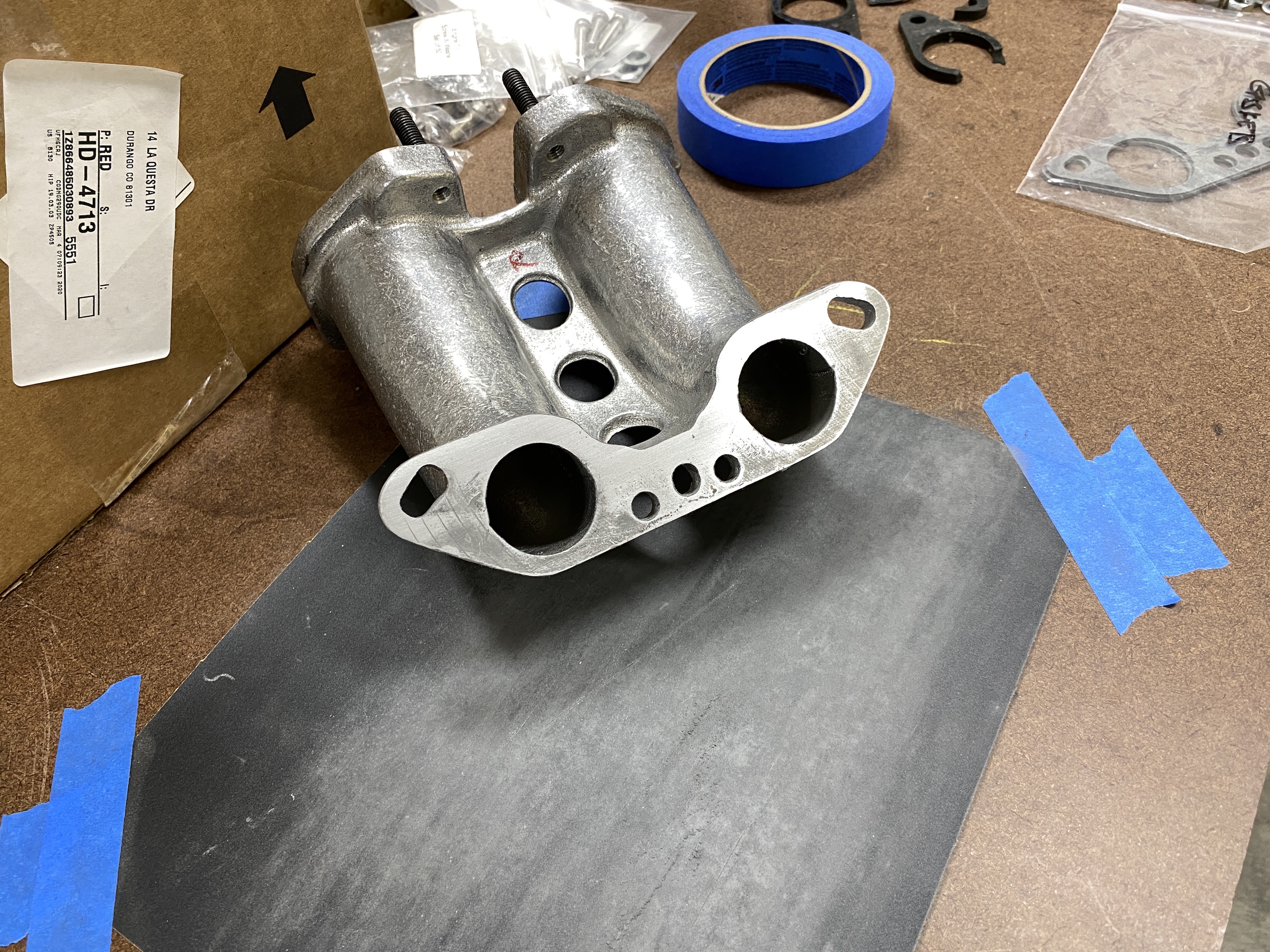

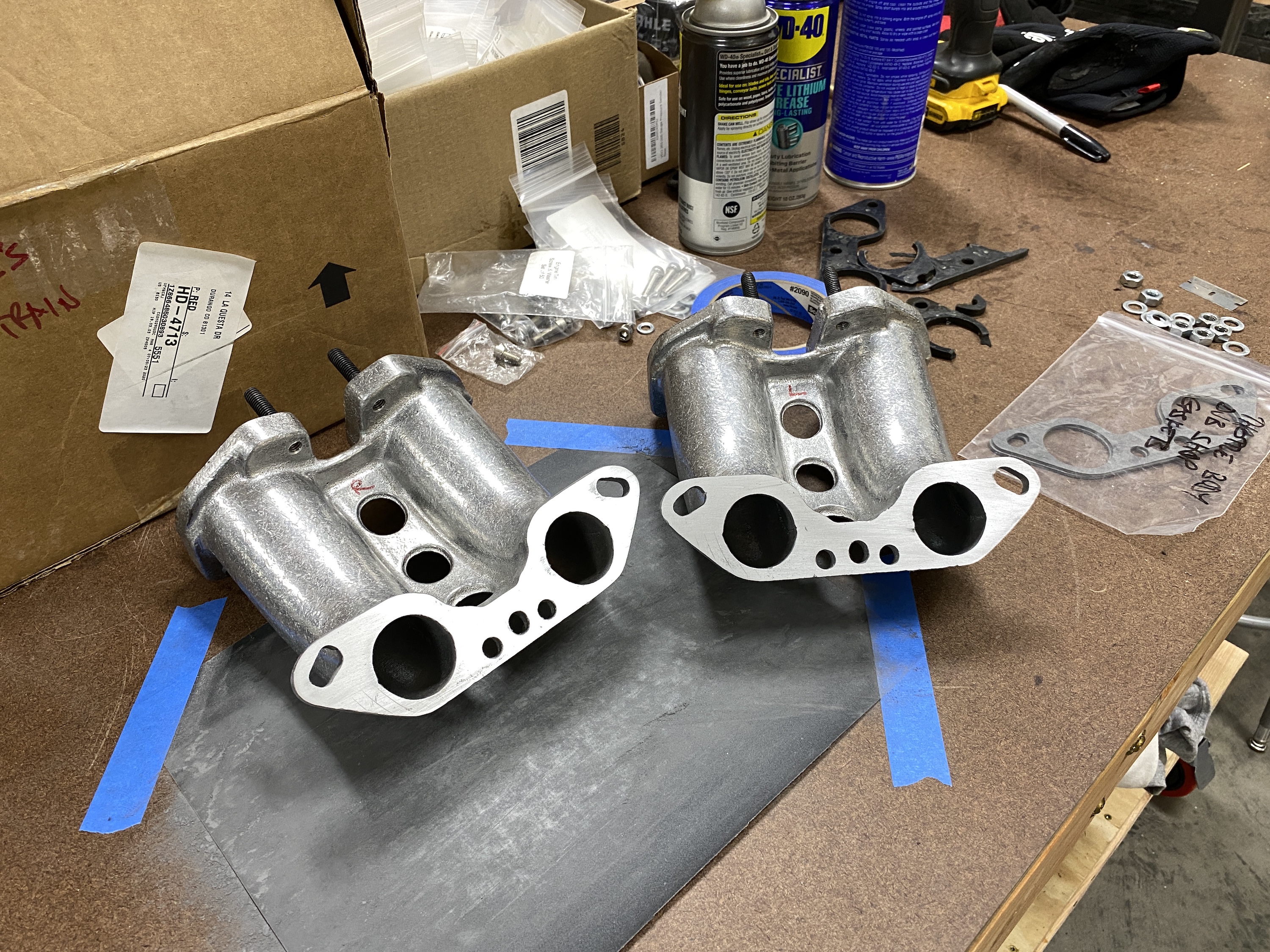

I cleaned the old gaskets off the intakes, and it looked like they did not seal evenly. A bit of scuffing on some sandpaper proves that.
bkrantz
post Feb 9 2023, 08:27 PM
Post #6177
Posts: 8,342
Joined: 3-August 19
From: SW Colorado
Member No.: 23,343
More sanding. Getting flatter.

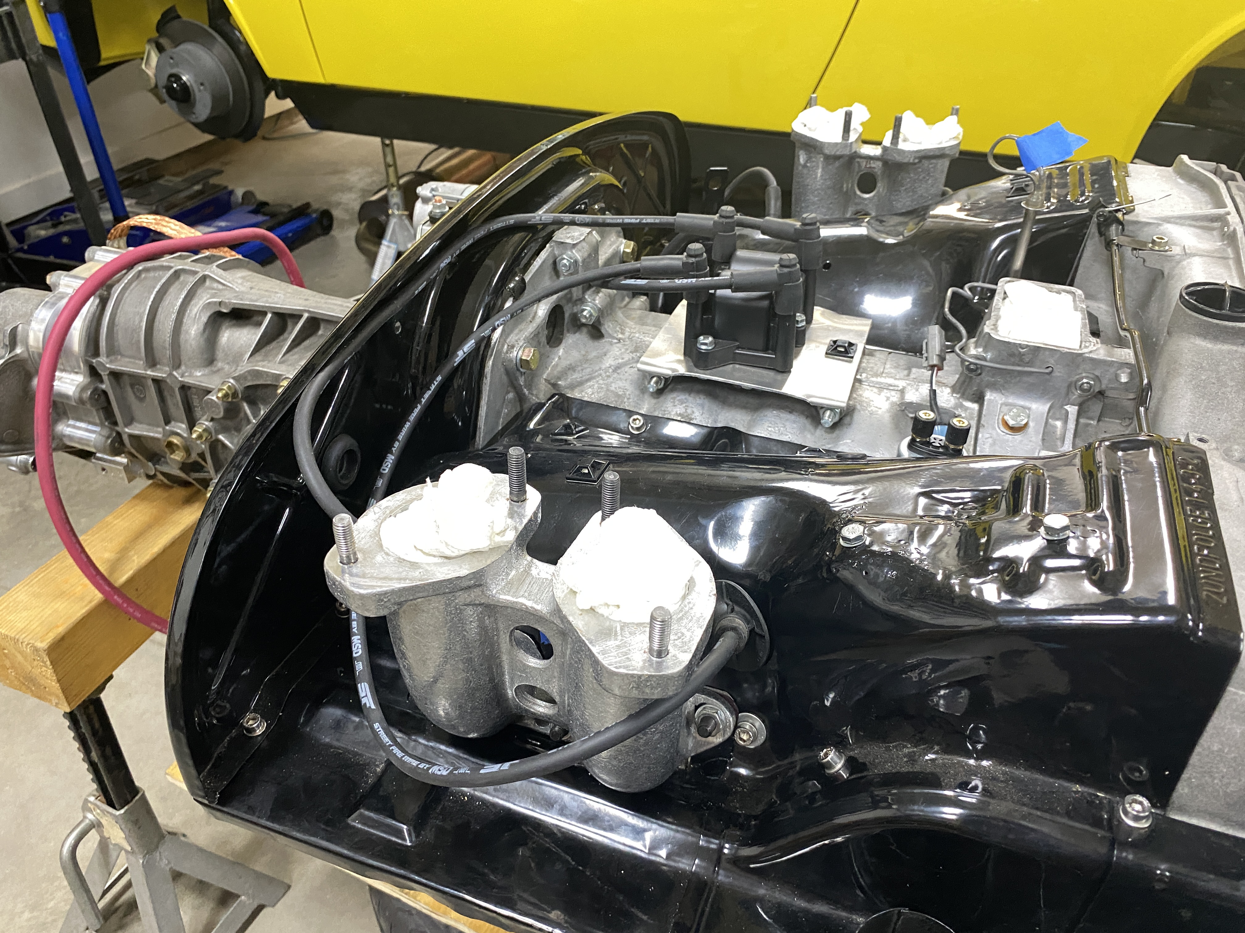

Intake manifolds installed (with thin gaskets).

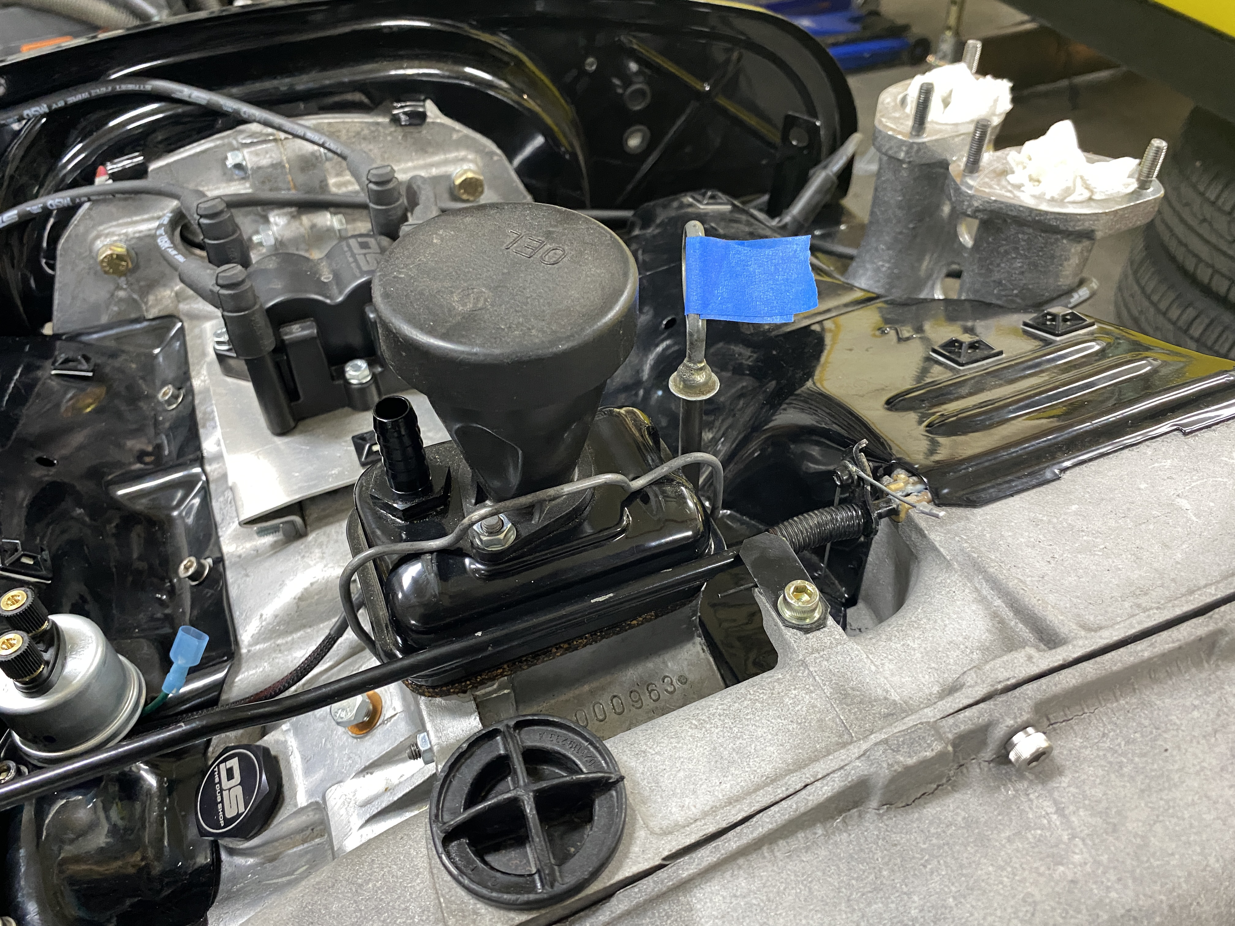

Oil filler/breather.
bkrantz
post Feb 11 2023, 08:36 PM
Post #6180
Posts: 8,342
Joined: 3-August 19
From: SW Colorado
Member No.: 23,343

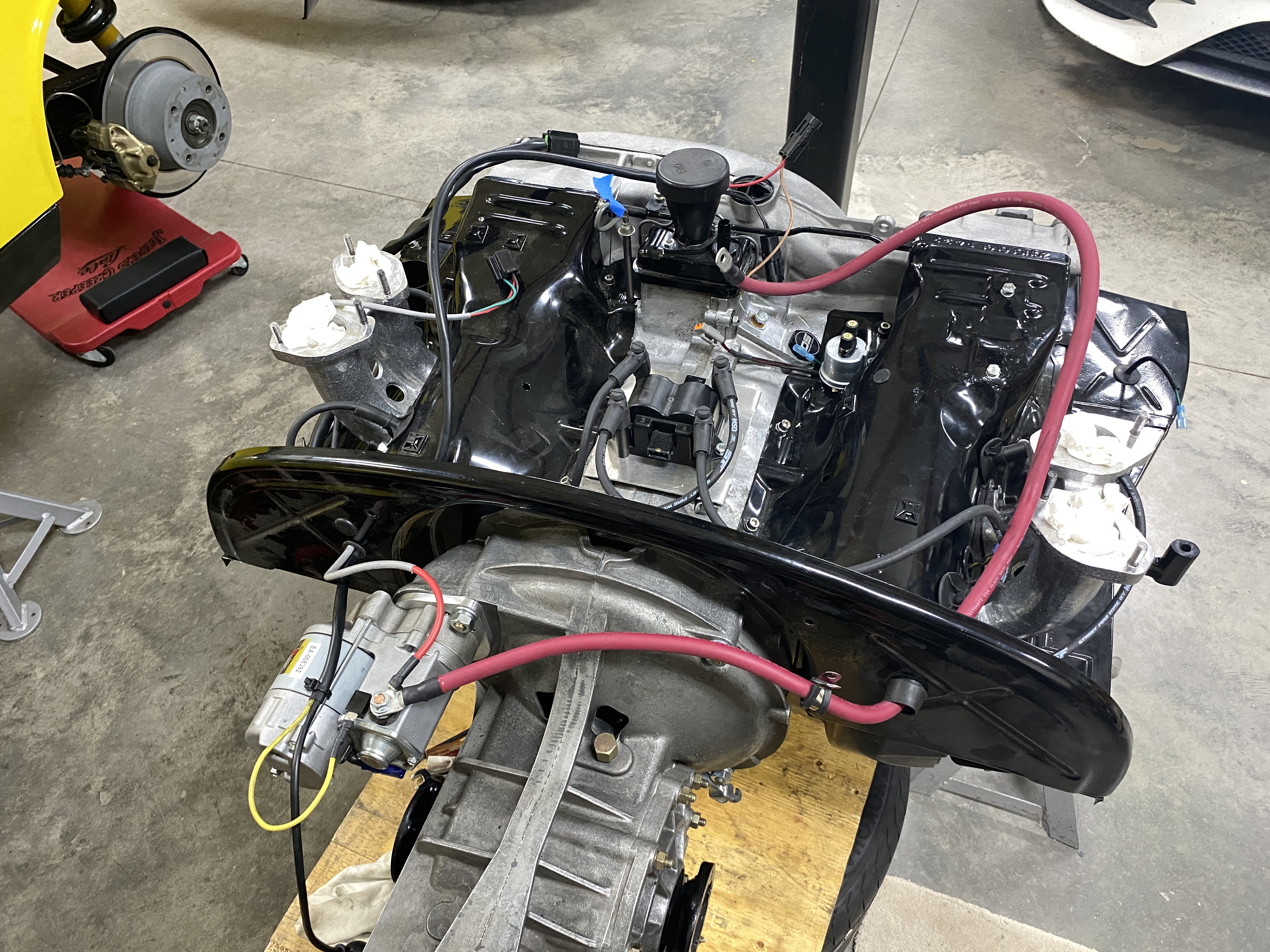

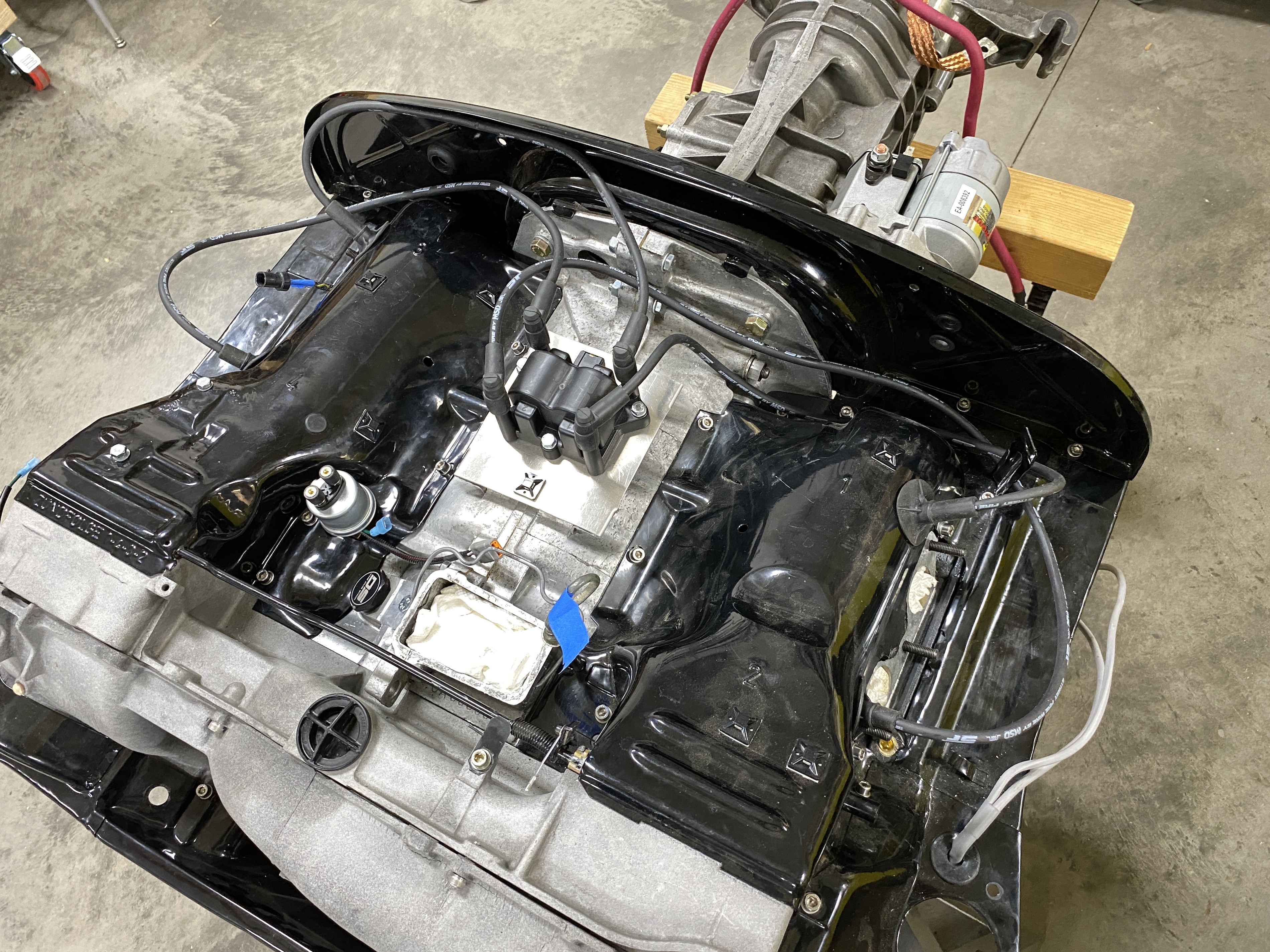

Top side wires, including starter cable.
