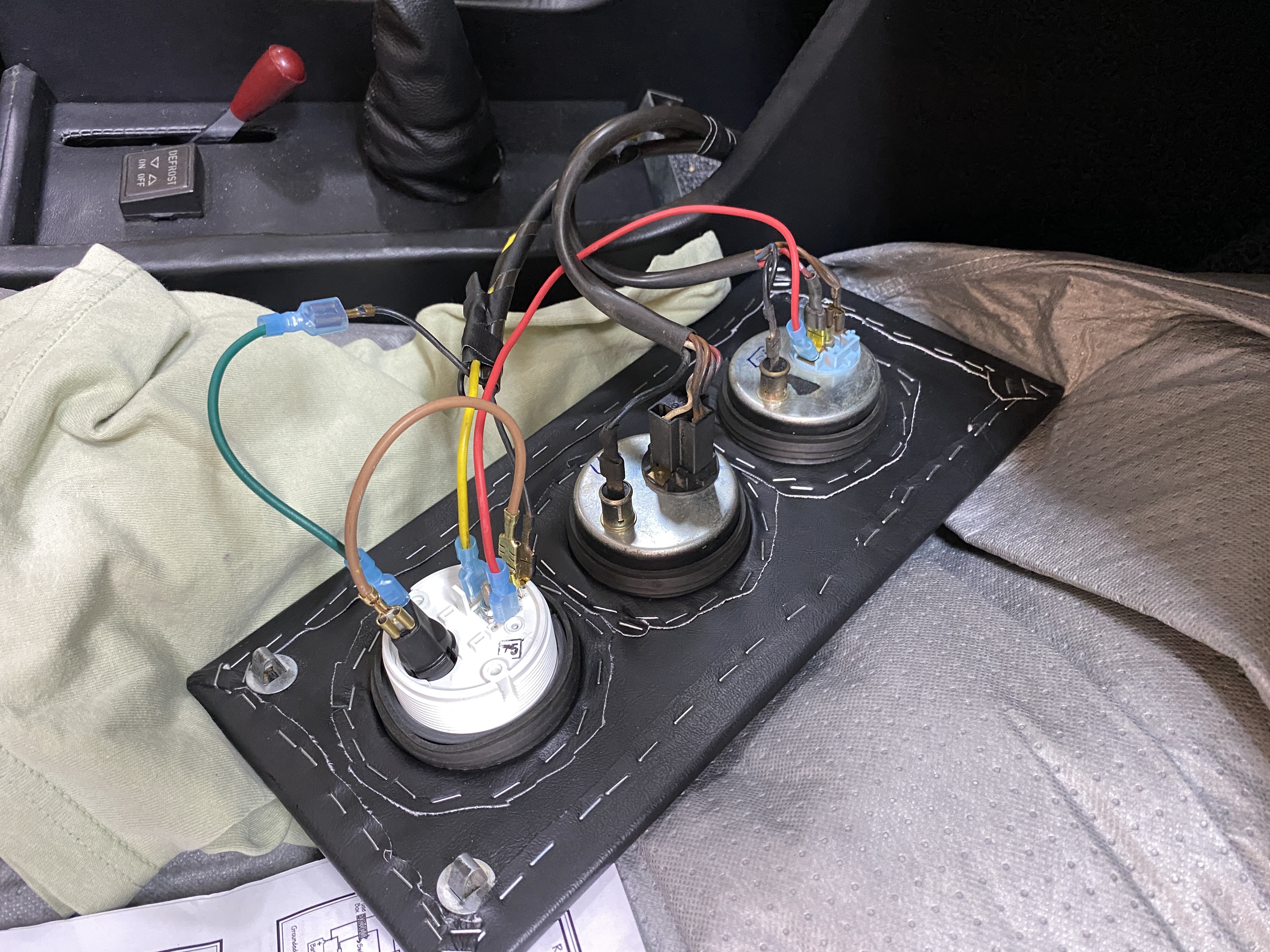

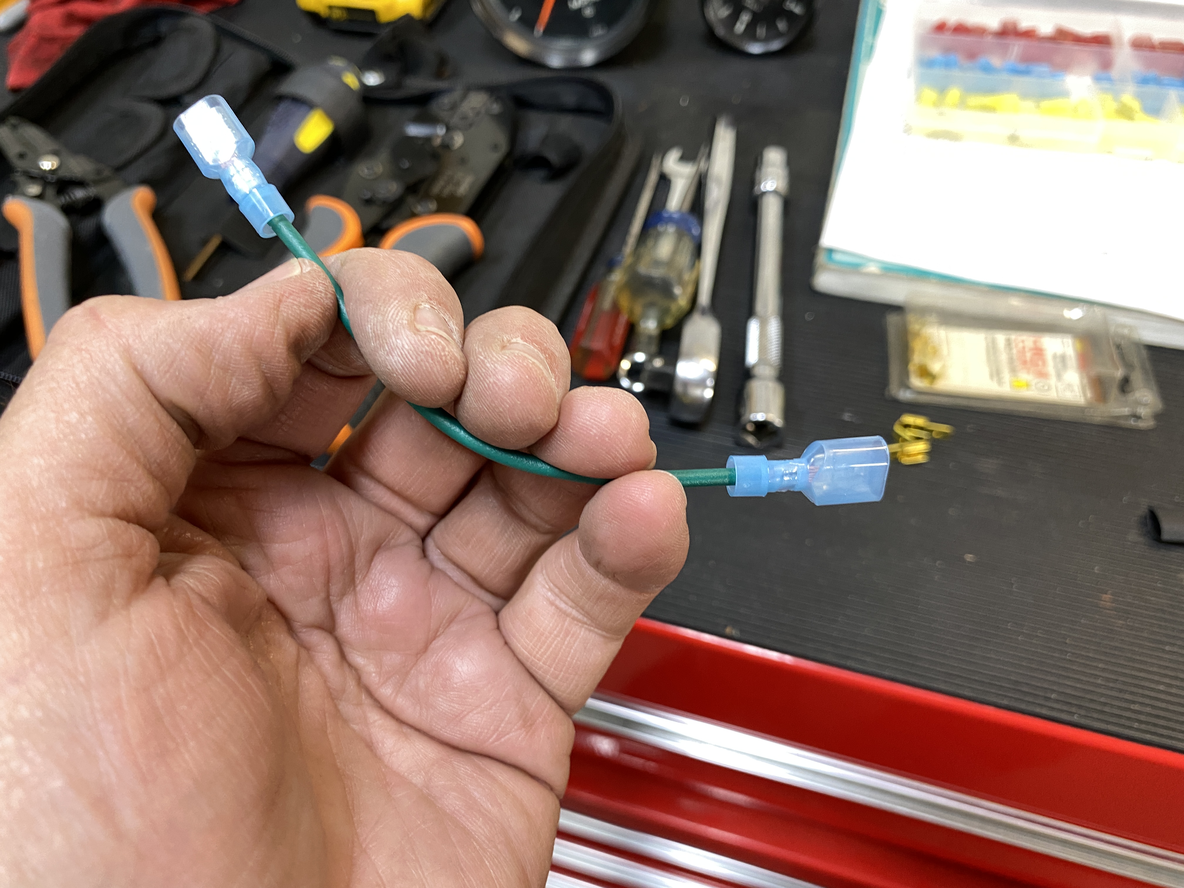

And a new ground jumper, for the light.
bkrantz
post Mar 9 2023, 08:57 PM
Post #6302
Posts: 8,342
Joined: 3-August 19
From: SW Colorado
Member No.: 23,343

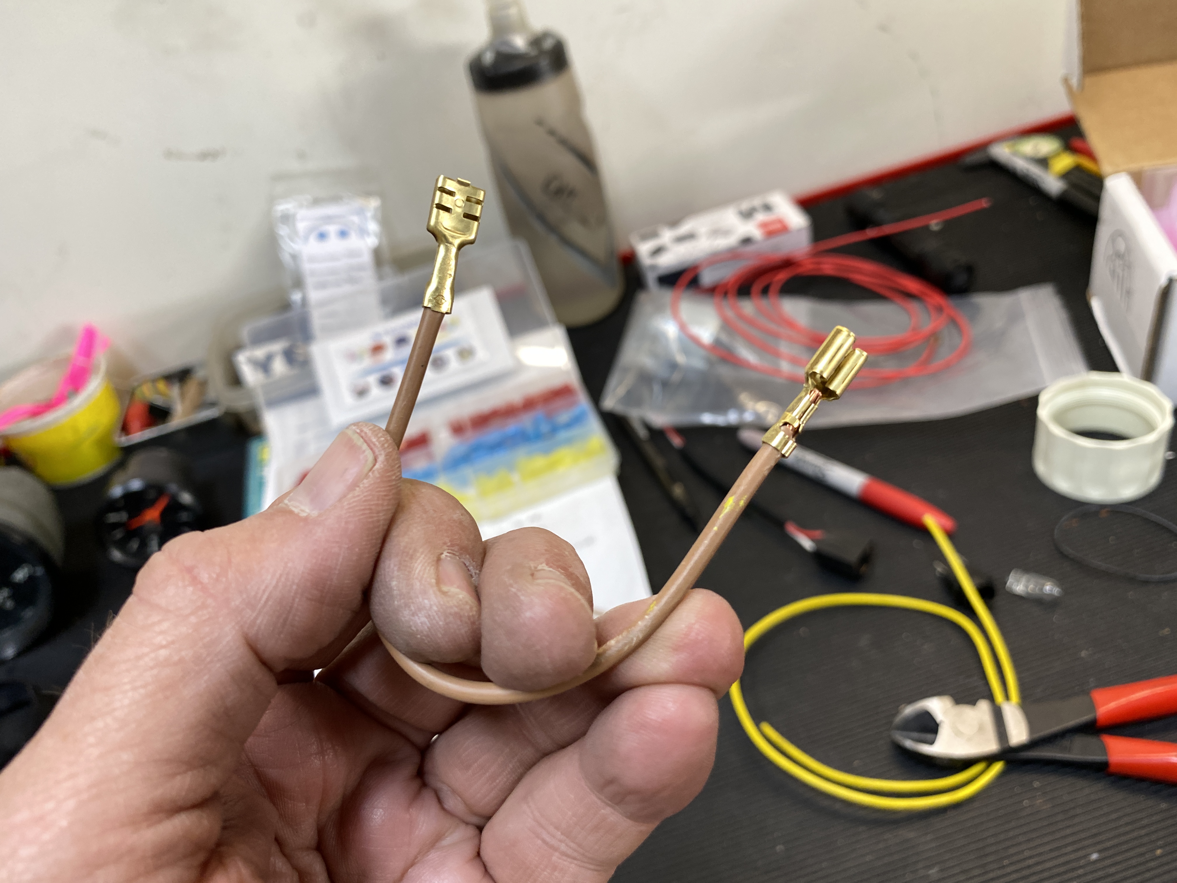

And an extension lead for powering the light, since the stock lead from the clock light does not quite reach. Should be blue, but can find that in my stock.
bkrantz
Post #6303
Posts: 8,342
Joined: 3-August 19
From: SW Colorado
Member No.: 23,343
All wired up.
bkrantz
post Mar 9 2023, 08:59 PM
Post #6304
Posts: 8,342
Joined: 3-August 19
From: SW Colorado
Member No.: 23,343

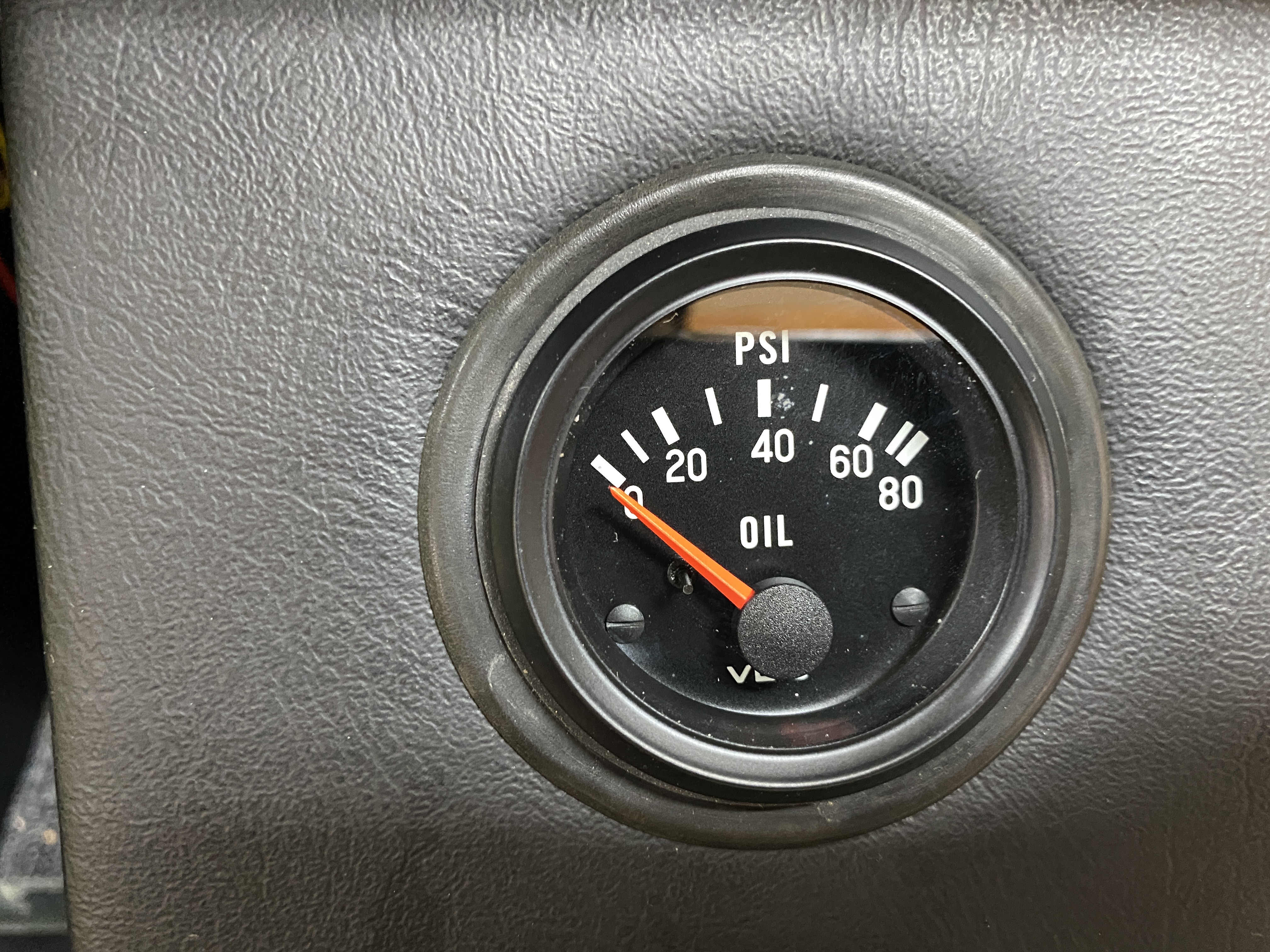

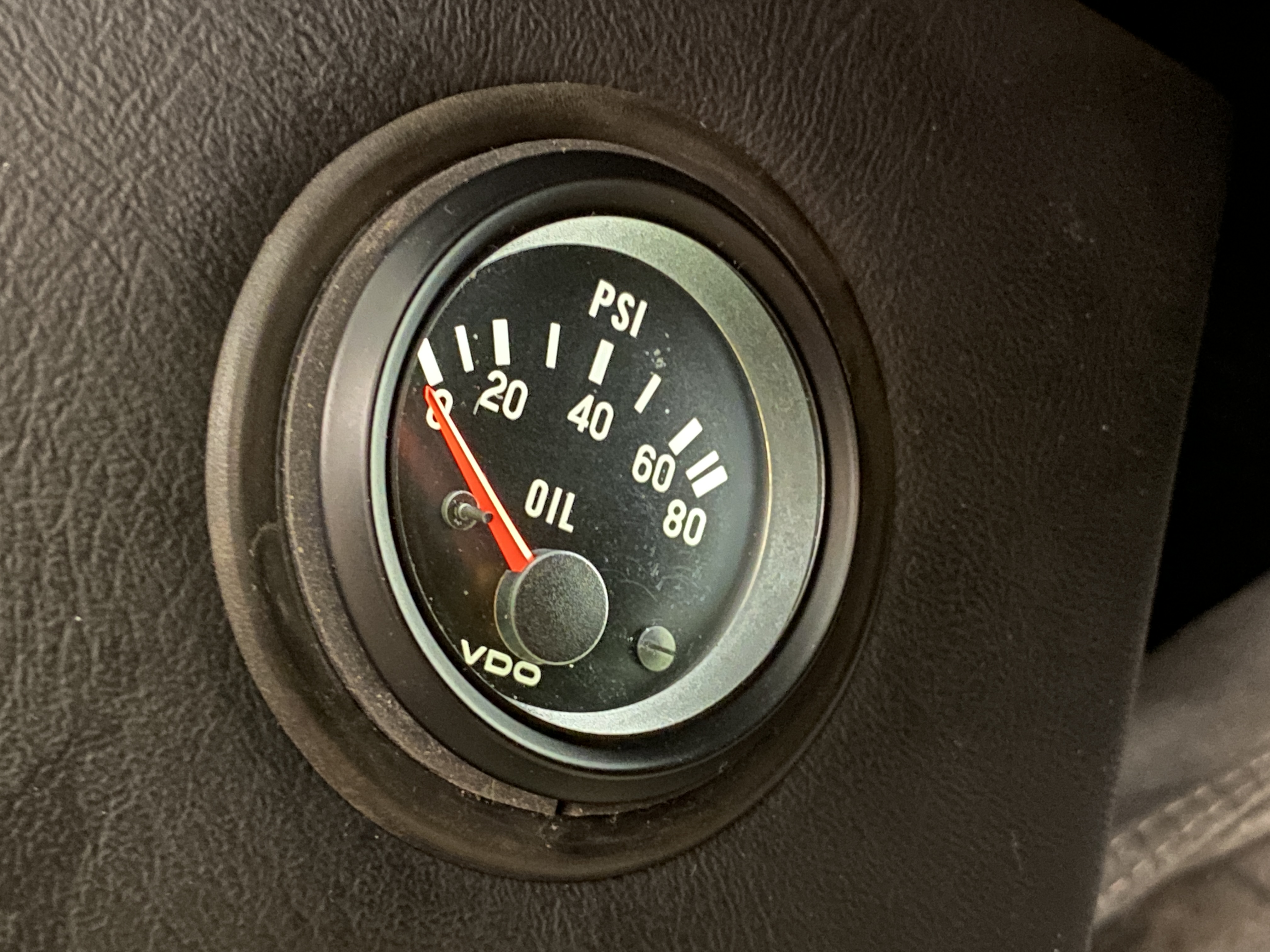

Power off: the needle sits on the rest.
bkrantz
Post #6305
Posts: 8,342
Joined: 3-August 19
From: SW Colorado
Member No.: 23,343

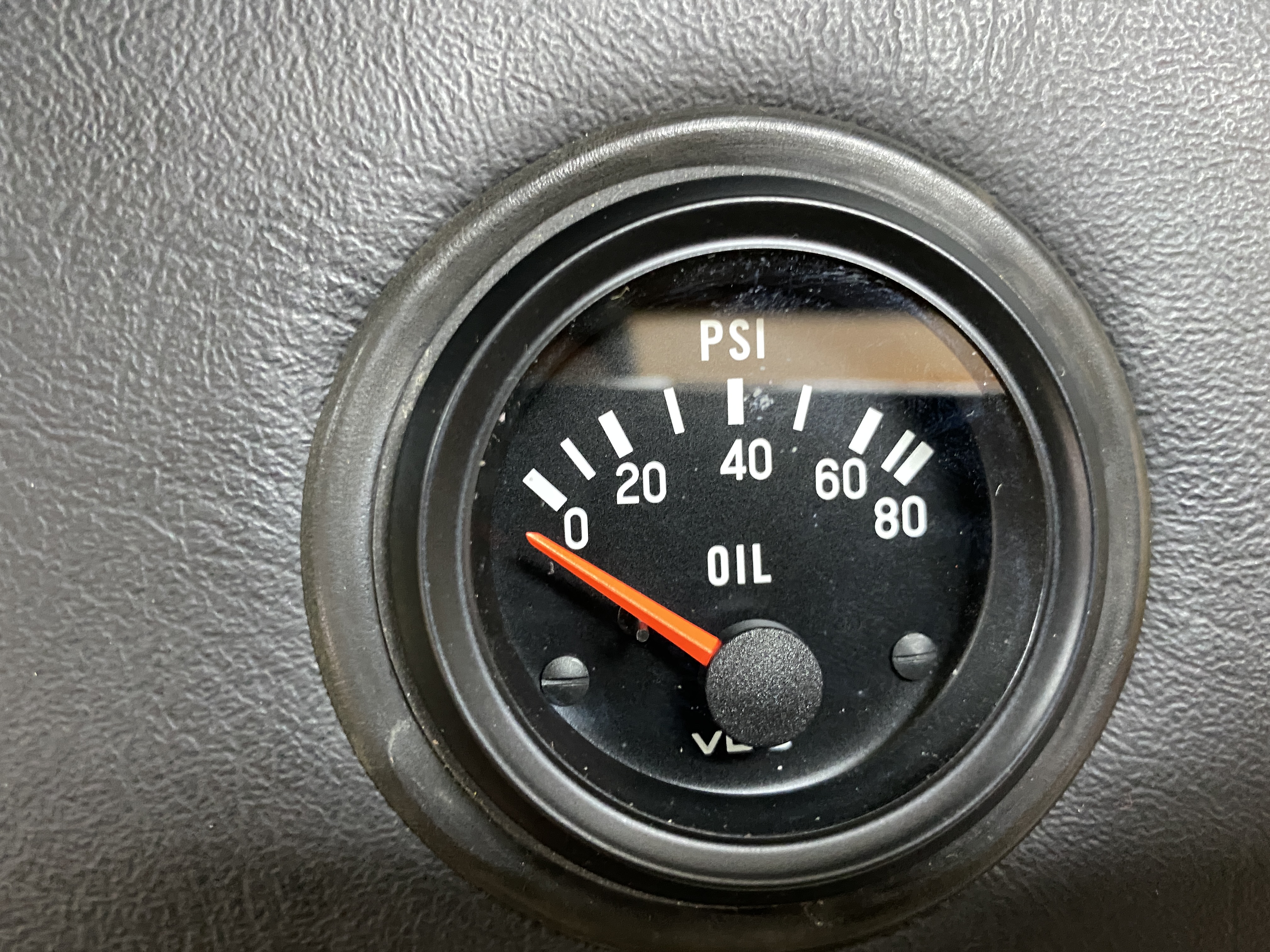

Power on: the gauge reads 0. Maybe this will work!

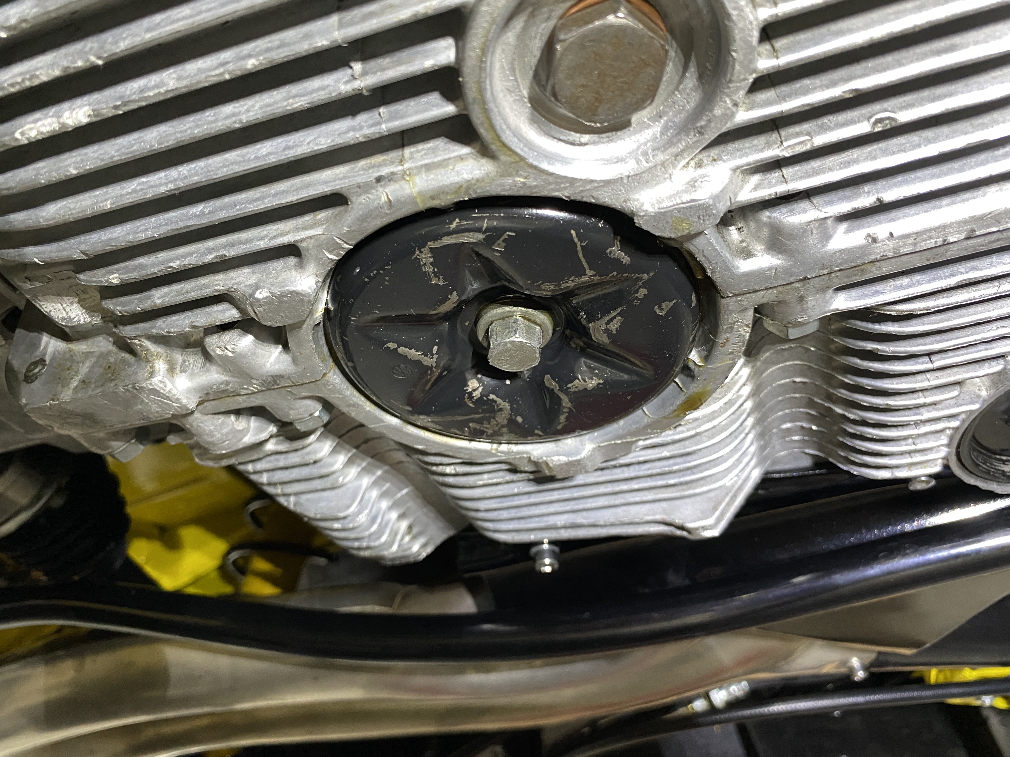

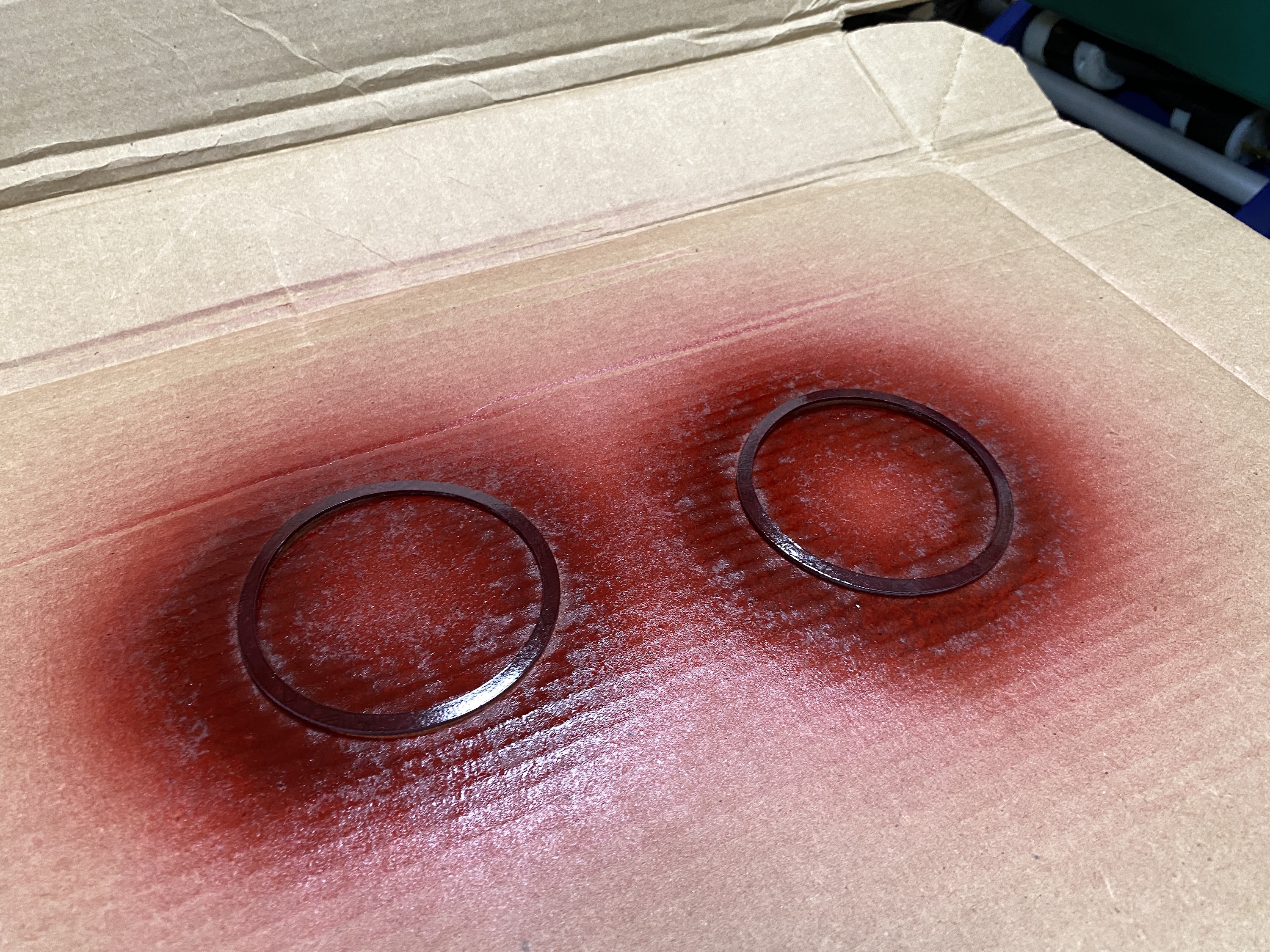

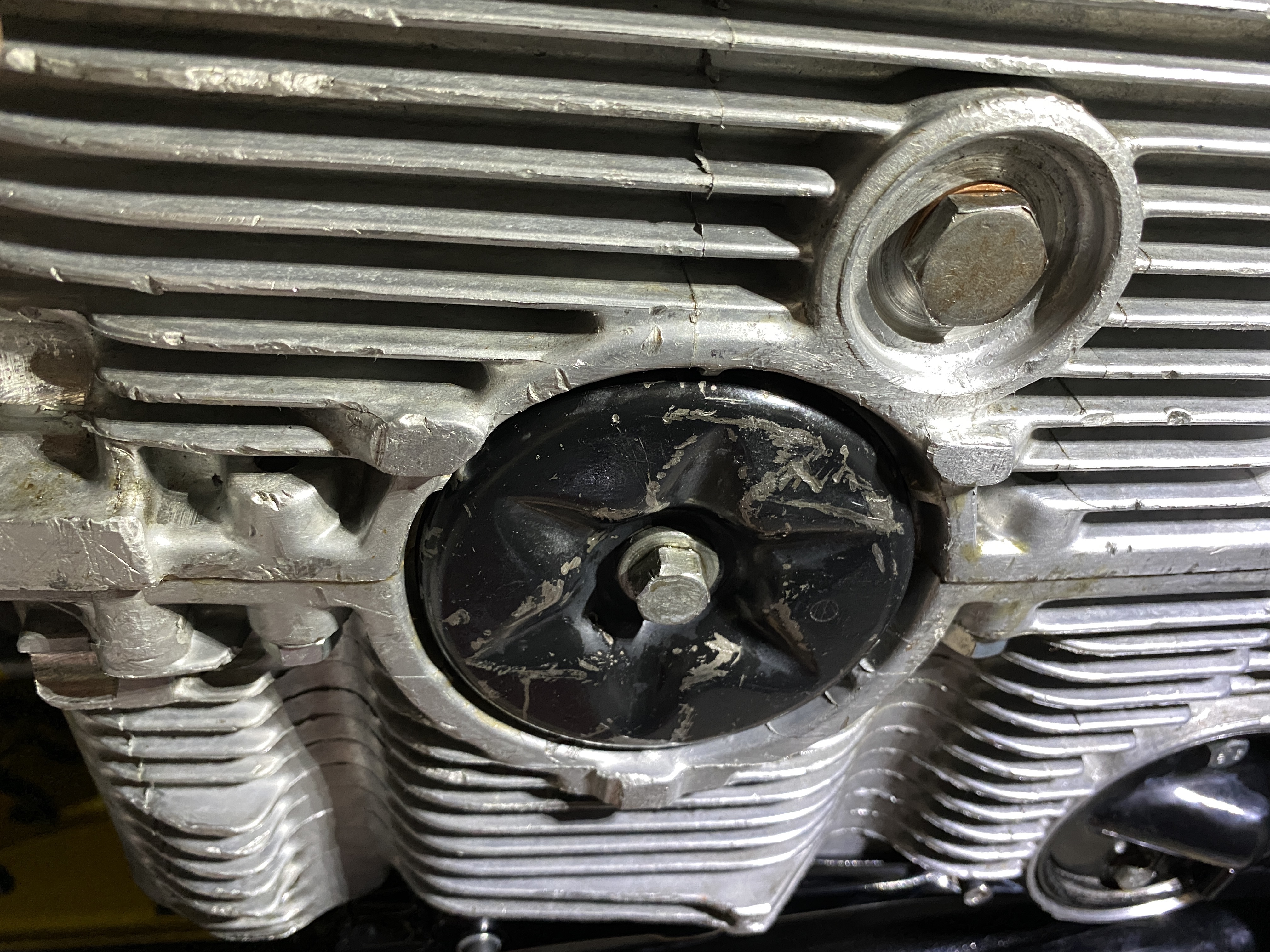

Before filling the case with new oil, I fixed one more potential leak--the strainer cover. It still oozes a drop, even with the case drained.
bkrantz
post Mar 11 2023, 08:16 PM
Post #6307
Posts: 8,342
Joined: 3-August 19
From: SW Colorado
Member No.: 23,343

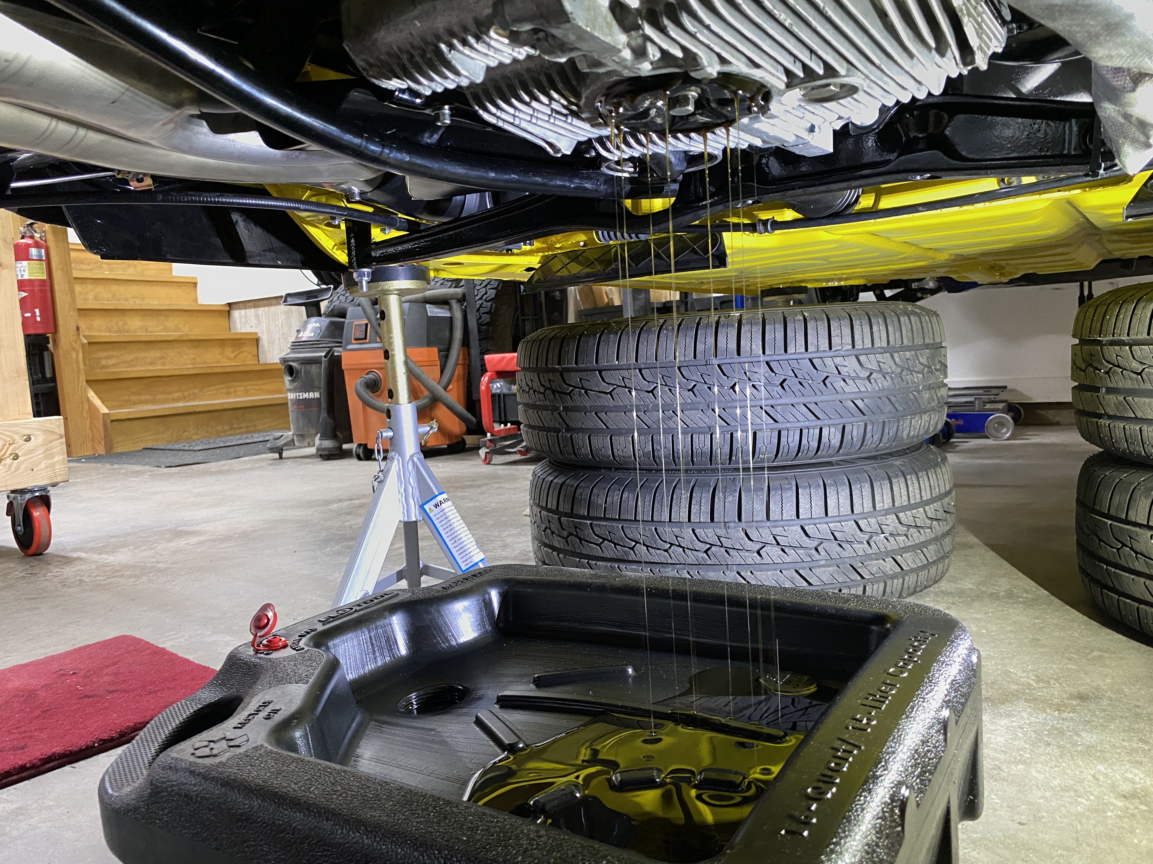

Draining the remaining oil. Looks like one of those cheesy lamps from the 70s.

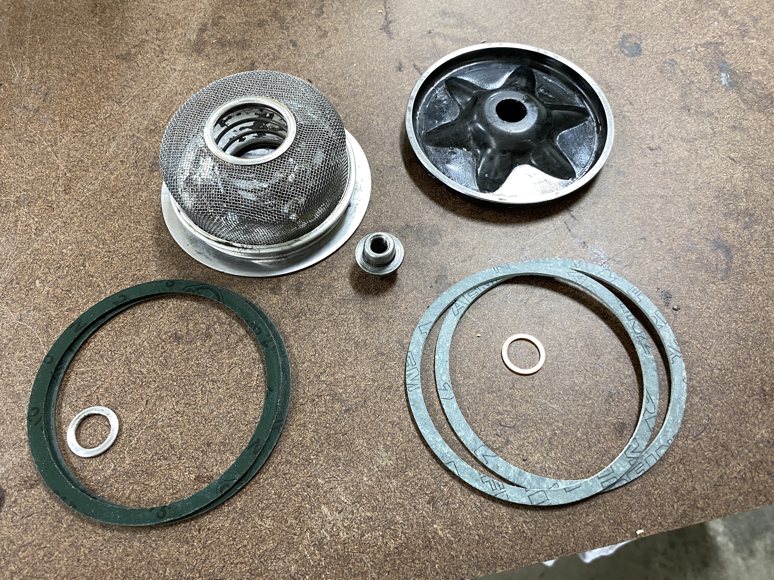

All the strainer parts. Last year I assembled these dry.
bkrantz
post Mar 11 2023, 08:18 PM
Post #6309
Posts: 8,342
Joined: 3-August 19
From: SW Colorado
Member No.: 23,343
This time, a bit of spray gasket.
bkrantz
post Mar 11 2023, 08:20 PM
Post #6310
Posts: 8,342
Joined: 3-August 19
From: SW Colorado
Member No.: 23,343
Back together and leak-proof?

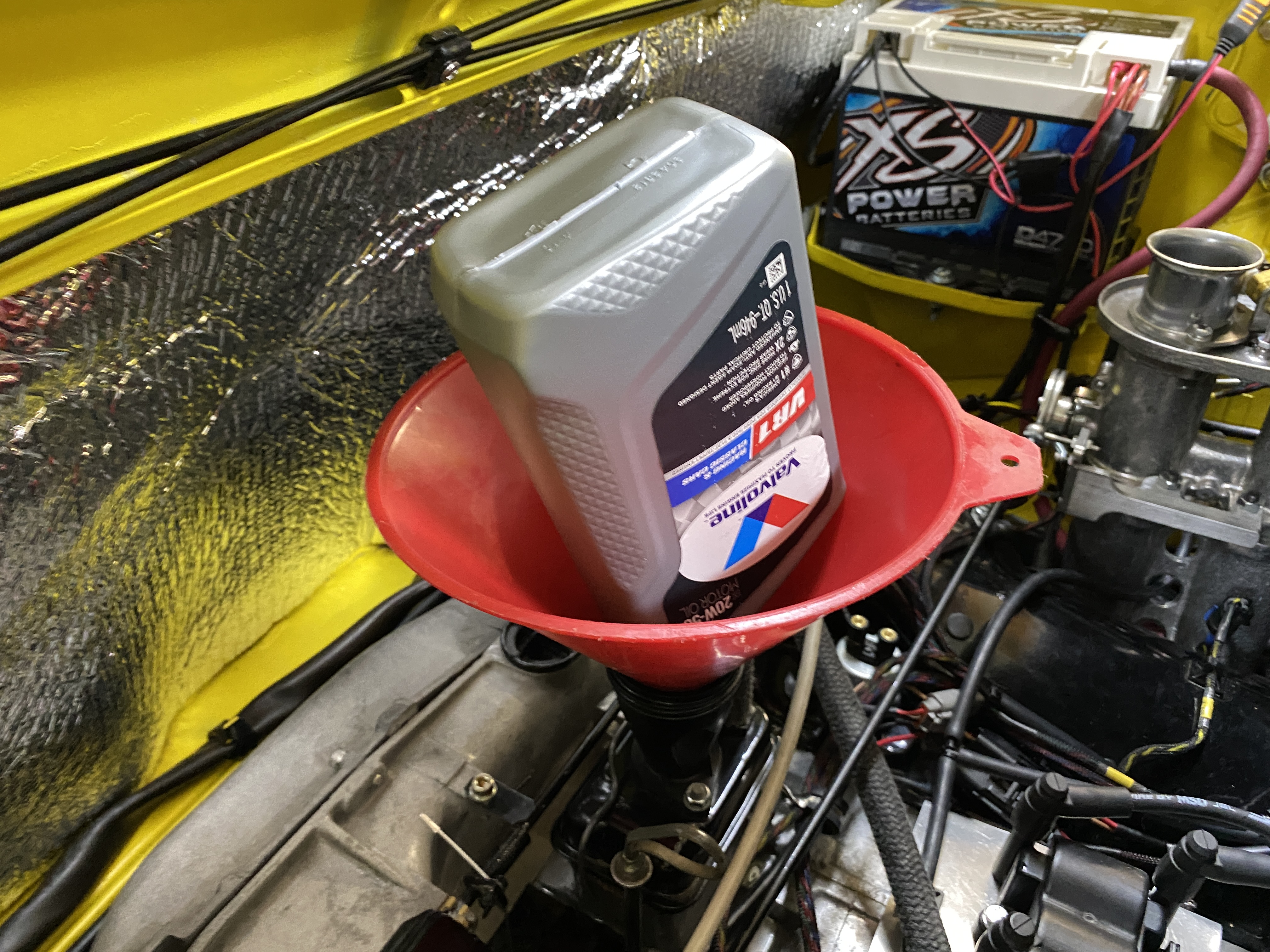

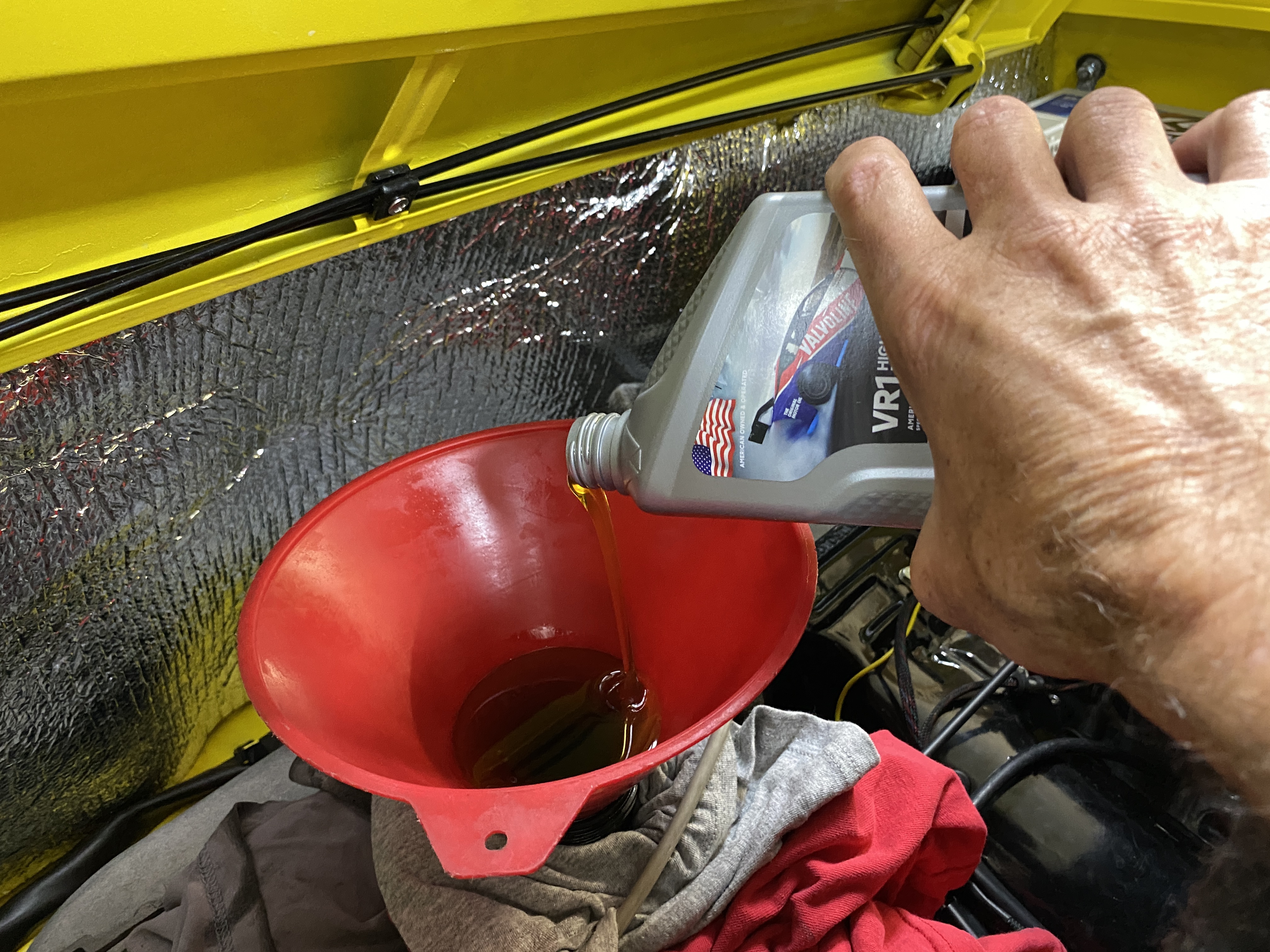

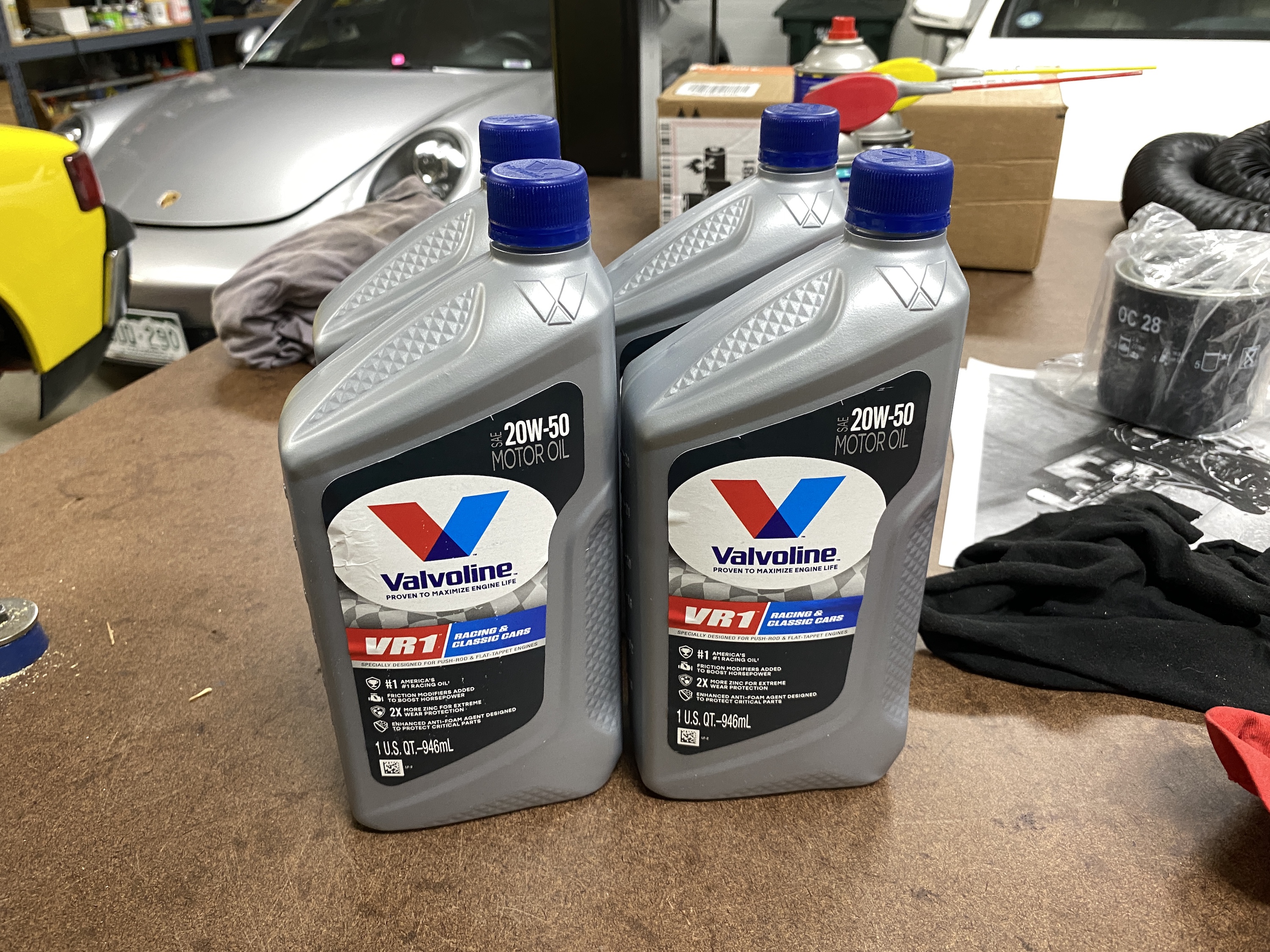

My choice for the first regular oil fill. Should have enough zinc.
bkrantz
post Mar 11 2023, 08:30 PM
Post #6312
Posts: 8,342
Joined: 3-August 19
From: SW Colorado
Member No.: 23,343

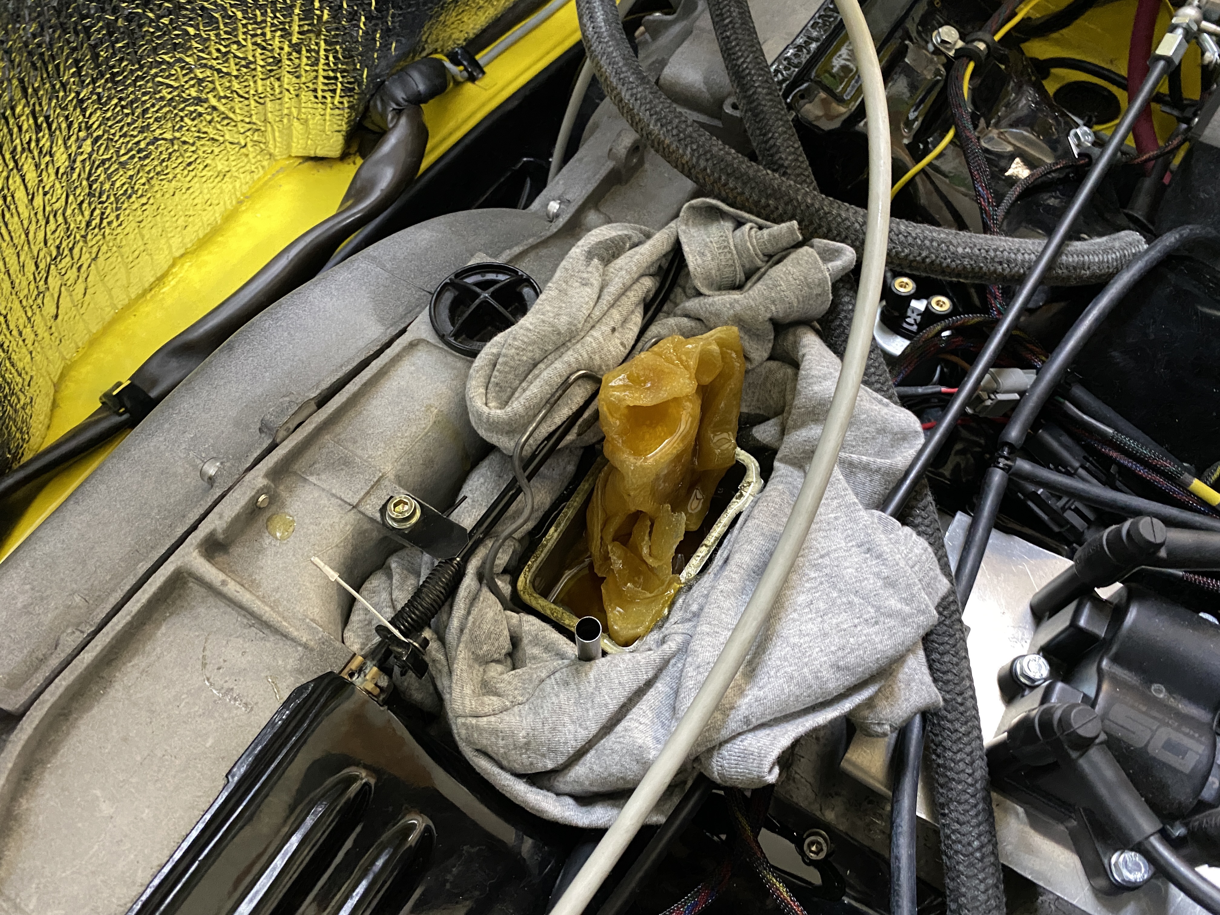

Then a puzzling moment. I tried to pour the first quart of oil into the case and it backed up. Over 5 minutes it gradually went in. I wondered if the cold oil (my garage was about 40° today) was too viscous. Then I started to think. Was I stupid enough to leave the paper towel in the oil breather cavity (to prevent anything from falling into the case while it was out of the car) when I put the breather on?
bkrantz
post Mar 11 2023, 08:32 PM
Post #6313
Posts: 8,342
Joined: 3-August 19
From: SW Colorado
Member No.: 23,343
Yup.
Another stellar moment. Sigh.
bkrantz
post Mar 11 2023, 08:36 PM
Post #6314
Posts: 8,342
Joined: 3-August 19
From: SW Colorado
Member No.: 23,343
At least the oil goes in now. But I spilled a bit on the top of the case when I removed the breather. I am beginning to think that the oil gods are against me.

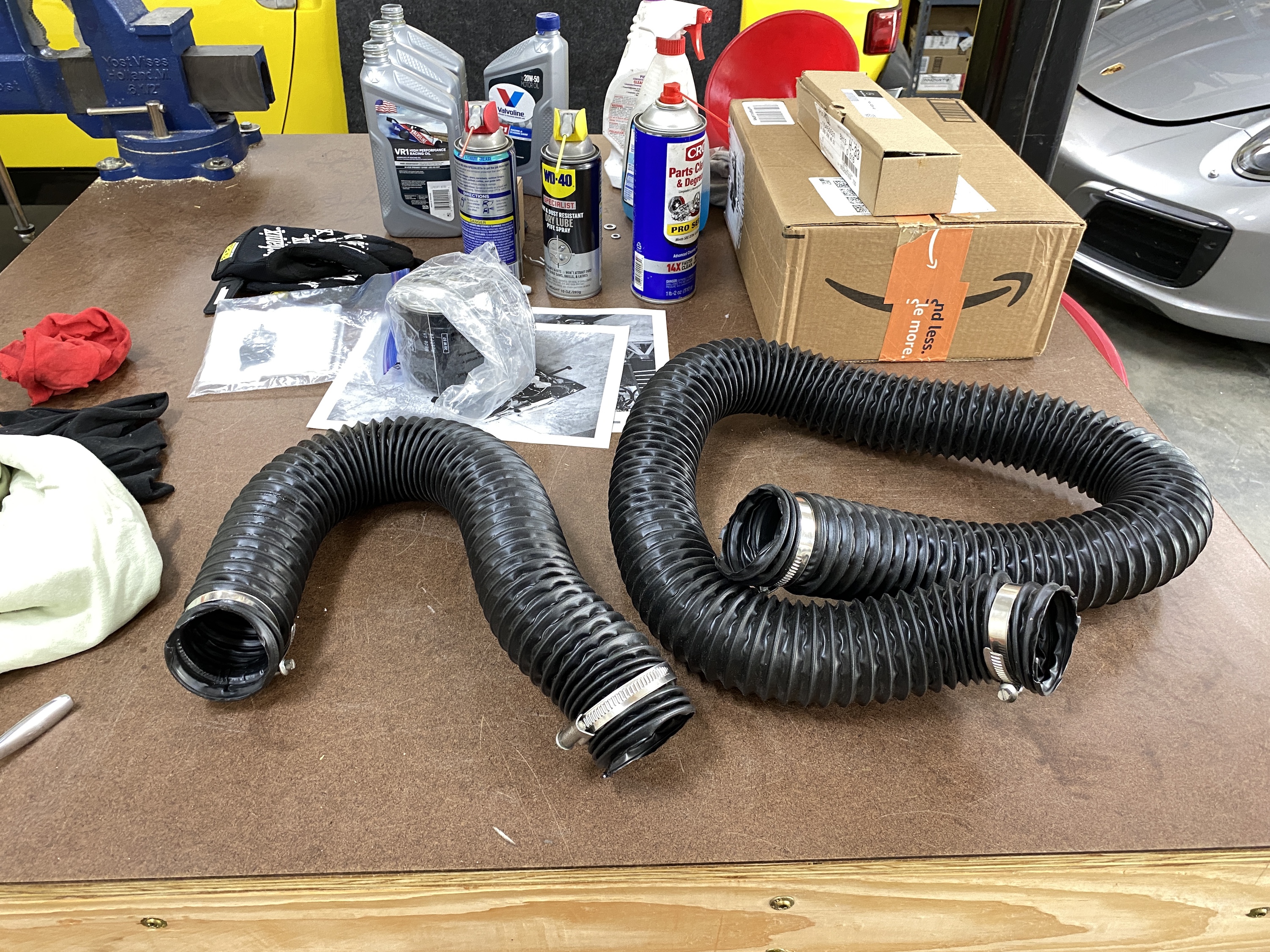

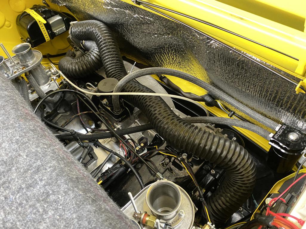

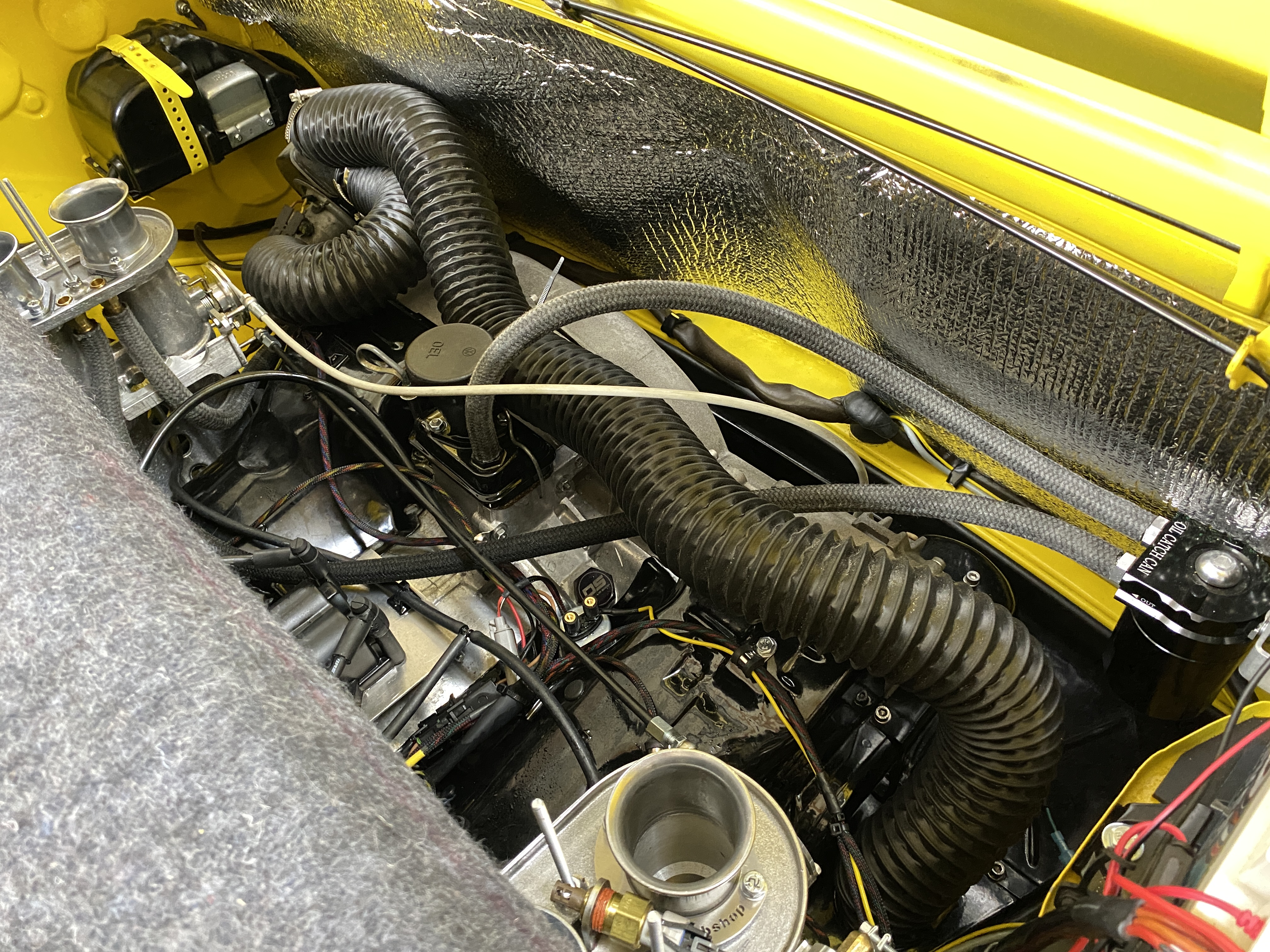

I did some cleaning up on the engine today. And then got out the last bits to install, the blower hoses.
bkrantz
post Mar 12 2023, 07:43 PM
Post #6316
Posts: 8,342
Joined: 3-August 19
From: SW Colorado
Member No.: 23,343
Done. But getting too late to try starting the engine today.

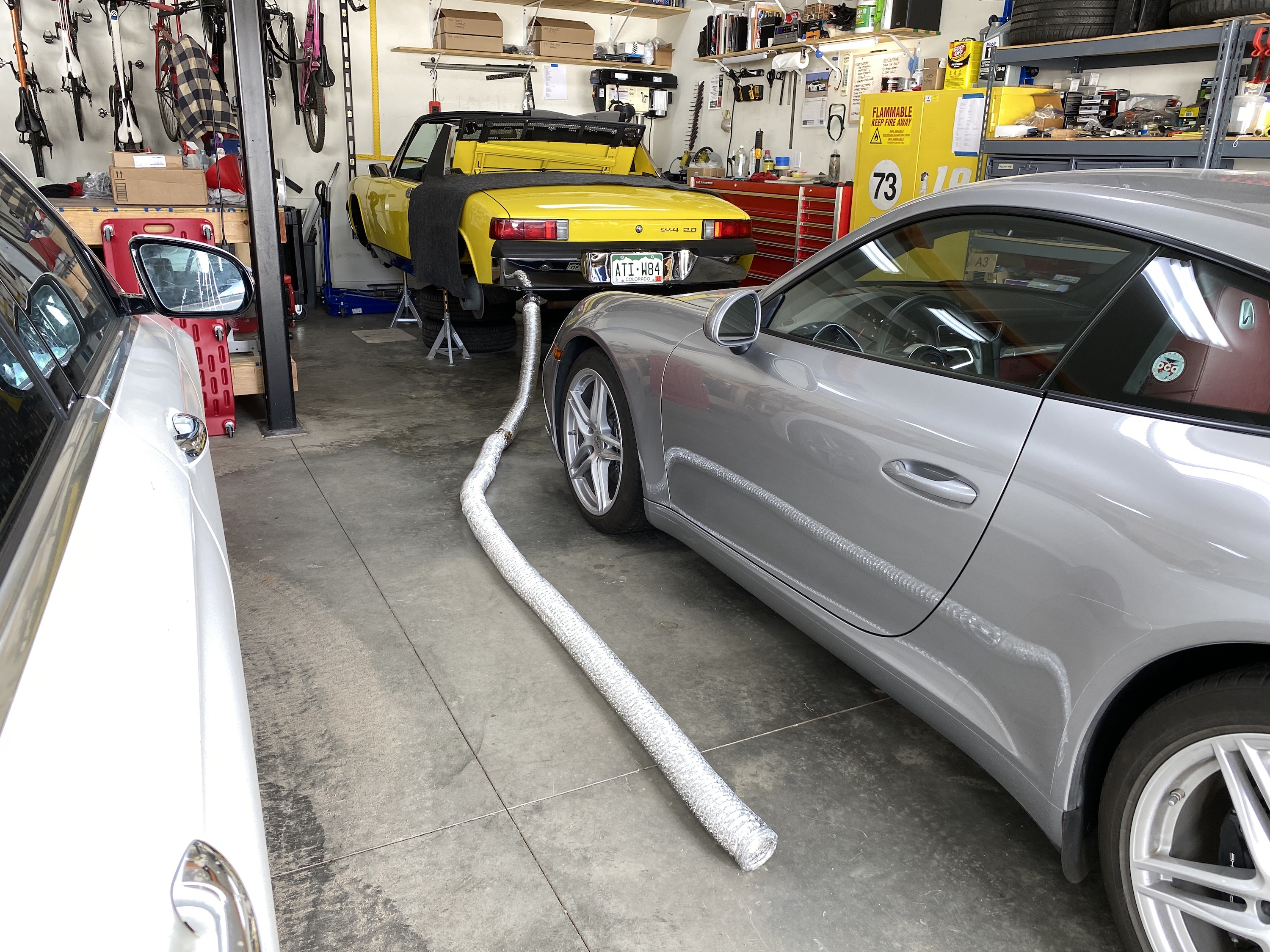

OK, time to try an engine start. I got out the exhaust extension I used last year. Kinda torn, and it only lasted about 10 minutes.
bkrantz
post Mar 13 2023, 07:30 PM
Post #6320
Posts: 8,342
Joined: 3-August 19

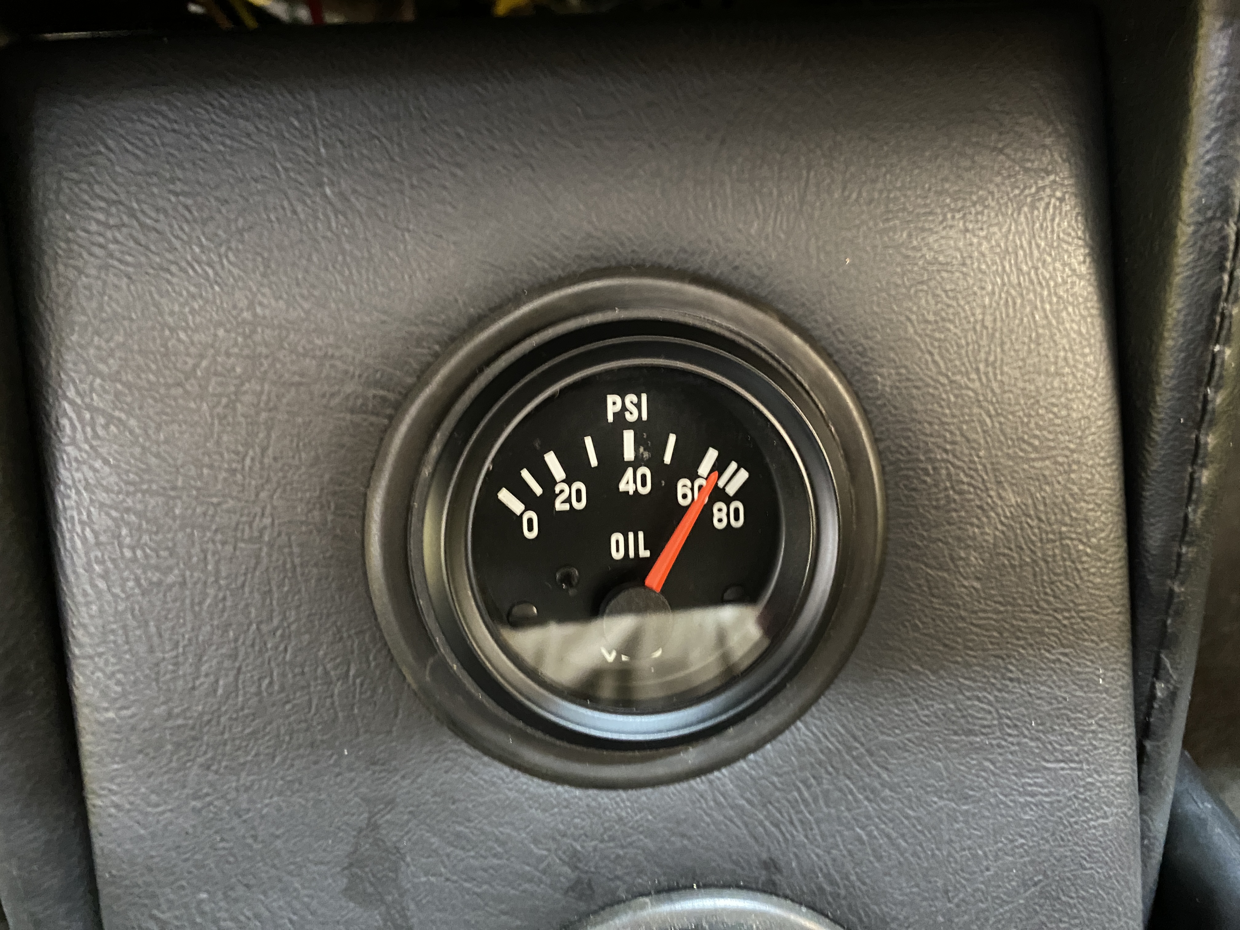

From: SW Colorado
Member No.: 23,343
Success! It was kinda cold and rough to start (my EFI has no true cold start circuit). But eventually it settled down to idle. It did make a couple of big backfires that I don't remember last year. I will need to check the ITB idle balance.
And the oil pressure gauge works. "Fast idle" (about 1500 rpm) reading 60 psi when cold, and dropped a bit at the oil started to warm up. We will see what it reads when the oil gets truly warm.
