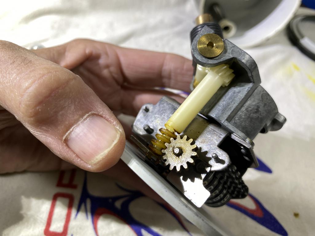

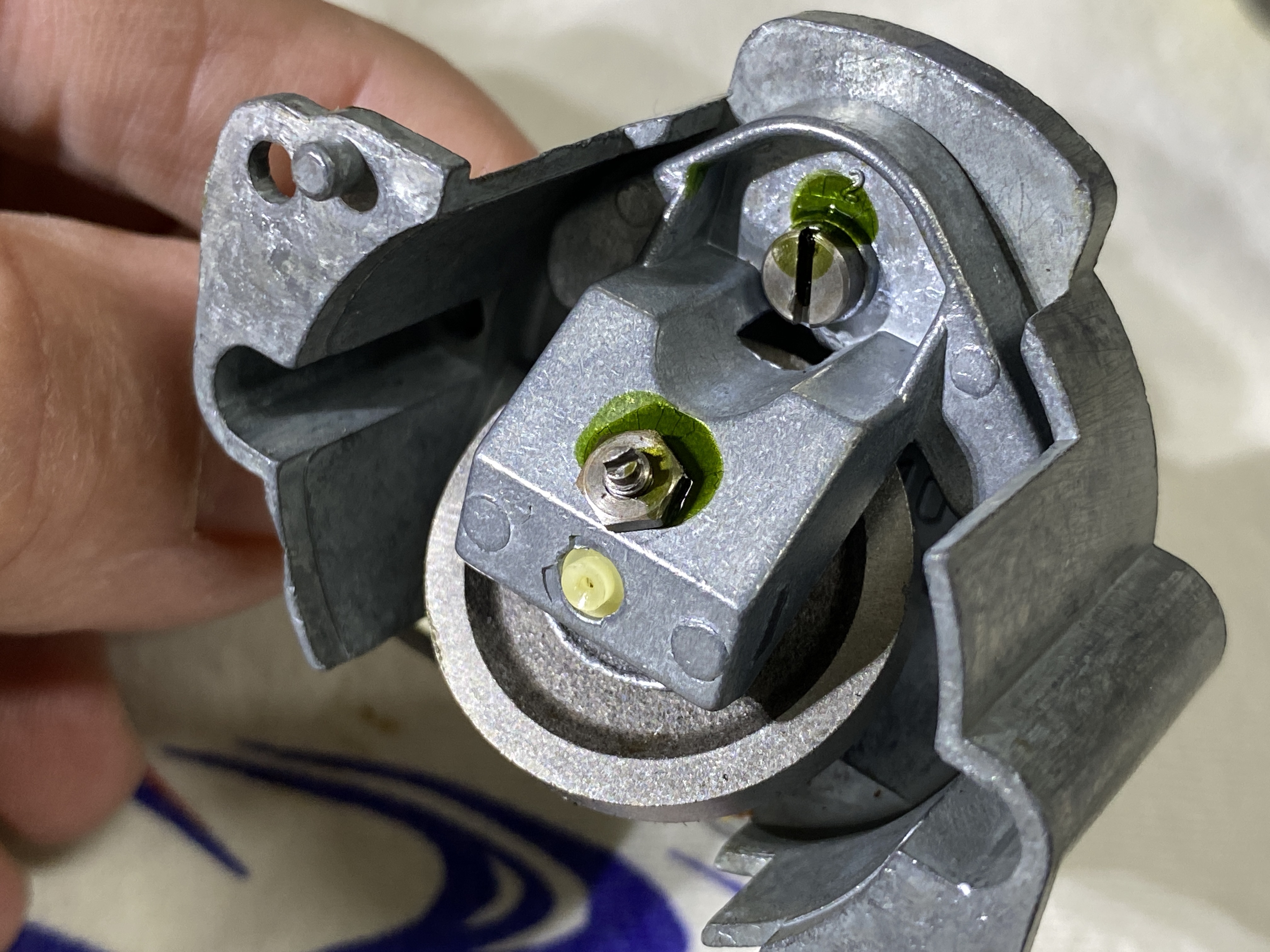

As best I can tell, this is the adjustment screw for the speedometer. But without the right equipment, I decided to put off trying to do something myself. I will live with having to subtract 5 mph from the indicated speed.

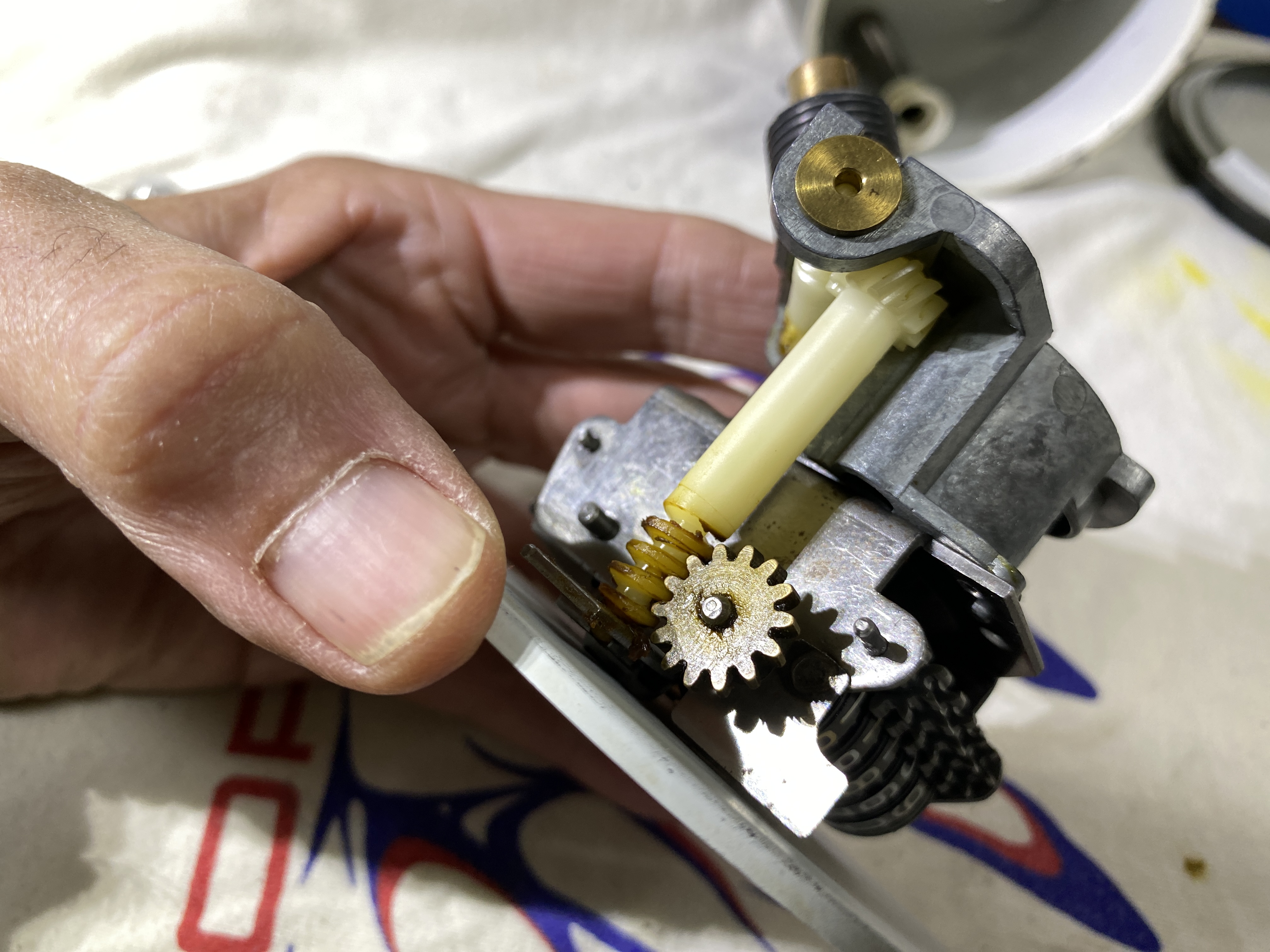

Reassembly: mount the speedo drive on the rest of the assembly, including the odometer drive shaft.

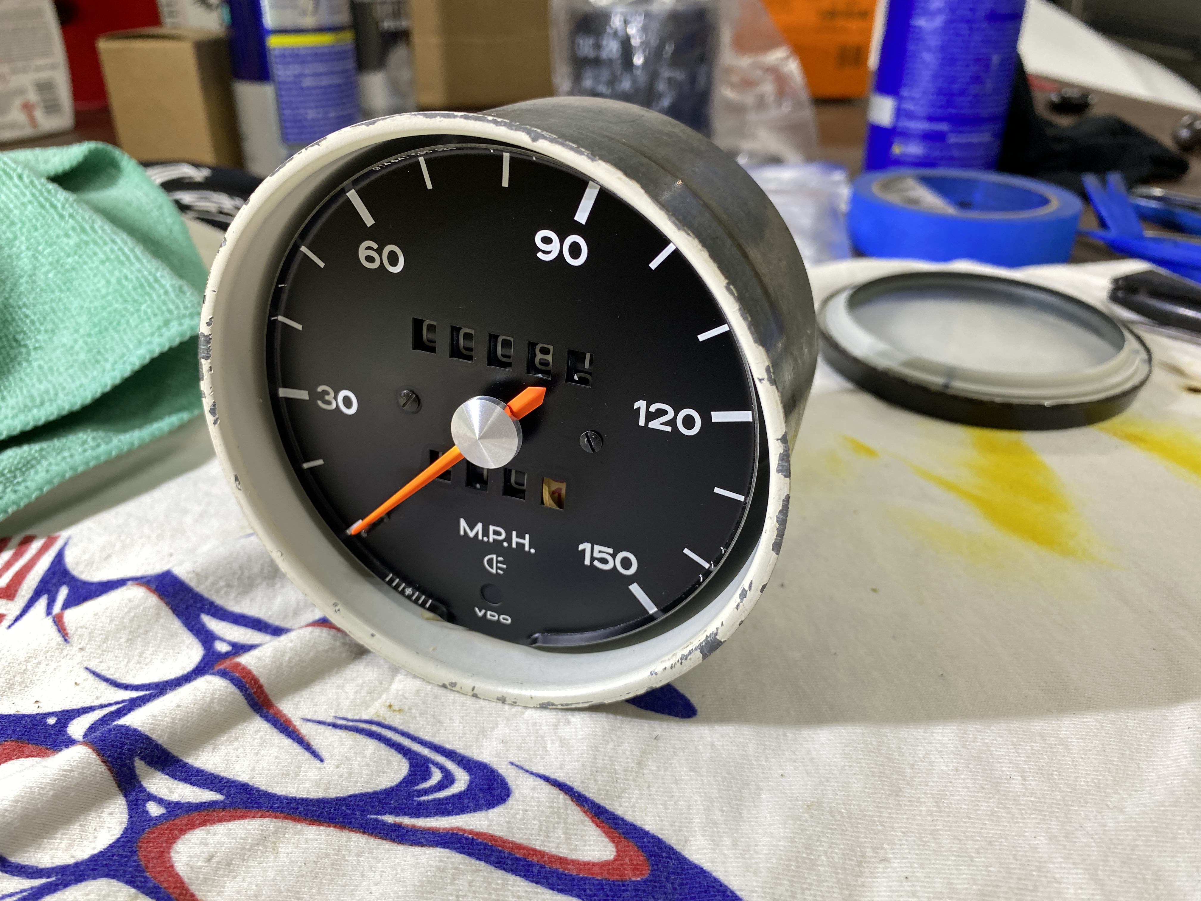

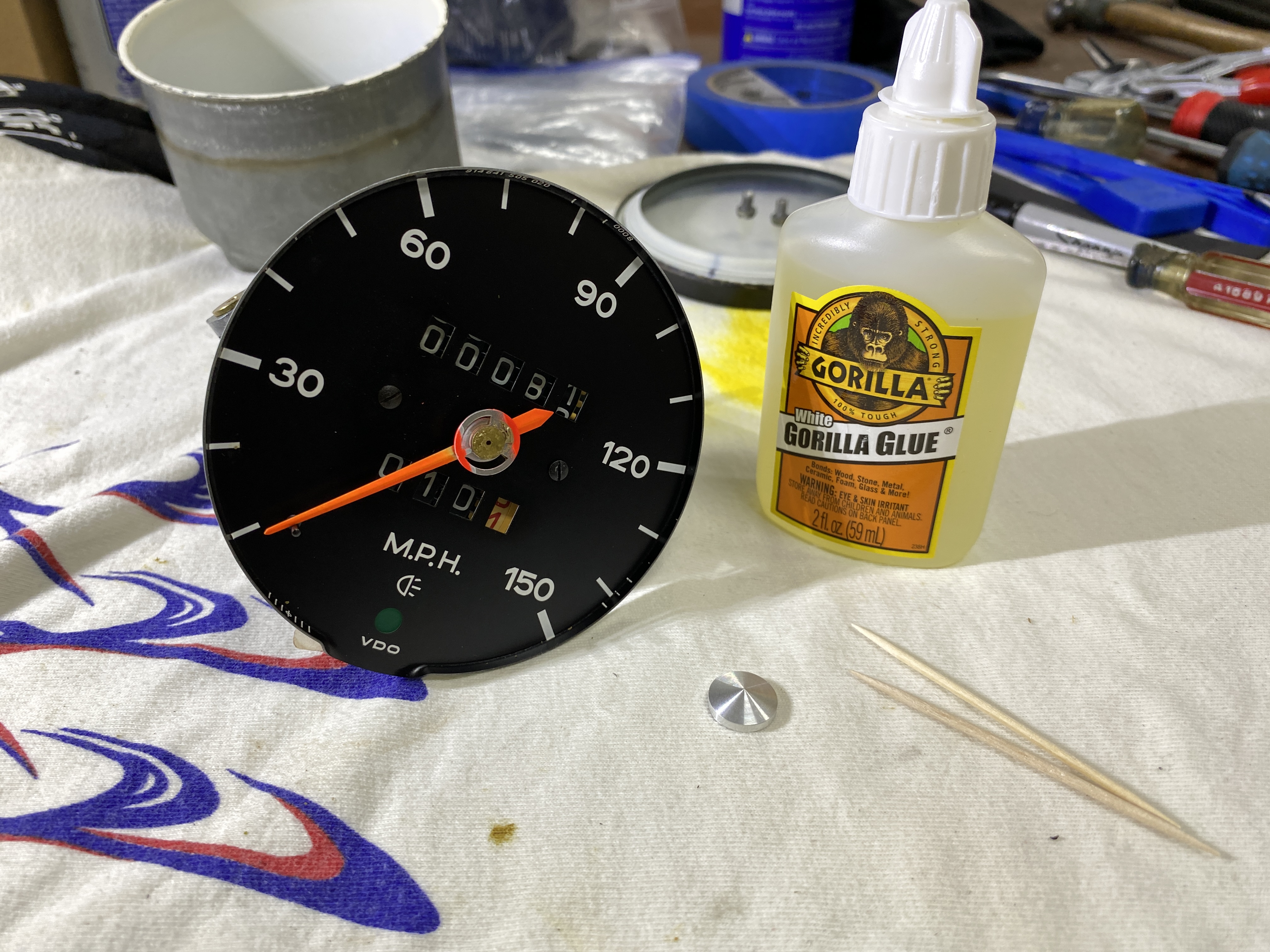

I glued the center cap back onto the needle.

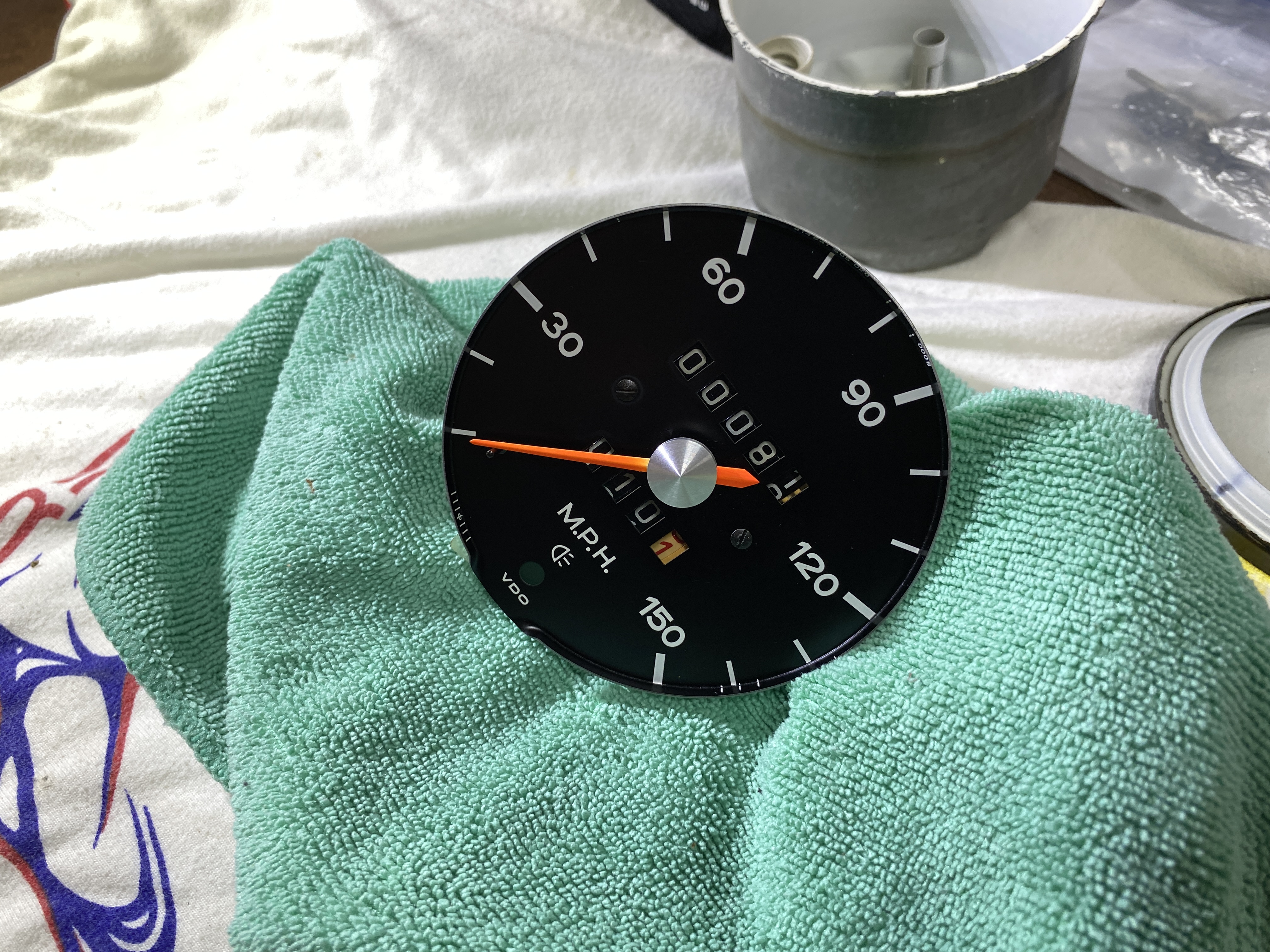

bkrantz
post Mar 15 2023, 07:33 PM
Post #6345
Posts: 8,342
Joined: 3-August 19
From: SW Colorado
Member No.: 23,343

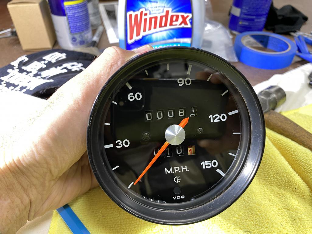

And I cleaned the dial face--no dirt or fingerprints.
bkrantz

Back into the housing.

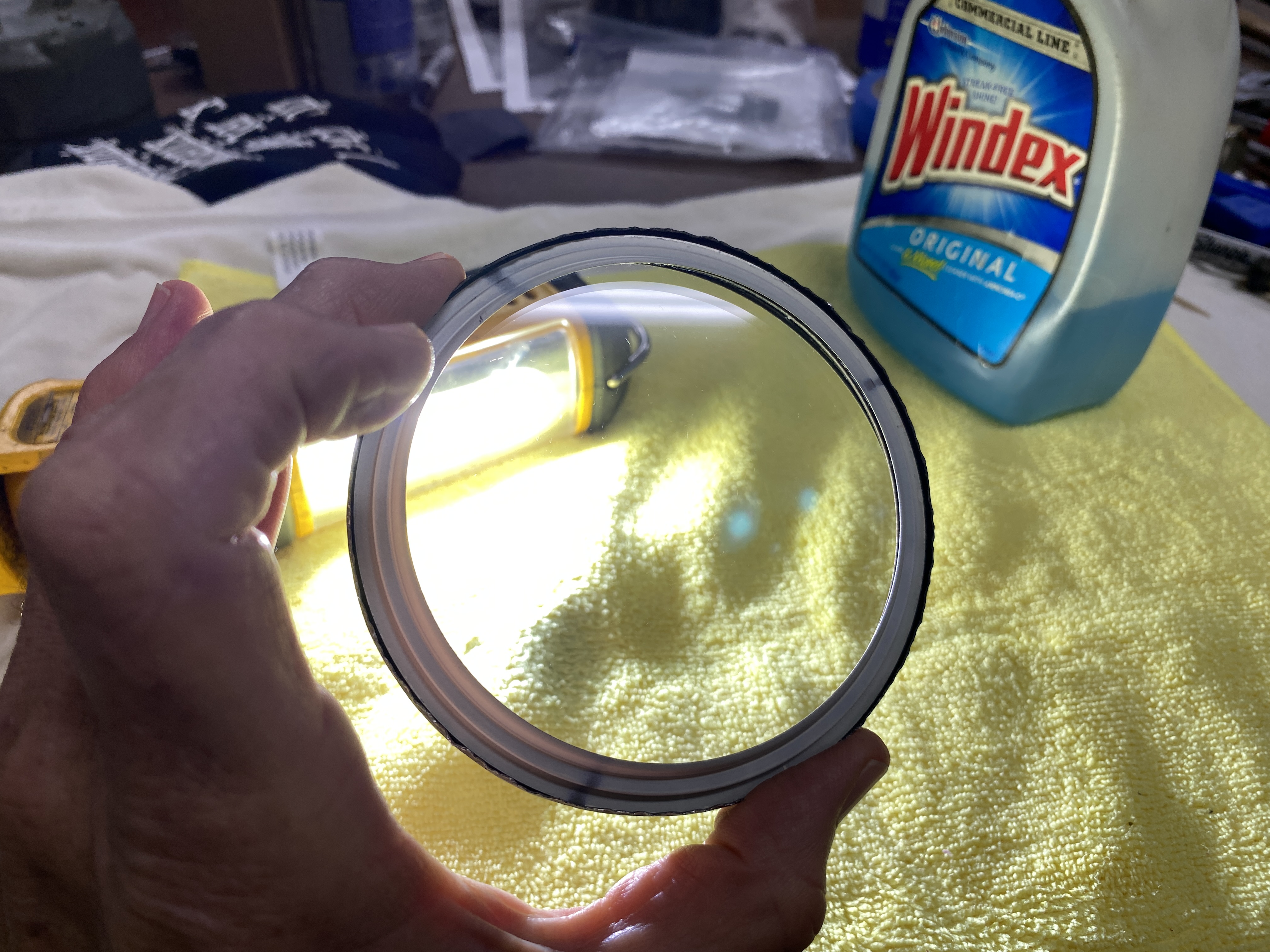

Then I cleaned the glass and all the rings.

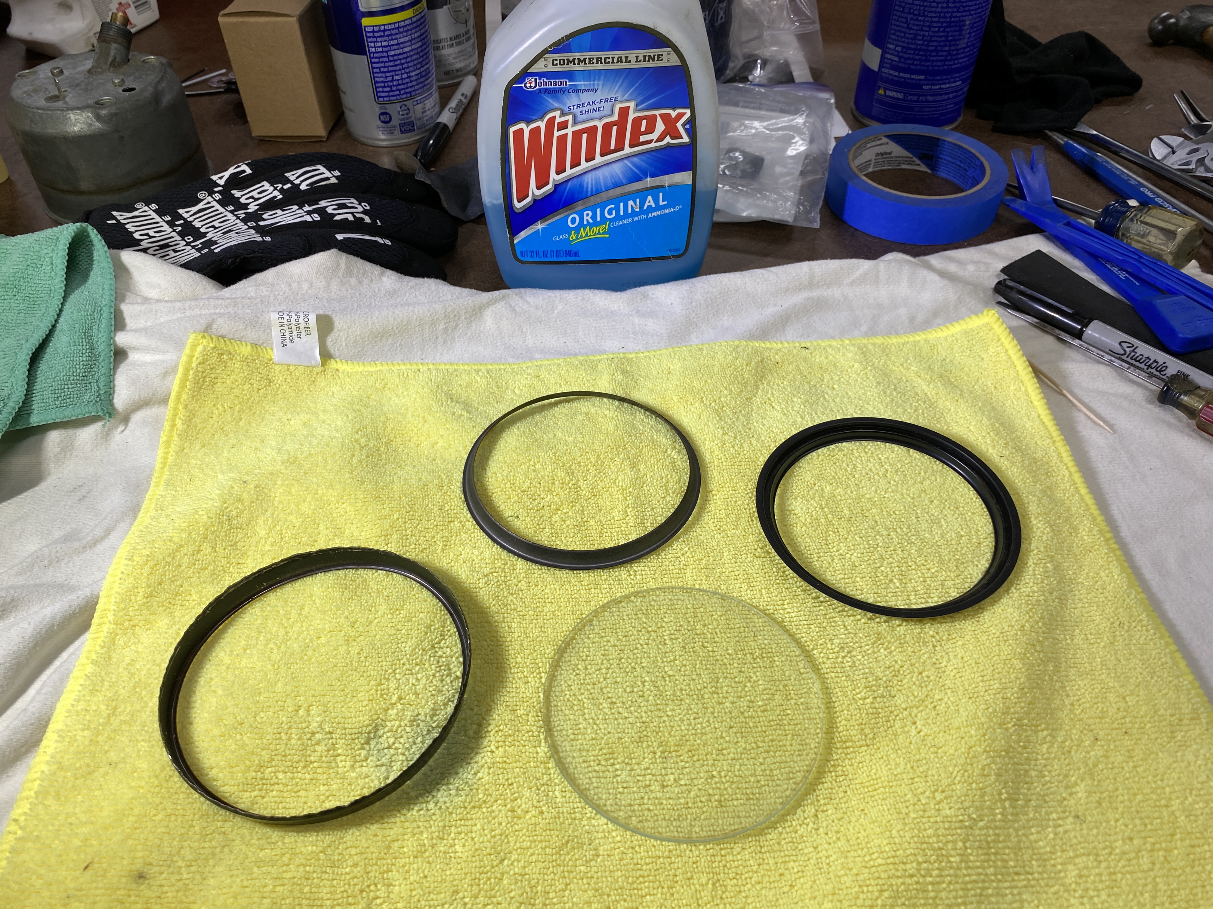

bkrantz
post Mar 15 2023, 07:37 PM
Post #6348
Posts: 8,342
Joined: 3-August 19
From: SW Colorado
Member No.: 23,343
Again, the goal is no fingerprints.
bkrantz
post Mar 15 2023, 07:38 PM
Post #6349
Posts: 8,342
Joined: 3-August 19
From: SW Colorado
Member No.: 23,343
Rings and glass back onto the housing.
bkrantz

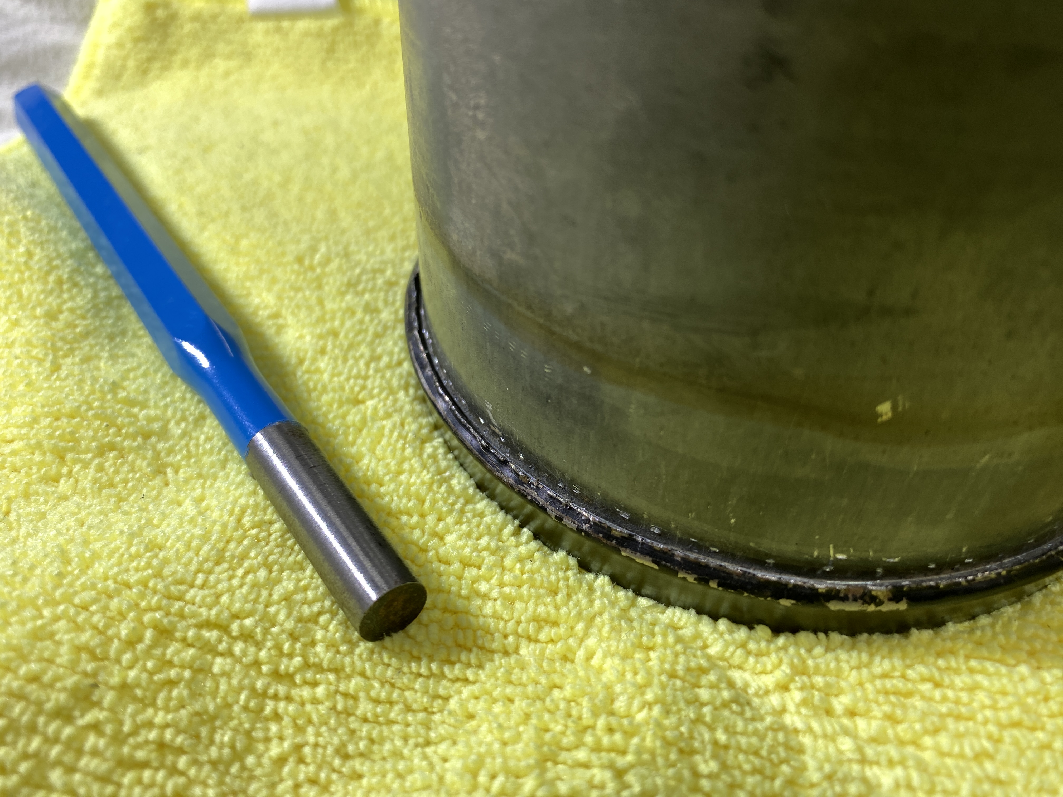

bkrantz
post Mar 15 2023, 07:39 PM
Post #6351
Posts: 8,342
Joined: 3-August 19
From: SW Colorado
Member No.: 23,343
Looks pretty good.
bkrantz

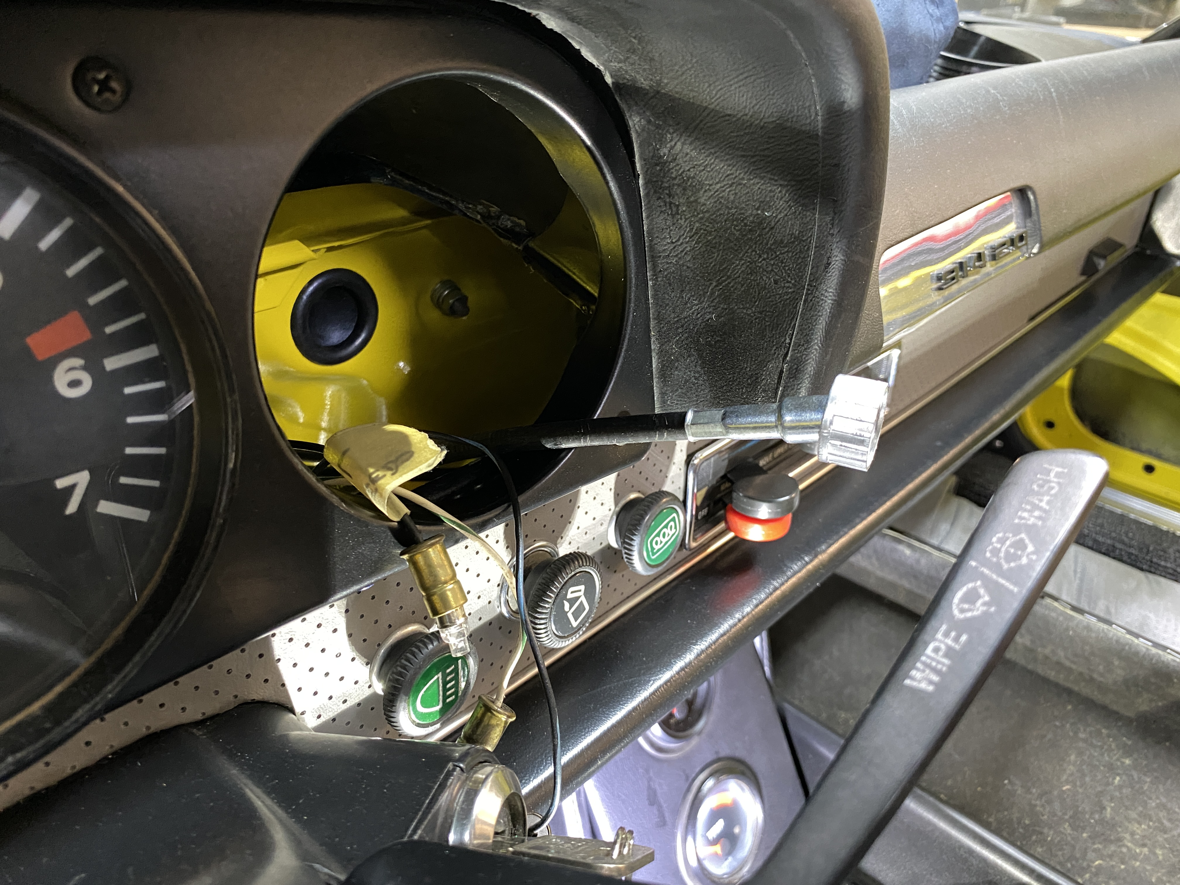

I plugged the odometer reset cable in.

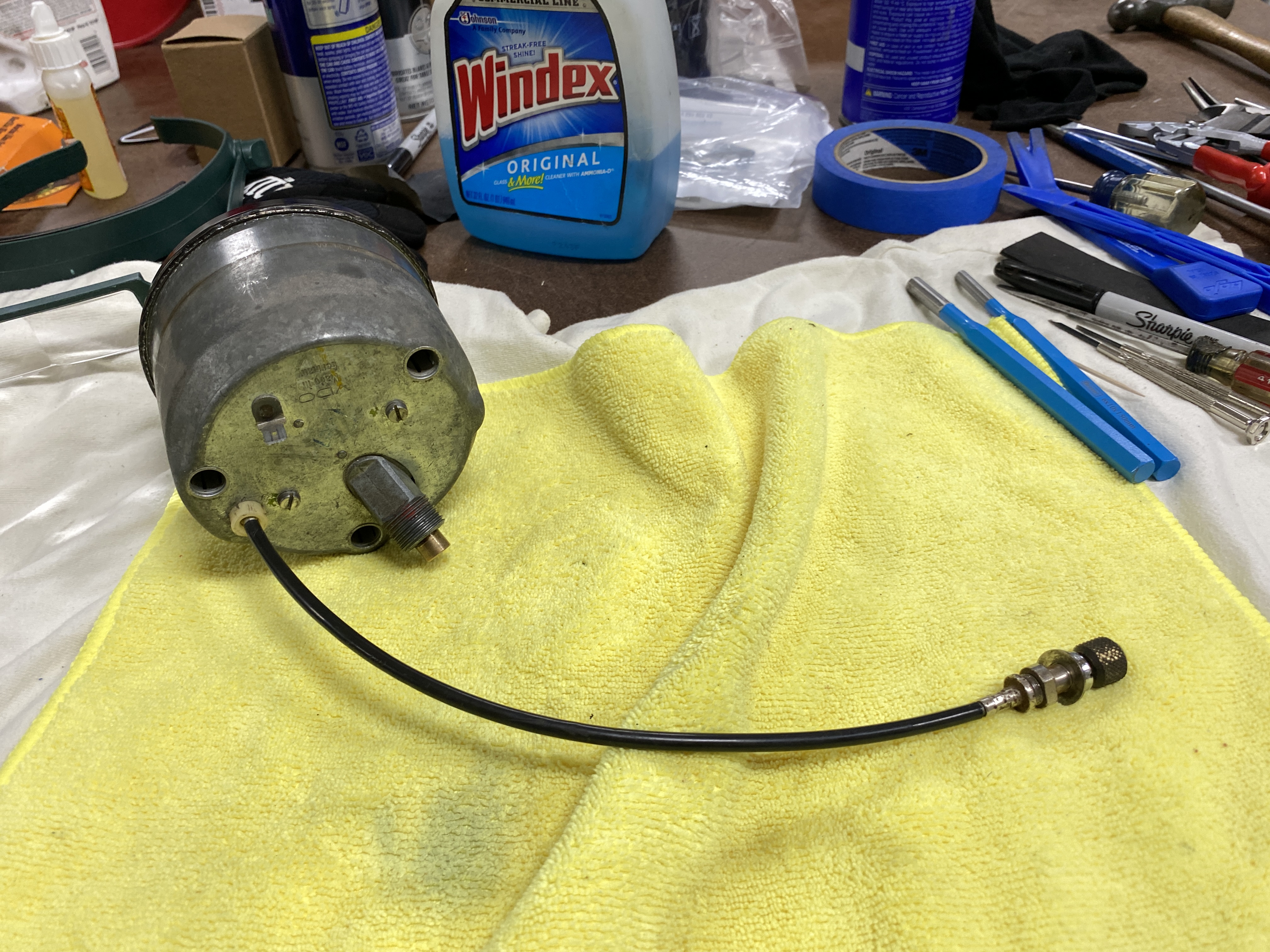

Before installation, I needed to deal with there length of the speedo cable. Right now, it only barely reaches the gauge when installed.

I pulled up the carpet and re-routed the cable.

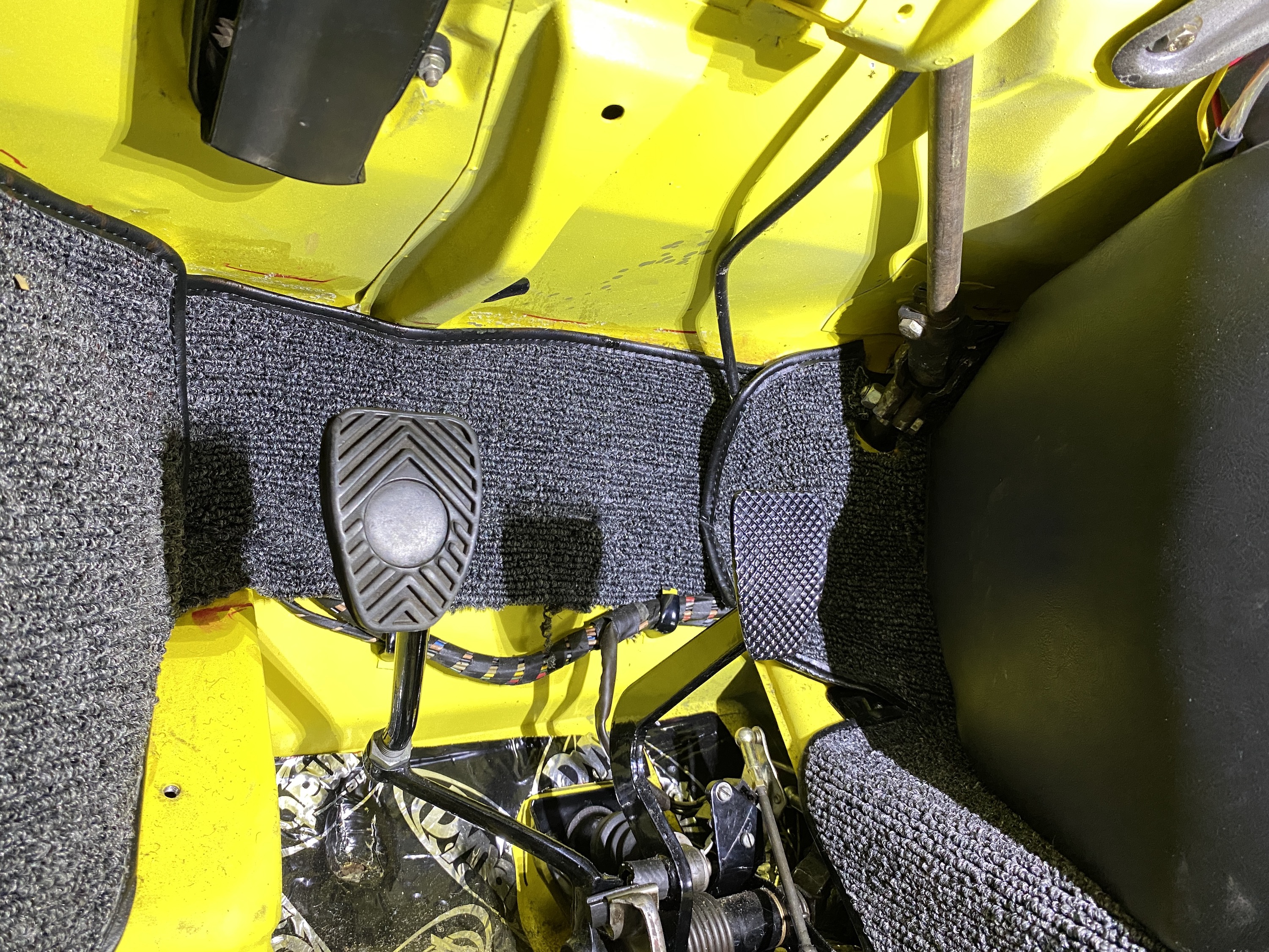

bkrantz
post Mar 15 2023, 07:46 PM
Post #6355
Posts: 8,342
Joined: 3-August 19
From: SW Colorado
Member No.: 23,343
Now there is plenty of spare length.
bkrantz

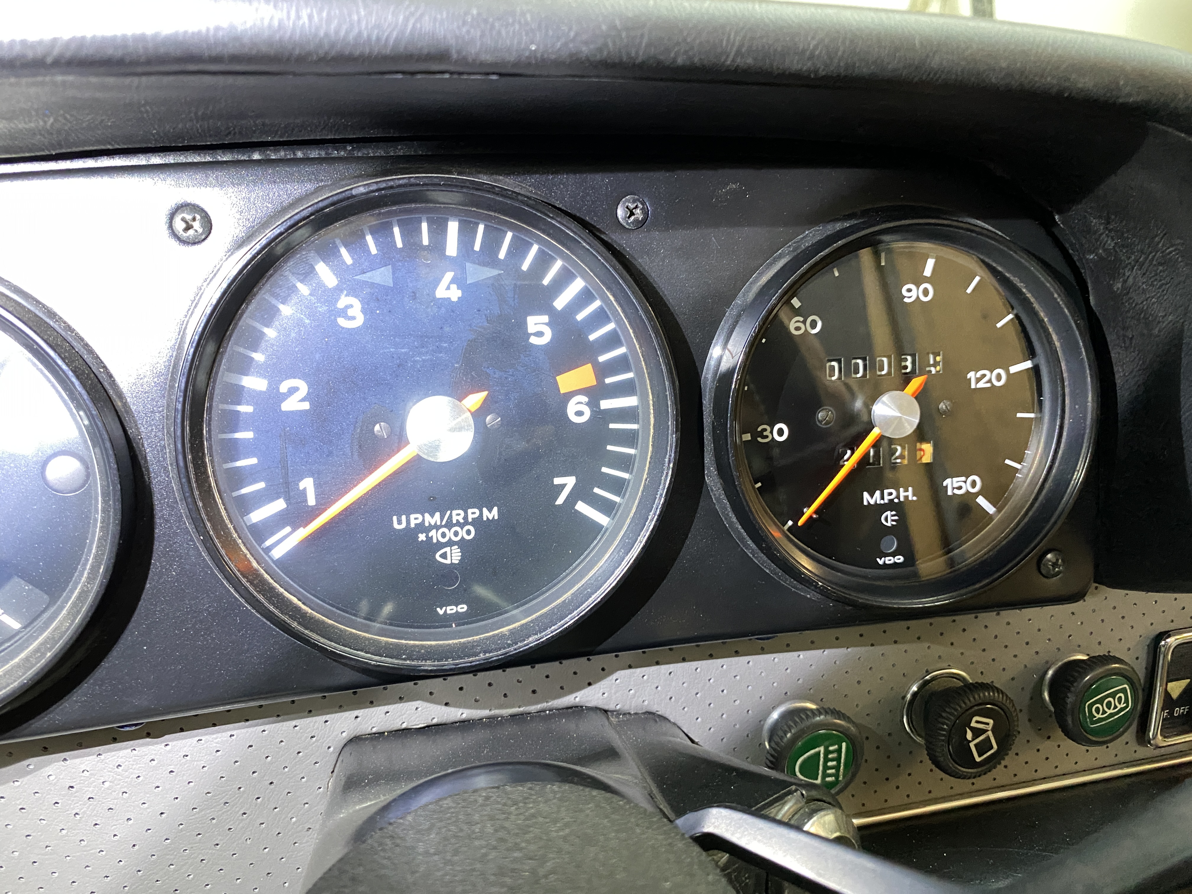

bkrantz
post Mar 15 2023, 07:48 PM
Post #6357
Posts: 8,342
Joined: 3-August 19
From: SW Colorado
Member No.: 23,343
Speedometer installed. It sure looks clean. The tach does not look as bad as the photo shows, but I already feel the need to take the glass off and clean it.
bkrantz

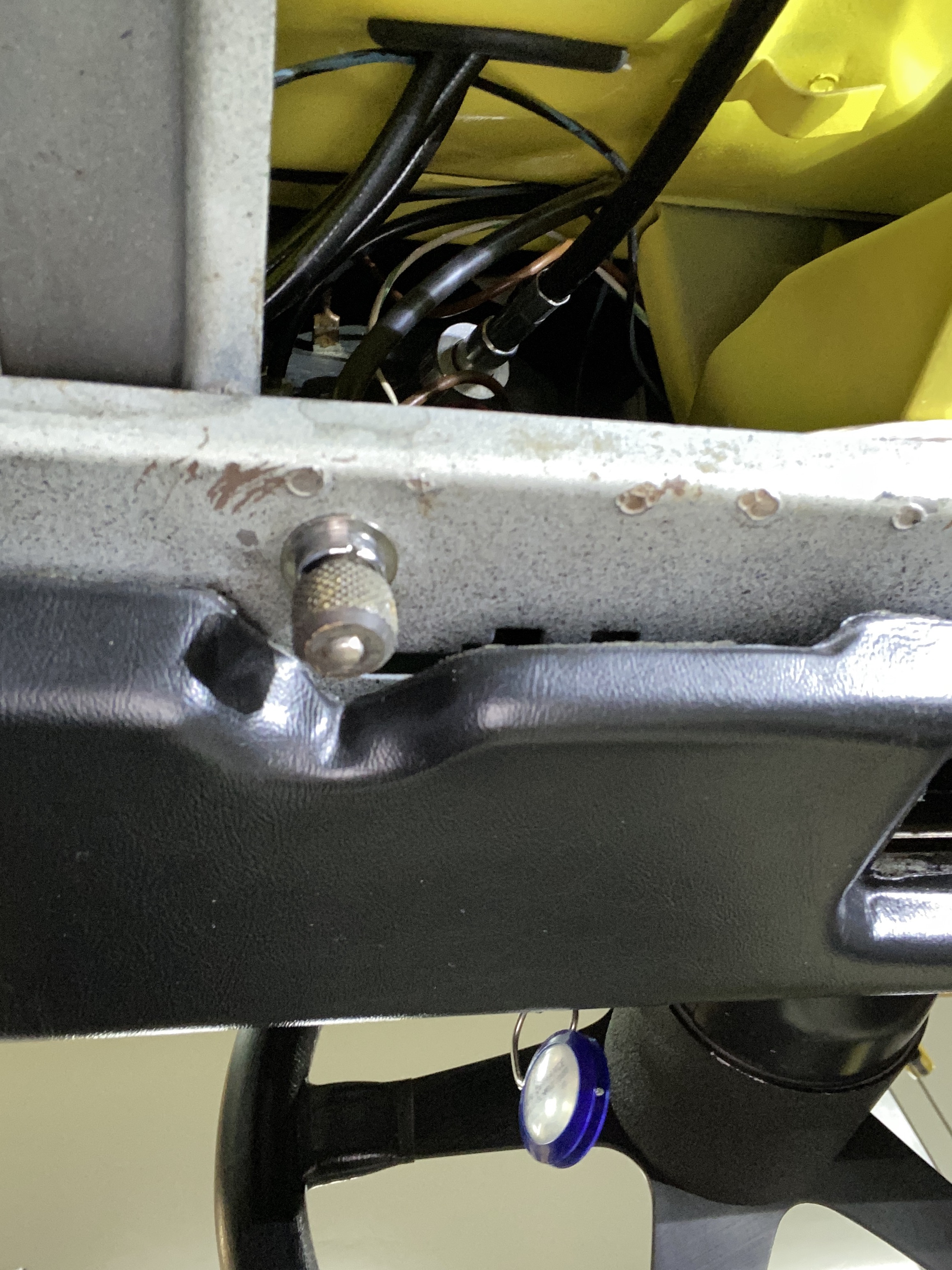

Here's the reset cable.

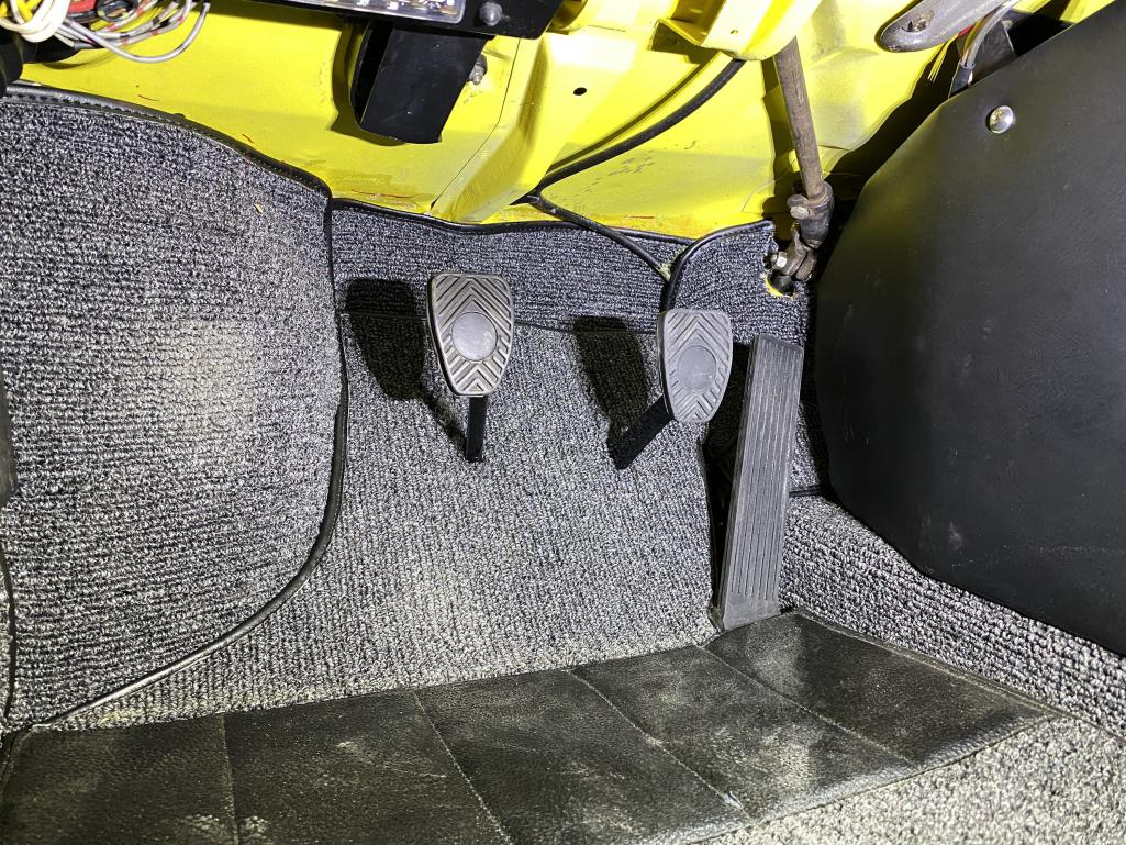

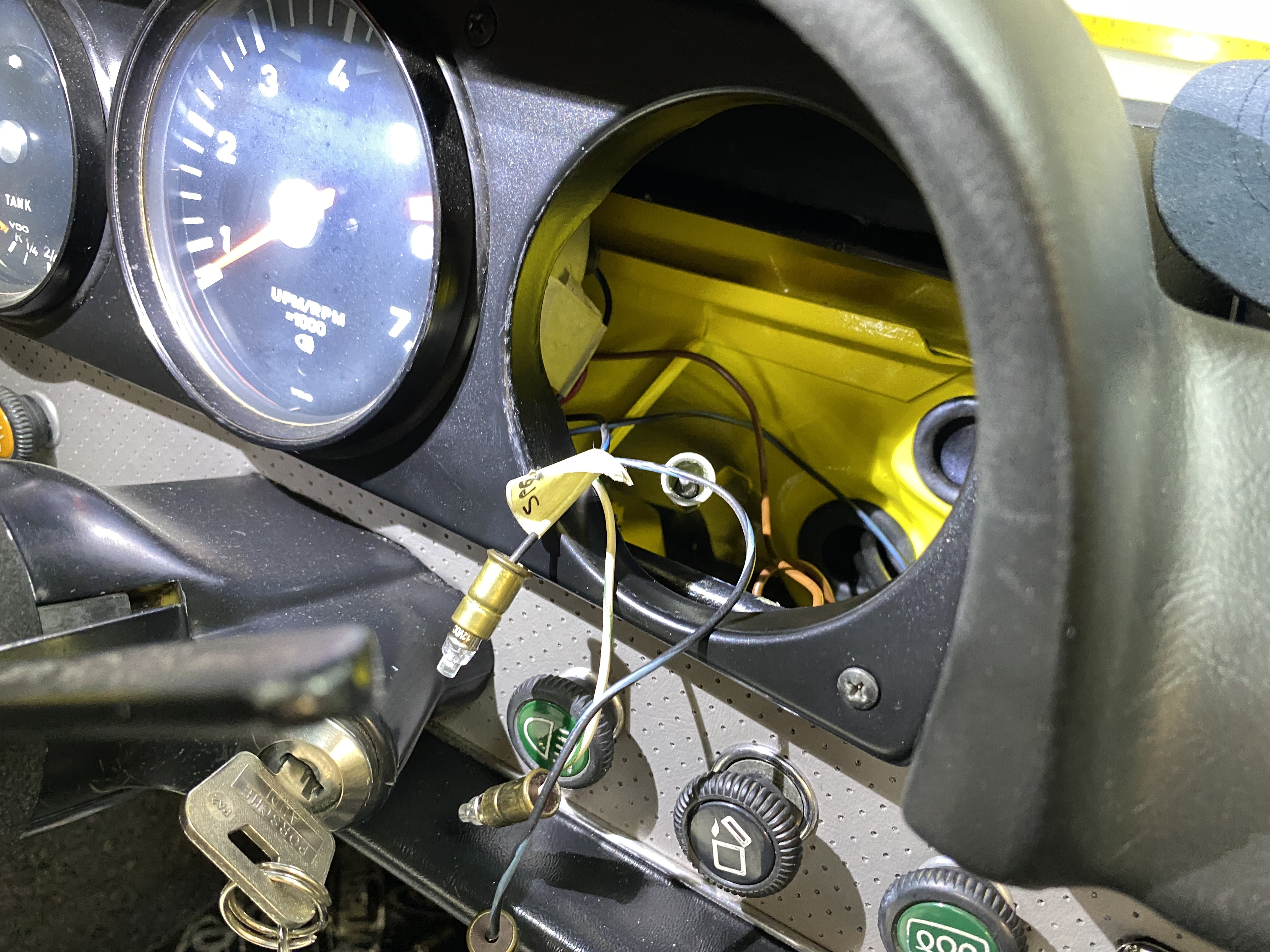

And everything put back together underneath. I did look at the brake pedal arm to see about trying to move the pedal a bit to the left, but that will have to wait for another time.
bkrantz
post Mar 15 2023, 07:52 PM
Post #6360
Posts: 8,342
Joined: 3-August 19
From: SW Colorado
Member No.: 23,343
Making progress.
343 Pages V « < 316 317 318 319 320 > »
