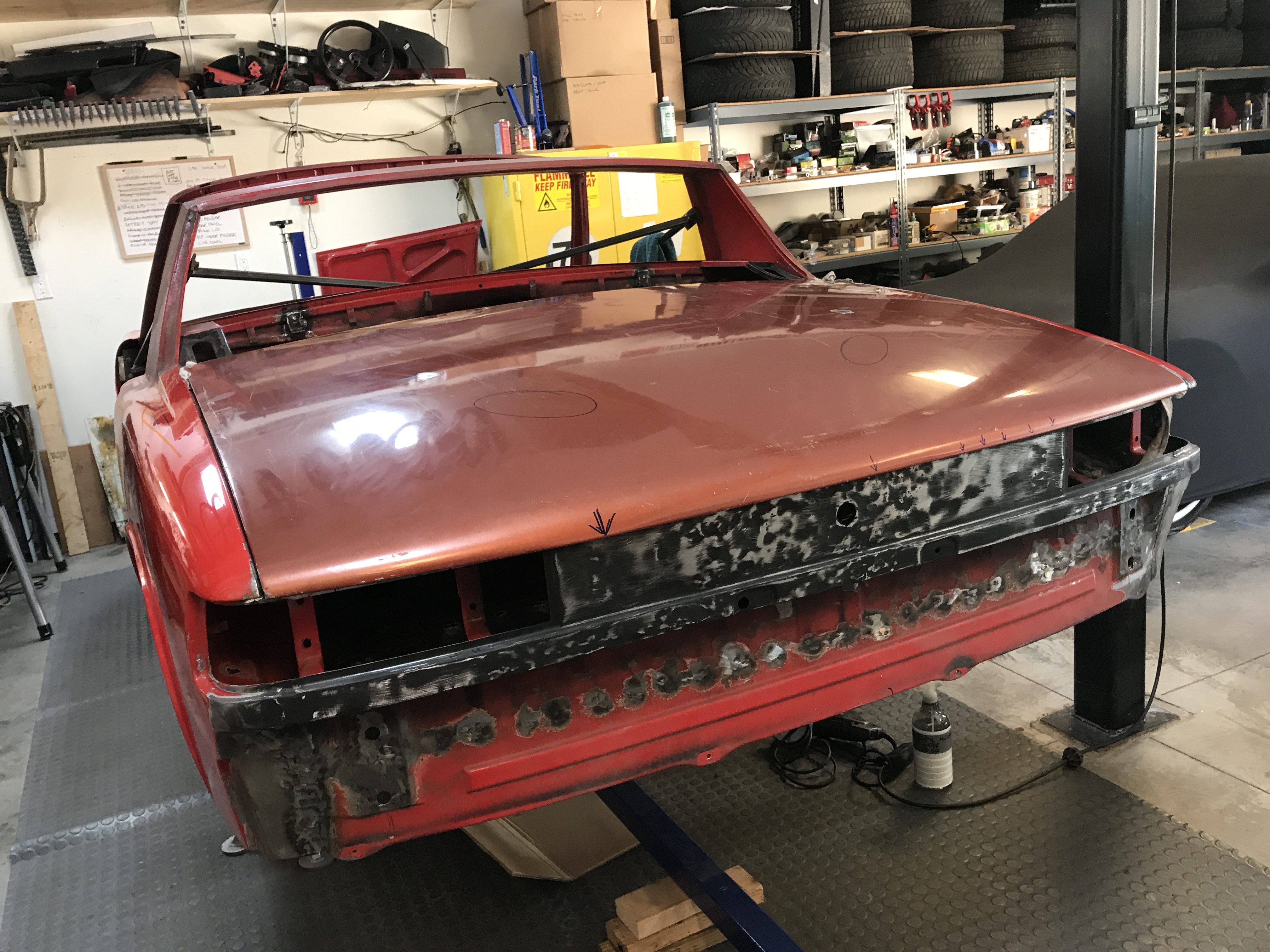

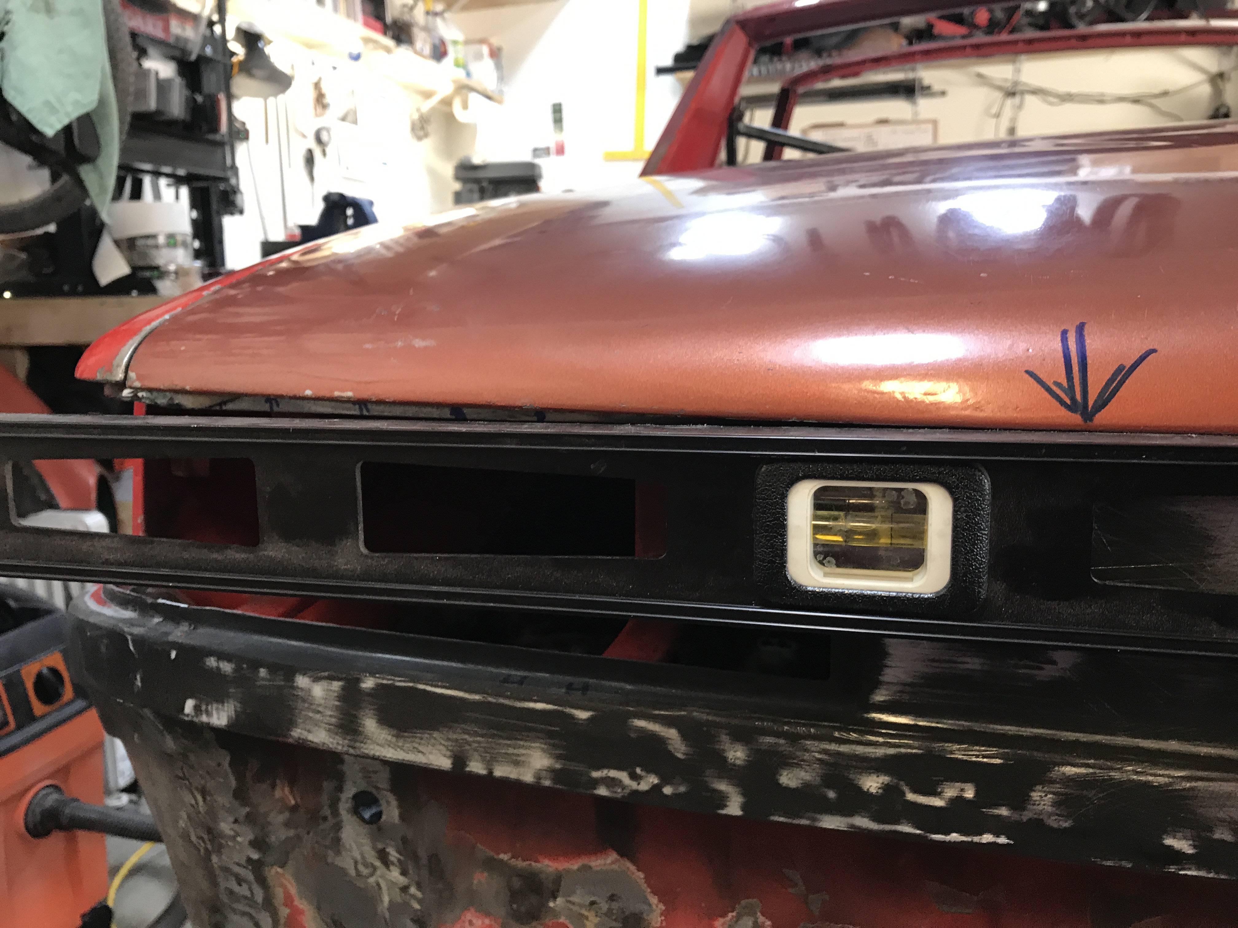

I then set the trunk lid back on the car, propped in rough alignment. The next step is to straighten out all the dings, including the trailing edge. From 10 ft it looks pretty good, but...

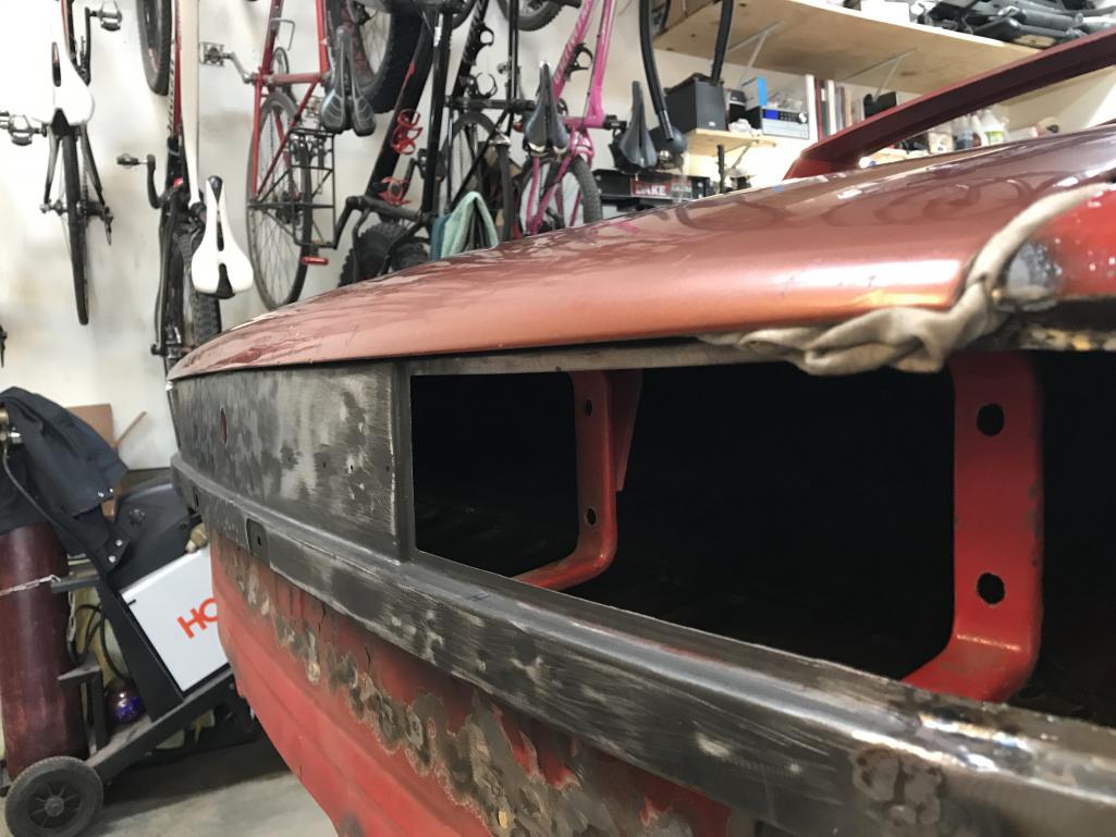

The trailing edge has been bent inward. I suspect it got set down hard enough on that edge to roll it under a bit. From the right side to the center, I see a gradual drop of the edge.

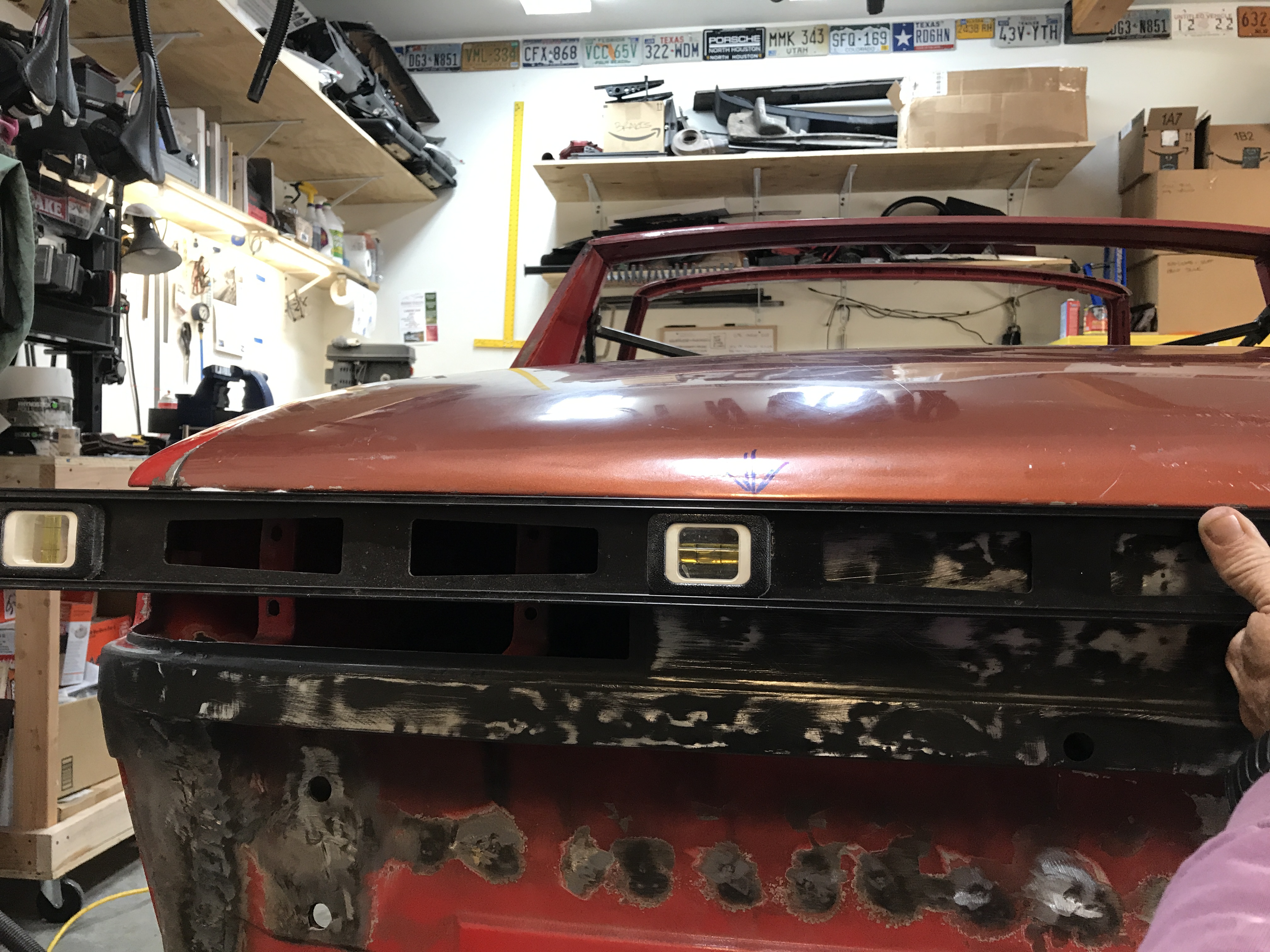

On the left side, the bend is more abrupt. I need to invent a lever that can clamp onto the edge, and ease it upward.

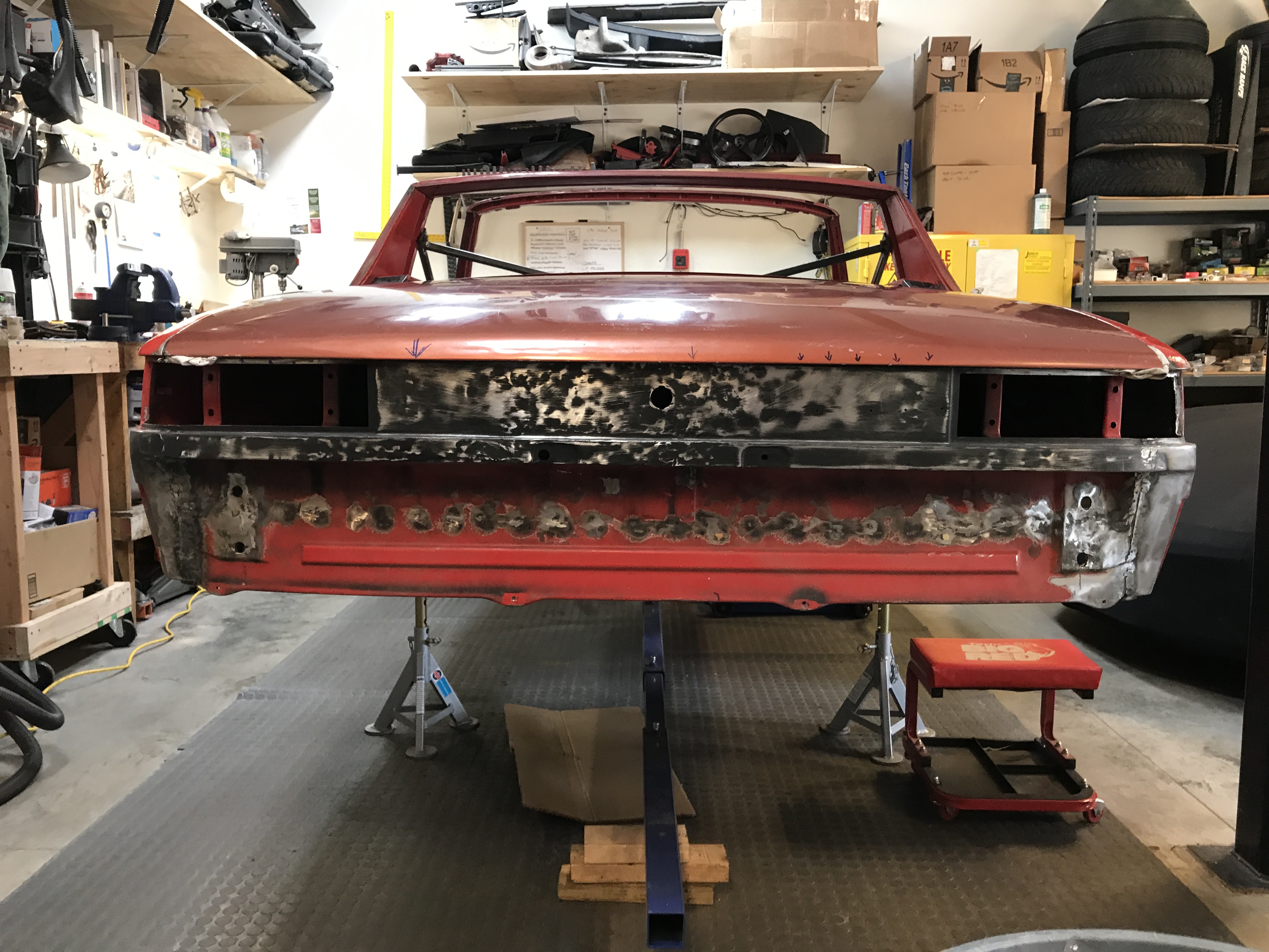

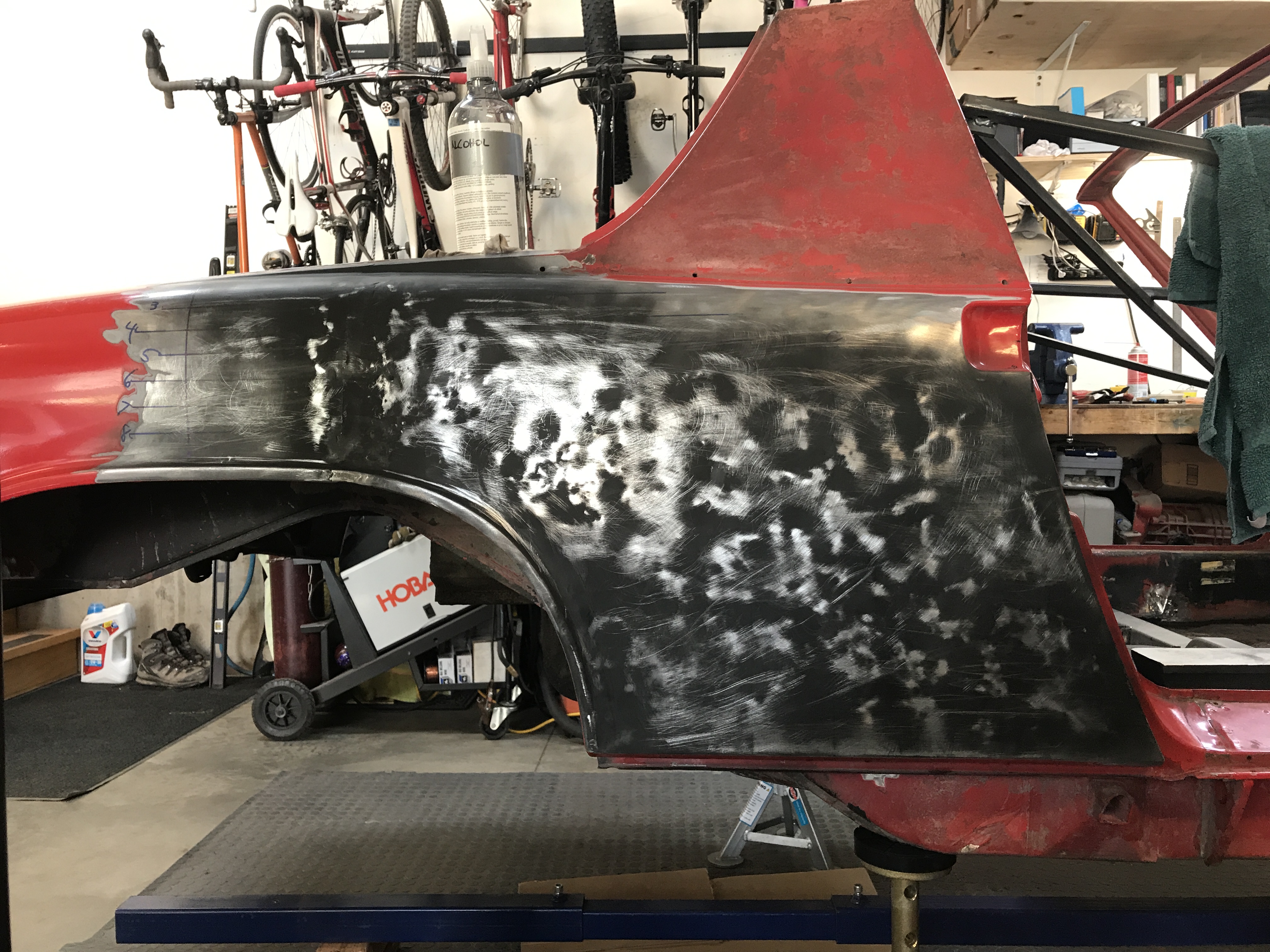

Meanwhile, I finished up the metal work on the right rear fender. The sanded spots in the guide coat make it look worse than it is. The highs and lows differ by only about 1 mm.

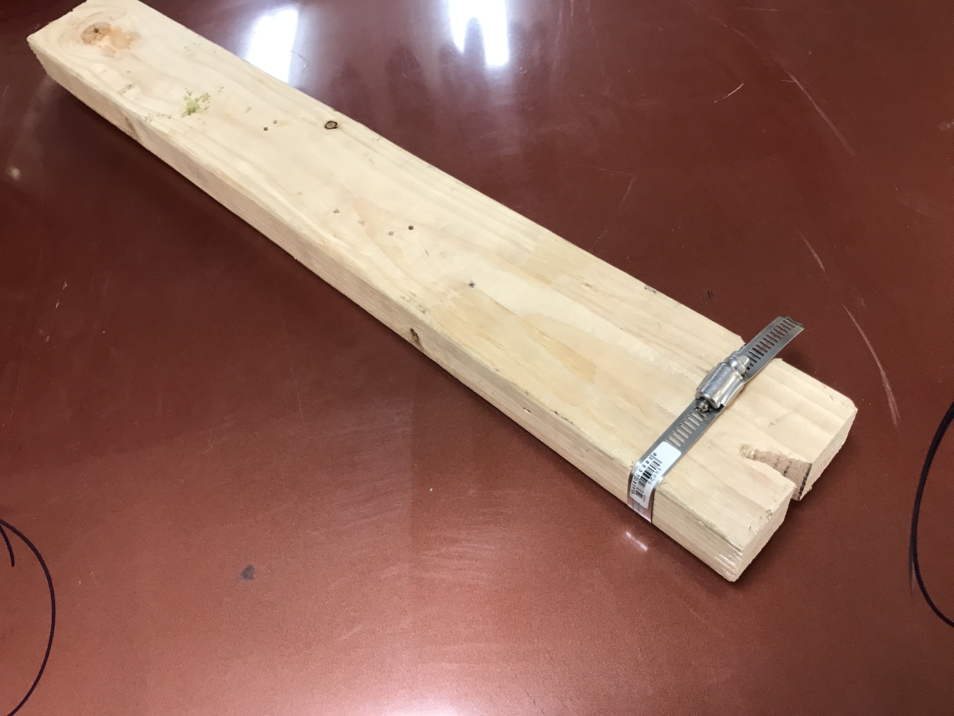

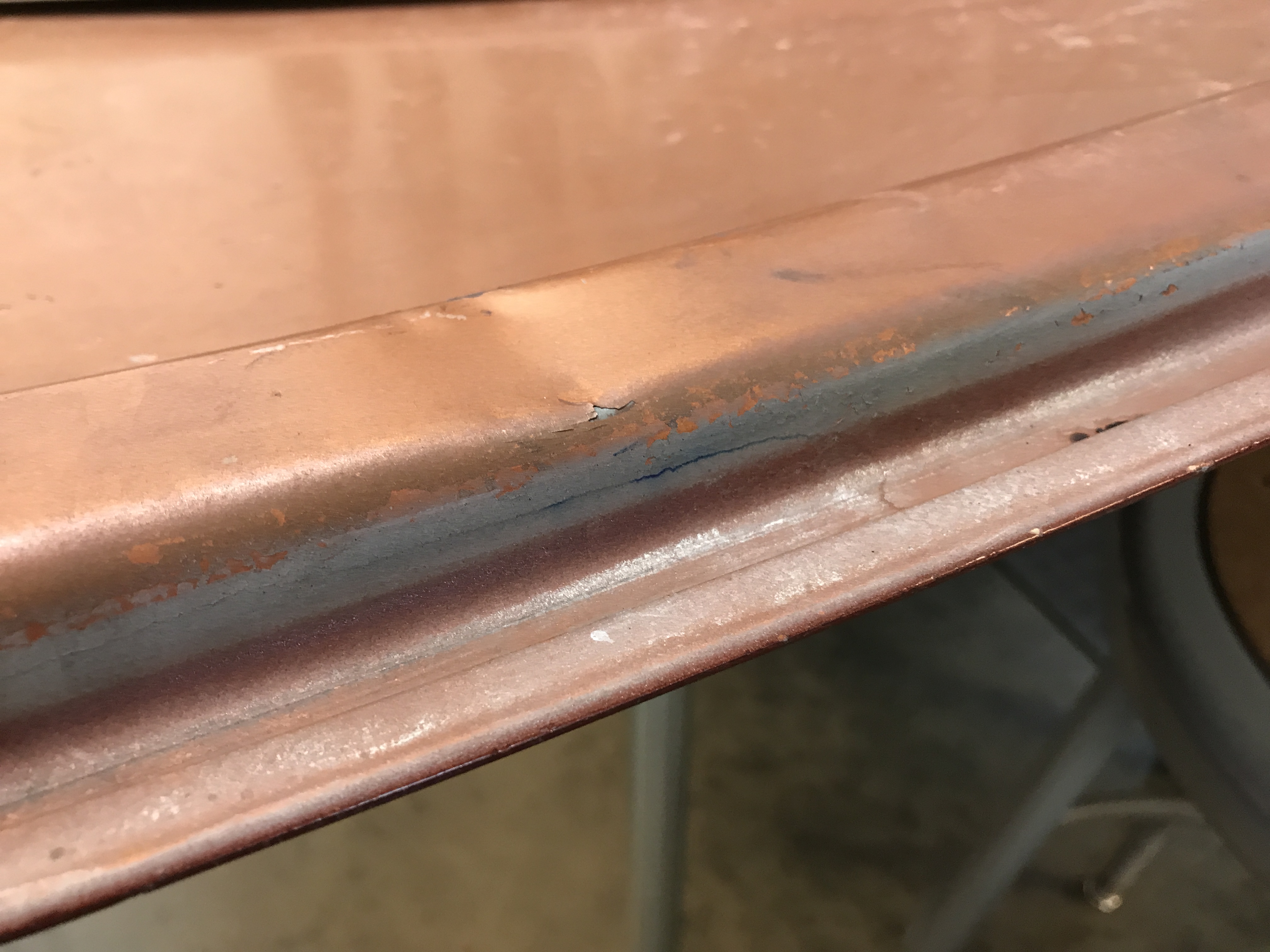

I worked more on the trunk lid today. First I made a tool to grab and pry the trailing edge. (some of the notch fell out during work--the clamp kept the 2x4 from splitting)
bkrantz
post May 11 2020, 08:14 PM
Post #646
Posts: 8,342
Joined: 3-August 19
From: SW Colorado
Member No.: 23,343
After some gentle prying, plus some more hammer work with a soft-face mallet, I got the edge close to straight, and equally distant from the rear panel along the arc.
bkrantz
Post #647
Posts: 8,342
Joined: 3-August 19
From: SW Colorado
Member No.: 23,343
Looks good by eye.
bkrantz
post May 11 2020, 08:16 PM
Post #648
Posts: 8,342
Joined: 3-August 19
From: SW Colorado
Member No.: 23,343
And even better from a few feet away.

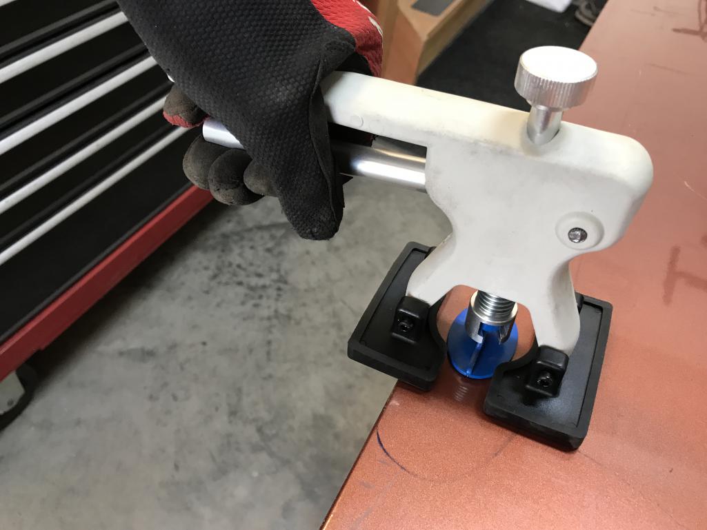

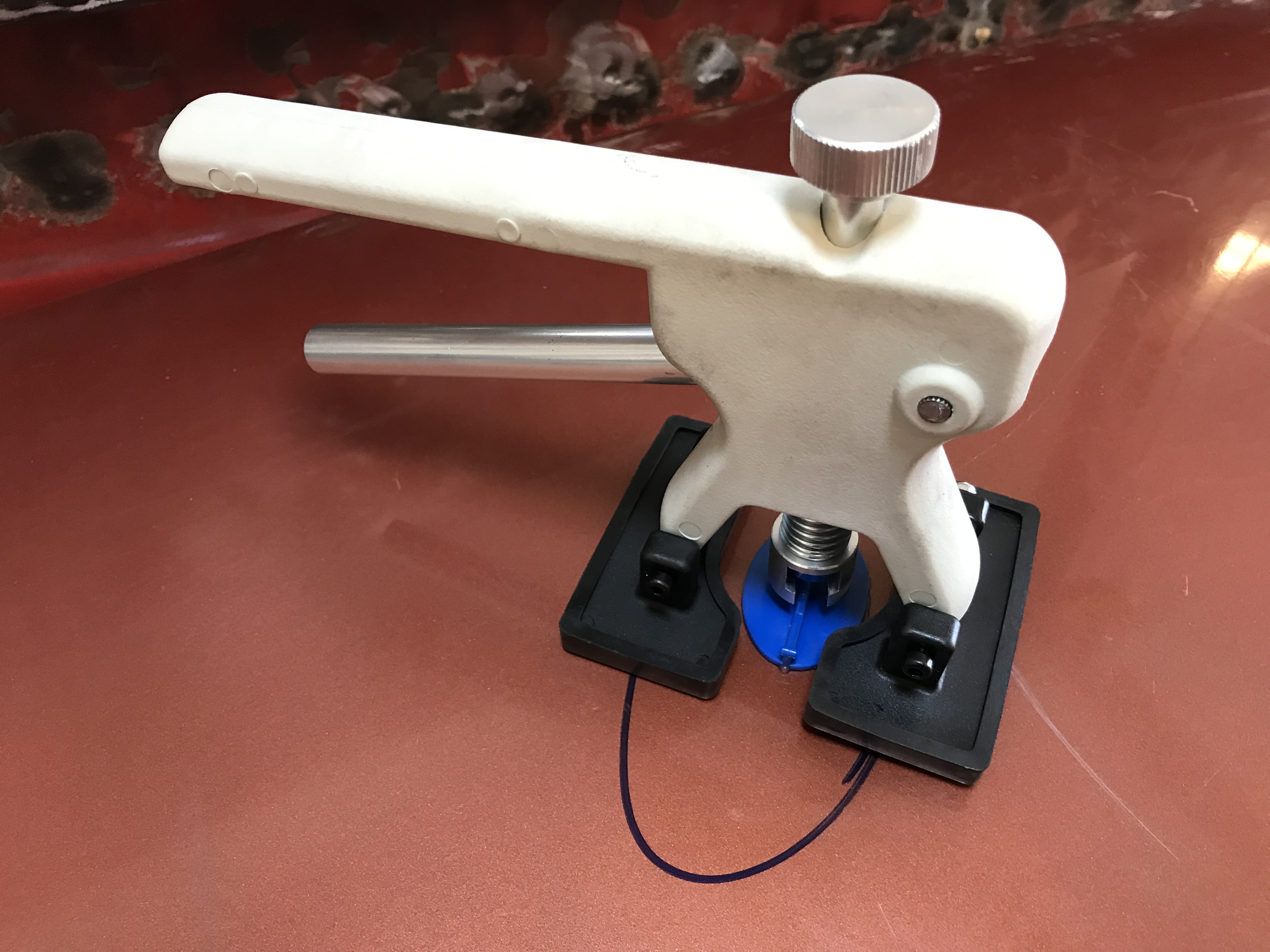

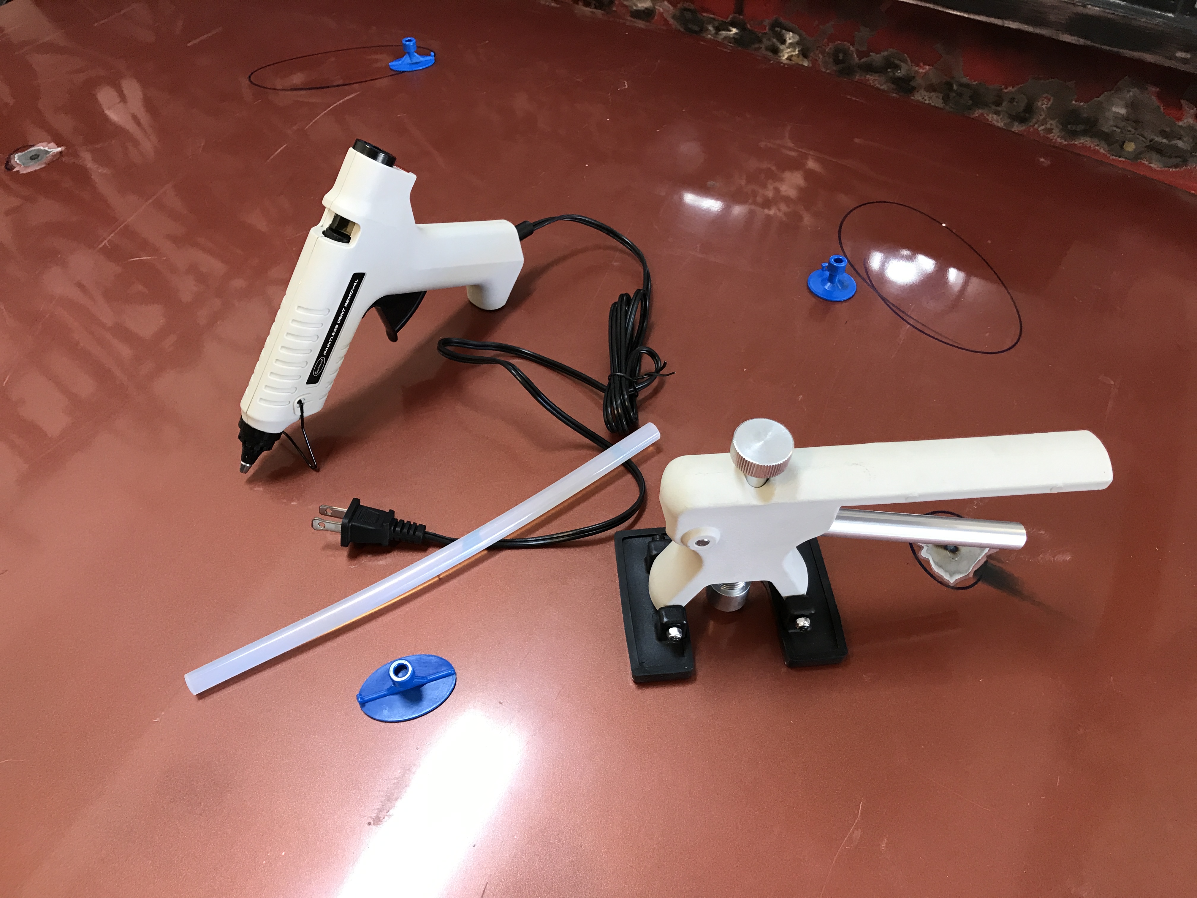

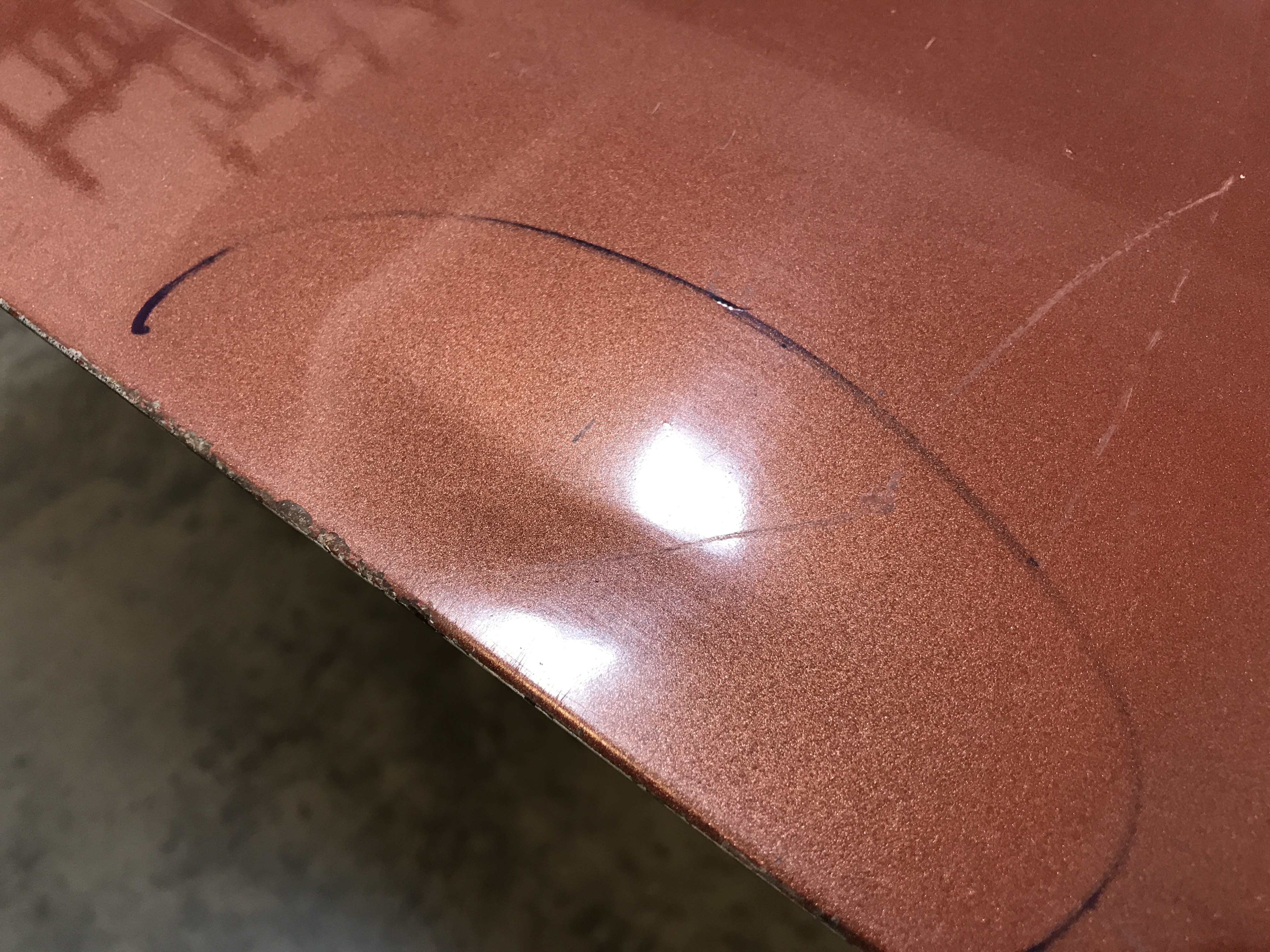

More work one the trunk lid today, and playing with a new tool kit. This is the pointless dent remover set from Eastwood. It comes with a glue gun, plastic pulling tabs, a hand lever pry thing, small slide hammer (not shown), and tab remover.
bkrantz
post May 12 2020, 07:45 PM
Post #653
Posts: 8,342
Joined: 3-August 19
From: SW Colorado
Member No.: 23,343

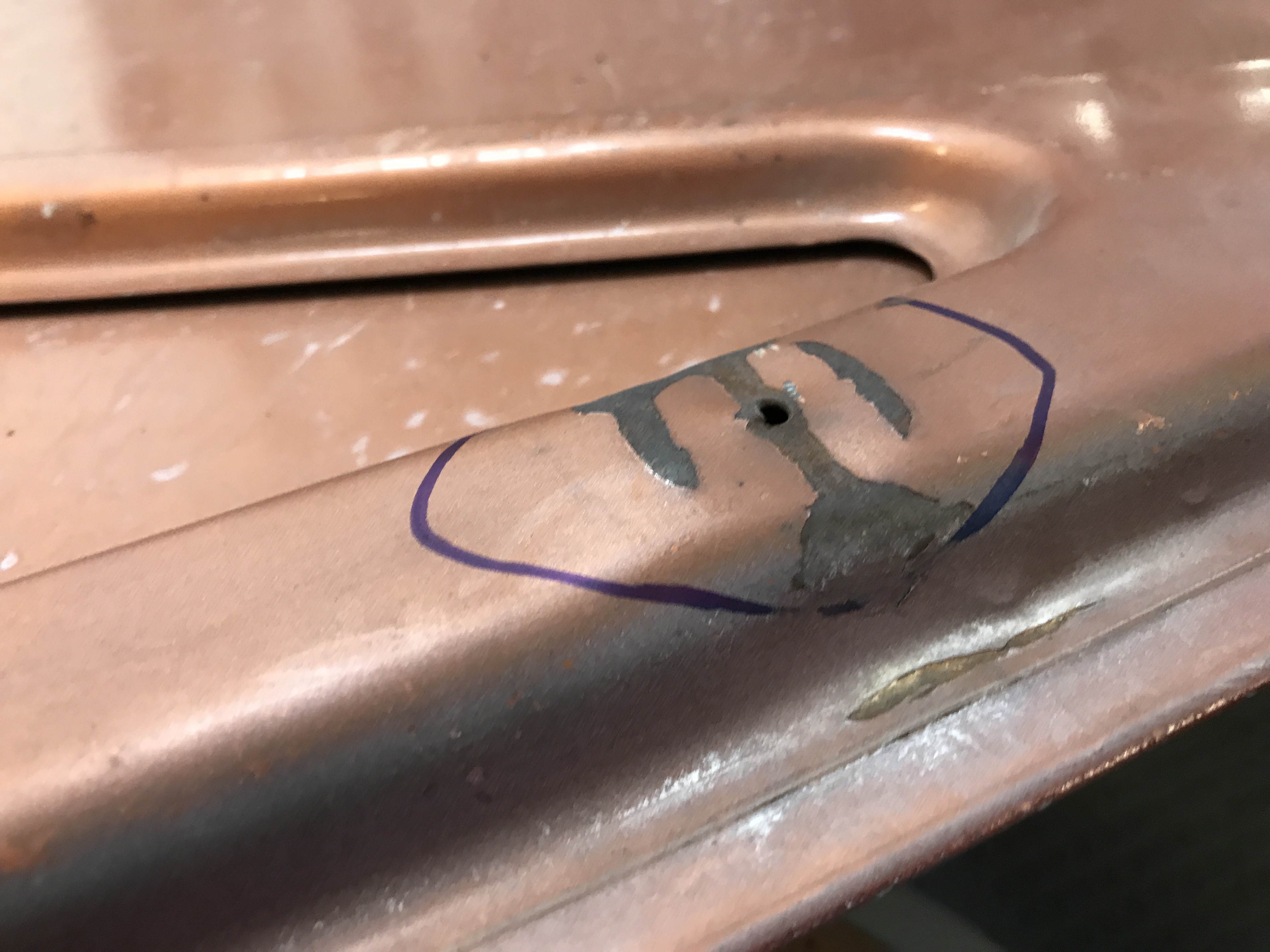

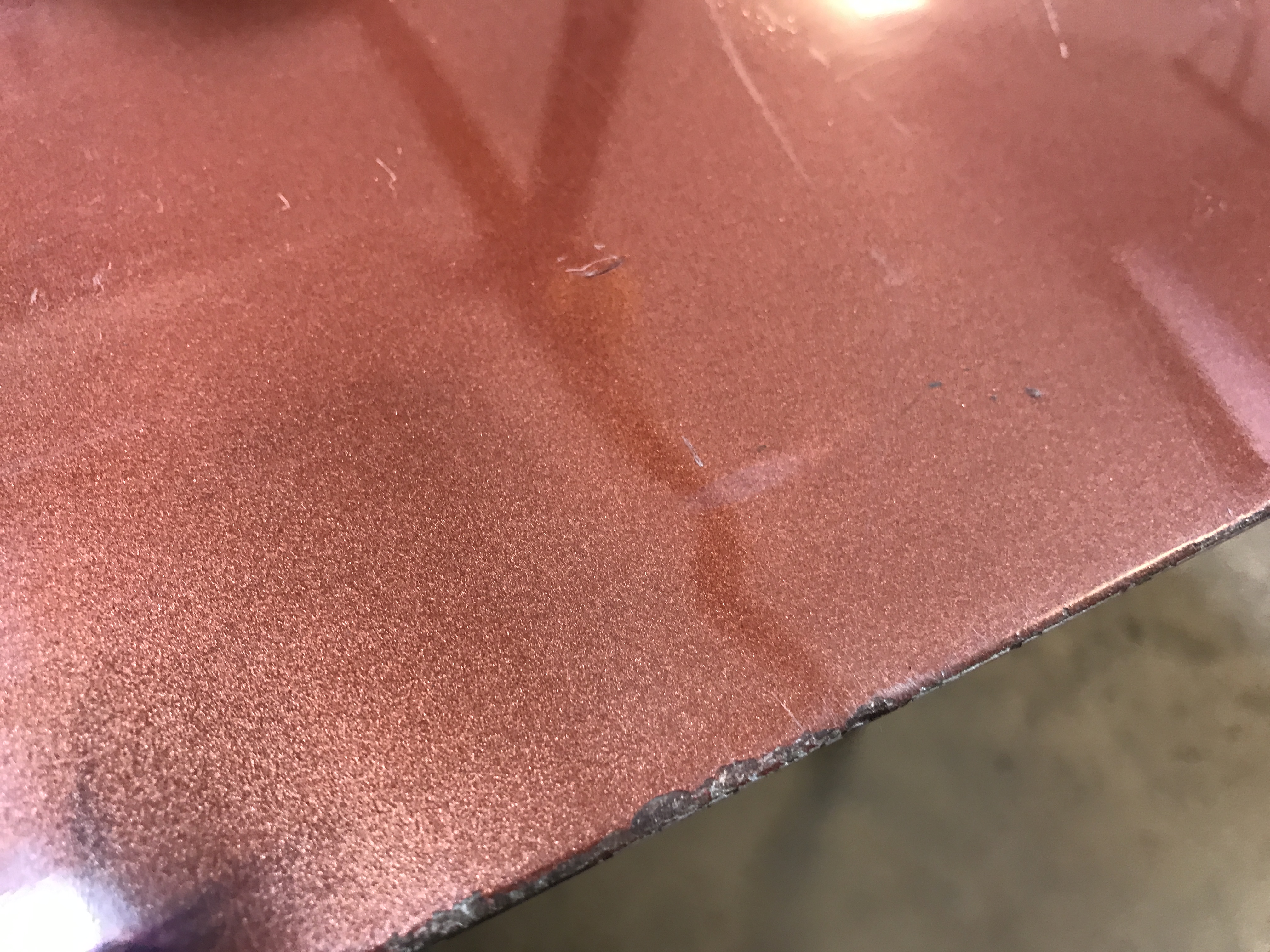

Here's a shallow dent in the outer skin, along the leading edge. The inner rib prevents access to the back of this.
bkrantz
post May 12 2020, 07:46 PM
Post #654
Posts: 8,342
Joined: 3-August 19
From: SW Colorado
Member No.: 23,343

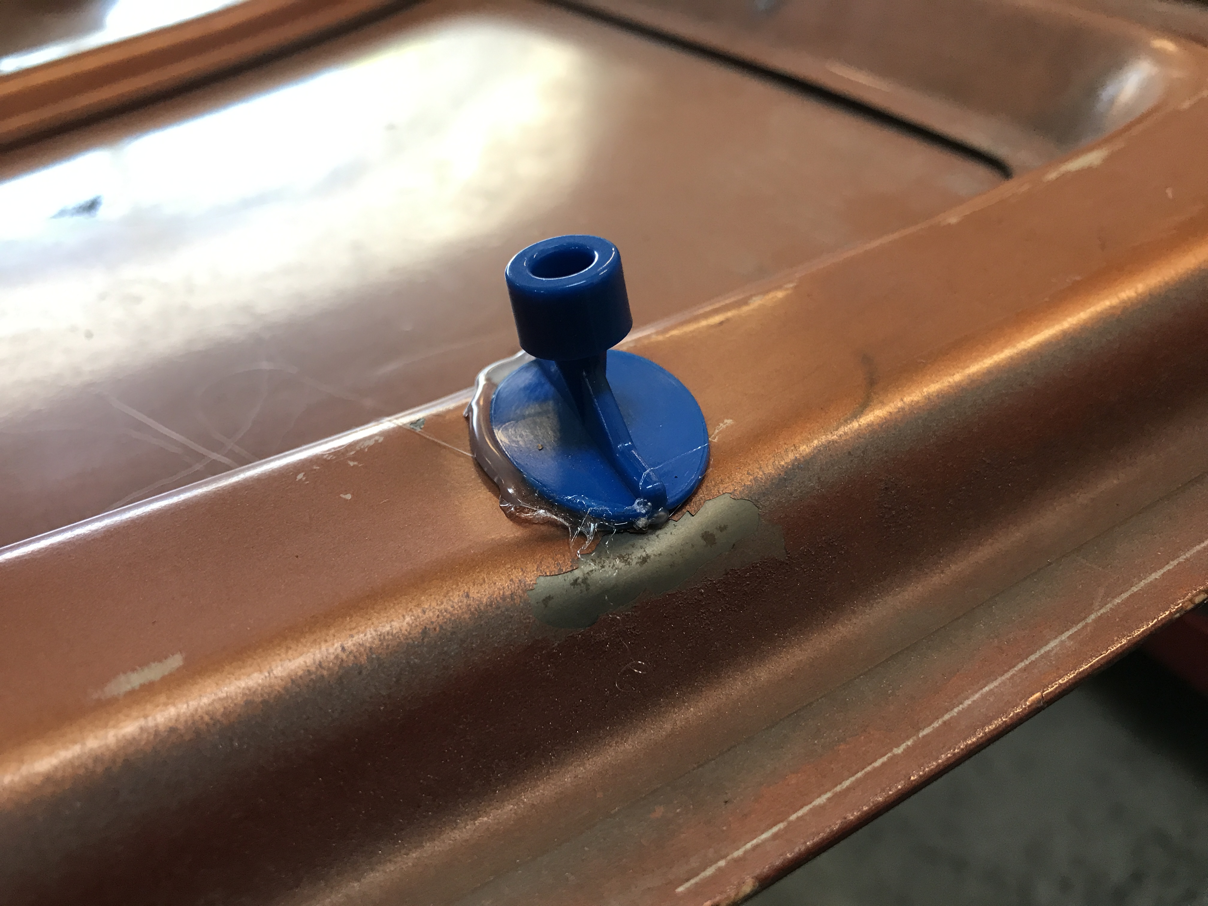

So heat the glue gun, apply to tab, stick on to center of dent, and pry away.
bkrantz
Post #655
Posts: 8,342
Joined: 3-August 19
From: SW Colorado
Member No.: 23,343
Not bad now.

I pulled a few more dents in the outer skin with pretty good results.

But the hot glue is not strong enough and the pull tabs kept popping off.

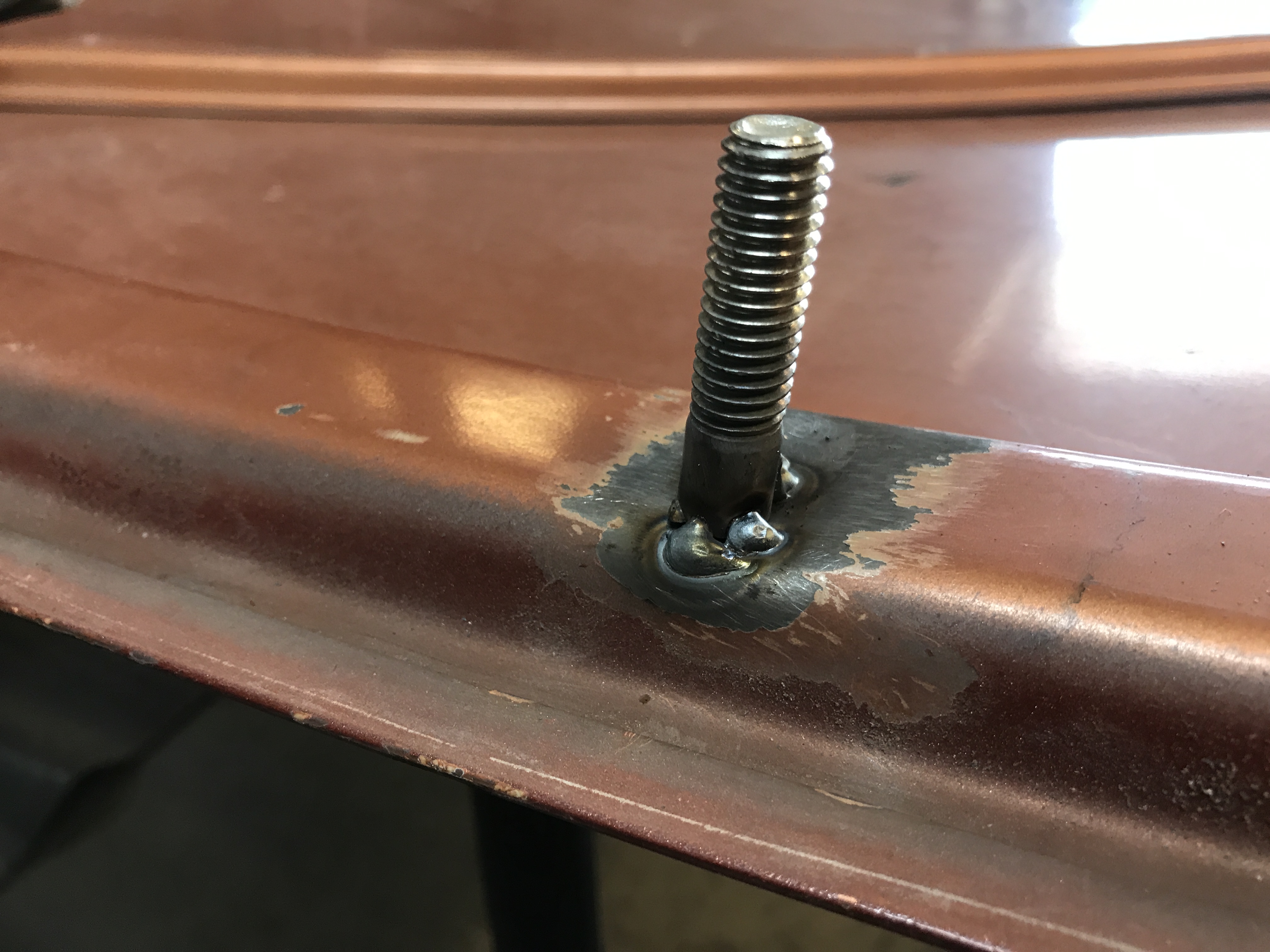

I could have done what a PO did, and drill holes for a screw-in puller.
bkrantz
post May 12 2020, 07:54 PM
Post #660
Posts: 8,342
Joined: 3-August 19
From: SW Colorado
Member No.: 23,343
Instead I welded on studs that my big slide hammer can screw on to.
