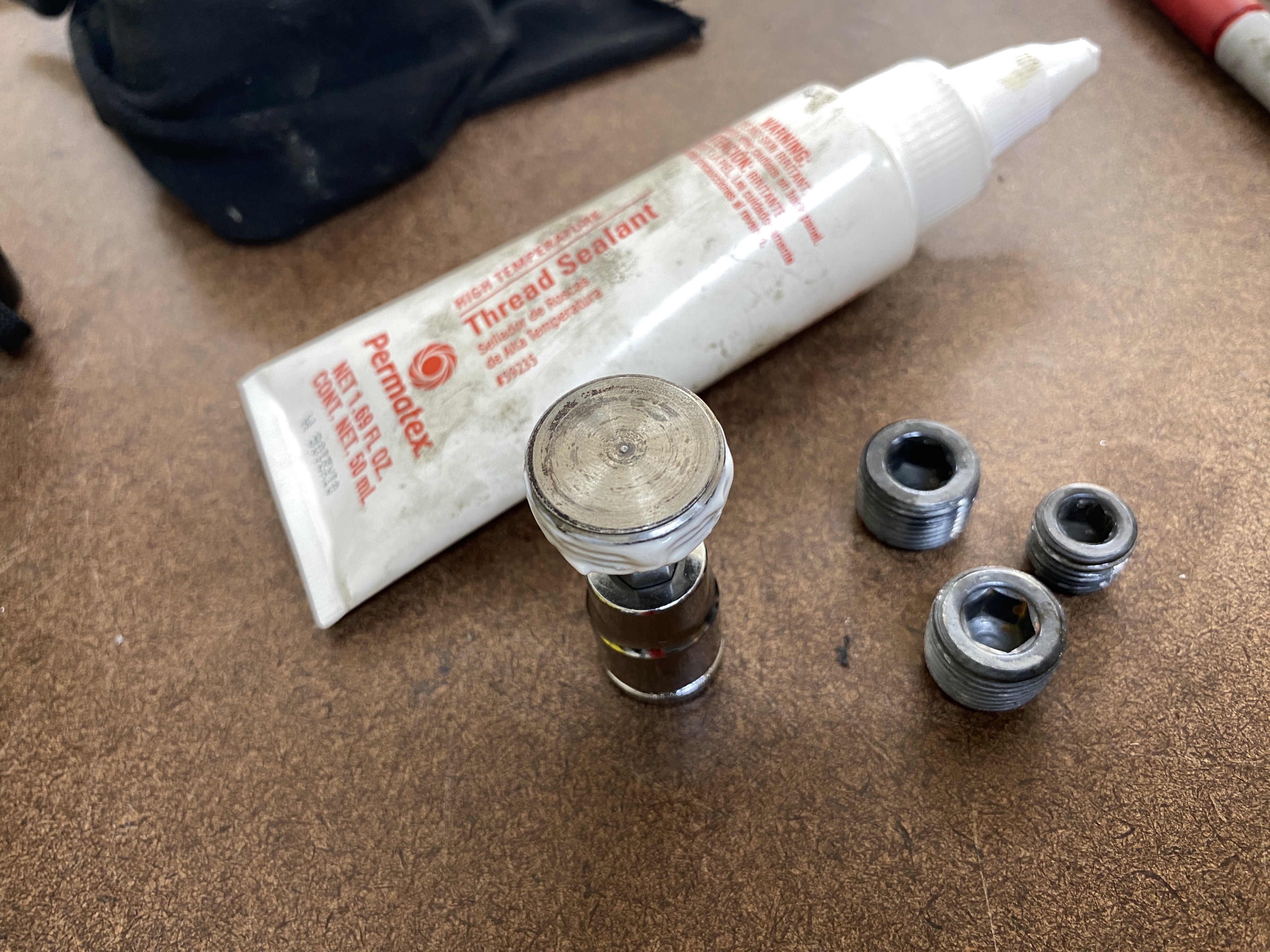

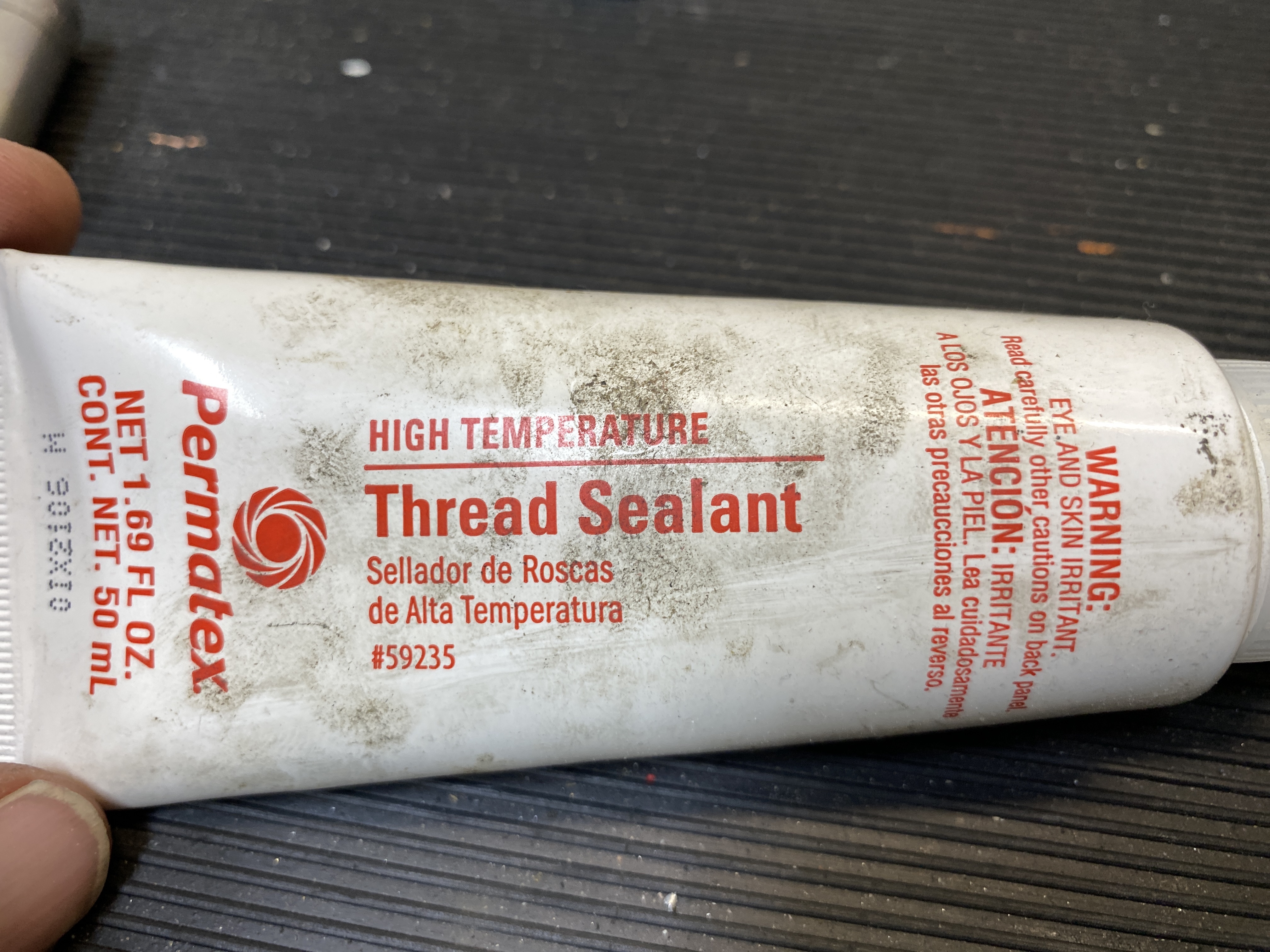

Personally, I've had good luck with the Permatex pictured but have not used it on galley plugs.

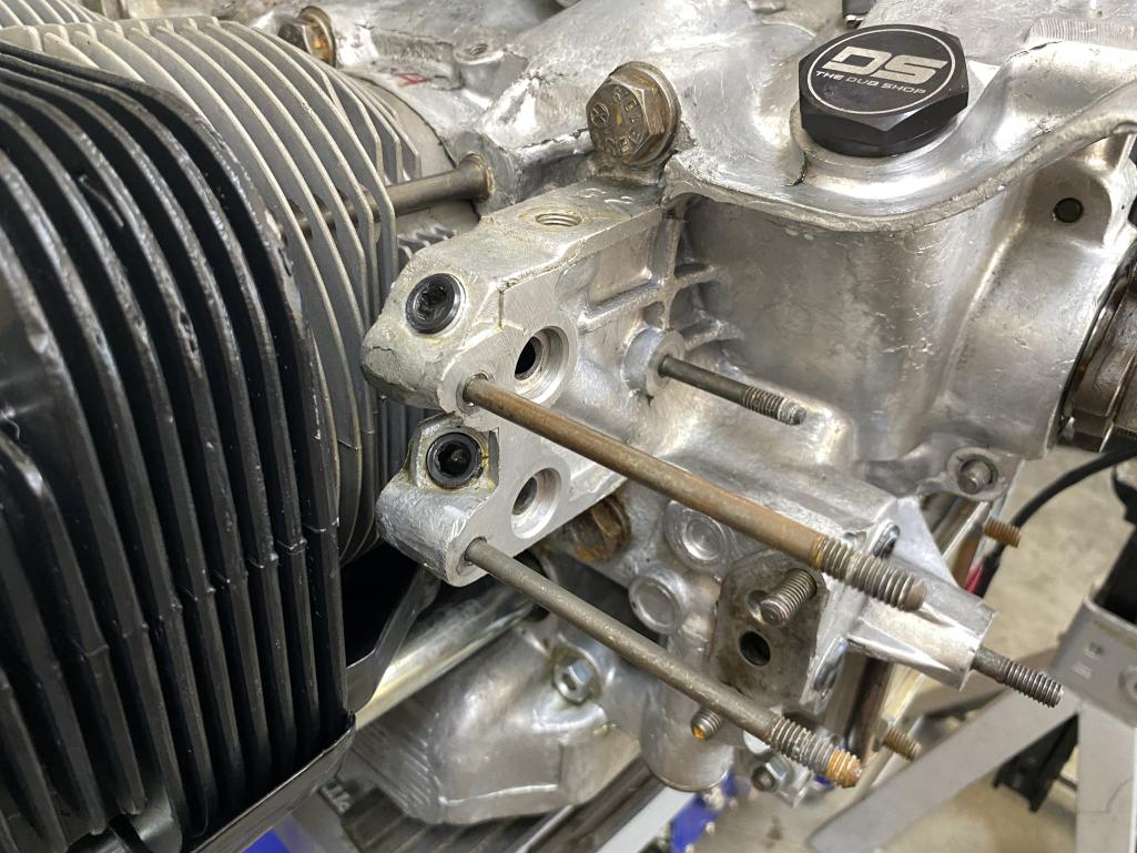

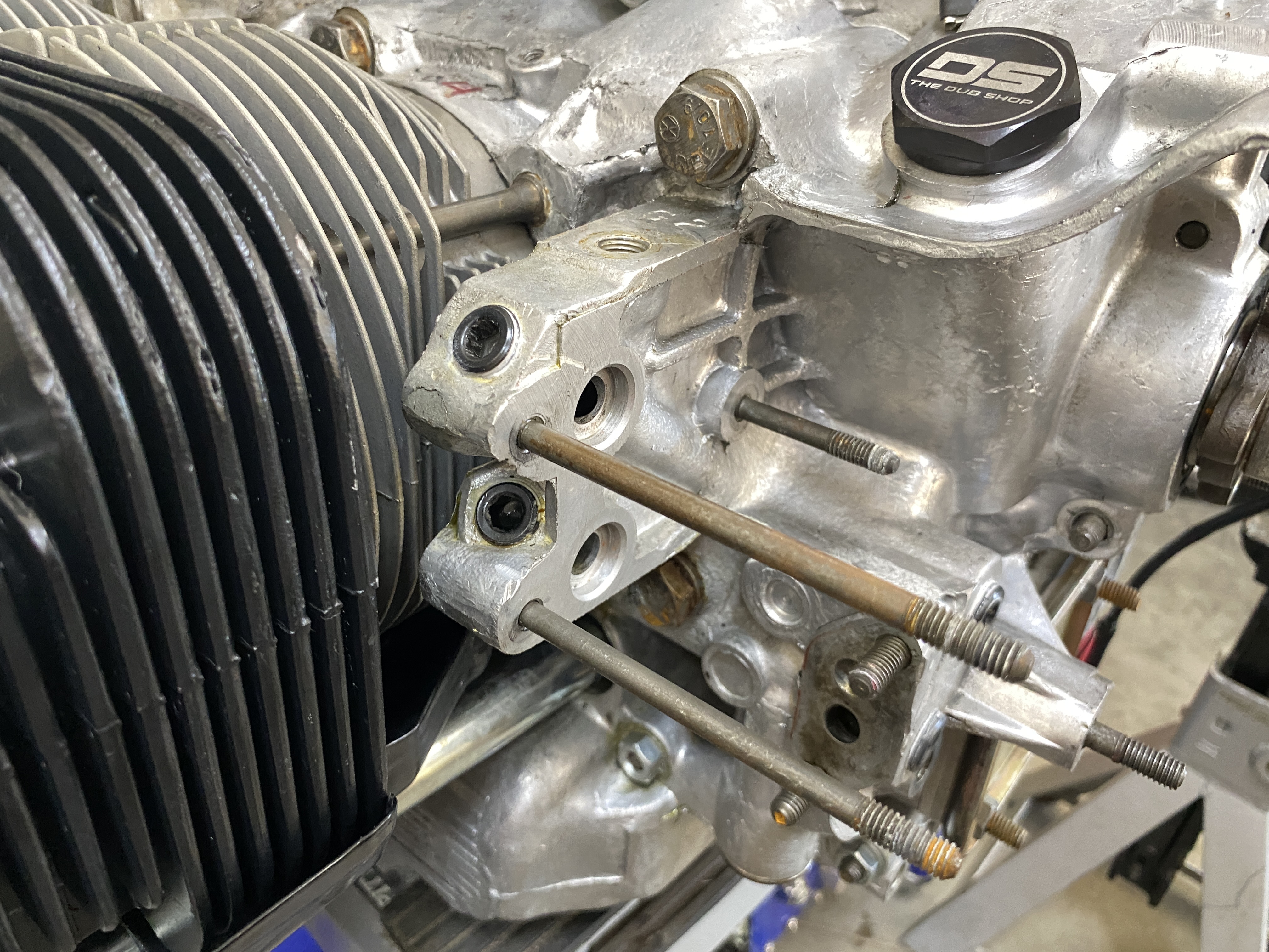

Starting to put things back together today. Step 1: clean the thread galley openings.
bkrantz
post Jun 24 2023, 07:55 PM

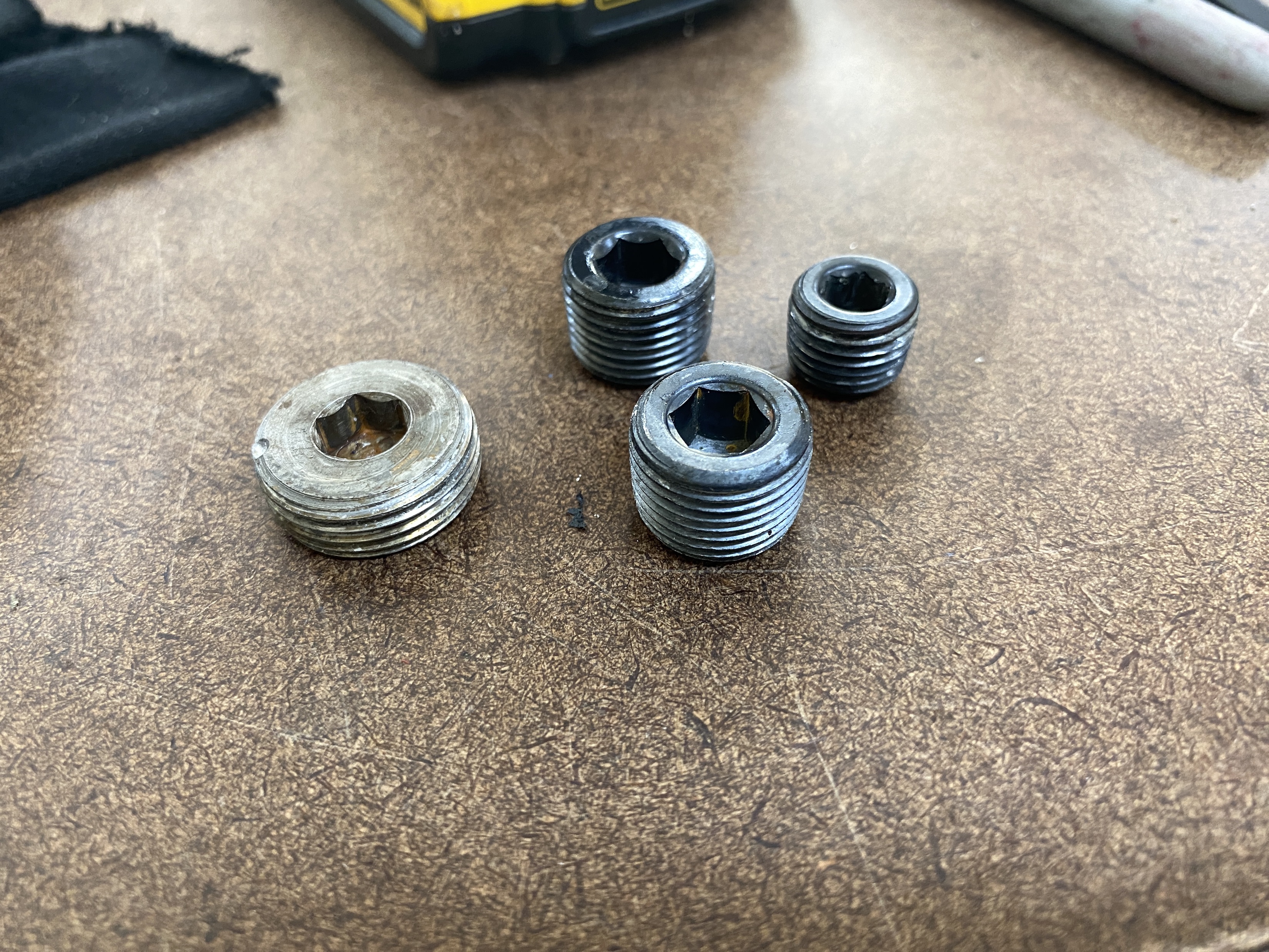

Step 2: clean the plugs.

Step 3: apply thread sealant.
bkrantz
post Jun 24 2023, 07:57 PM

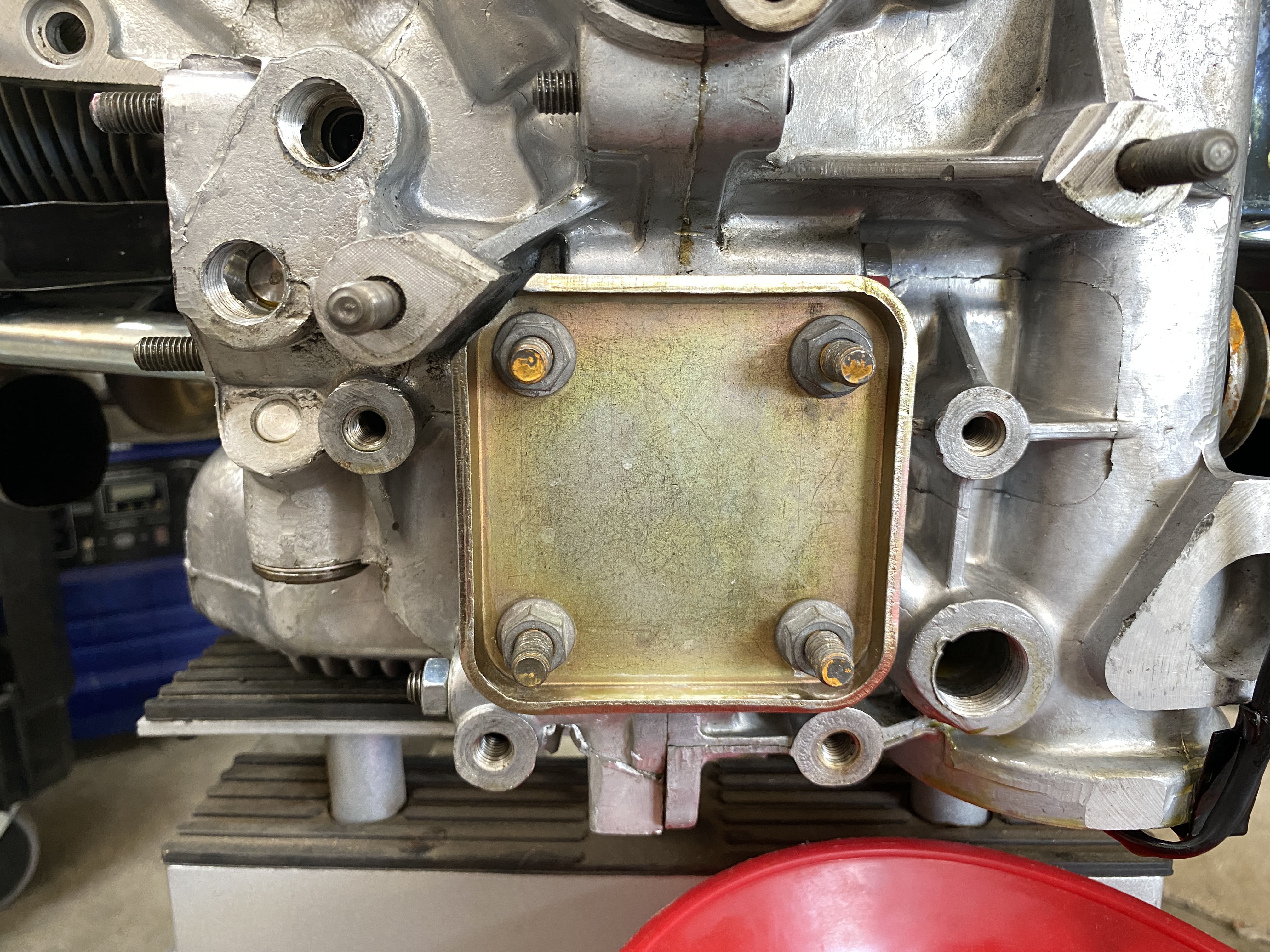

Step 4: insert plugs and make TIGHT.
bkrantz
post Jun 24 2023, 07:58 PM
Post #6550
Posts: 8,341
Joined: 3-August 19
From: SW Colorado
Member No.: 23,343
Including the plugs on the cooler casting boss.

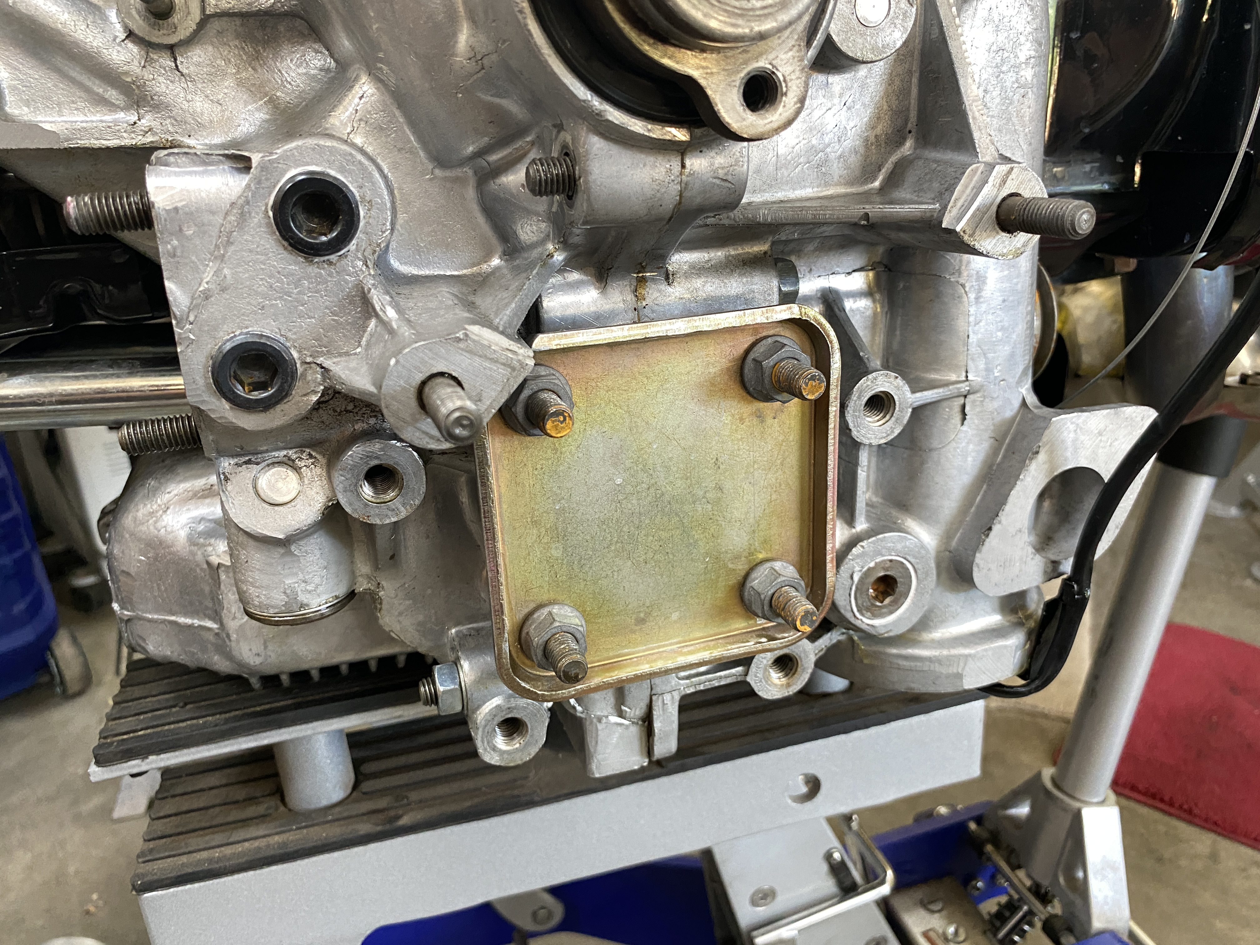

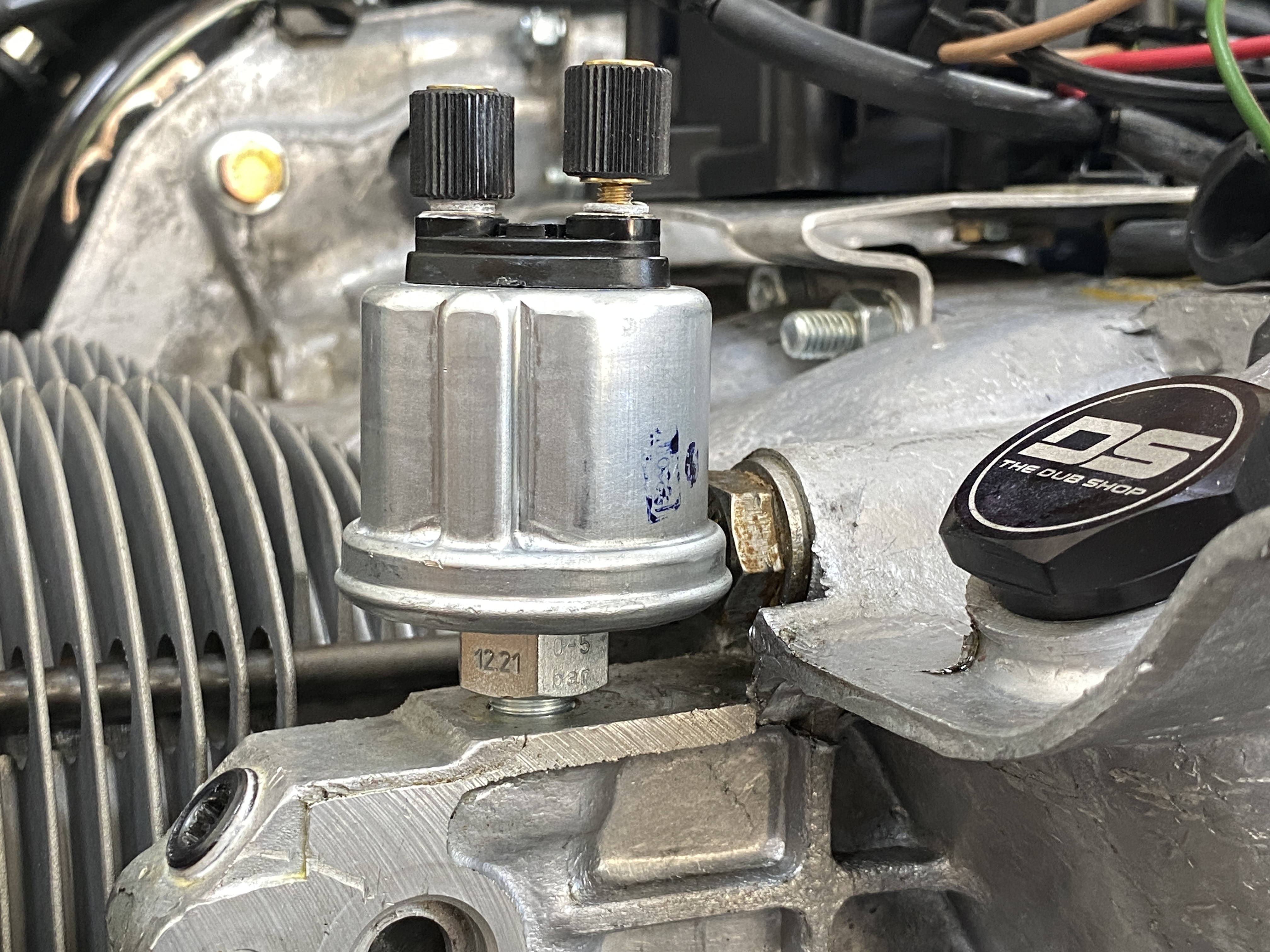

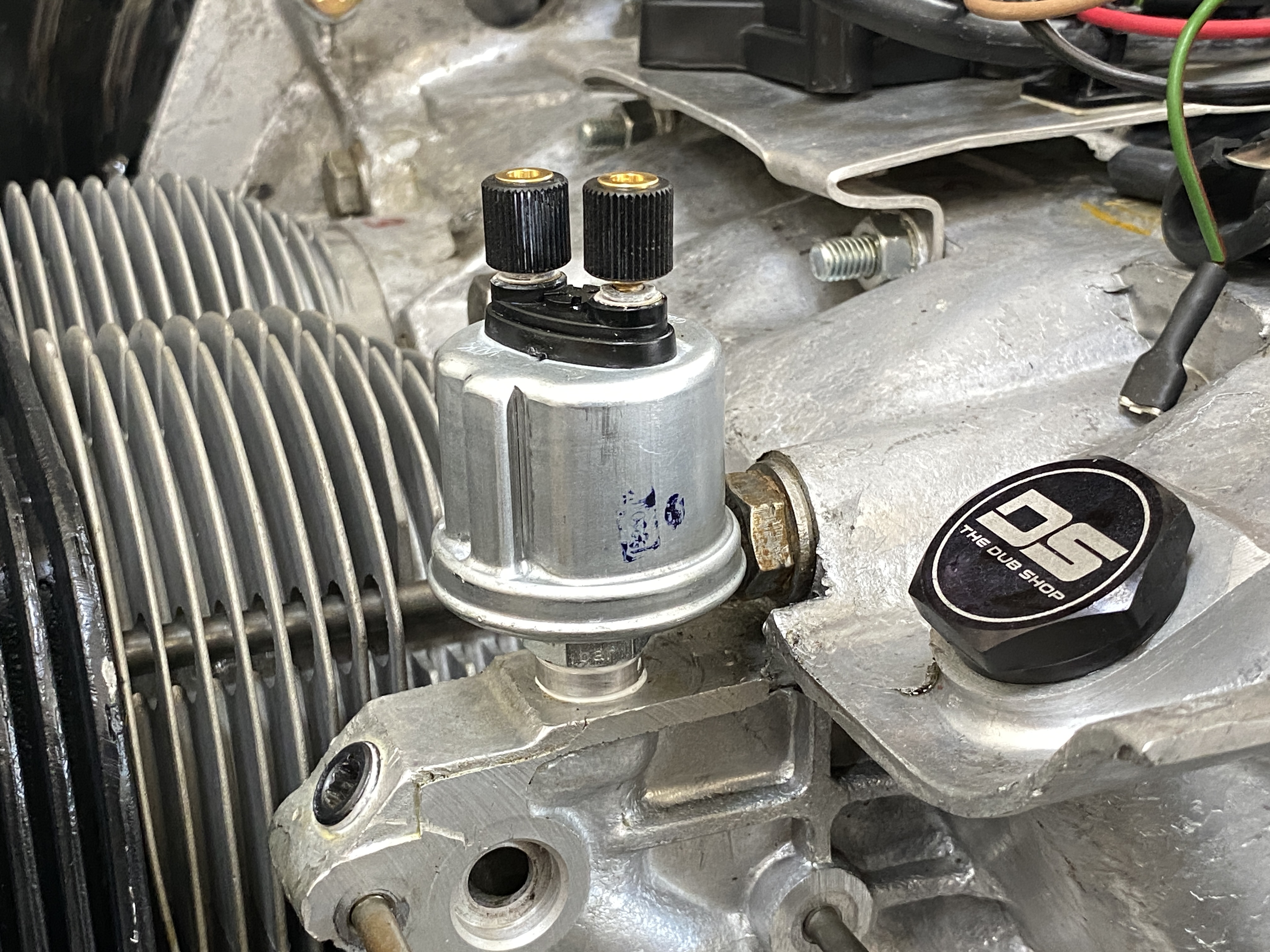

Now thinking about the oil pressure sender. I know there are options, but I am worried most about oil leaks now, so simple is better. I will mount the VDO sender directly to the case, and like with the "aggressive" idiot light.
In the future I might try something else so I can use the stock idiot light sender. I do feel nervous about any flexible hoses, and will keep thinking about options.

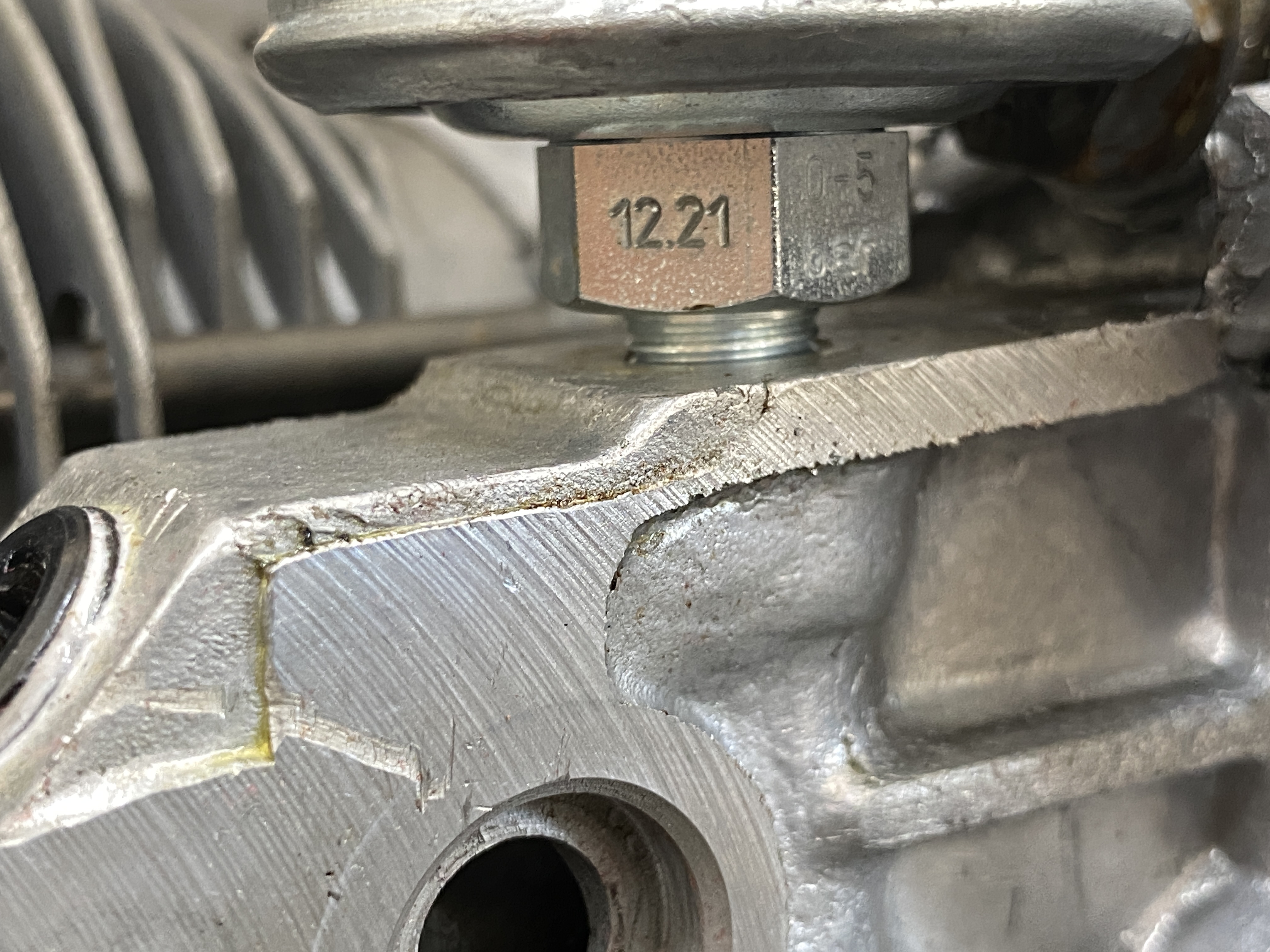

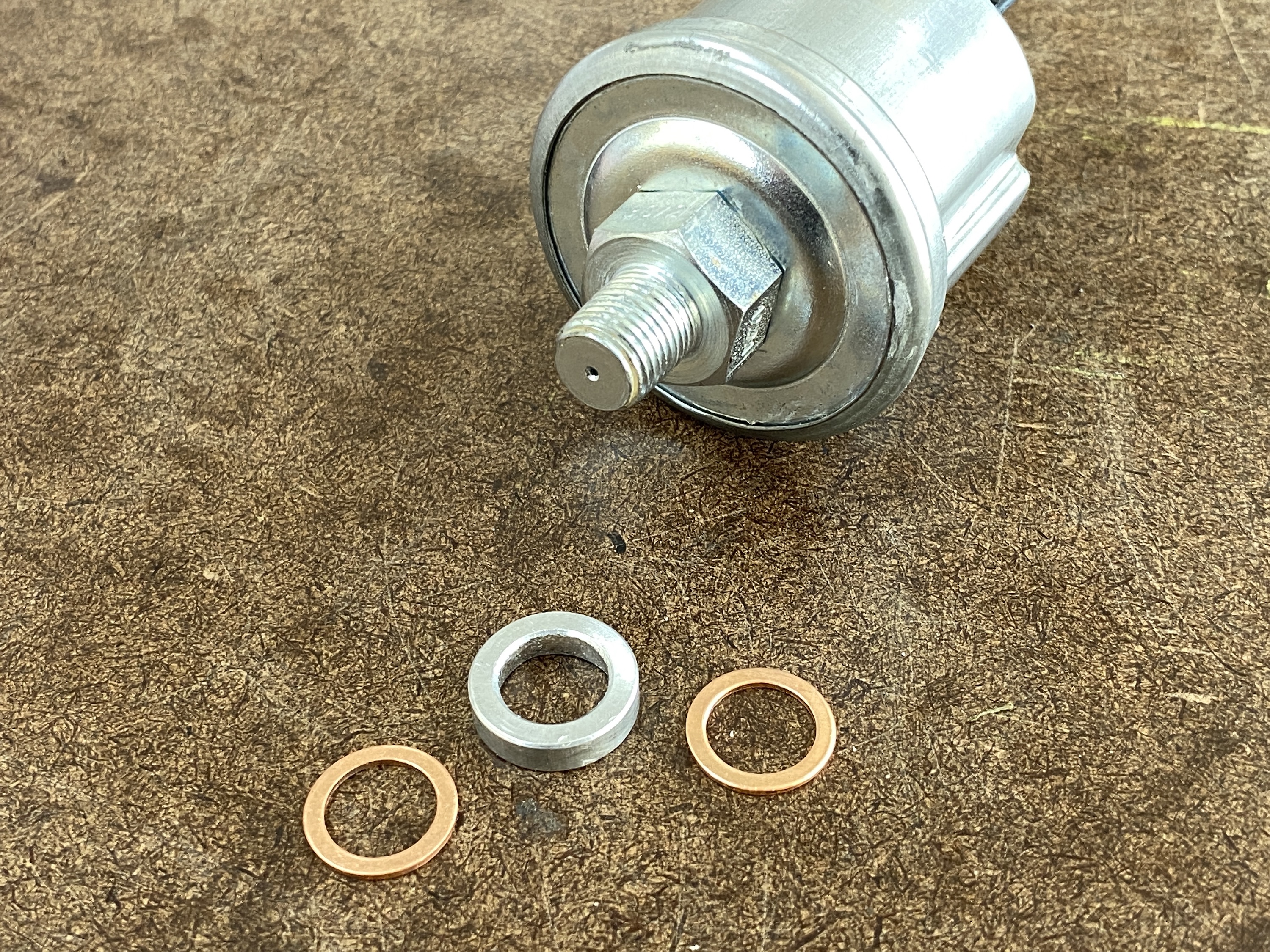

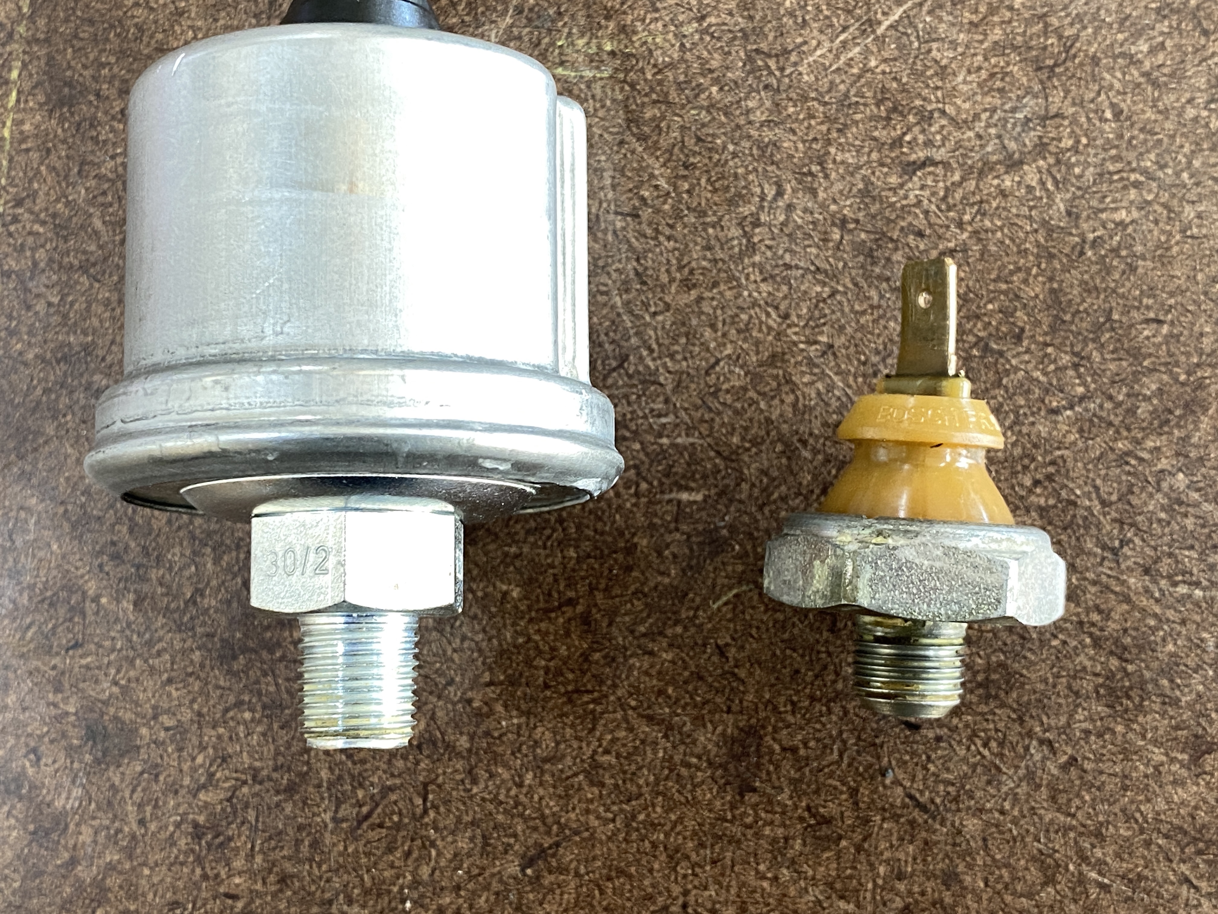

But the VDO threaded stud is longer than stock.
bkrantz
post Jun 24 2023, 08:07 PM
Post #6553
Posts: 8,341
Joined: 3-August 19
From: SW Colorado
Member No.: 23,343
And the VDO sender bottoms out in the case hole.
bkrantz
post Jun 24 2023, 08:09 PM
Post #6554
Posts: 8,341
Joined: 3-August 19
From: SW Colorado
Member No.: 23,343
I rummaged through my miscellaneous hardware and found an aluminum M10 spacer. That plus a pair of copper washers should do it.

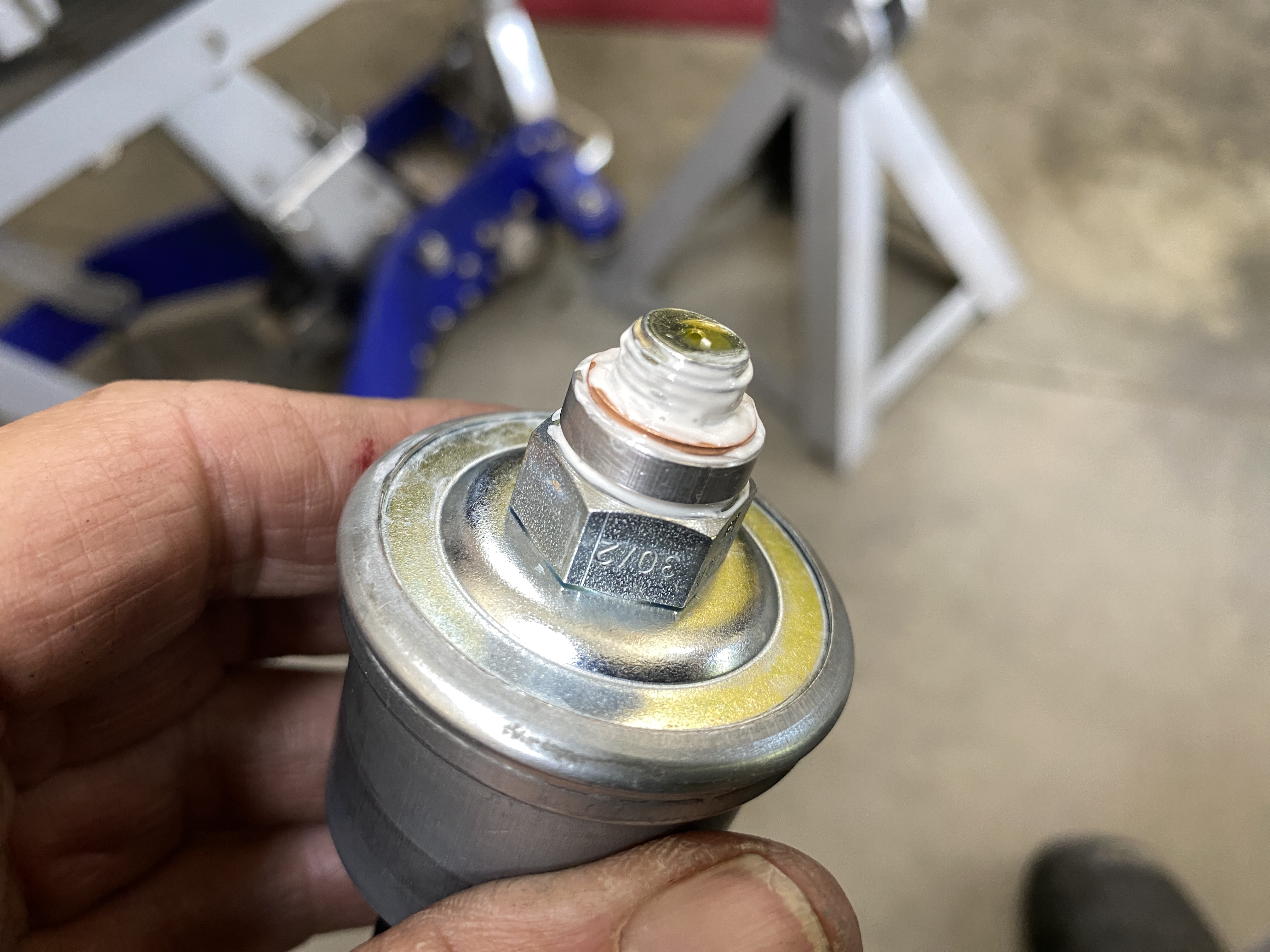

bkrantz
post Jun 24 2023, 08:10 PM
Post #6555
Posts: 8,341
Joined: 3-August 19
From: SW Colorado
Member No.: 23,343
Plus a bit of thread sealant.
bkrantz
post Jun 24 2023, 08:11 PM
Post #6556
Posts: 8,341
Joined: 3-August 19
From: SW Colorado
Member No.: 23,343
I sure hope this cures the worst leak I had.

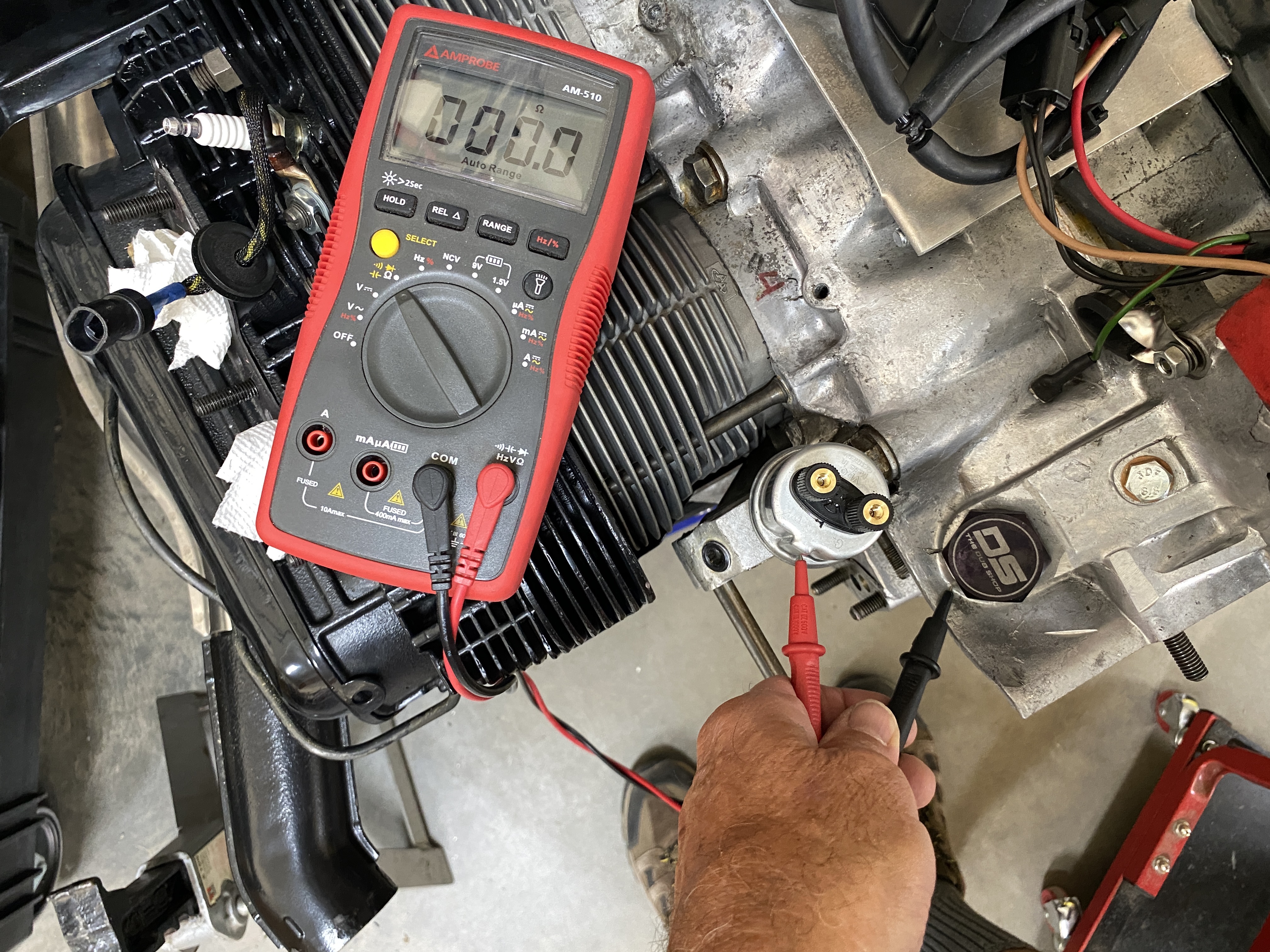

A quick check on electrical conductivity--looks good.

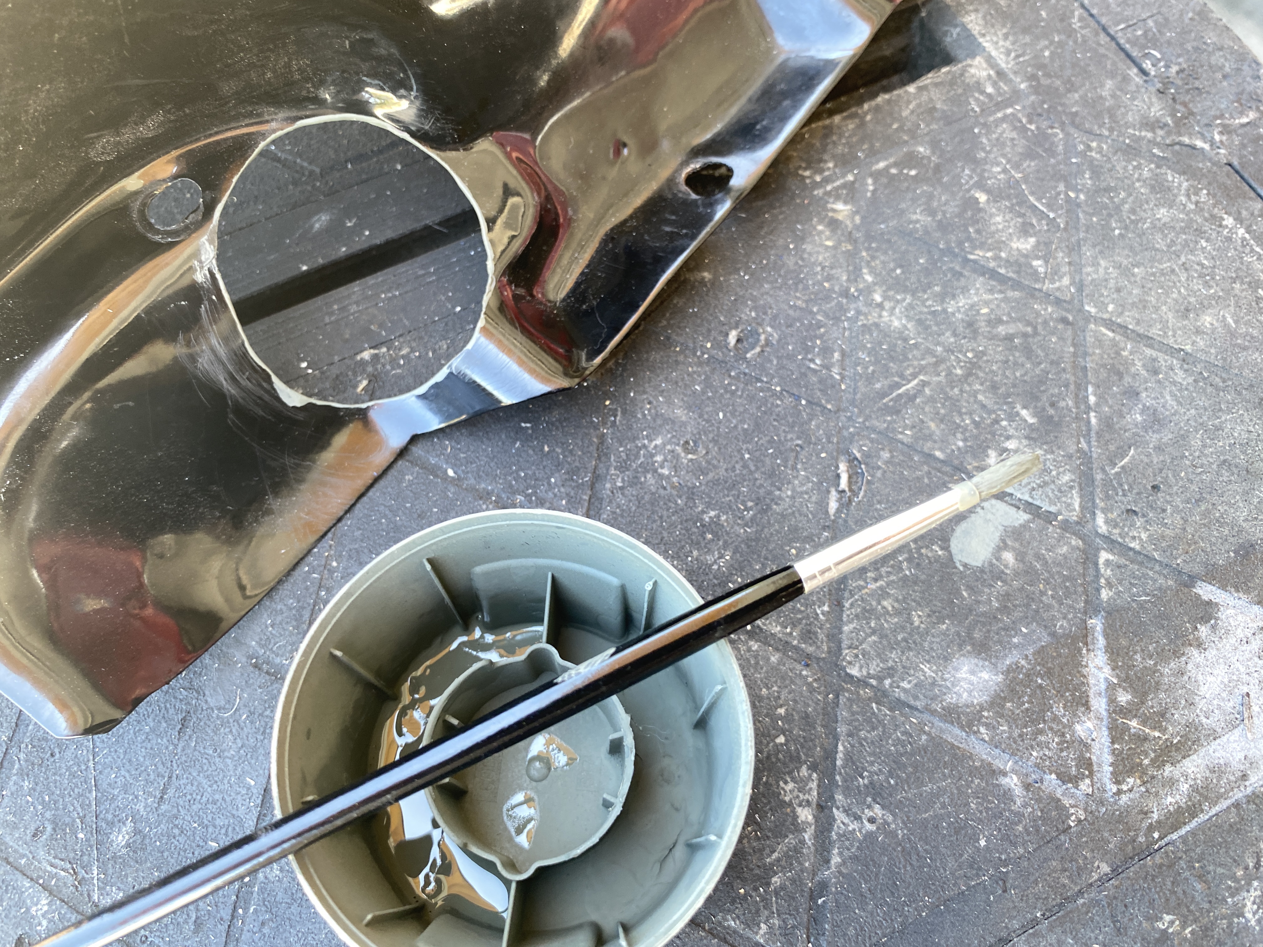

One more thing. The stock sheet metal hole will not clear the VDO sender.

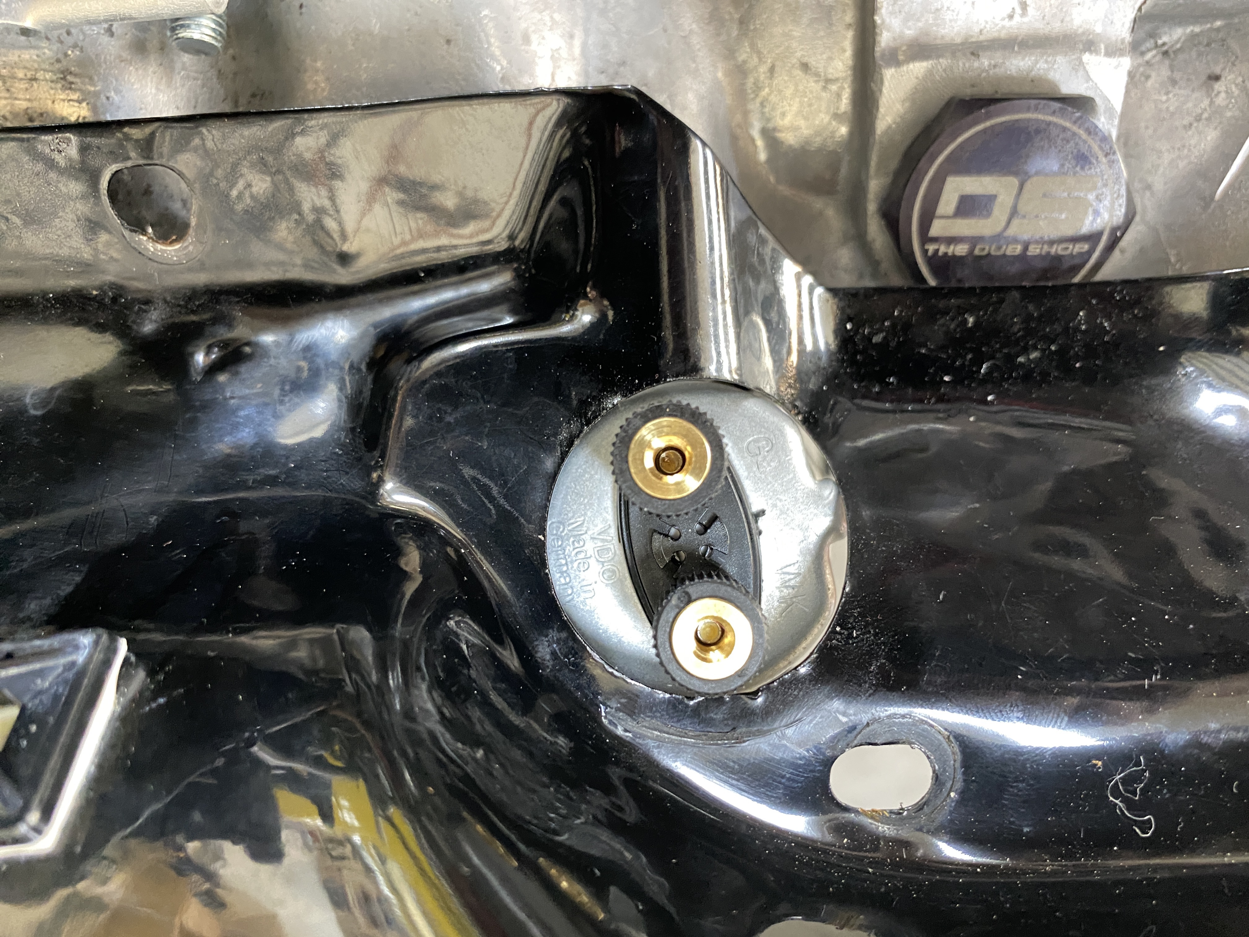

Member No.: 23,343

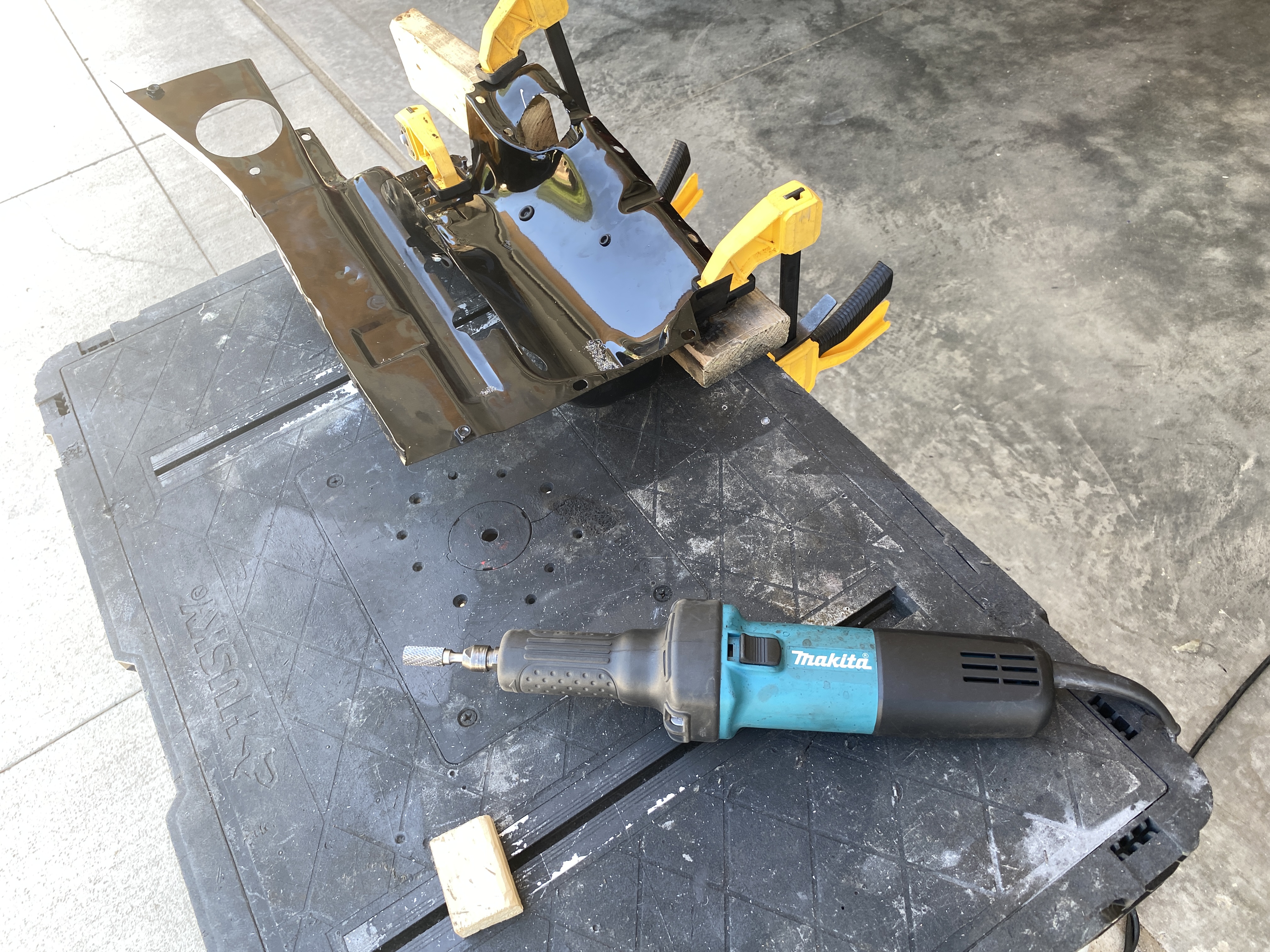

I got out my die grinder for the first time since working on the body in 2021.
bkrantz
post Jun 24 2023, 08:17 PM
Post #6560
Posts: 8,341
Joined: 3-August 19
From: SW Colorado
Member No.: 23,343
I painted the raw edges (primer and black). The rest of it is still powder-coated.
