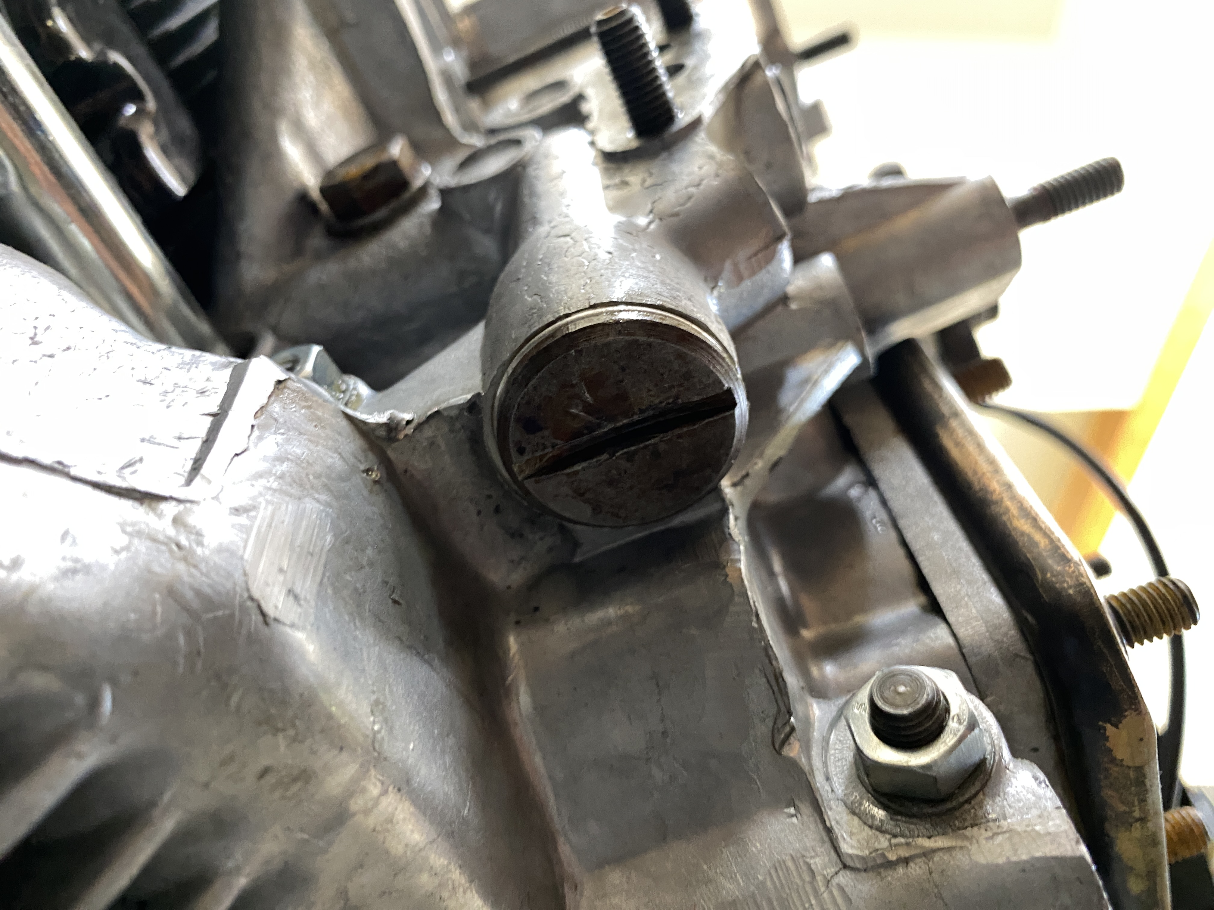

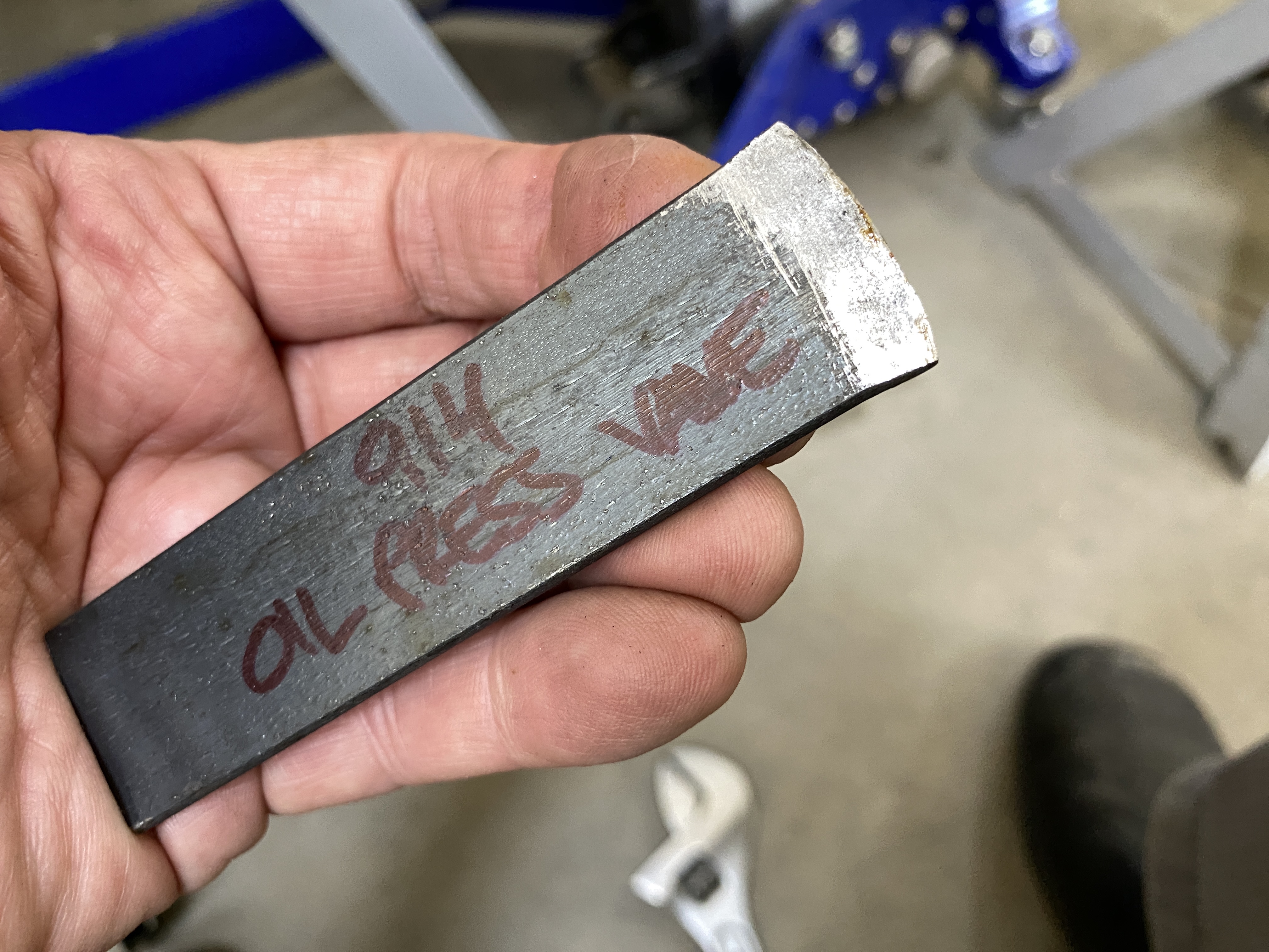

Mini-marathon today to see if I can get everything back on the motor and be ready for putting in back in the car.
I remembered to check the tightness of the oil pressure release valve cap.
bkrantz
post Jun 25 2023, 04:22 PM
Post #6564
Posts: 8,341
Joined: 3-August 19
From: SW Colorado
Member No.: 23,343
That means I get to use my special tool. I was able to tighten the cap about1/4 turn. Maybe another leak?

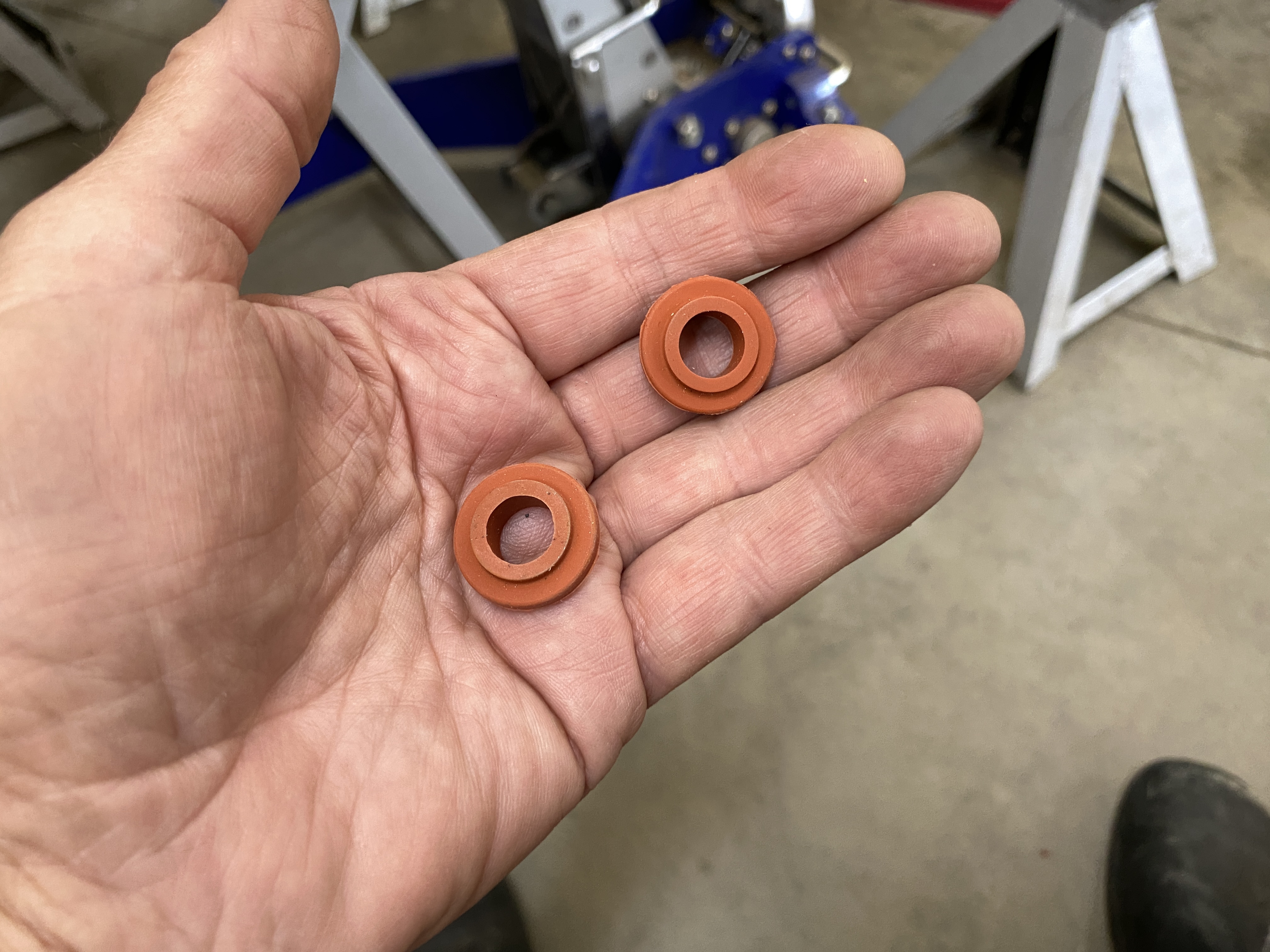

Then the oil cooler, with new seals.
bkrantz
post Jun 25 2023, 04:24 PM
Post #6566
Posts: 8,341
Joined: 3-August 19
From: SW Colorado
Member No.: 23,343
As is traditional, a dab of grease to hold them in place.

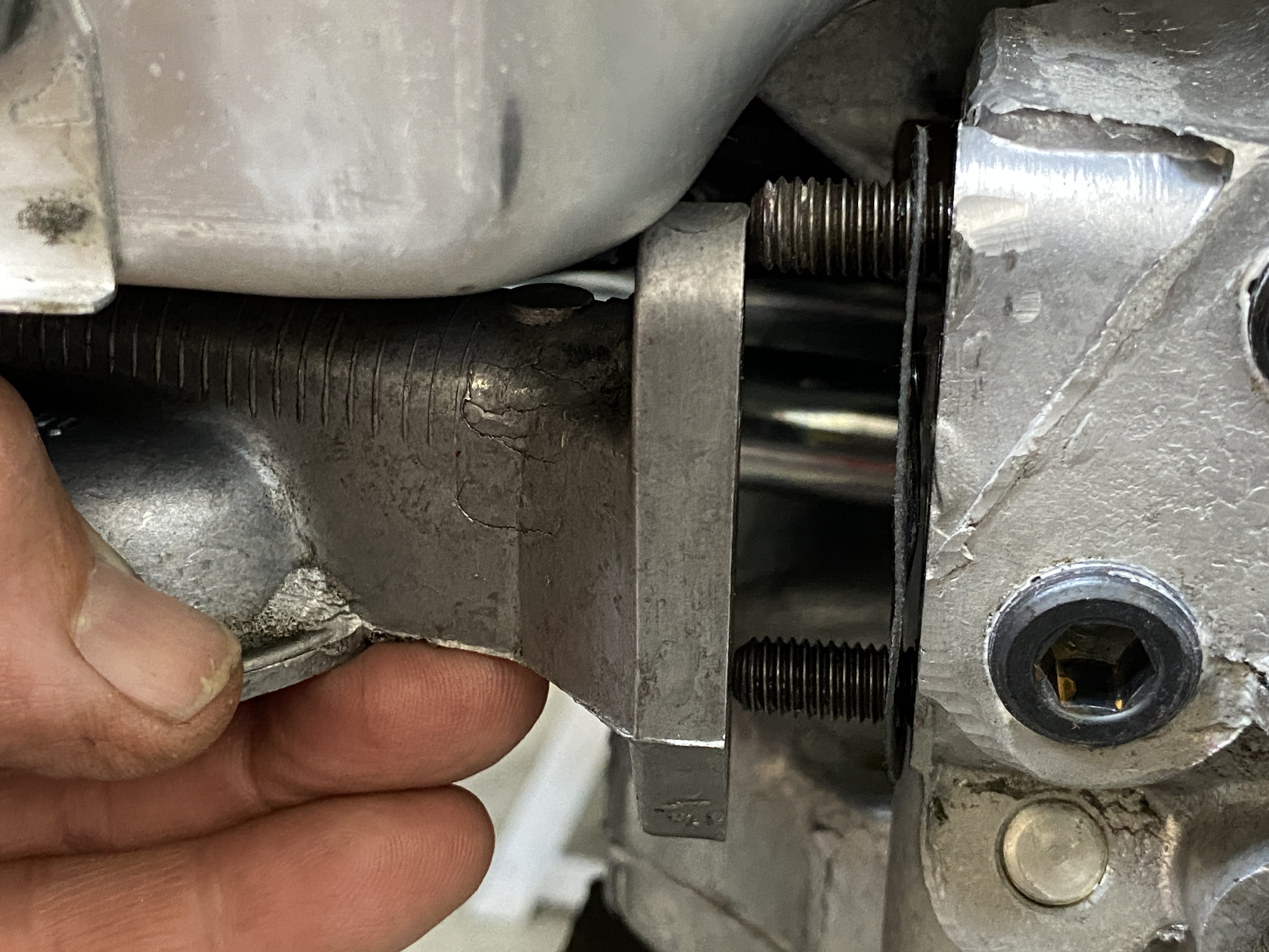

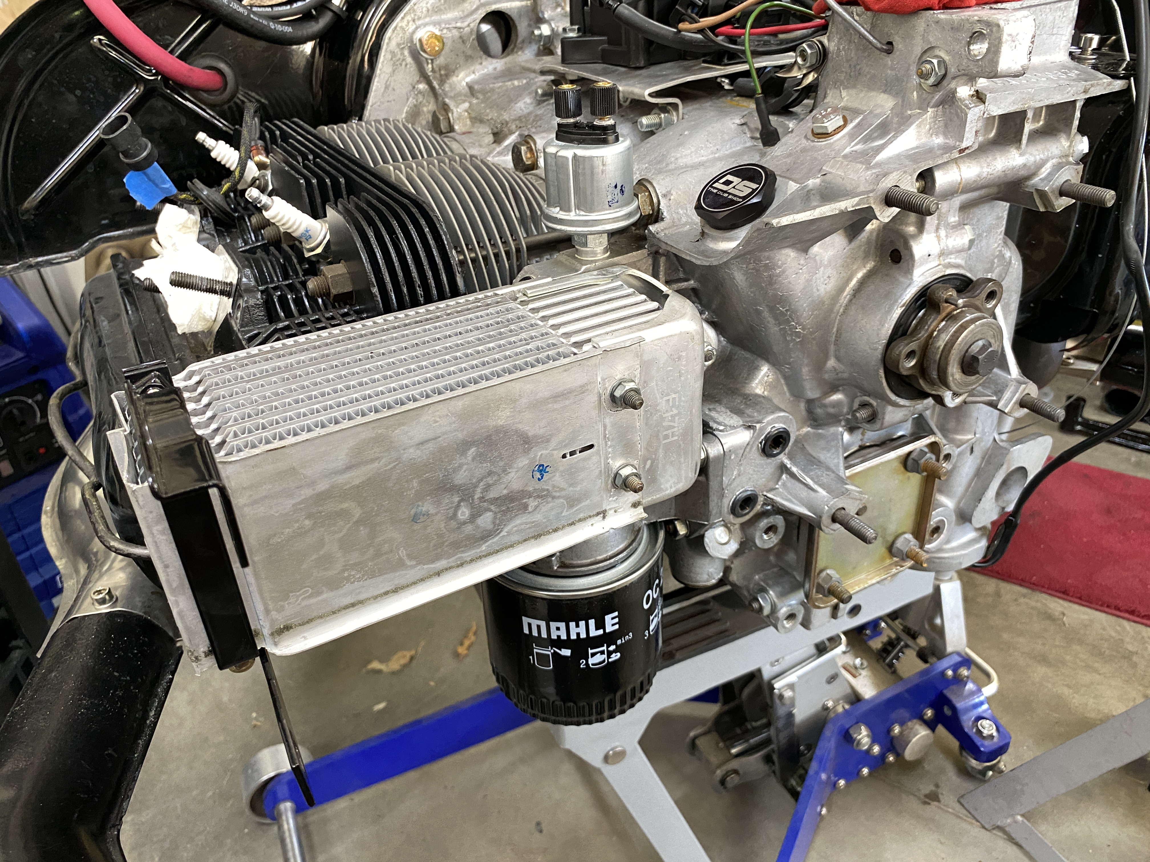

Cooler installed, but...
bkrantz
post Jun 25 2023, 04:25 PM
Post #6568
Posts: 8,341
Joined: 3-August 19
From: SW Colorado
Member No.: 23,343
Not enough clearance to bolt on the oil filter mount. Grrr.

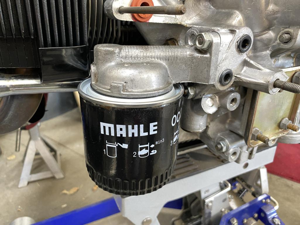

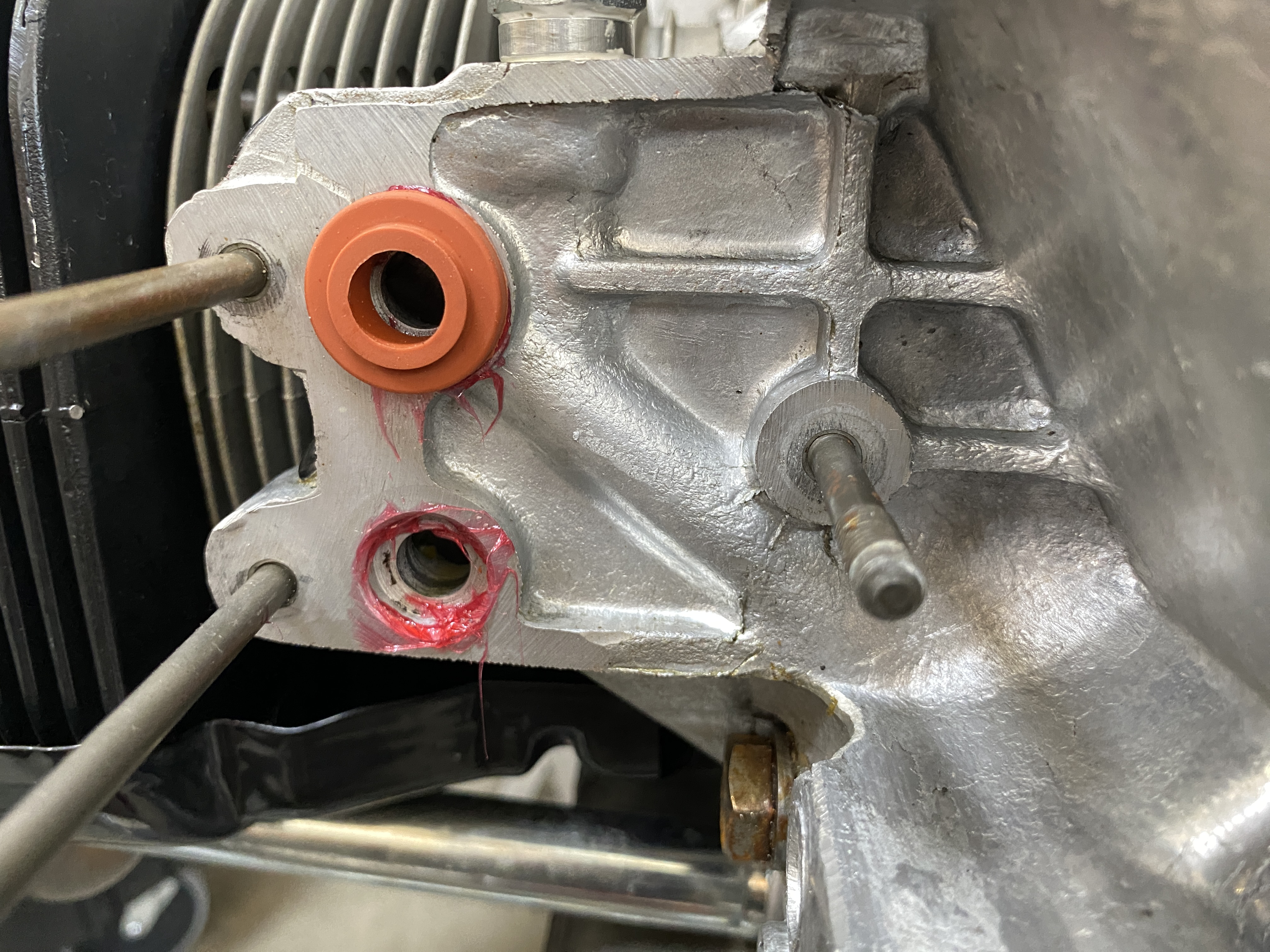

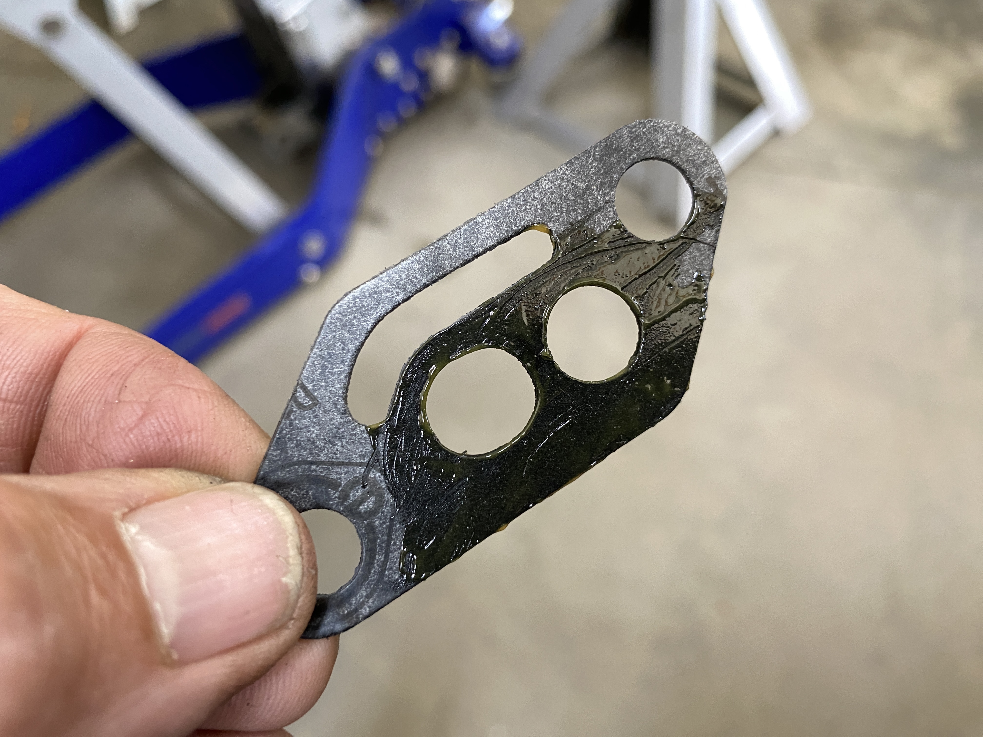

So, remove the oil cooler and give the new filter mount gasket a smear of sealant.
bkrantz
post Jun 25 2023, 04:28 PM
Post #6570
Posts: 8,341
Joined: 3-August 19
From: SW Colorado
Member No.: 23,343
And bolt on the mount with a new filter. BTW, I have used at least 4 filters since last summer. I think I am getting about 100 mpg (miles per filter).

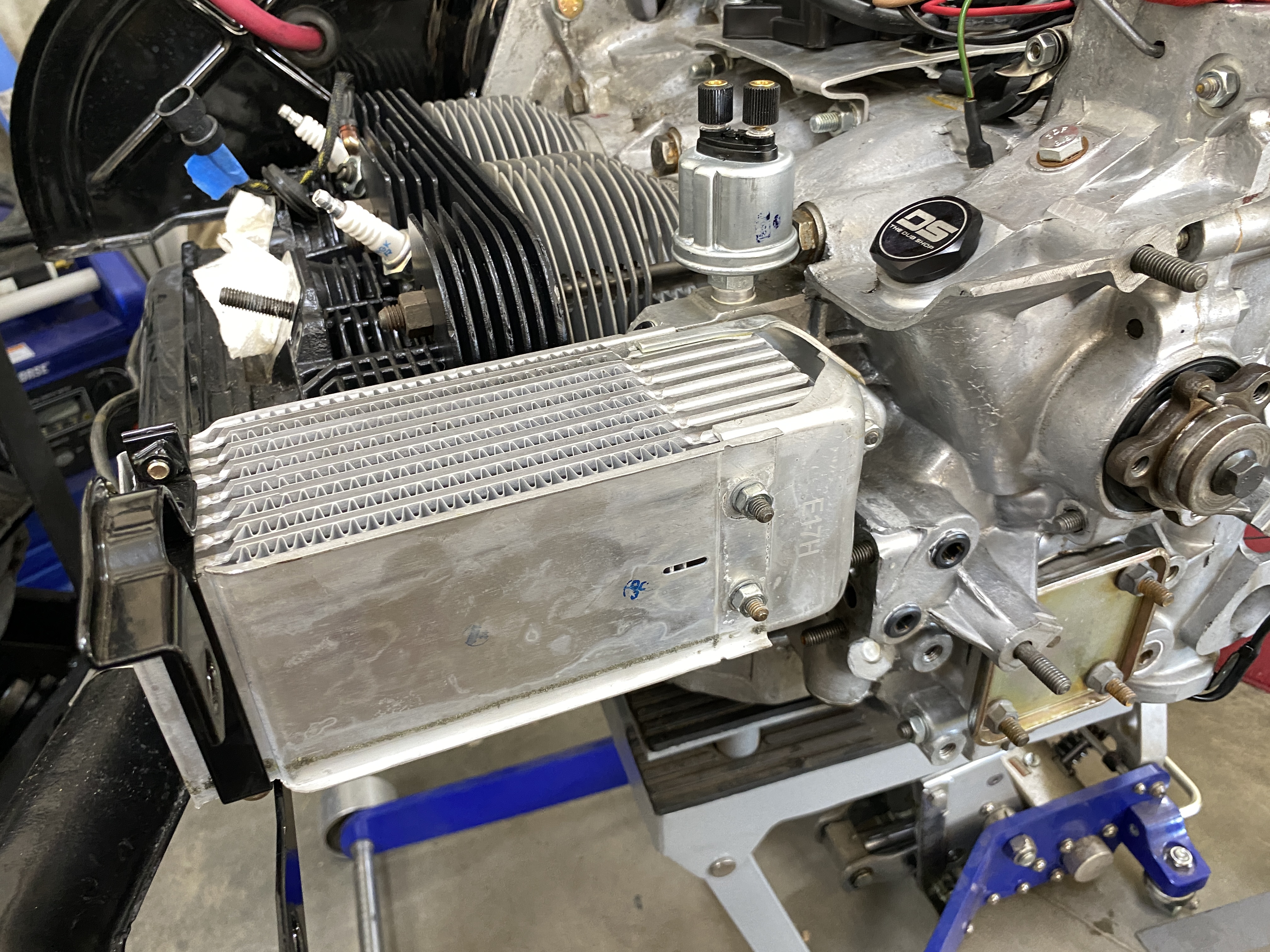

Cooler back on, and make double sure the seals are in place.

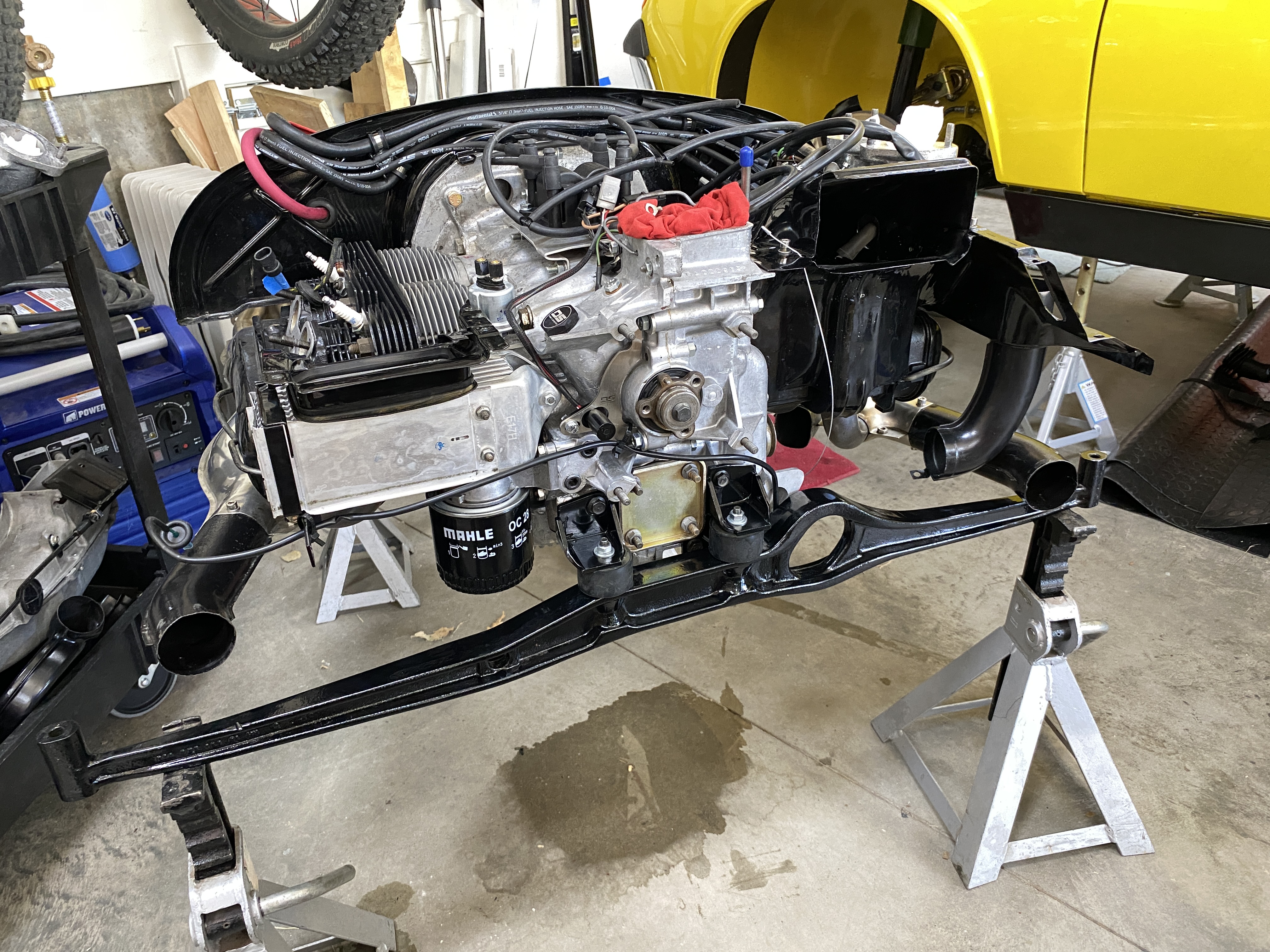

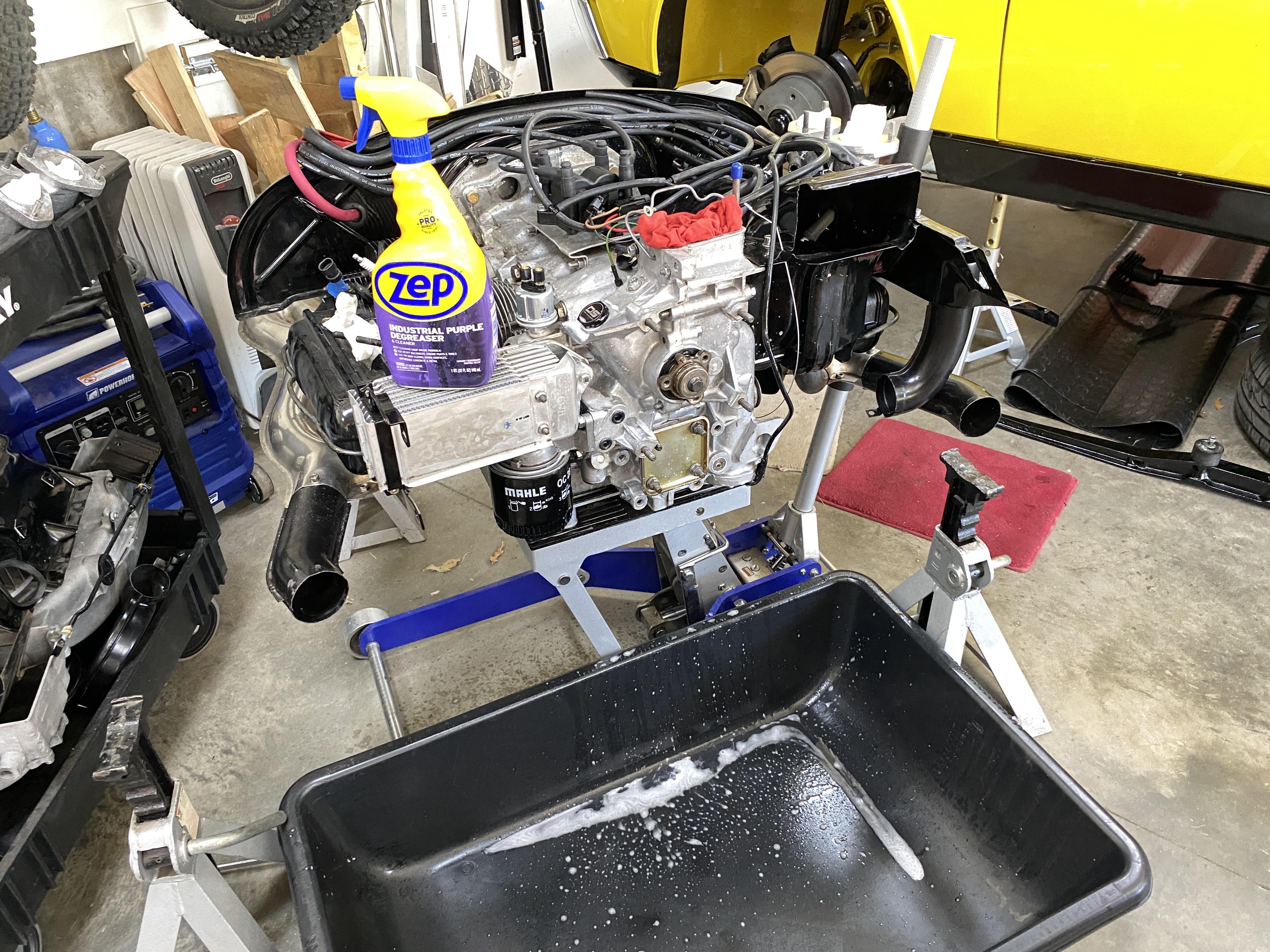

With everything closed up, I did another cleaning to remove any remaining oil spill residue.

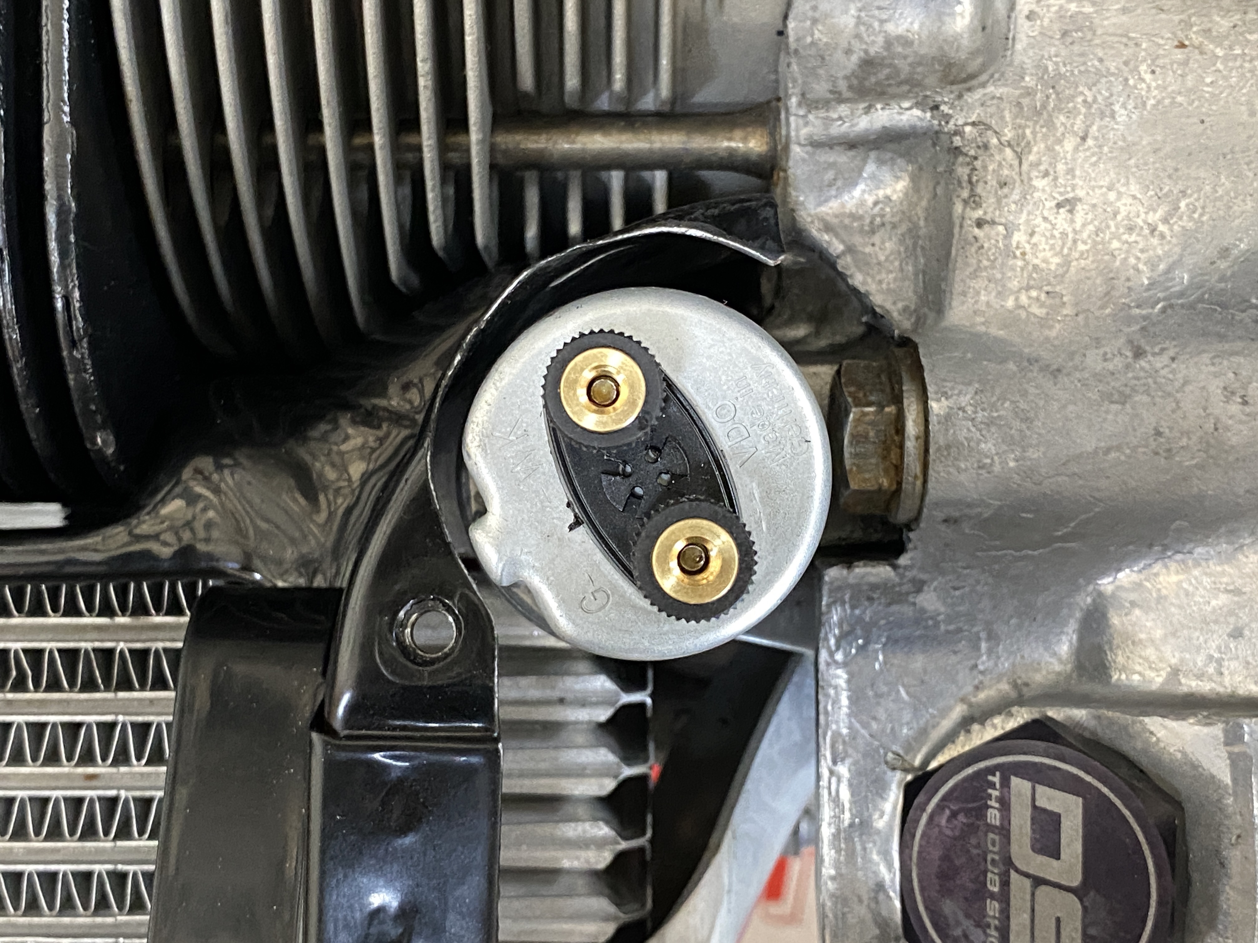

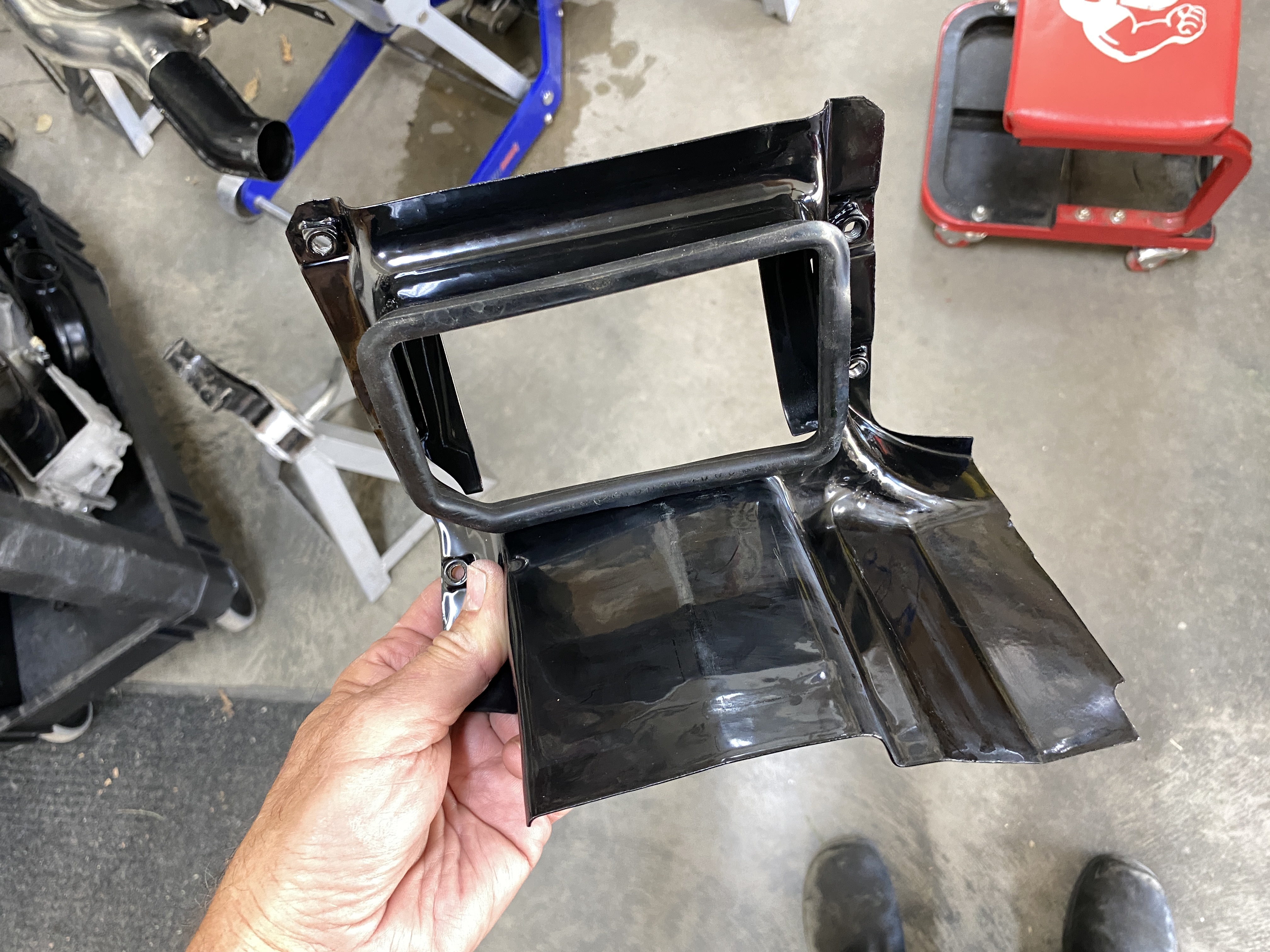

Time to start with sheet metal and other air cool system parts. Here's the baffle that mounts behind the oil cooler.
bkrantz
post Jun 25 2023, 04:33 PM
Post #6574
Posts: 8,341
Joined: 3-August 19
From: SW Colorado
Member No.: 23,343

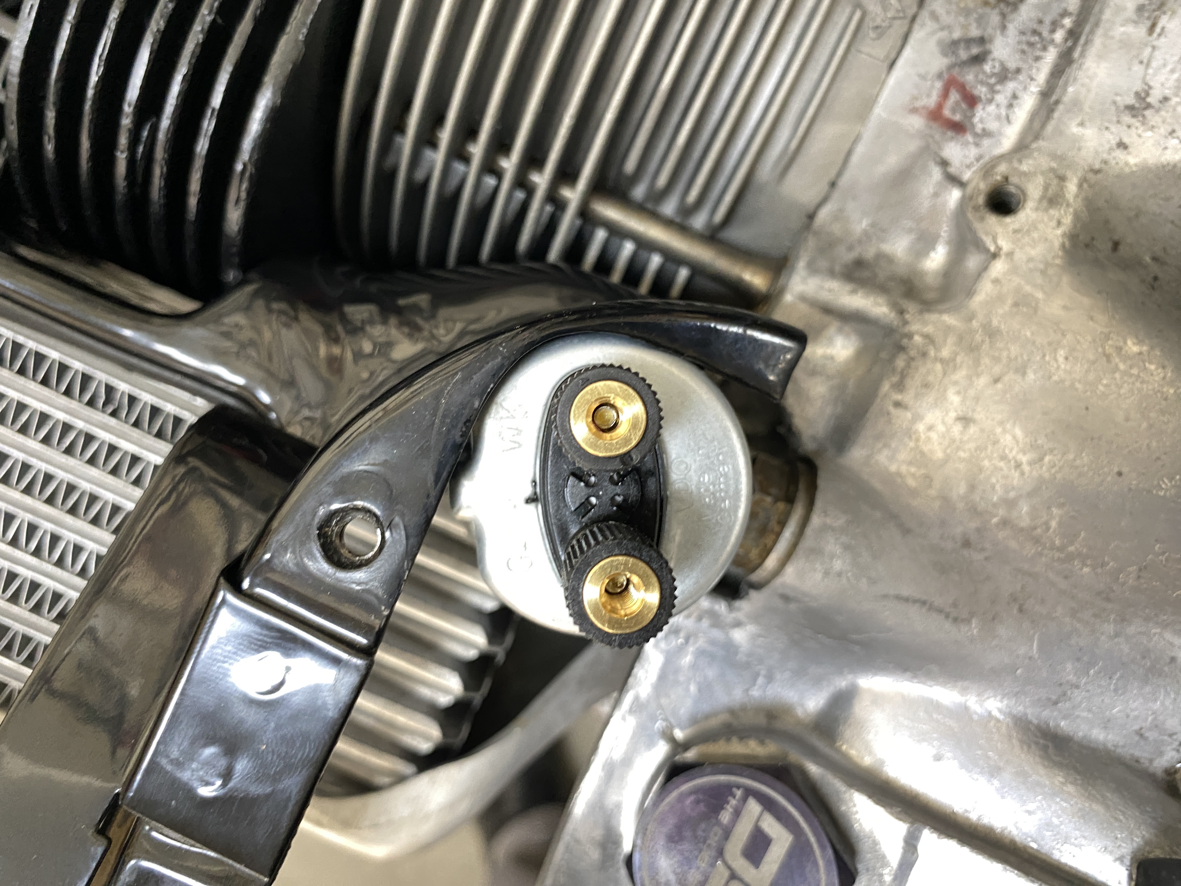

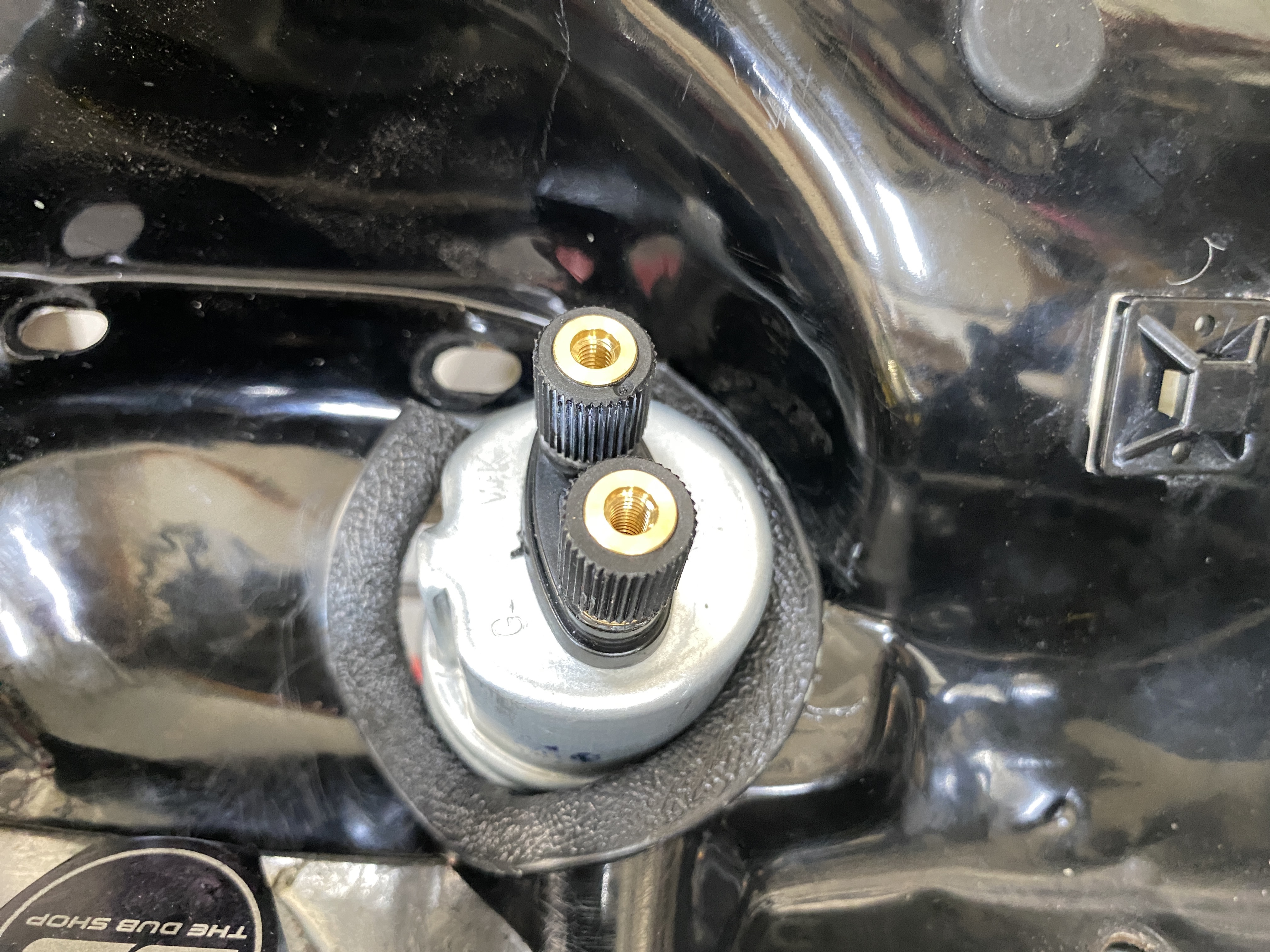

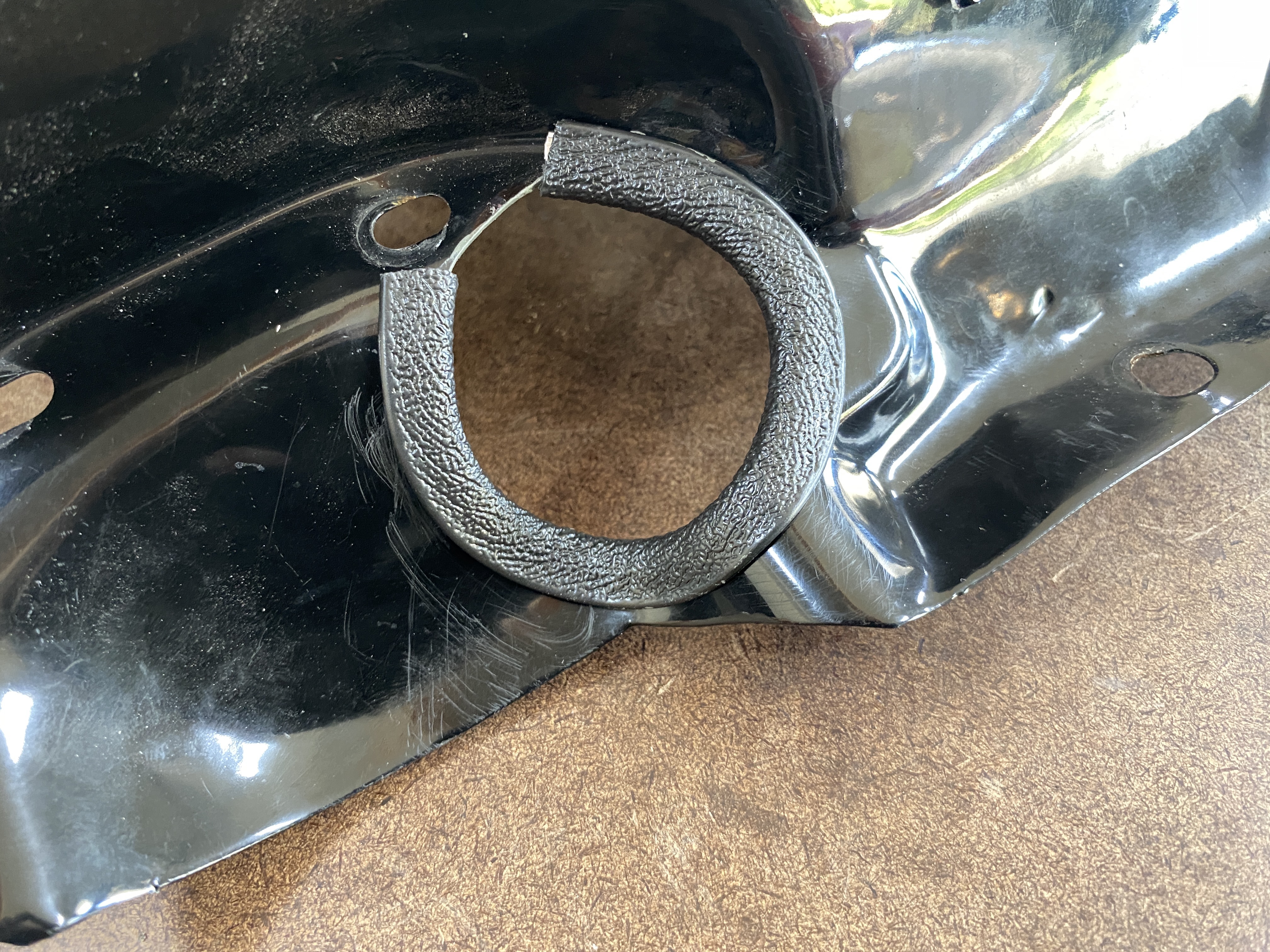

Uh-oh. This also does not clear the VDO pressure sender.
bkrantz
post Jun 25 2023, 04:35 PM
Post #6575
Posts: 8,341
Joined: 3-August 19
From: SW Colorado
Member No.: 23,343
Another 10 minutes with the die grinder and the hammer and dolly. This should work.

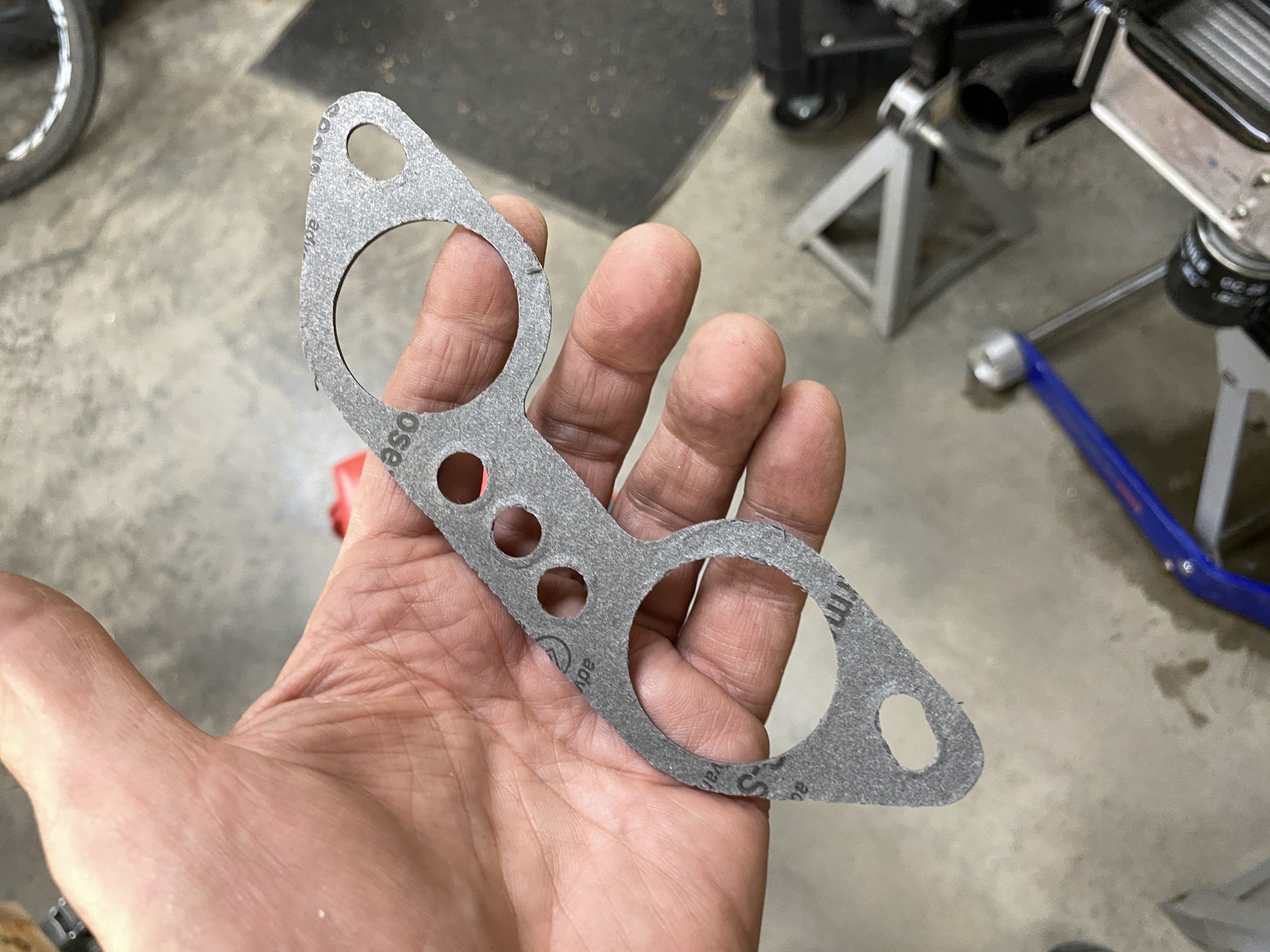

Before I forget, a new head gasket for the intake manifold. I like to install this before the sheet metal to make sure it sits on the head.

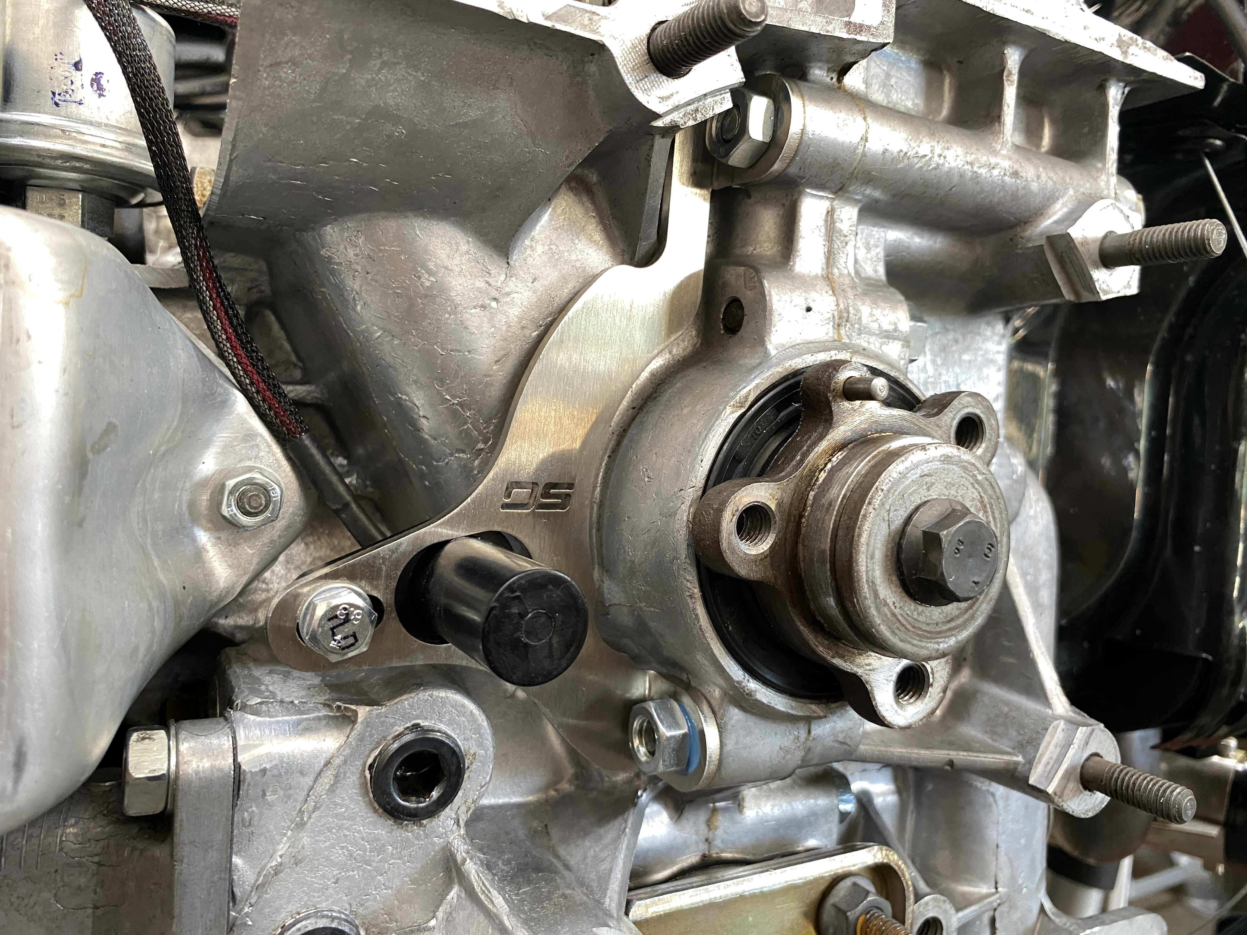

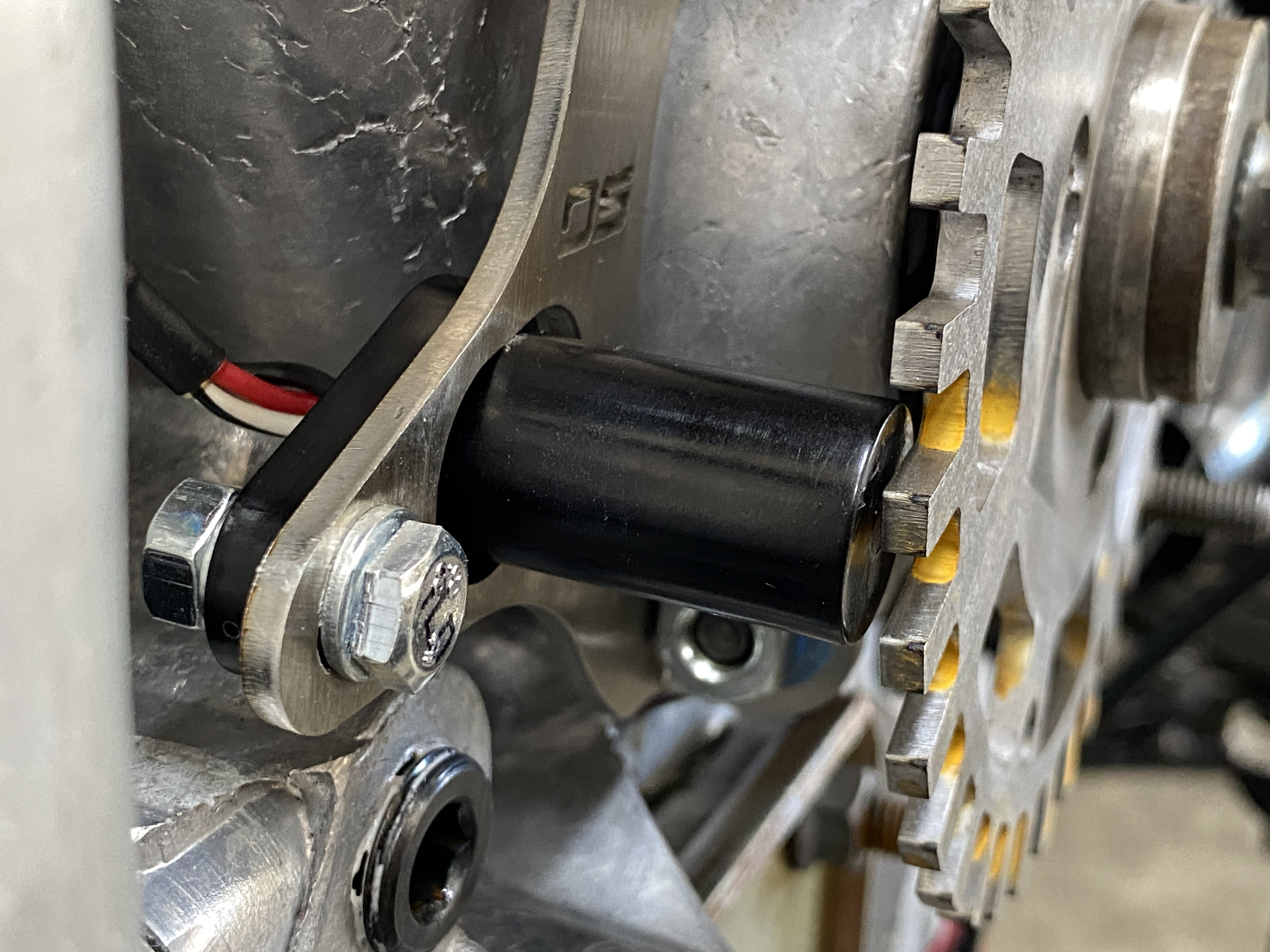

And another small thing: the Hall sensor and bracket.

Member No.: 23,343
Check the clearance with the trigger wheel.

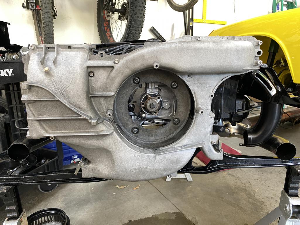

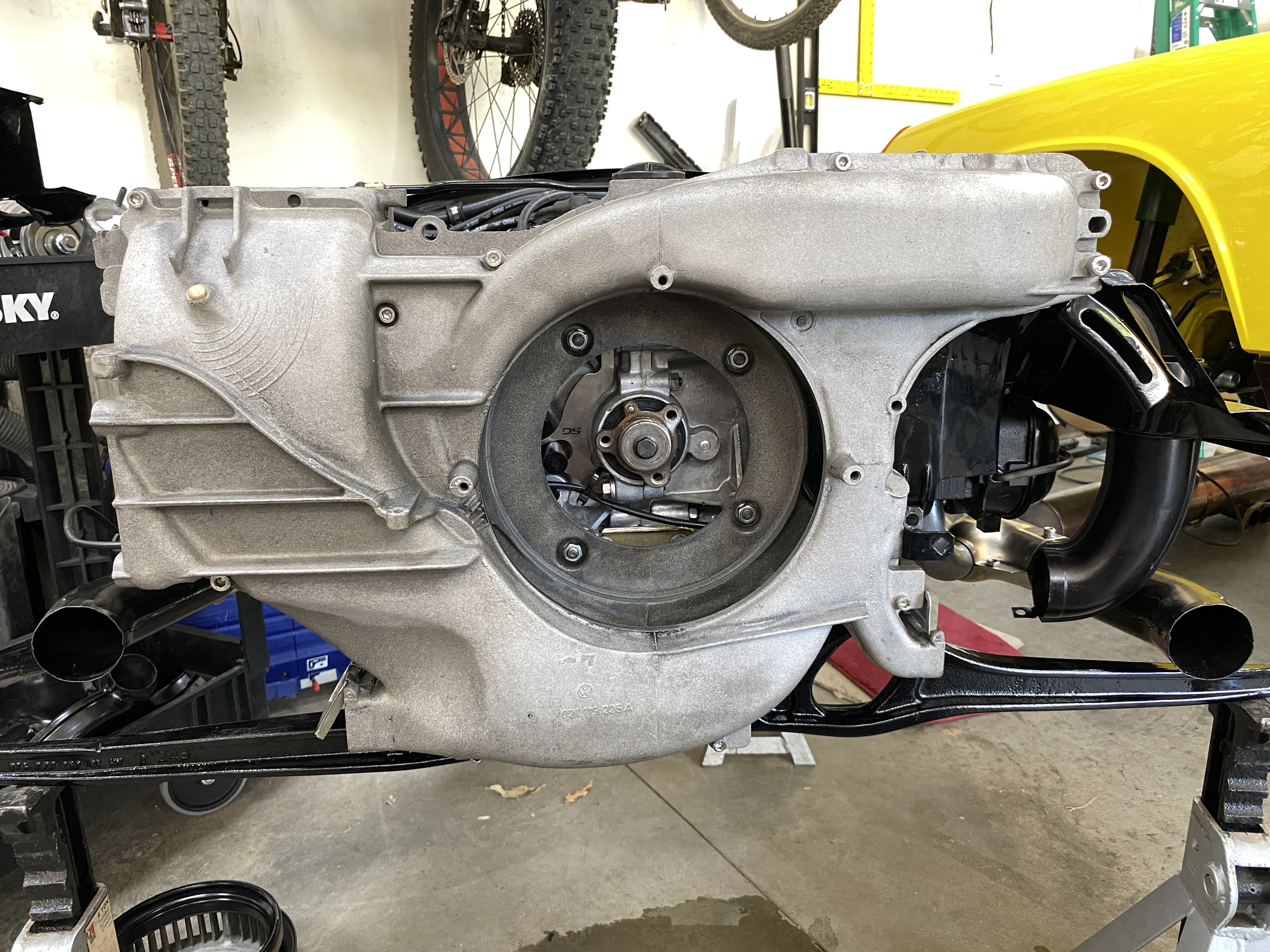

OK, with motor mounts and the cross bar, ready for the blower housing.
bkrantz
post Jun 25 2023, 04:40 PM
Post #6580
Posts: 8,341
Joined: 3-August 19
From: SW Colorado
Member No.: 23,343
Housing installed.
