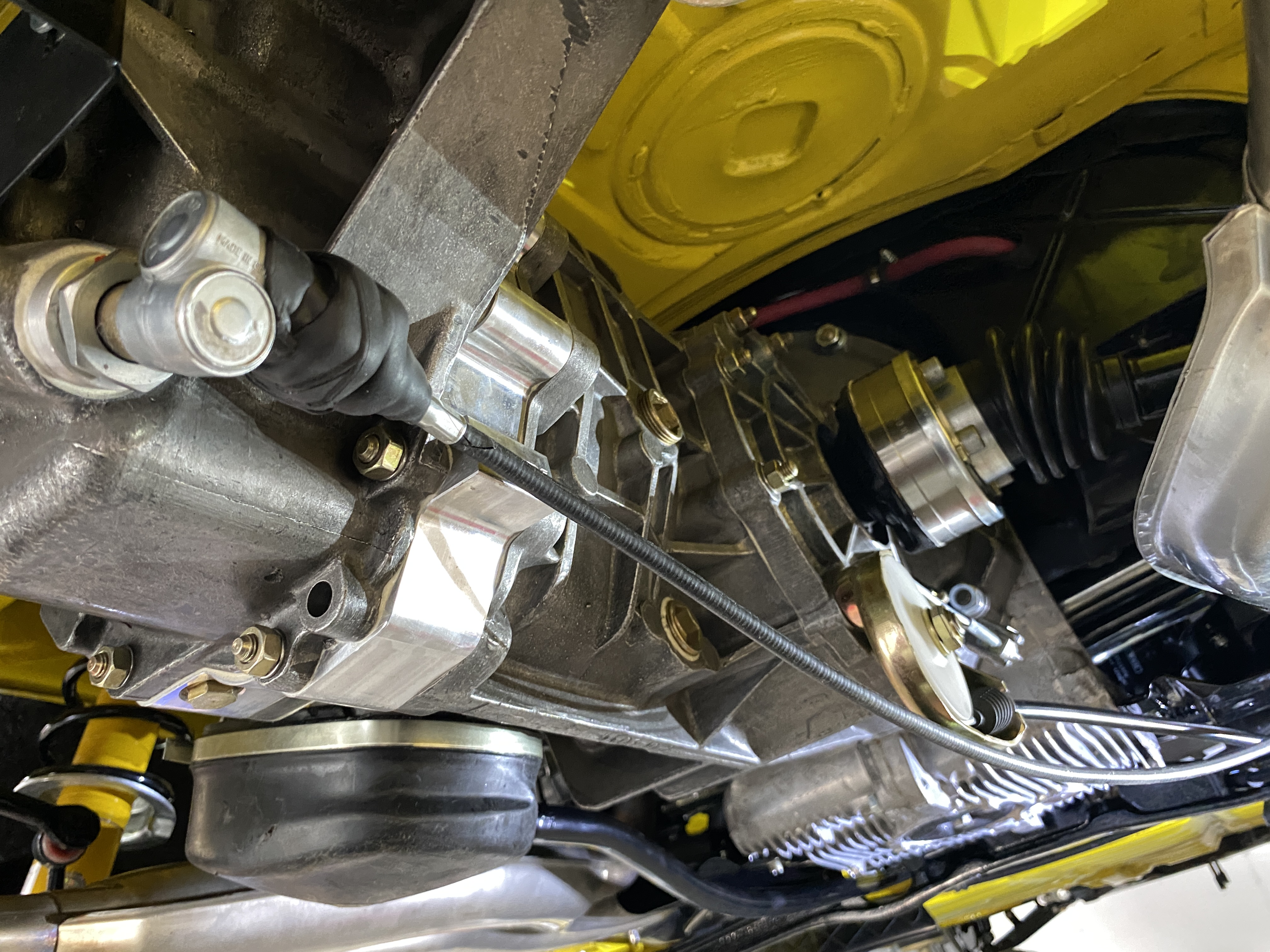

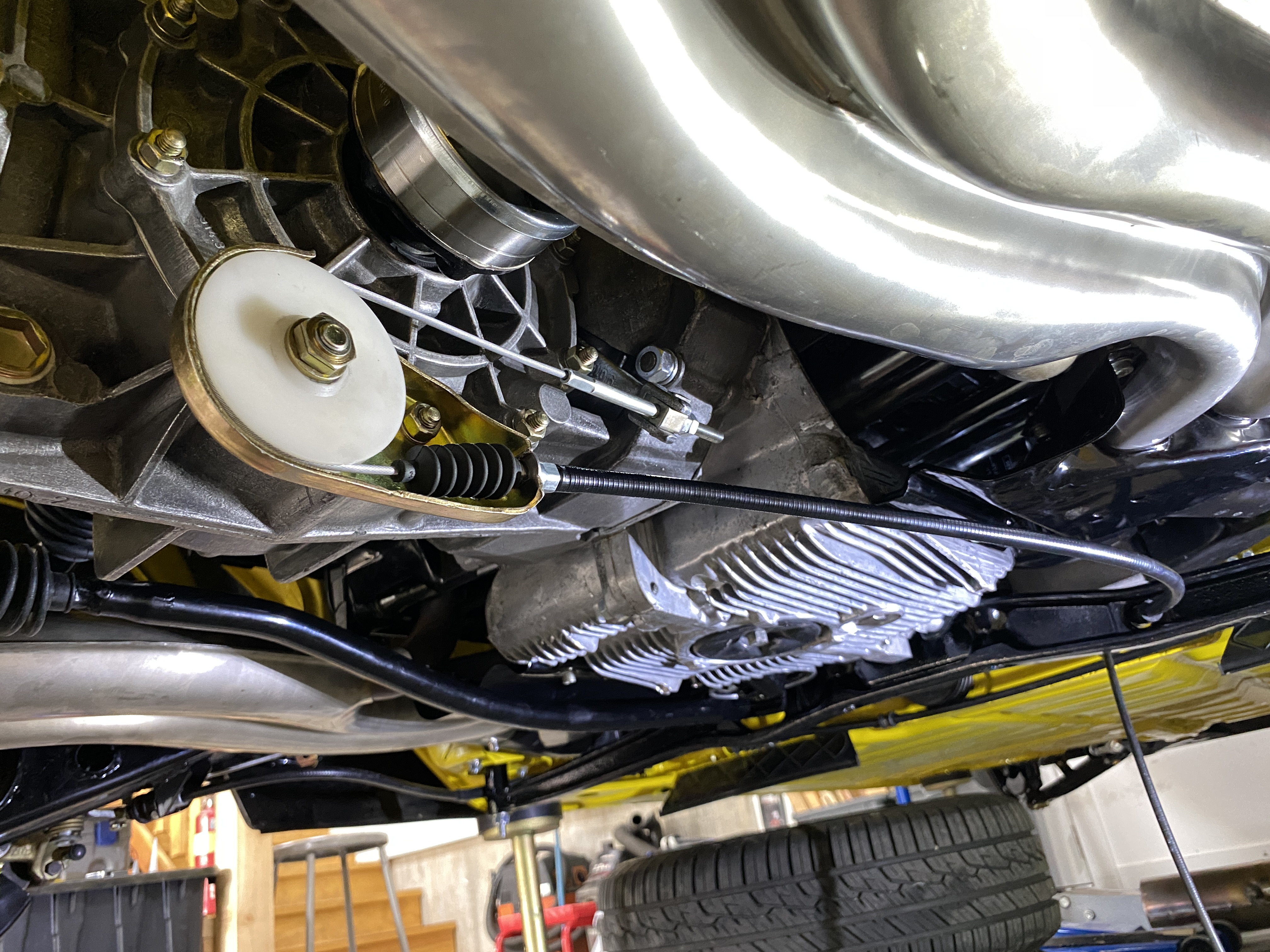

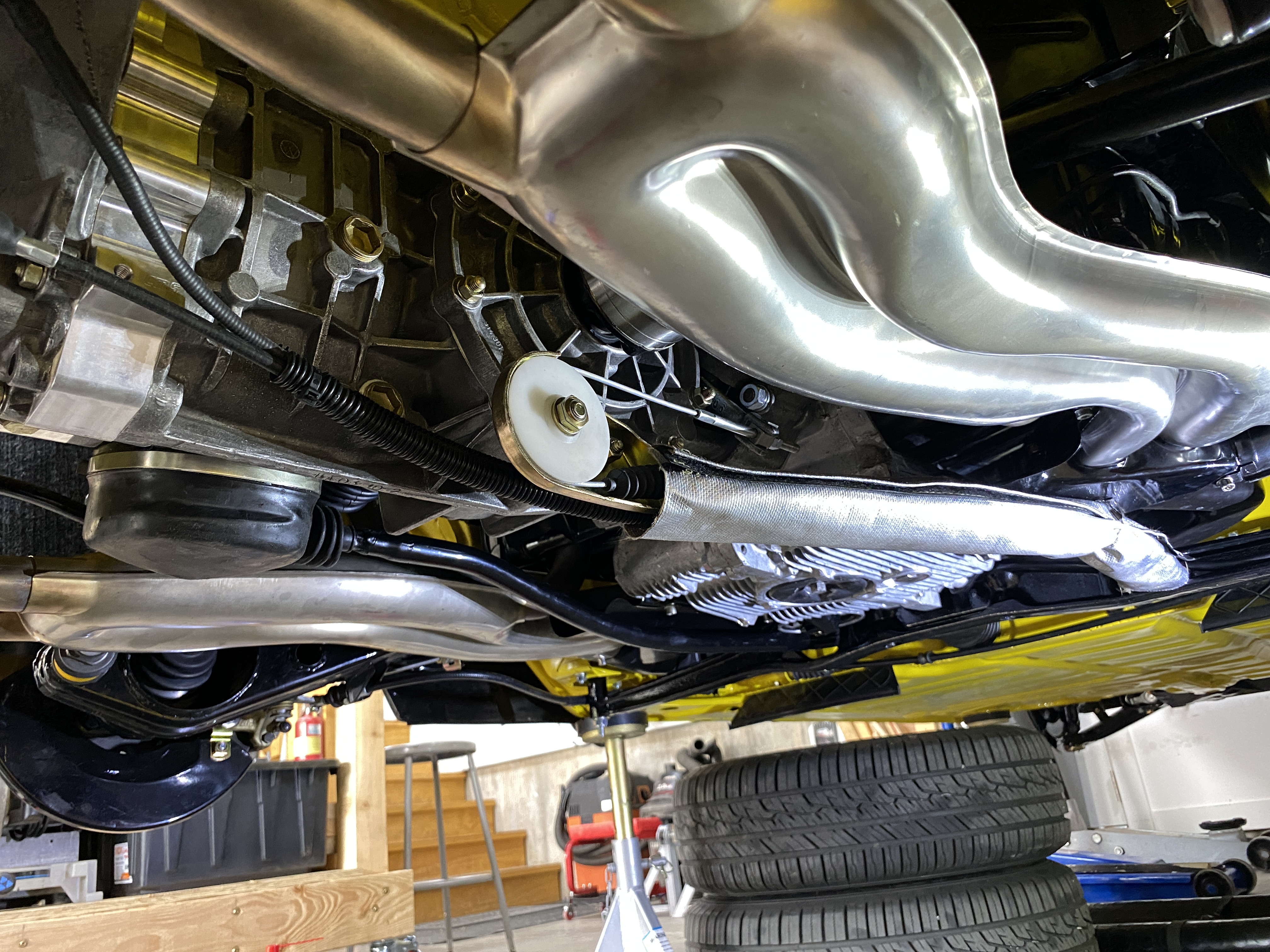

Clutch cable.
bkrantz
post Jun 26 2023, 07:13 PM
Post #6602
Posts: 8,341
Joined: 3-August 19
From: SW Colorado
Member No.: 23,343
Speedo cable, with a "boot" made from 3M rubber tape.
bkrantz
post Jun 26 2023, 07:14 PM
Post #6603
Posts: 8,341
Joined: 3-August 19
From: SW Colorado
Member No.: 23,343

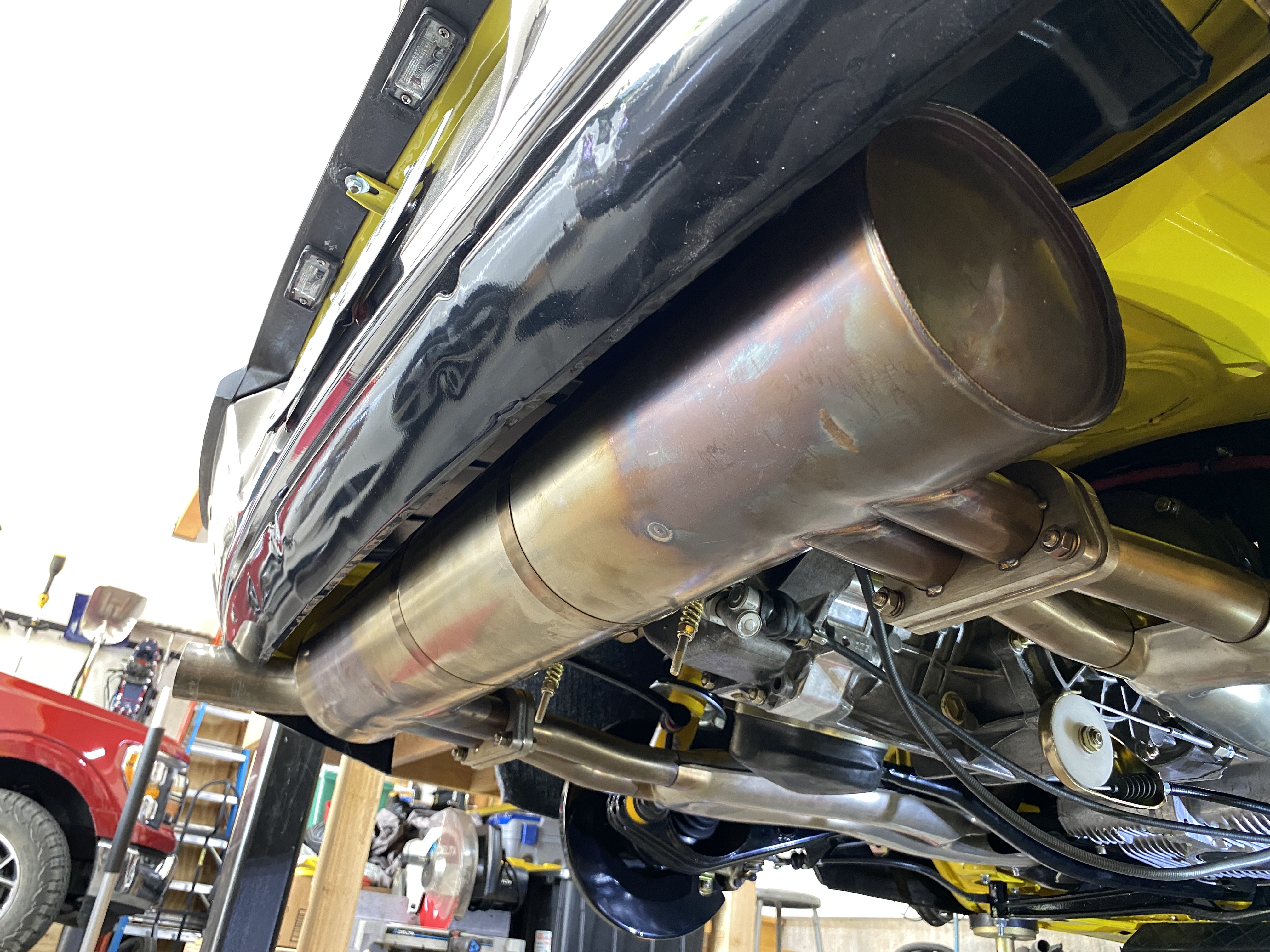

Muffler and new flange gaskets.
bkrantz
post Jun 26 2023, 07:15 PM
Post #6604
Posts: 8,341
Joined: 3-August 19
From: SW Colorado
Member No.: 23,343
O2 cable, and then all the cables bundled and wrapped. Everything underneath done.

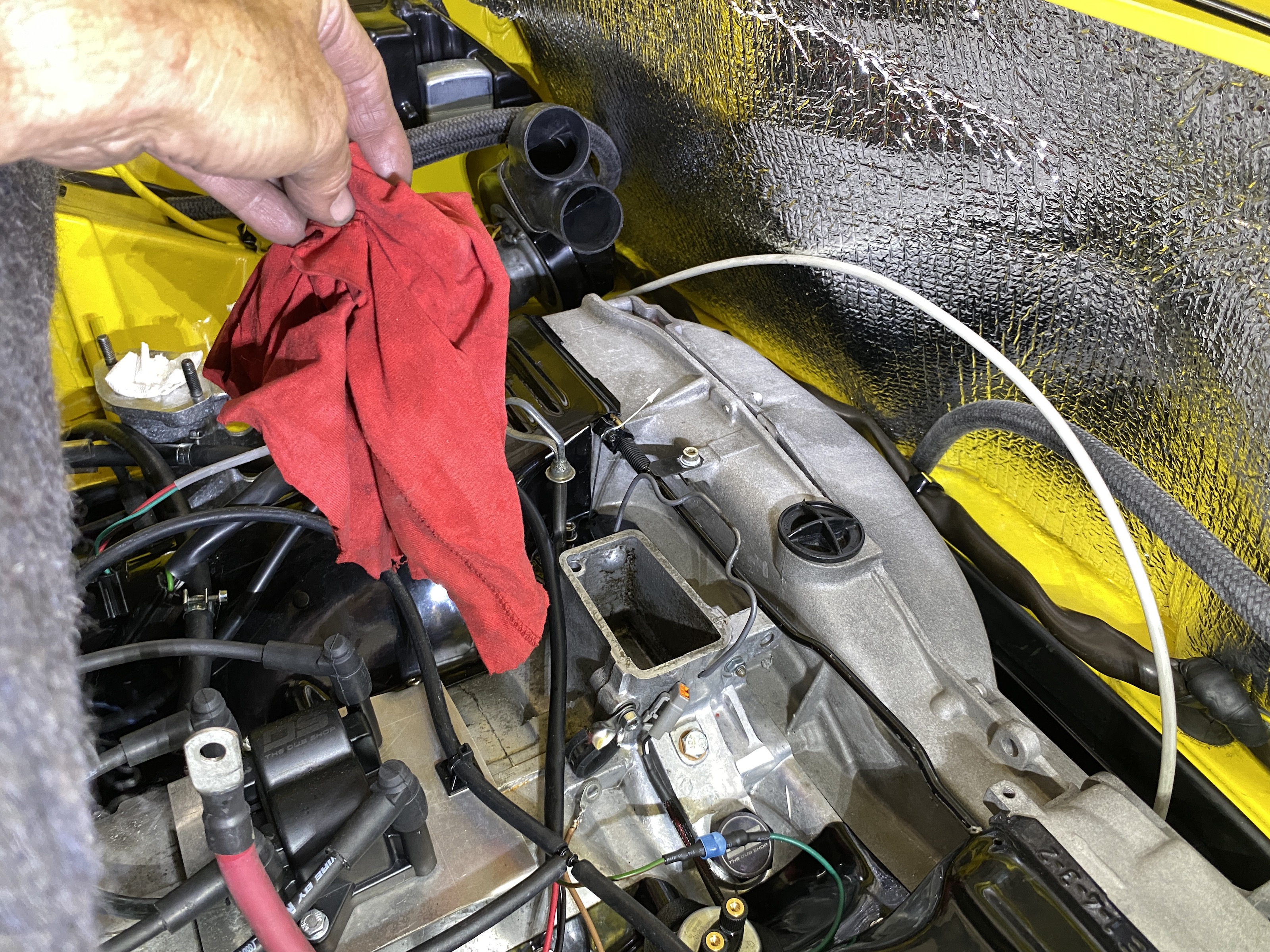

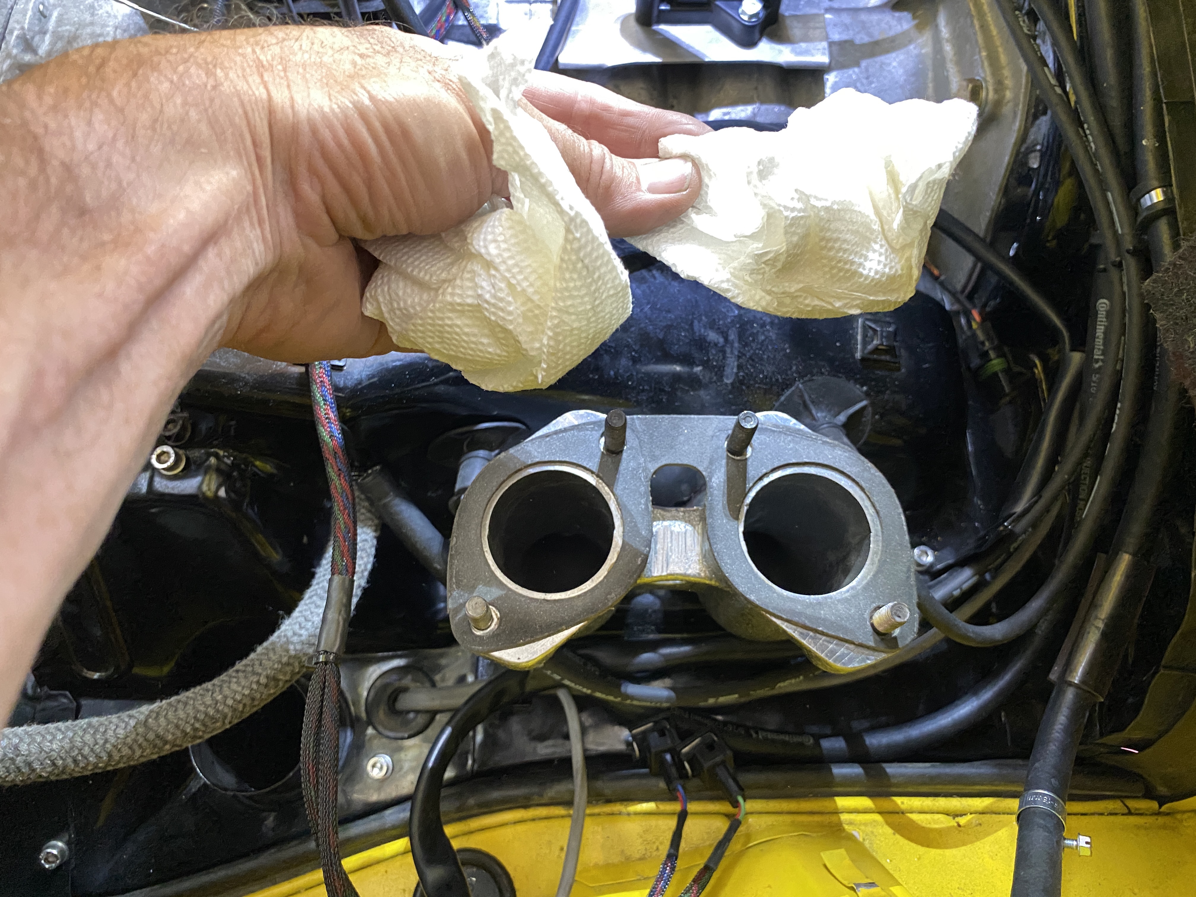

Here is photo proof that I took the rag out of the oil fill cavity. No dumb spill this time.

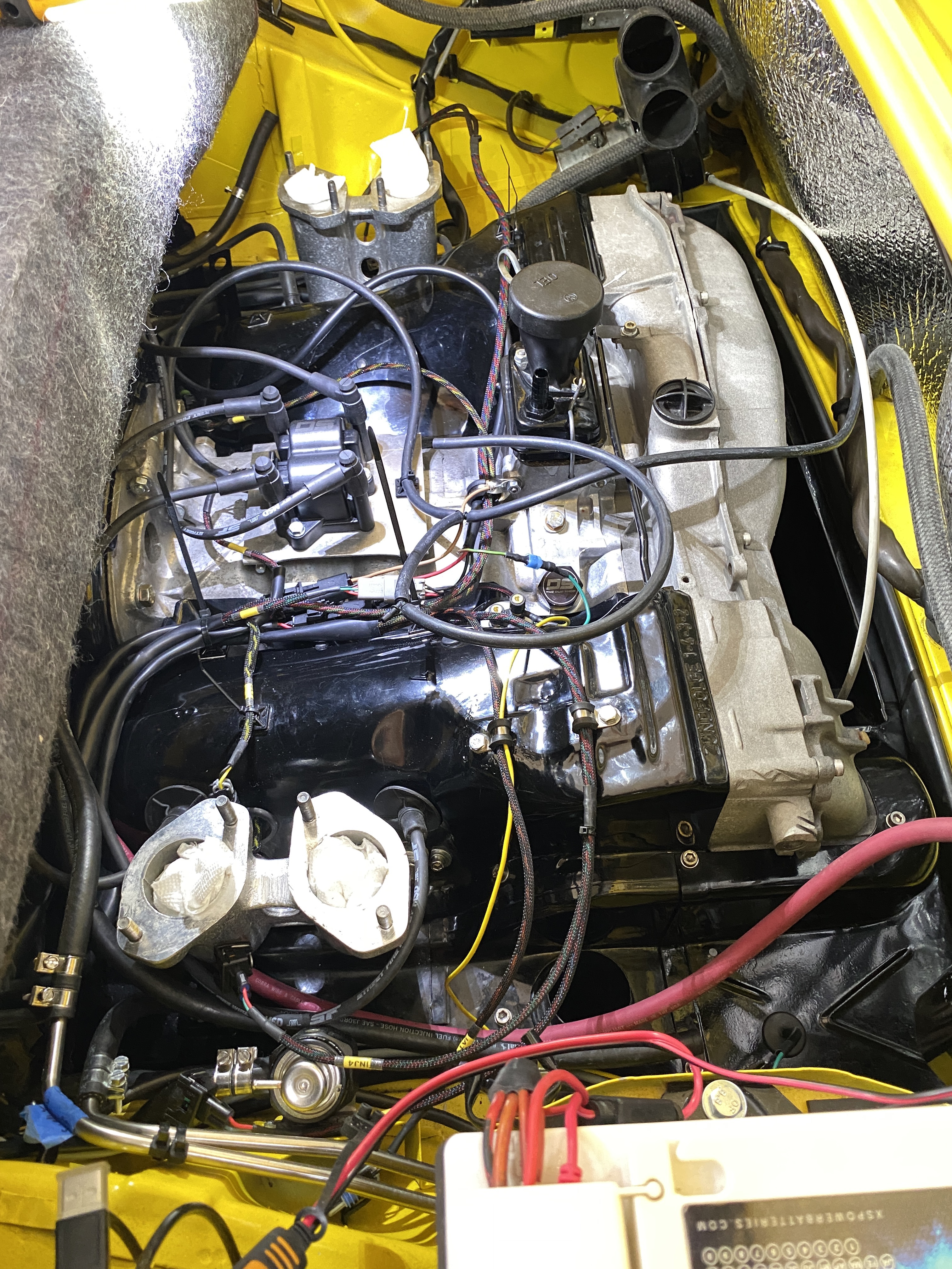

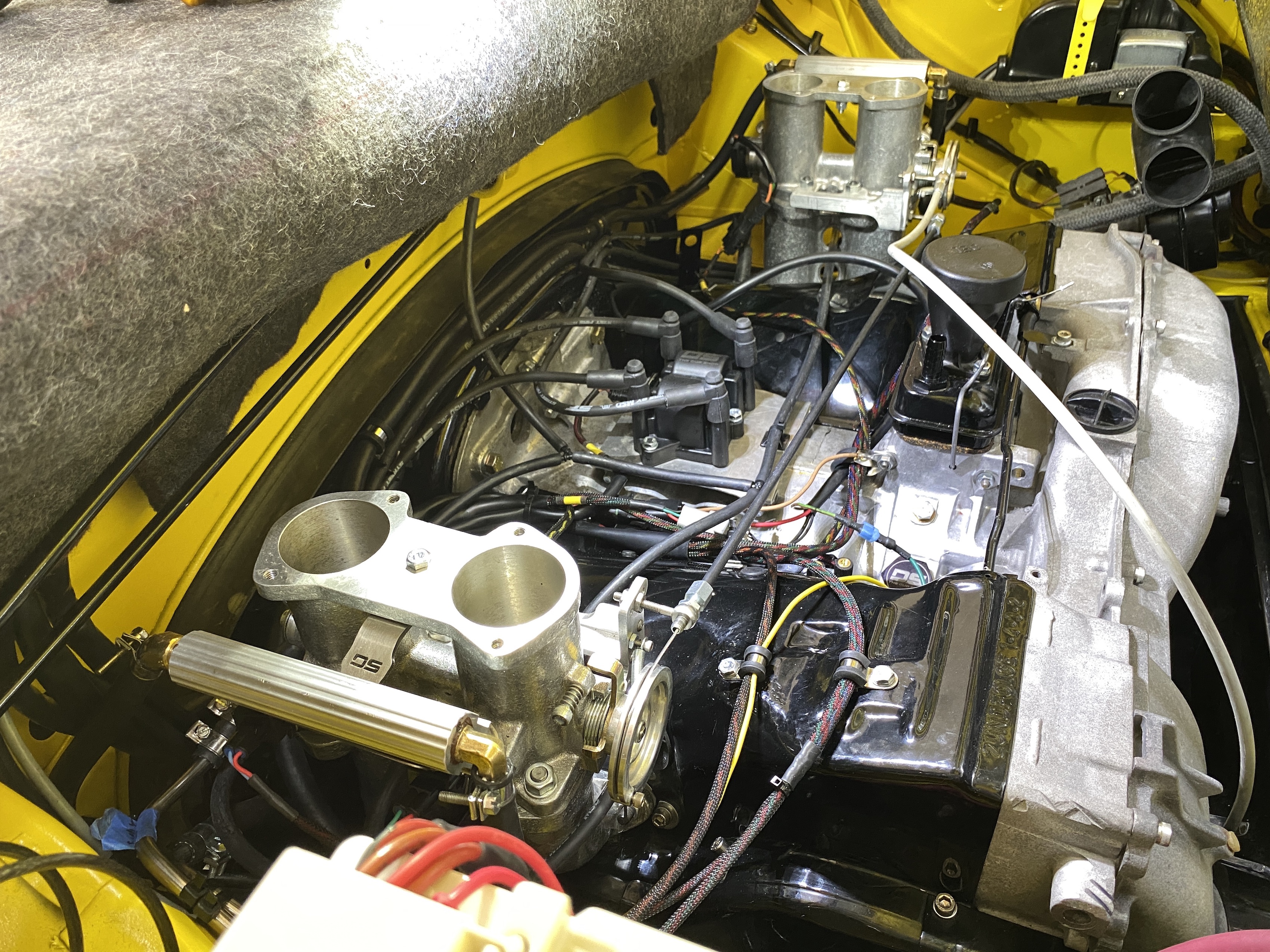

OK, all the wires laid out and first connections.

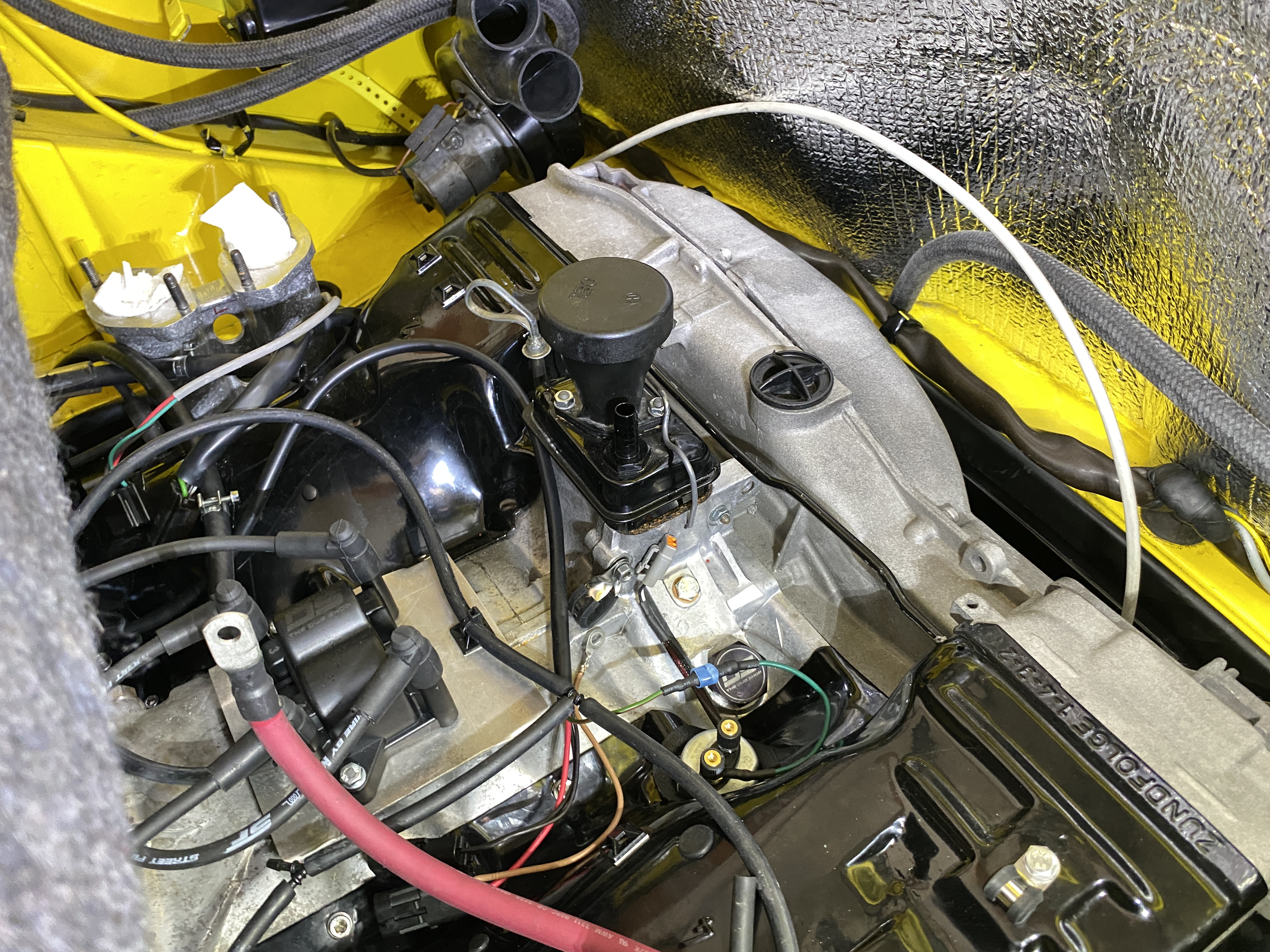

ITBs, more cables, vacuum lines, and fuel lines.

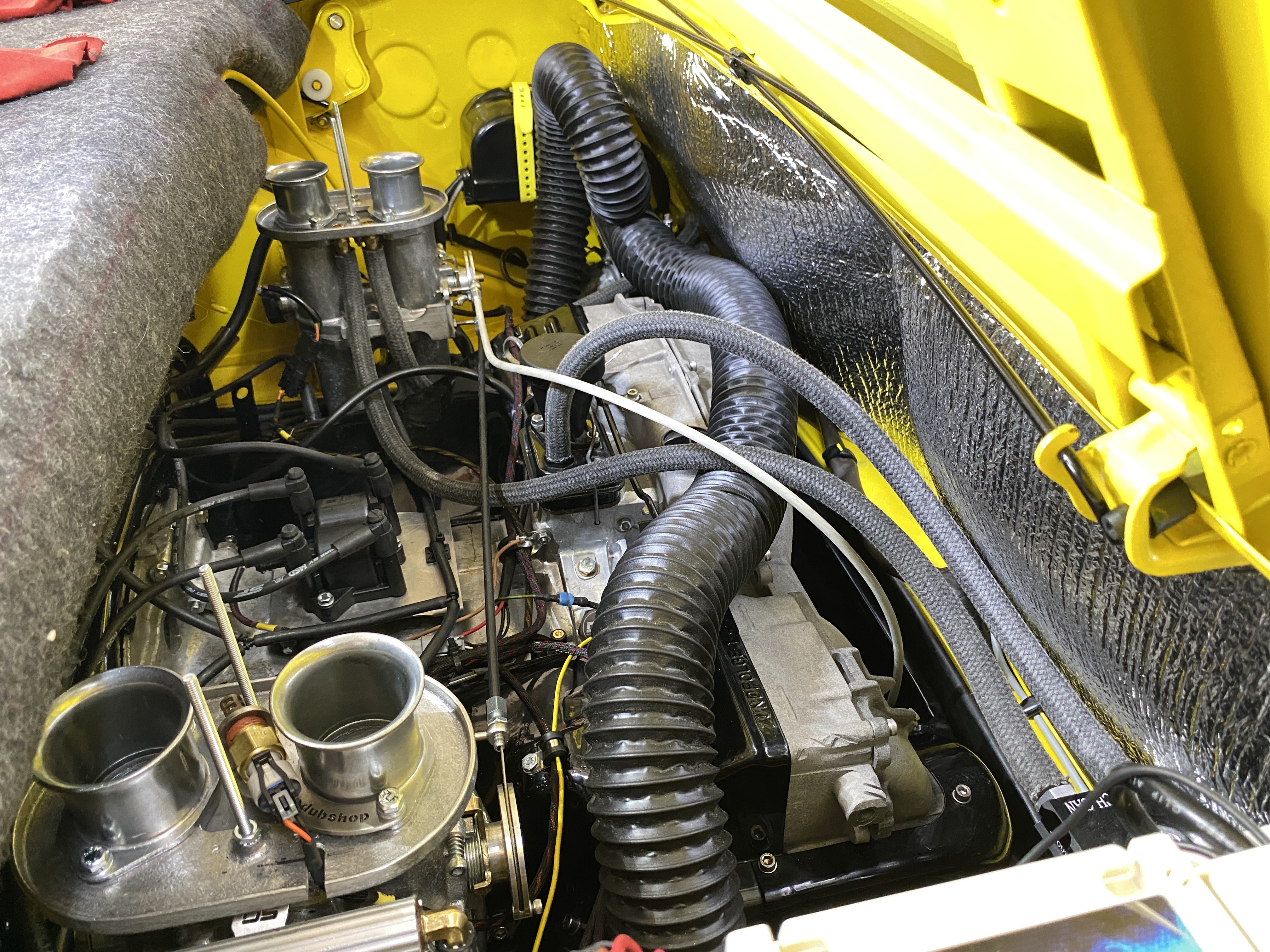

OK, everything installed (except the air filters).

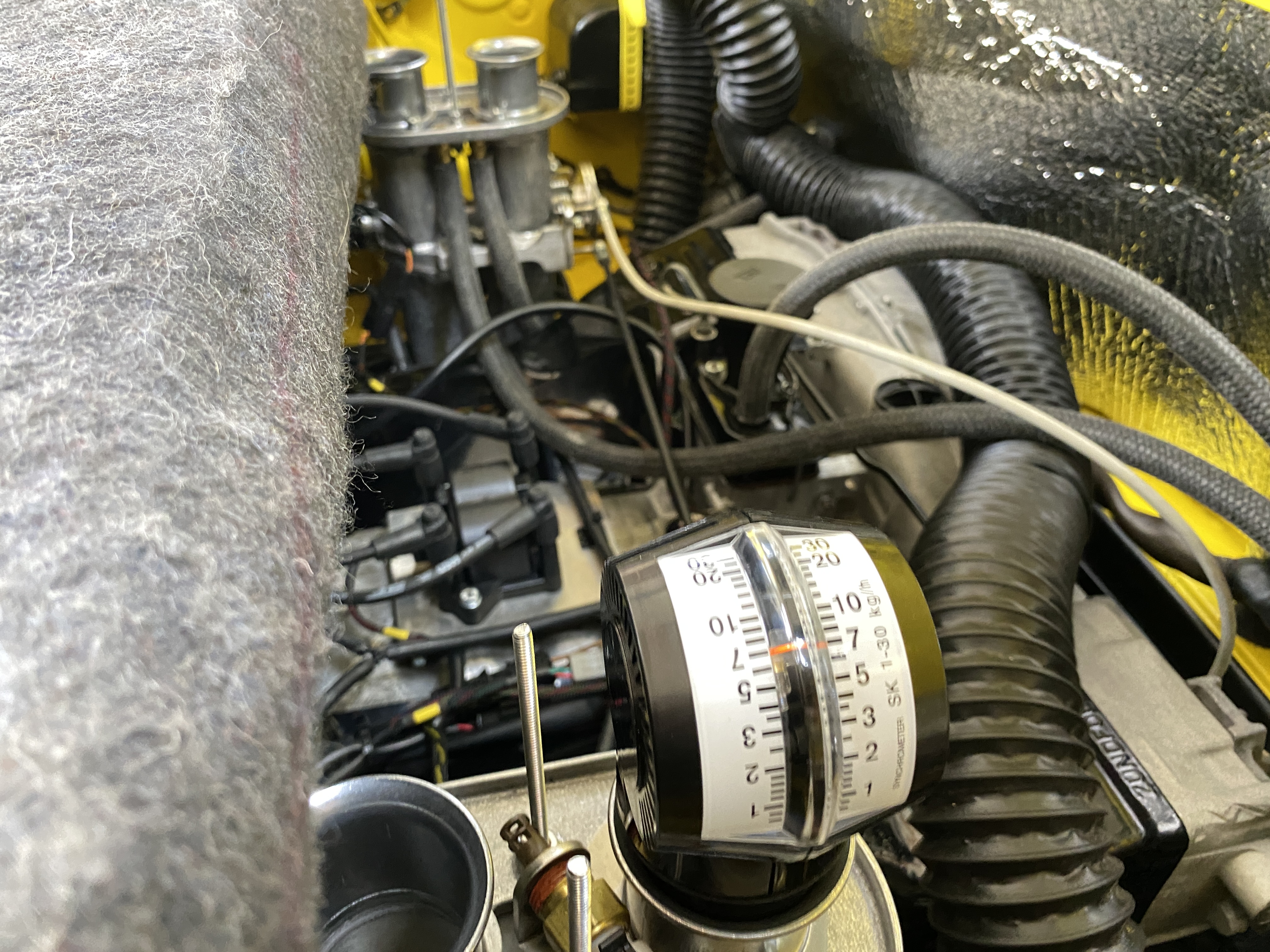

Once warmed up, I checked the airflow balance from left to right.

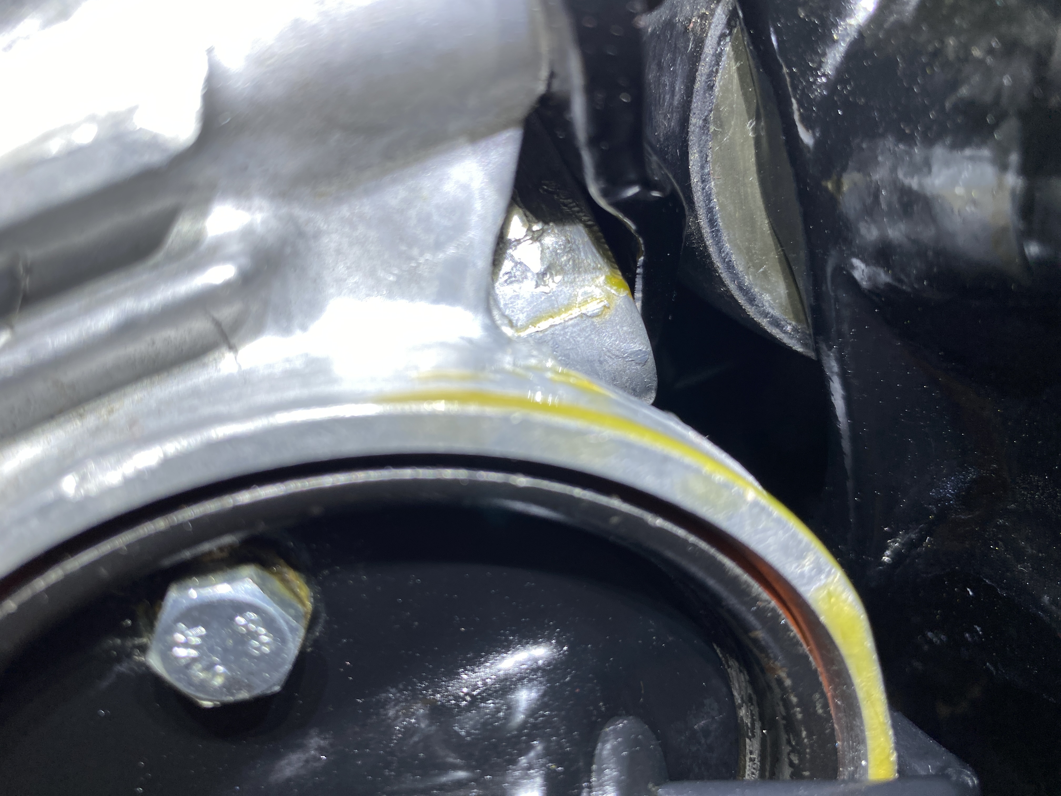

I shut it down and checked underneath. No leaks (yet) from the front galley plugs.
bkrantz
post Jun 28 2023, 08:17 PM
Post #6616
Posts: 8,341
Joined: 3-August 19
From: SW Colorado
Member No.: 23,343
And no signs of leaking (yet) from the cooler seals, and the overlying sender.

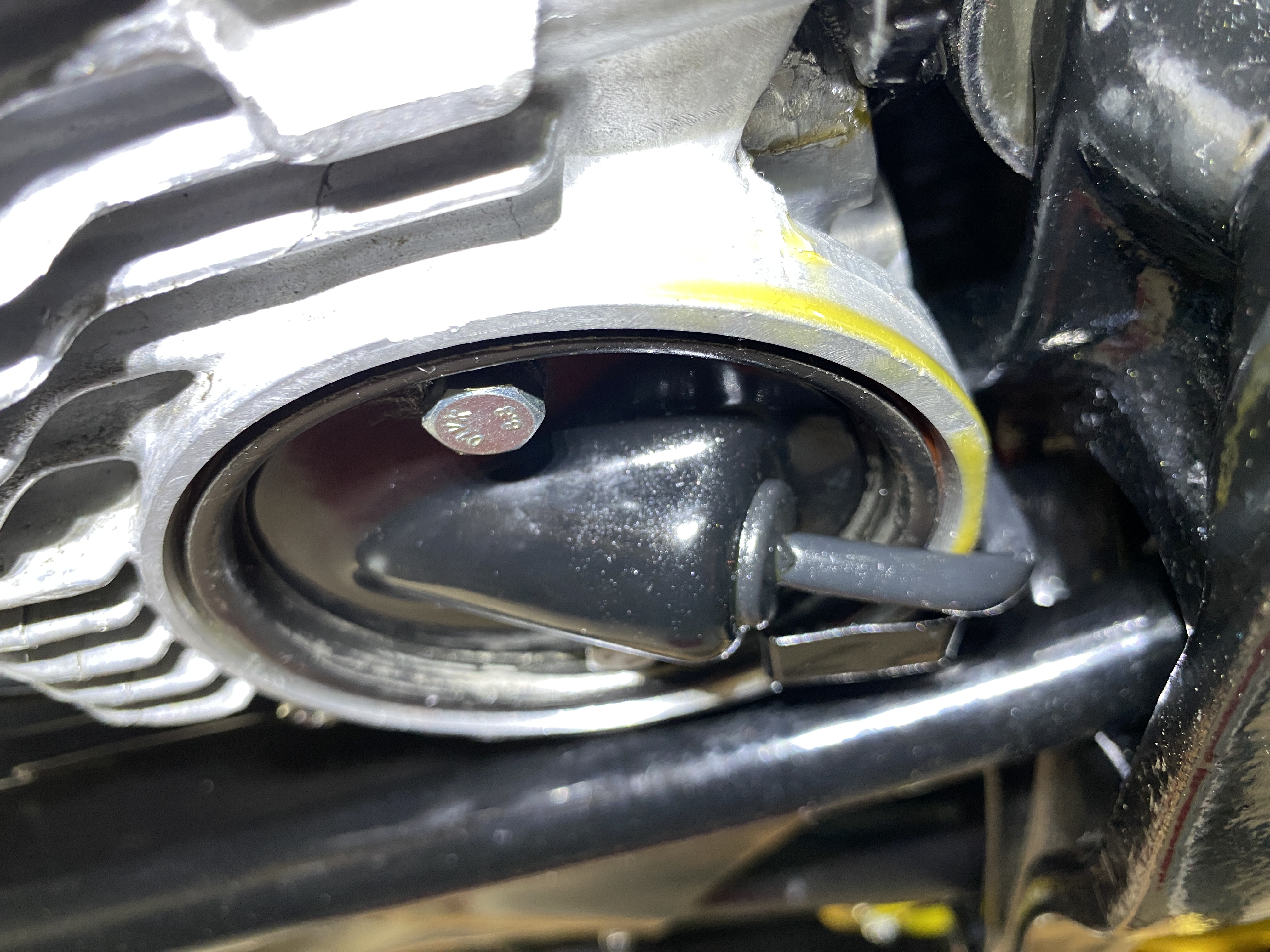

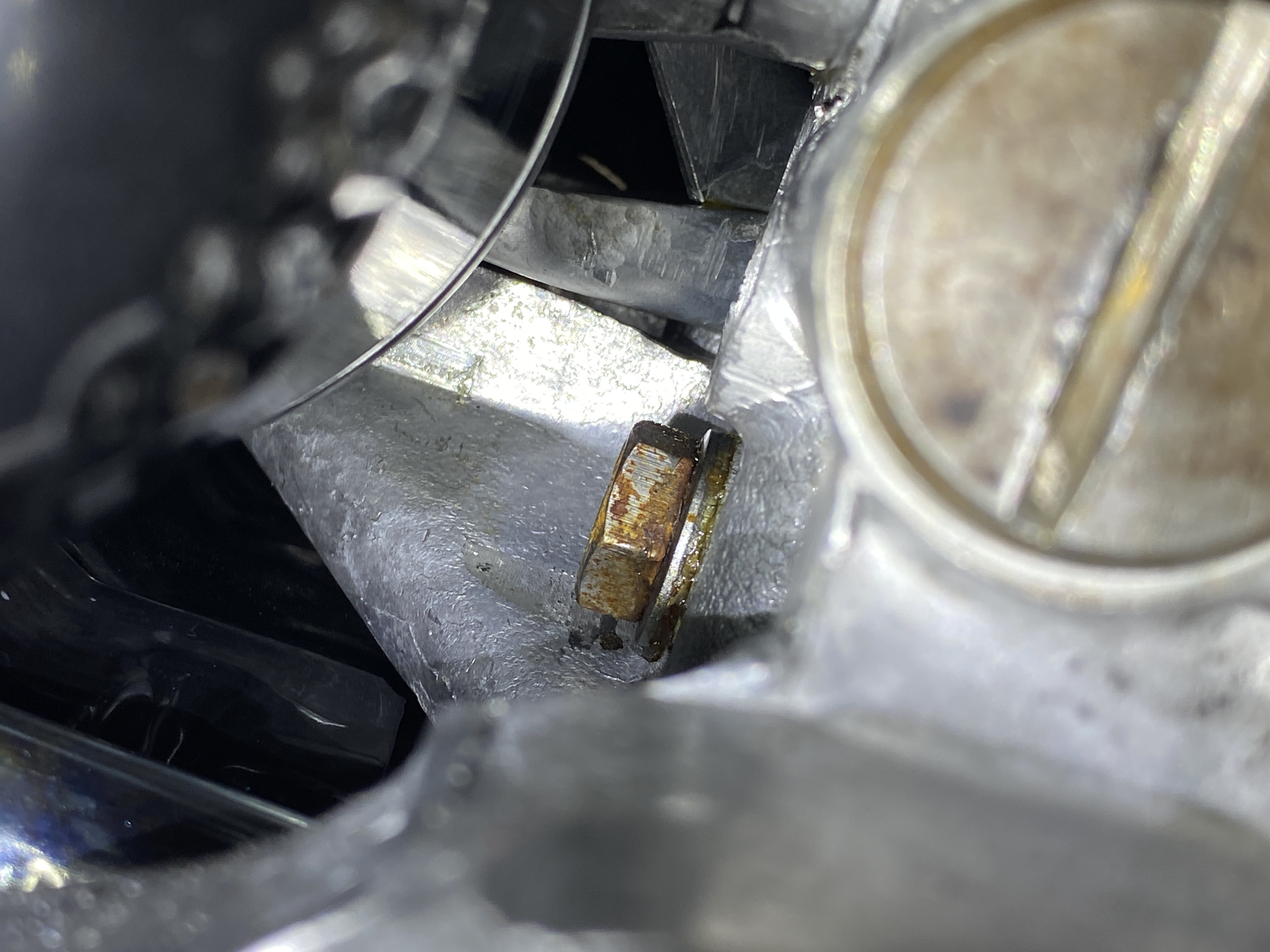

Fudge! I checked underneath today after the engine cooled overnight. And this was waiting for me.
bkrantz
post Jun 29 2023, 07:57 PM
Post #6619
Posts: 8,341
Joined: 3-August 19
From: SW Colorado

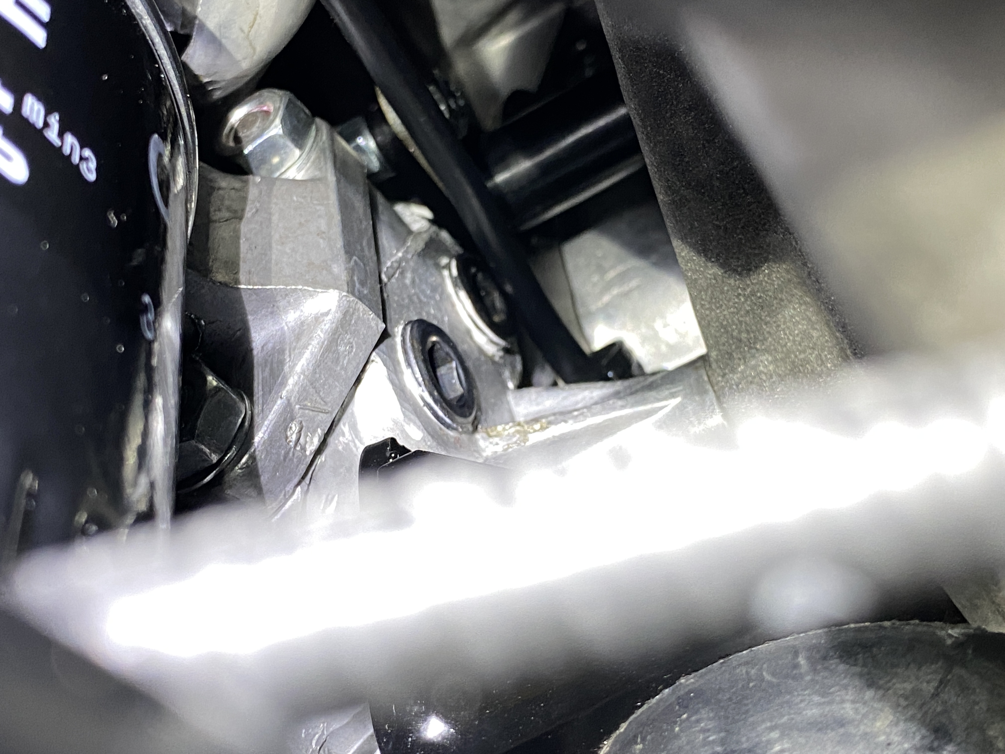

Member No.: 23,343
It looks like the stock screw-in galley plug is leaking. The other plugs and seals don't show any leaks so I guess that's something.
Not sure what I want to do now. I might see if I can R&R the plug without dropping the engine, at least all the way.

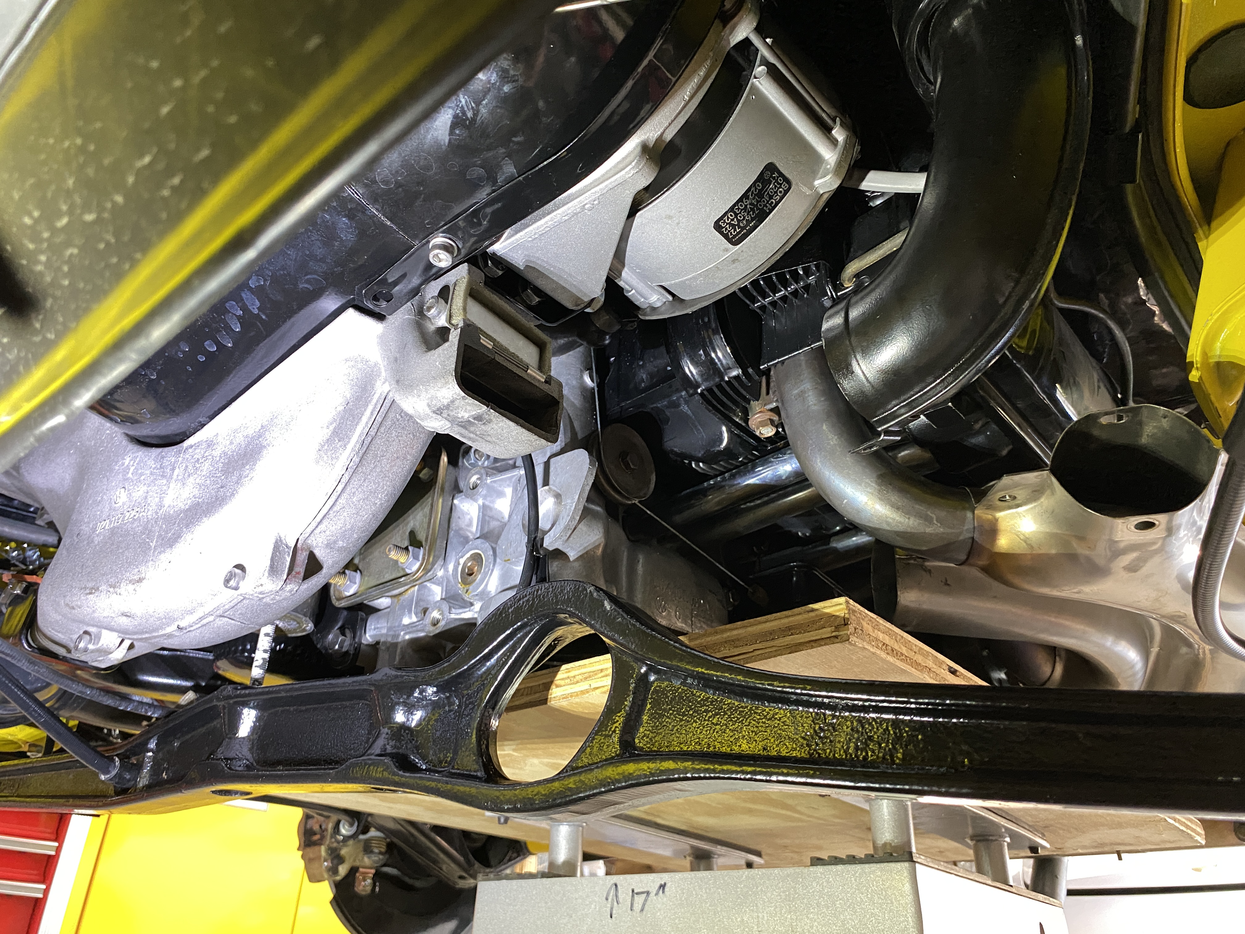

OK, fellow maniacs, I thought about this for a couple of days, including laying under the car to eye-ball and imagine, and I decided to try getting to the plug with the engine in place.
To do this, I removed the shift rod, all the heating ducts on the left side, the engine support cross bar, and the left front motor mount. At that point the access was not bad. (note the cross bar is still captured by the clutch cable)
