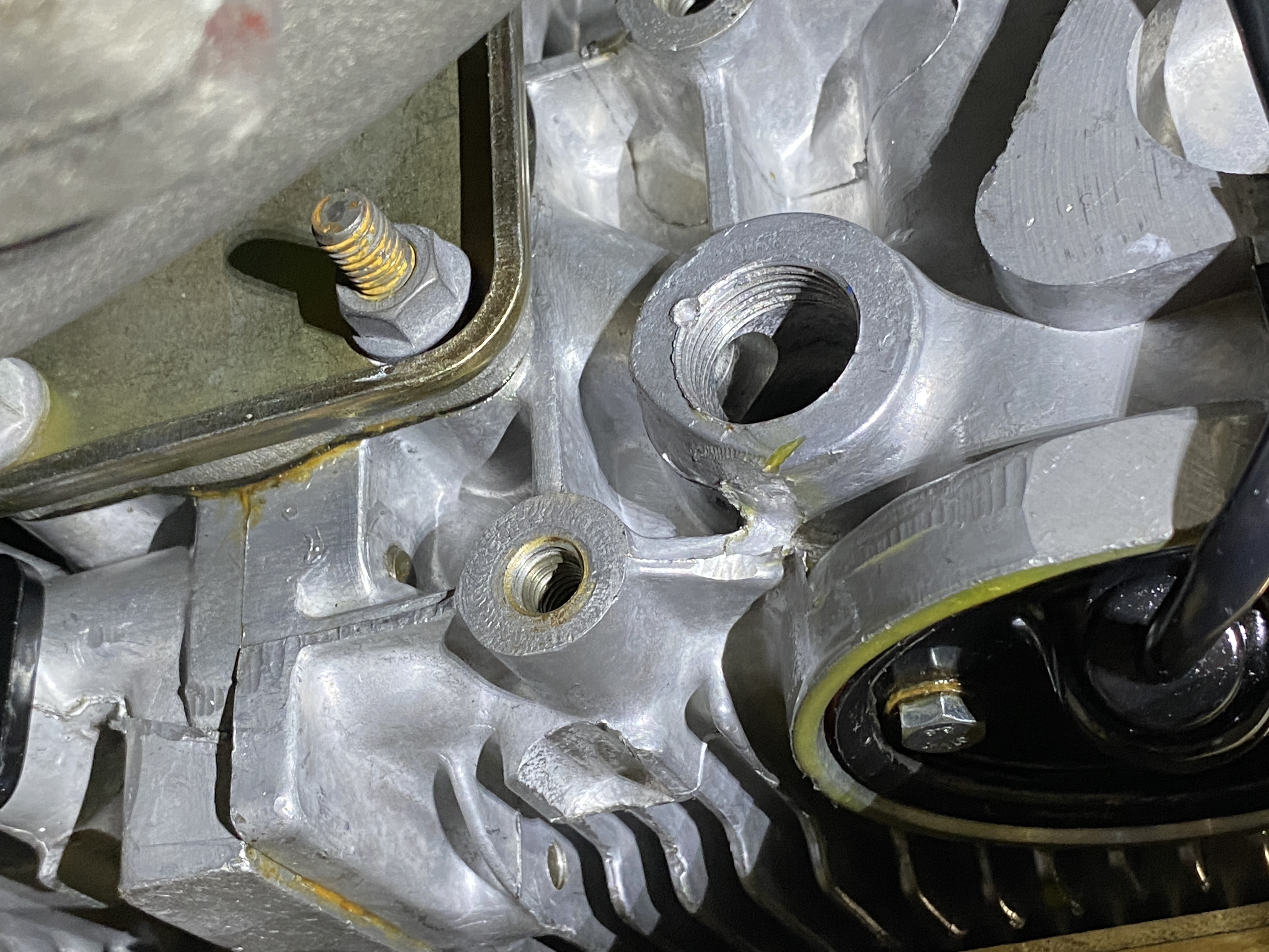

[quote name='Ottomotion' date='Jul 6 2023, 08:53 AM' post='3087704']
Not a crack (I hope!) but a surface scratch and/or a casting mark.
[/quote]
The more I look at the pics (not just this one) the more it looks like a crack repair......that has failed. Probably over torqued at some point in engine's past? otherwise strange spot for a crack.
[/quote]
Possible but I still think/hope not. See the photos below.

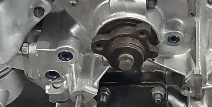

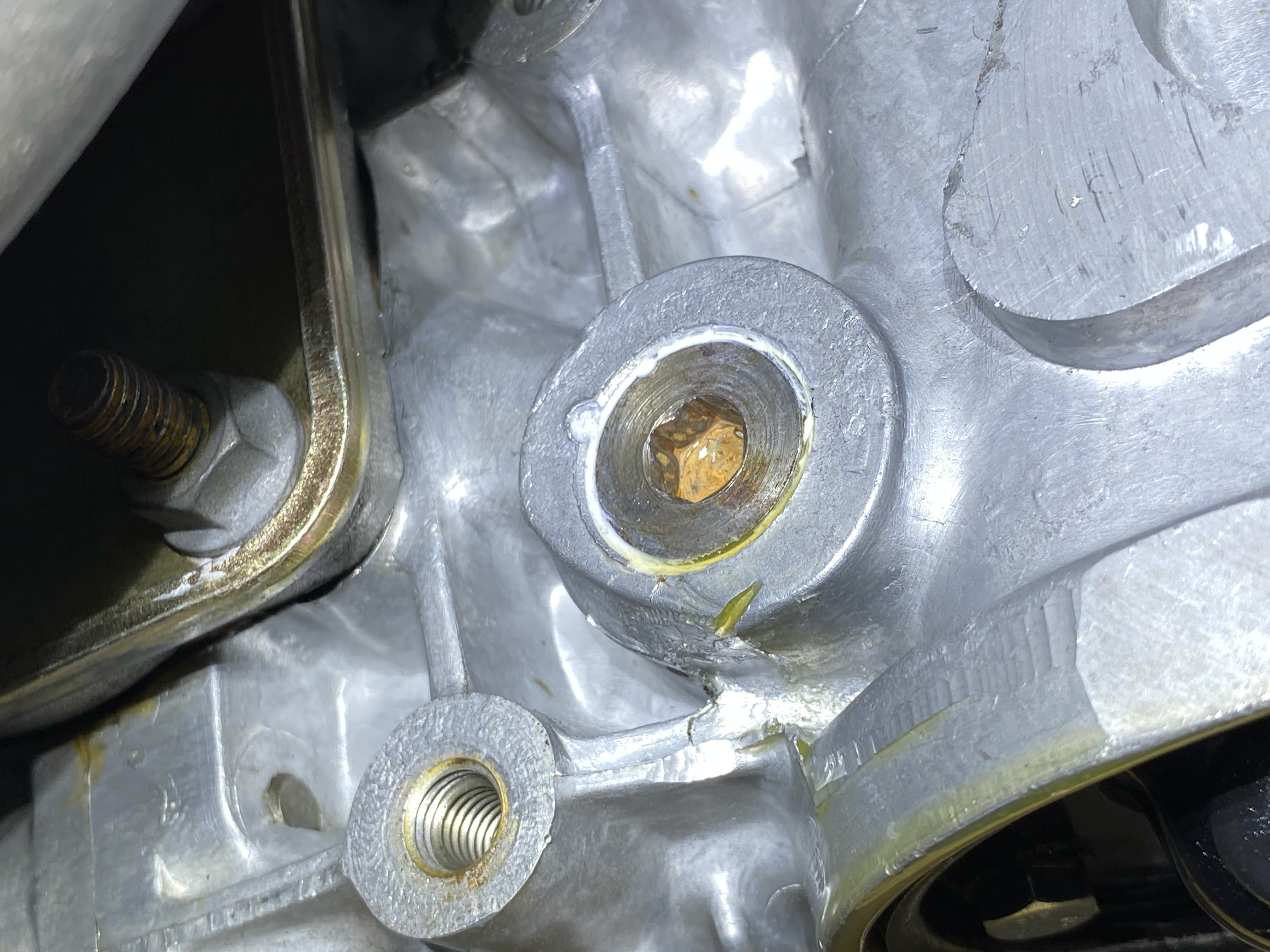

I removed the cross bar and left motor mount again. Here's the plug, which looks much like last time with oil showing around the lower half of the plug-case joint.

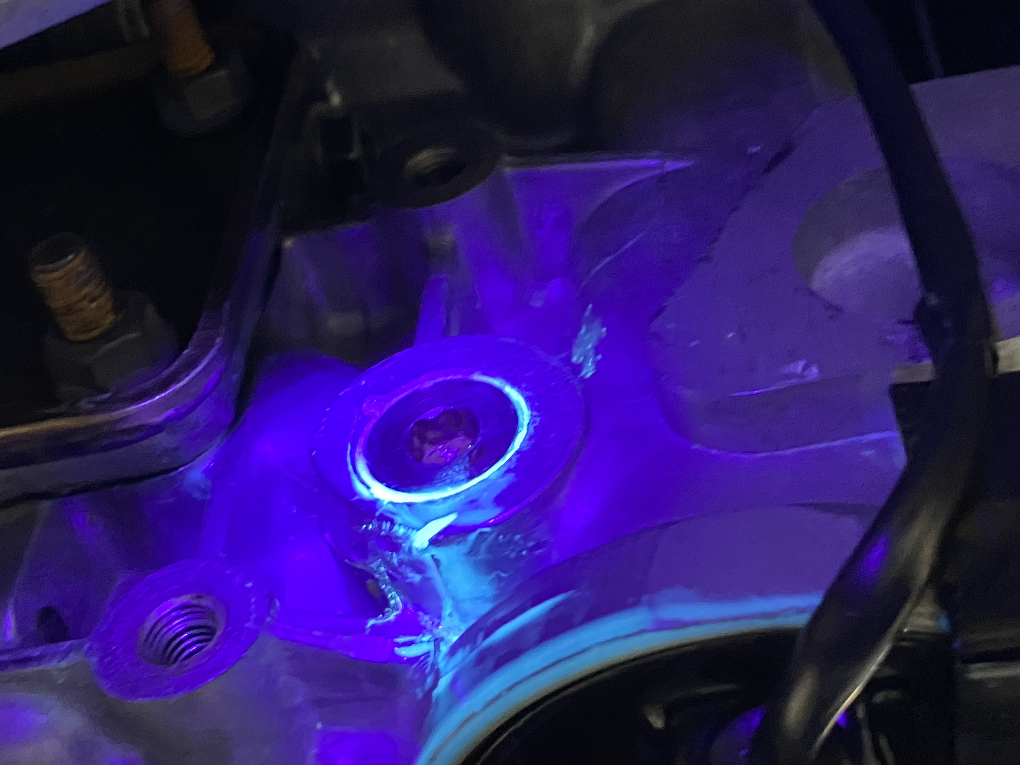

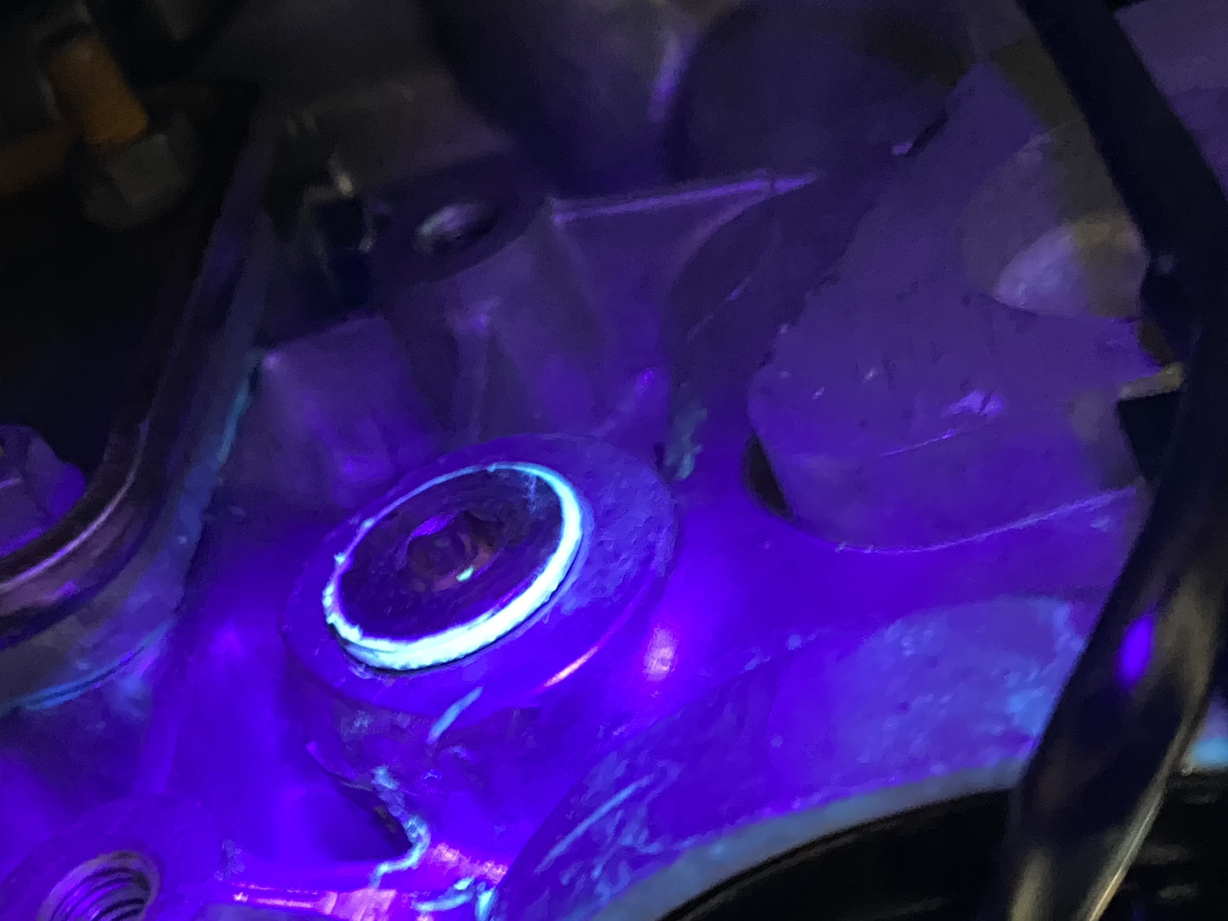

Under UV light before any cleaning. Most of the joint surrounding the plug looks oily.

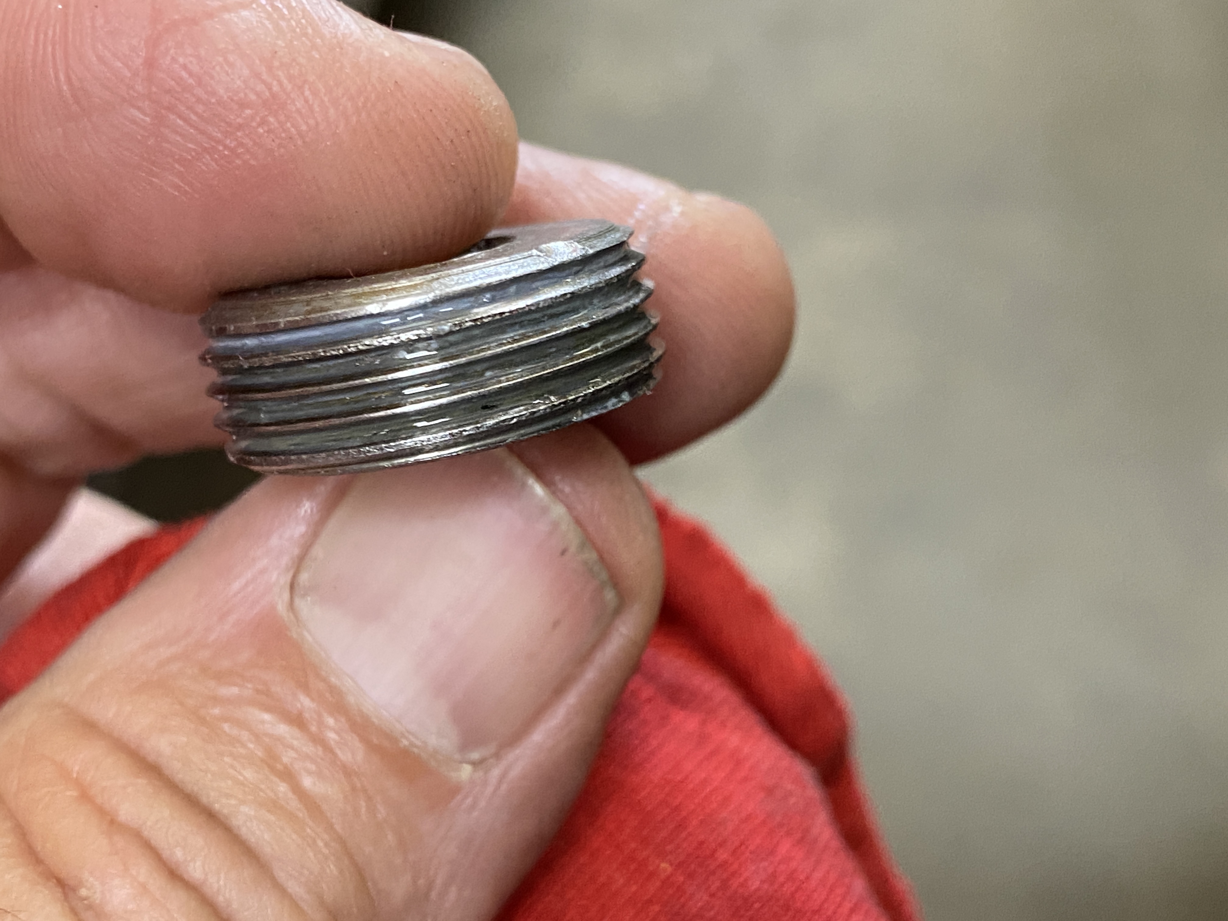

As I unscrewed the plug, the sealant was uncured and very fluid. Again.

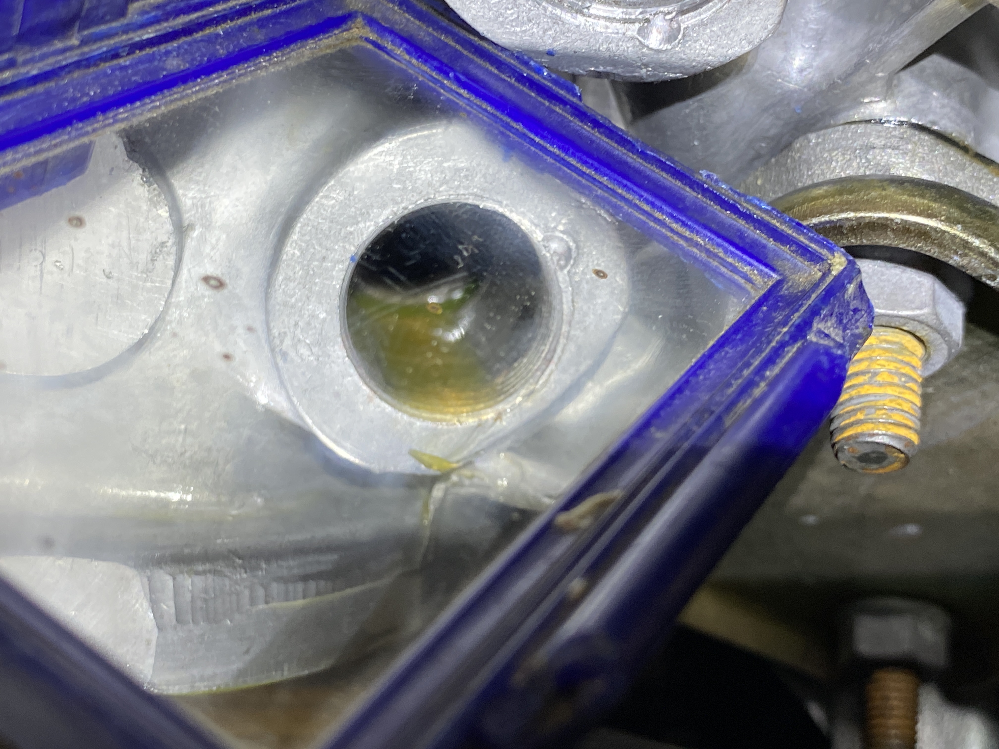

To check for a crack I used a mirror to get a look at the inside after cleaning it with solvent on a rag. I figure just like a normal crack test, any oil would act like a dye and light up the crack. I did not see anything like that.

Just like last time, with different sealant, the plug threads look oily and without cured sealant--and potentially leaky.

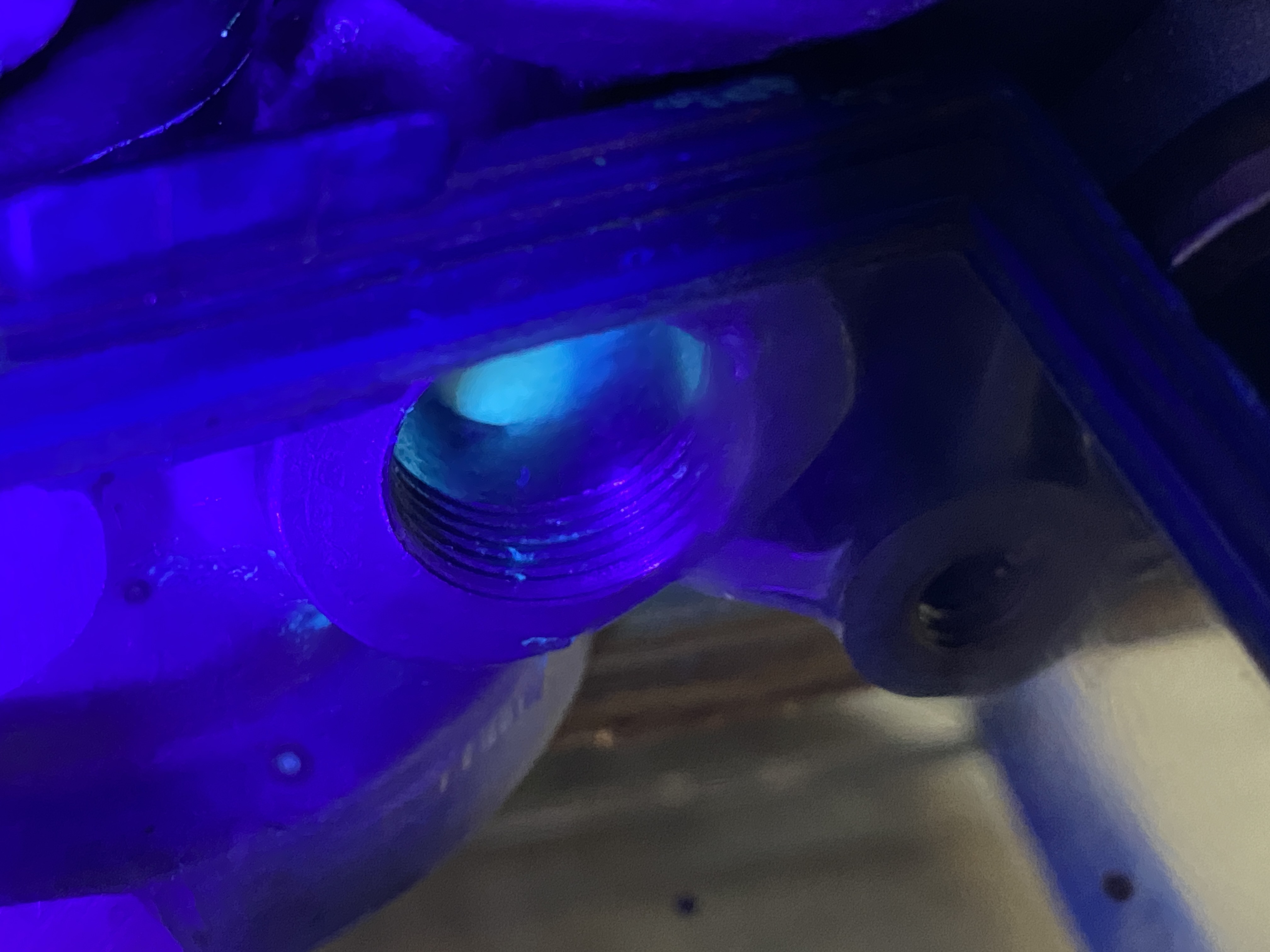

Her we go again. One thing I found that might have contributed to my problems getting a good seal: even through I tried to clean all the oil out of the galley, after sitting for a few day enough drained down to flow out.
bkrantz
post Jul 10 2023, 07:28 PM
Post #6657
Posts: 8,341
Joined: 3-August 19
From: SW Colorado
Member No.: 23,343
Using a mirror to see how much oil pooled in the bottom of the galley, I can imagine how it contaminated the thread sealants I tried after previous adventures with the plug, from the inside.
This time I cleaned it out again, and waited long enough (I hope) to make sure no more oil draining down.

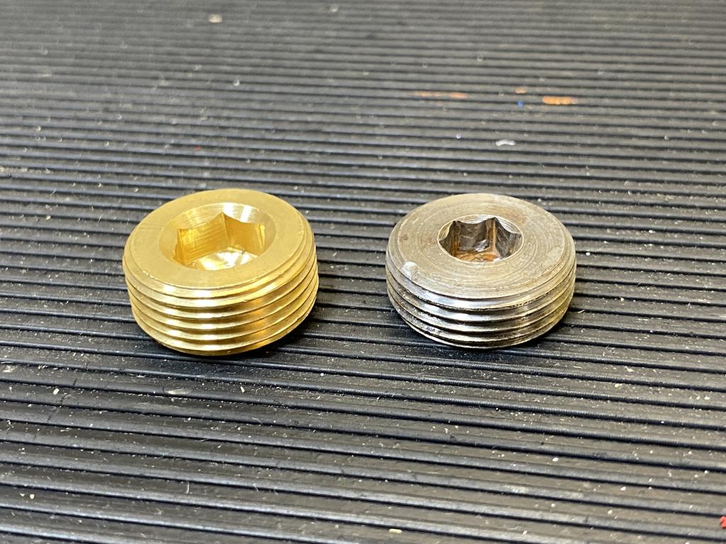

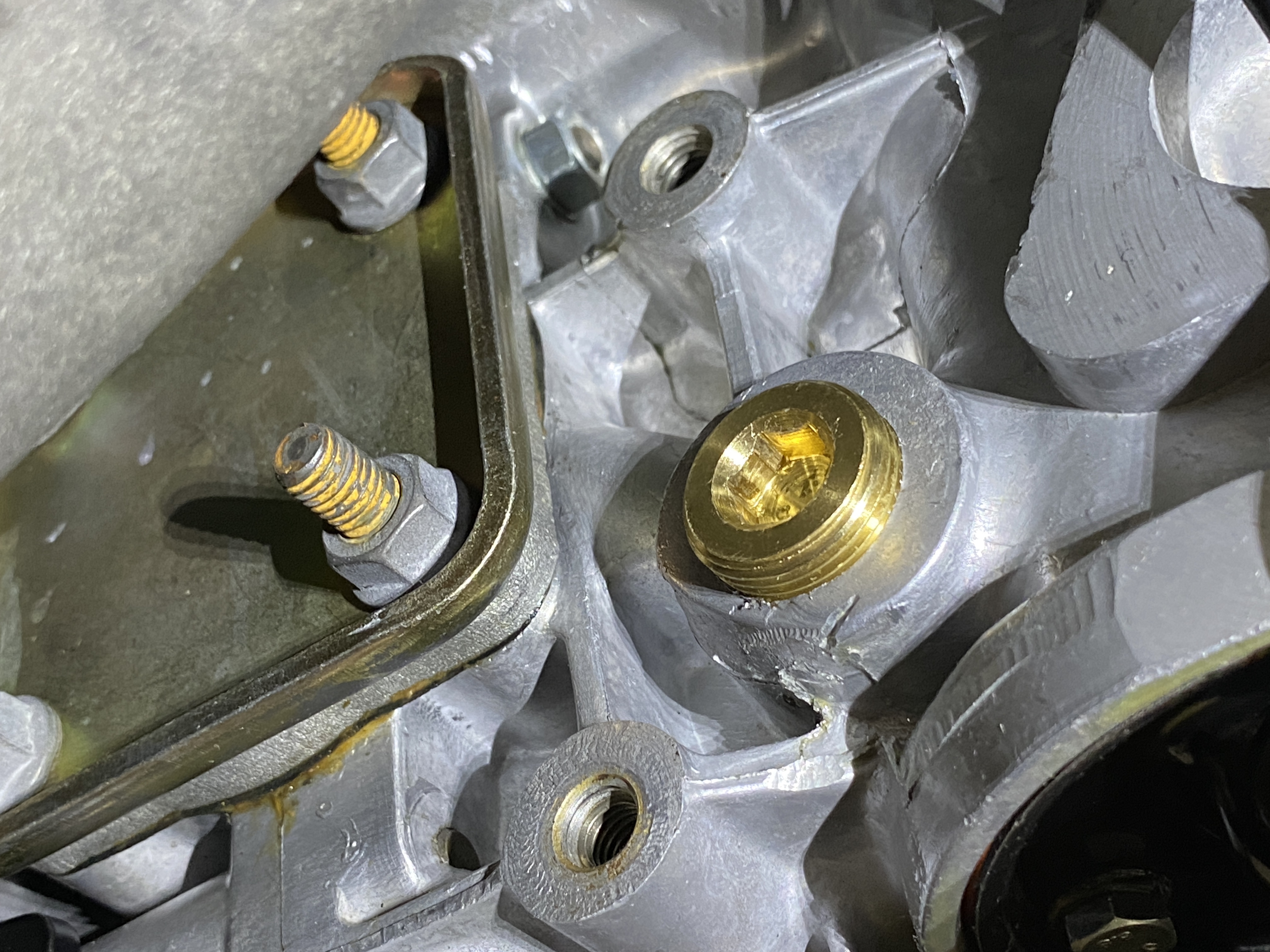

Fedex brought this today. Same basic diameter and thread pitch as the stock plug, but brass. This should have thermal expansion closer to the aluminum case. Obvisouly, the brass plug is taller.
bkrantz
post Jul 10 2023, 07:32 PM
Post #6659
Posts: 8,341
Joined: 3-August 19
From: SW Colorado
Member No.: 23,343

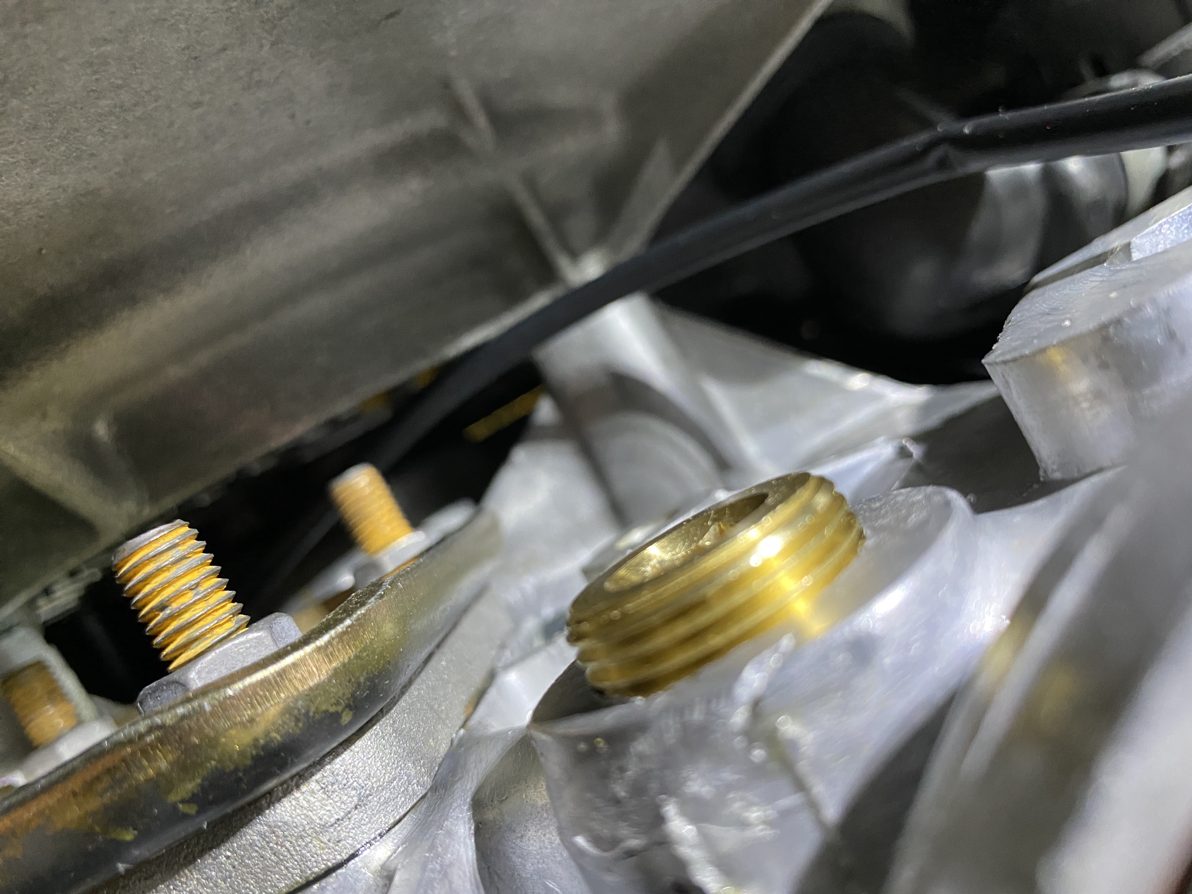

Good news: it does thread into the hole.
bkrantz
post Jul 10 2023, 07:35 PM
Post #6660
Posts: 8,341
Joined: 3-August 19
From: SW Colorado
Member No.: 23,343
Bad news: with a moderate amount of torque, this is as far as it screws in.
