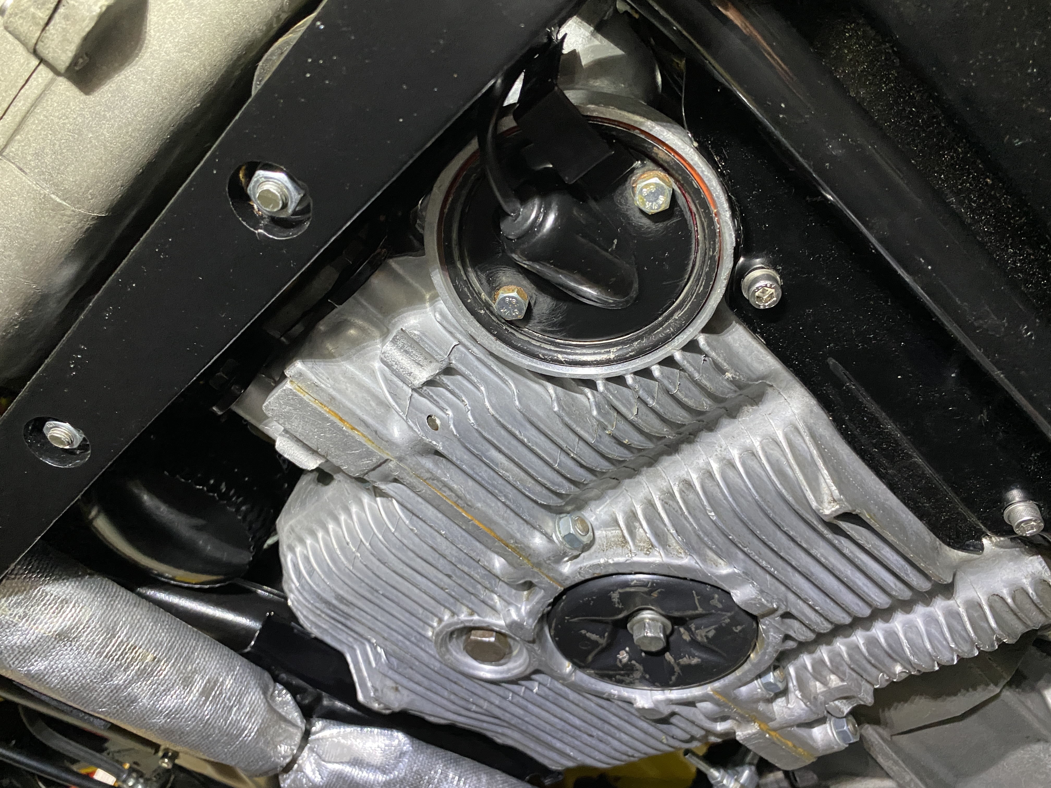

Back home, and a bit of 914 time. Still no oil drops so I put everything back together, starting with all the blower ducts on the left side.

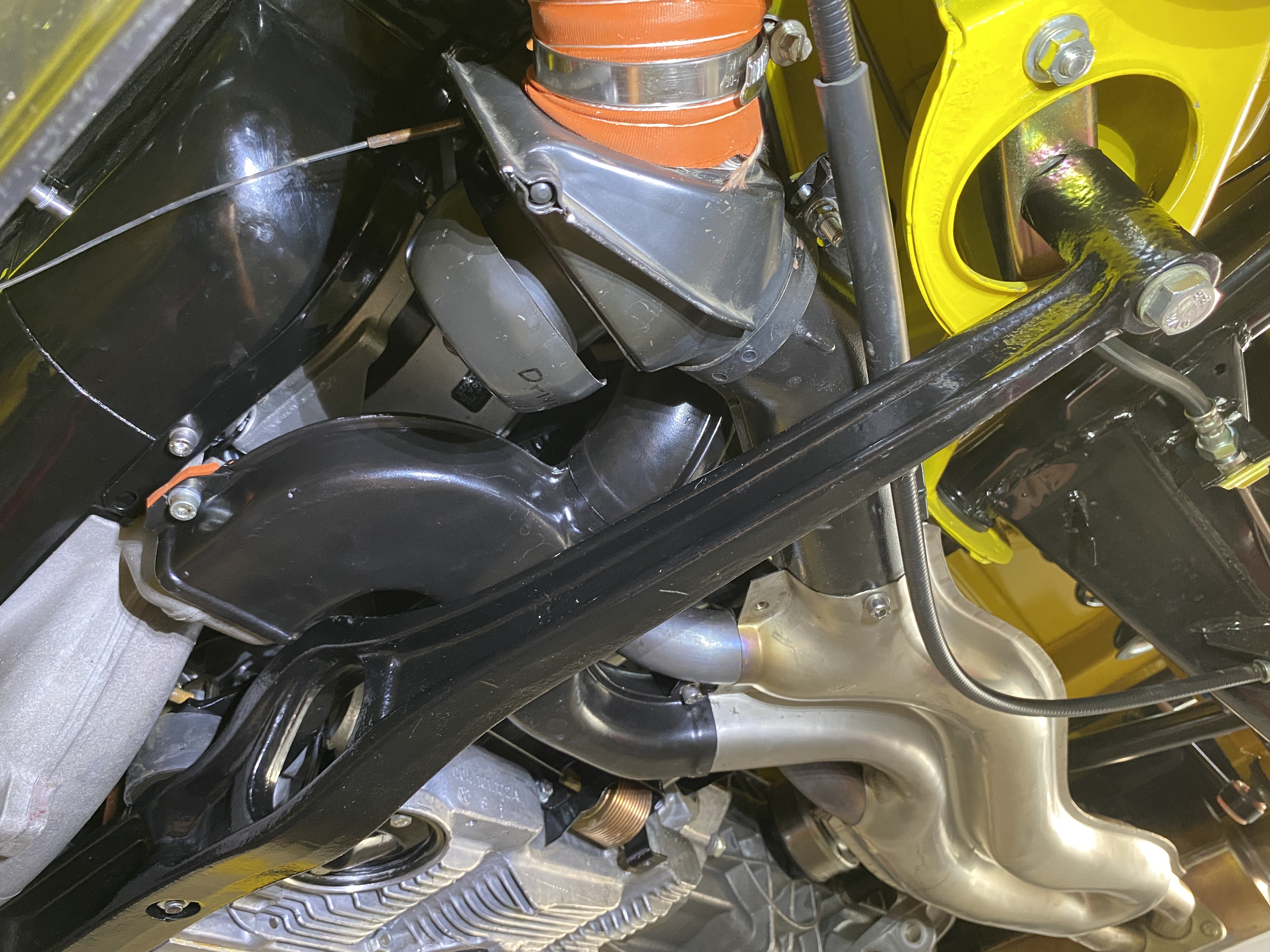

Left side lower sheet metal.

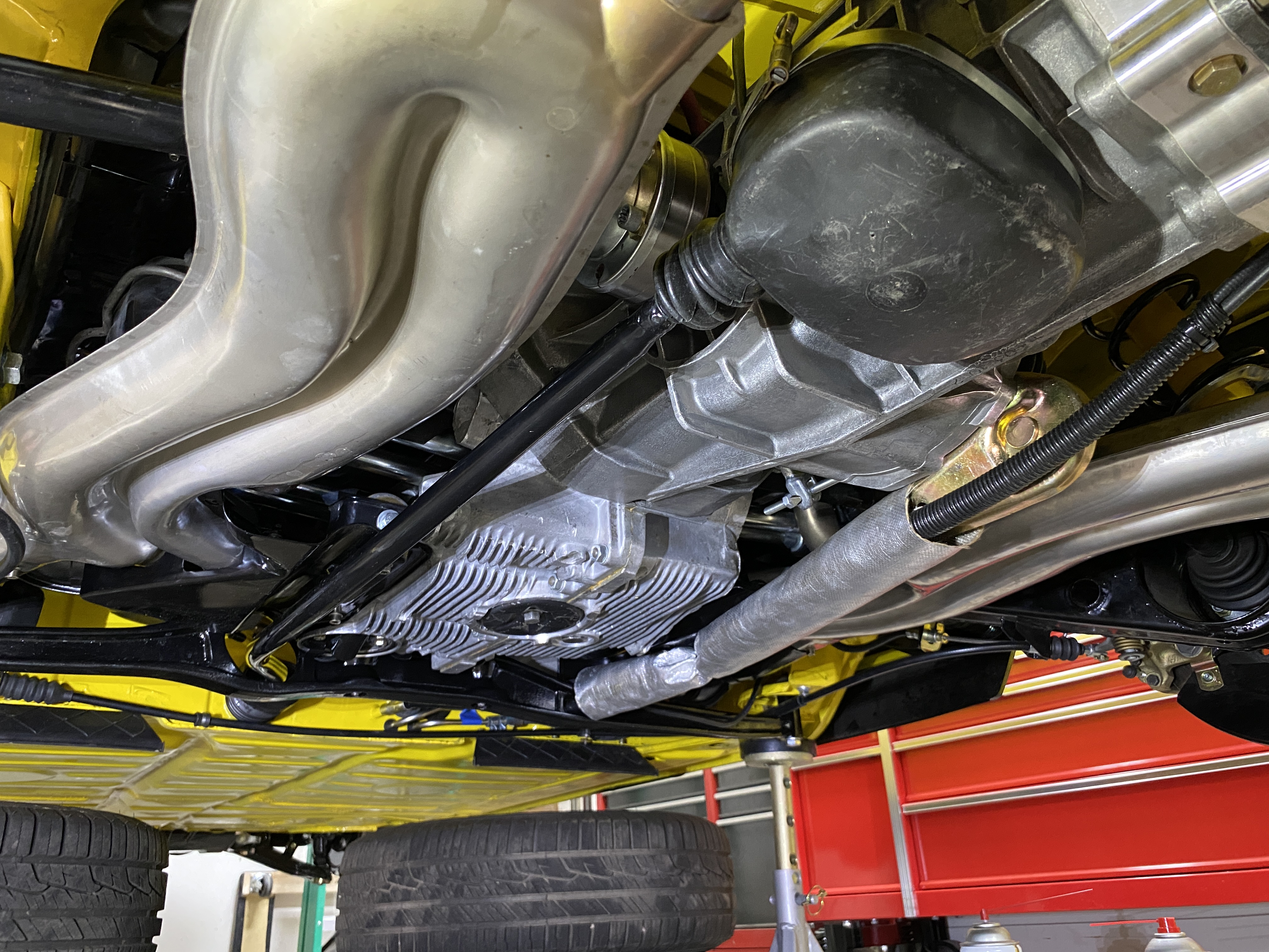

Shift rod. And checked everything.

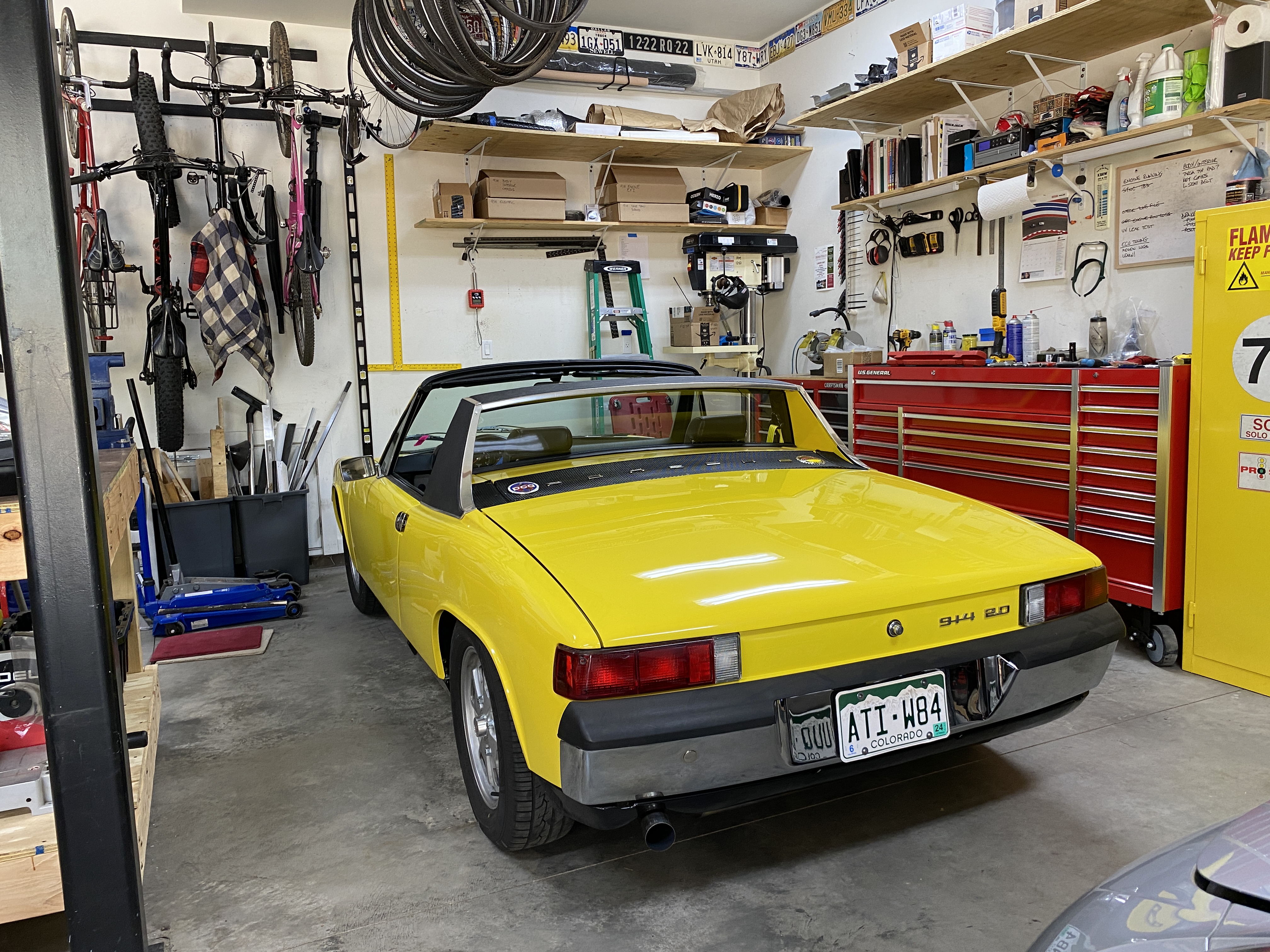

Back on the wheels--finally. Tomorrow I should have time for a drive.

Thanks, guys. One more good sign today, after the engine cooled overnight: no drips!
Finally, I can get on to playing with the engine tune again.

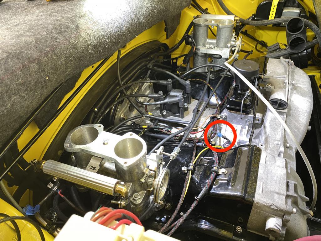

Bob, what is that wires coming out of the tin in the foreground with the blue connector on it? I should know these things but...LOL. thanks for the underside pics to re Clutch, Speedo routing.

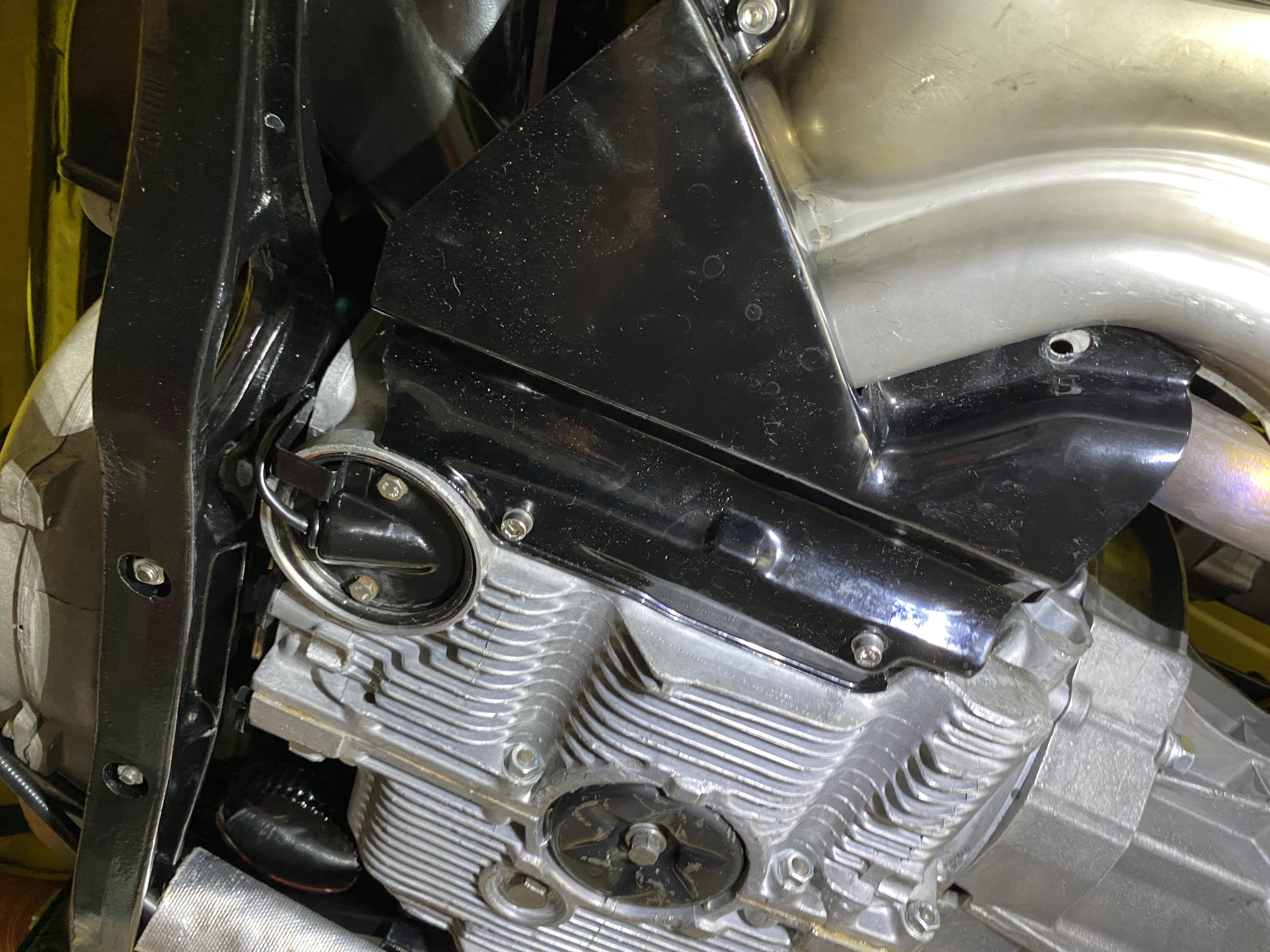

QUOTE(NS914 @ Jul 21 2023, 08:06 AM) *
Do you mean this one (circled)? If so, that is the adapter cable I made to connect the stock oil pressure wire, with female spade connector (for the idiot light) to the VDO sender, with loop connector.
