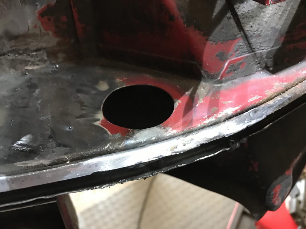

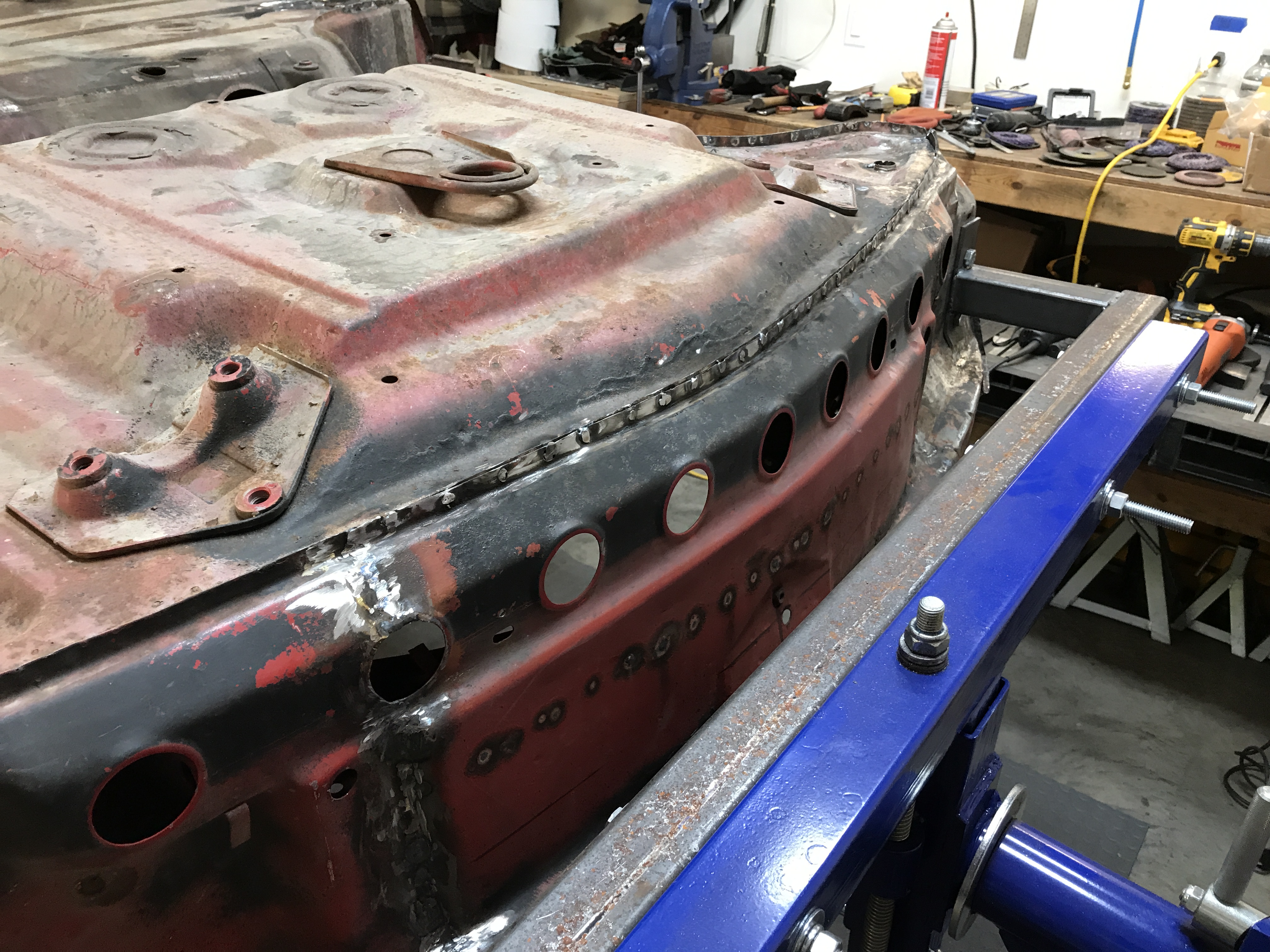

And then finished up with welding the under side of the tray. Again, having the rotisserie to turn the car upside down made this easier.

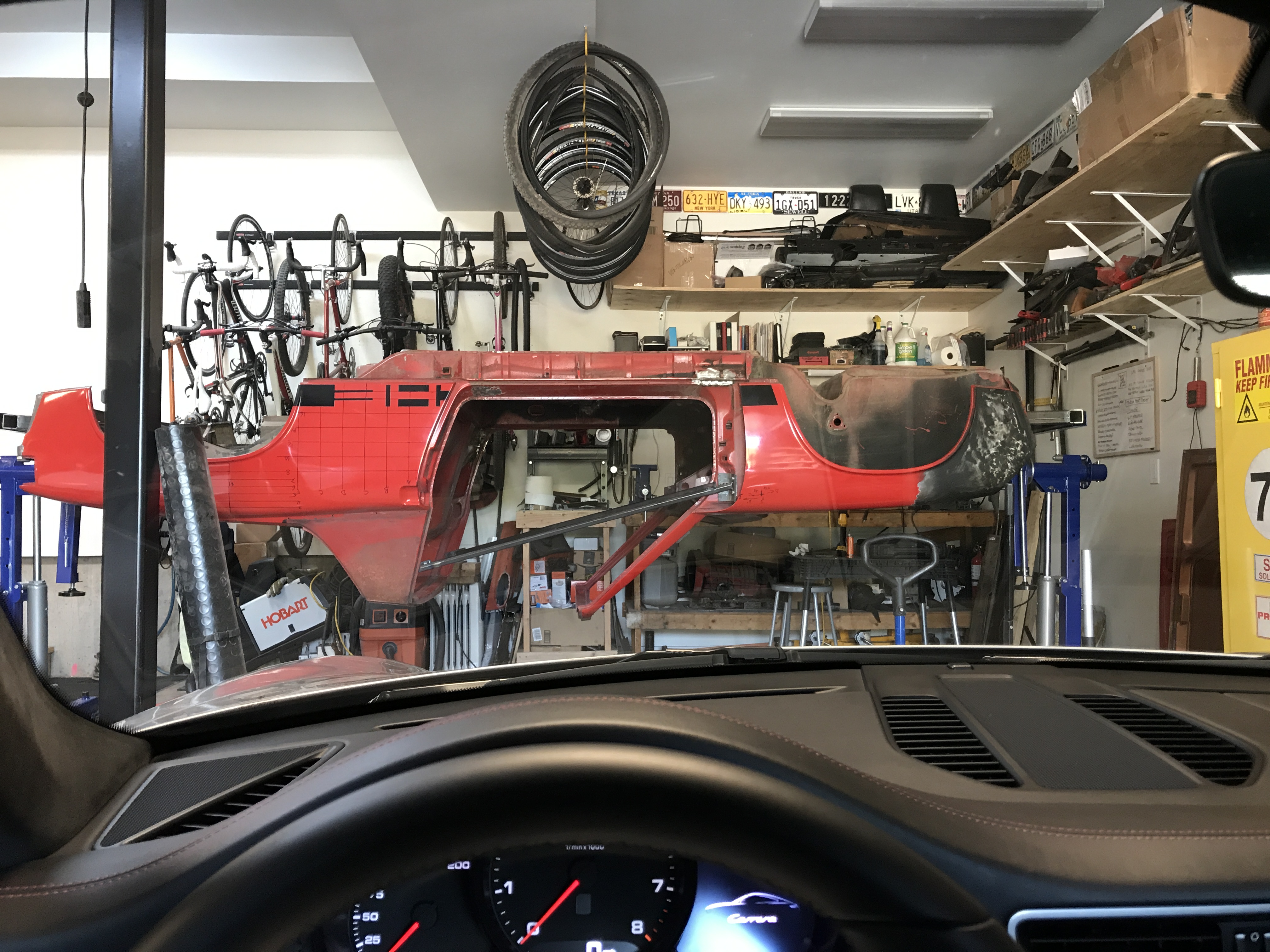

No 914 work today, but when I took my 991 out for a drive before changing the oil, I noticed this view.
I noticed all the bikes on the wall. And bike wheels/tires hanging from the rafters. Ha
I do NOT have a bike problem--maybe a storage problem. Plus S has 4 bikes on the other side of the garage. And we have some bikes stashed at our son's place in Tucson.

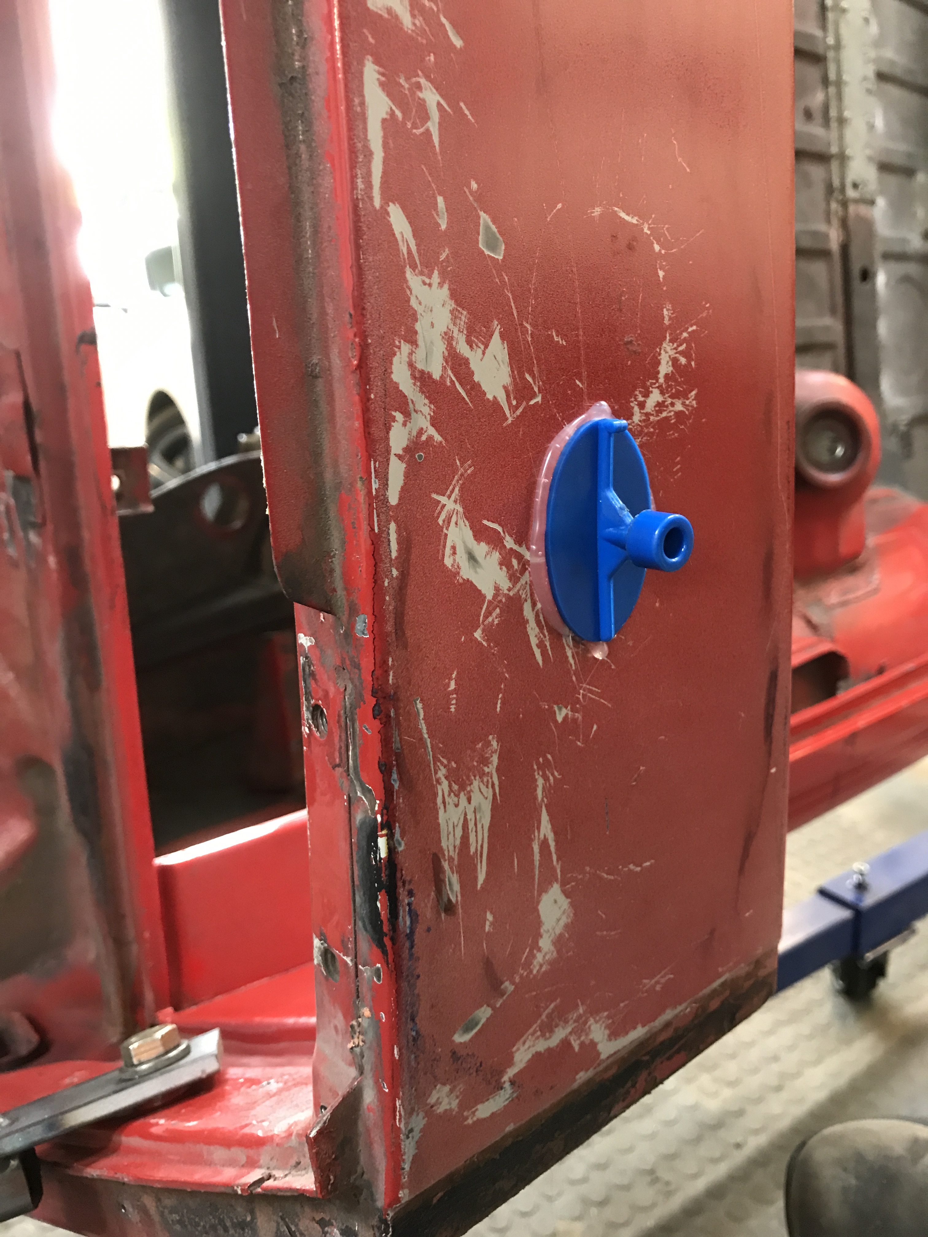

I worked on the targa hoop top today, to remove a shallow (max 3/32") dent on the left side. I got out the paintless dent remover kit again. I did about a dozen pulls in different locations.

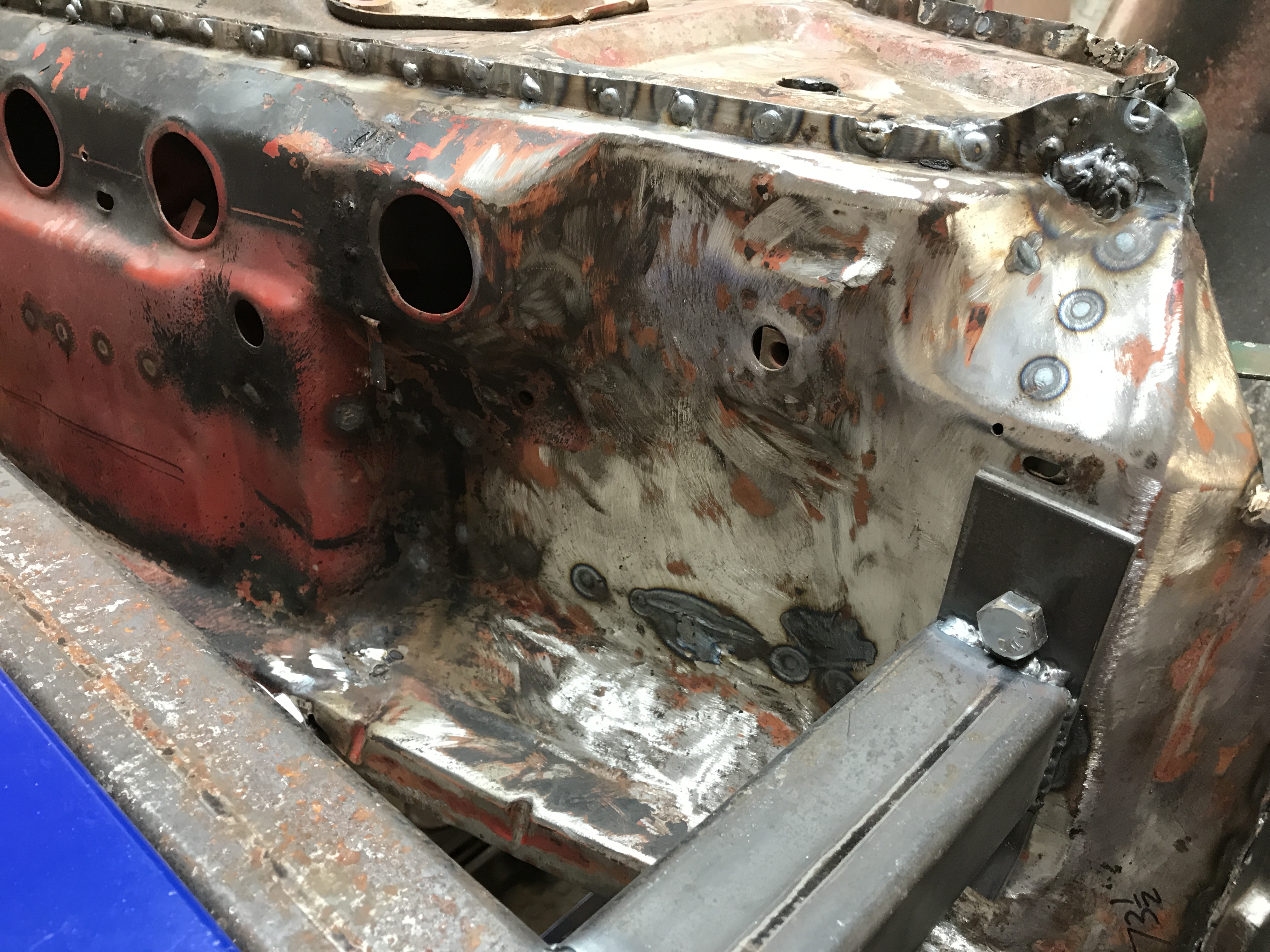

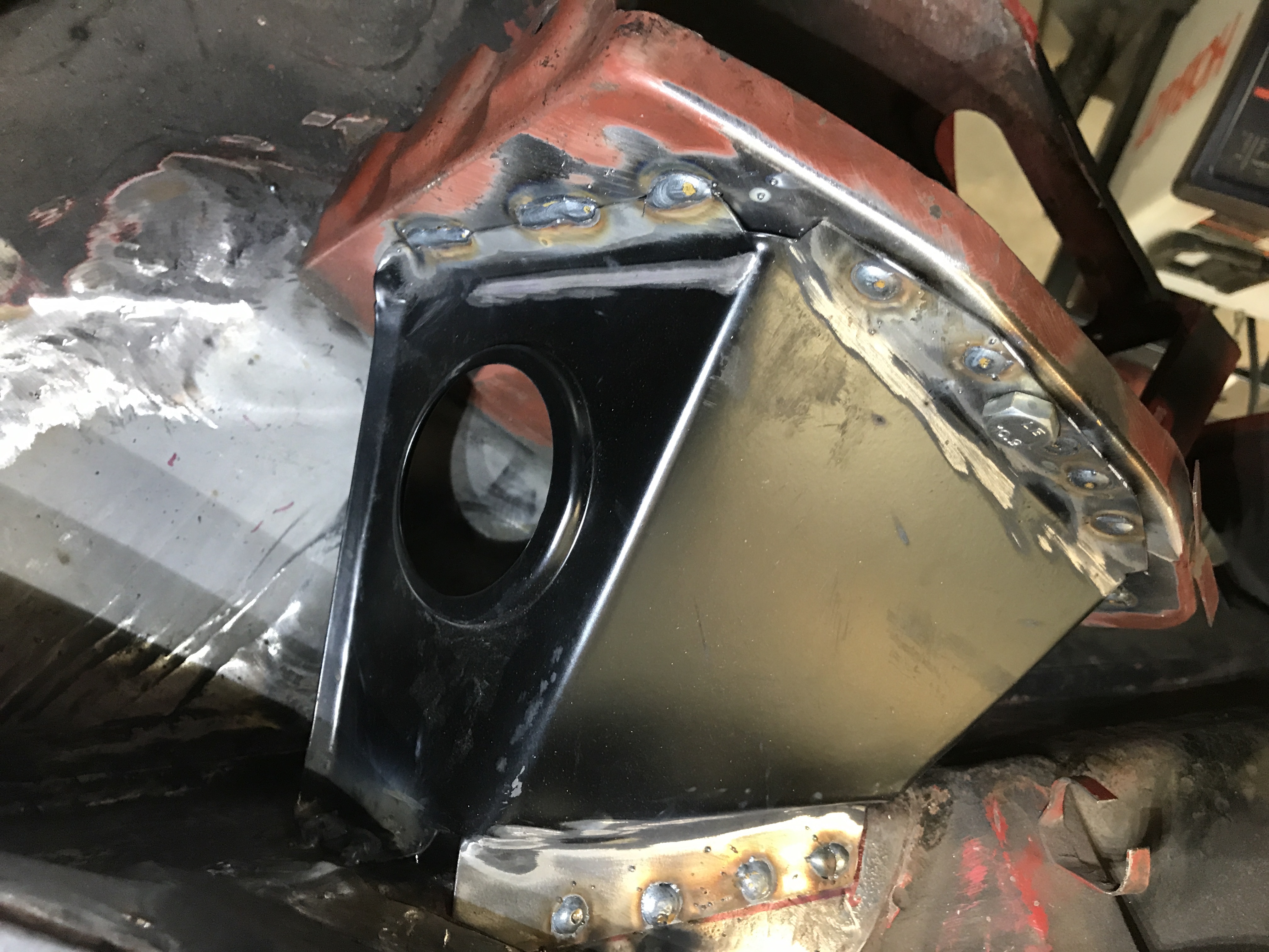

Another bit of progress today. This does not look like much, doing some touch-up welding on the engine compartment rubber seal channel. But this is the last welding job on the list!

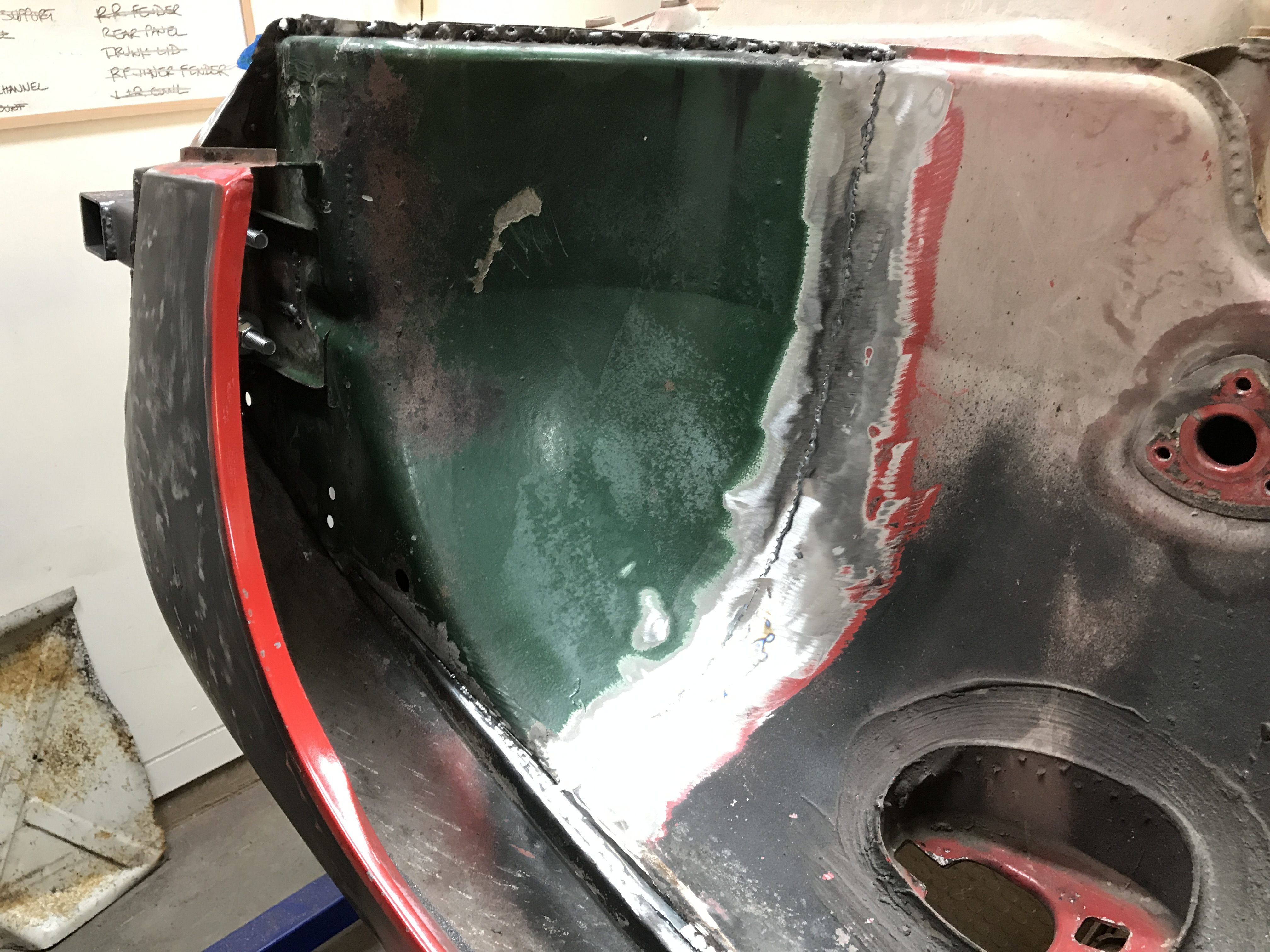

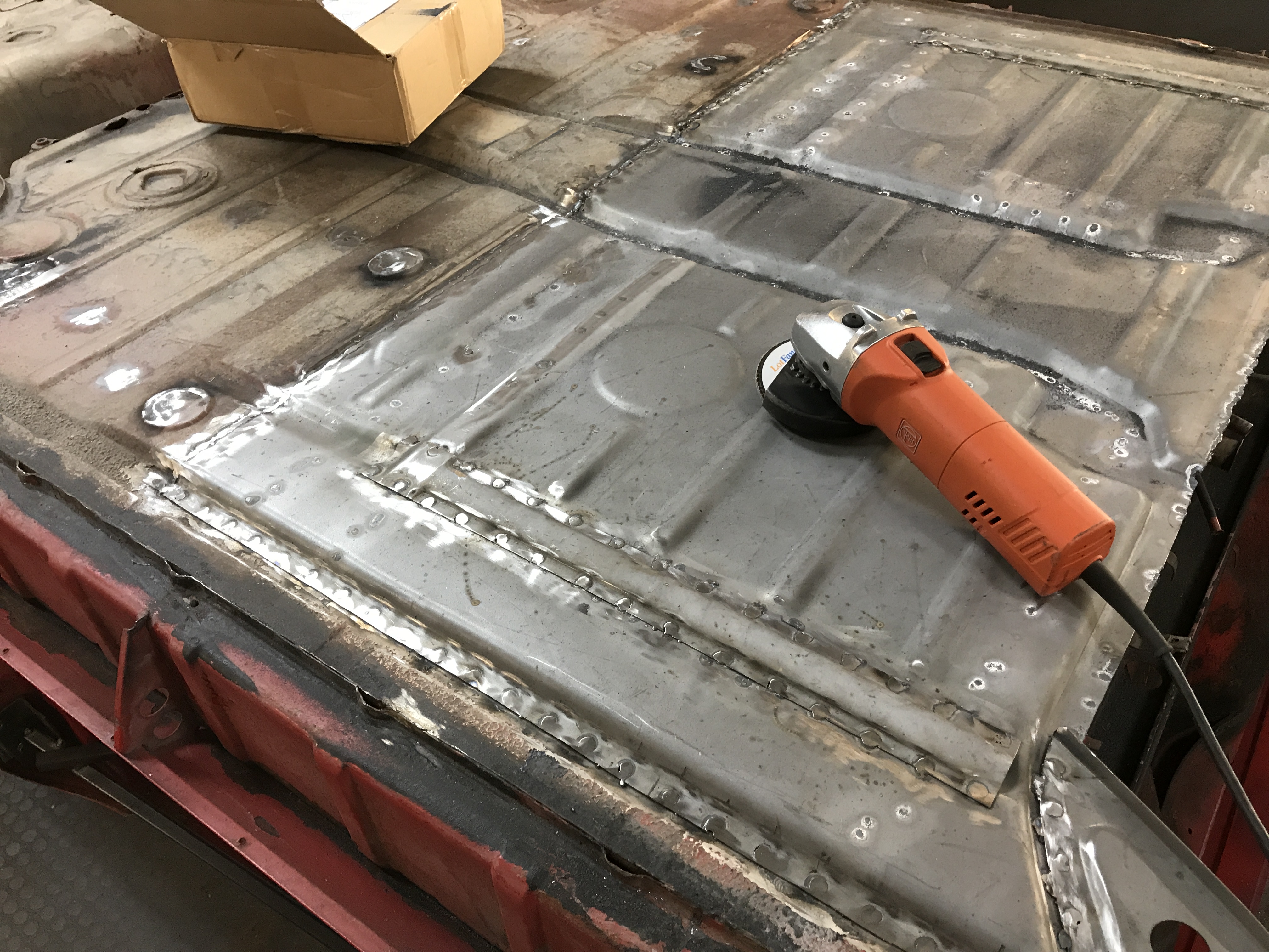

Back to the festival of weld grinding. It does make the plug welds a bit less obvious.

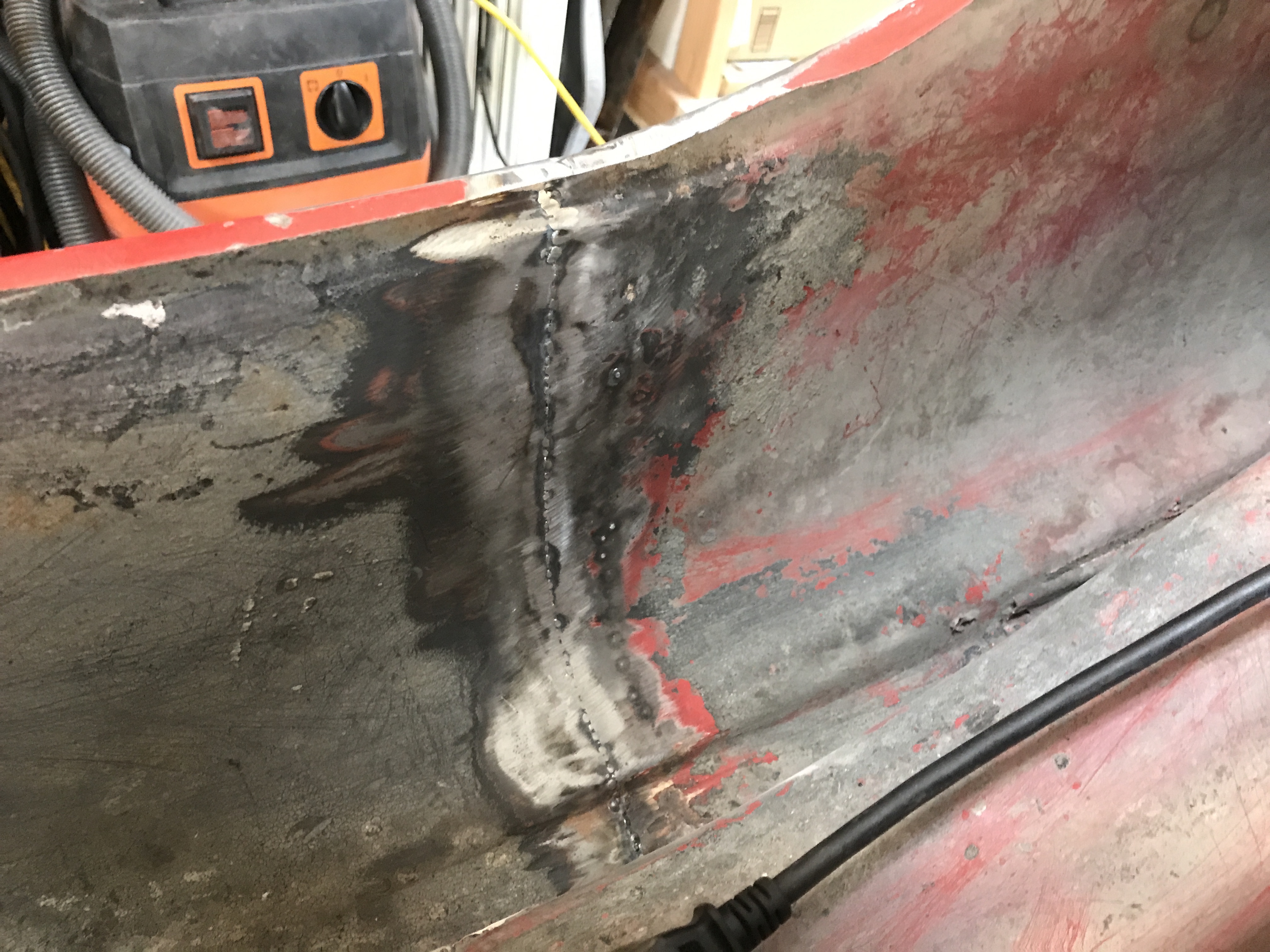

Inside the RR fender.

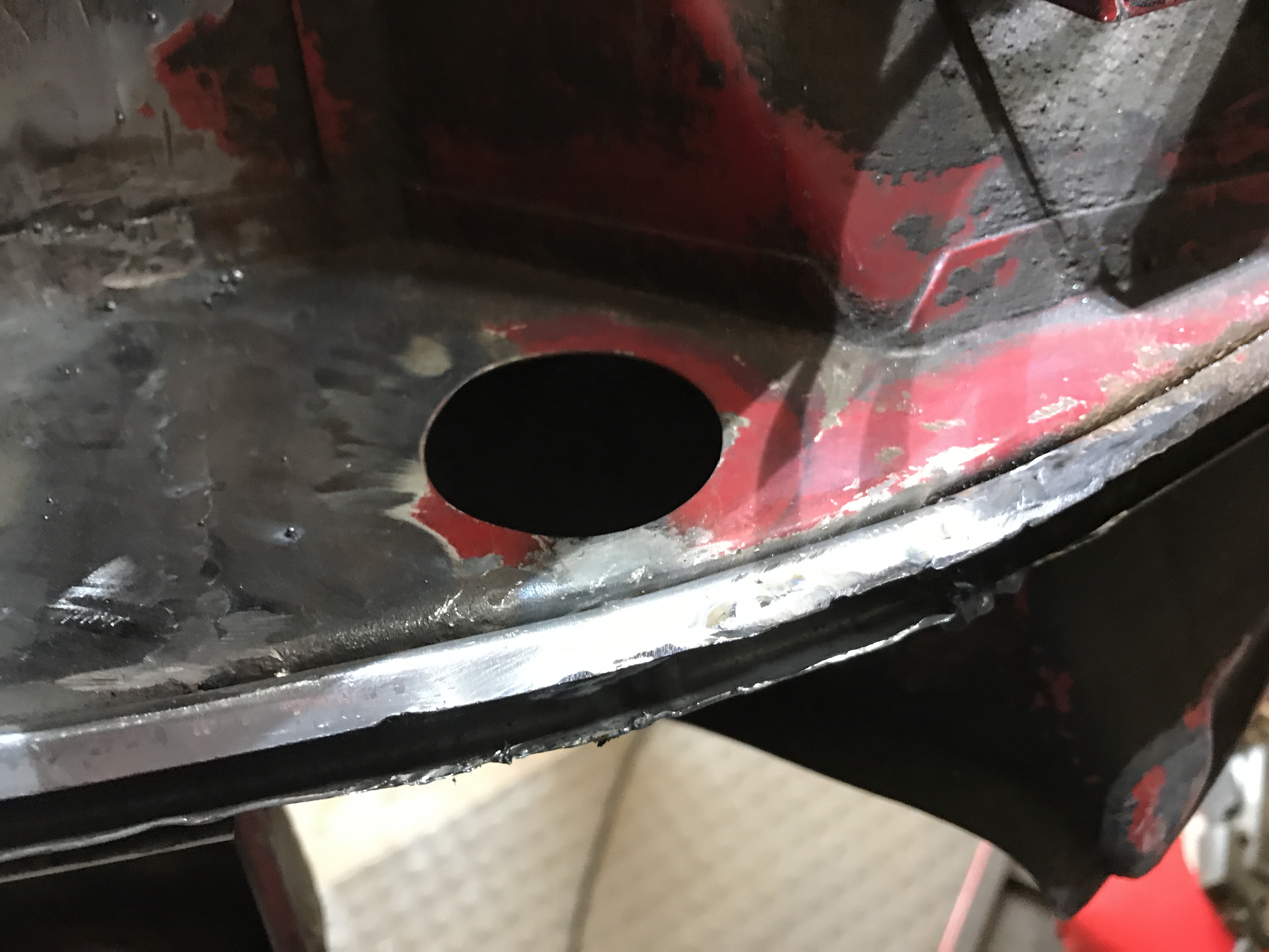

Along the front panel lower seam.
