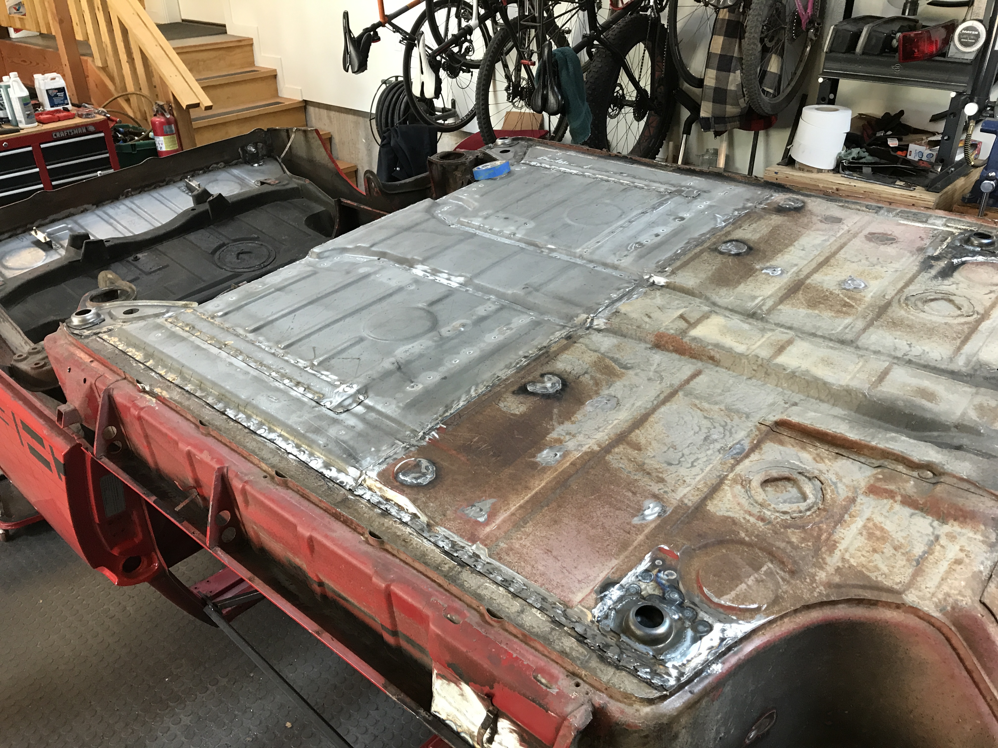

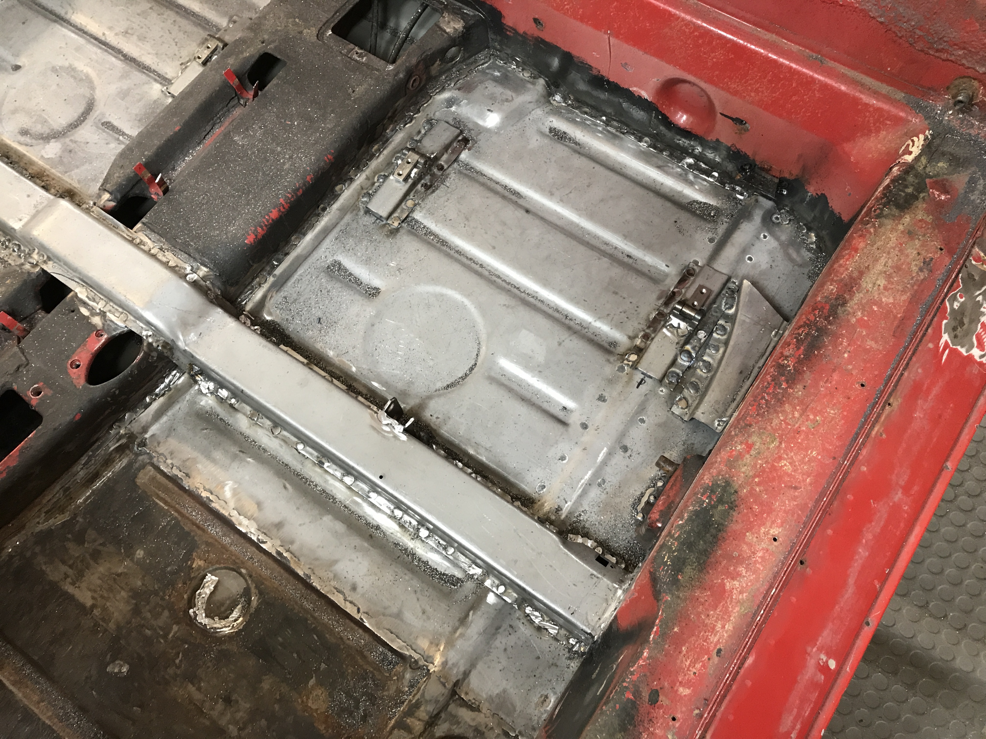

Underside of floor all done.
bkrantz
post May 24 2020, 07:23 PM
Post #702
Posts: 8,342
Joined: 3-August 19
From: SW Colorado
Member No.: 23,343

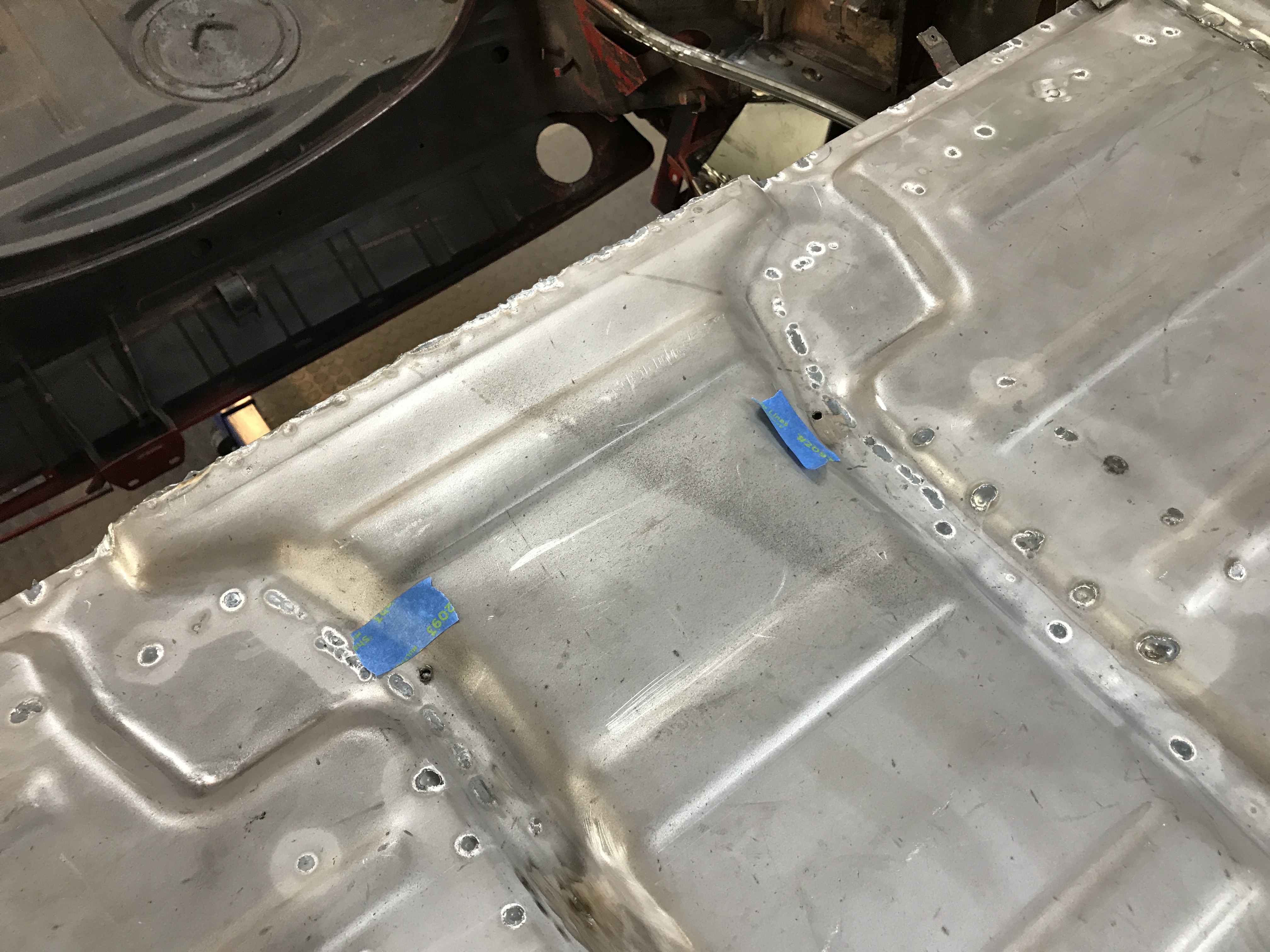

I did find a couple of temporary screw holes from fitting the floor section. These will get welded tomorrow.

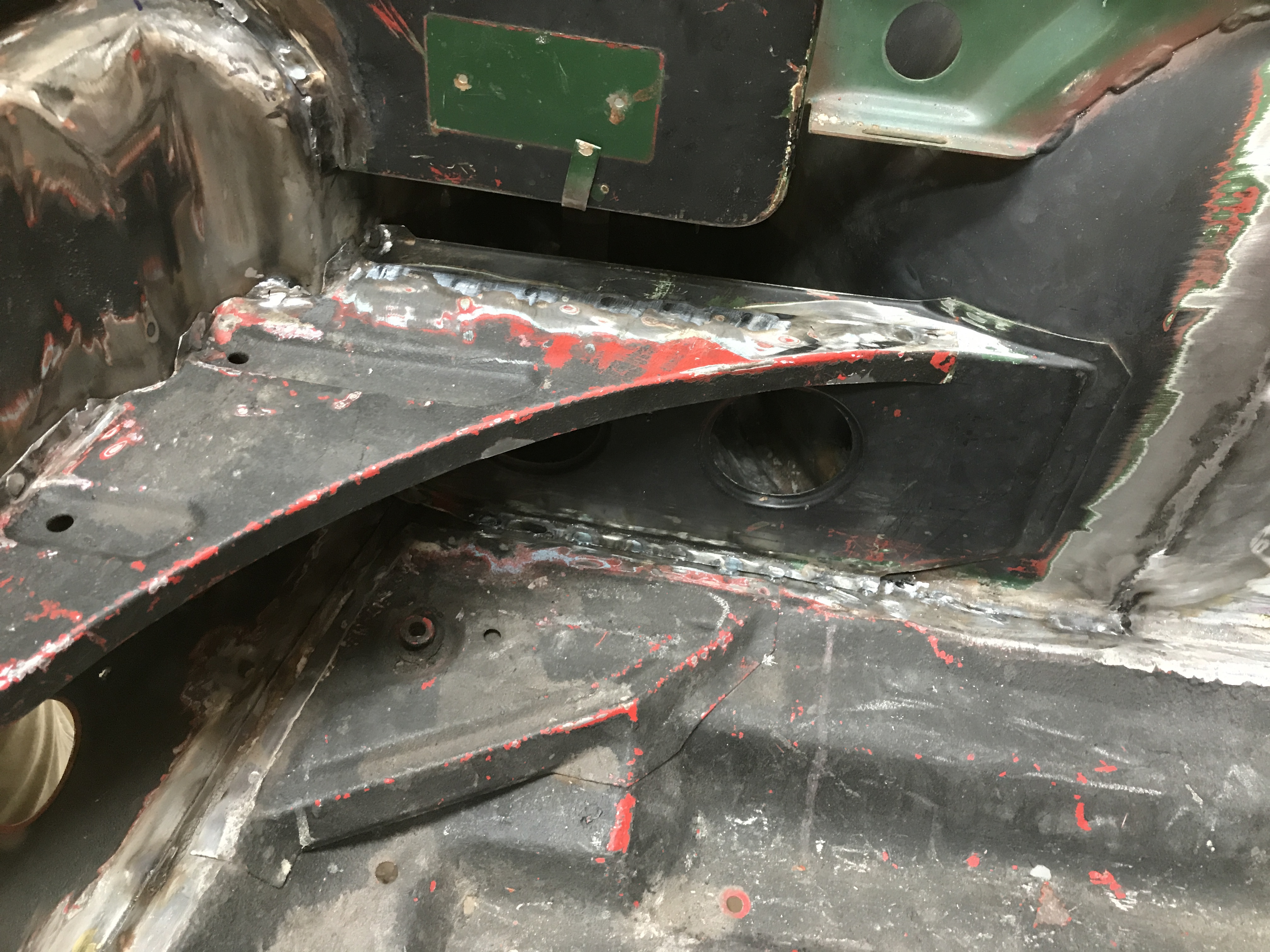

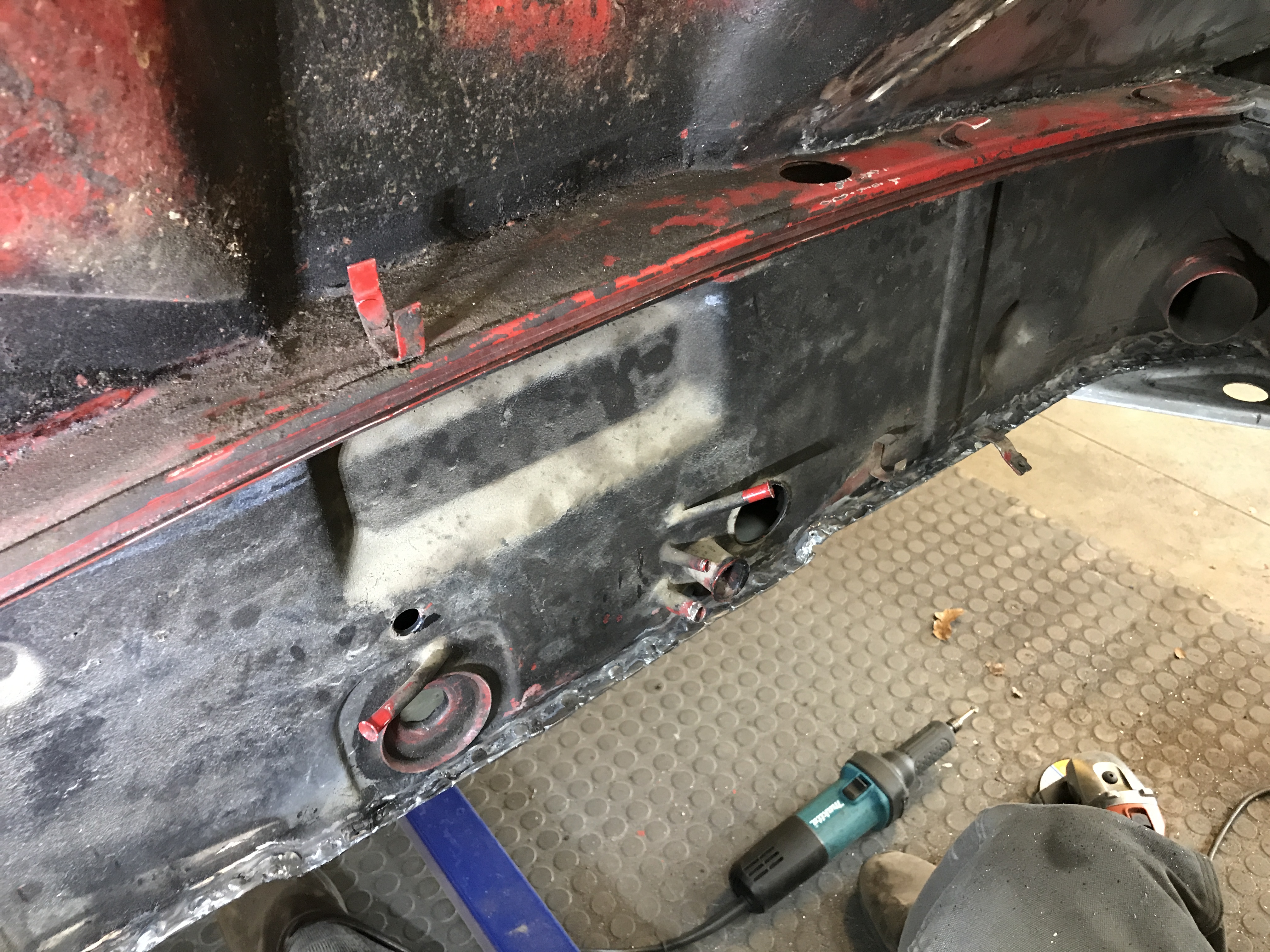

Back to grinding today. My focus was inside the frunk.
bkrantz
post May 25 2020, 07:50 PM
Post #707
Posts: 8,342
Joined: 3-August 19
From: SW Colorado
Member No.: 23,343
Got the frunk finished (unless another weld is hiding somewhere).

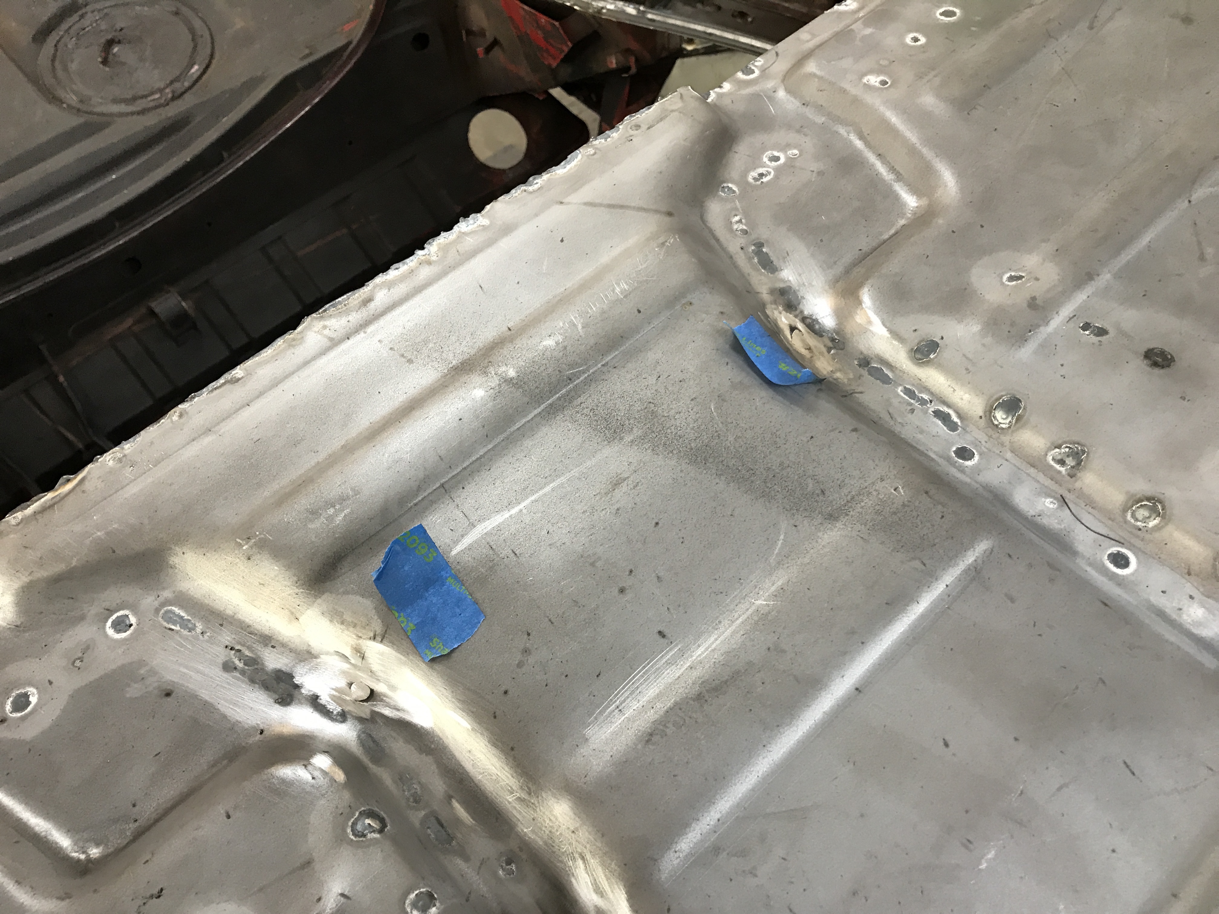

And a quick weld and grind on the floor screw holes.
bkrantz
post May 26 2020, 08:57 PM
Post #709
Posts: 8,342
Joined: 3-August 19
From: SW Colorado
Member No.: 23,343
More grinding today. Got the left side of the inner floor done.

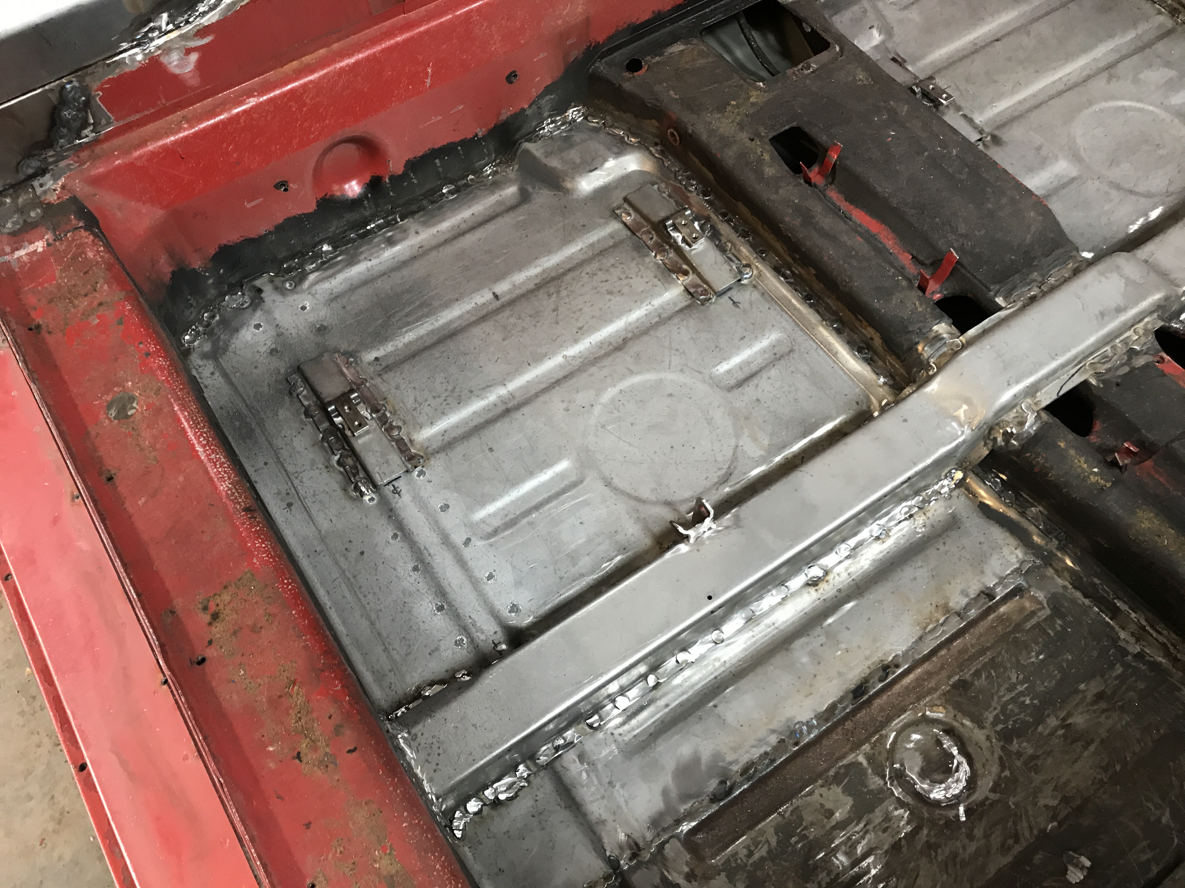

Finished the right side of the floor.

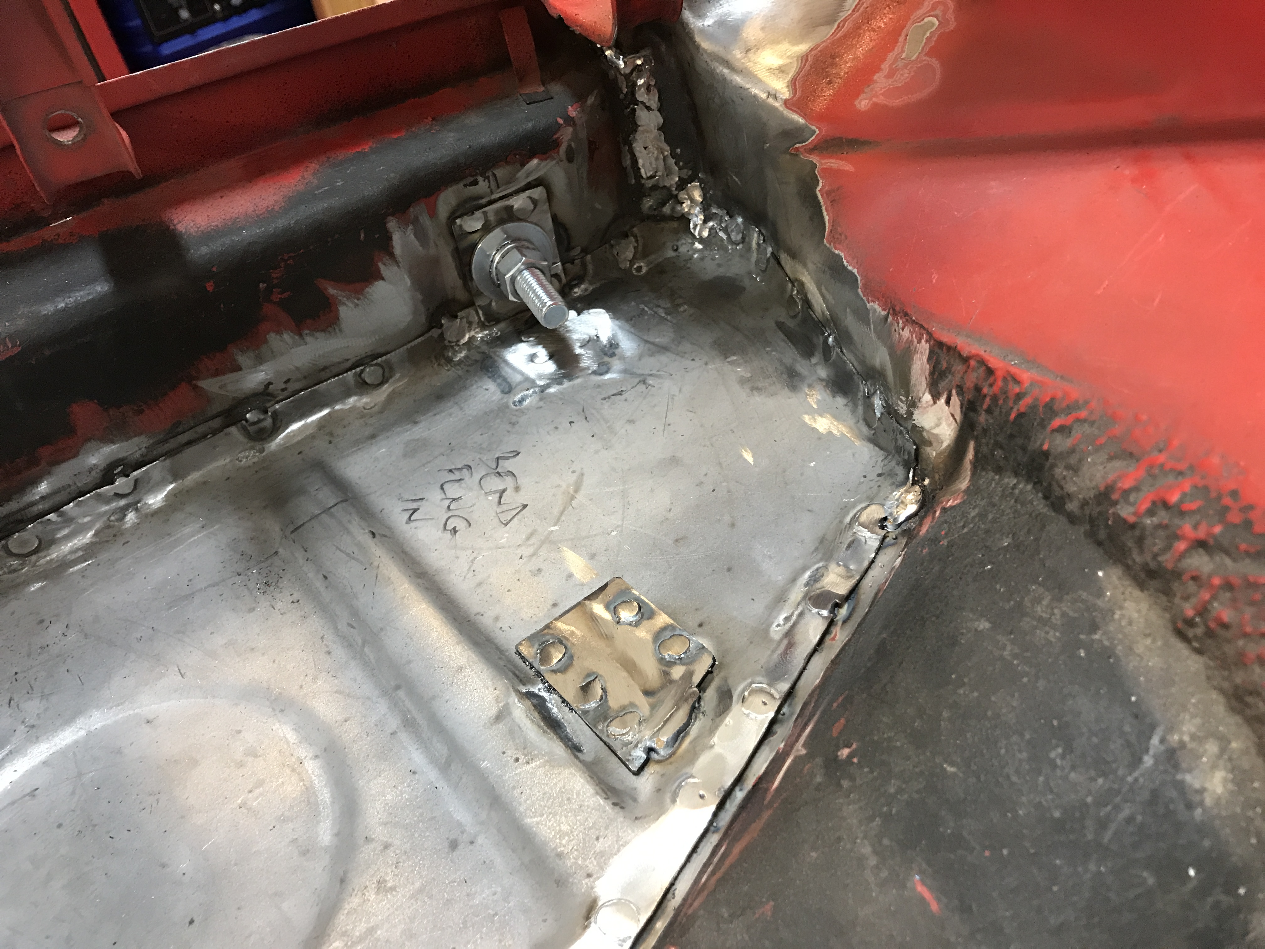

Onto the trunk interior today. Grinding welds is getting old.
bkrantz
post May 28 2020, 08:34 PM
Post #714
Posts: 8,342
Joined: 3-August 19
From: SW Colorado
Member No.: 23,343

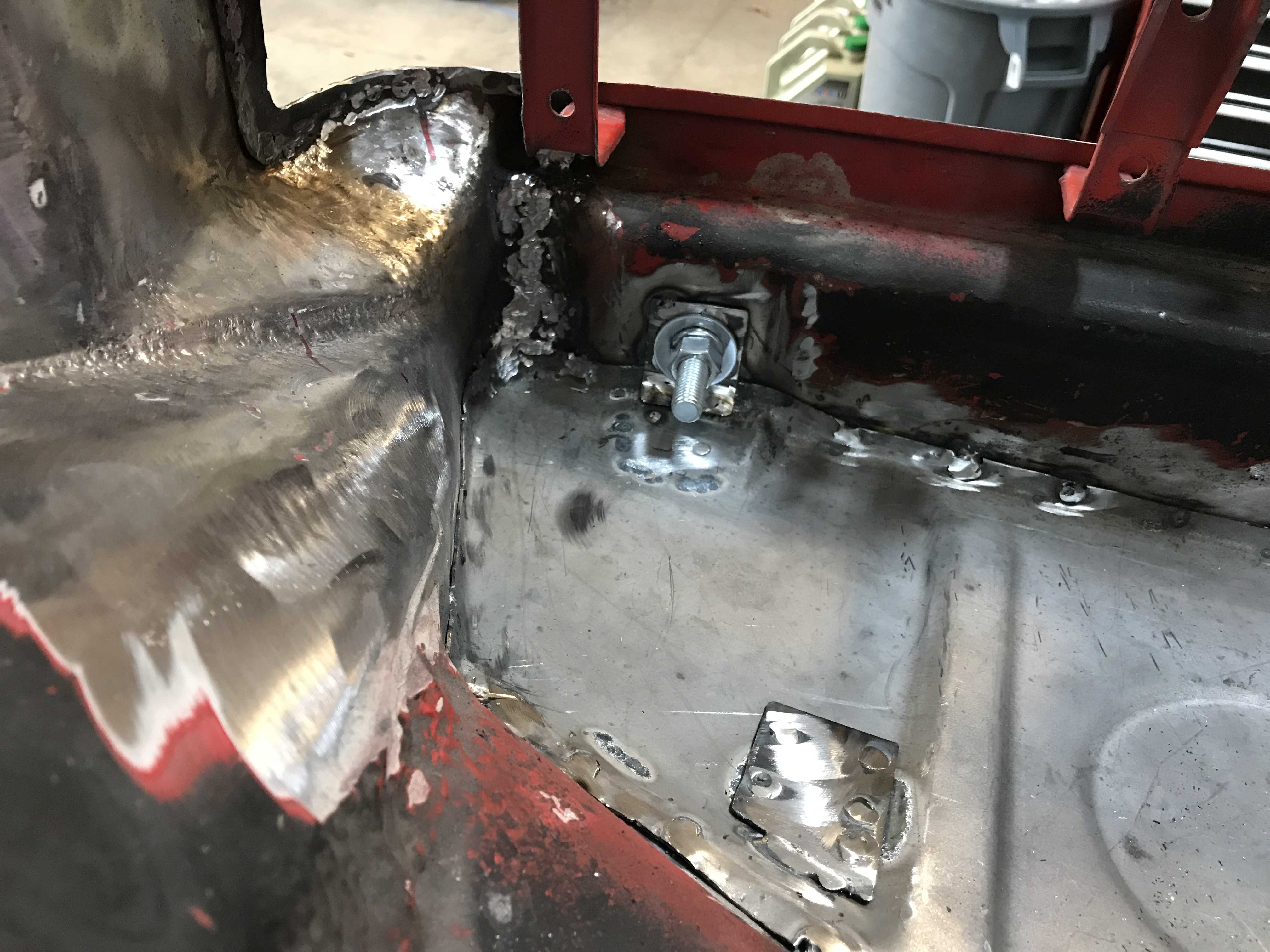

I also took care of the spot welds along the top of the right fender, in the trough.
bkrantz
post May 29 2020, 08:18 PM
Post #715
Posts: 8,342
Joined: 3-August 19
From: SW Colorado
Member No.: 23,343

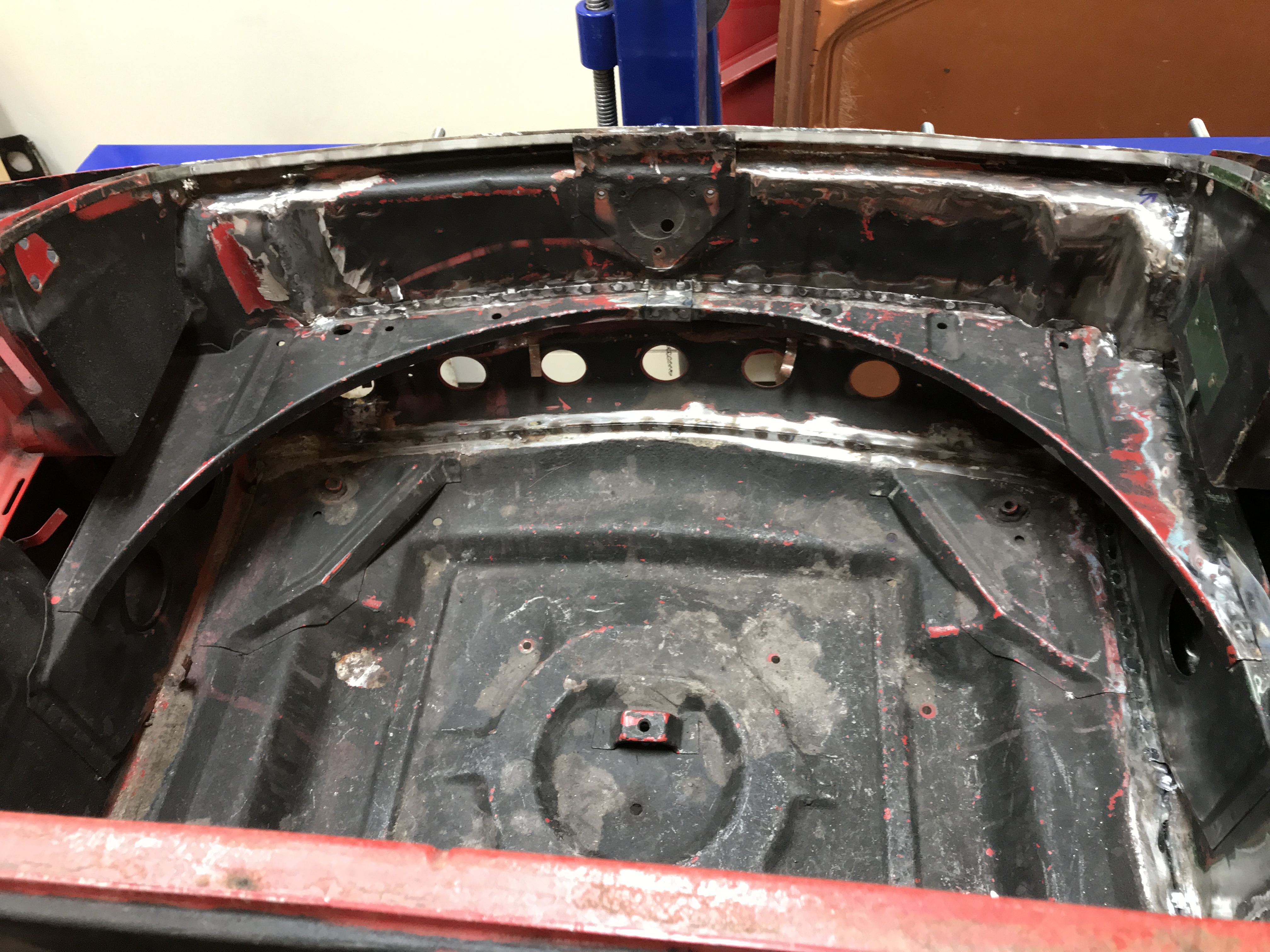

The trunk is done.

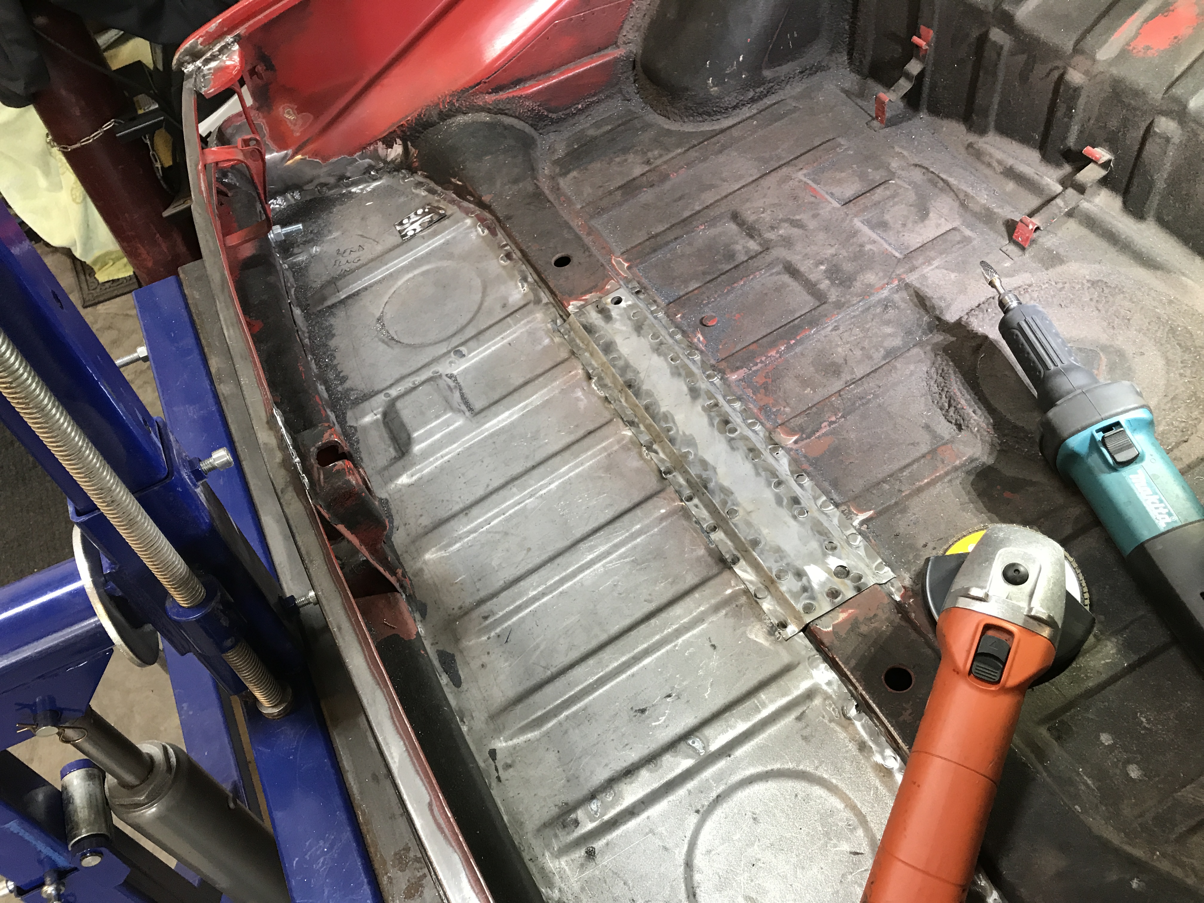

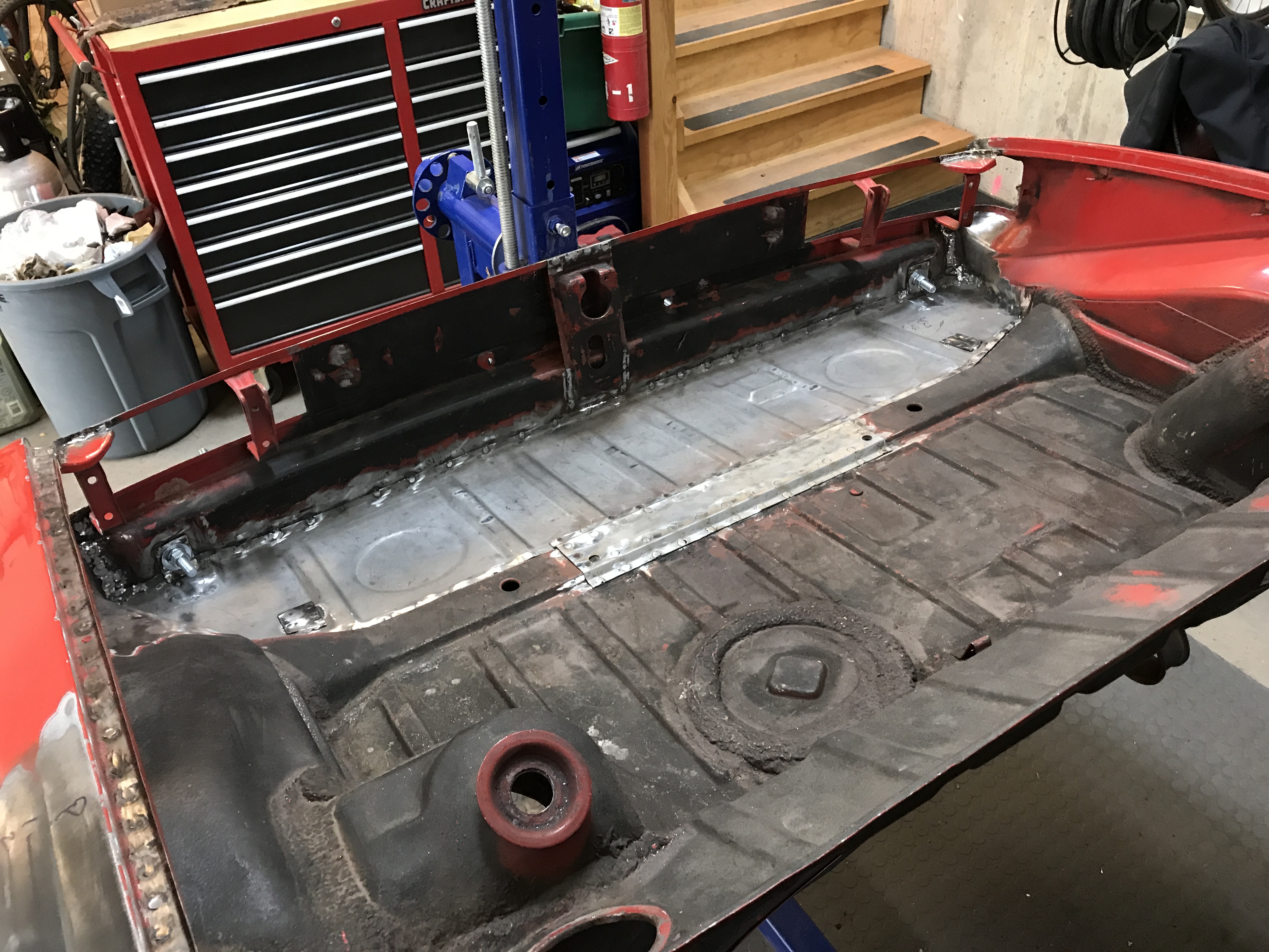

I took care of all weld grinding (as least the ones I can reach) in the engine compartment today. Most of that was along the seam on the rear edge of the floor panel, where I duplicated the factory edge weld in addition to some plug welds.
Lilchopshop
post Jun 1 2020, 01:04 PM
Post #719
Posts: 85
Joined: 17-February 20
From: New York
Member No.: 23,932

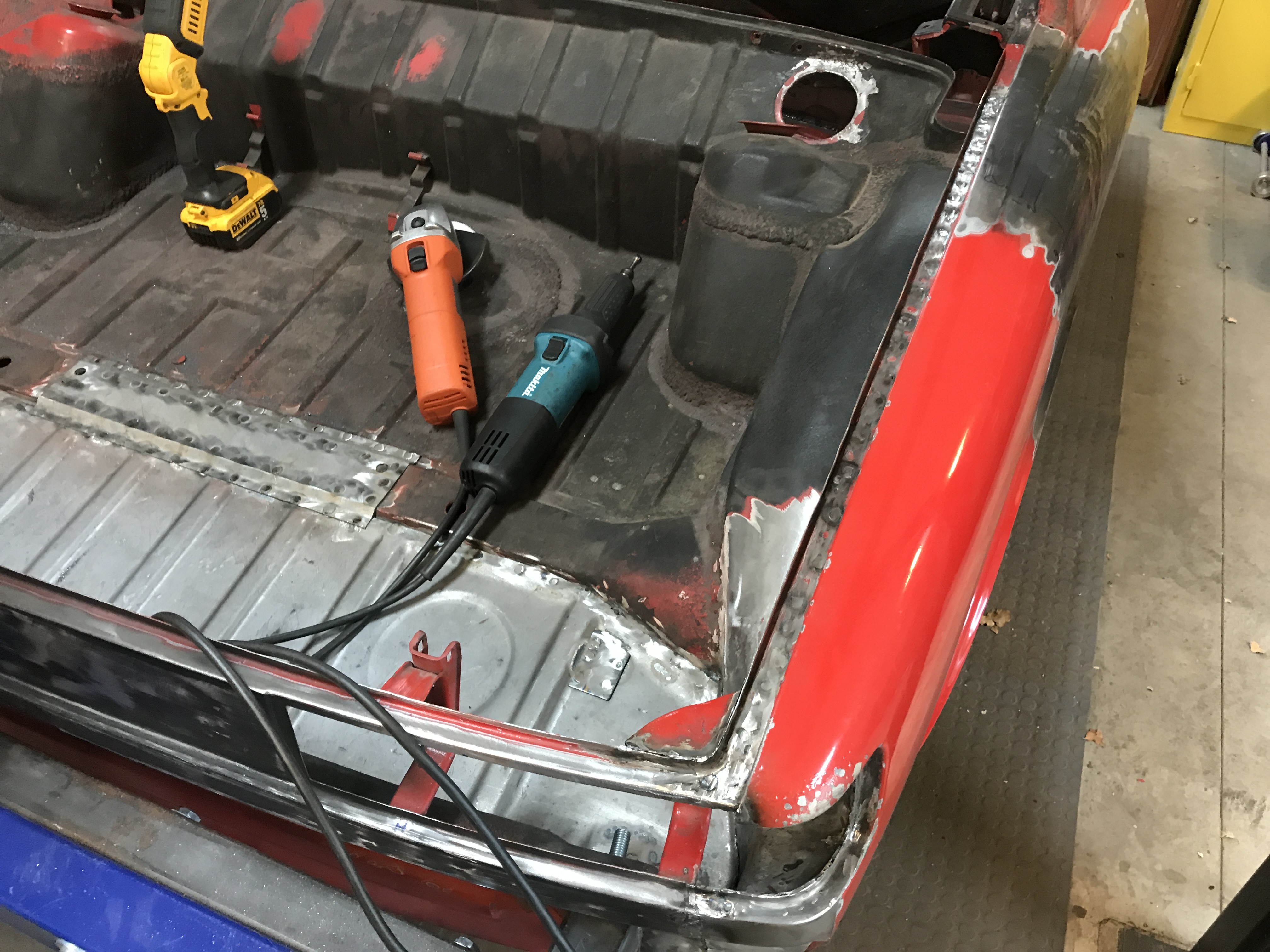

I notice you’re using an electric die grinder with carbide burrs. How do you like this setup for grinding welds? I’ve been alternating between using a 4.5 inch angle grinder and a dremel tool with a cutoff wheel for grinding welds. The dremel tool is great for precise control, but it’s very slow. Been contemplating buying the same tools you show in your pictures.
Thanks,
bkrantz
post Jun 1 2020, 08:47 PM
Post #720
Posts: 8,342
Joined: 3-August 19
From: SW Colorado
Member No.: 23,343
QUOTE(Lilchopshop @ Jun 1 2020, 01:04 PM) *
Thanks,
I like it very much. It cuts quicker (beware!) and reaches into corners. Of course, it also leaves a more irregular surface unless I am VERY patient and careful.
