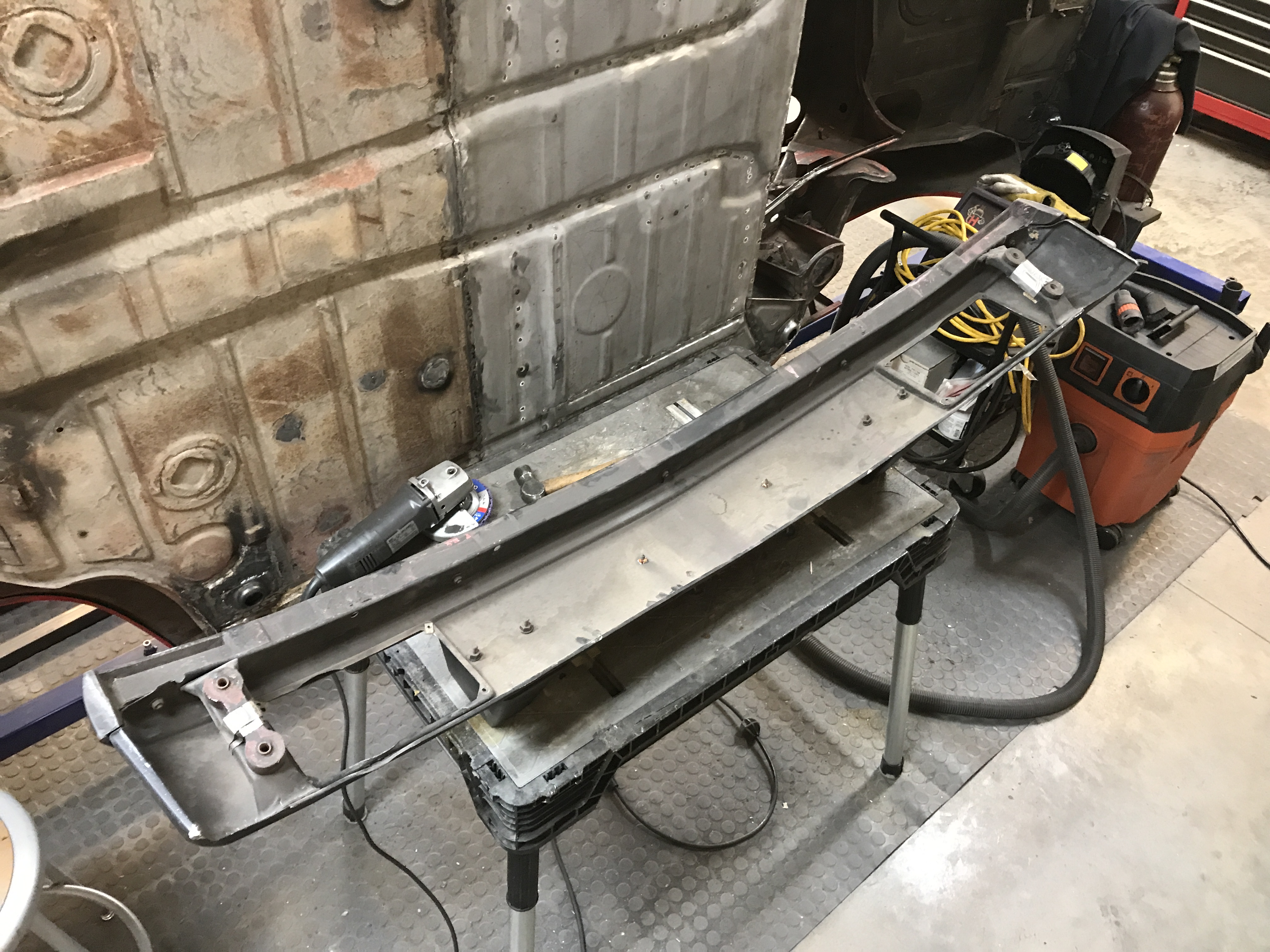

Working on the rear bumper today.

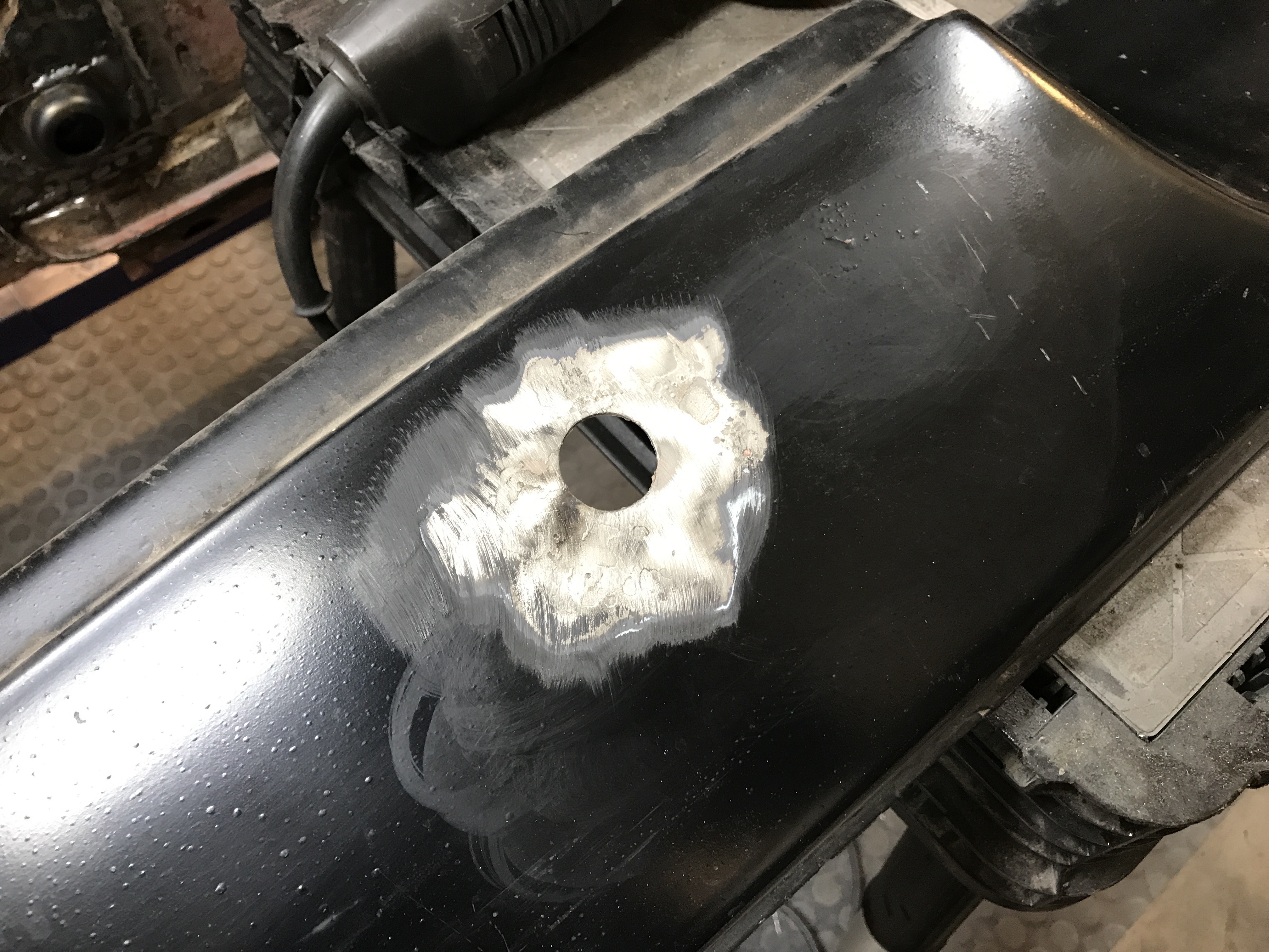

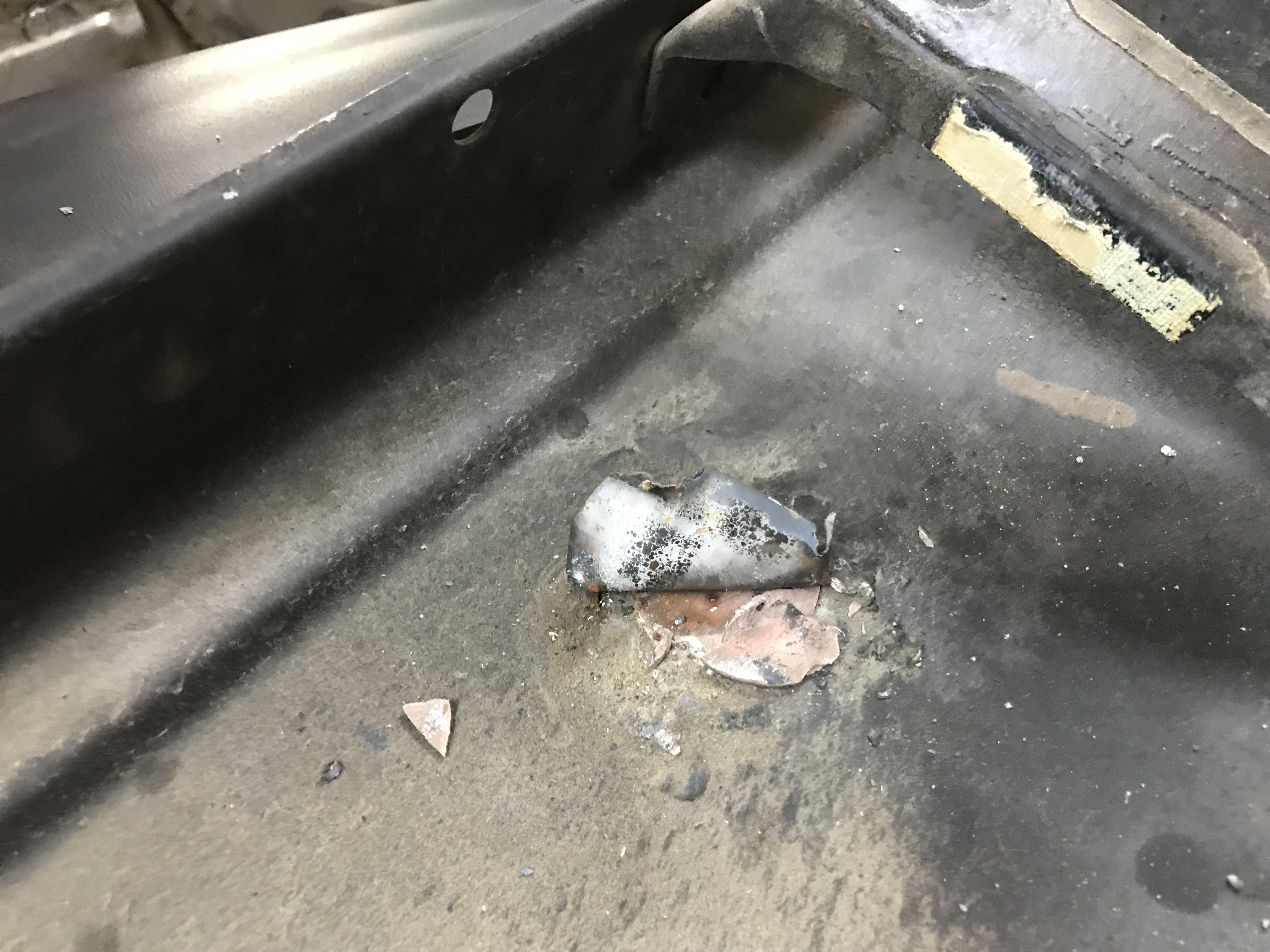

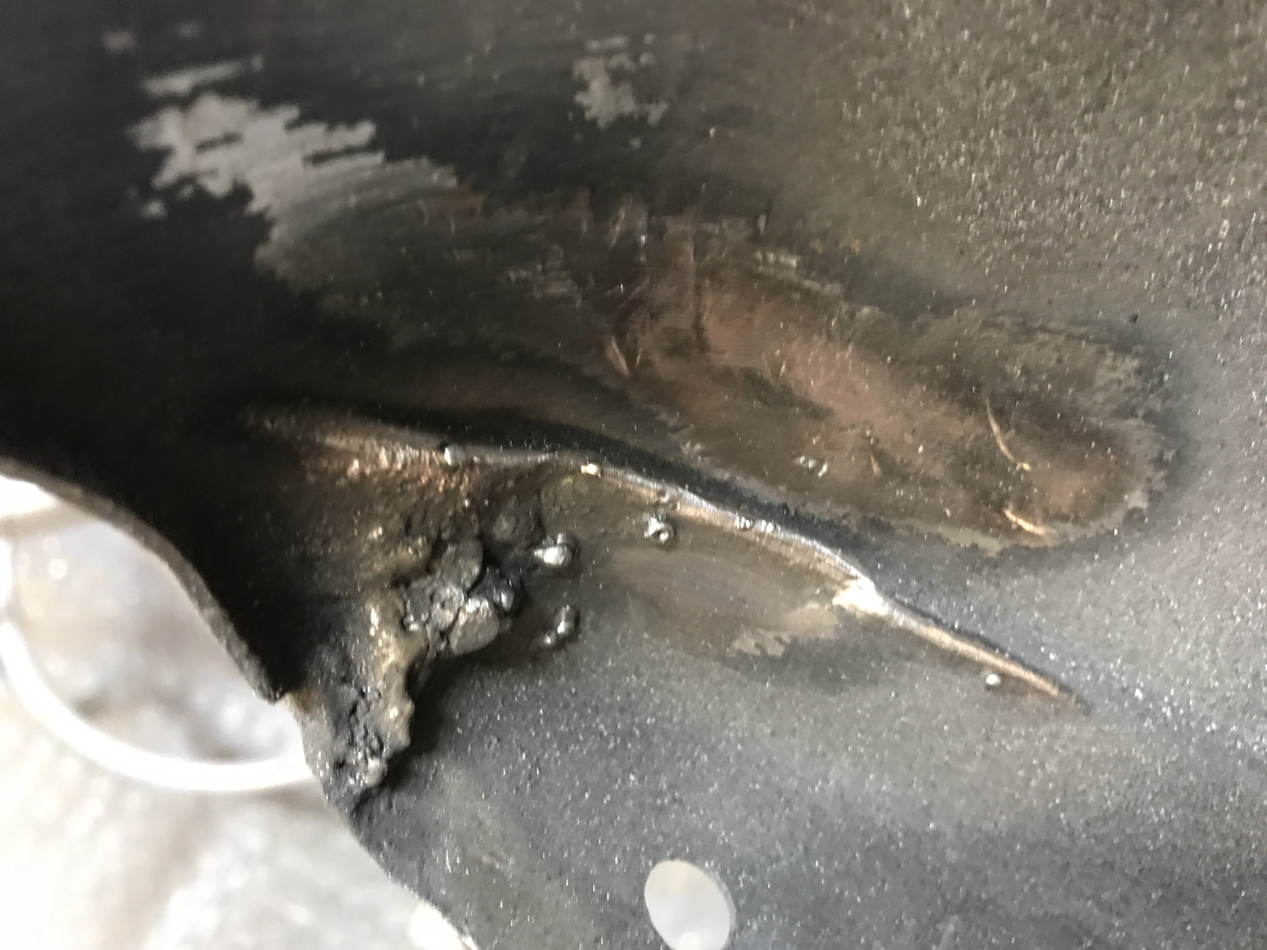

Here's how the PO filled the towing eye hole, with a sheet metal patch brazed on the inside.
bkrantz
post Jun 12 2020, 08:57 PM
Post #764
Posts: 8,342
Joined: 3-August 19
From: SW Colorado
Member No.: 23,343
After some grinding to clear up the hole. Looks a bit ragged.

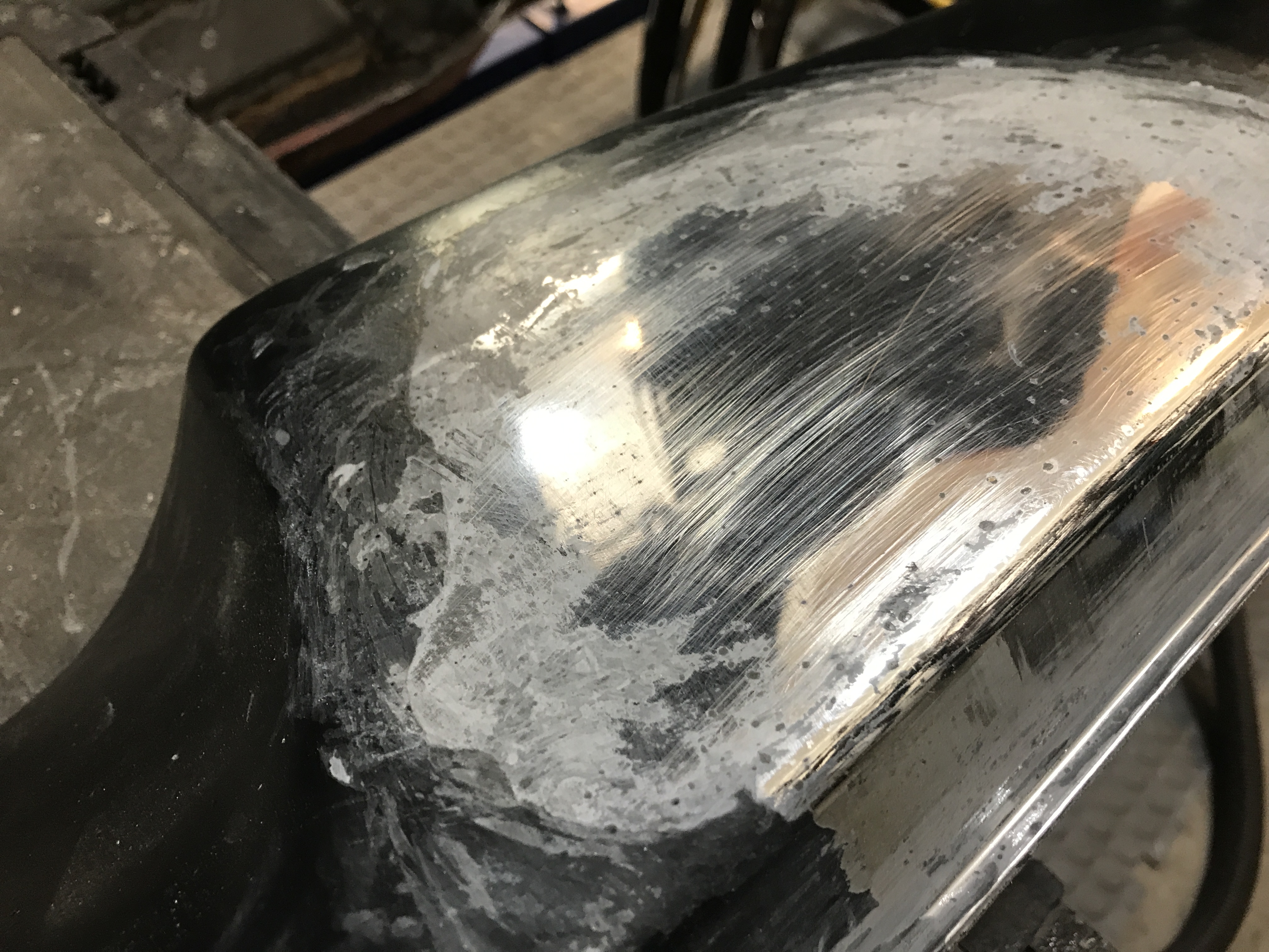

This is a chrome bumper, but the PO attacked it with sandpaper before painting it black.

The rear bumper has a few minor dings but is in good shape overall.

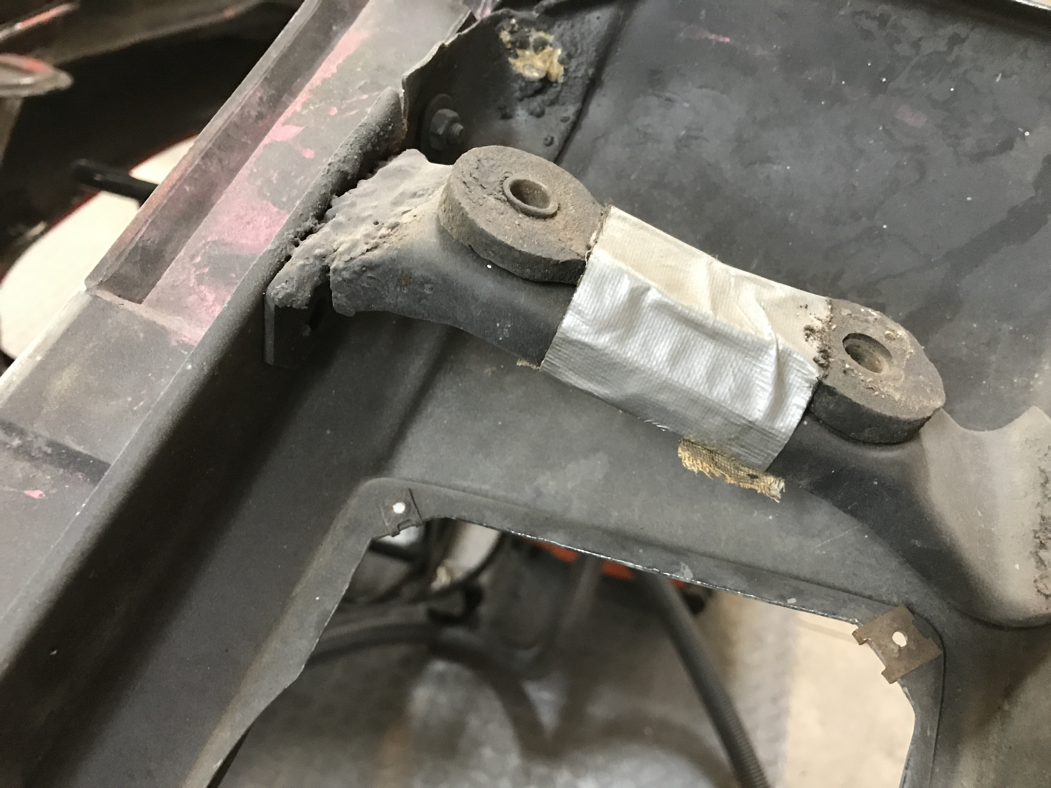

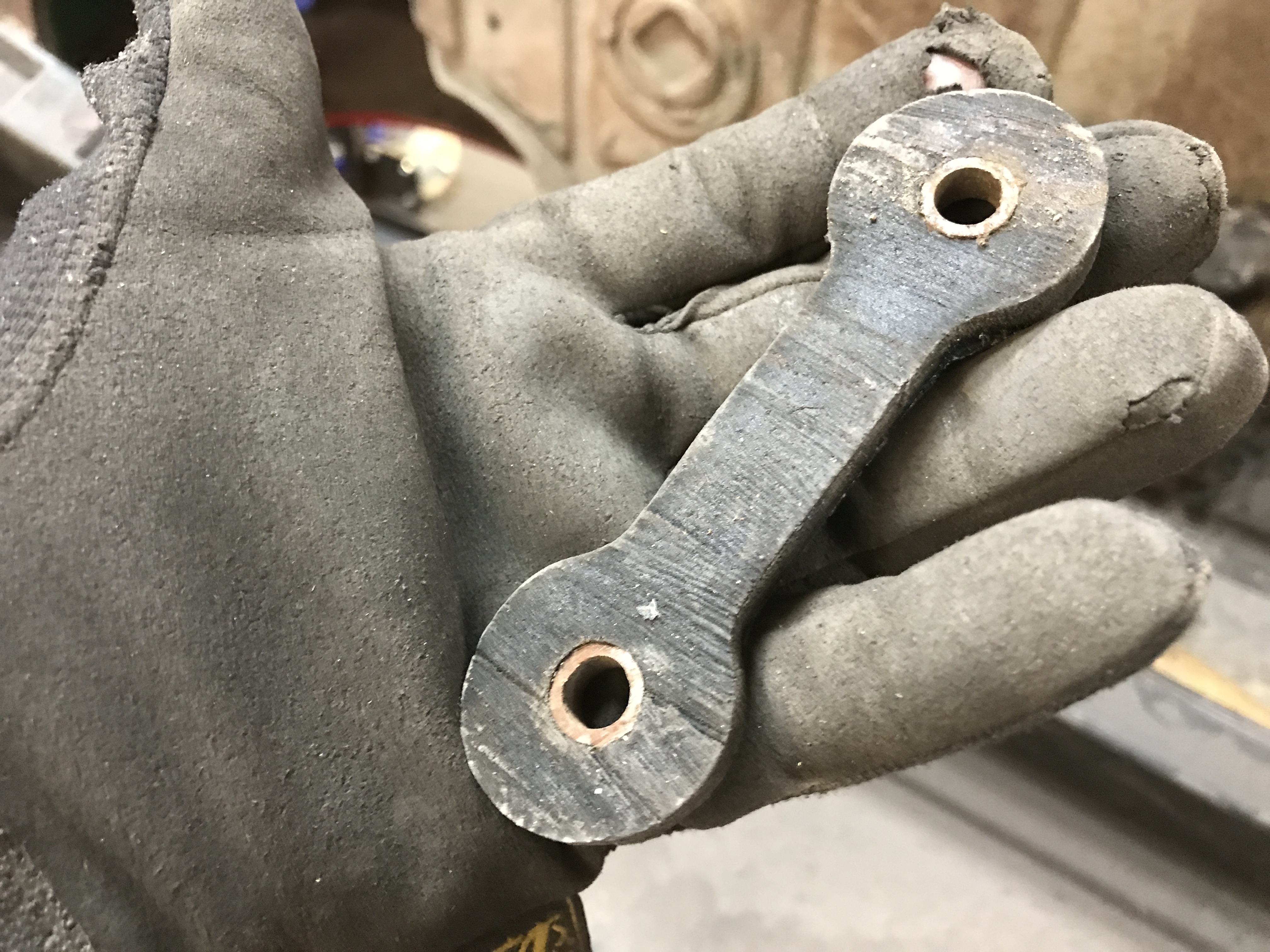

How about a custom dog bone--half thickness?

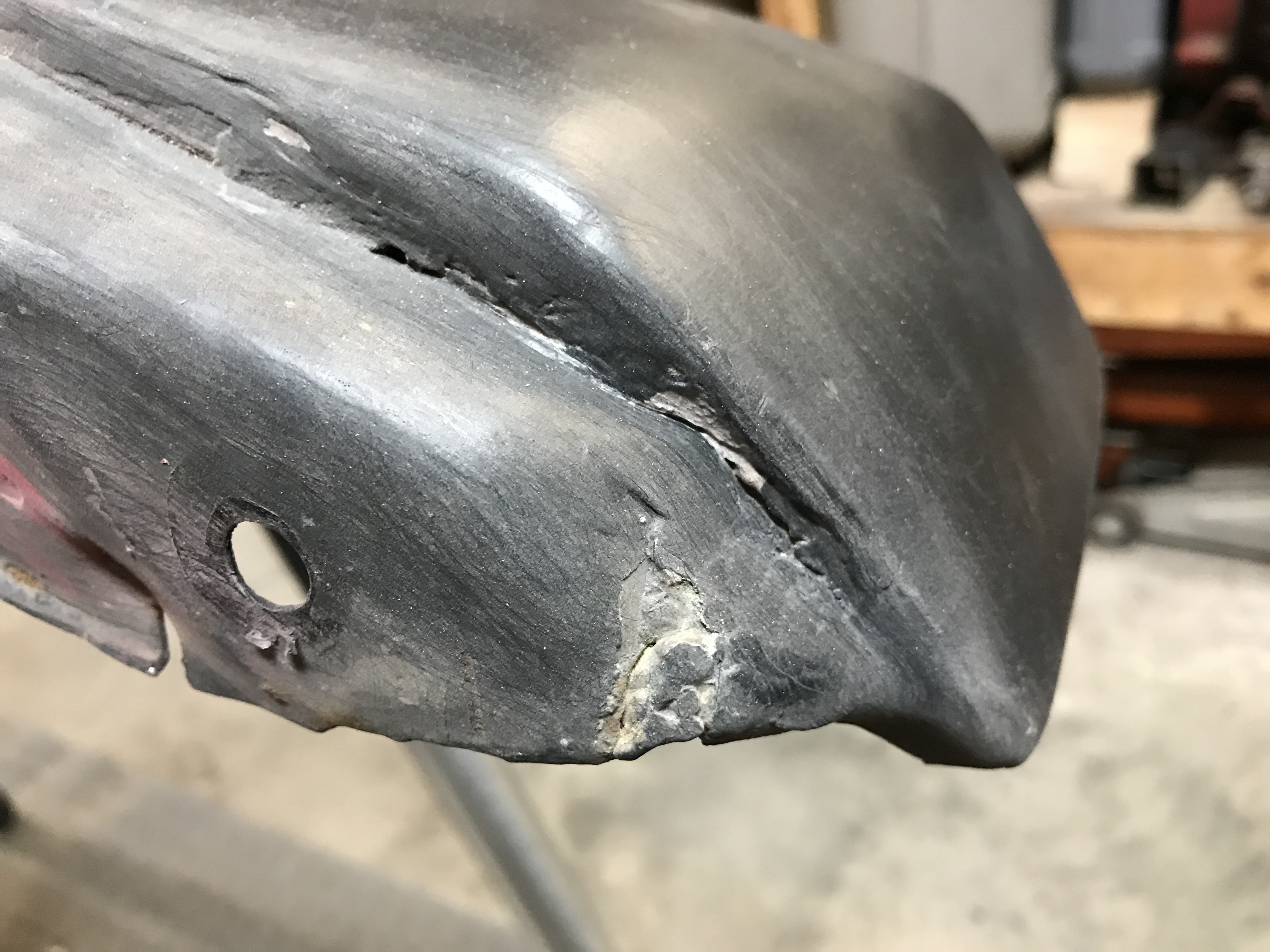

But after a big of work with the wire wheel, surprise! That's about 1/2 inch of bondo.

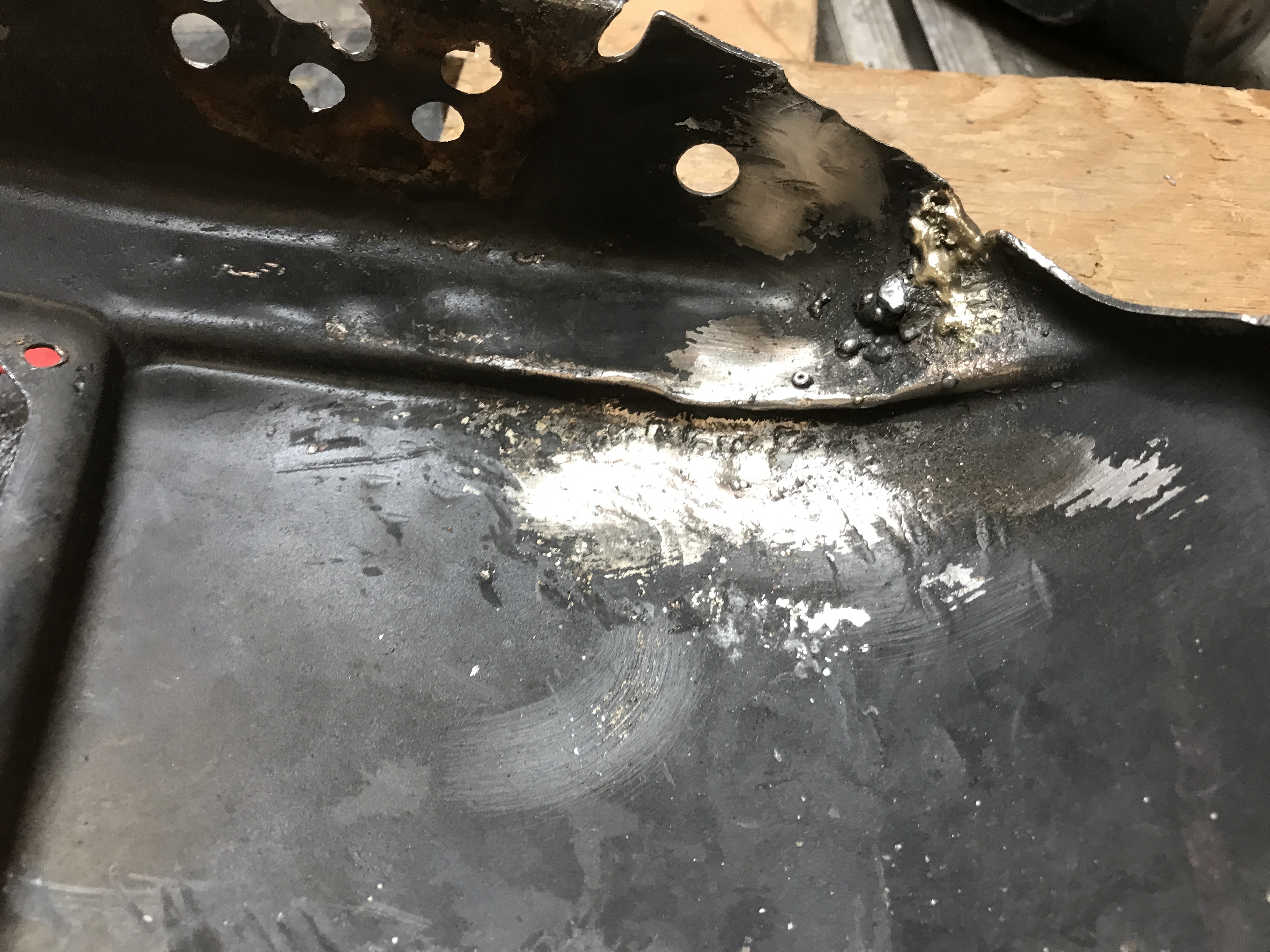

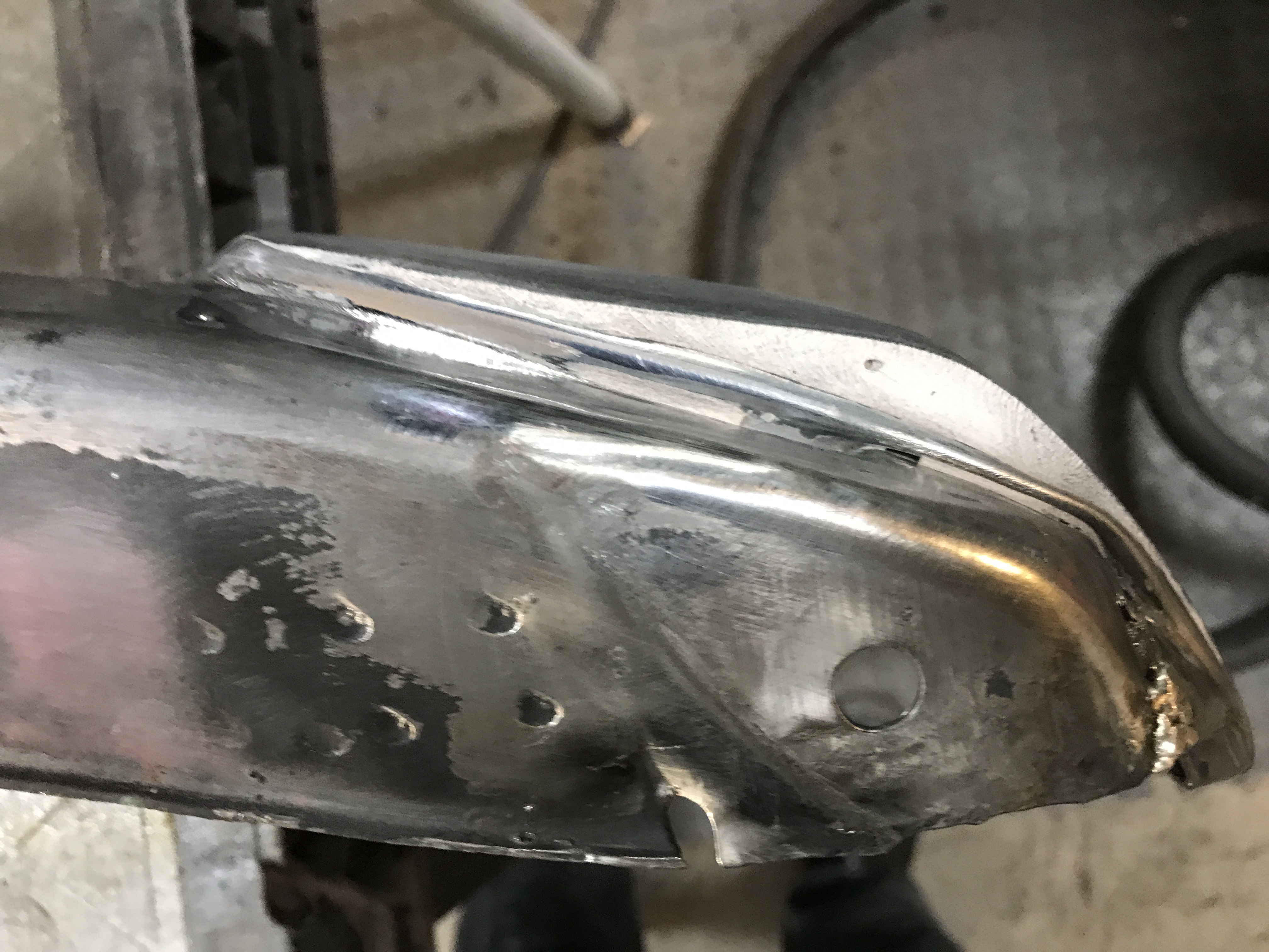

The inside also shows how the fender got crimped.
bkrantz
post Jun 12 2020, 09:09 PM
Post #773
Posts: 8,342
Joined: 3-August 19
From: SW Colorado
Member No.: 23,343
After removing the rest of the bondo, it looks pretty ugly.

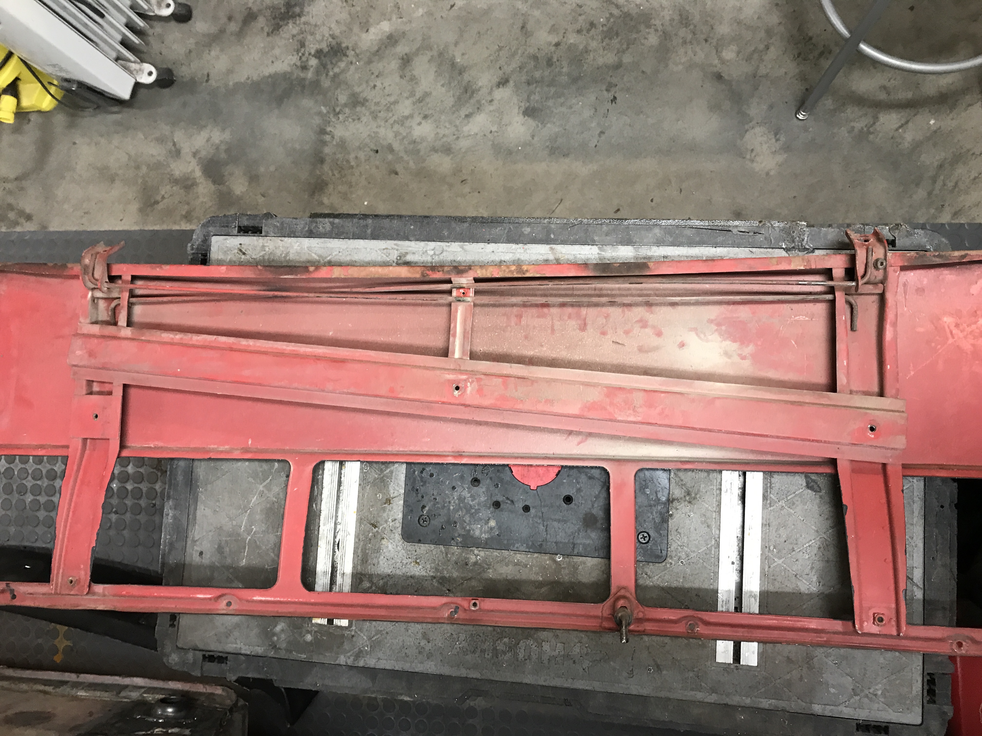

Today, I remember to strip the engine lid (torsion bars, latch peg)--and also made sure it had no surprises.

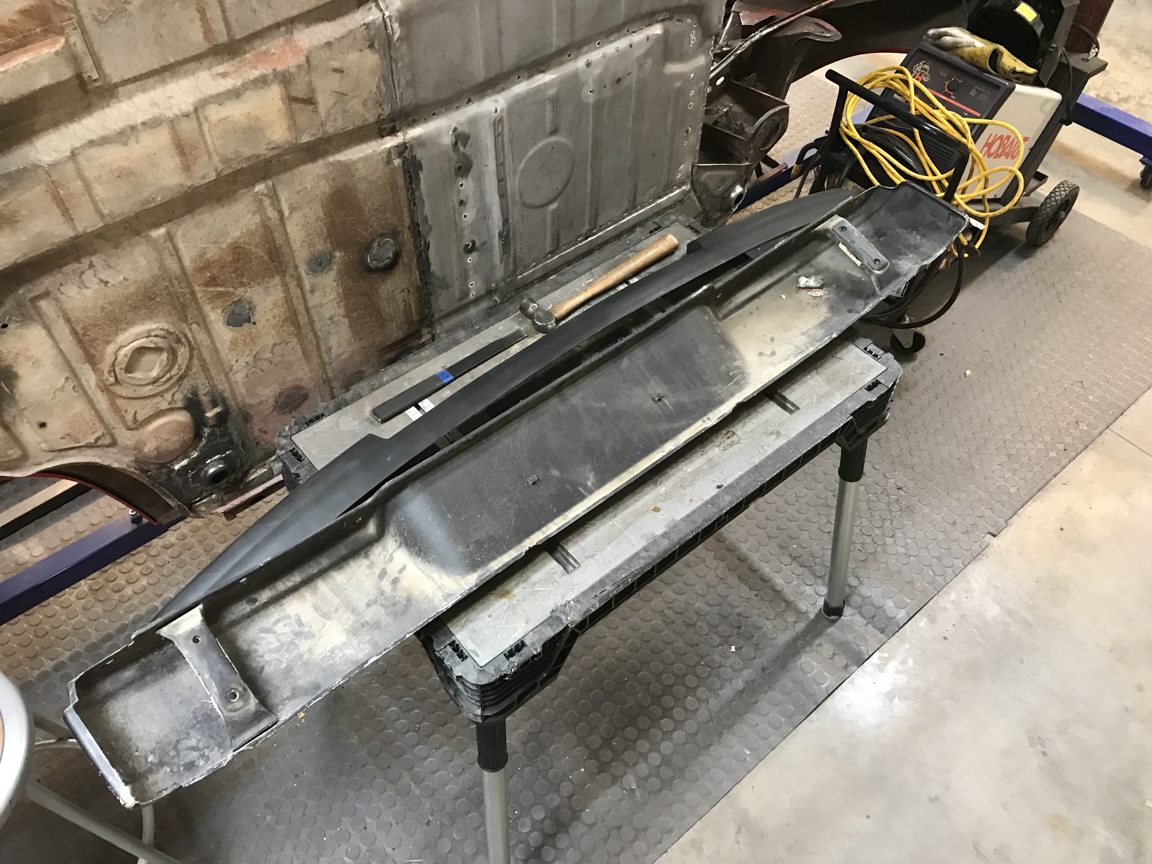

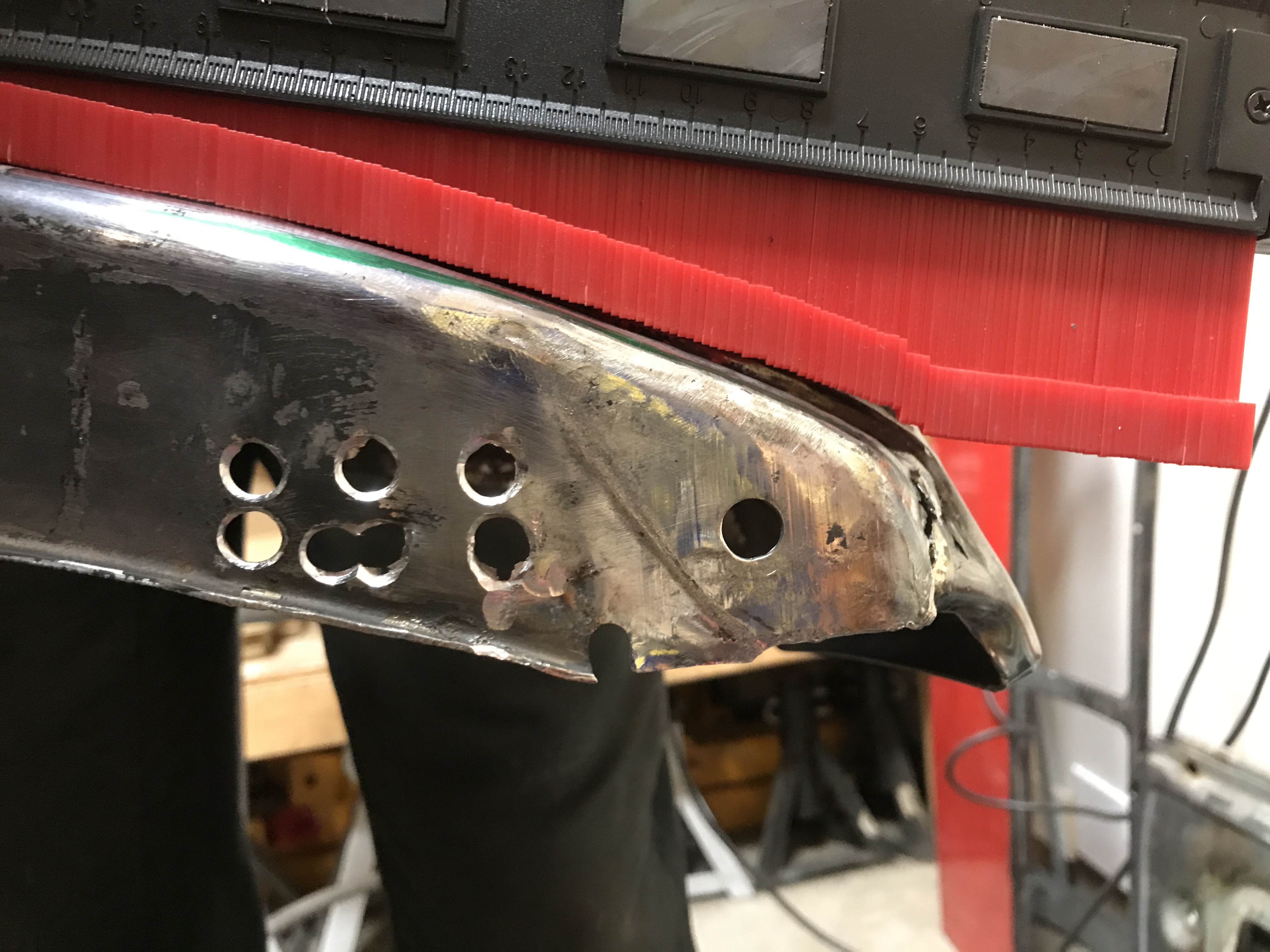

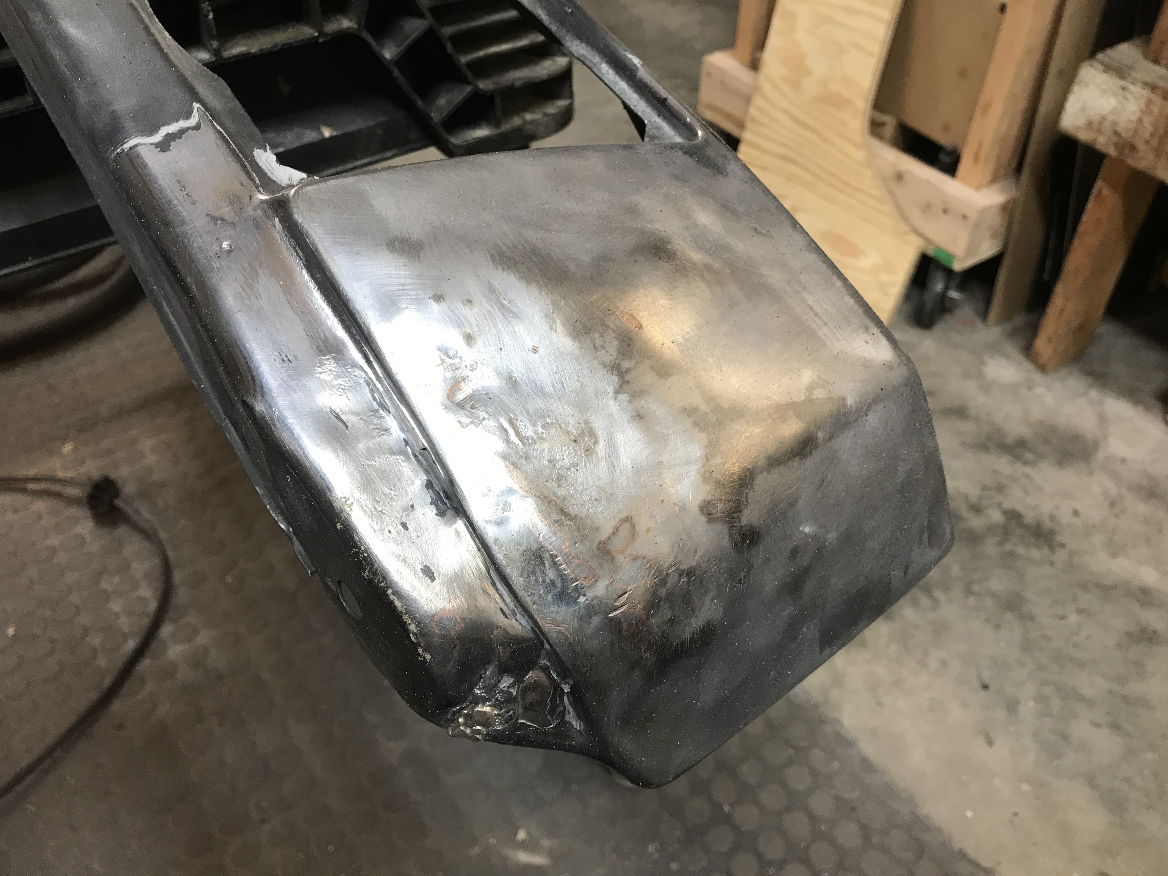

Spent a few frustrating hours working on the front bumper end today.
Here is how much the end profile is off, compared to the other side.

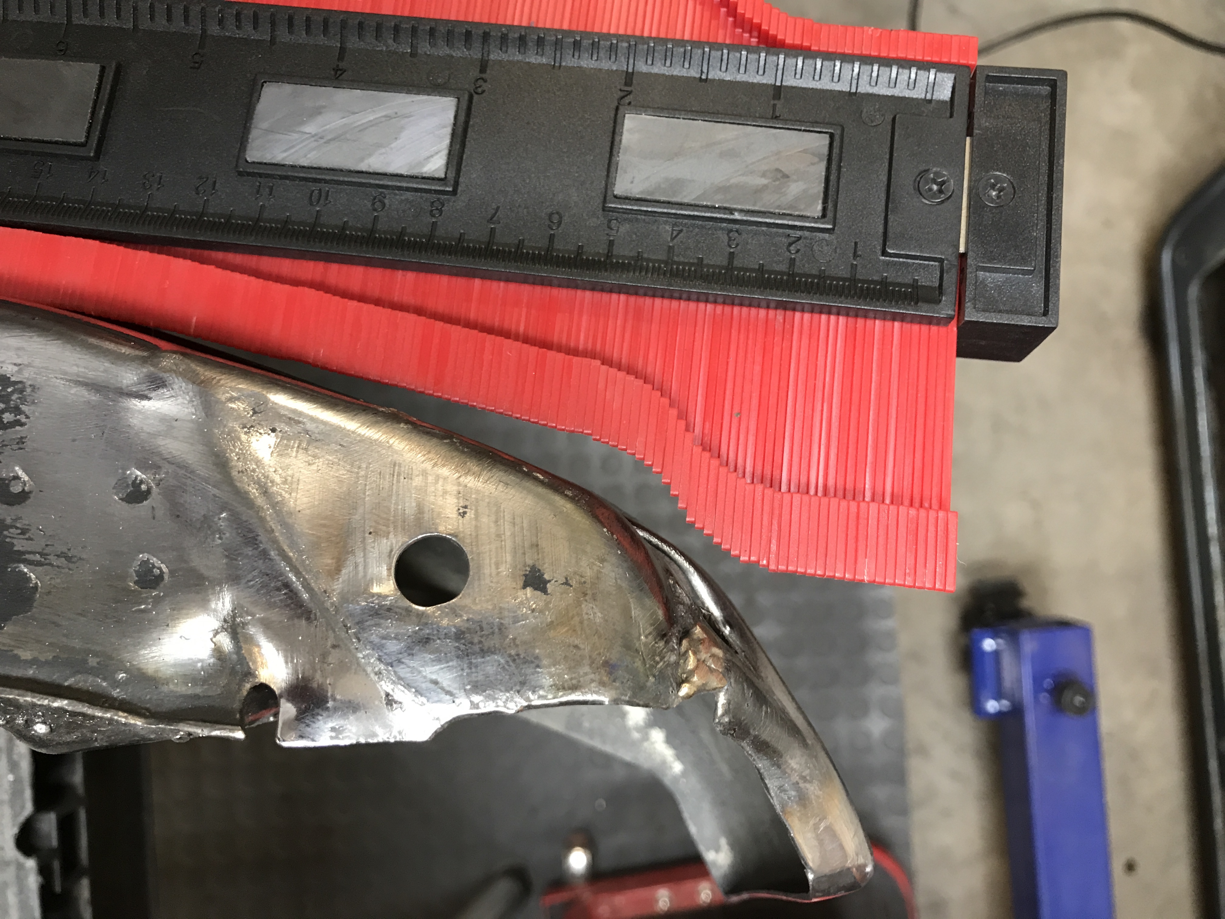

The inside view shows the severe crimping.

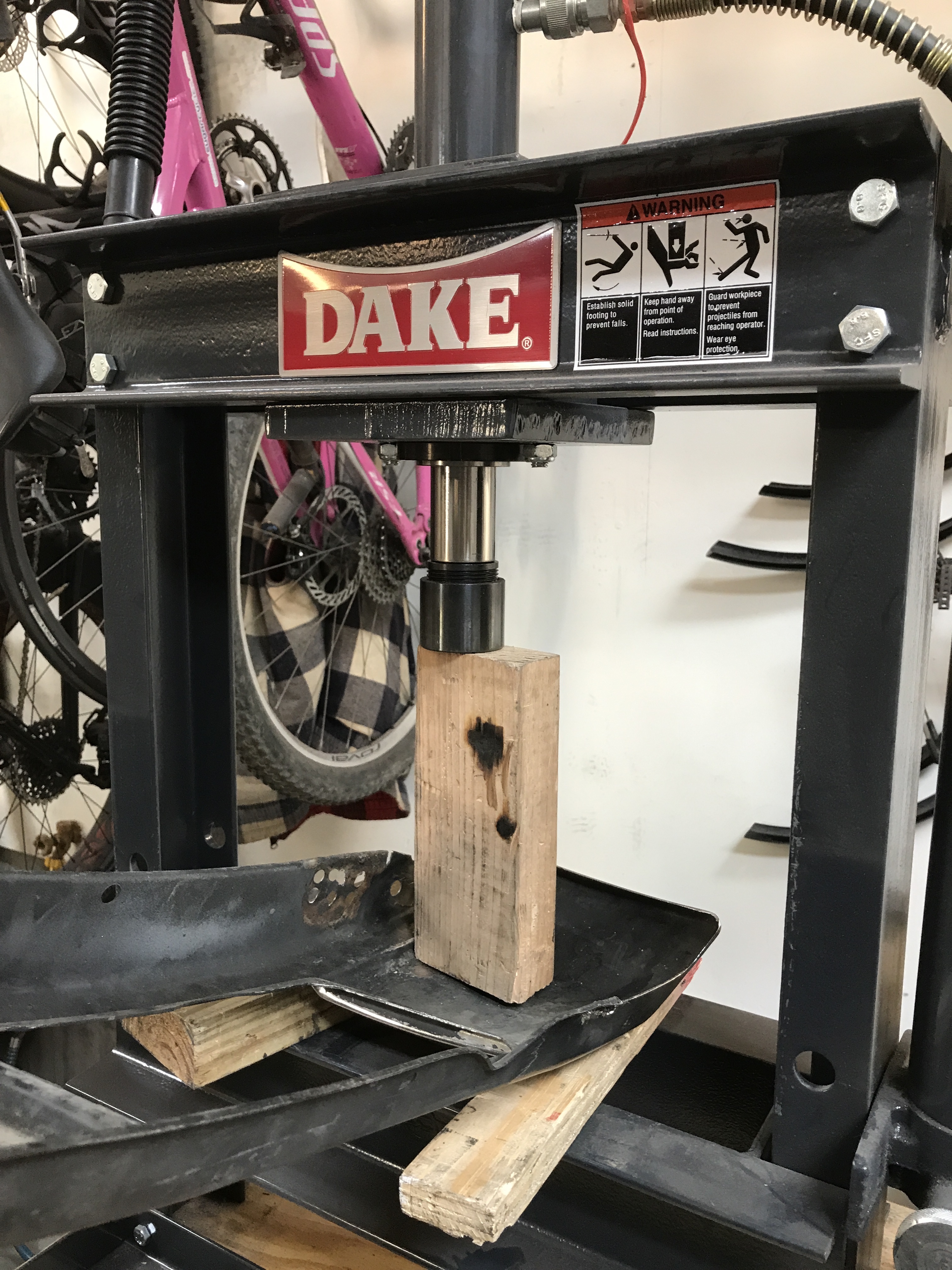

I used my press to try to unfold some of the damage, with partial success.
bkrantz
post Jun 14 2020, 07:17 PM
Post #780
Posts: 8,342
Joined: 3-August 19
From: SW Colorado
Member No.: 23,343
I got the profile a bit better, but still off.
