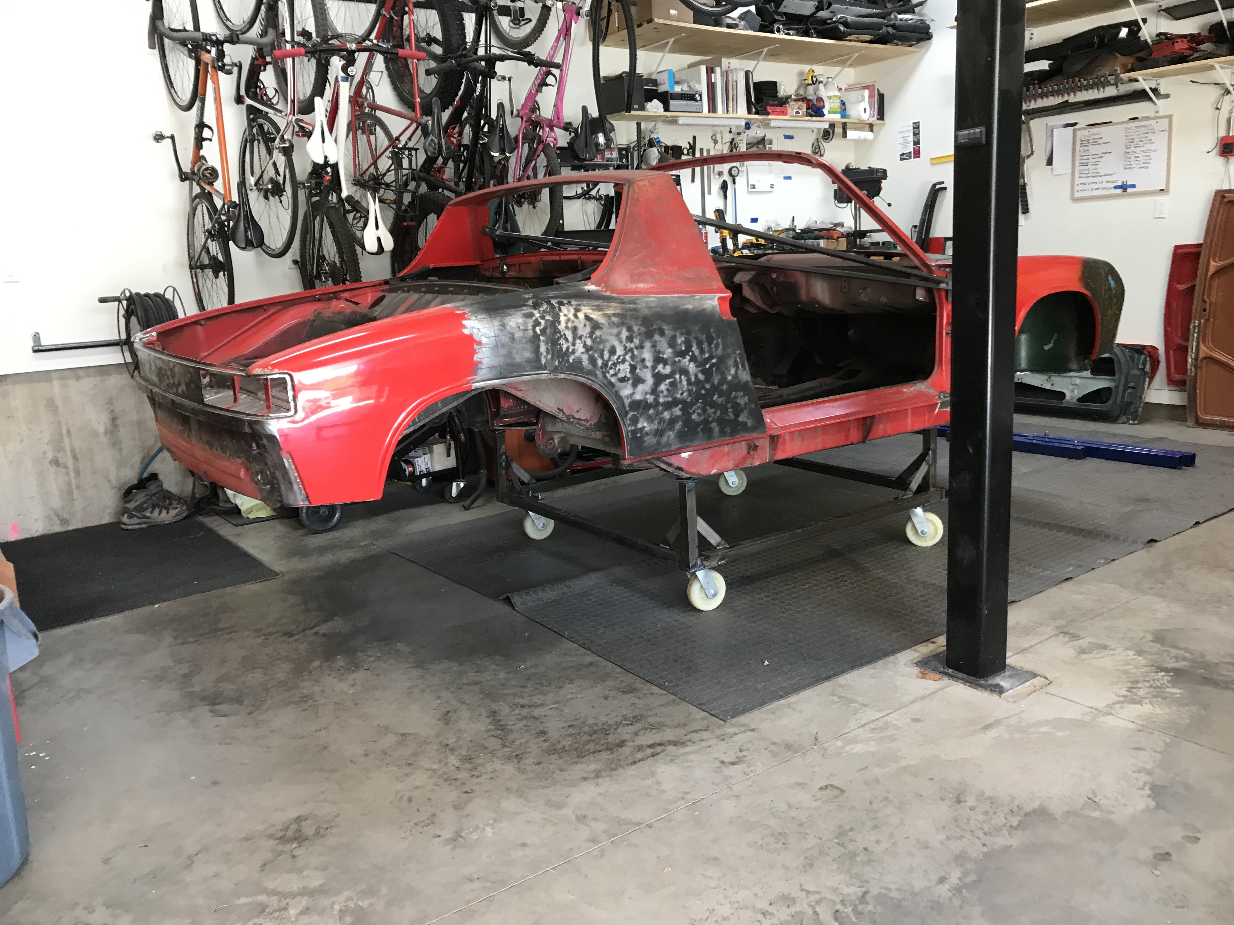

We got the car body onto the dolly today--a real milestone. With luck, it will go to the paint shop by the end of the week.

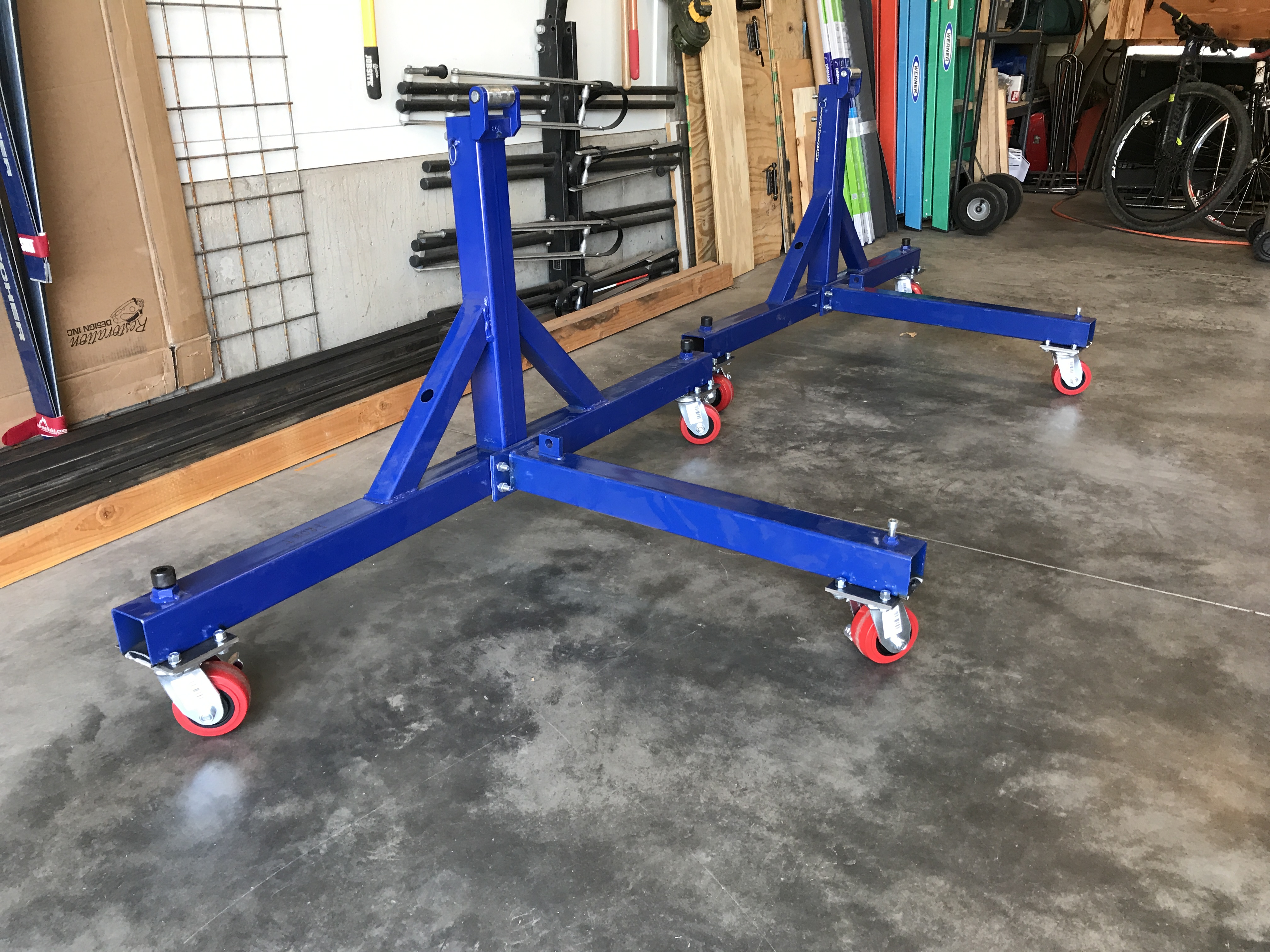

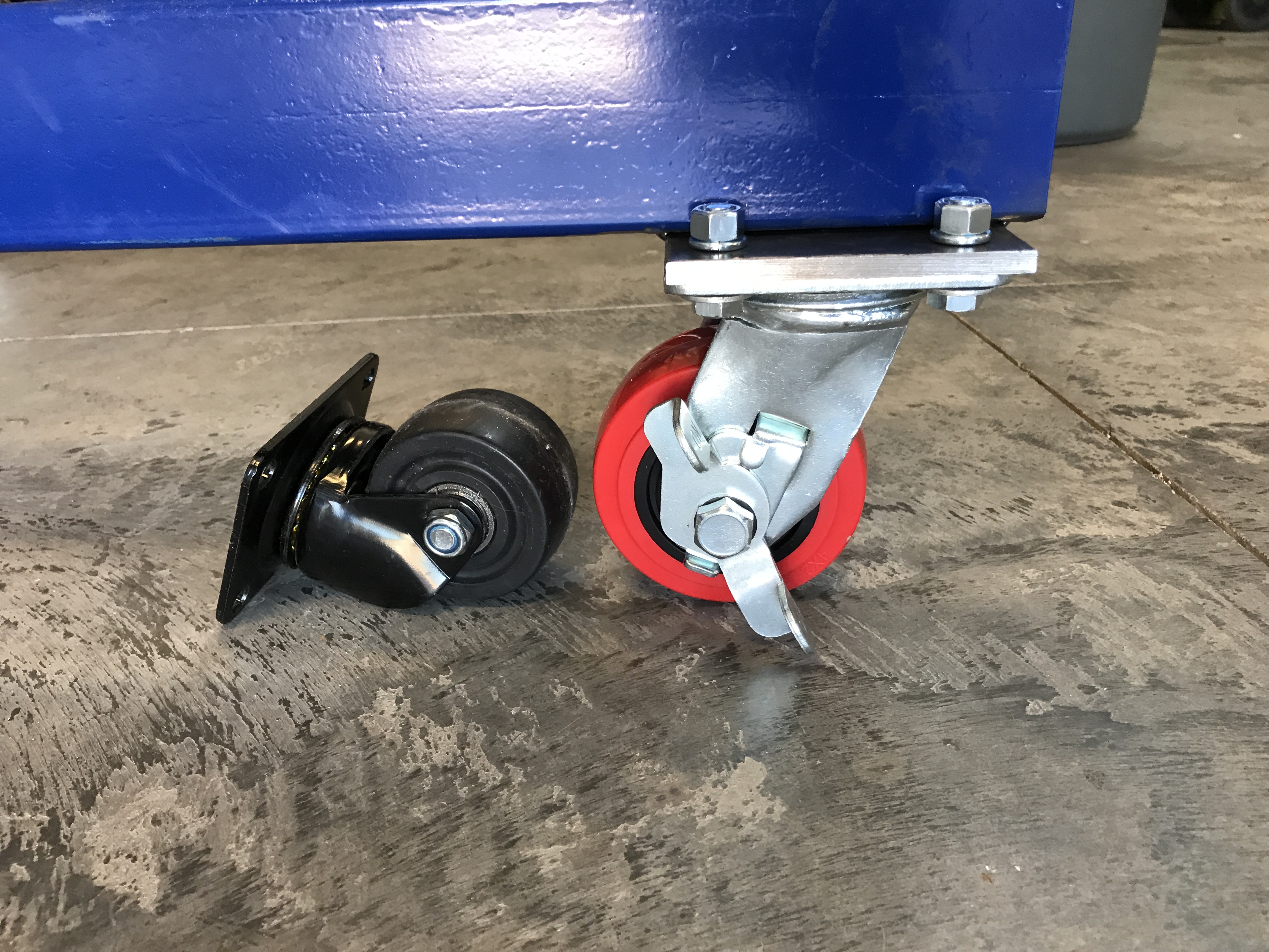

We also upgraded the wheels on the rotisserie. The paint shop will probably use it for stripping and for priming the underside. The original wheels might not survive rolling in and out of the shop.
bkrantz
post Jun 20 2020, 08:57 PM
Post #803
Posts: 8,342
Joined: 3-August 19
From: SW Colorado
Member No.: 23,343
Mounting the red wheels required cutting off the original plates and welding on new ones.

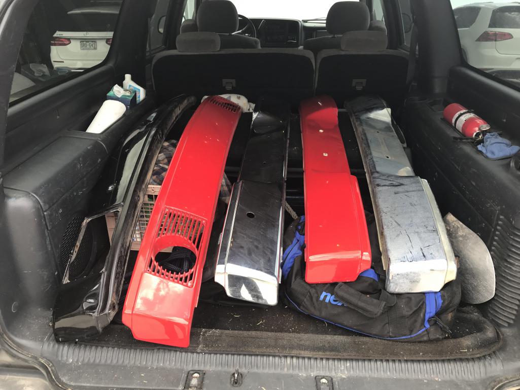

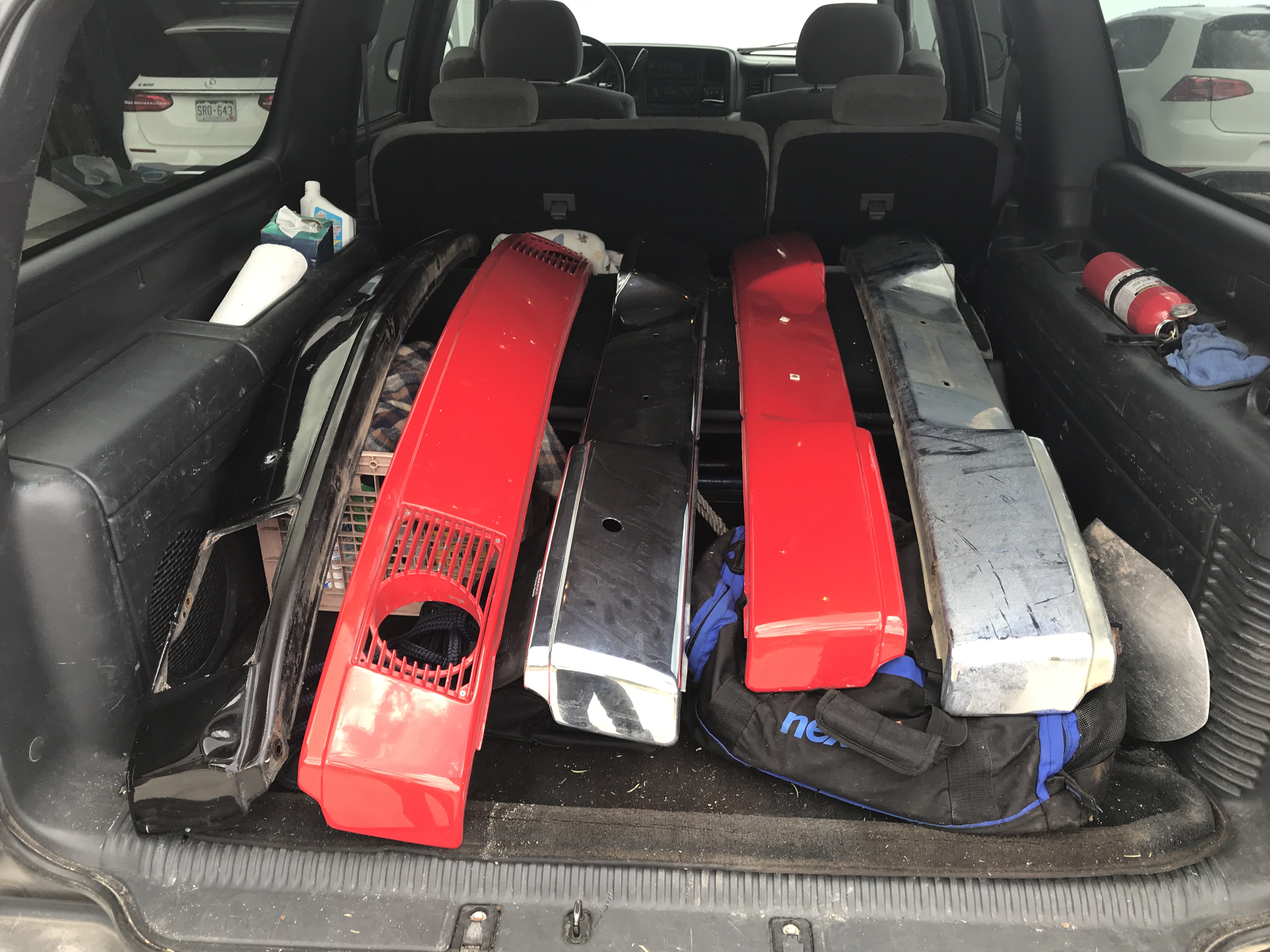

Bumper day! Mike let me try out candidates from his inventory.

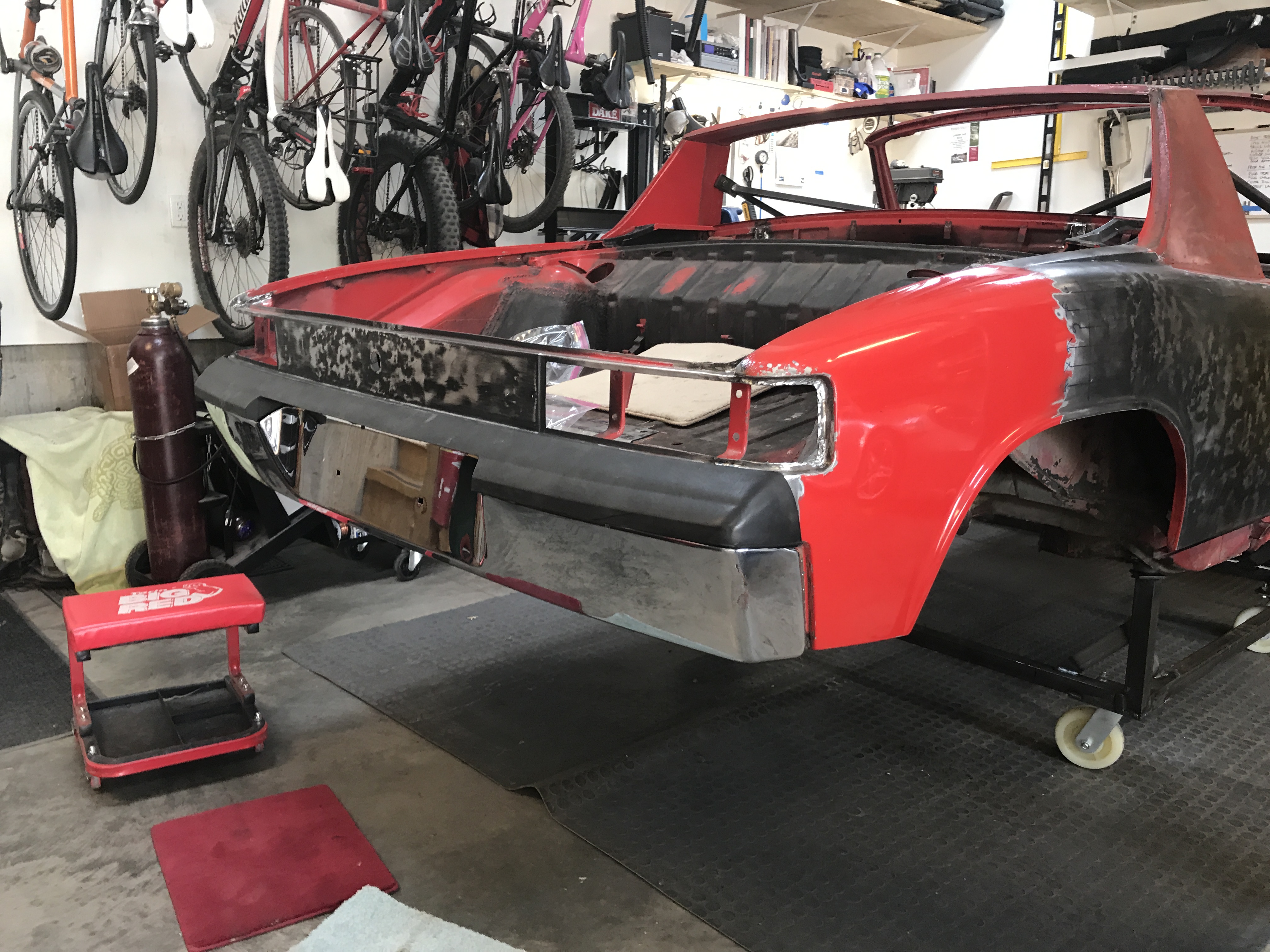

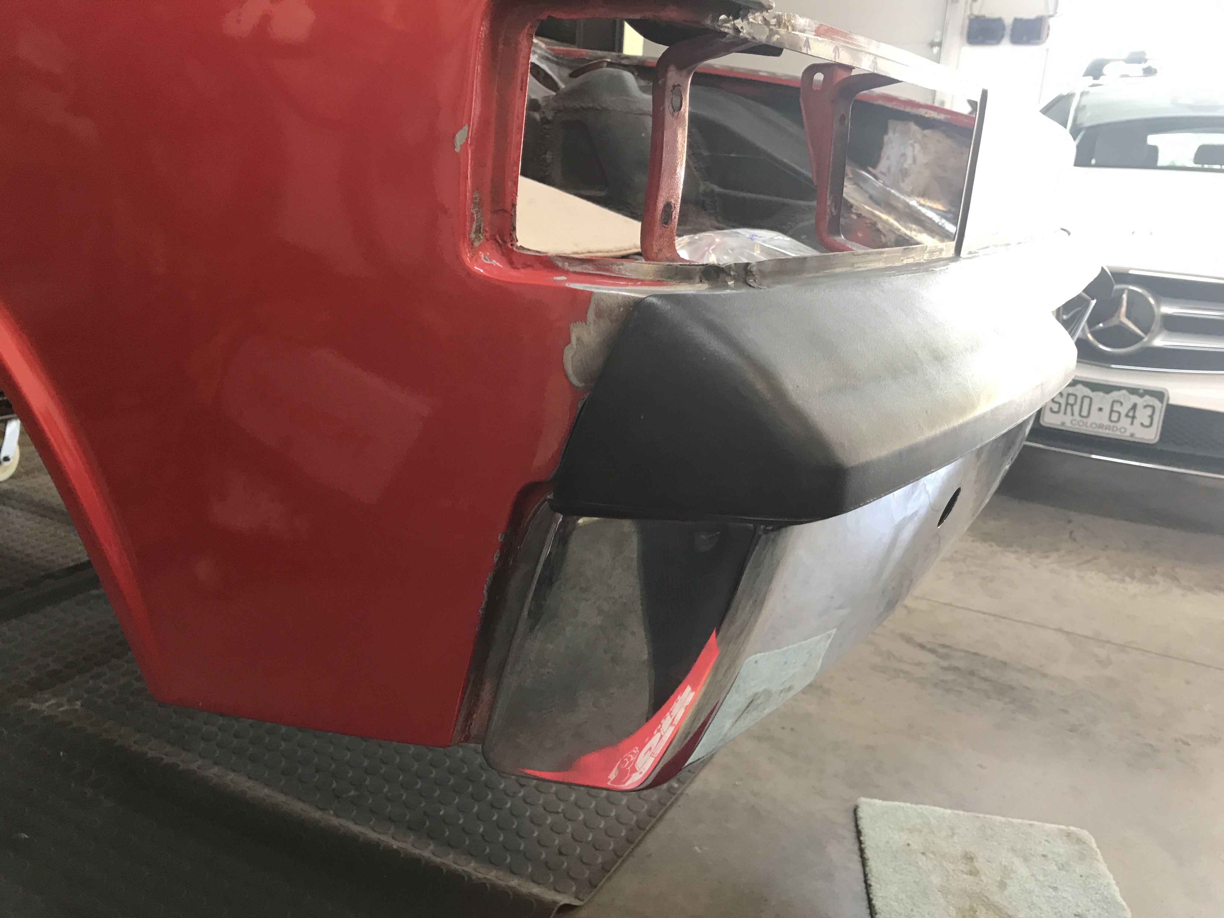

Started on the rear, with the straightest bumper in the collection. First fit on the car, with my original top cap.
bkrantz
post Jun 21 2020, 09:08 PM
Post #806
Posts: 8,342
Joined: 3-August 19
From: SW Colorado
Member No.: 23,343
Left end.
bkrantz
post Jun 21 2020, 09:09 PM
Post #807
Posts: 8,342
Joined: 3-August 19
From: SW Colorado
Member No.: 23,343

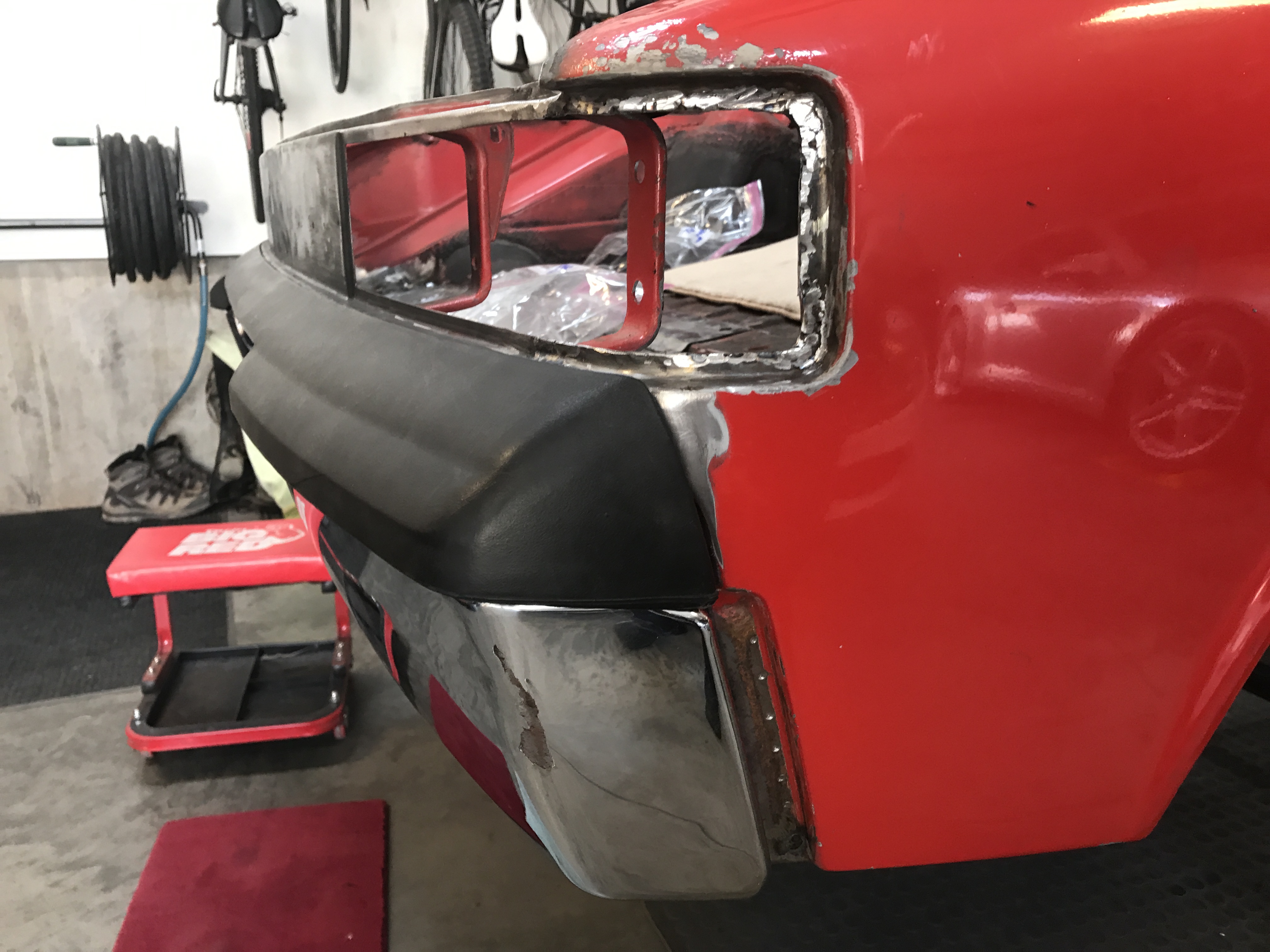

Right end. The gap along the side fender recess looks big (but the cap is against the fender).
bkrantz
post Jun 21 2020, 09:10 PM
Post #808
Posts: 8,342
Joined: 3-August 19
From: SW Colorado
Member No.: 23,343
Overall the fit looks pretty good, just a bit high on the right side.

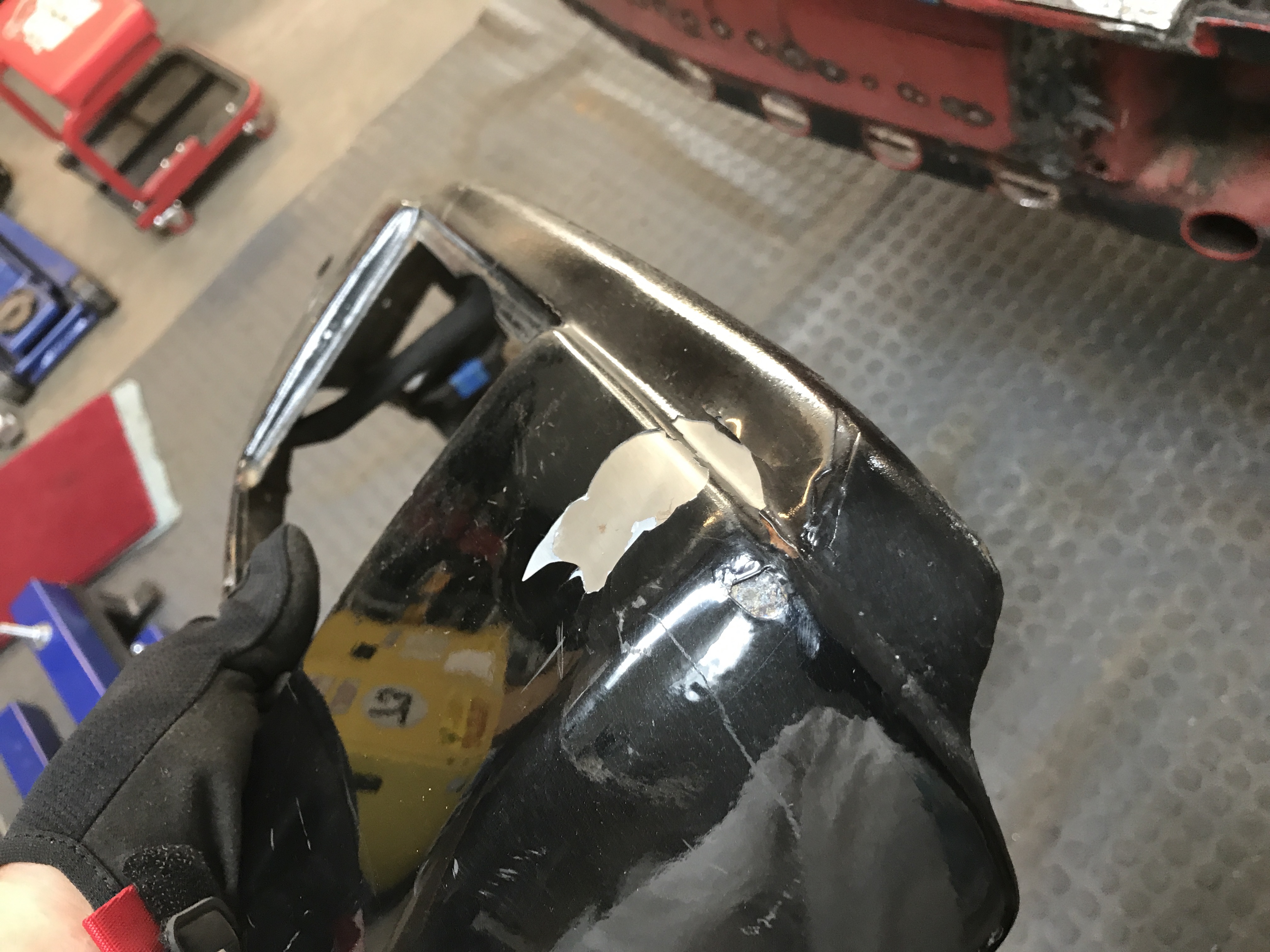

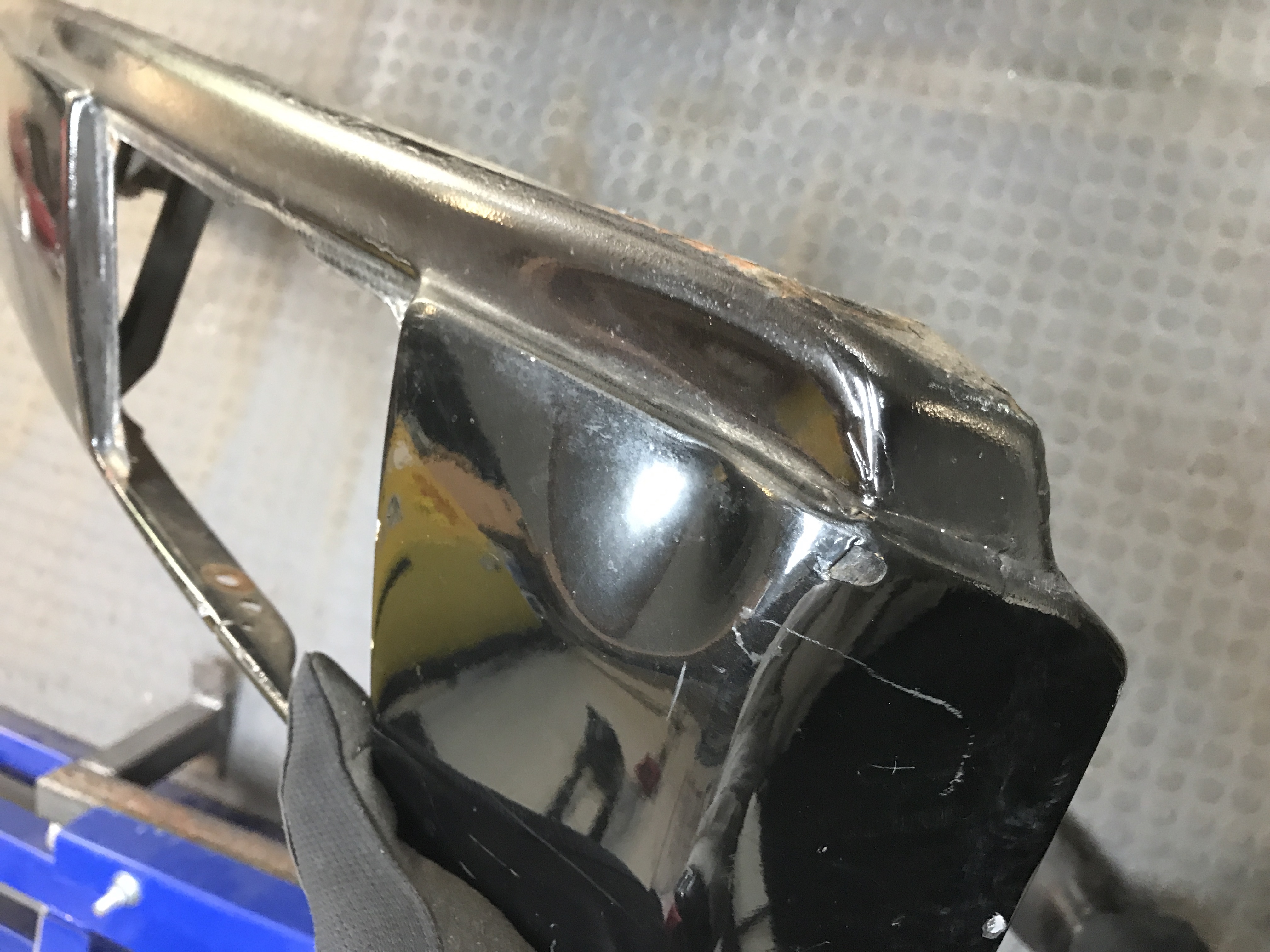

For the front, the straightest bumper had a small but distinct dent near the left end.
bkrantz
post Jun 21 2020, 09:13 PM
Post #810
Posts: 8,342
Joined: 3-August 19
From: SW Colorado
Member No.: 23,343
To mount the top cap, and have it aligned properly, I had to remove the dent. After some work with my press and hammers, I got it 90%--good enough for the fitting.

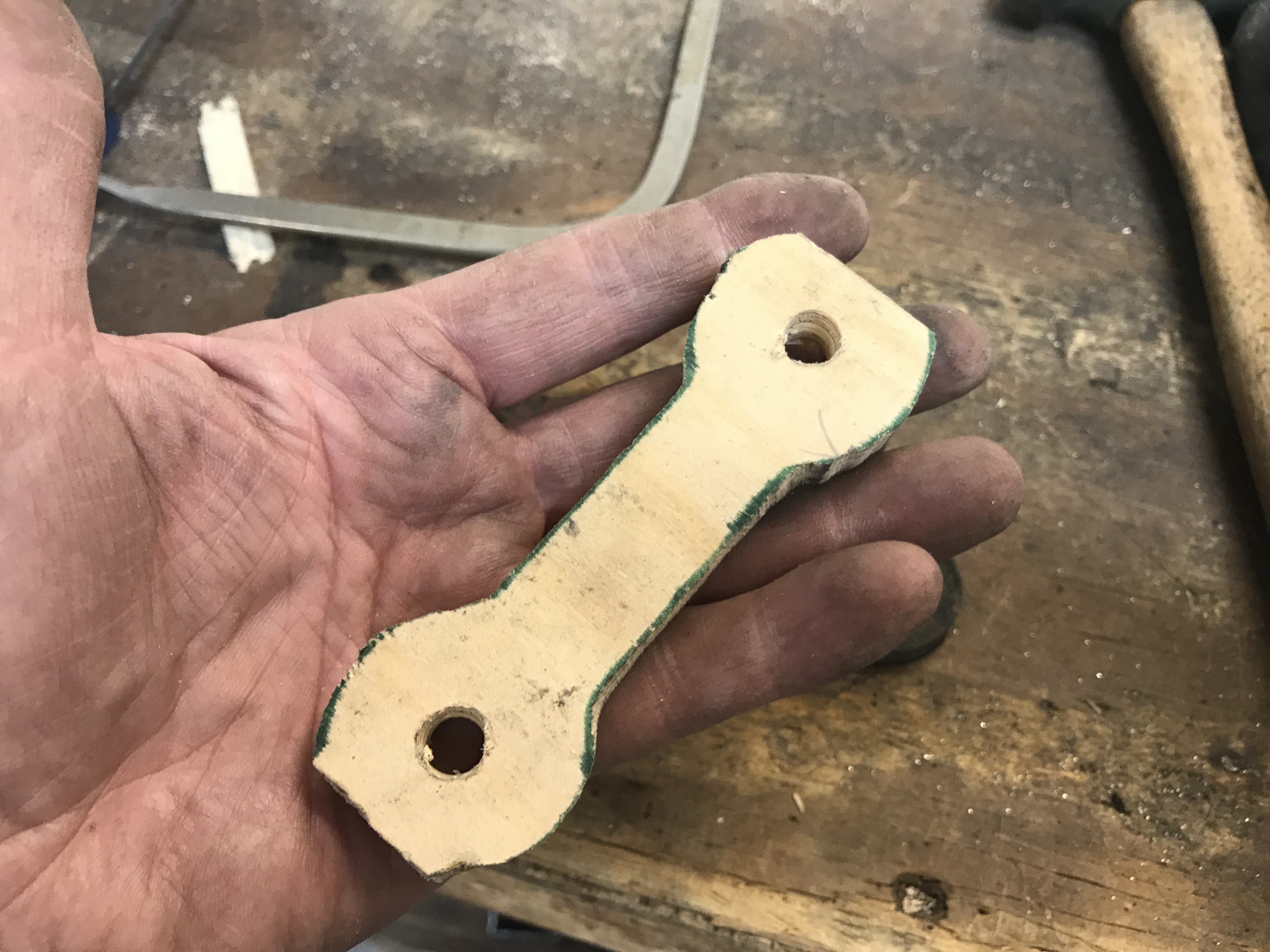

Member No.: 23,343

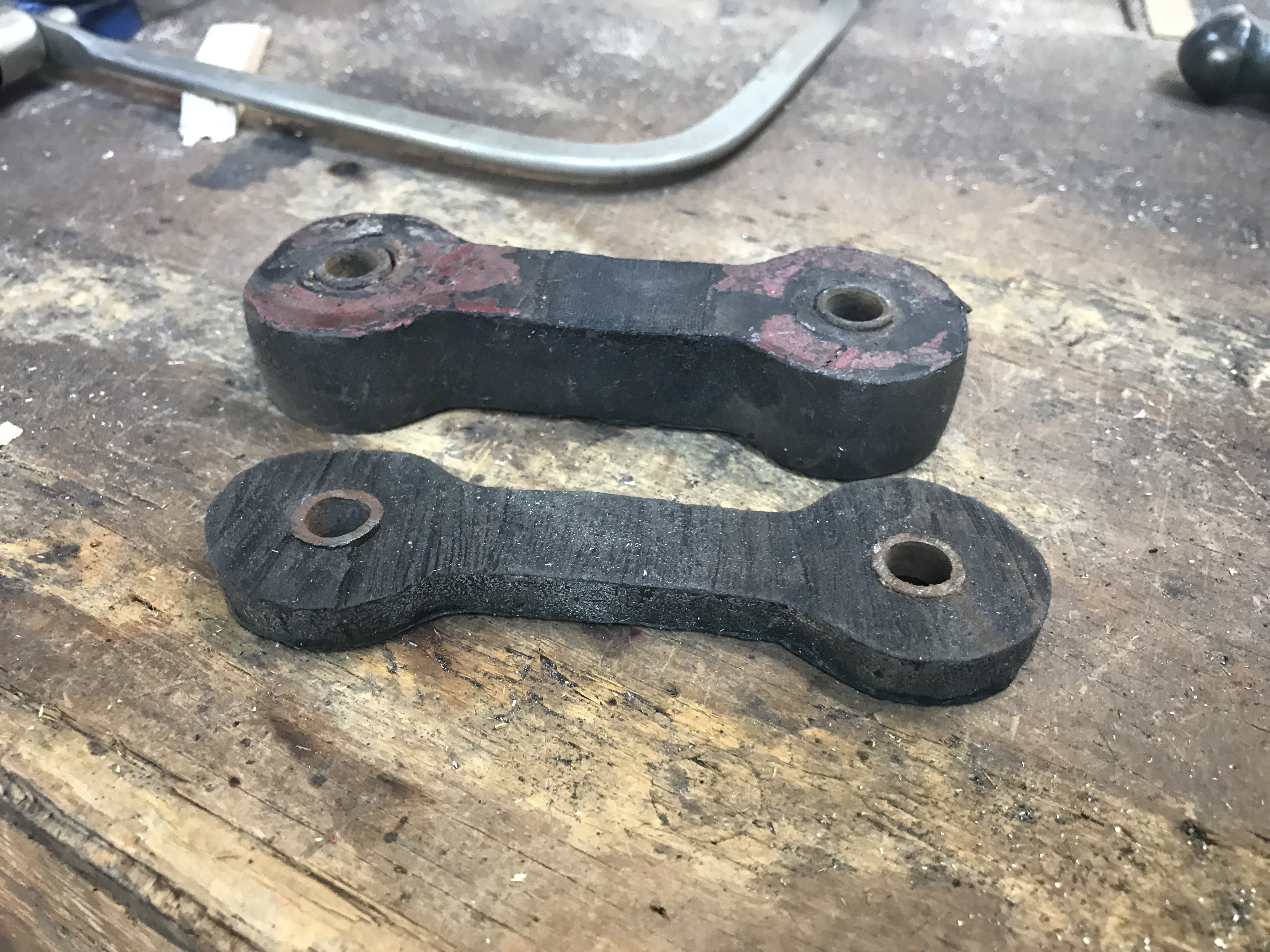

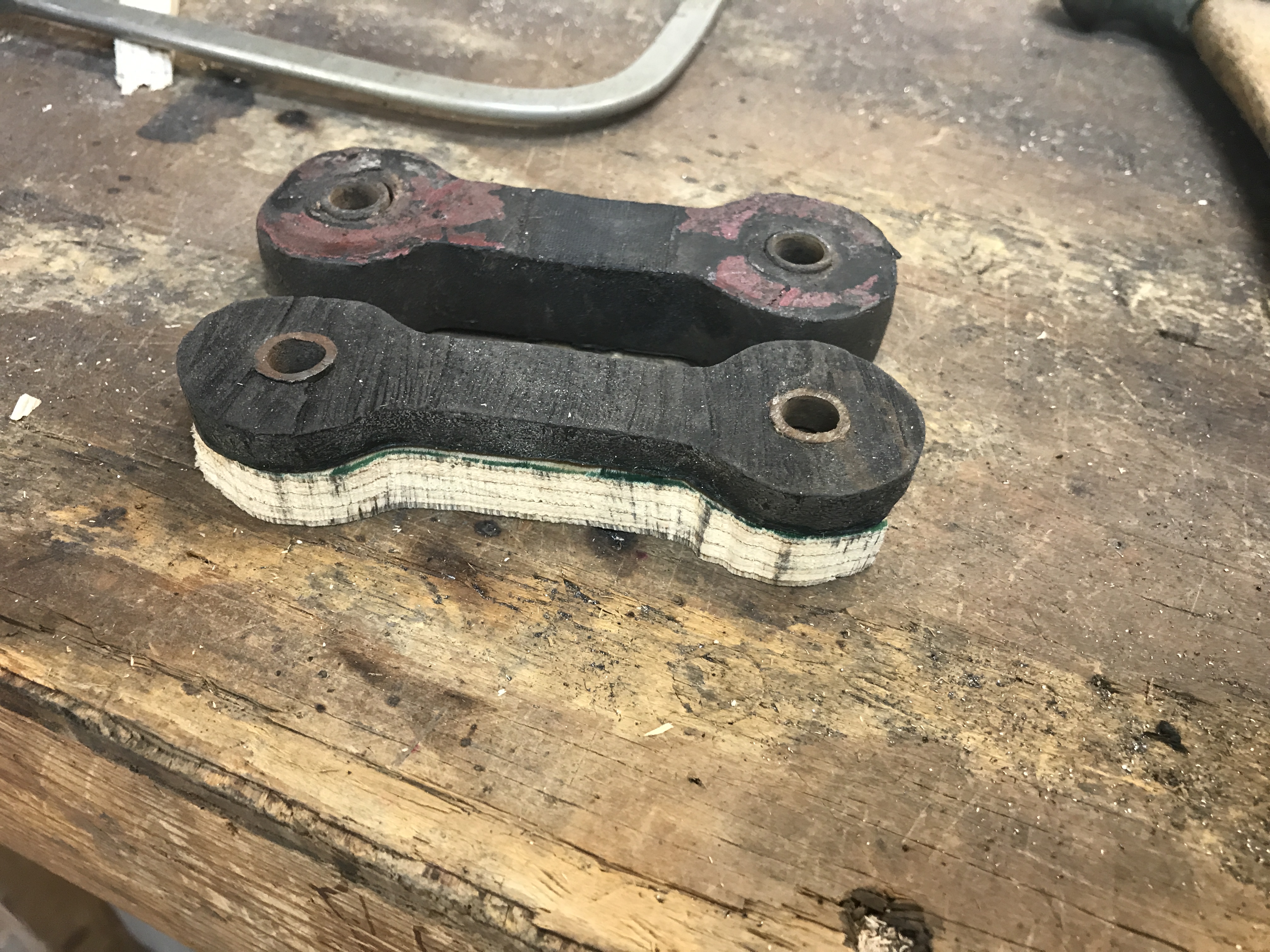

I also had to come up with a temporary fix for the modified dog bone, since the PO trimmed one by 2/3 to adjust for the crappy right fender repair.
bkrantz
post Jun 21 2020, 09:15 PM
Post #812
Posts: 8,342
Joined: 3-August 19
From: SW Colorado
Member No.: 23,343
Since I do not have a spare, I made a wood dog bone spacer.
bkrantz
post Jun 21 2020, 09:19 PM
Post #813
Posts: 8,342
Joined: 3-August 19
From: SW Colorado
Member No.: 23,343
Dig my temporary dog bone need to be bone-shaped? No, but why not?

Here is the bumper mounted, with the frunk lid propped in place.
bkrantz
post Jun 21 2020, 09:21 PM
Post #815
Posts: 8,342
Joined: 3-August 19
From: SW Colorado
Member No.: 23,343
The left end.

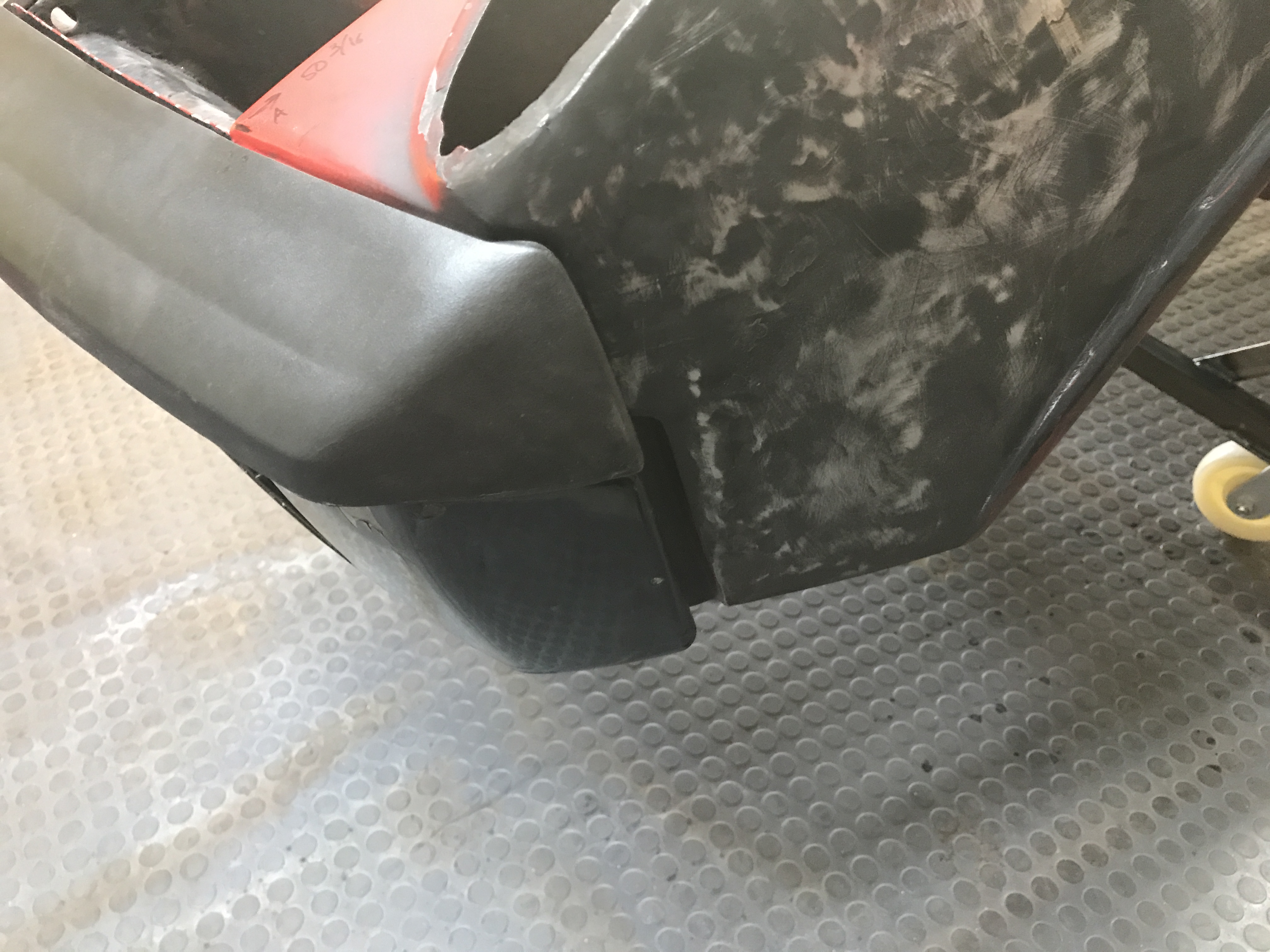

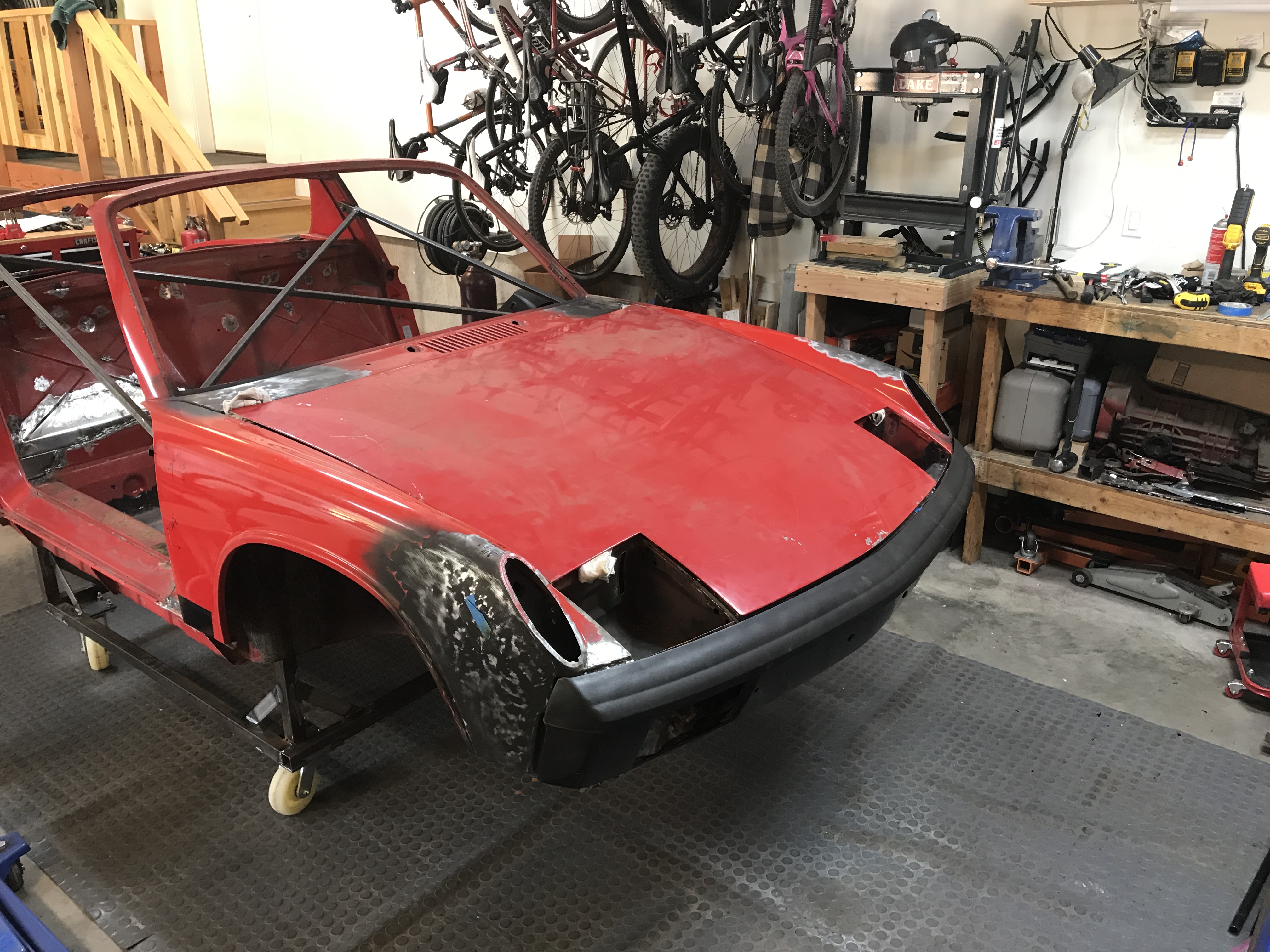

More bumper fitting today. In the rear, I elongated the holes a bit so the bumper sits lower. To get it to fit closer, I think I will need to shave some dog bones.

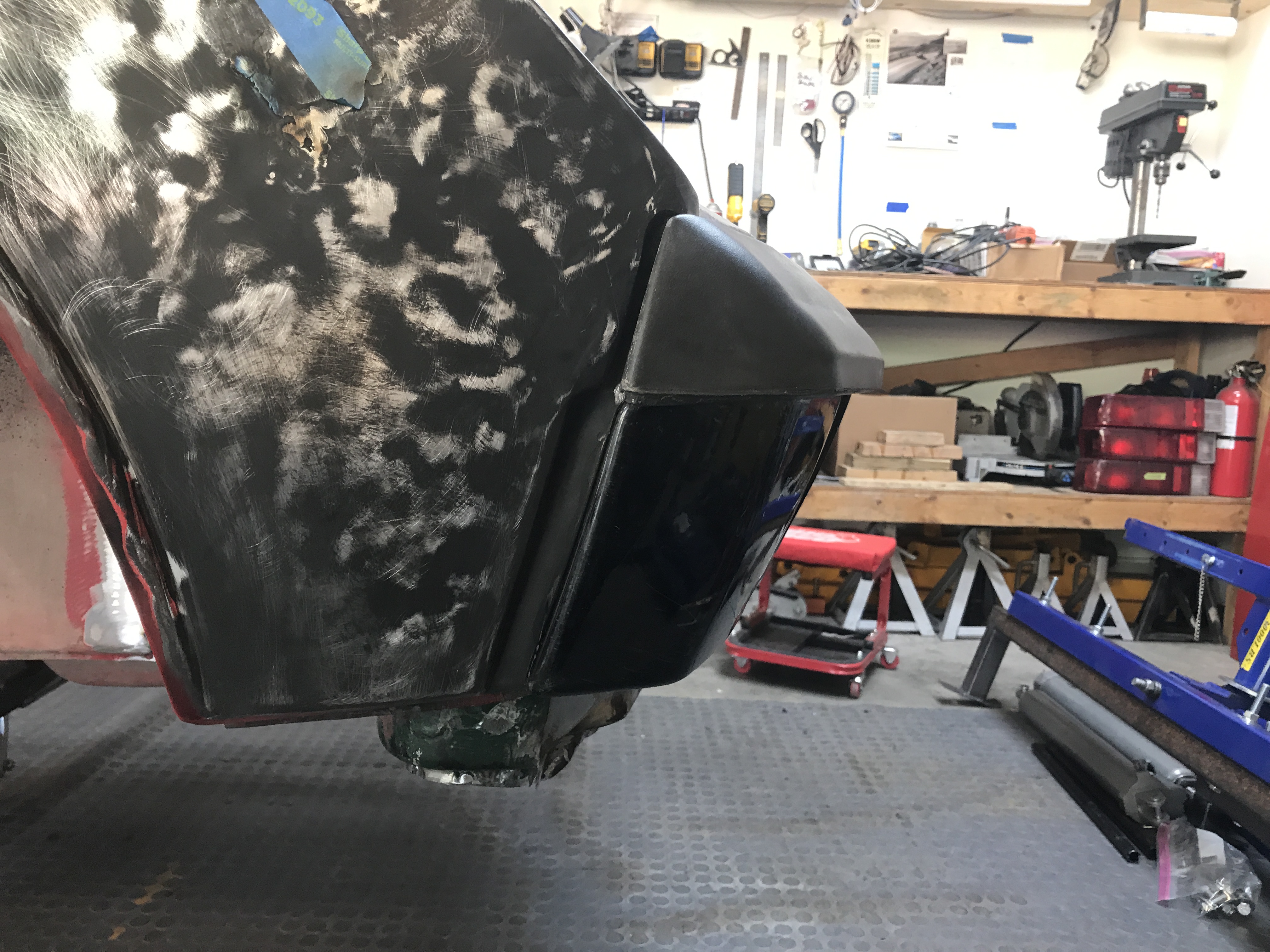

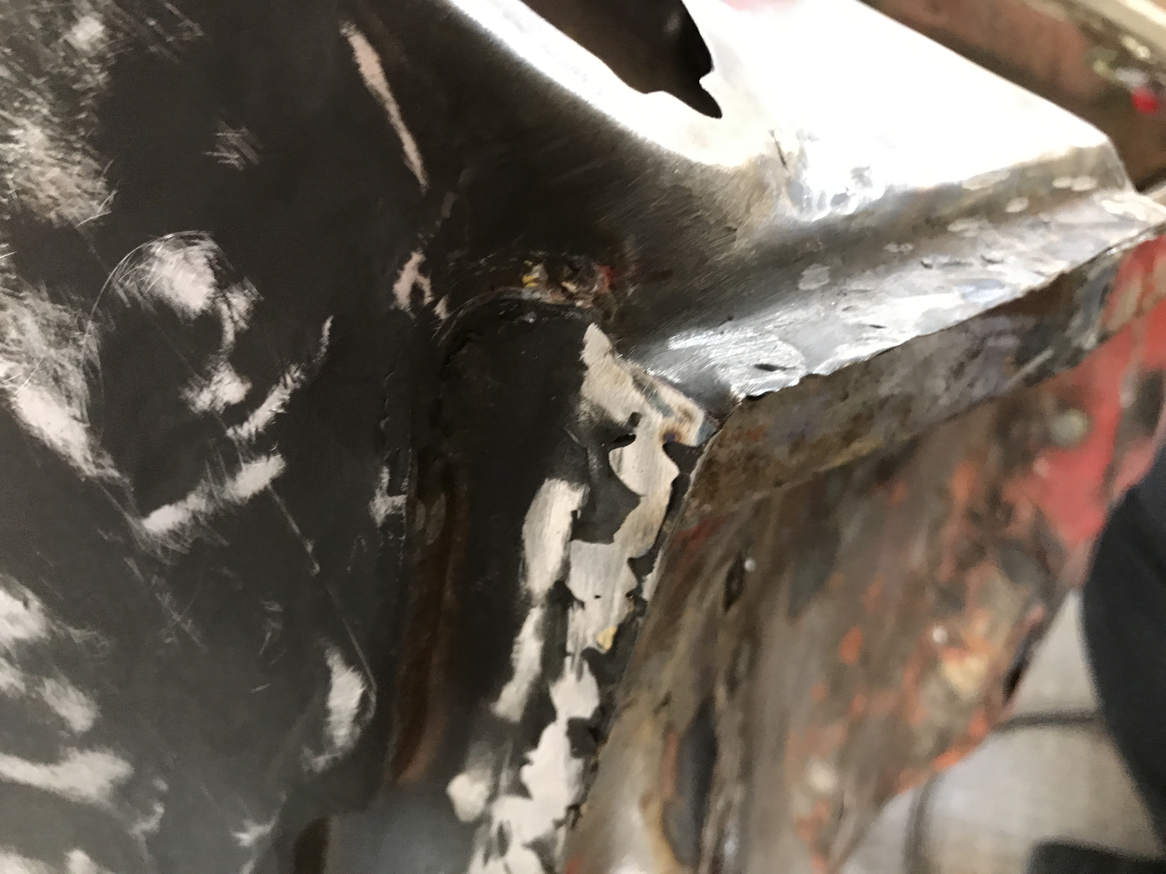

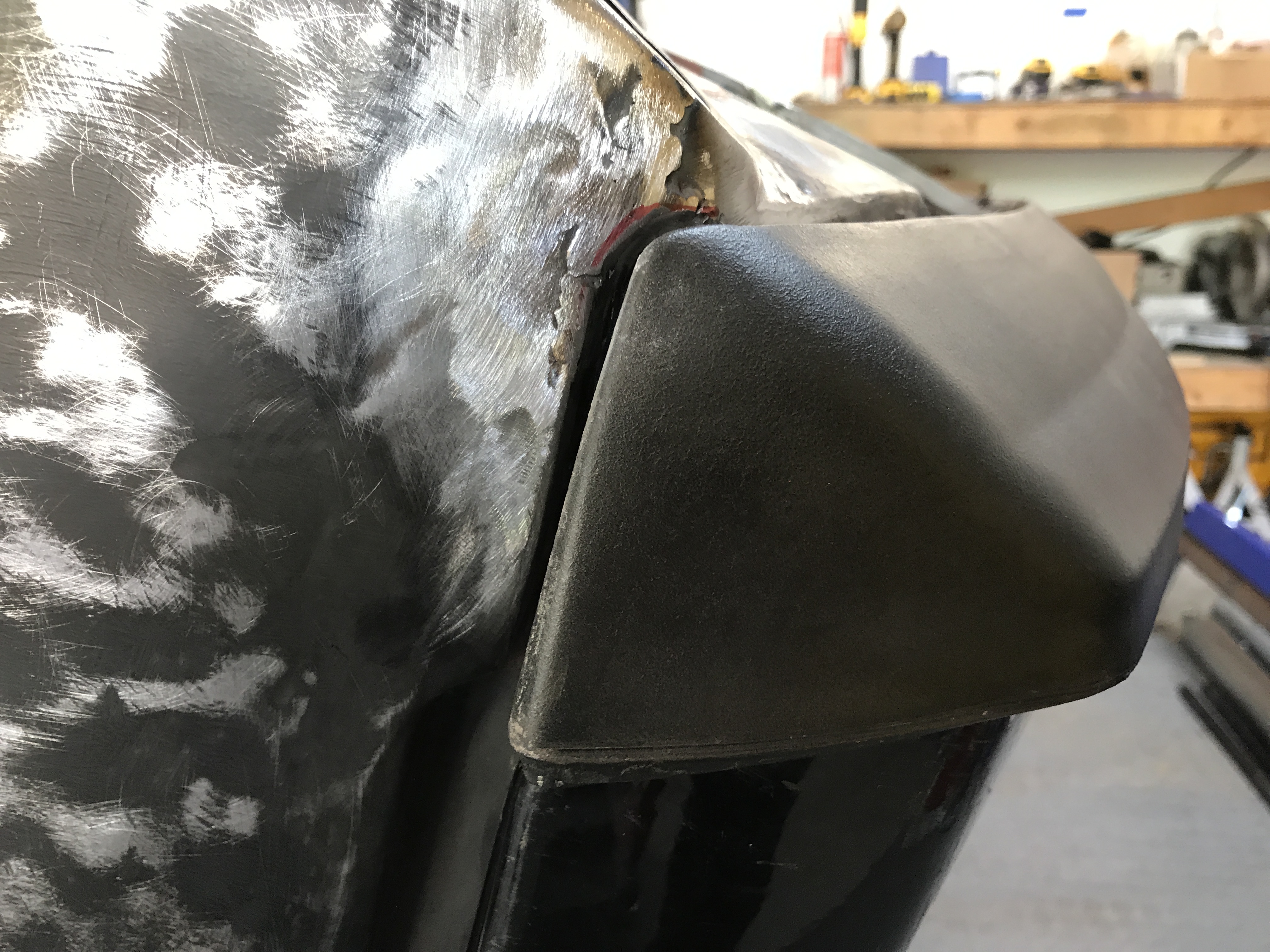

In the front, I redid the recess in the right fender for the top cap corner. Here is the way it was, with markings (hard to see).
bkrantz
post Jun 22 2020, 07:57 PM
Post #820
Posts: 8,342
Joined: 3-August 19
From: SW Colorado
Member No.: 23,343
And after a bit of hammer work, build-up MIG welding, and grinding.
