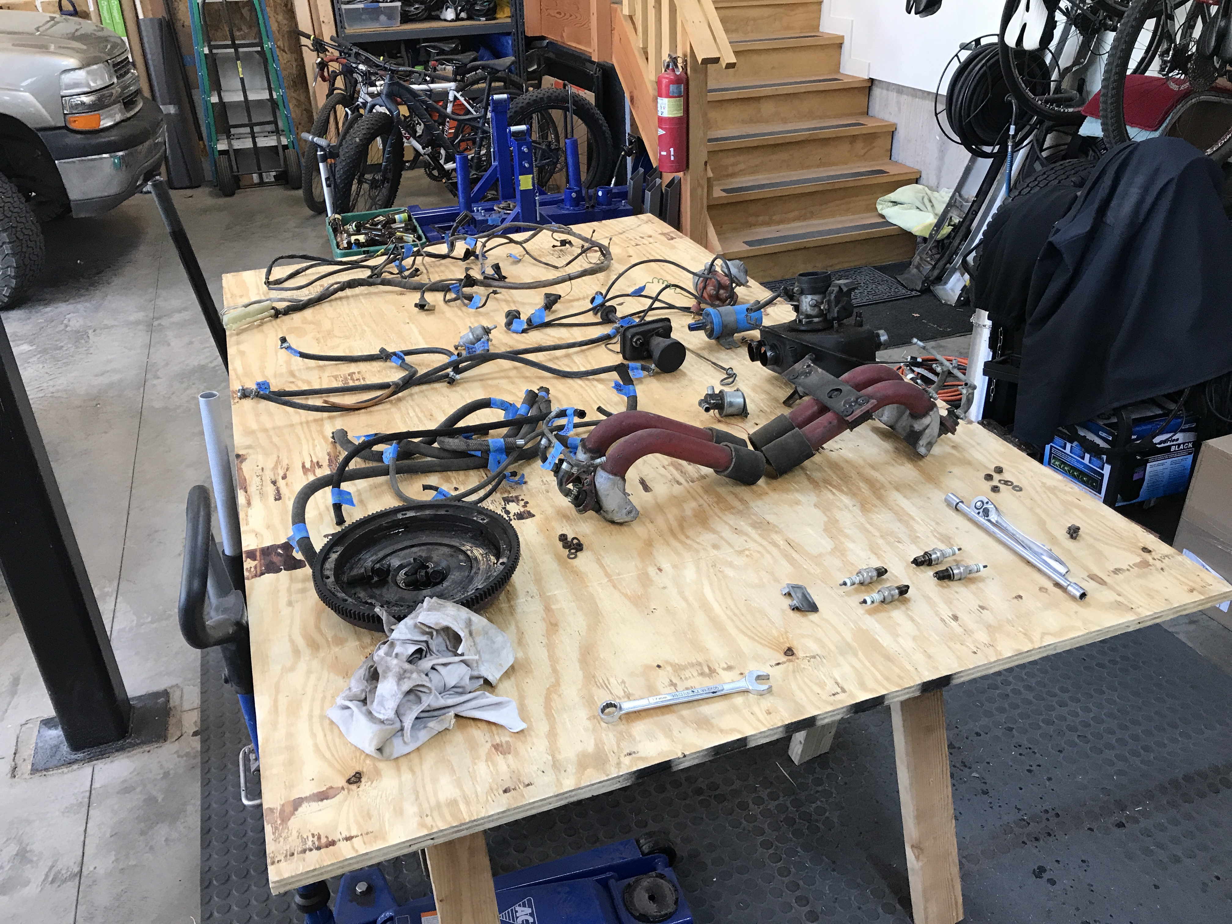

bkrantz
post Jul 1 2020, 08:40 PM
Post #863
914 Guru
Group: Members
Posts: 8,154
Joined: 3-August 19
From: SW Colorado
Member No.: 23,343
Region Association: Rocky Mountains

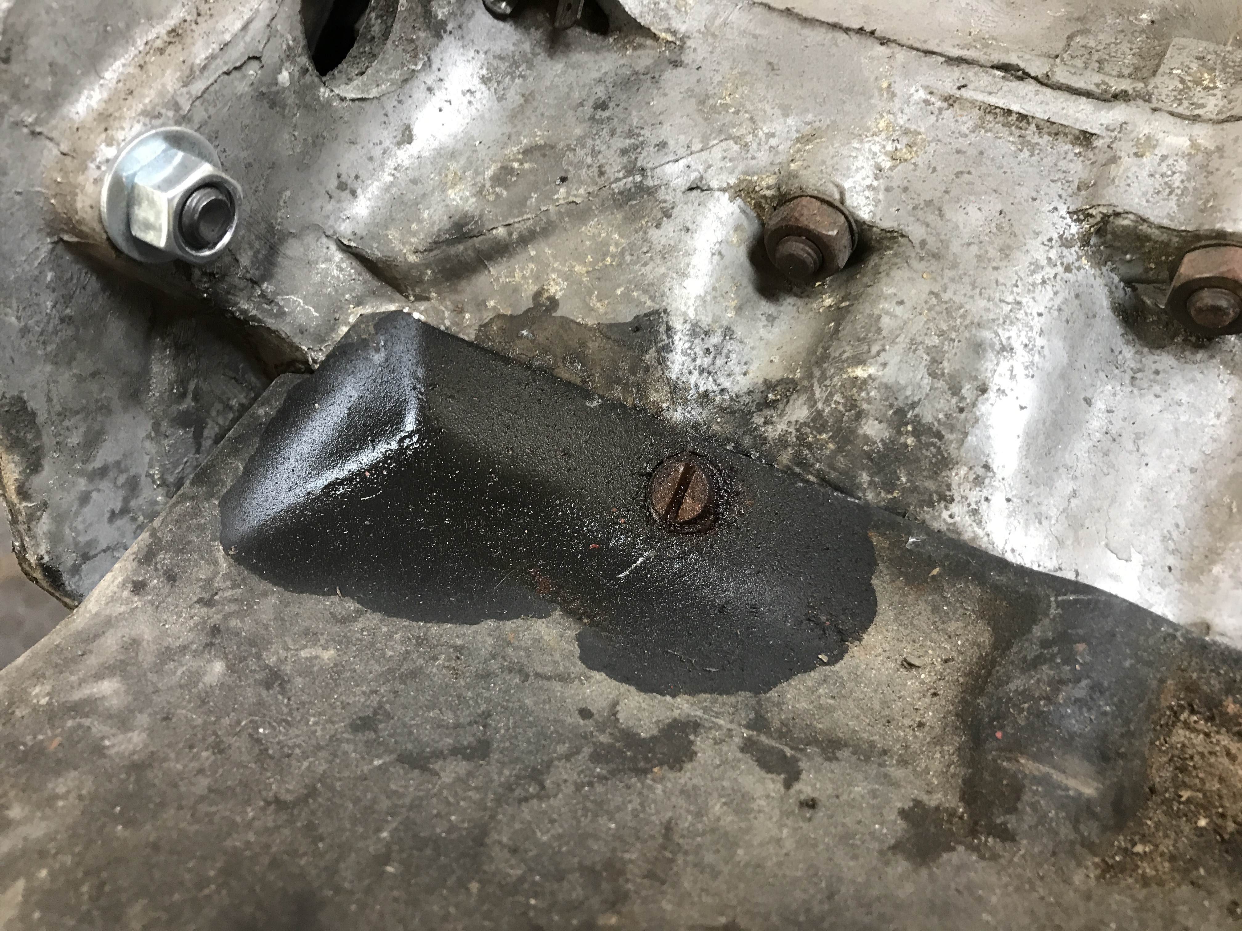

Today, I stripped the outside of the engine. Everything came off easily, except one cheesehead screw. Given that this screws into the top of the case, I took some care. That turned into about 30 minutes of penetrating oil, finesse with a beefy screwdriver, heating with a torch, and finally lots of "gentle" taps with a hand impact tool. Eventually, it gave up.

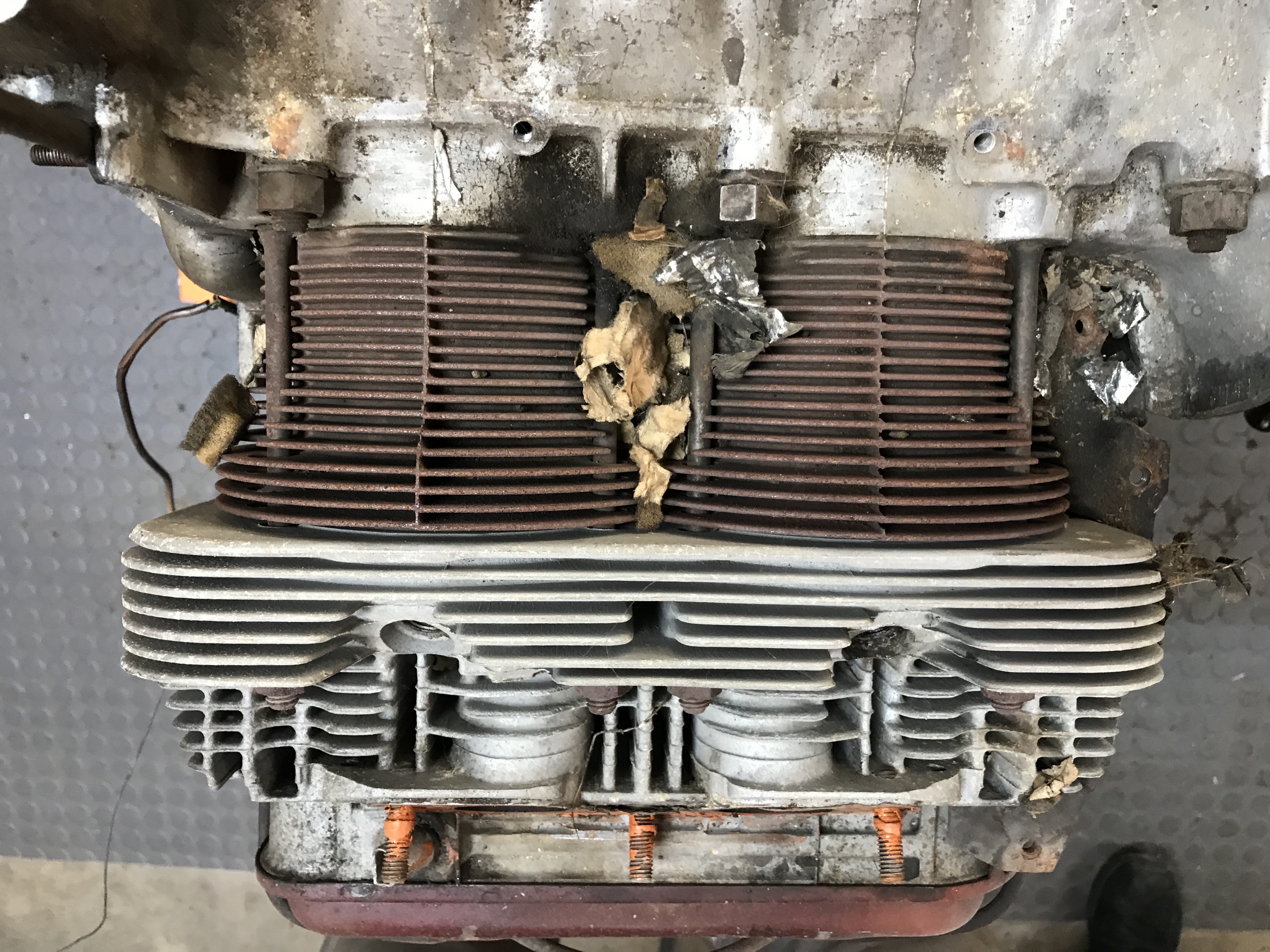

bkrantz
post Jul 1 2020, 08:41 PM
Post #864
914 Guru
Group: Members
Posts: 8,154
Joined: 3-August 19
From: SW Colorado
Member No.: 23,343

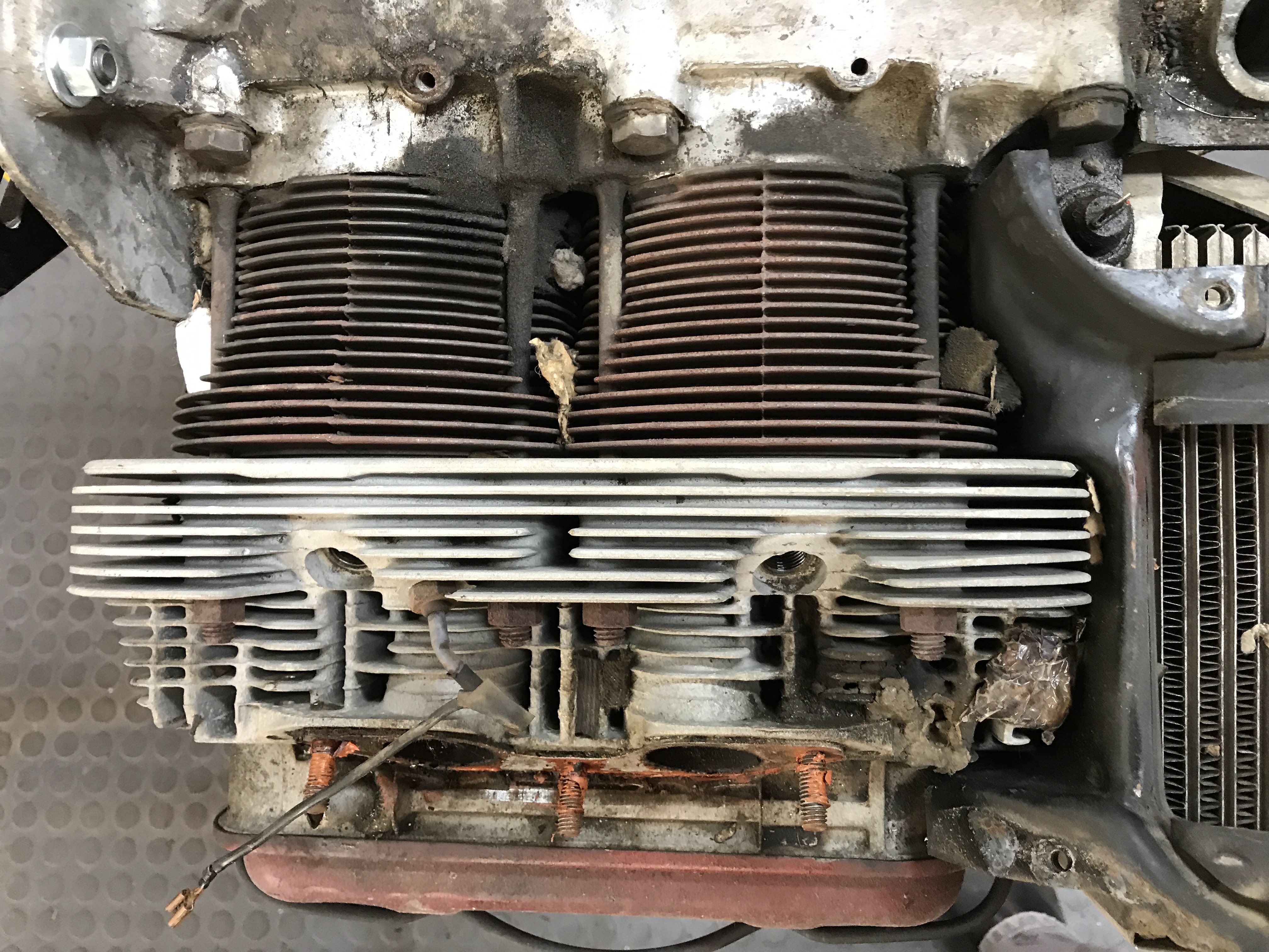

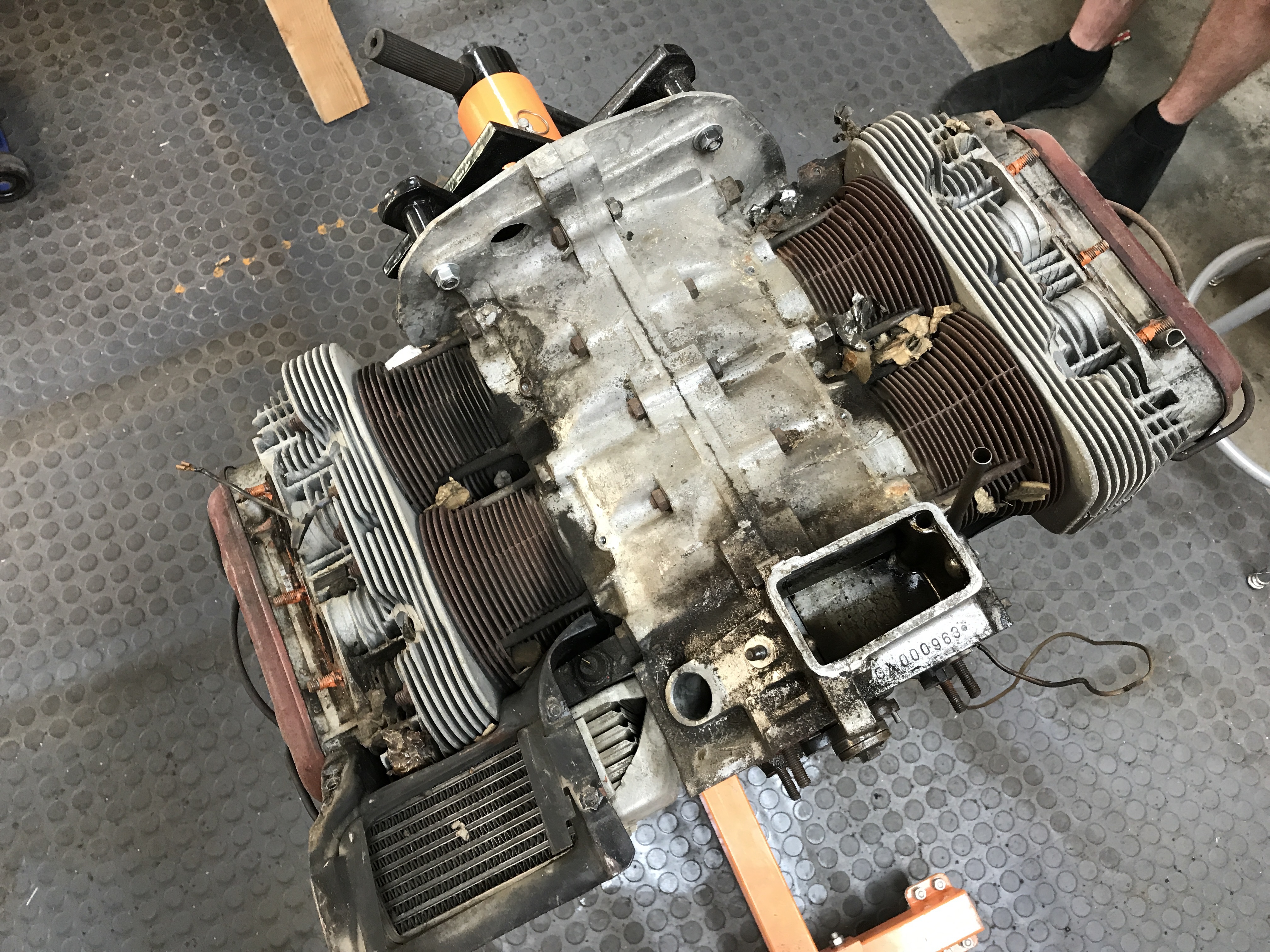

With the sheet metal off, I could see the tops of the cylinders. I was a little disappointed not to find an official 914 mouse nest, but a fair amount of crud made up for it.

Right side

Next, we get to look inside, and see what is hiding there.

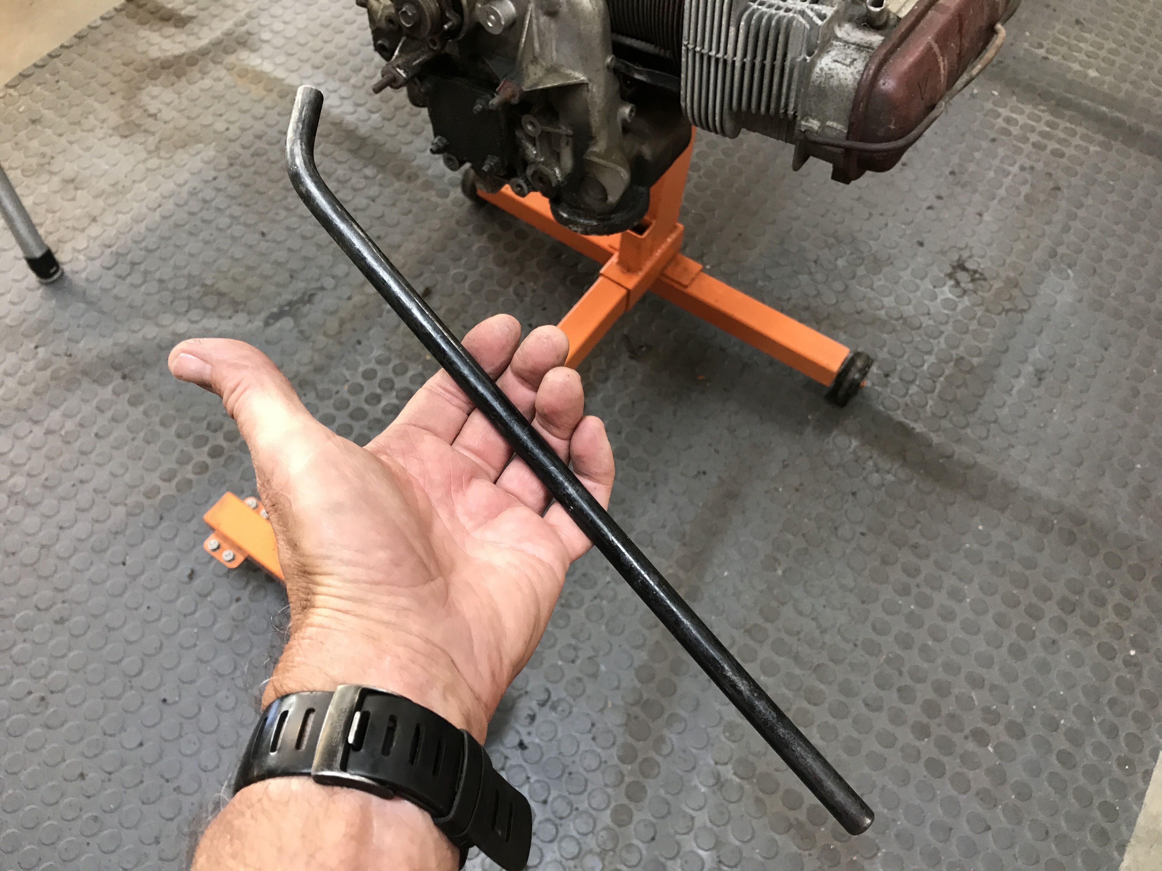

bkrantz
post Jul 2 2020, 08:03 PM
Post #869
914 Guru
Group: Members
Posts: 8,154
Joined: 3-August 19
From: SW Colorado
Member No.: 23,343

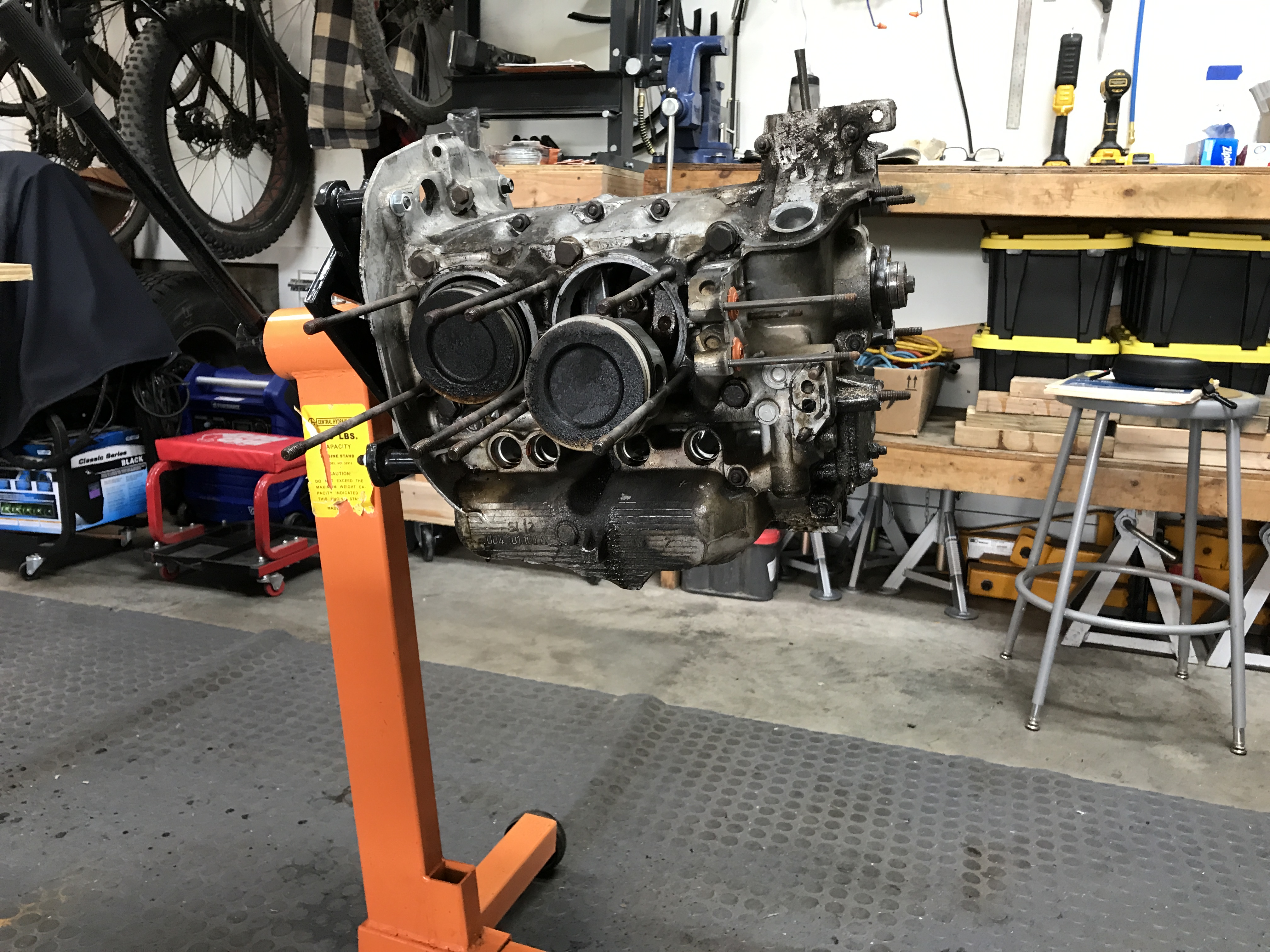

I opened up the engine today. Good thing I still have an official 914 pry tool, from previous ownerships.

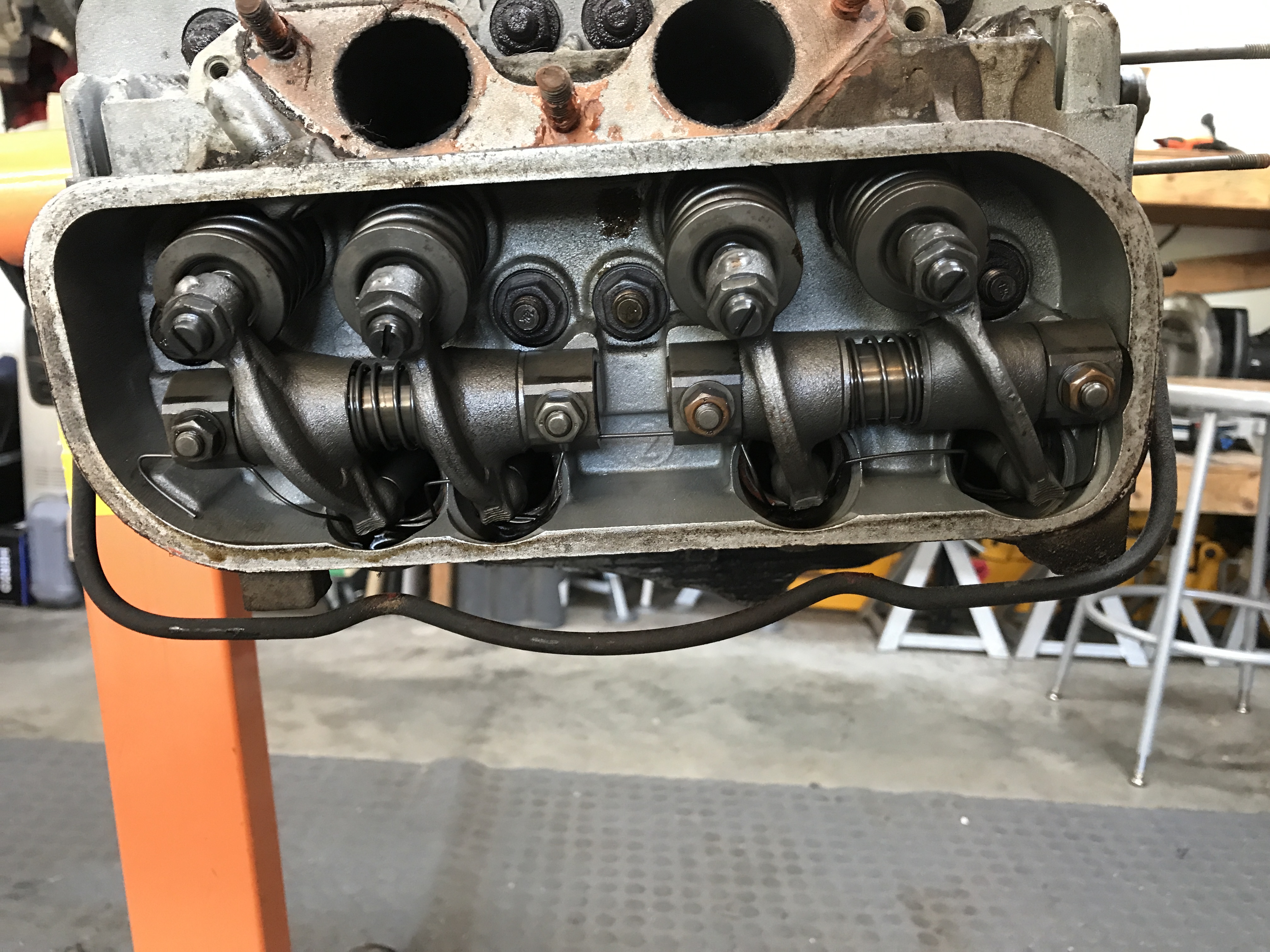

Valve train all present and looking OK.

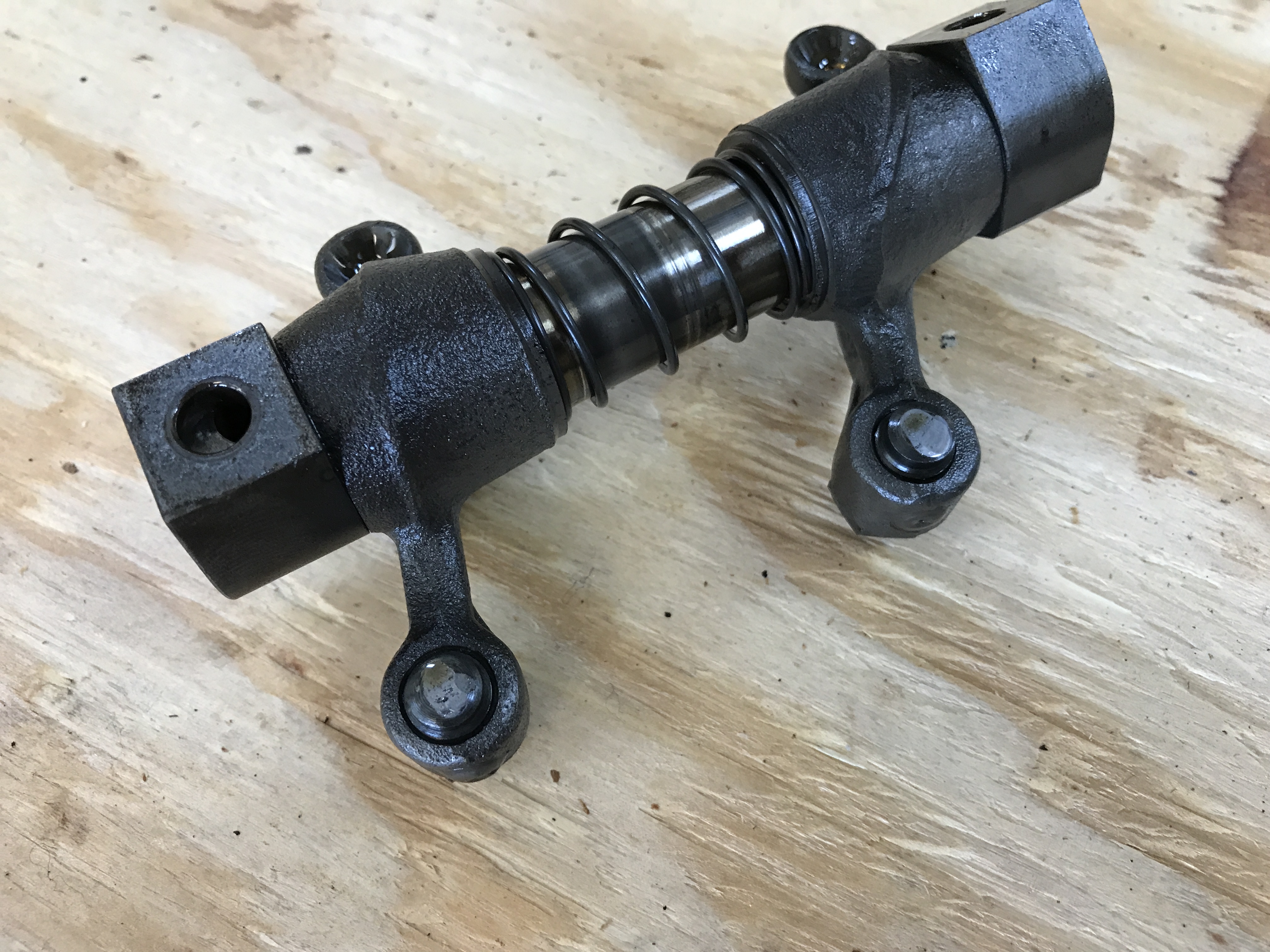

A couple of the adjusting screws have pits.

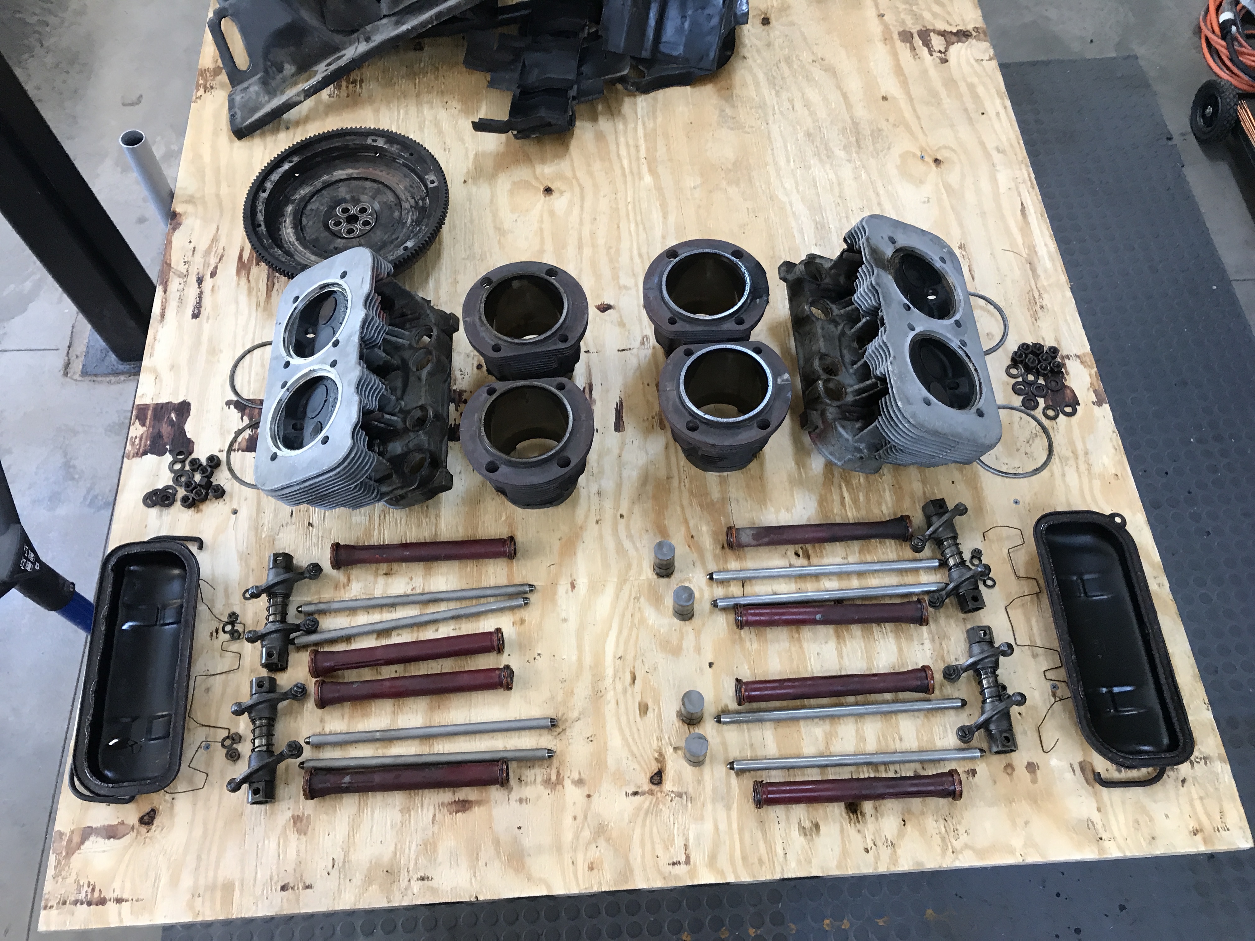

bkrantz
post Jul 2 2020, 08:06 PM
Post #872
914 Guru
Group: Members
Posts: 8,154
Joined: 3-August 19
From: SW Colorado
Member No.: 23,343
Everything came off easily: push rod tubes, heads, cylinders.
User is offlineProfile CardPM
Go to the top of the page
+Quote Post

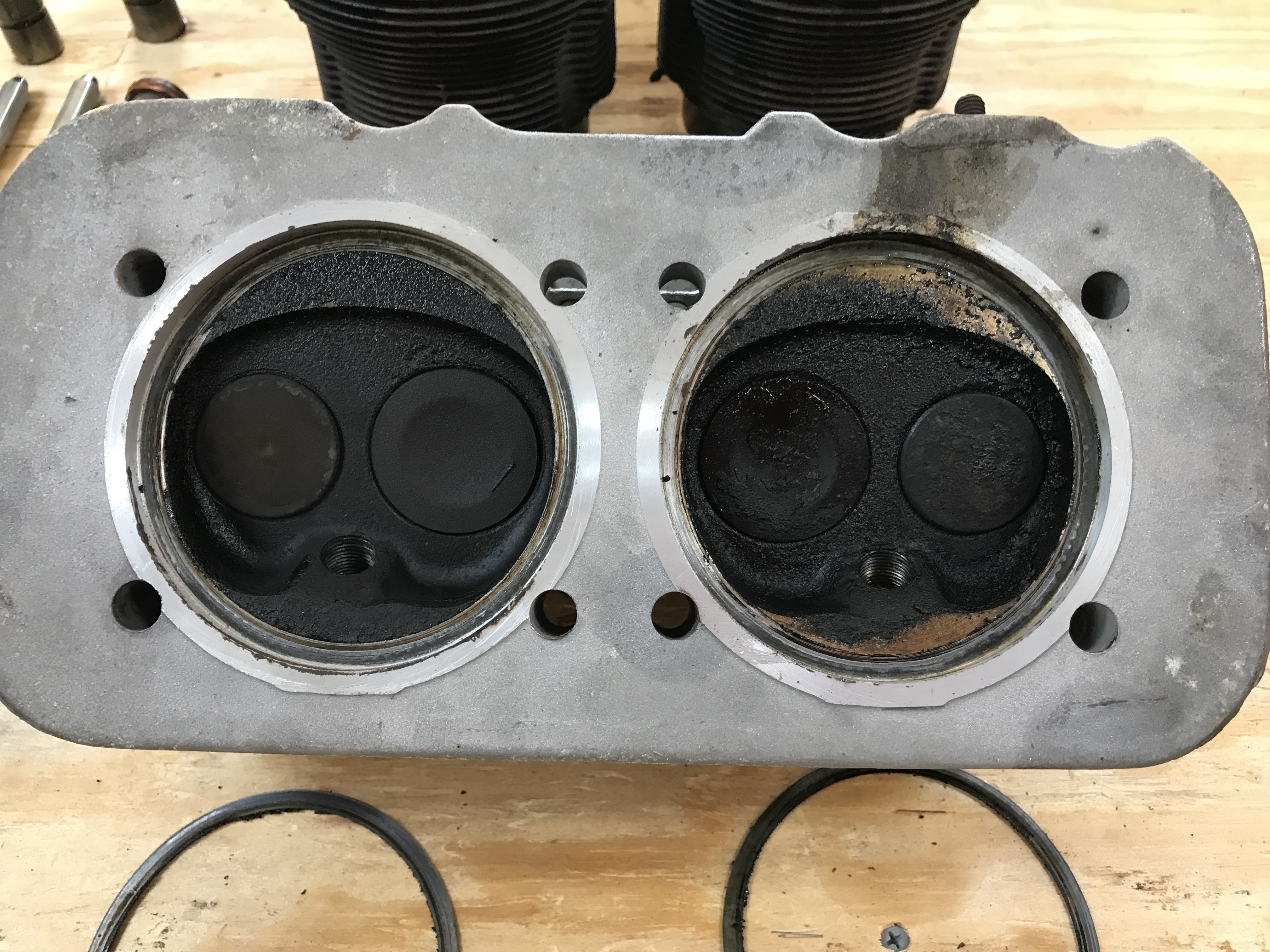

I need to clean off the carbon and crud, but the heads look OK so far. Left side.

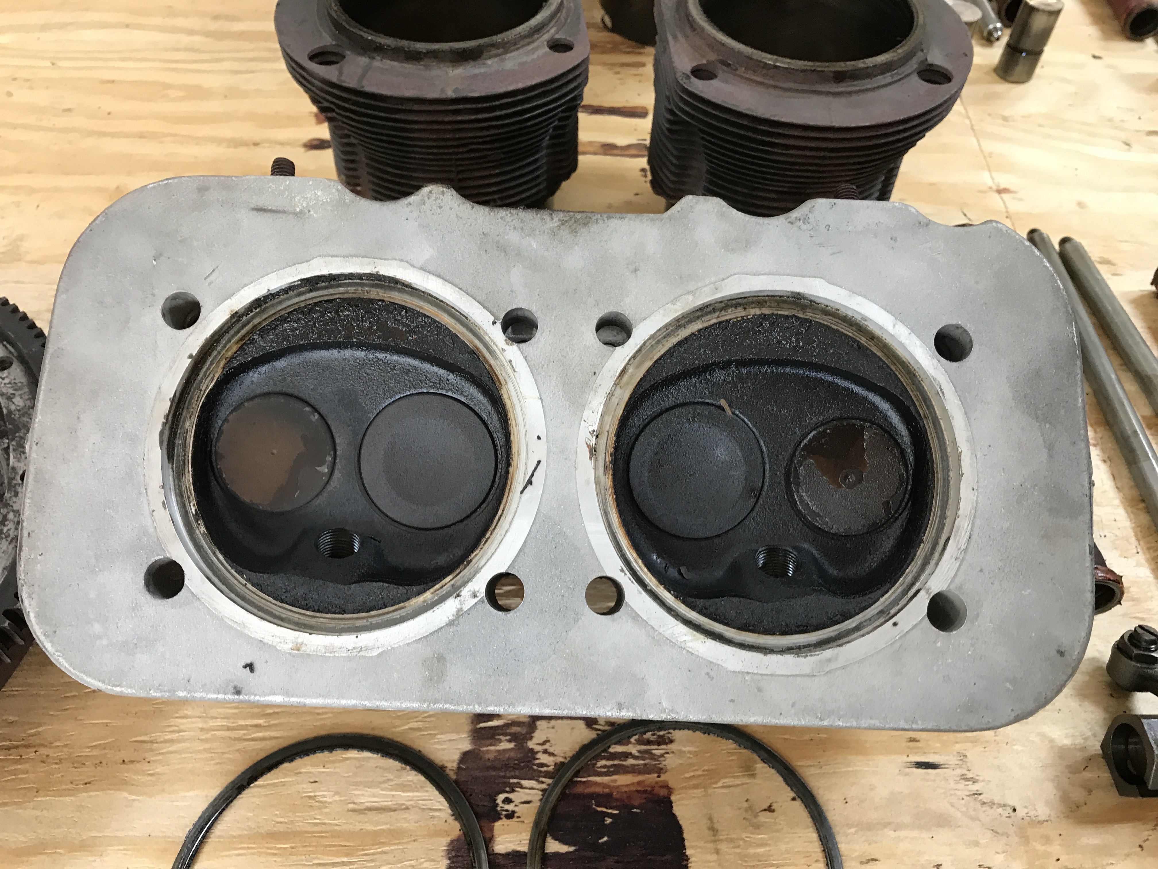

Right side.

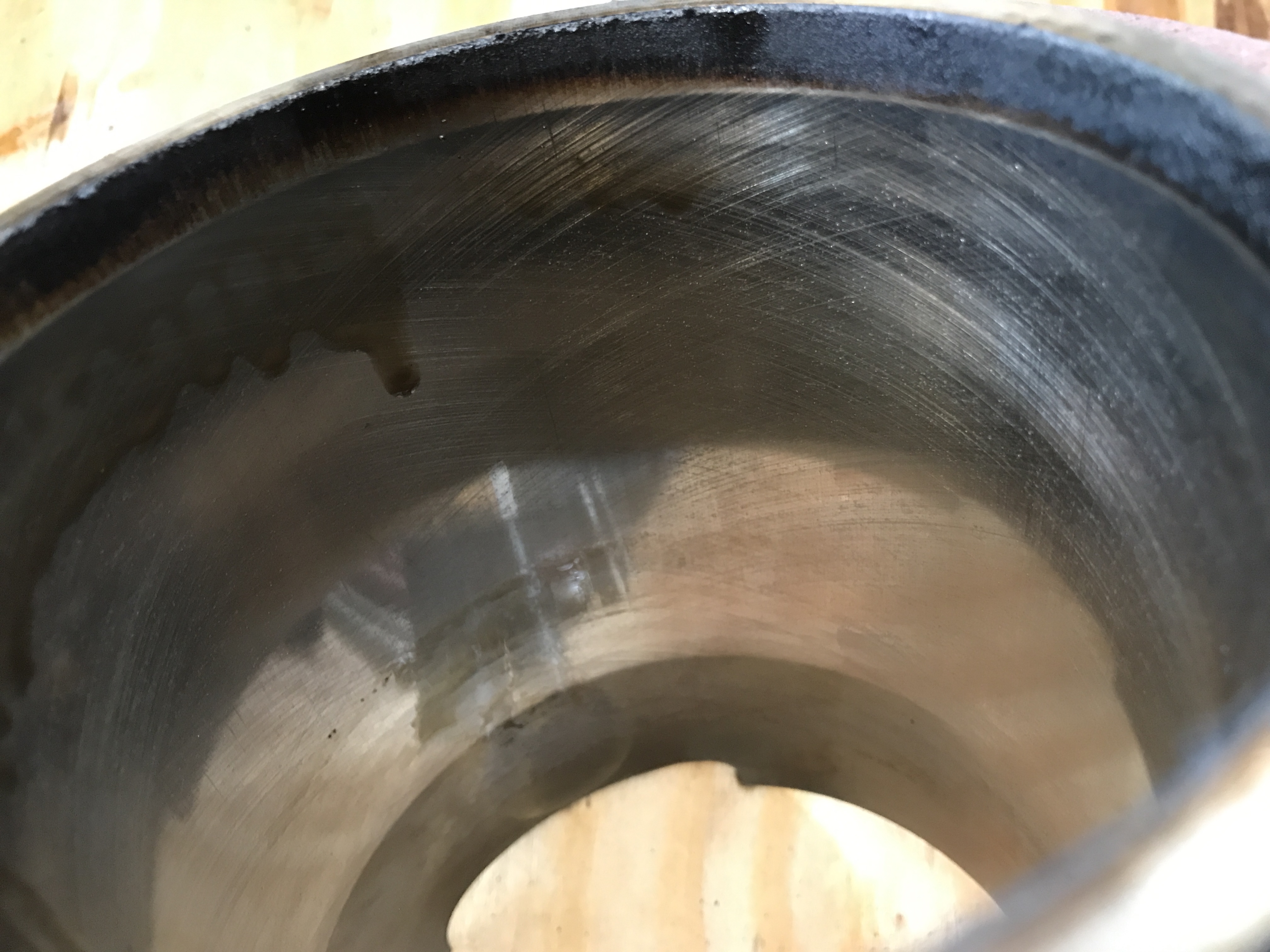

The cylinders even show cross hatching and no signs of wear.

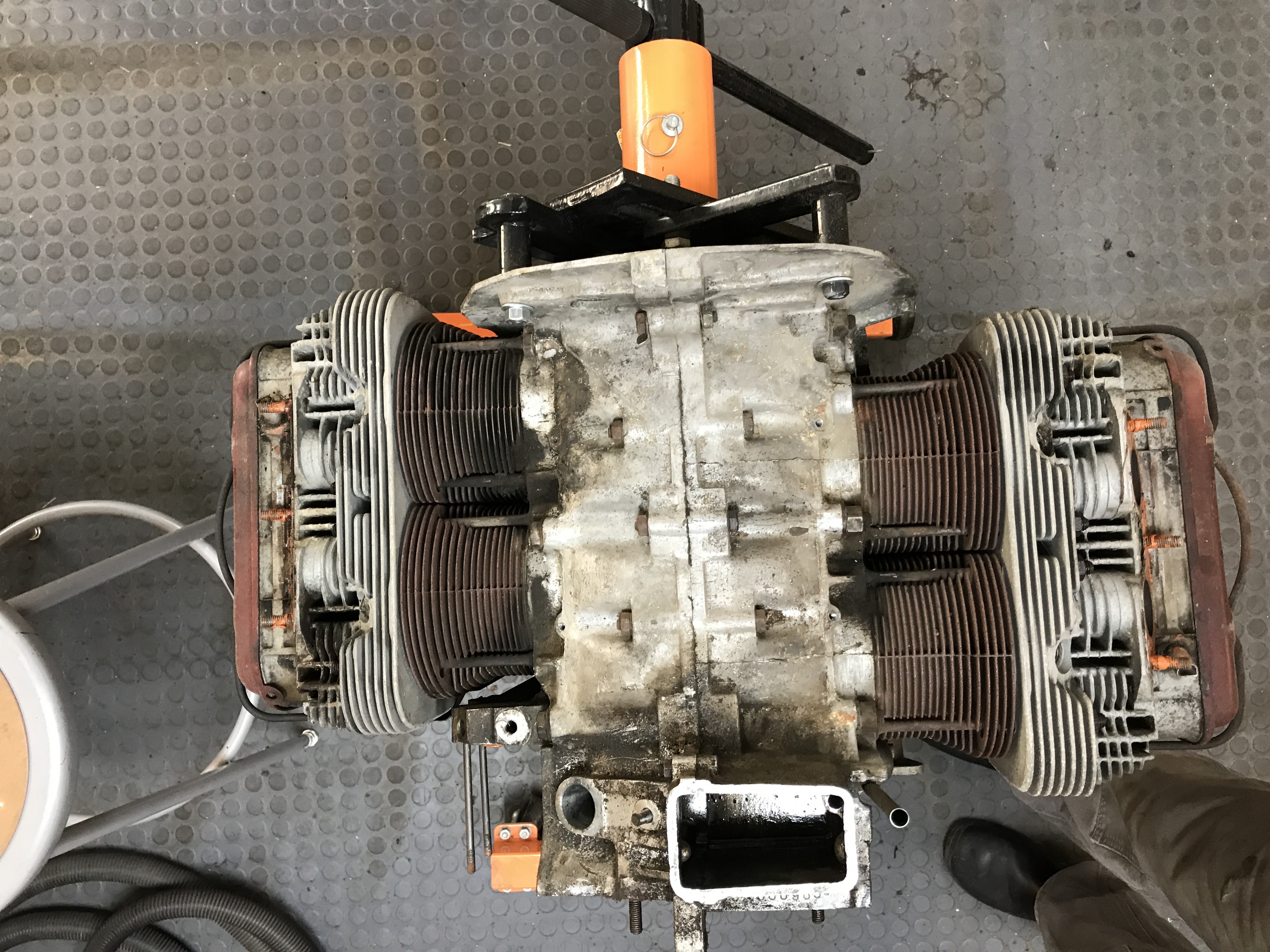

Next up: removing the pistons and miscellaneous, and then splitting the case.

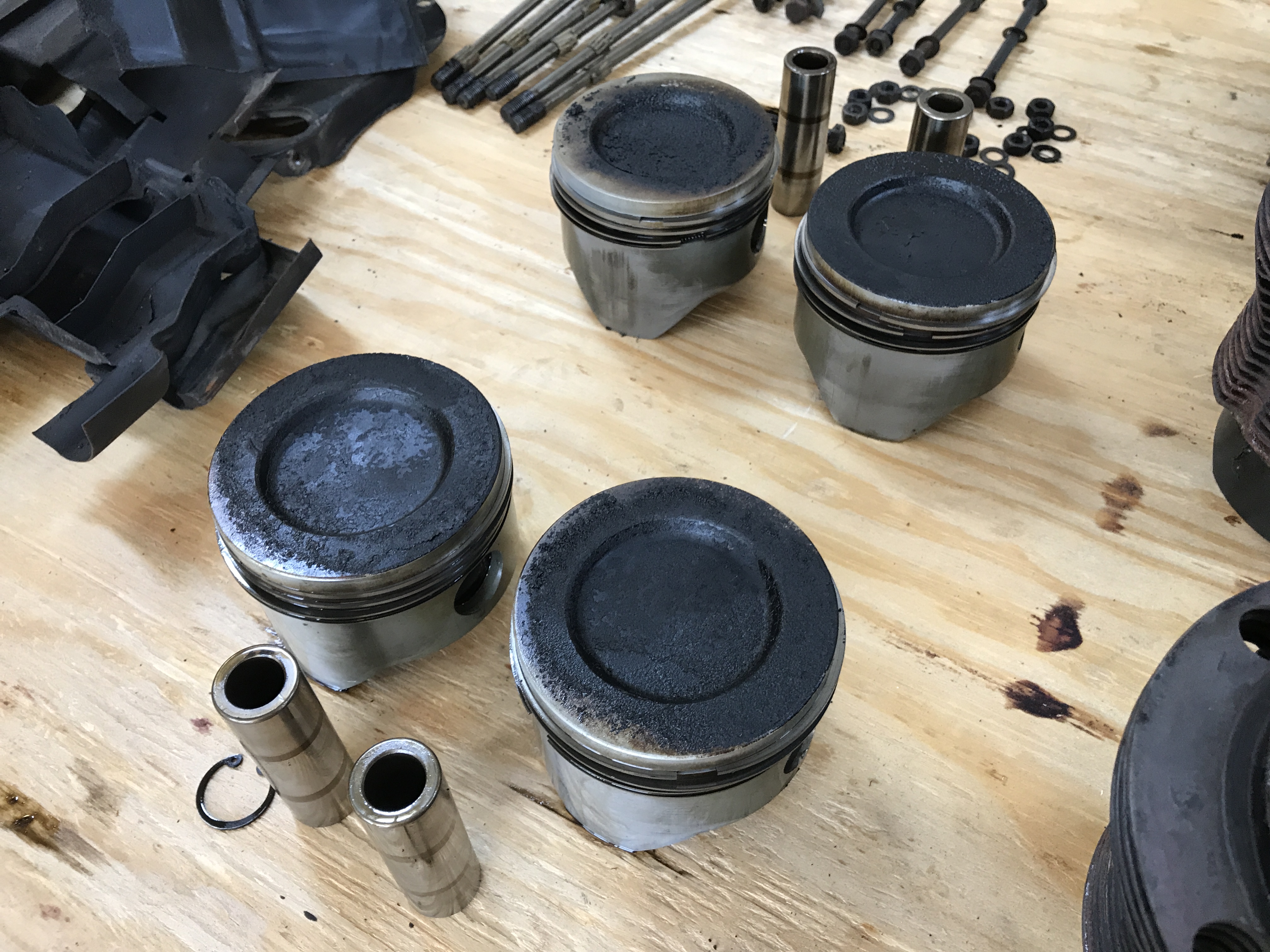

Pistons out. Looking OK, but with a lot of oily carbon crud on top.

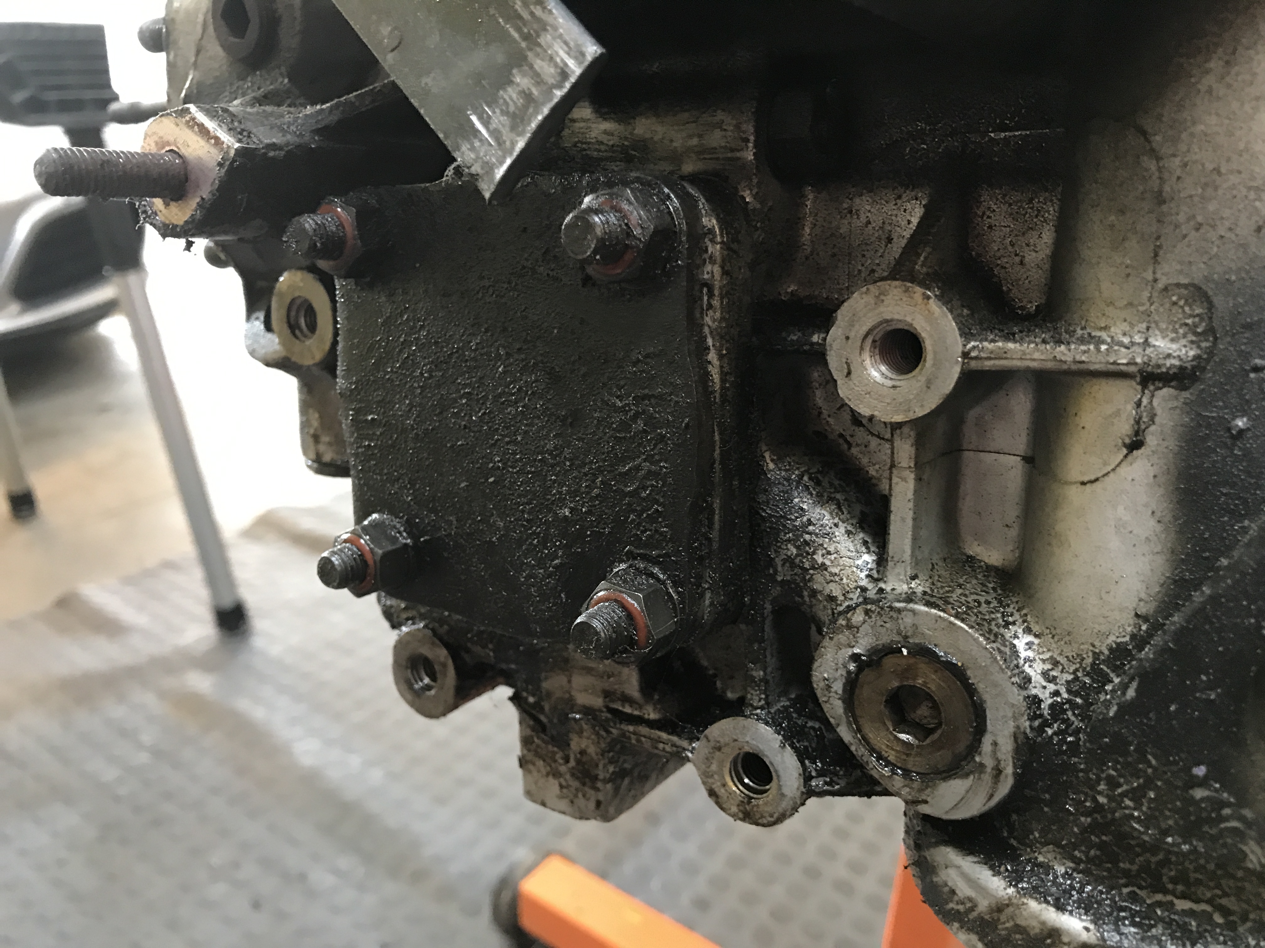

bkrantz
post Jul 3 2020, 08:43 PM
Post #879
914 Guru
Group: Members
Posts: 8,154
Joined: 3-August 19
From: SW Colorado
Member No.: 23,343
Oil pump, exterior view.

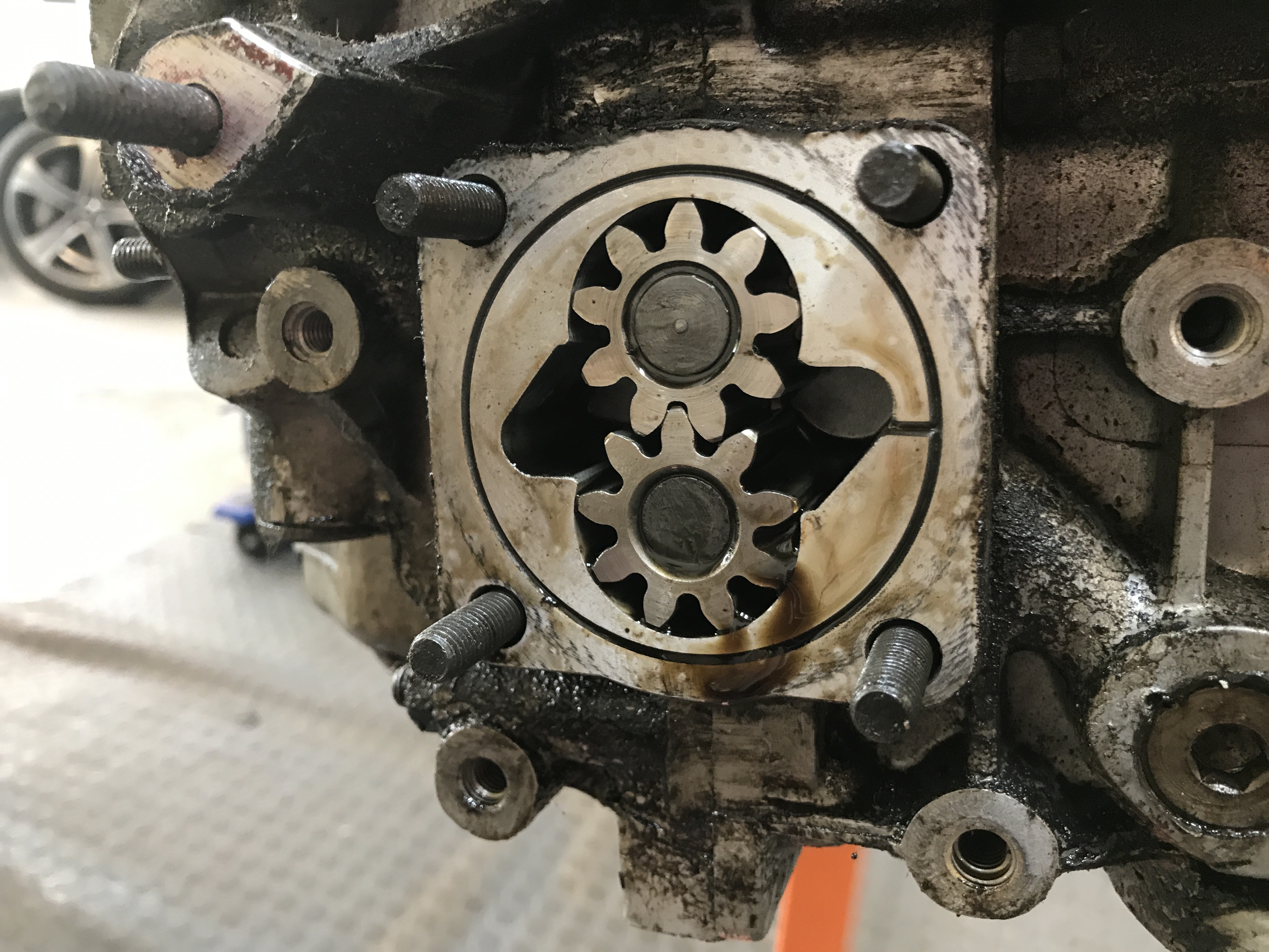

post Jul 3 2020, 08:47 PM
Post #880
914 Guru
Group: Members
Posts: 8,154
Joined: 3-August 19
From: SW Colorado
Member No.: 23,343
Oil pump, interior. Anyone recognize this pump?
