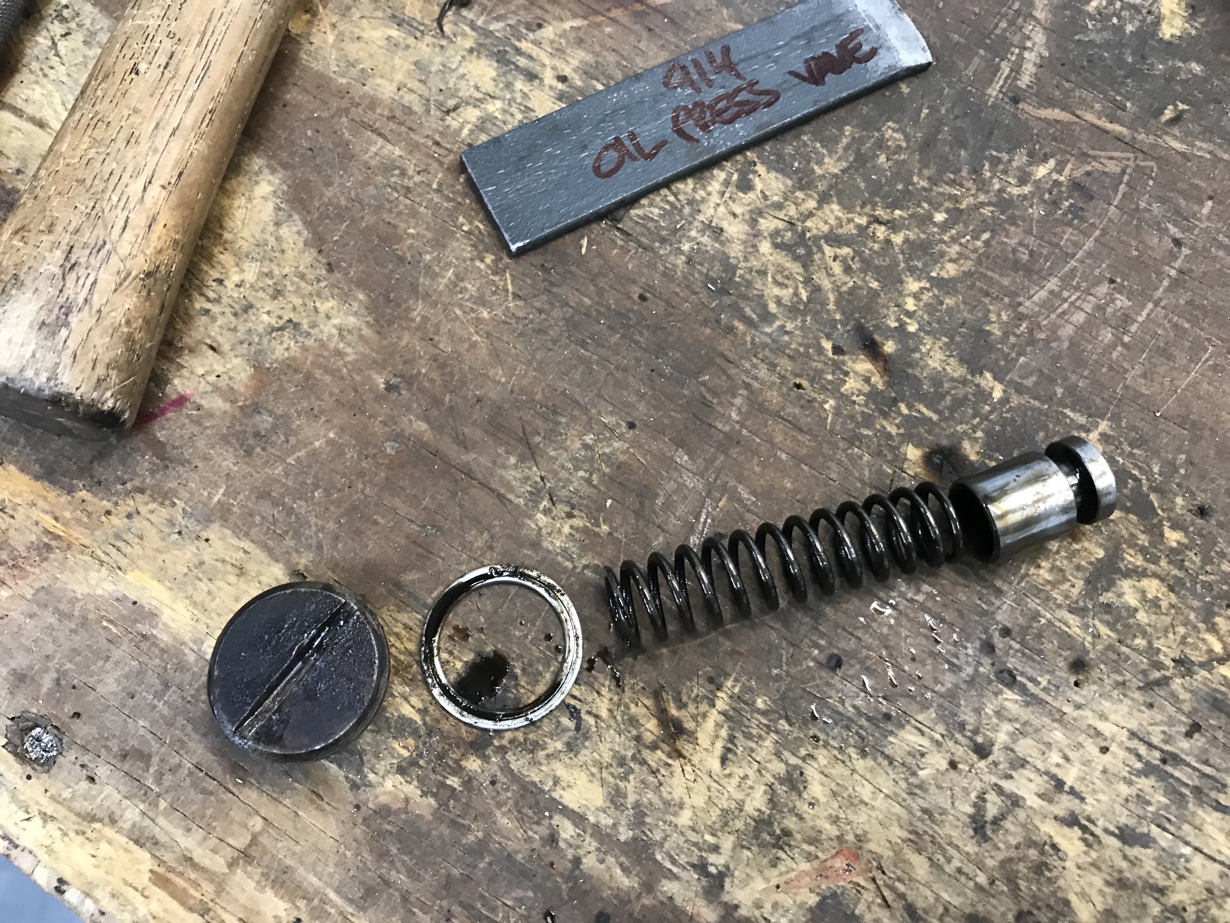

Pressure relief valve parts.

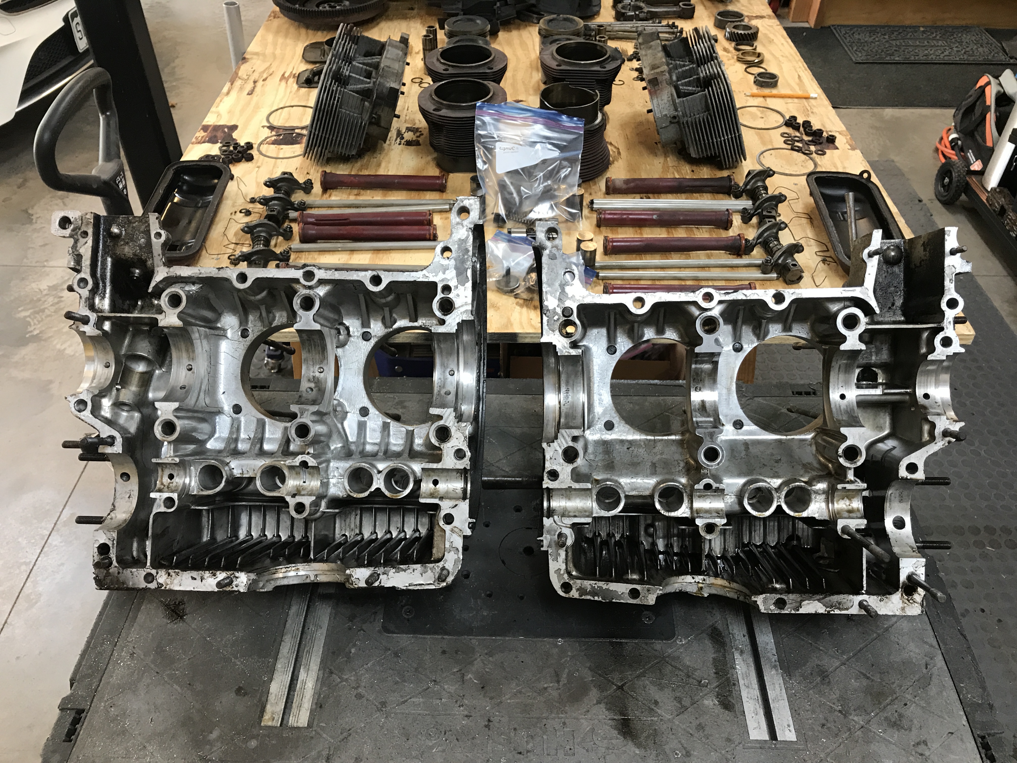

More inspection of the case. I am still waiting on new solvent for my parts cleaner.

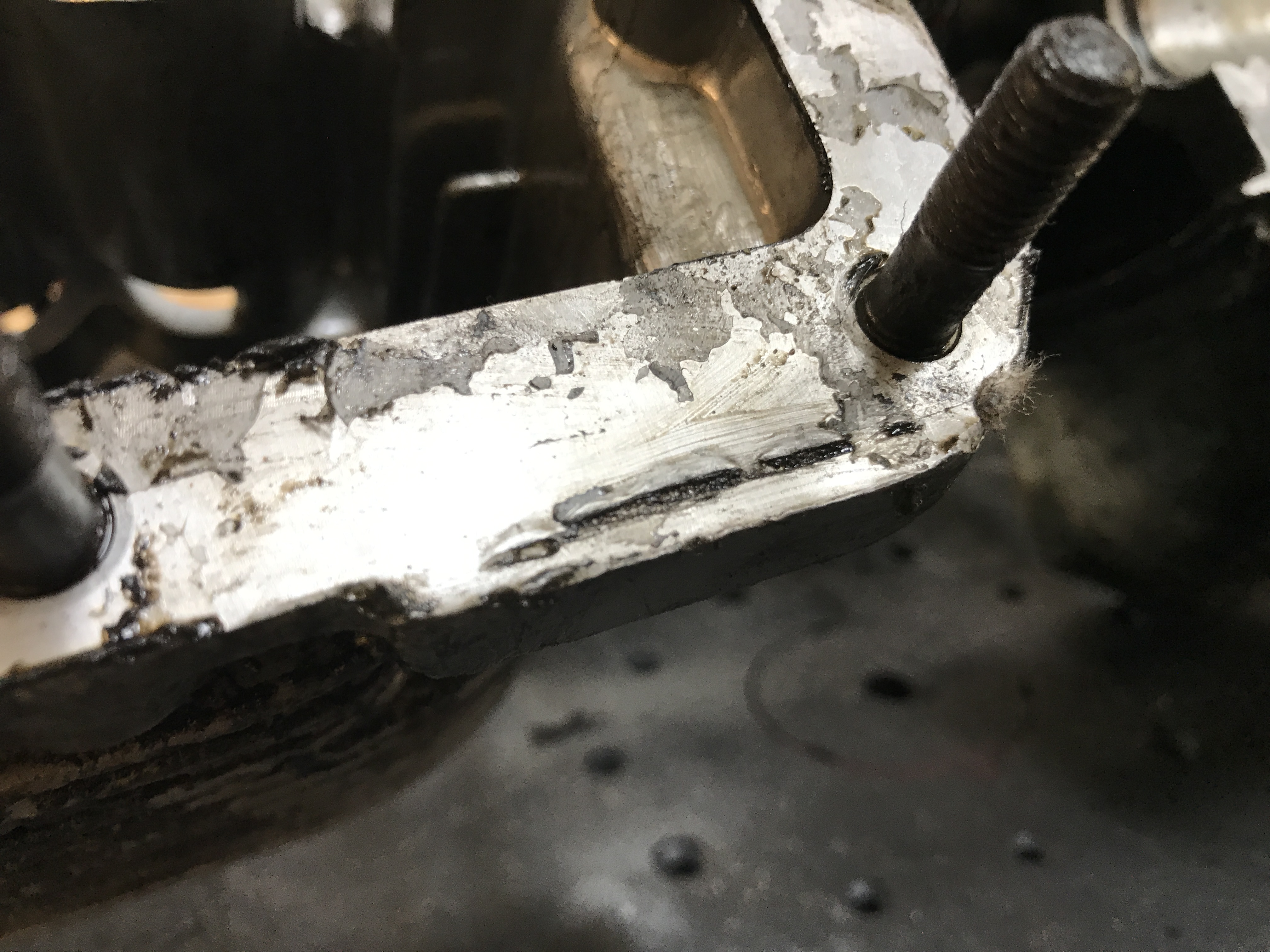

I found evidence of where a PO got rough separating the case halves.
bkrantz
post Jul 5 2020, 08:35 PM
Post #905
Posts: 8,342
Joined: 3-August 19
From: SW Colorado
Member No.: 23,343
I swear it wasn't me!

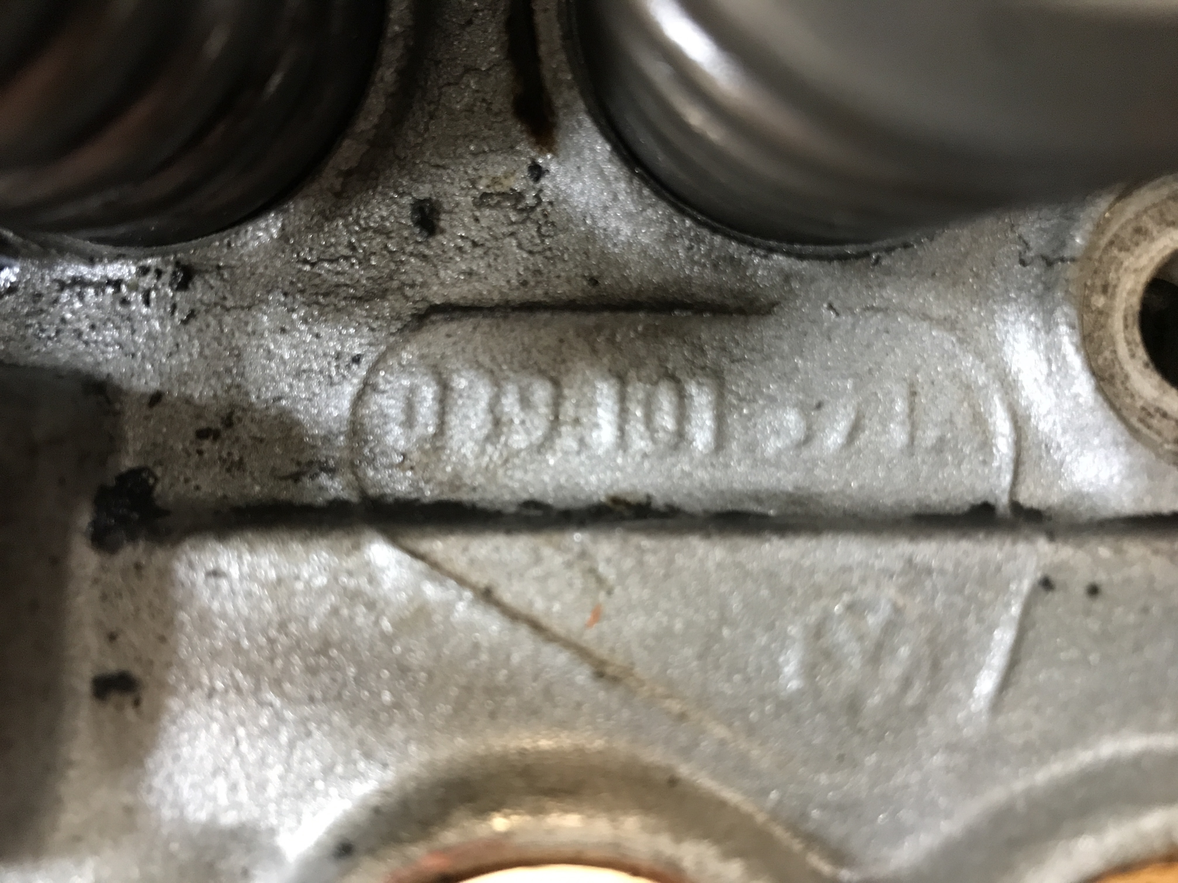

Cylinder head marking 1.

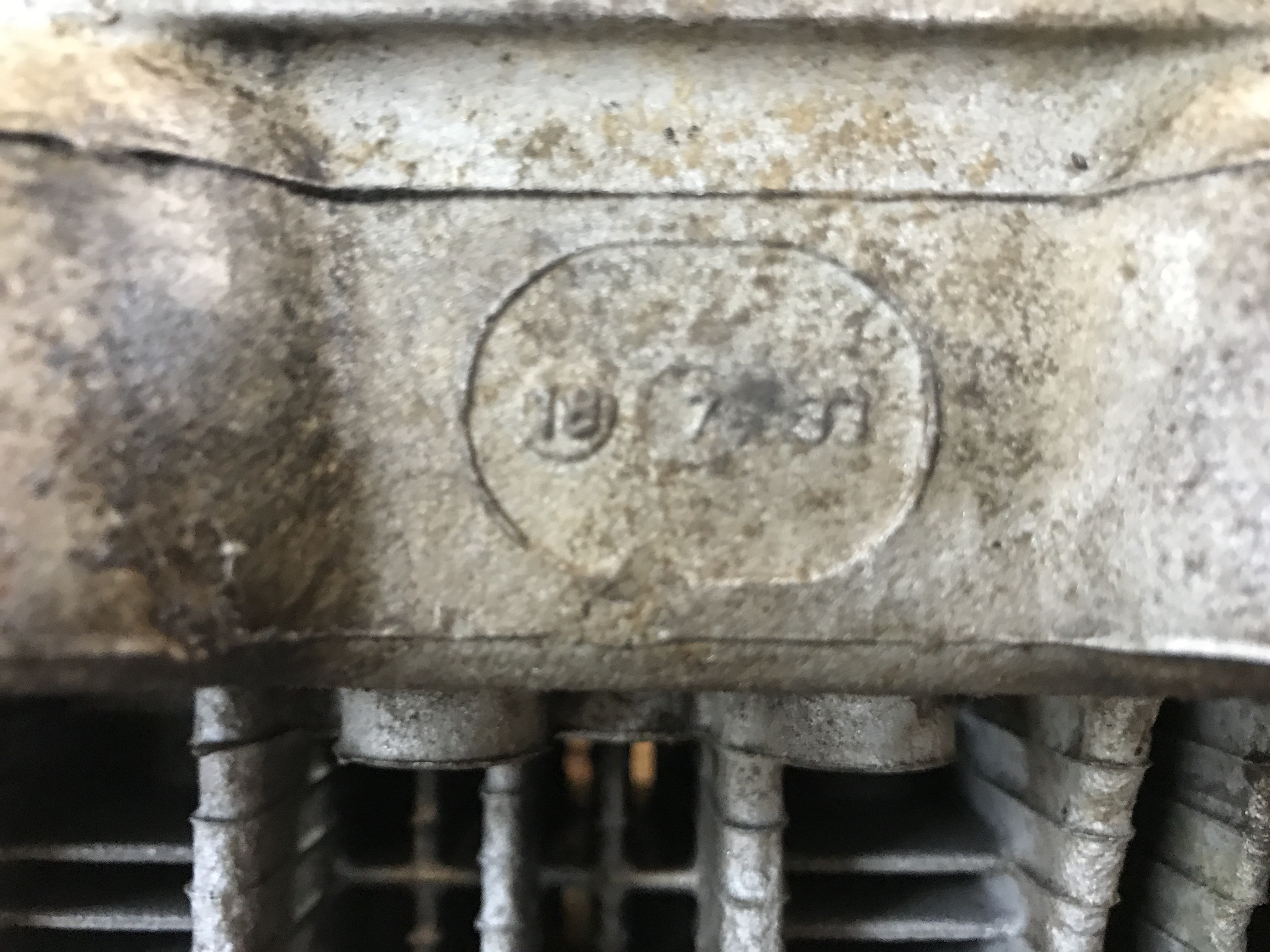

Marking 2.

Member No.: 1,143
QUOTE(bkrantz @ Jul 5 2020, 09:35 PM) *
That's gonna cause an oil leak.....

QUOTE(ClayPerrine @ Jul 6 2020, 07:18 AM) *
Most likely. On the list to fix.

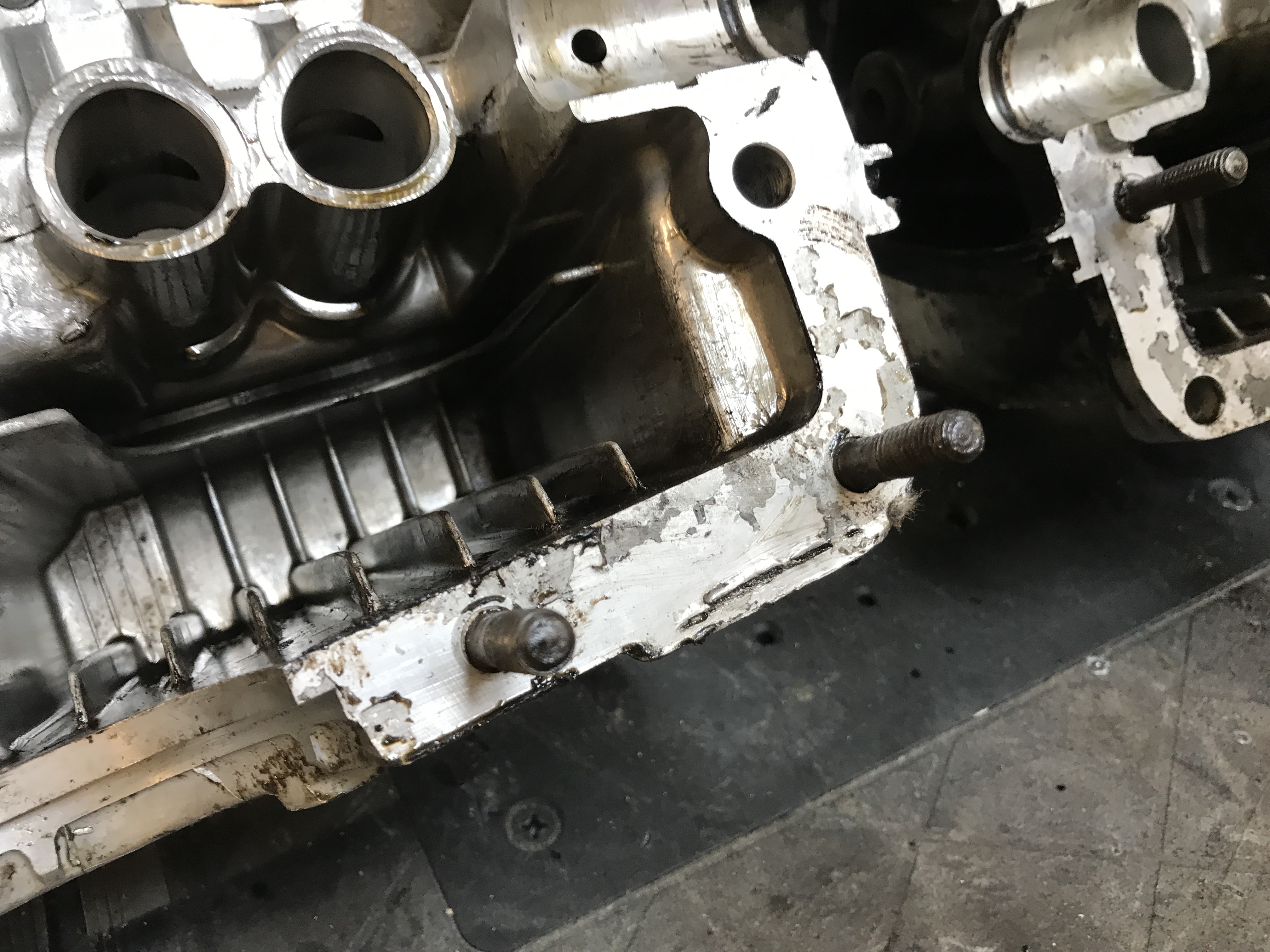

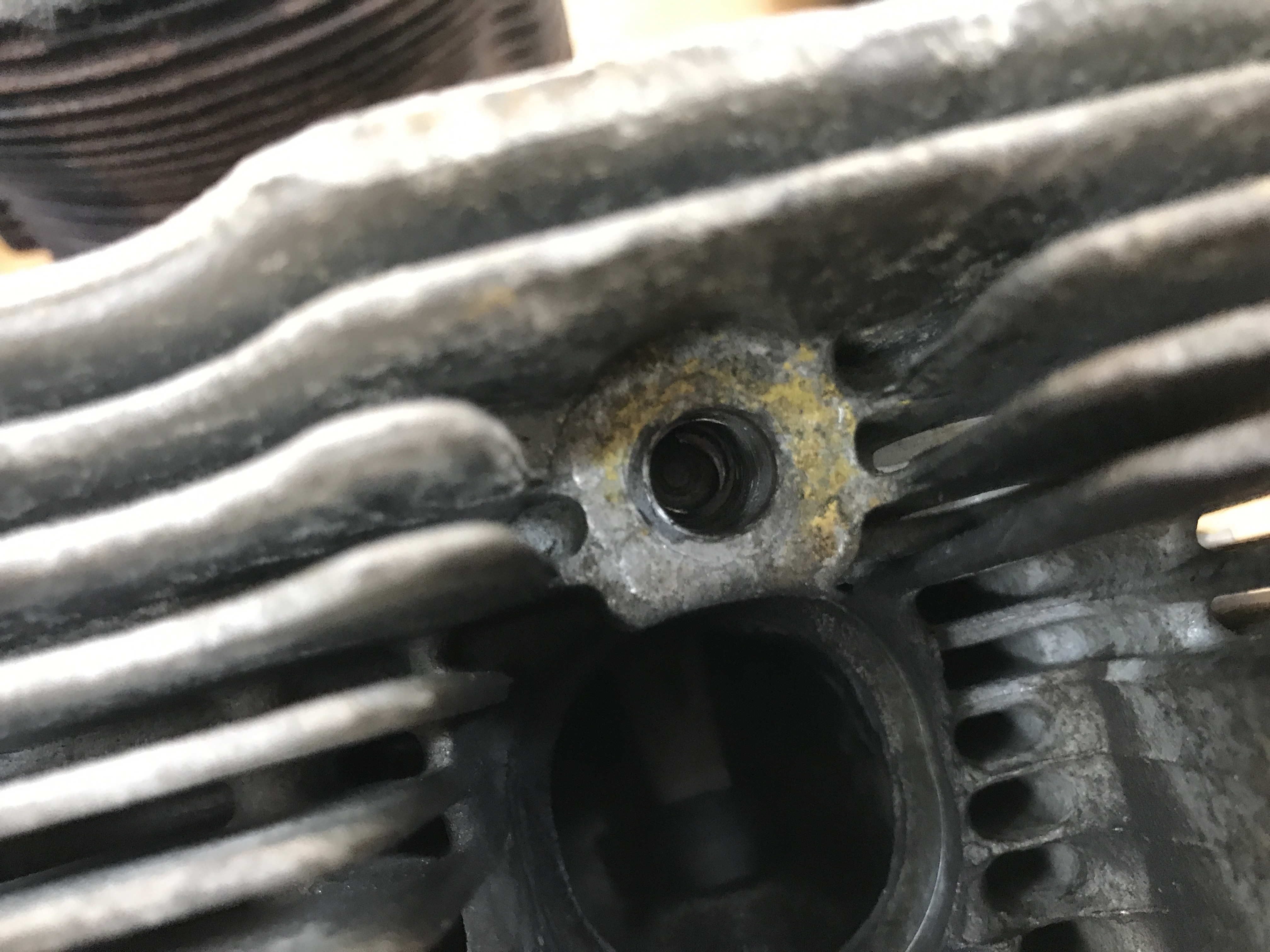

The left cylinder head has a pulled exhaust stud.

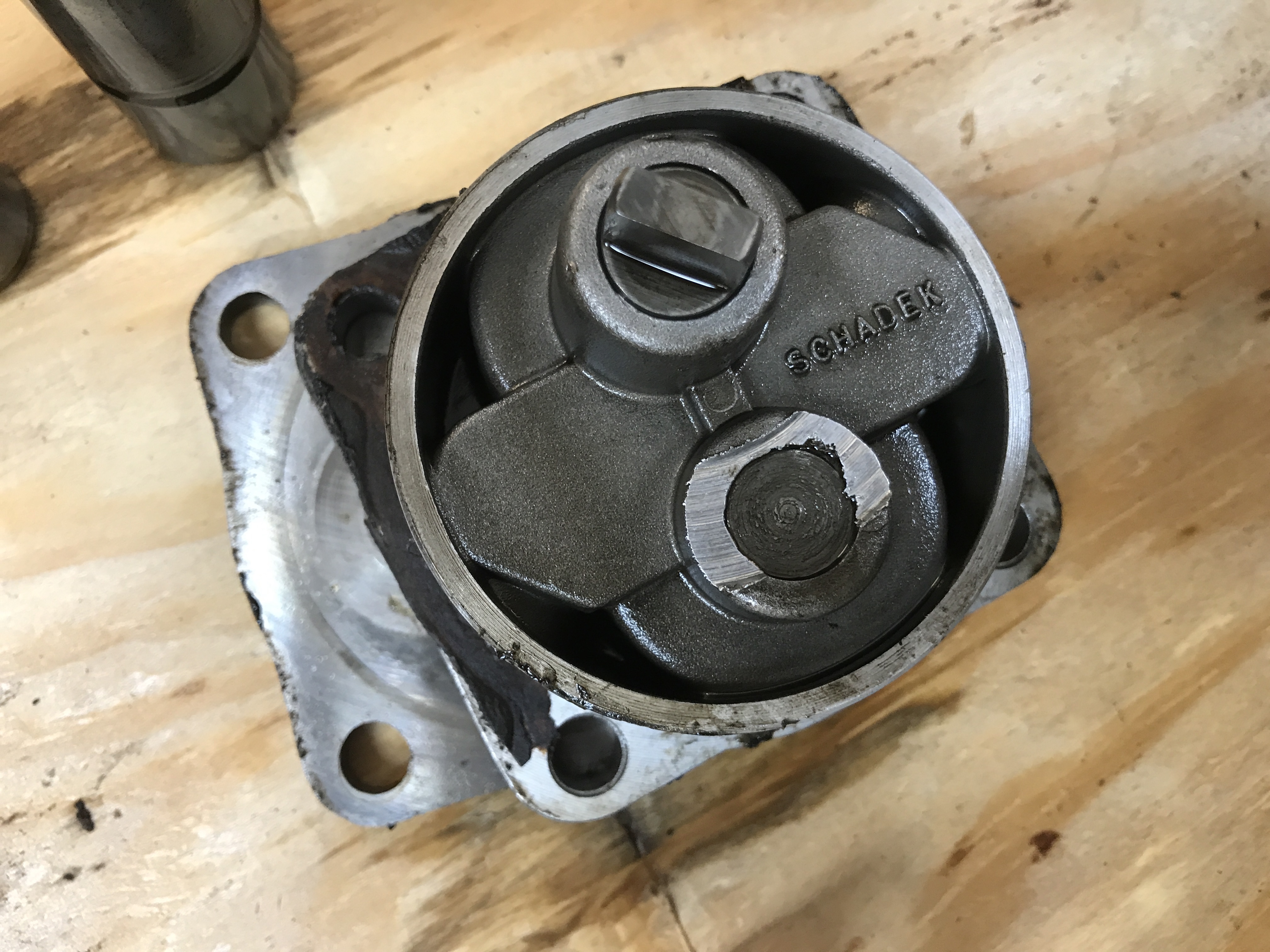

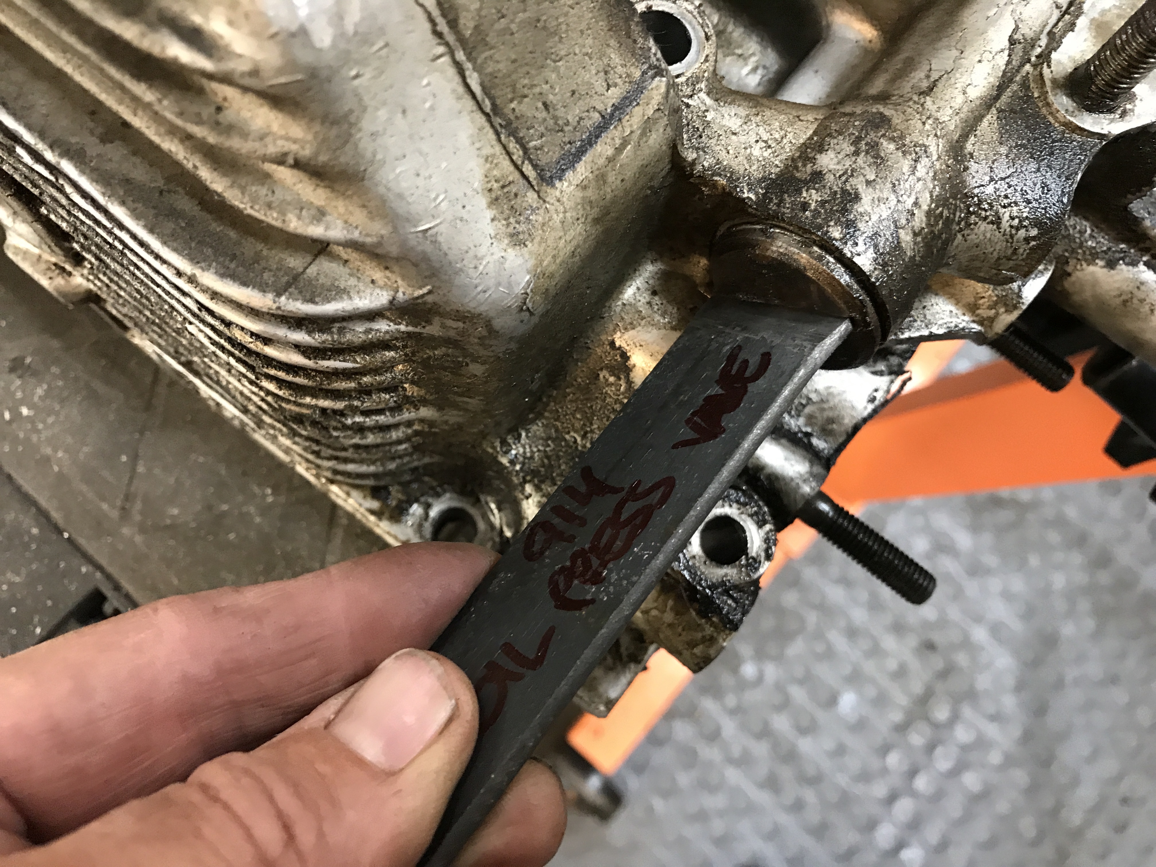

The type 1 oil pump made contact, probably with a camshaft. But not the cam I removed, since the bolt heads on the cam gear are pristine.

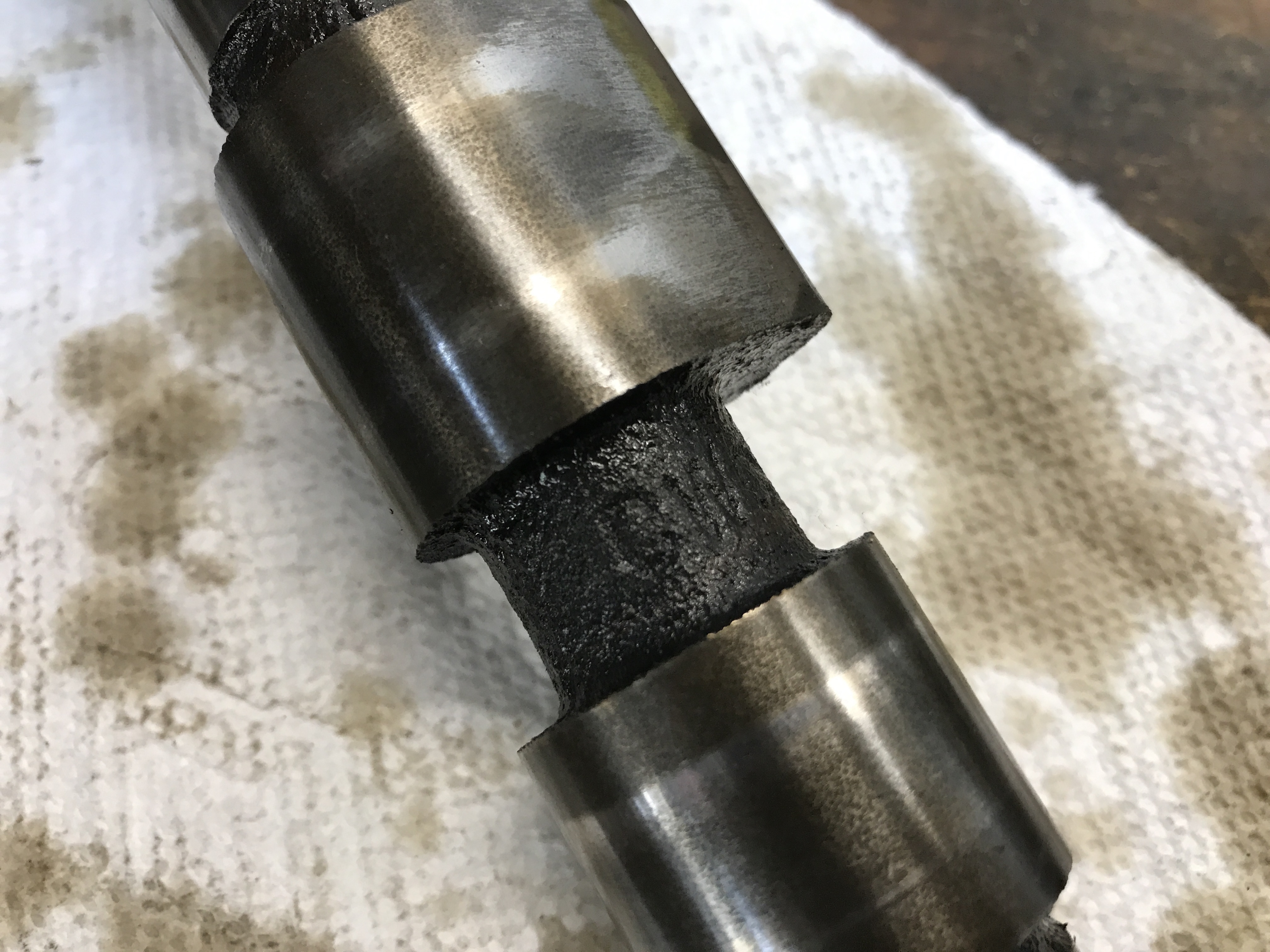

Some ID info, cast into the cam. This looks like a CWC cam. But with an intake lift of about .318 and exhaust lift of .306, it is far from stock--and probably not compatible with the stock FI.

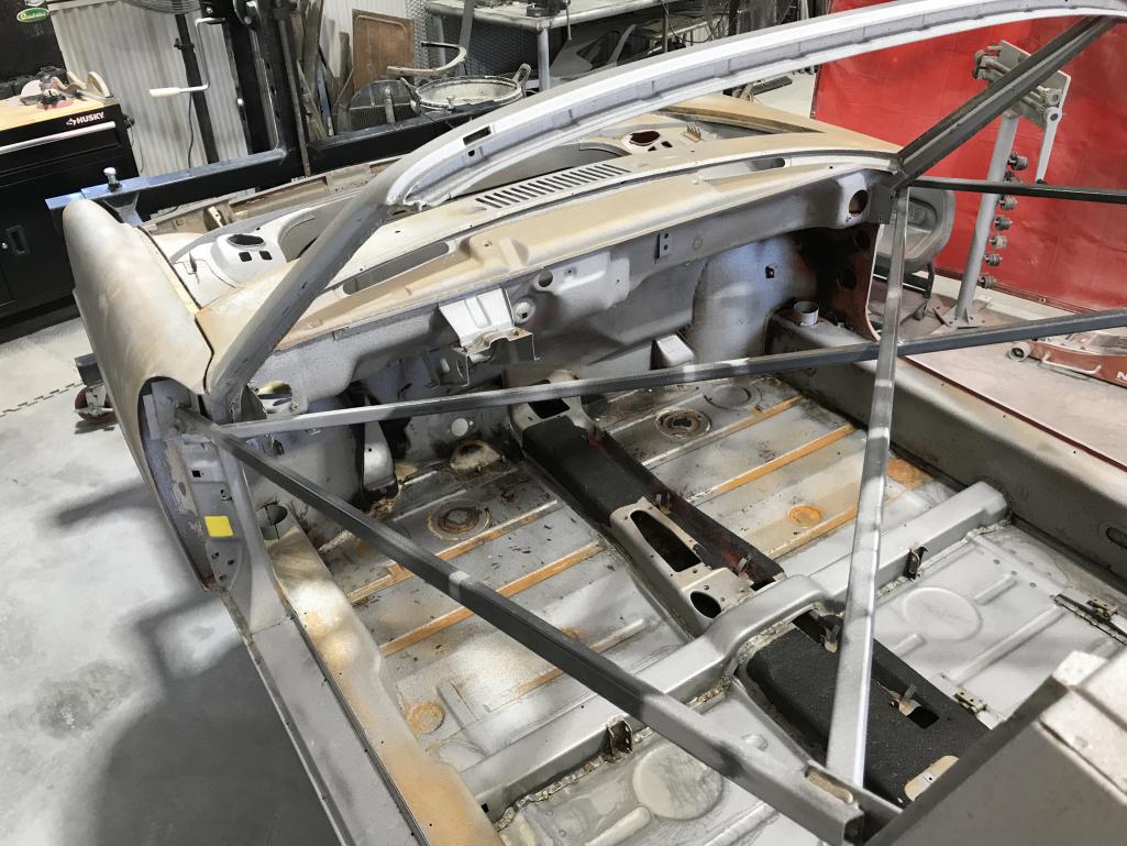

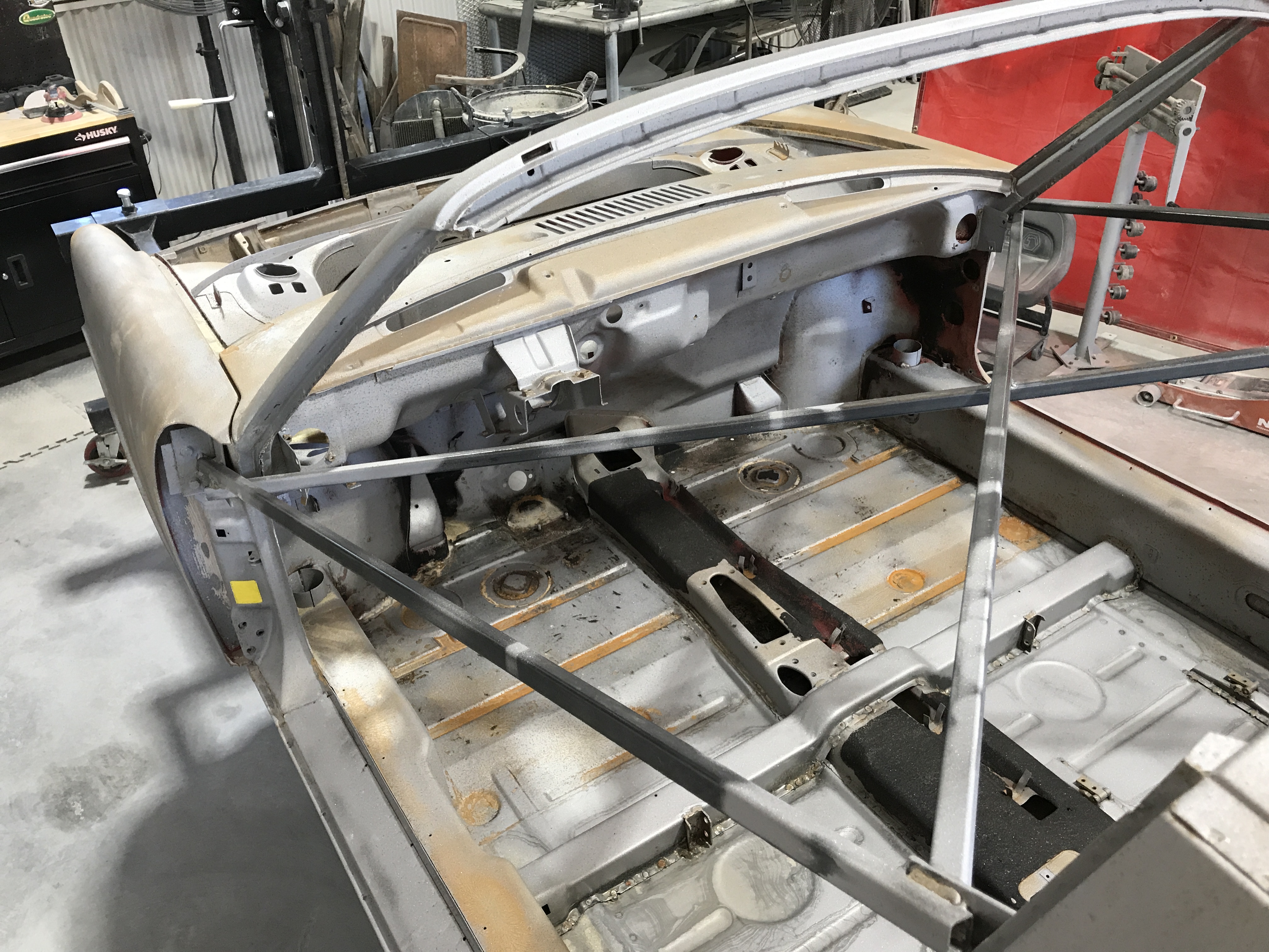

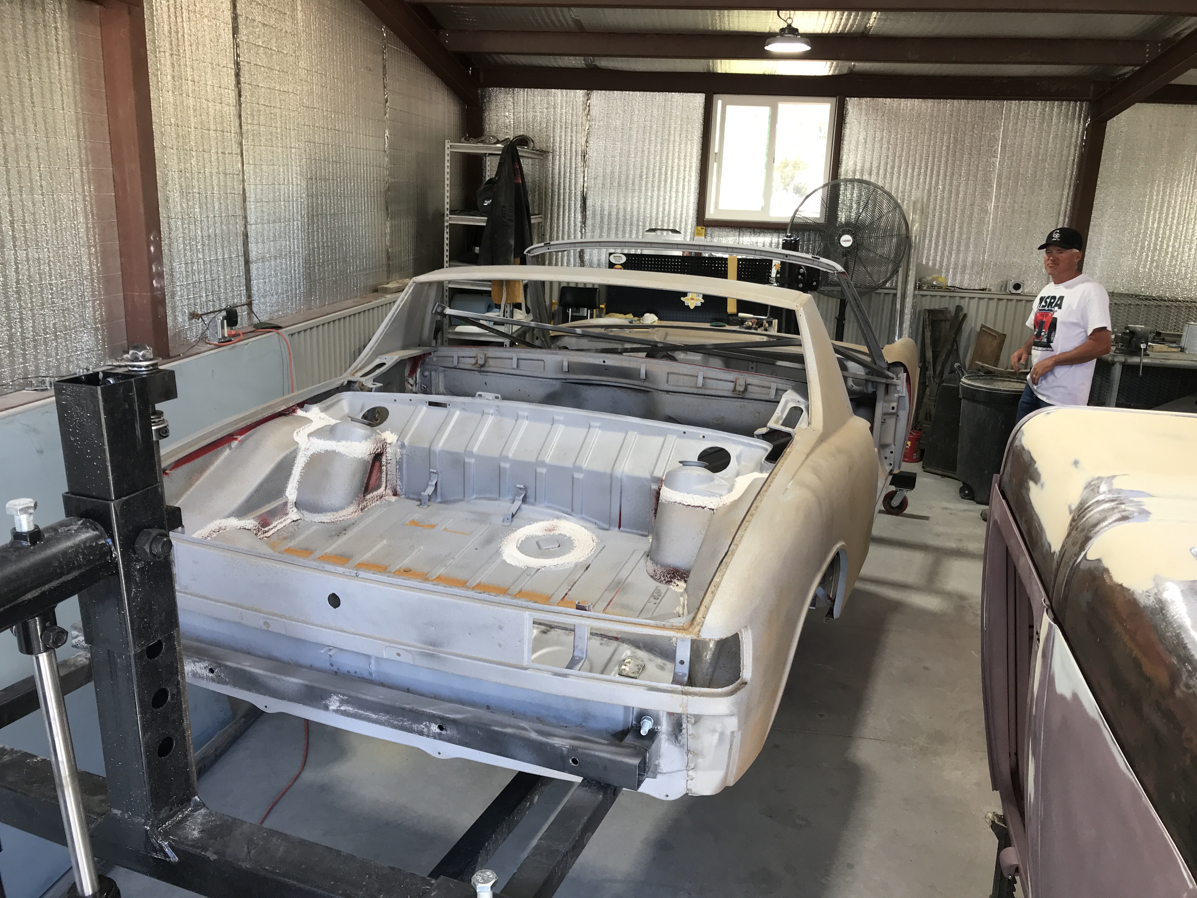

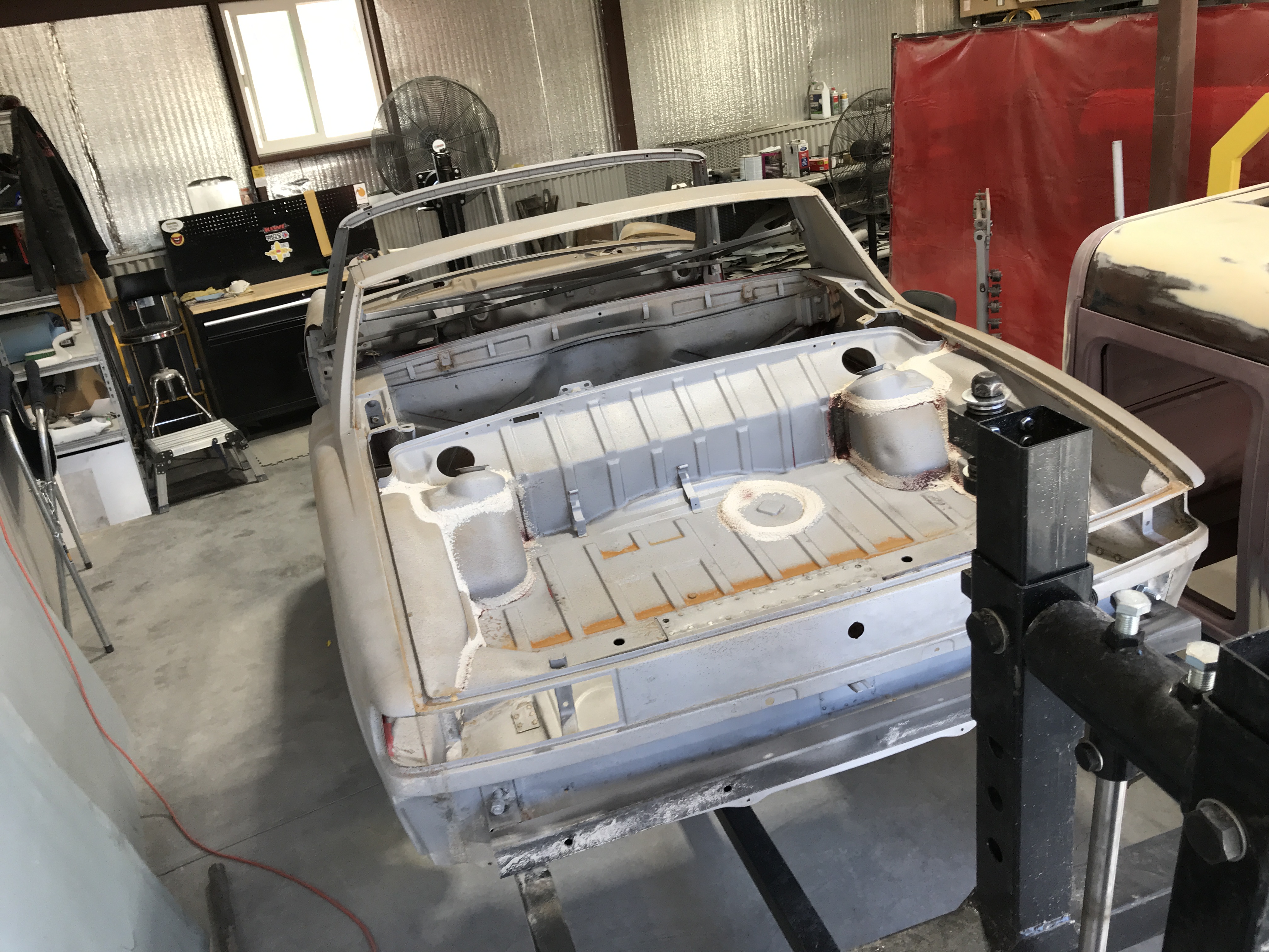

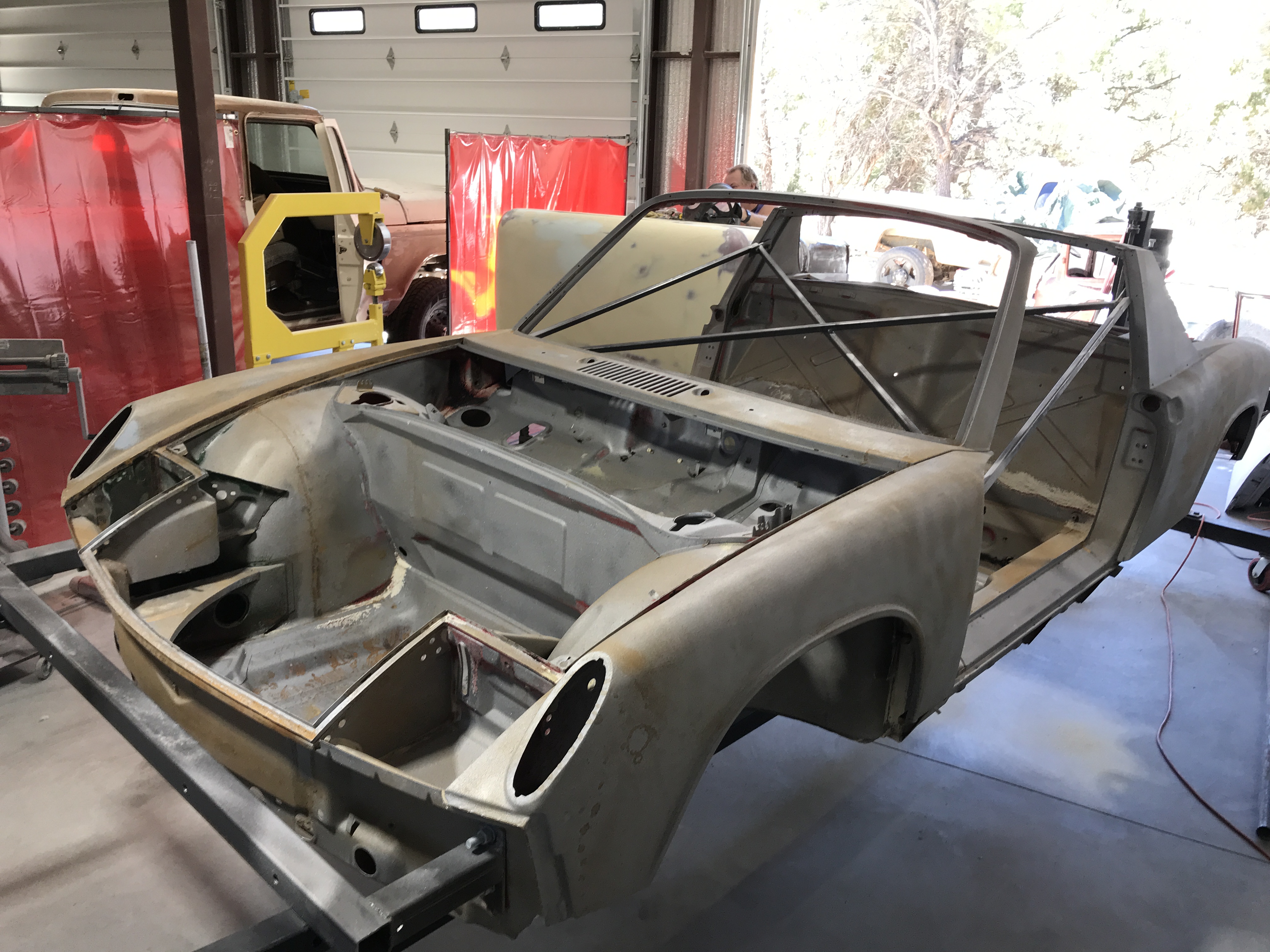

I stopped by the body shop today. They finished stripping the paint yesterday, with a dustless blaster rig.
bkrantz
post Jul 8 2020, 08:07 PM
Post #917
Posts: 8,342
Joined: 3-August 19
From: SW Colorado
Member No.: 23,343
First good news: no surprises under the paint.
bkrantz
post Jul 8 2020, 08:08 PM
Post #918
Posts: 8,342
Joined: 3-August 19
From: SW Colorado
Member No.: 23,343

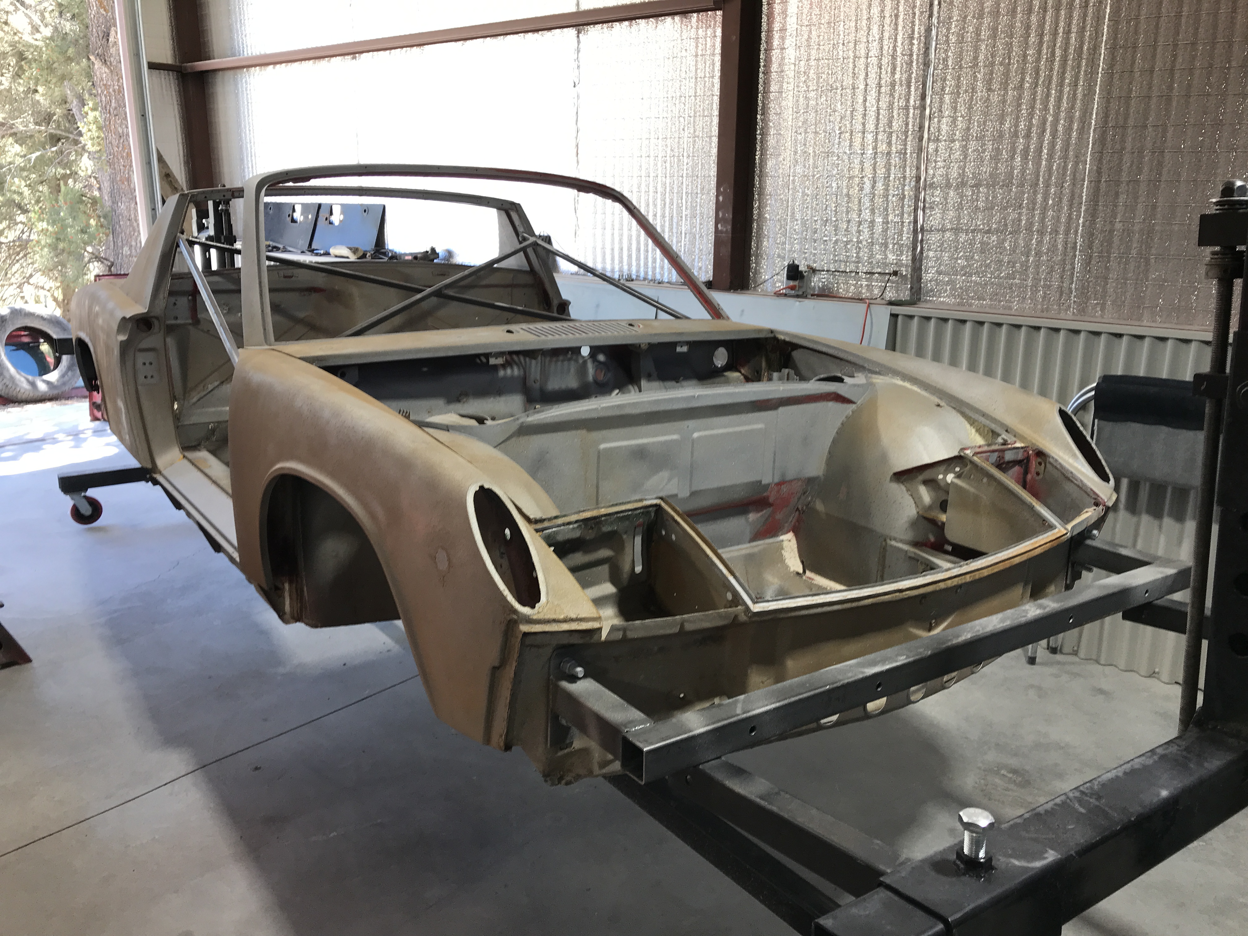

Second good news: the guys at the shop at least acted reasonably impressed with all my work.
bkrantz
post Jul 8 2020, 08:10 PM
Post #919
Posts: 8,342
Joined: 3-August 19
From: SW Colorado
Member No.: 23,343
The shop owner just bought a rotisserie, and will keep my car mounted for now, probably through painting the underside.
