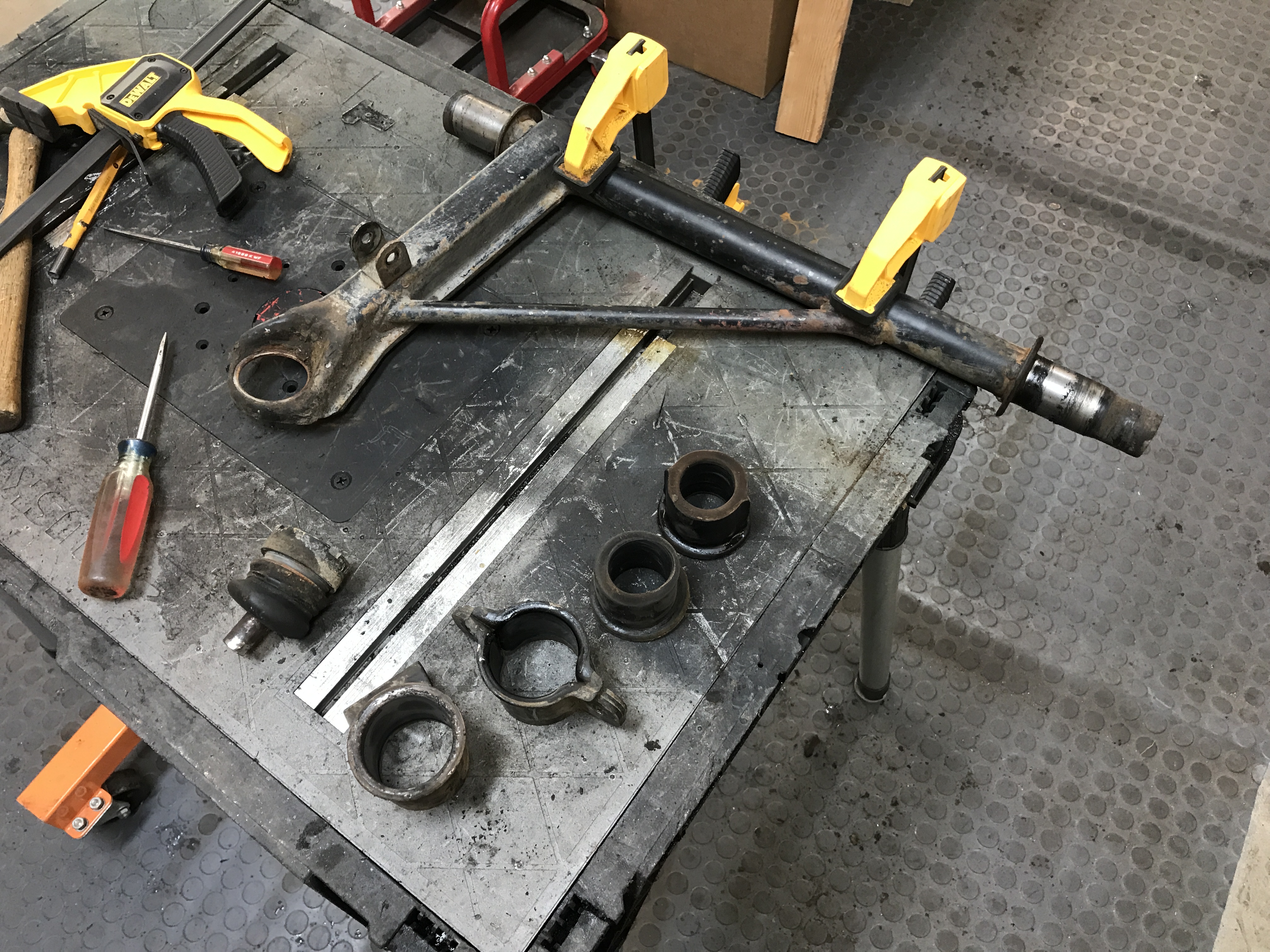

Posts: 8,342
Once the end fitting is off, I then pried the bushing out.
post Jul 24 2020, 09:04 PM
Post #982
Posts: 8,342
I also removed the ball joints. Given the neat and tidy bending of the cotter pins, I bet these were original.

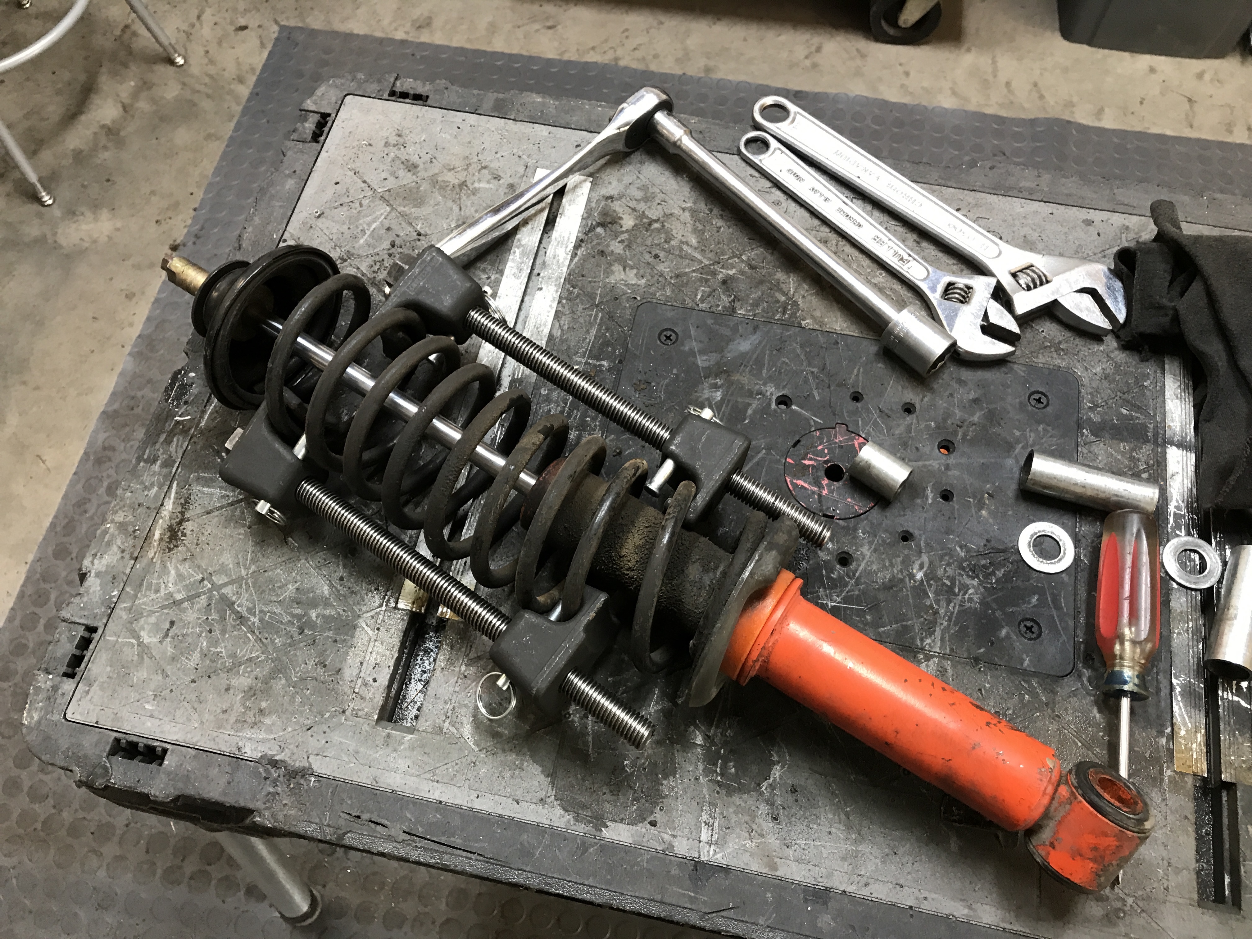

Next, I took the rear shocks and springs apart. Pretty easy with my trusty spring compressor. I originally bought these for working on 914 springs almost 30 years ago.

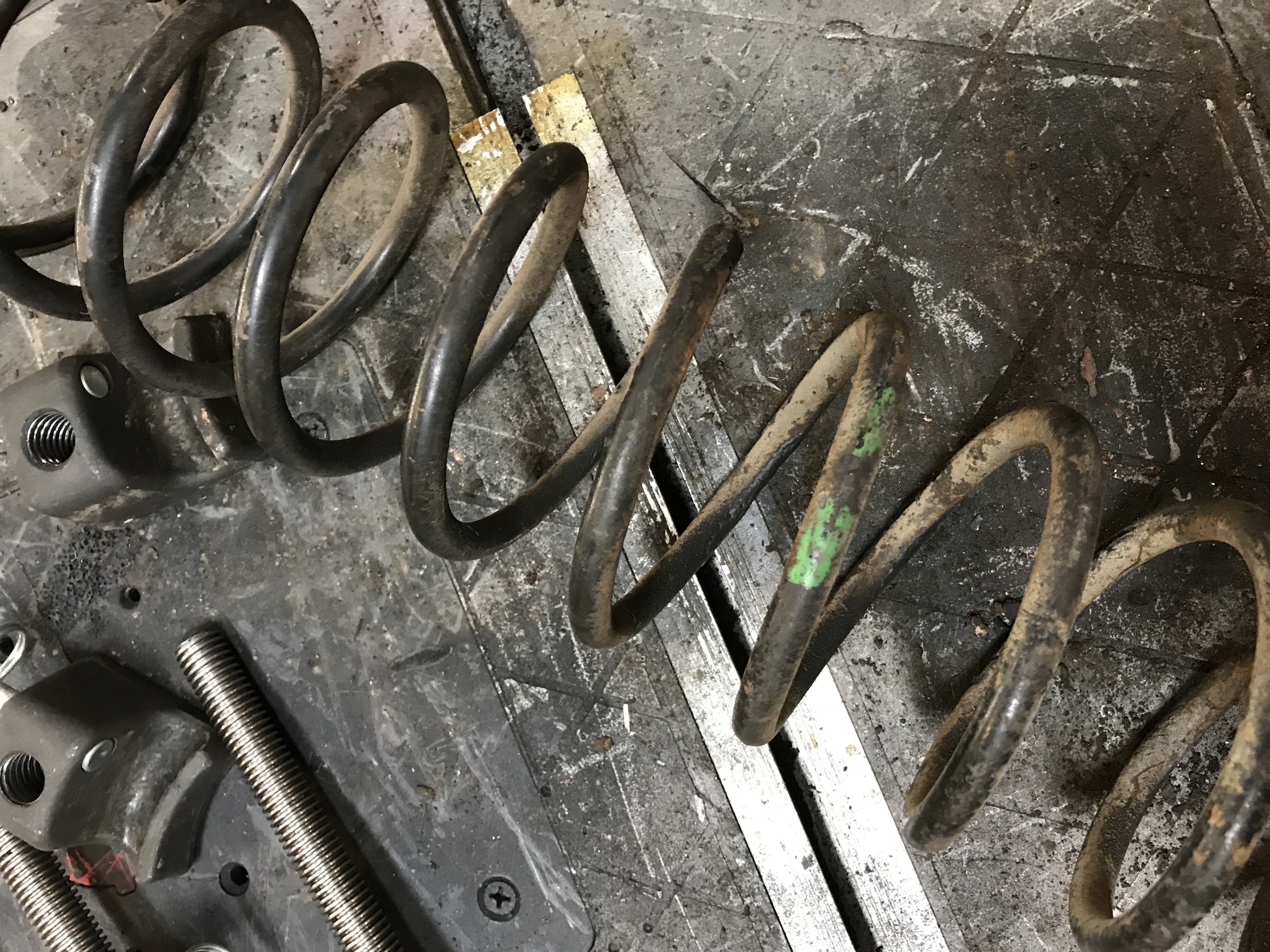

These springs have green color code.

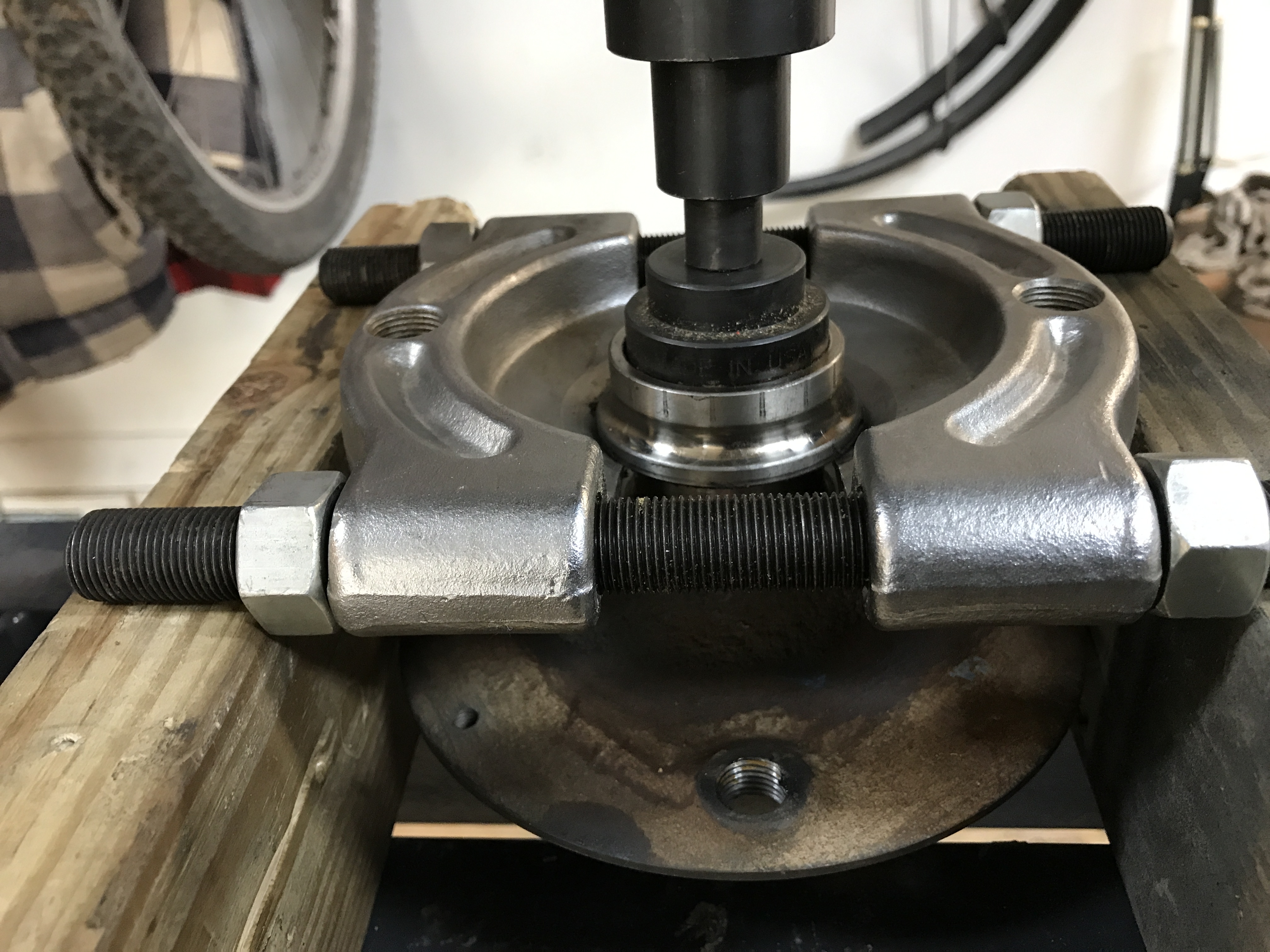

Posts: 8,342

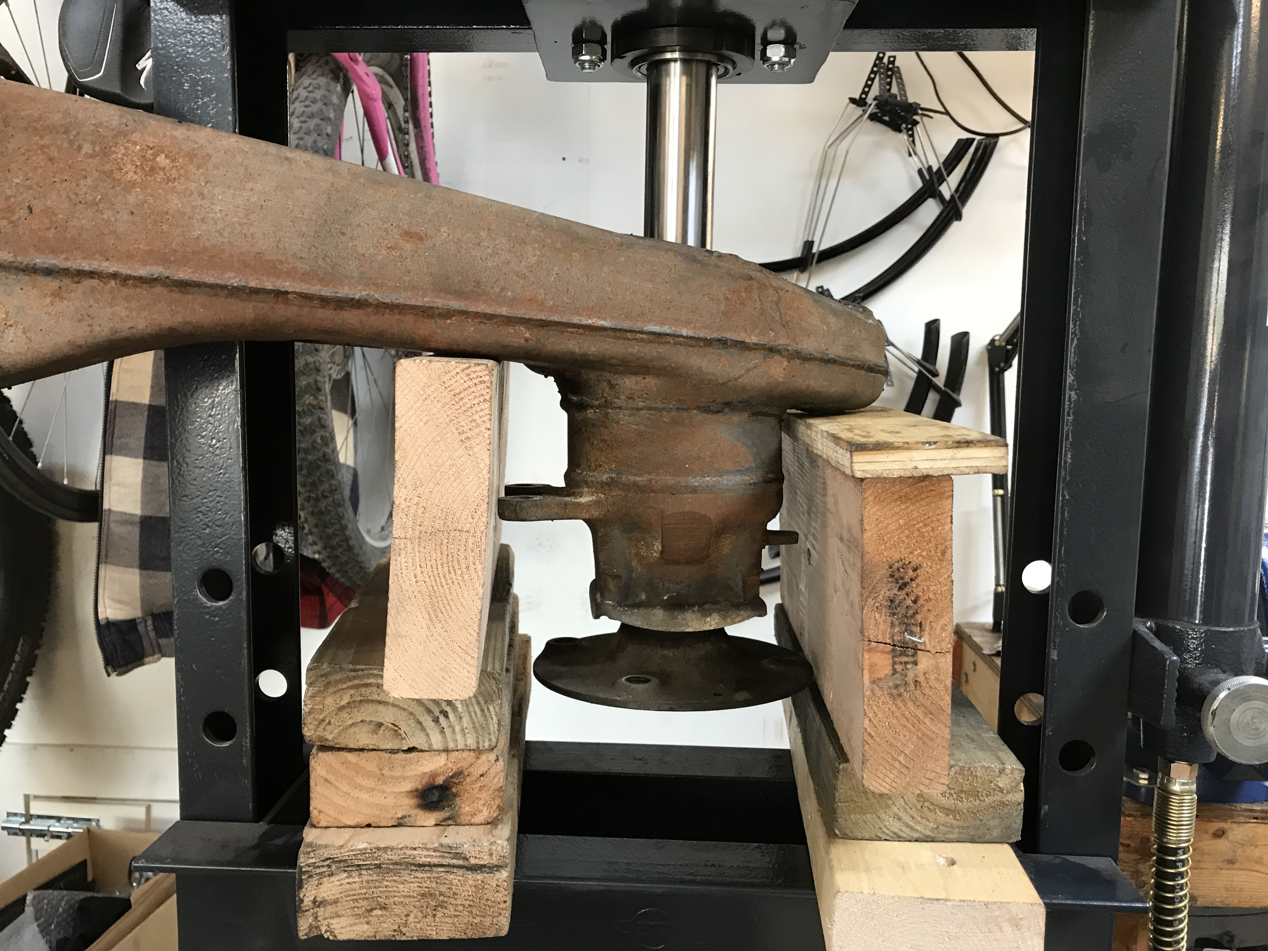

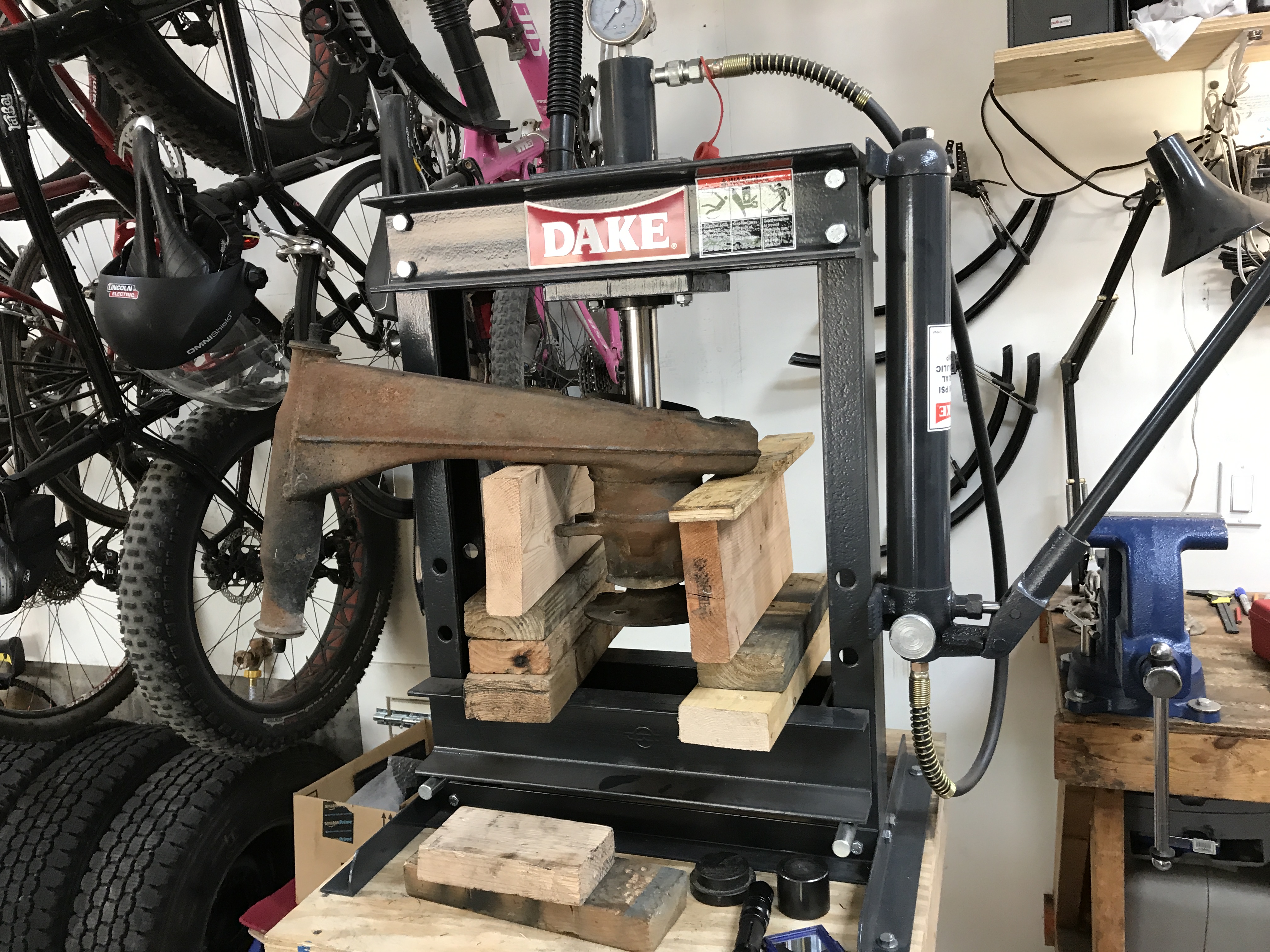

I then got on to pressing out the rear wheel bearings and hubs. I know this Jenga set up looks sketchy.
post Jul 24 2020, 09:10 PM
Post #986
Posts: 8,342
This was going to be just a mock-up, but when I put just a small amount of pressure on the hub, it moved.
post Jul 24 2020, 09:12 PM
Post #987

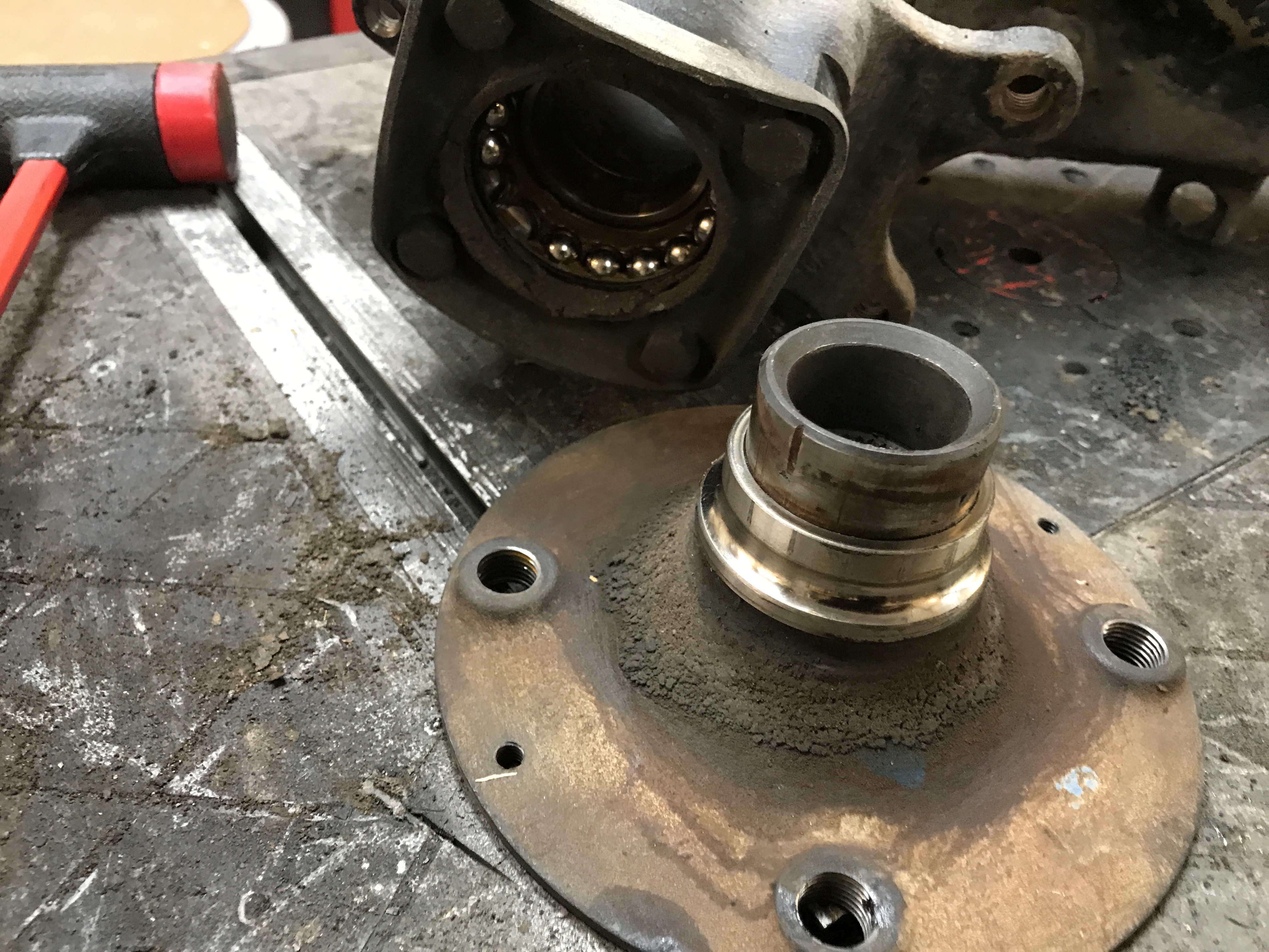

Posts: 8,342

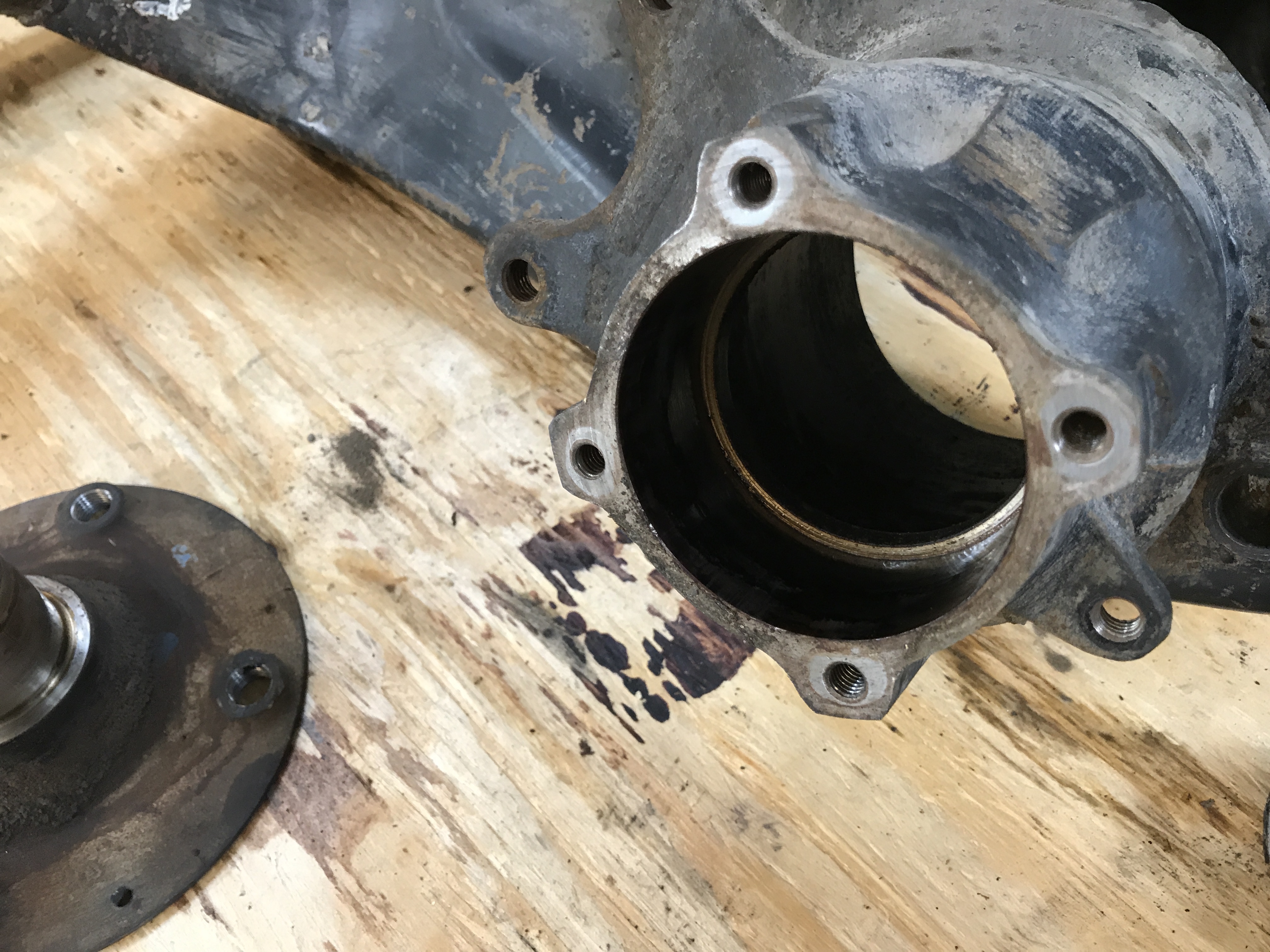

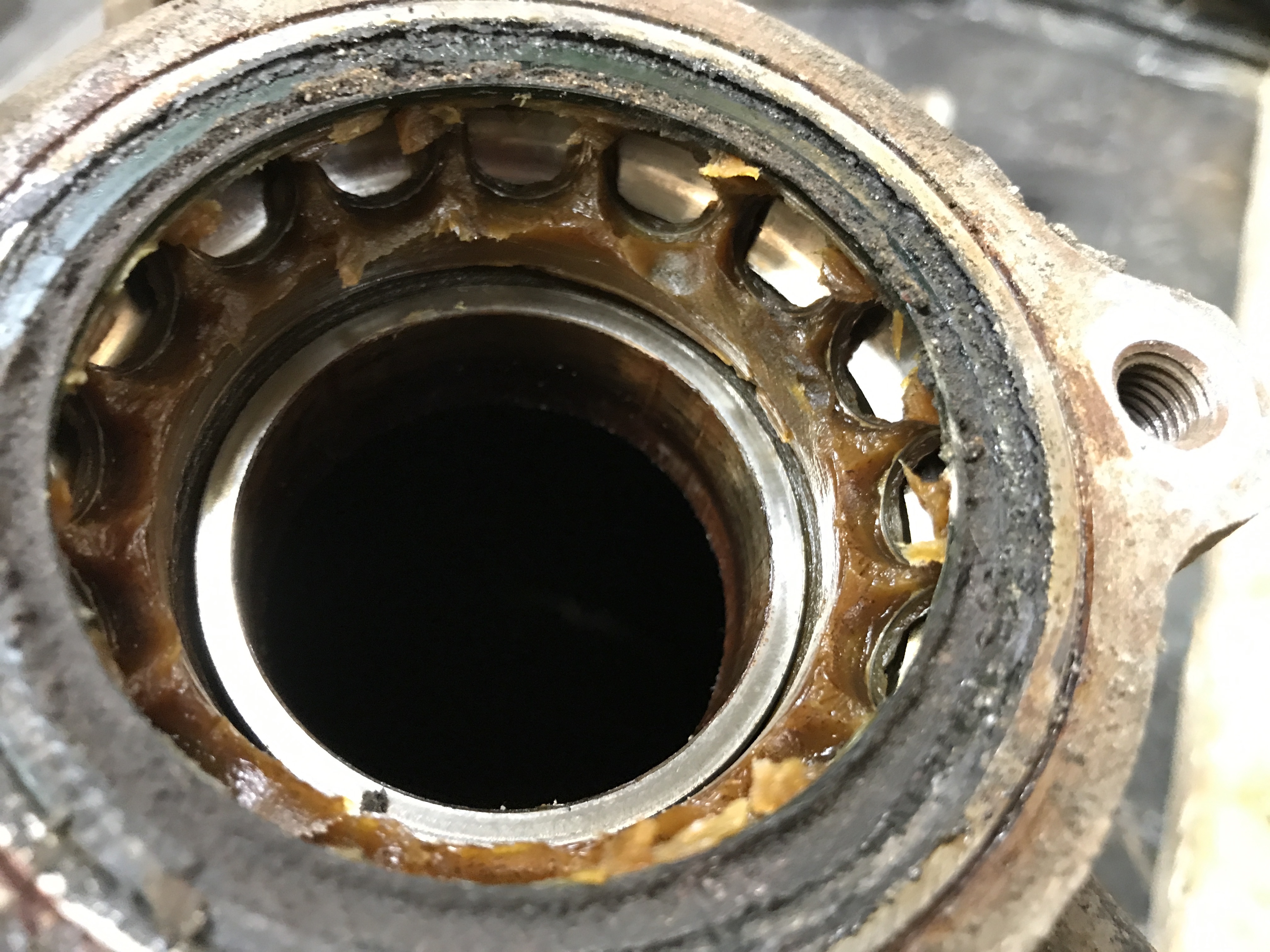

On one side, the bearing came out intact, but on this side one bearing race came out on the hub.
post Jul 24 2020, 09:14 PM
Post #988
Posts: 8,342
That led to one extra step on the press.
post Jul 24 2020, 09:15 PM
Post #989
Posts: 8,342
The bearing grease on that side was almost dry and hard.
post Jul 24 2020, 09:16 PM
Post #990
Posts: 8,342
Trailing arms without bearings!

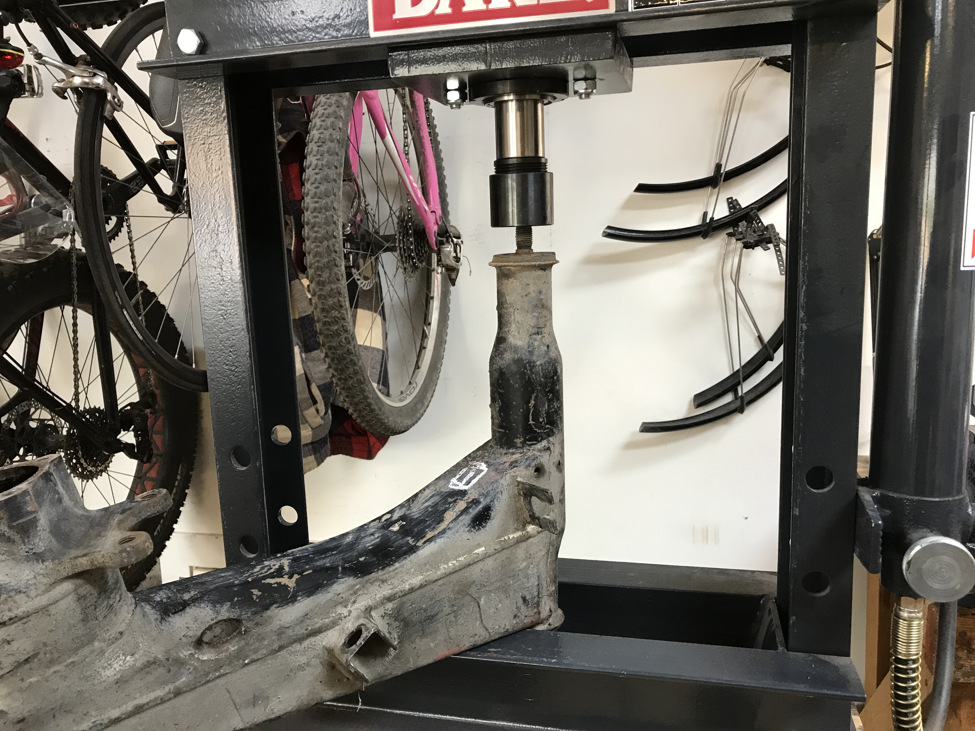

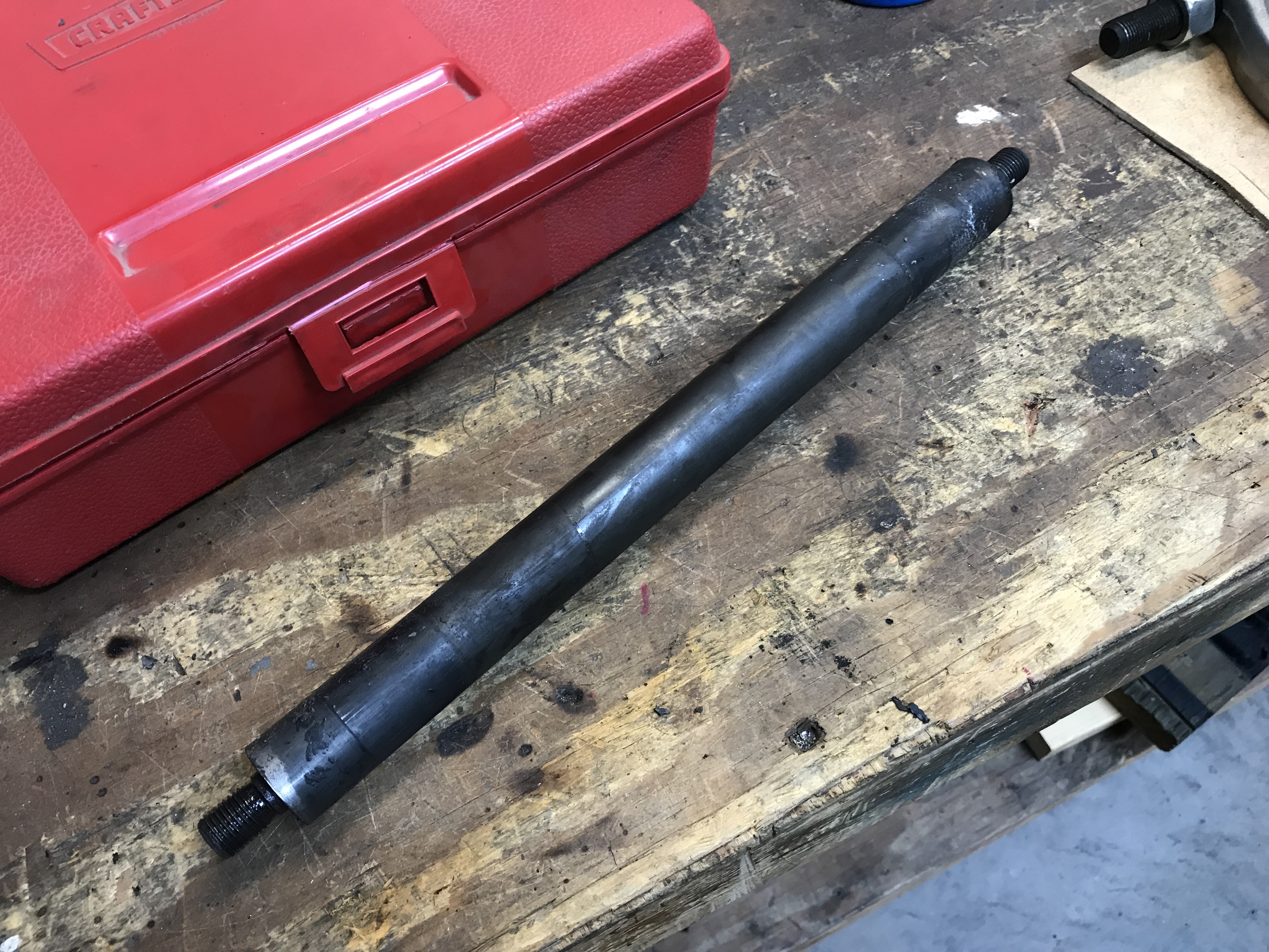

The last step was pressing out the axle. I pressed one end in far enough to clear the bushing.
post Jul 24 2020, 09:19 PM
Post #992
Posts: 8,342
I could then pry the bushing out.
post Jul 24 2020, 09:20 PM
Post #993
Posts: 8,342
I then pushed the other end of the axle in past the bushing, and pried out that side.
post Jul 24 2020, 09:21 PM
Post #994
Posts: 8,342
Trailing arm axles out!

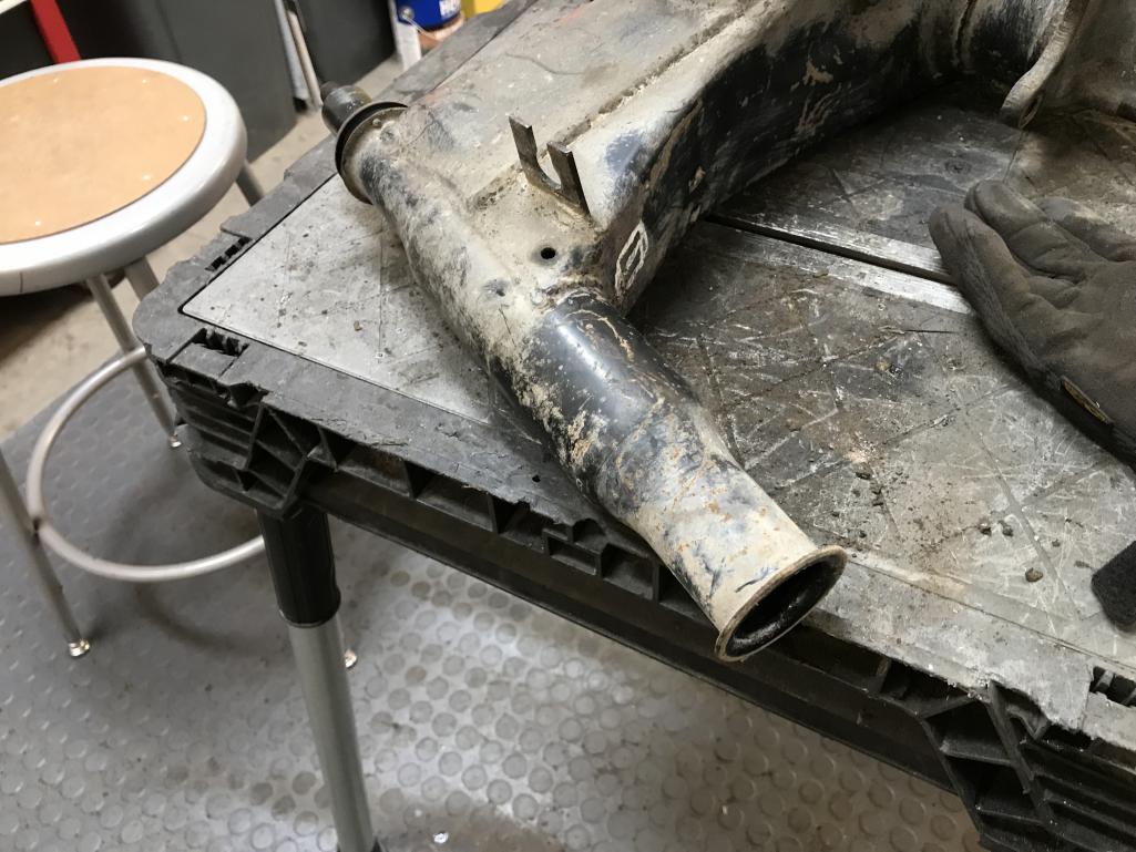

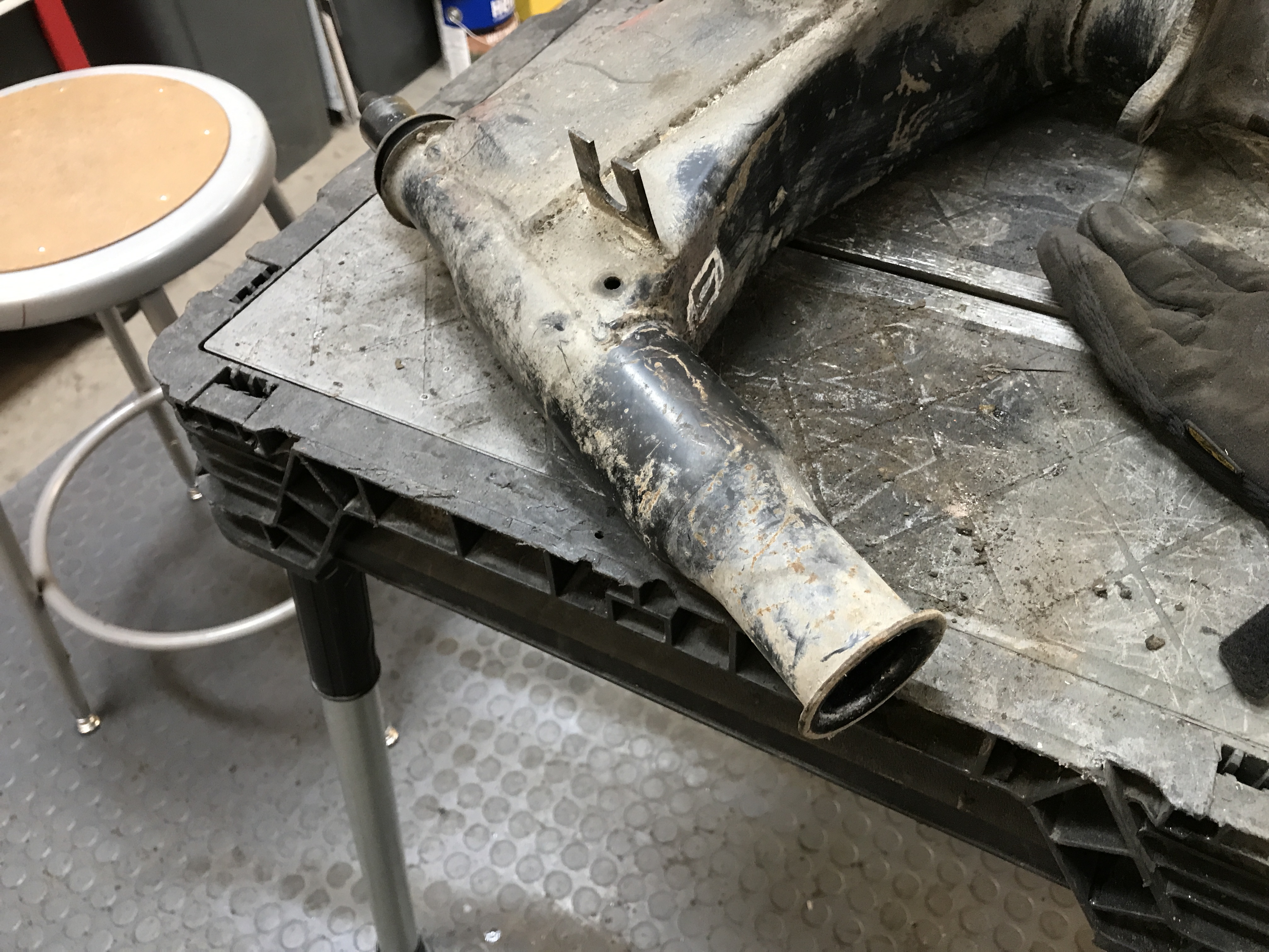

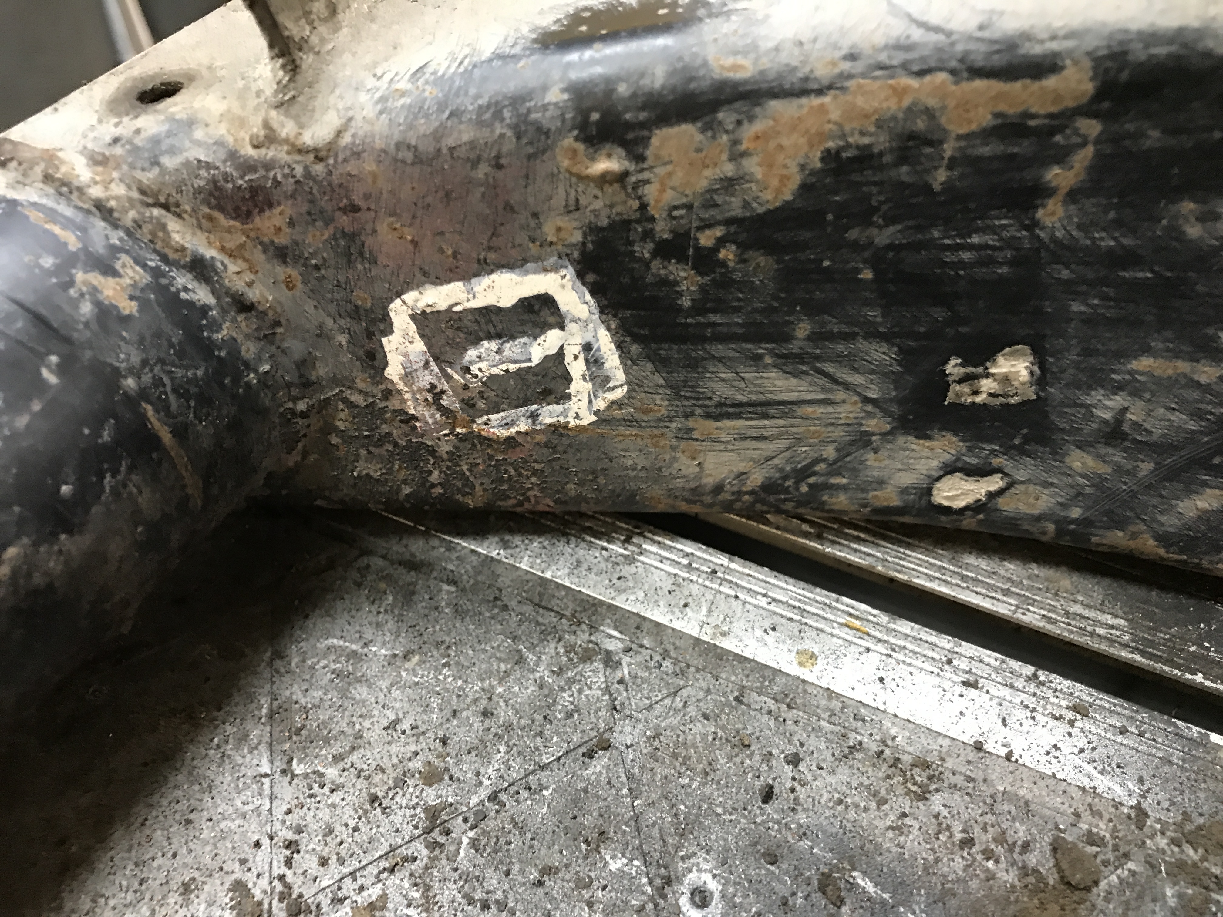

And I found the traditional hieroglyphics on the trailing arms.
post Jul 24 2020, 09:24 PM
Post #996
Posts: 8,342

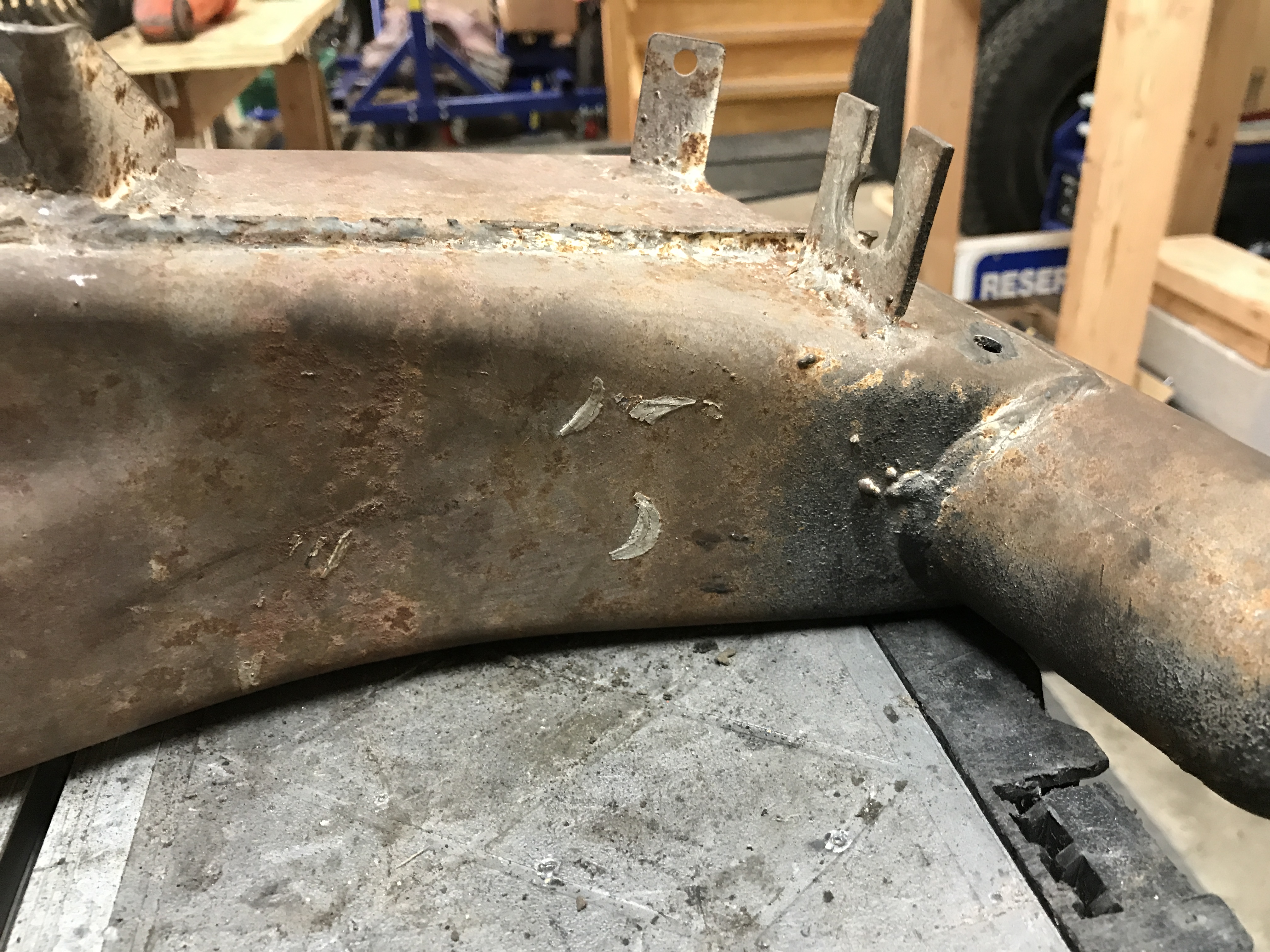

I am curious about the paint. One trailing arm has reasonably intact black paint, but this side is almost paint-free.

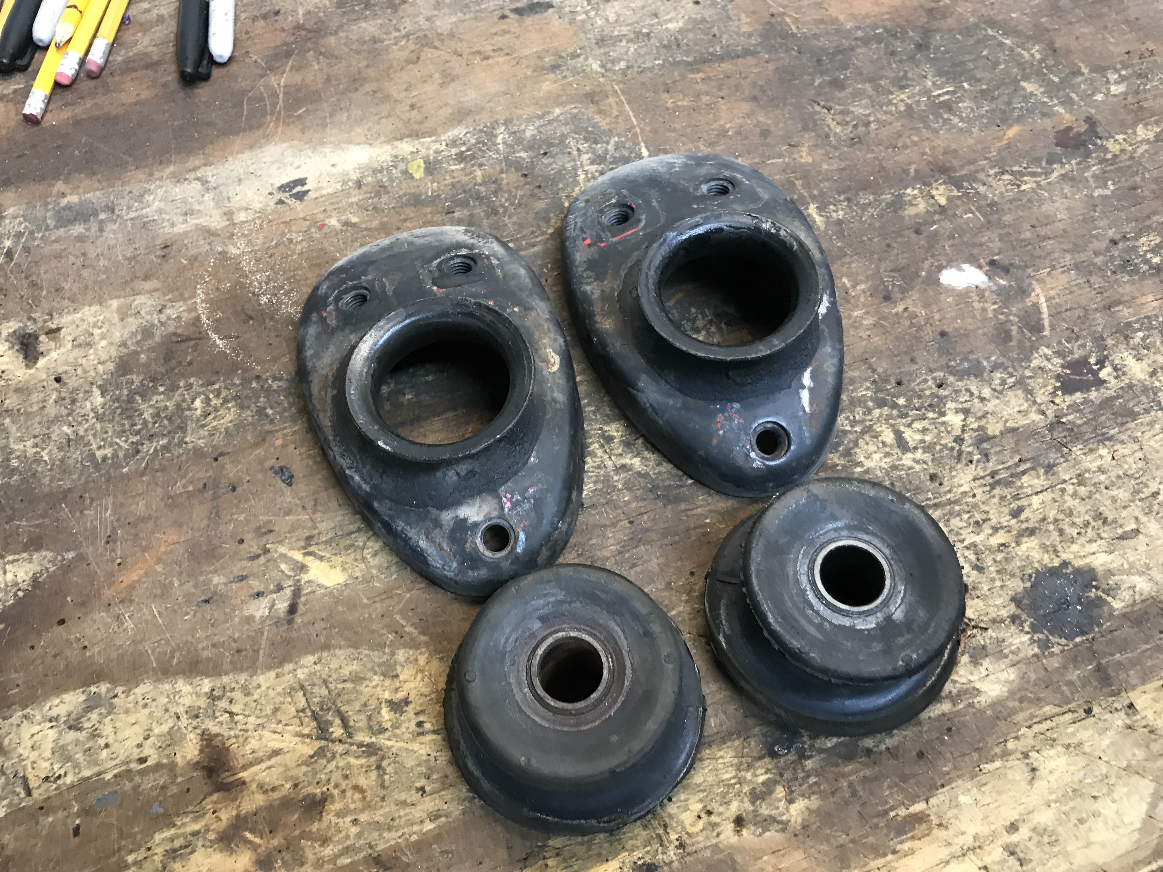

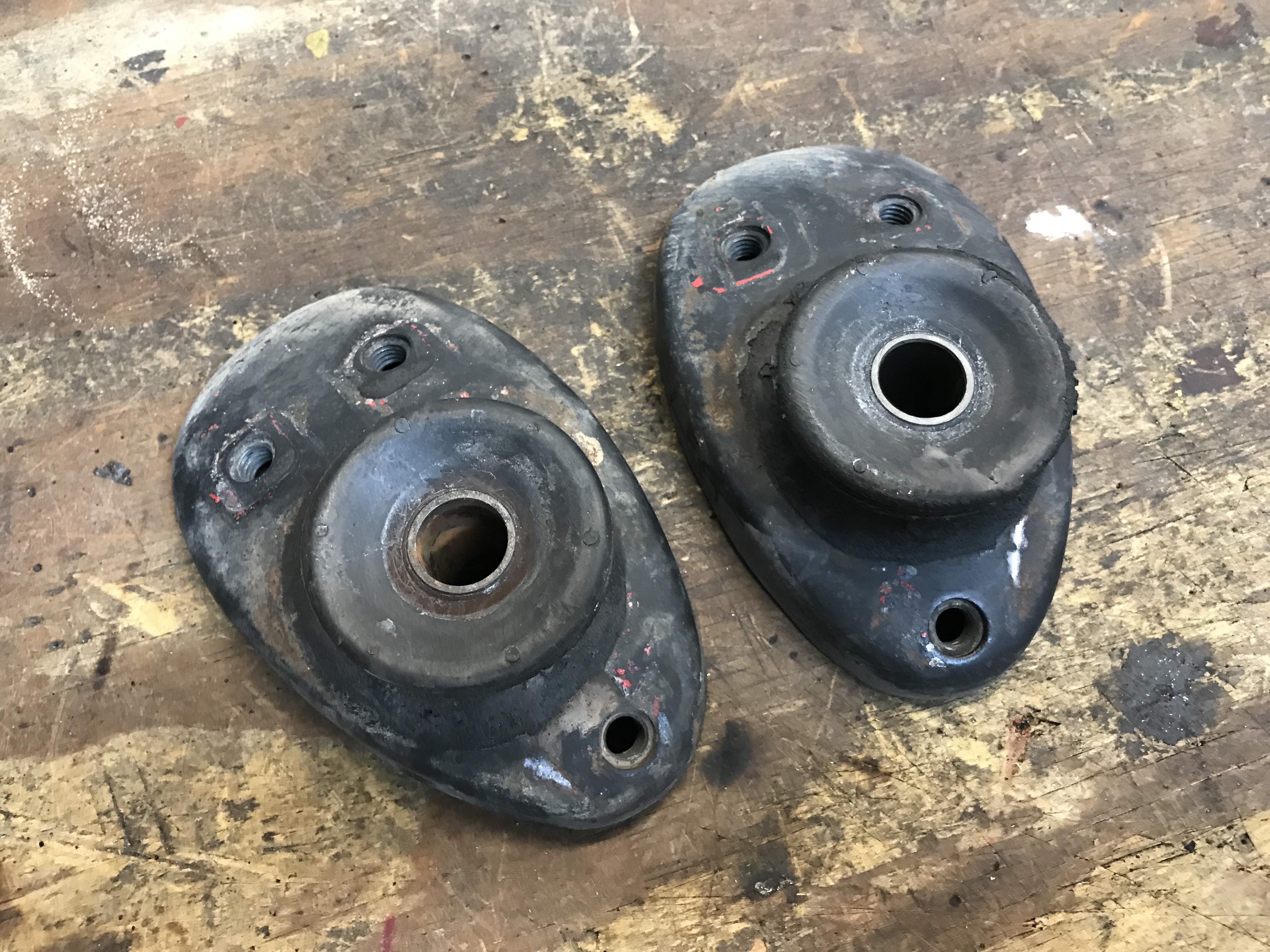

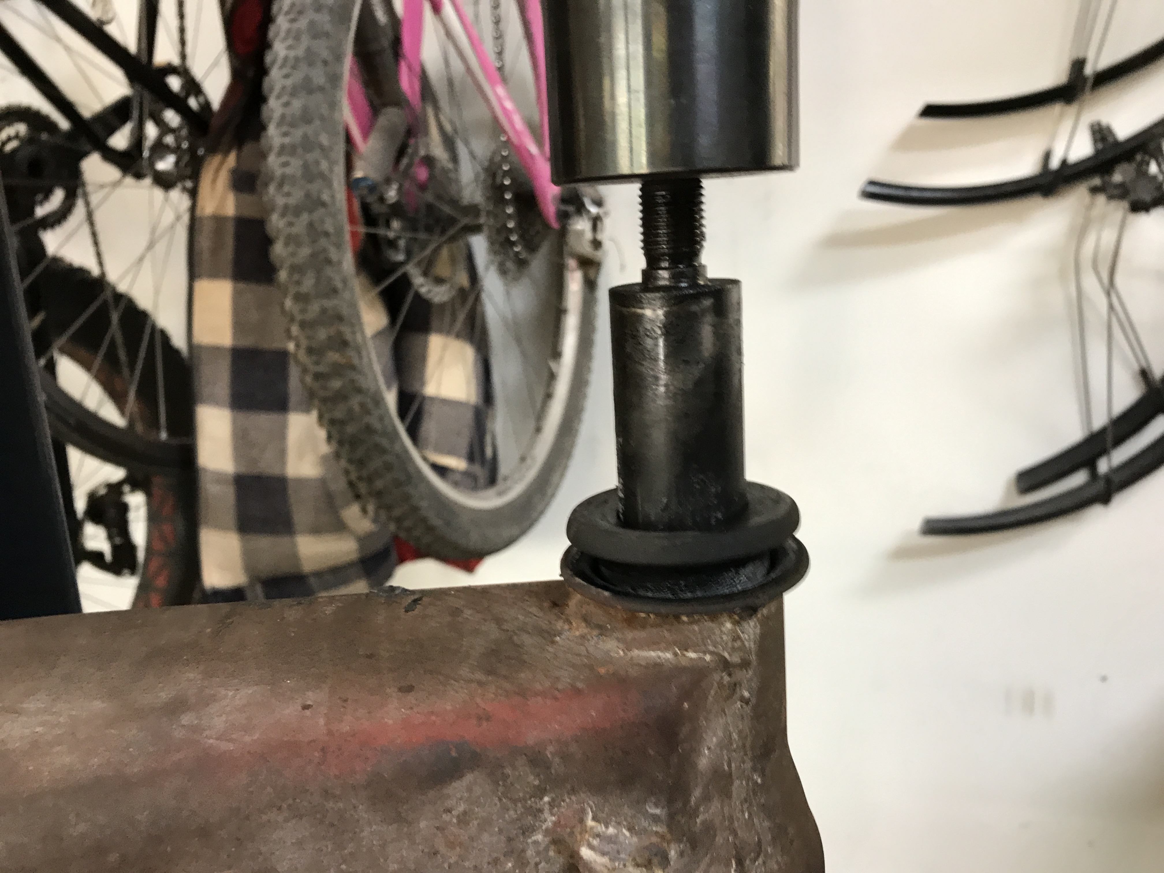

Posts: 8,342

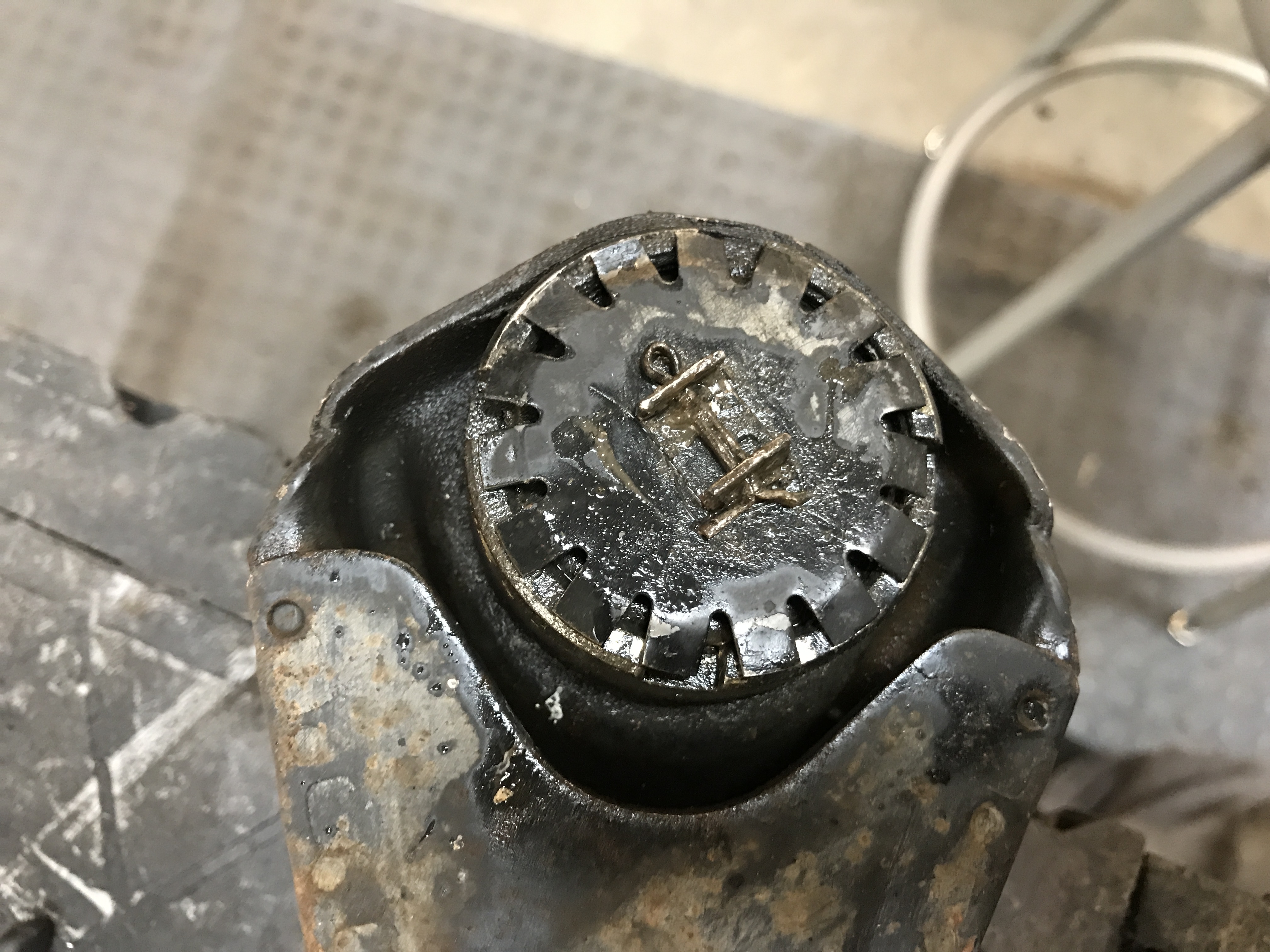

I forgot the last two rubber bushings, in the strut top mounts.
post Jul 25 2020, 08:25 PM
Post #1000
Posts: 8,342
That took about 60 seconds with the press.
