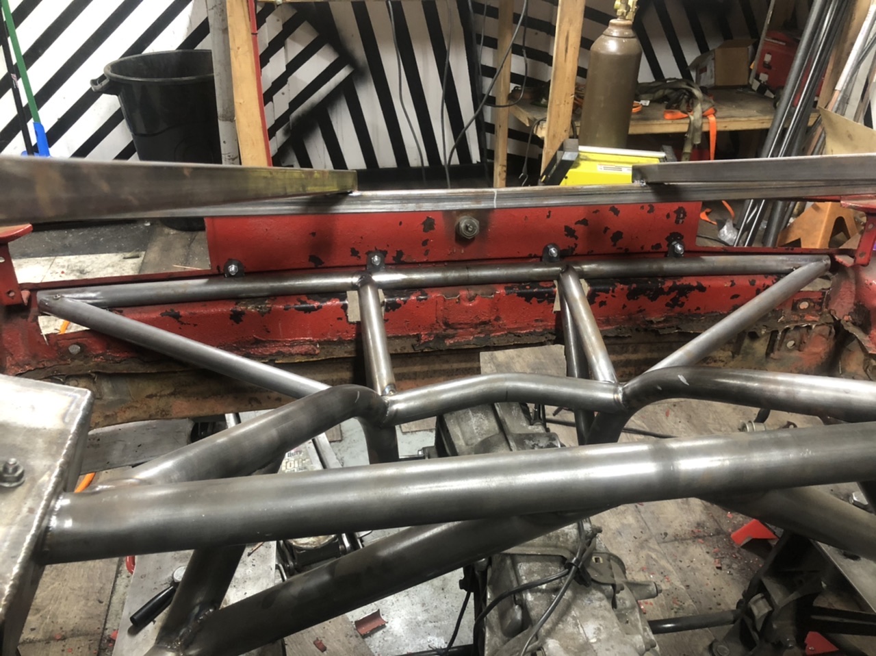

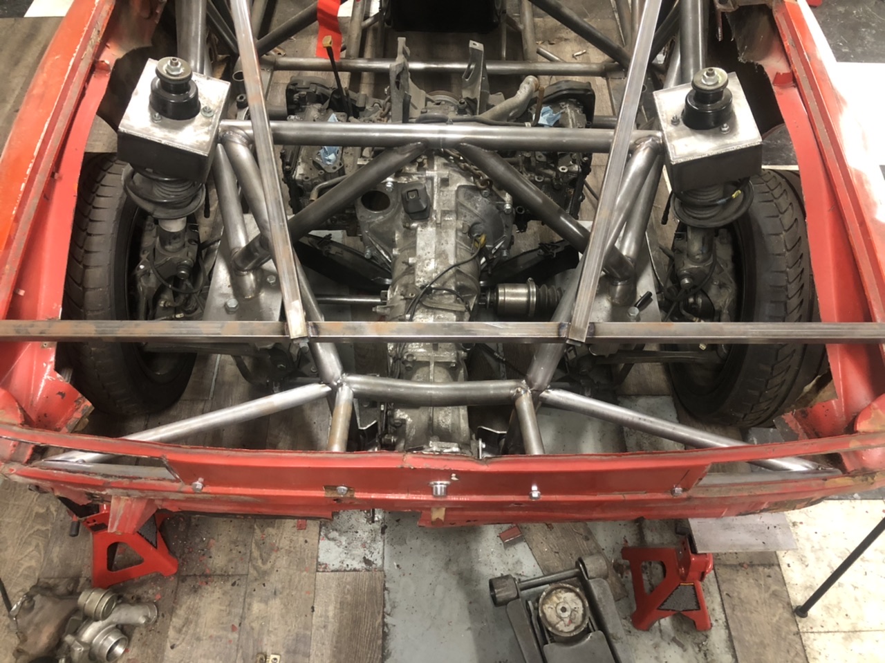

Got the rear bumper tacked up, it’s looking pretty mean and ready for double duty as a diffuser mount (IMG:style_emoticons/default/cheer.gif)
Things took longer than expected because i had to go through a few design iterations before settling on this, and i really like it!

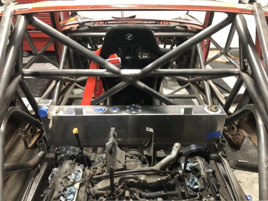

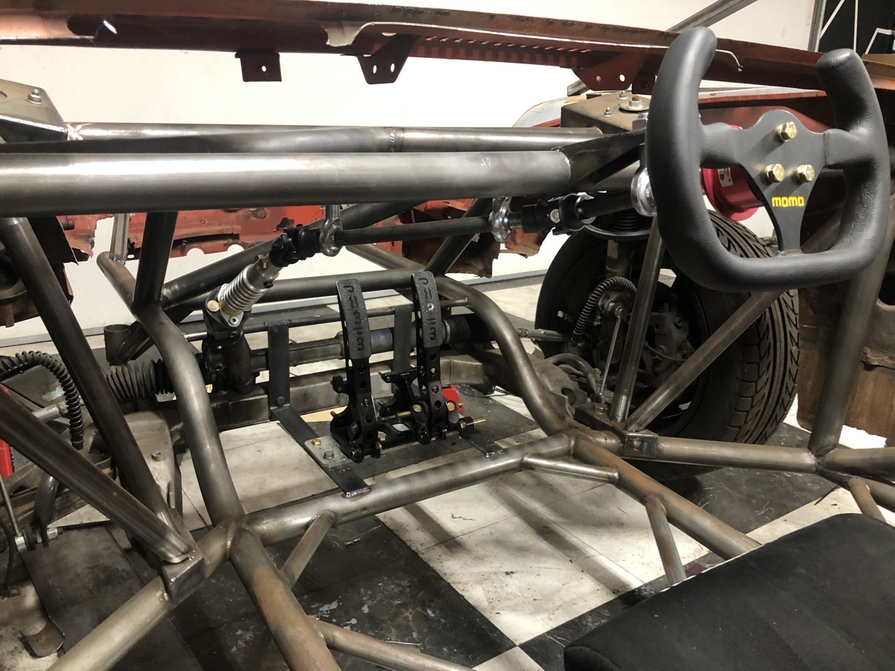

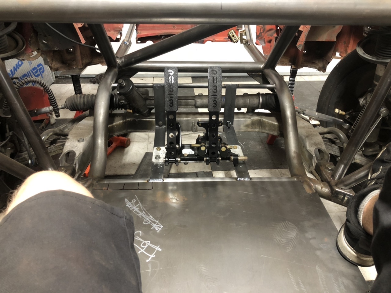

Got the pedals in! i decided that im going to mount all the things that make me smile this weekend: pedals, wheel, gas tank and maybe shifter. so we’ll see how things progress!Attached Image

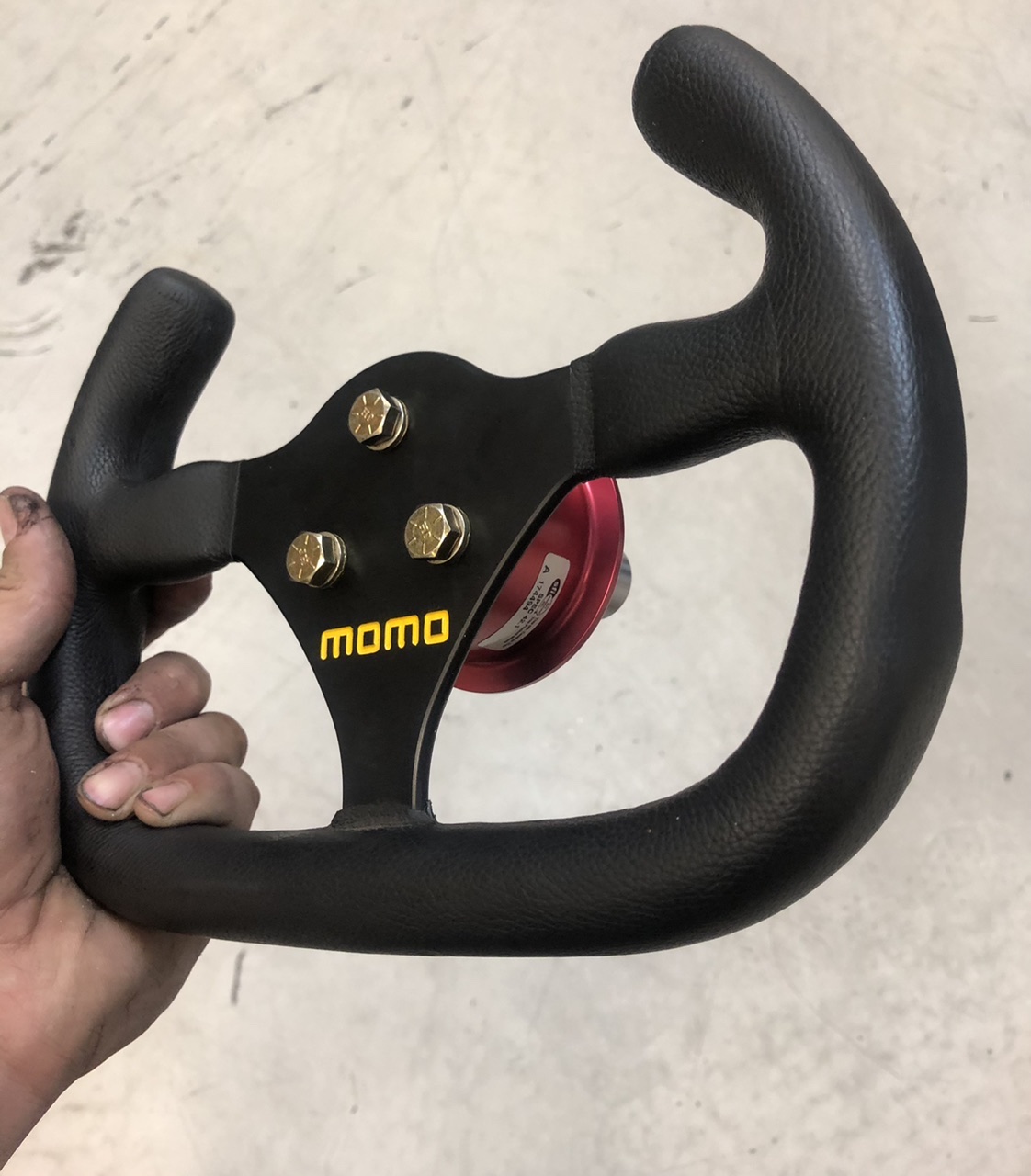

Brought my steering wheel into work today and used the bridgeport to put the bolt pattern of the quick release hub into the wheel. It felt very high stakes but it all worked out in the end, plus i learned more about triangles (IMG:style_emoticons/default/piratenanner.gif)

Boy that is a Tiny wheel!
Love the progress buddy!
tazz9924
post Aug 22 2021, 09:44 AM
Post #187
Posts: 720
Joined: 31-May 15
From: Mooresville NC
Member No.: 18,779
QUOTE(Andyrew @ Aug 22 2021, 07:36 AM) *
Yes it is! just a little smaller than my daily drivers wheel so i should be ok

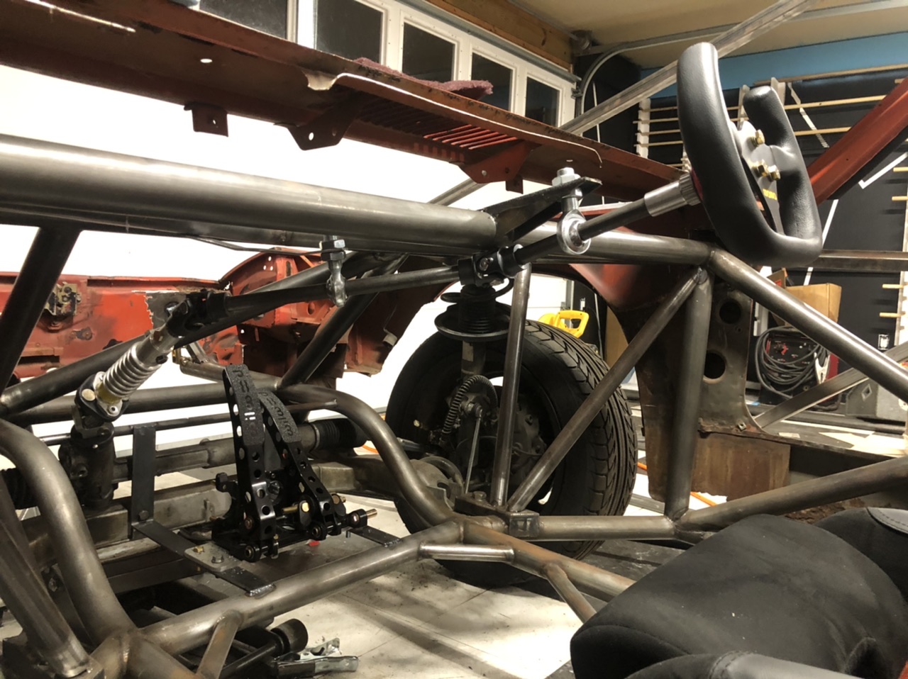

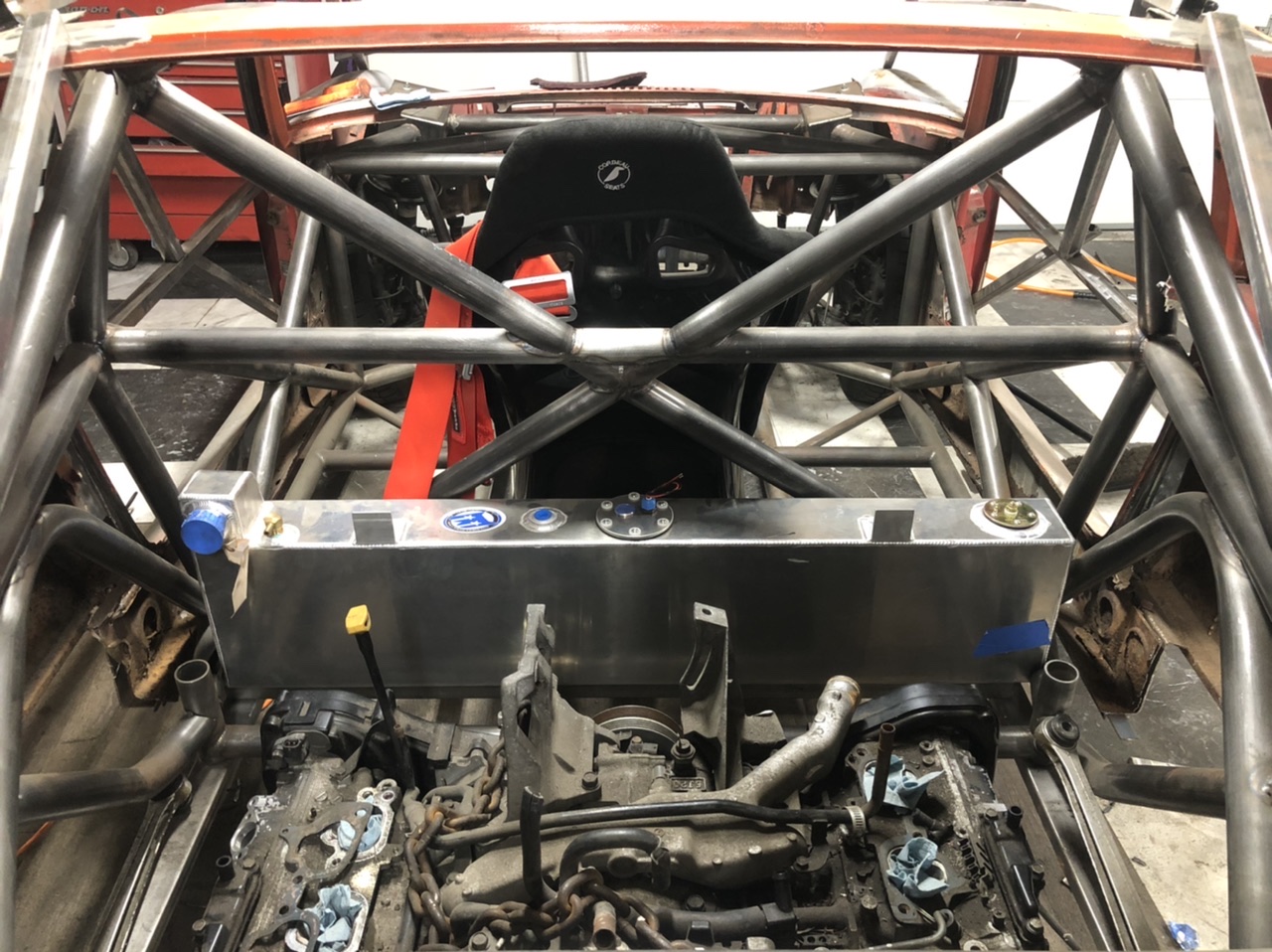

Did some major steering system work! I made it to the point where it is free from binding and all that good stuff, but i need one more steering shaft bearing to prevent it from telescoping but it looks good and thats half the battle
I also took the time to knotch the tubes to allow the gas tank to sit nicely in it’s little hovel. That was driving my ocd up a wall looking at it crooked.

Better refined the steering system today and got it tacked together enough to actually turn the wheels!! Man will this thing be cool. I still need to reinforce the steering heim joints to fully eliminate play but as a proof of concept i am extremely happy. Attached Image

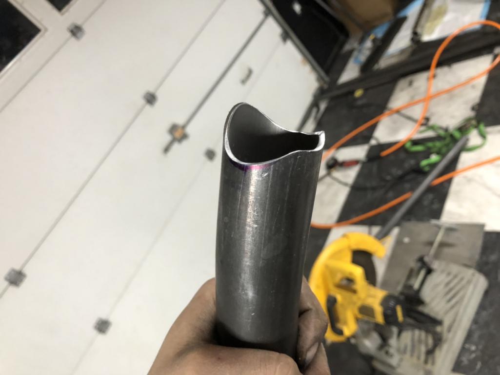

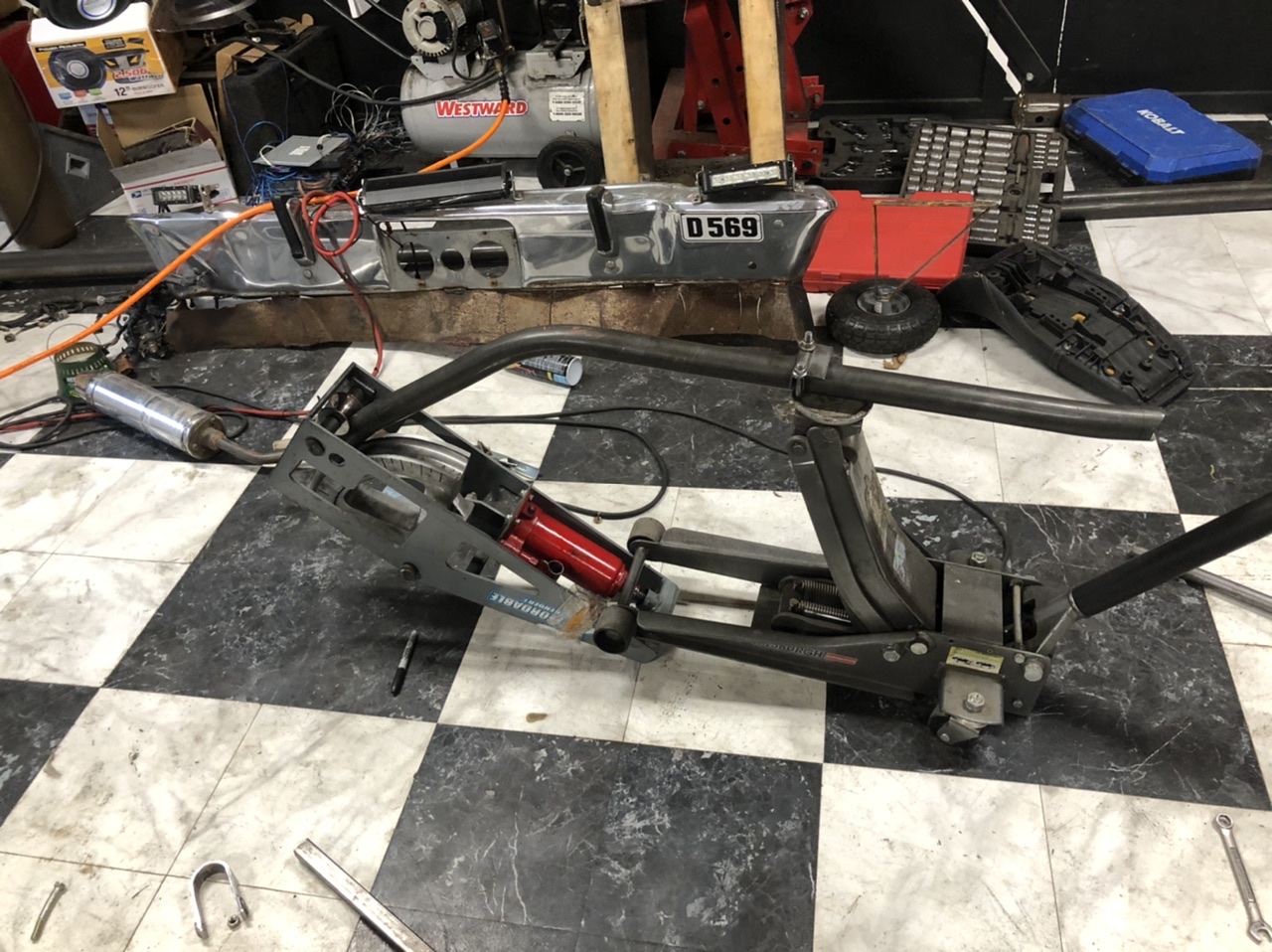

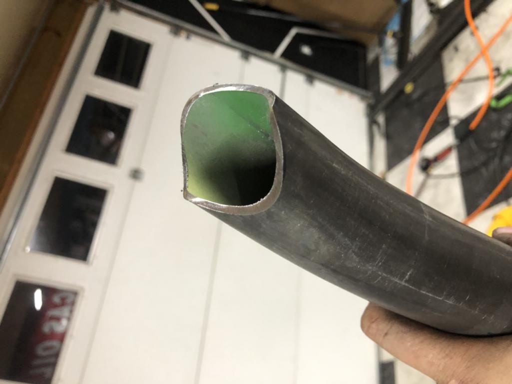

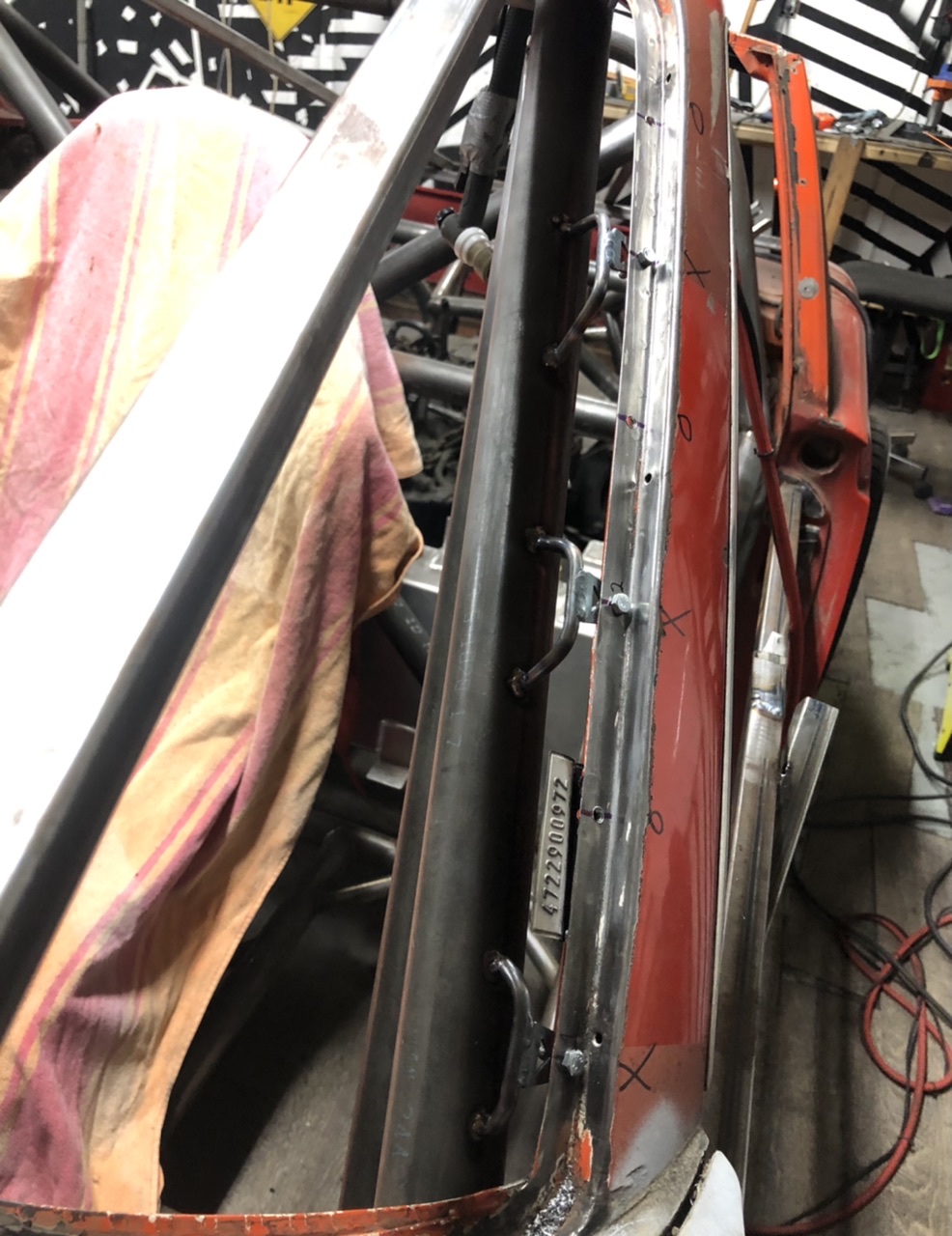

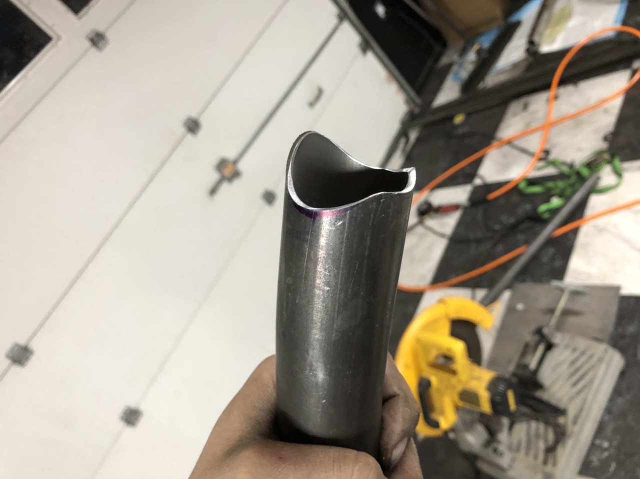

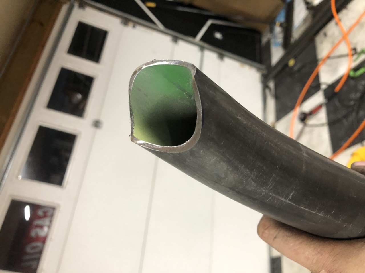

Over the last two days i built the A pillar bars. Each bar has 3 bends and 5 notches. 4 notches were completely hand made but by the time its done it felt like all 5 were hand done. im quite happy with how they turned out, as always i was very worried about the feasibility of it to only make it happen nicely! Next comes the roof bars!!!Attached Image
I also made a home made tubing un-bender.... Its ghetto but it worked

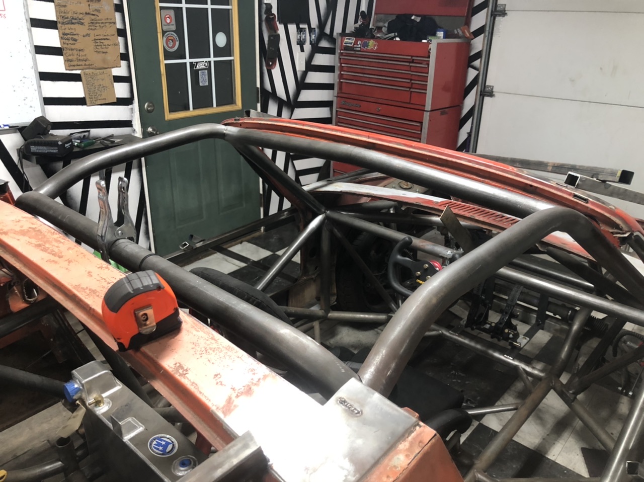

Made a very good fitting eyebrow bar, it sits a little under an 1/8” from the windshield frame with a 6* bend in the center. I also worked on some other tubes so hopefully its a big update tomorrow!

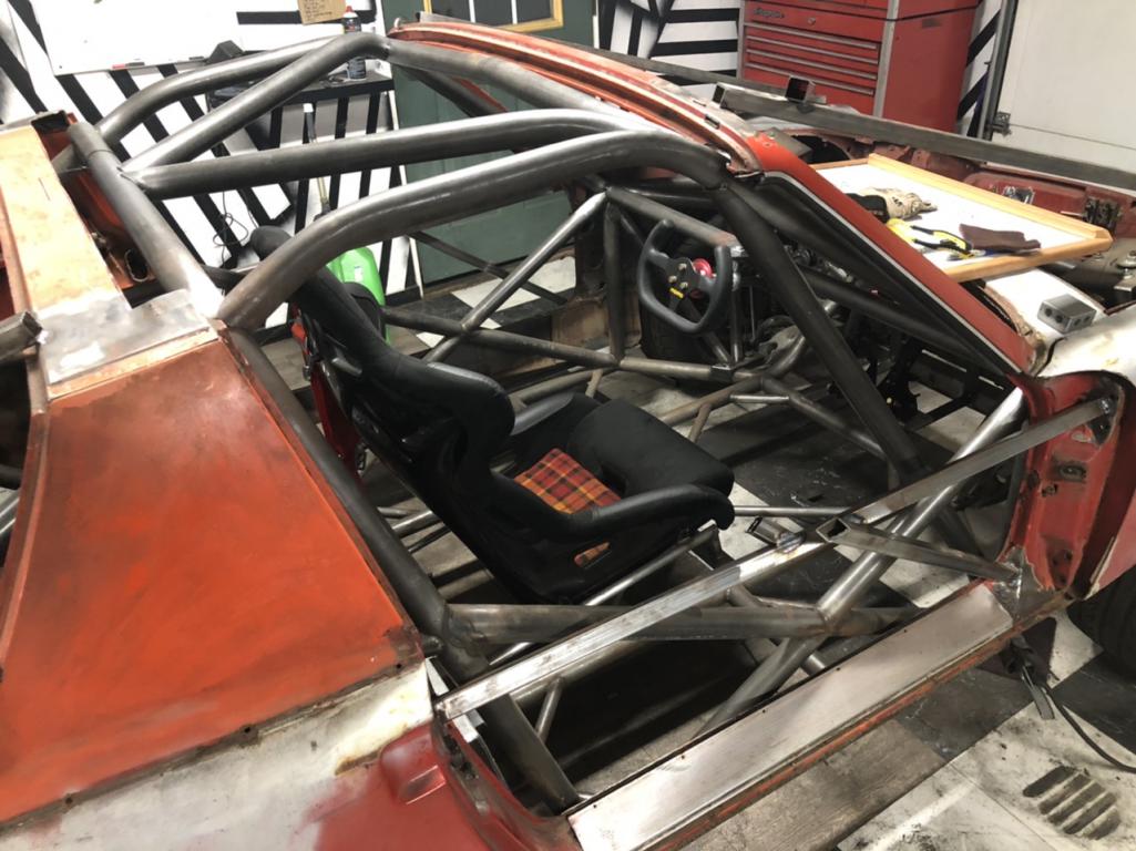

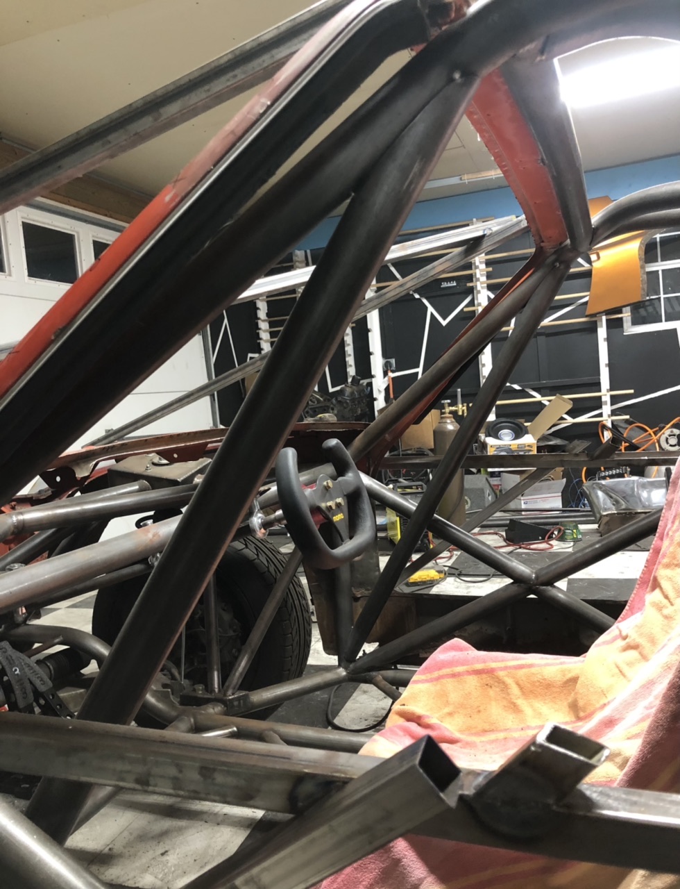

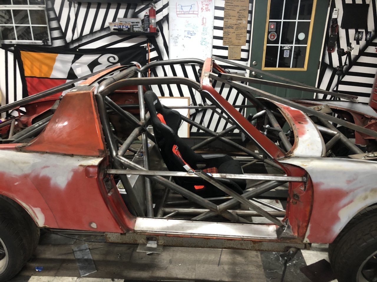

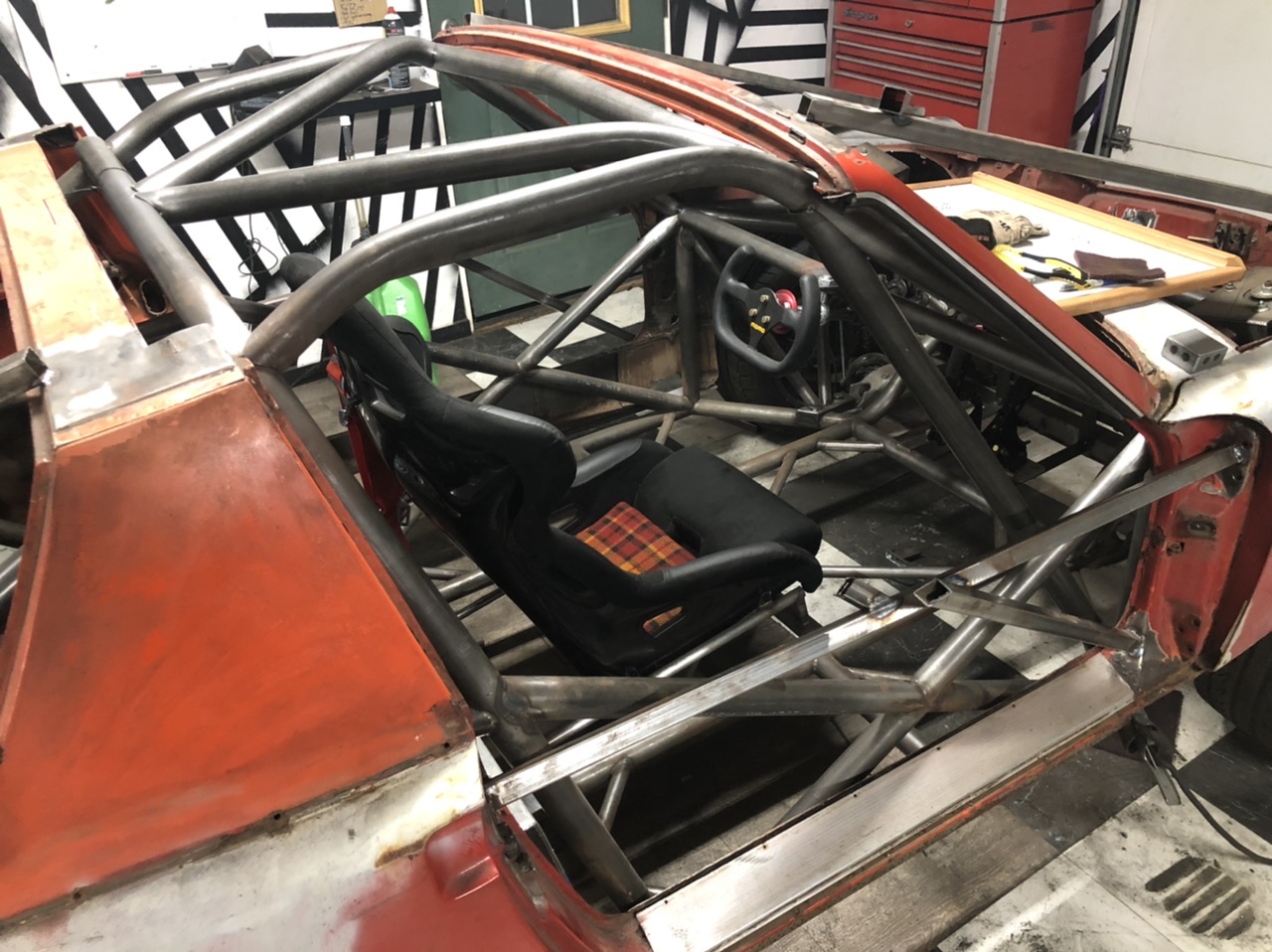

Didn’t get everything i wanted done today but i did get quite a bit! I made the roof V to protect my squishy bits from above, while still allowing me easy and quick exit from the vehicle. I also completed one of the FIA bars that extend from the footwell to the upper bend on the A pillar bar. I had my doubts about it because of driver egress concerns but its really not an issue. Once i get that done its gusset time and a little special piece? maybe we’ll see!

Finished the other fia bar and started mounting of the windshield!

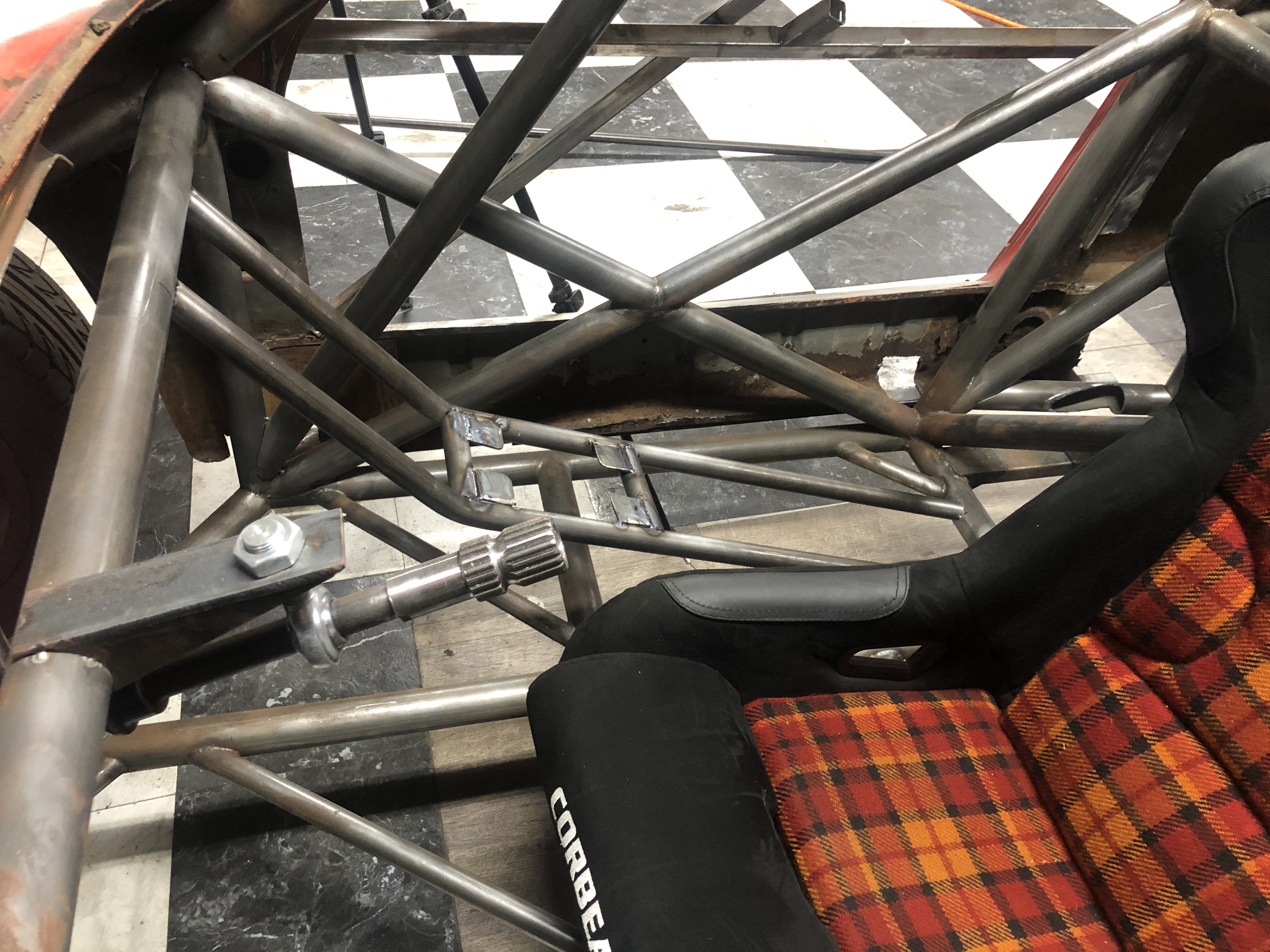

tazz9924
post Sep 19 2021, 10:30 PM
Post #200
Posts: 720
Joined: 31-May 15
Member No.: 18,779

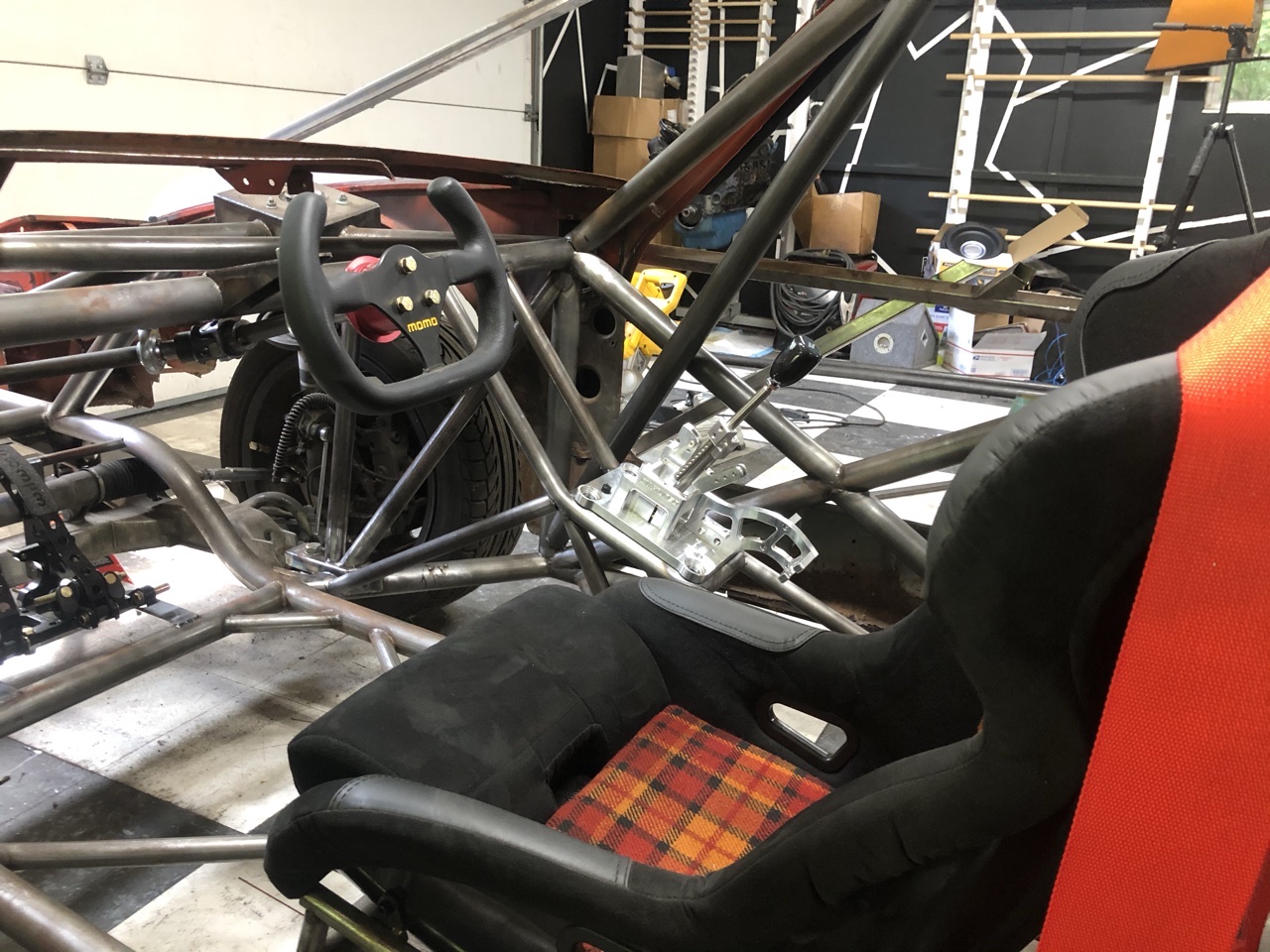

did a lil bit of reinforcement for the off center console and bolted in my K-tuned shifter. I finally have all the haptic stuff installed and i have no complaints!
