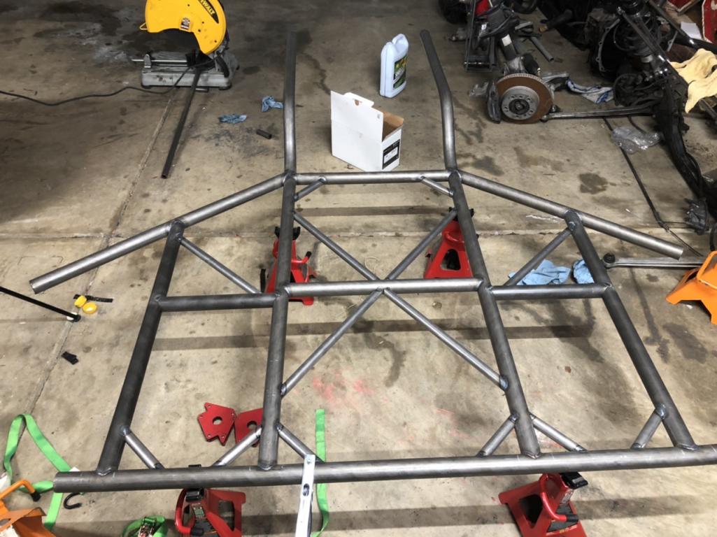

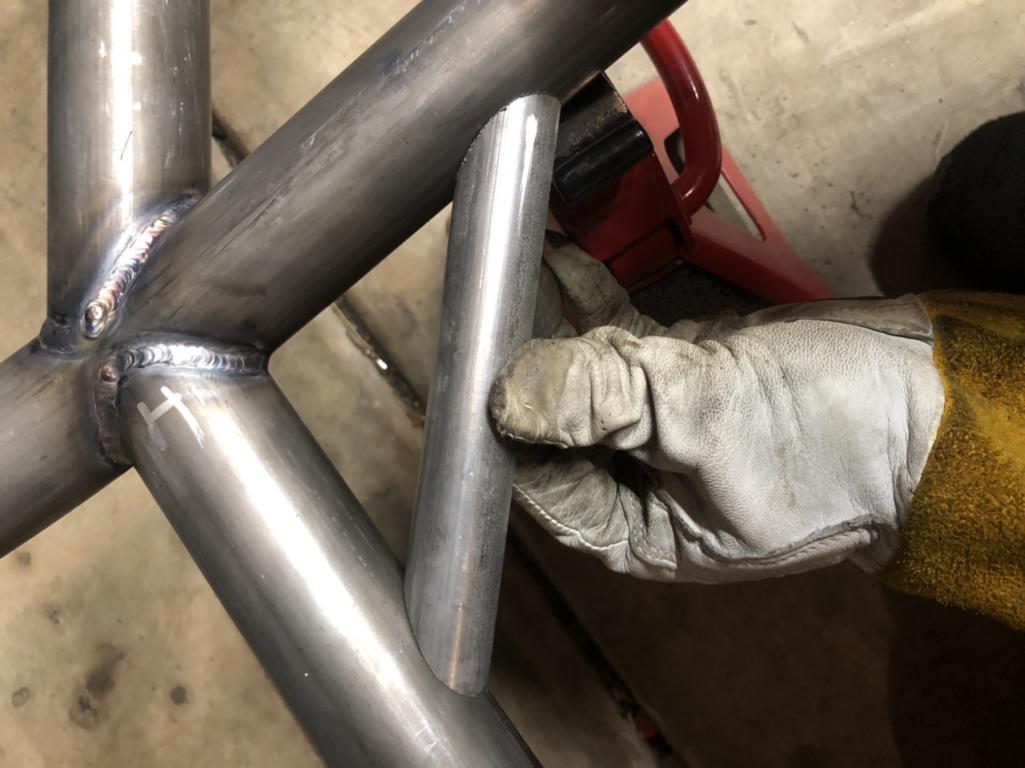

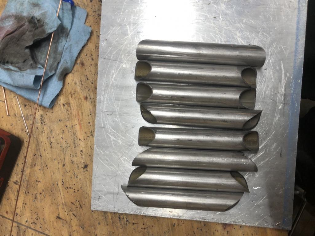

Built a lot of gussets, i really badly wanted them to sit flush with the bottom of the floor but after an hour and a half of trial and error, i found it cannot be done on 90 degree joints with my tube notcher as is. I wanted the gussets to double as mounts to the floor pan but ill have to fab up separate mounts for that (IMG:style_emoticons/default/confused24.gif) They gussets fit pretty good and i made all 8 in 30 minutes after that whole debacle. Now to weld in!

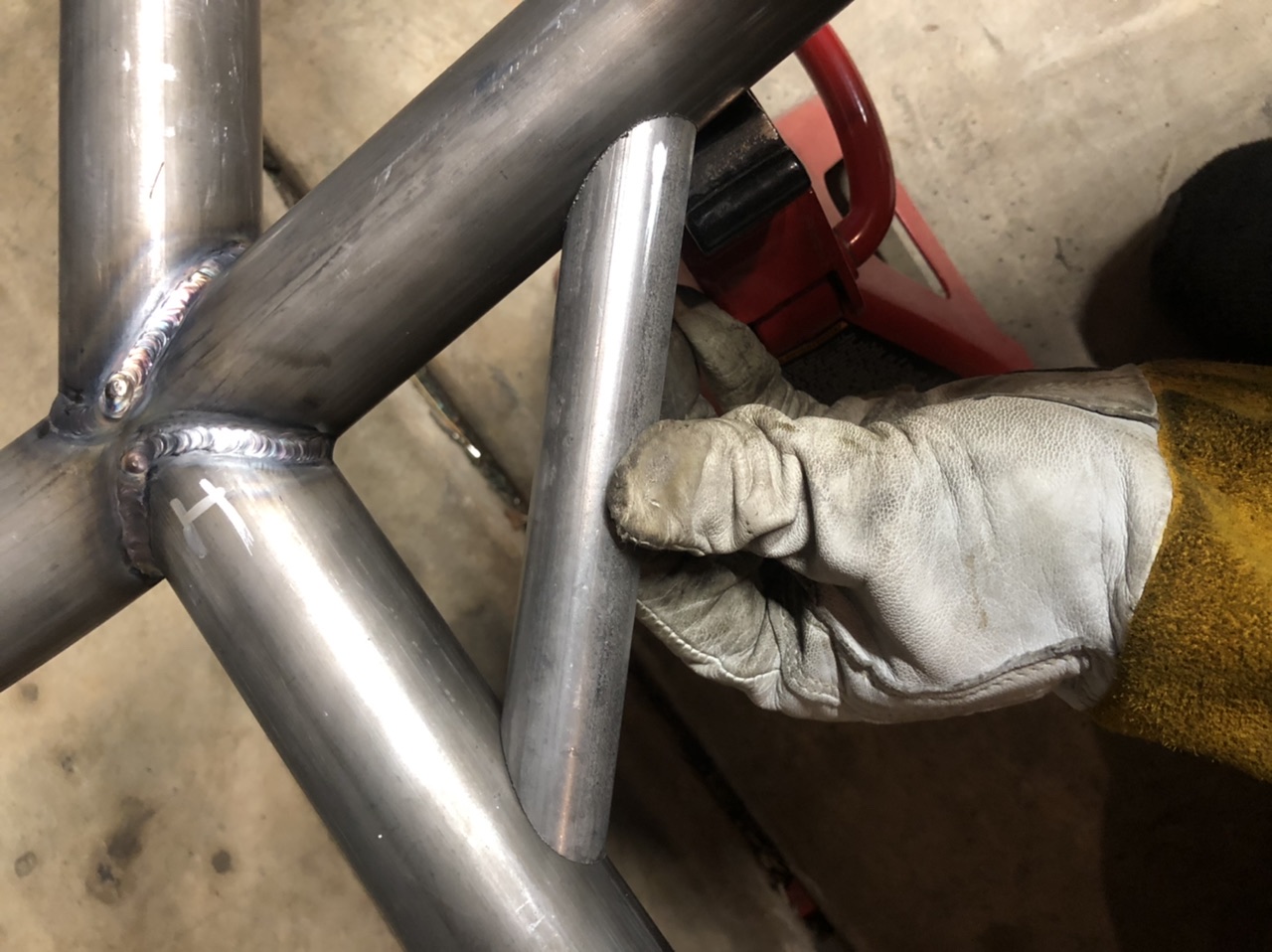

Not a big day but got some of the gussets added in. I also added the middle bar back into the floor now that i know where center is.

Lover your welding! (IMG:style_emoticons/default/wub.gif)

Ahh but it is the word of the day with the new additions to the floor!Attached Image

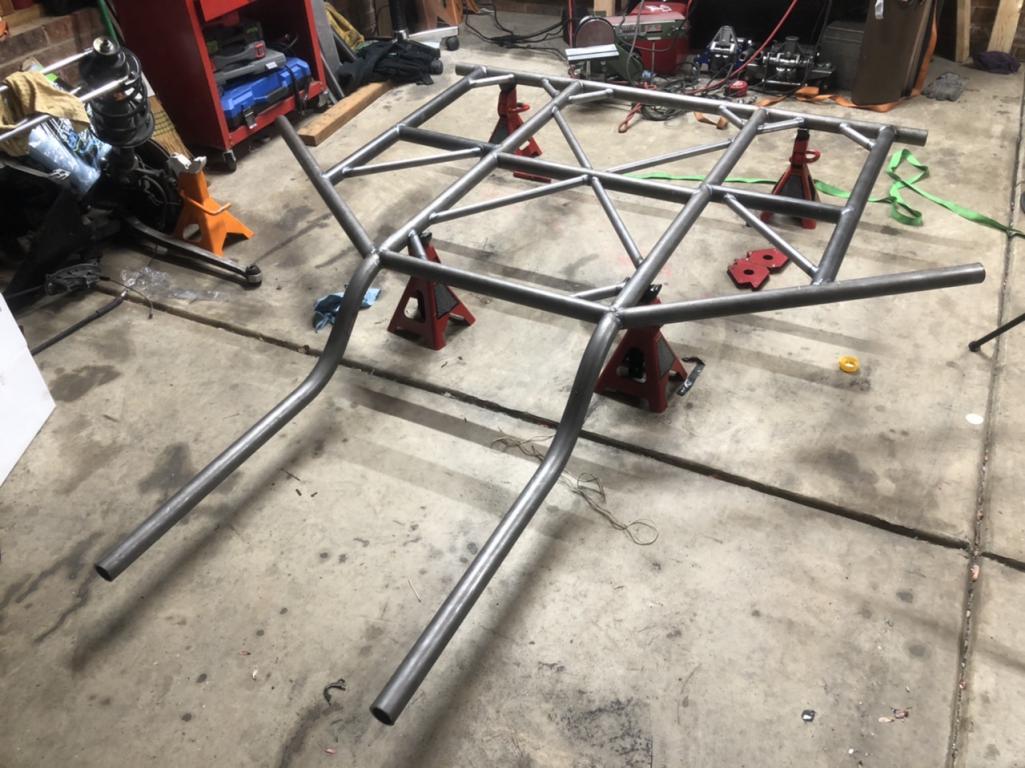

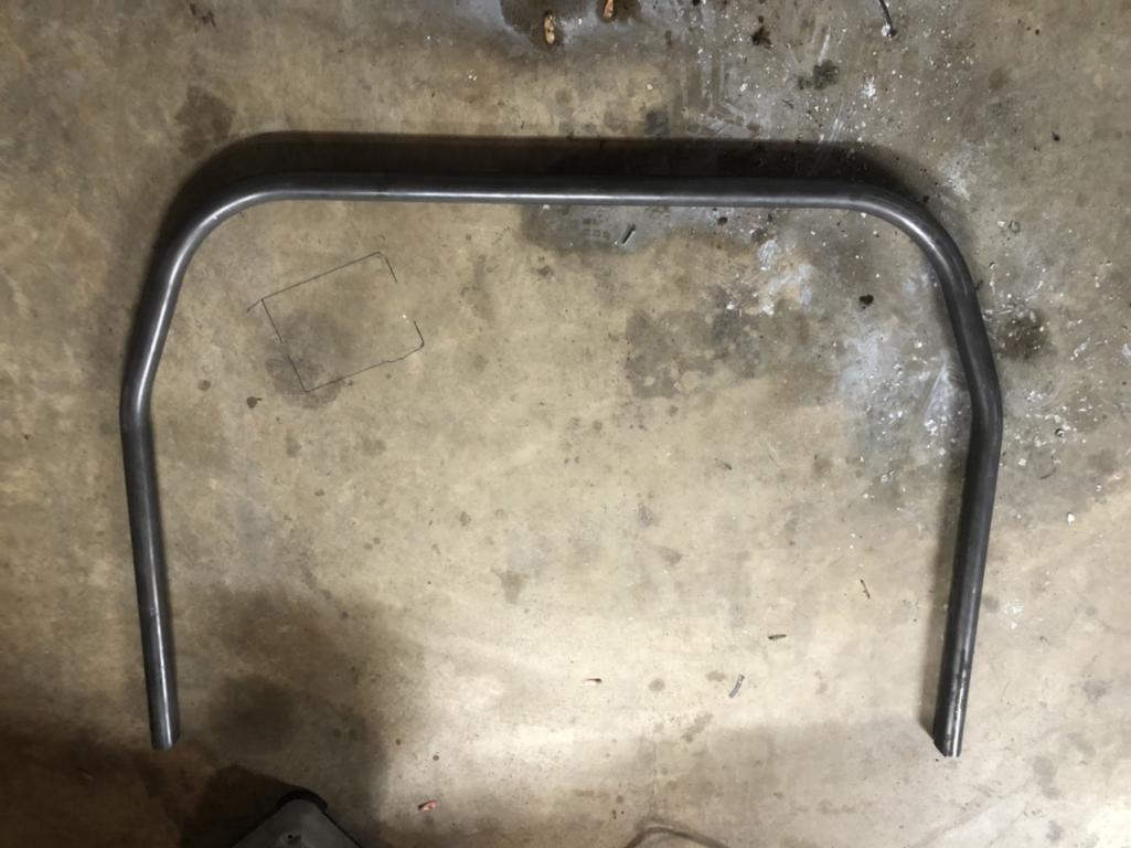

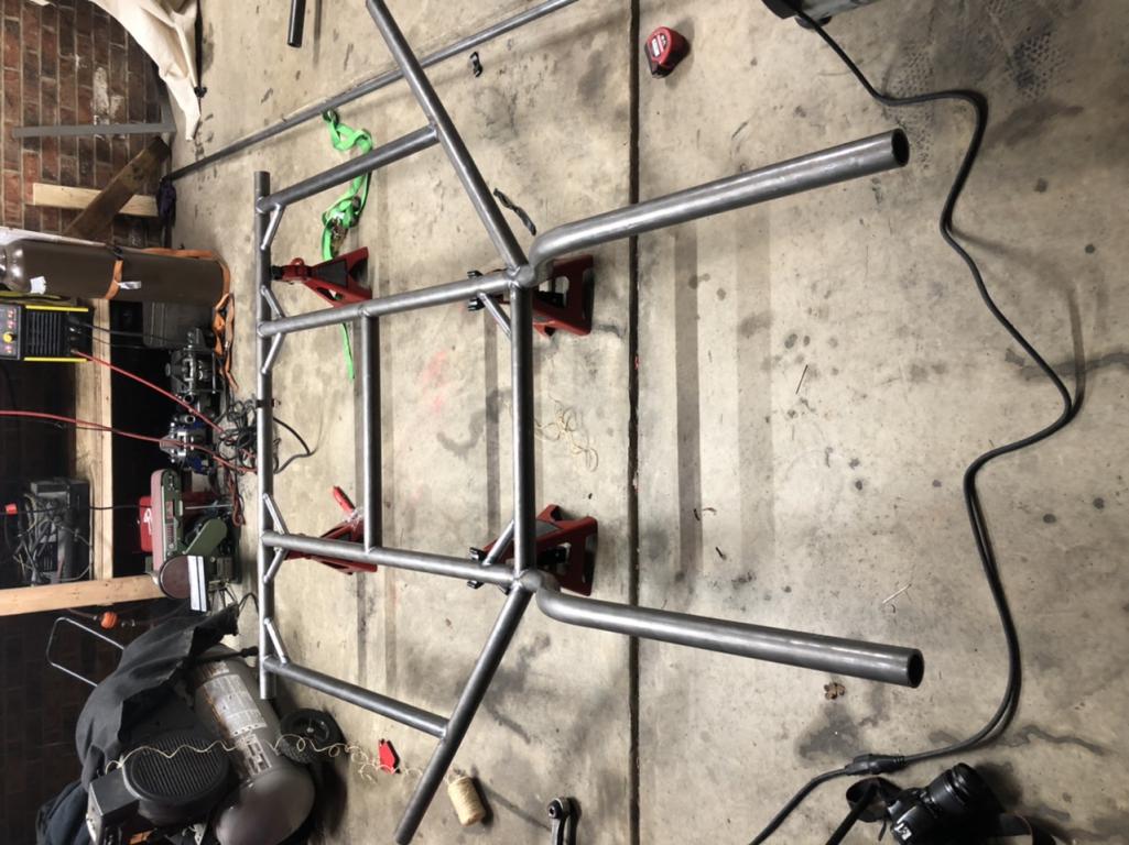

Got the last of the welding that is possible on my current tig cup, i was gonna get the right cup today but it was damn good friday. The last of the tight welds will wait till monday. I also finally got the main hoop bent and notched. It still needs a little work to get it right because its a little wide. i may tighten a couple bends a degree or so to bring it next to perfect. Nothing serious. But it’ll wait till tomorrow like the dash bar

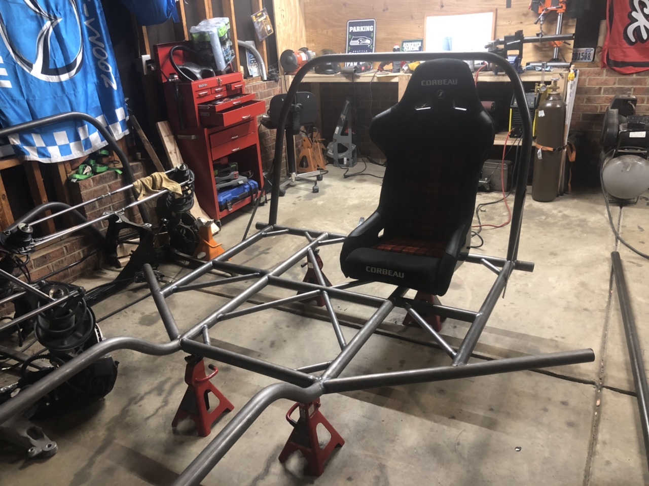

Finally building in 3d, got the main hoop finish notched and welded on!

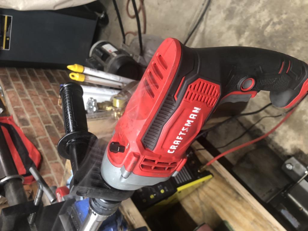

Killed the drill finally, i was trying to notch dash bars... Craftsman Warranty..?

Craftsman warranty? Good luck with that. What was the original warranty? Head for Lowe's and see what they say. Let us know what happens if you pursue it. I have plenty of Craftsman tools and no Sears nearby. Good luck.
The "Craftsman tools warranty" died when Sears sold off the Craftsman name. The new stuff is no where near the quality it used to be, and even Sears (if you can find one) doesn't honor the warranty for the old stuff.

I hear Ace and Lowe's still exchange them. Craftsman as a brand is not dead... Just Sears.
