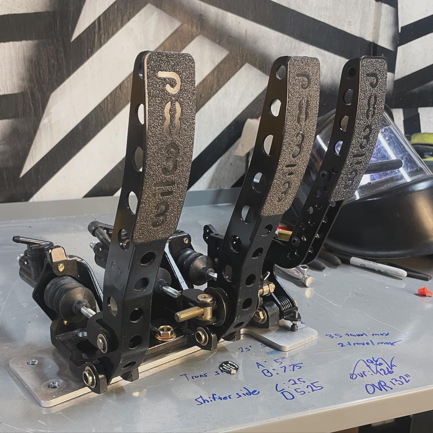

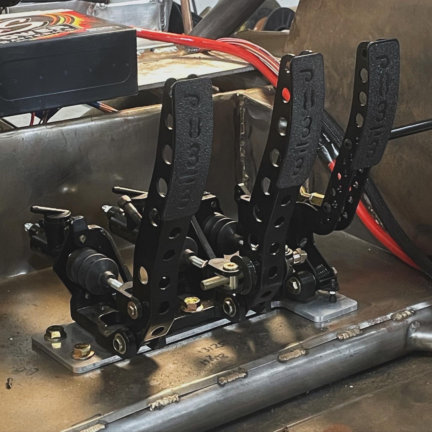

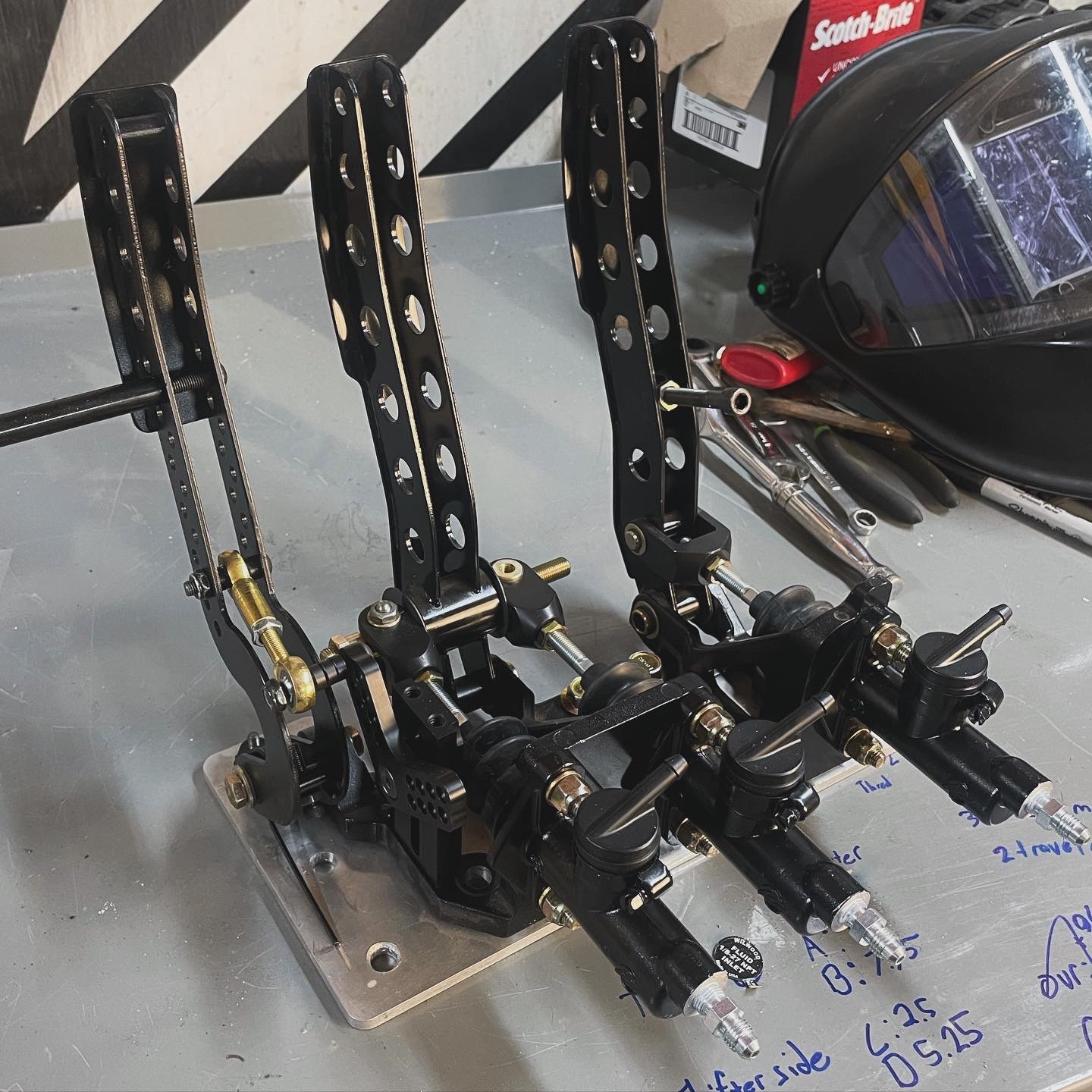

Did pedals yesterday. The wilwood clusters are super trick!

Could the reservoirs be inverted if one wanted to hang vs stand the cluster?

QUOTE(76-914 @ Feb 16 2024, 07:48 AM) *
This one is specifically designed to be floor mounted but there a slightly different part number that’s meant to be hung

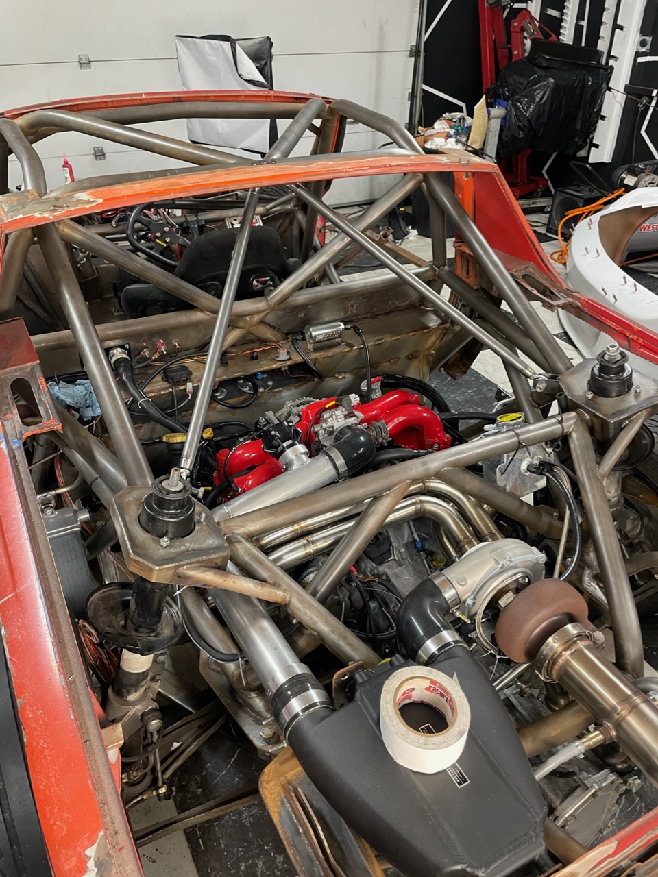

I added removable braces that go from the roof to the shock towers. I used tube adapters from mc mastercarr and some heim joints to allow we to preload them and also remove them for service

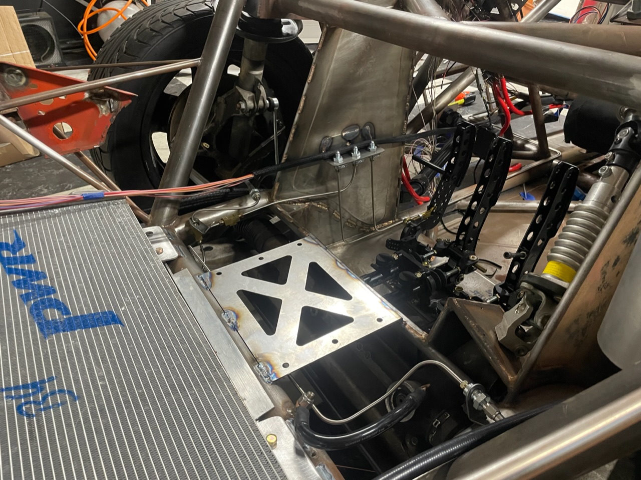

Recent work has been dedicated to the brakes, and thus I finally got to run all the stainless brake and clutch lines and it came out very clean!

Super clean work! I'm usually cleaning up my lines after the fact...

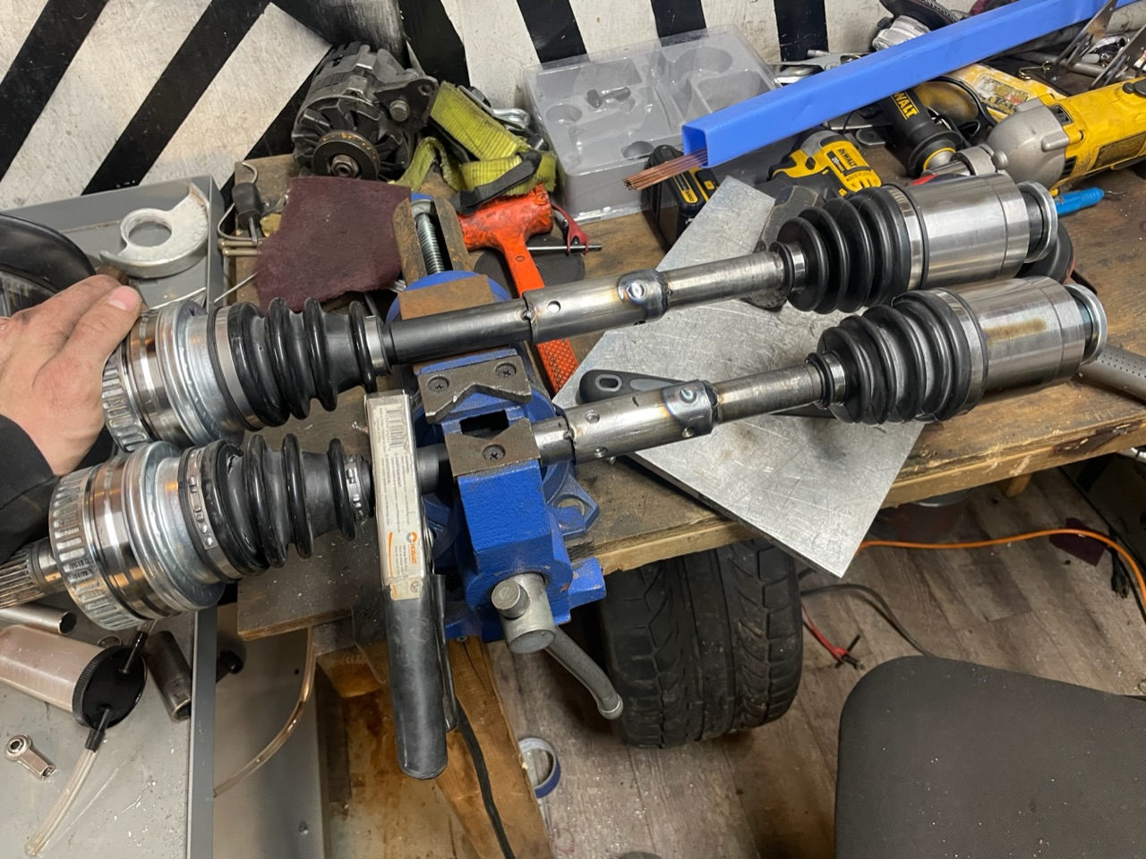

Been making a custom set of mock up axles. These will see very limited driving and such but they should be plenty strong but im no engineer. Boxster outer subaru inner.

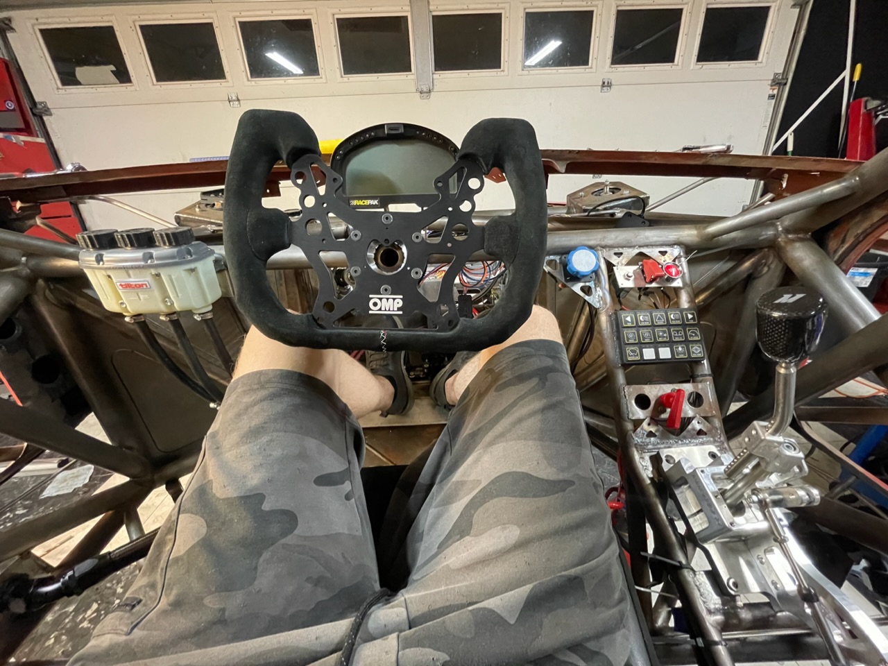

Decided it was time to change steering wheels on this beast in preparation for the first drive. Something a little more… wild. Its a tad bigger than before to allow it to steer a bit easier along with mounts for my buttons.

QUOTE(tazz9924 @ Feb 26 2024, 09:59 PM) *
This will be interesting! (IMG:style_emoticons/default/popcorn[1].gif)

QUOTE(tazz9924 @ Feb 27 2024, 06:40 PM) *
Mmmmmm... steering wheel buttons.....

QUOTE(tazz9924 @ Feb 27 2024, 12:59 AM) *
It'll be interesting to see how those hold up. I've had best success with both sides of the axles pressed into a tube with two "fishmouths" on it so the welds are at 45 degrees to the axle circumference. That reduces the shear load and adds a component of bending which is a lot easier to handle. Done the way you show I've had a weld break and one side of axle free rotate (not dangerous in any way). But every case is different. (IMG:style_emoticons/default/smile.gif)

QUOTE(jd74914 @ Feb 28 2024, 01:54 PM) *
Yeah its less than ideal. Eventually ill have the driveshaft shop make a real set but this will get the car off the jacks. The axles basically pressed into the collar so at least they will be balanced.

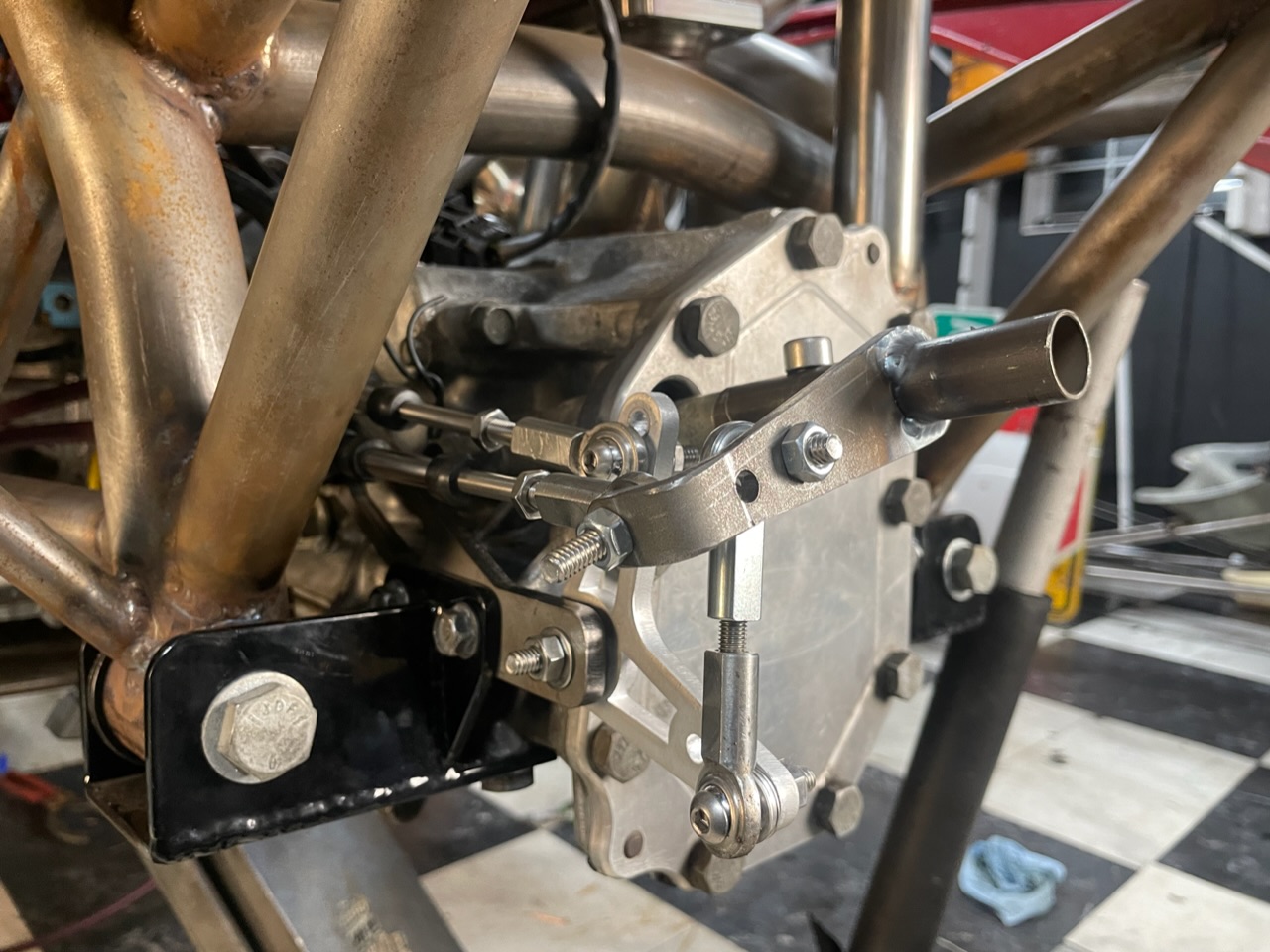

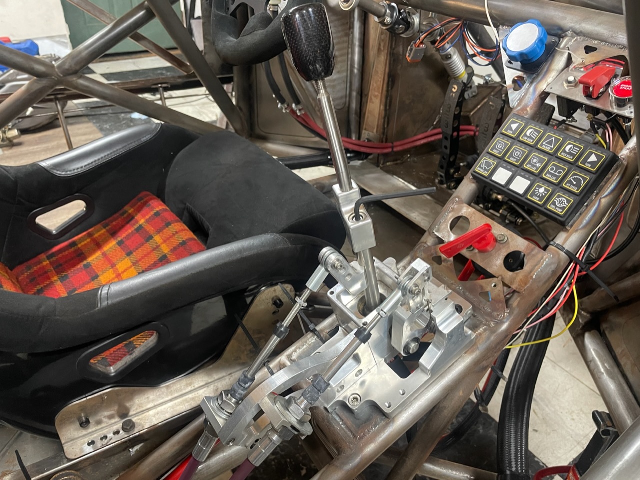

I “finished” the shift linkage. Everything looks great, it goes in every gear but theres one major issue: 1st is on the right and fifth is on the left (IMG:style_emoticons/default/dry.gif). I didn’t mess up, not totally. The original shifter in my old car id from an mr2 and I thought id be fancy and get a k tuned shifter. This was a bad idea because apparently the k tuned shifter pulls the cable when you move the stick to the right instead of pushing it like the mr2. So maybe a good cable shift mechanism (minus cables) and a subaru cv to 914 stock cv custom axle will be fir sale soon
