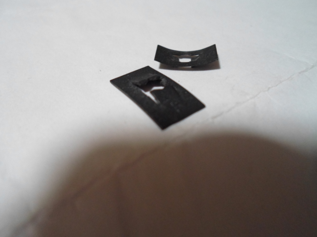

I'm in the process of refreshing the Deck lid and grill parts as well. I haven't gotten them fully sanded and painted yet, so I haven't reassembled. However, Mark at 914 Rubber told me that they don't include those push nuts in their Engine Deck Lid Kit because they have to get them from the Porsche dealer and they are pricey(if you call them, they CAN get them for you though). Since I'm not doing a Concours resto, I just went to the hardware store and bought these:
I test fit these on the grill "prongs", and I think they are going to work fine.

thanks, they look just the job, I will measure up the prongs and order similar on line

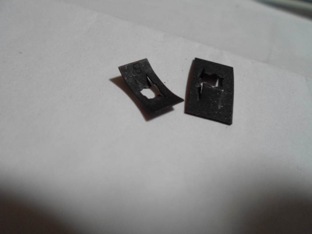

I picked these up for $3 for 25
They do the job perfectly although they are single use but for that price (IMG:style_emoticons/default/beerchug.gif) Attached Image
