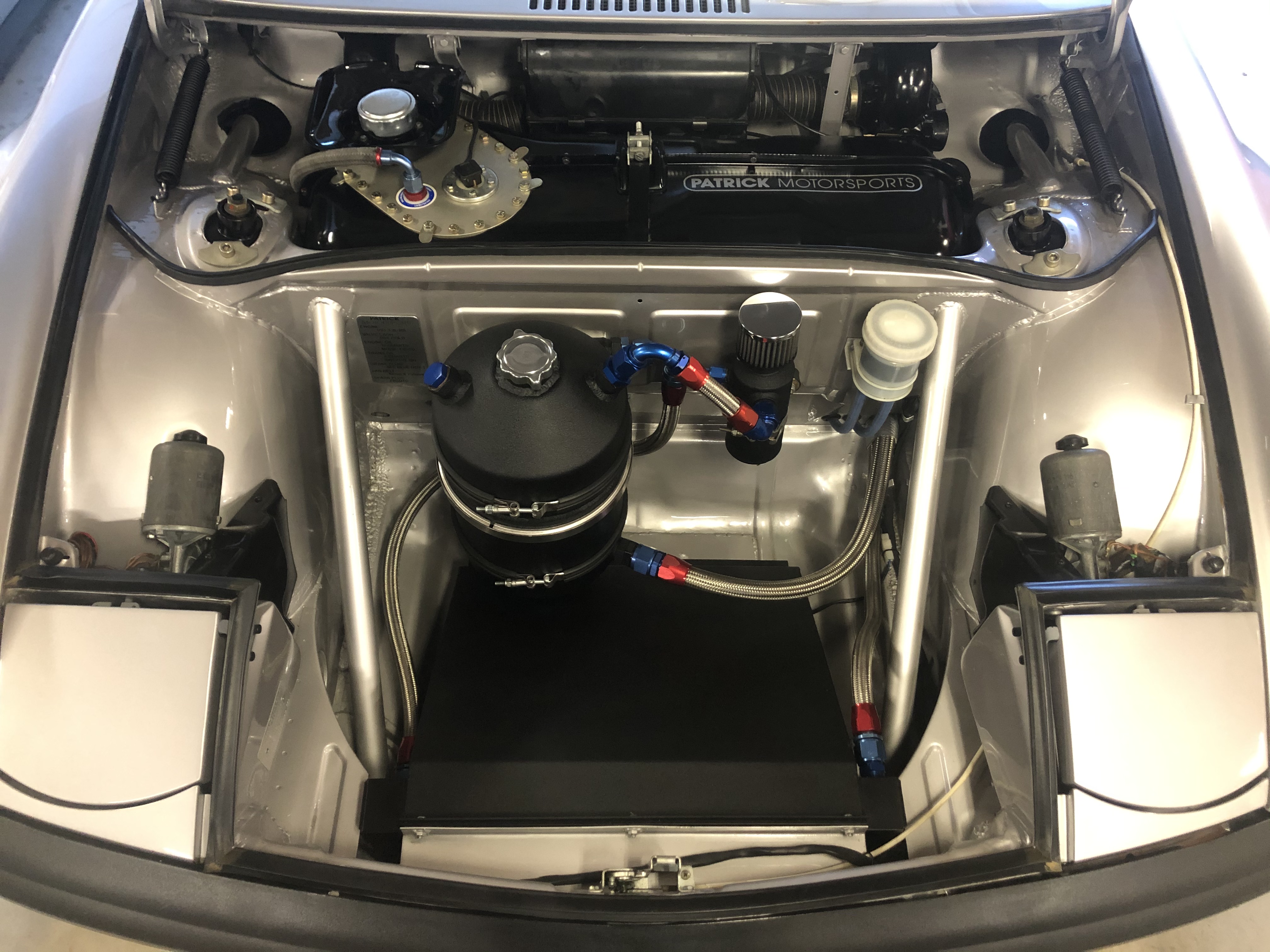

^^ That approach is great because it leaves you with a Frunk that's actually "usable"
Between the ducting and the Petersen oil tank, I can't realistically put anything in mine (IMG:style_emoticons/default/dry.gif)
@riquemar aren't you still using the Petersen "keg" also?

Here is my system which is a Patrick Motorsports Setrab unit on a modded 993 3.6. I ran mine for a couple years without fans BUT I got caught once on a backed up freeway and the temps went thru the roof. I added 4 puller fans with a tstat switch. The system configuration, install, fans, and electric circuit were all my design. This system has been a life saver.
