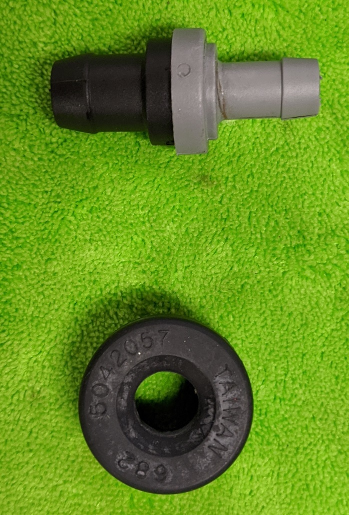

The solution I finally came up with (again taking a cue from pbanders), was to adapt a modern, readily available PCV valve to the car. This provides apparently similar airflow as stock at high engine loads (low vacuum), and lower airflow than stock at idle (high vacuum). If you try this, you'll likely need to adjust the idle screw on the throttle body to compensate for the reduced flow.
The components I used are as follows:
PCV Valve: Microgard PCV 279 (cross for FRAM FV279) which is a generic valve for a 1990 Toyota Corolla
Grommet: dormanproducts.com p/n 42057 PCV Grommet (cross for Toyota 90480-18180)
The grommet fits the hole perfectly in the 914 breather box. The nipple on the valve is around 11mm diameter, which is a bit too small for the 13mm PCV hose (or elbow) on the 914. I currently just have the nipple on the valve wrapped with electrical tape to size it up to 13mm, but I plan to fit a proper adapter to size down the 13mm hose and connect directly to the valve. I suppose I could also fit the original elbow, but plan to just leave the hose exiting the valve vertically.
Here are the relevant pics:
I hope that somebody may find this useful. Comments are welcome and appreciated.

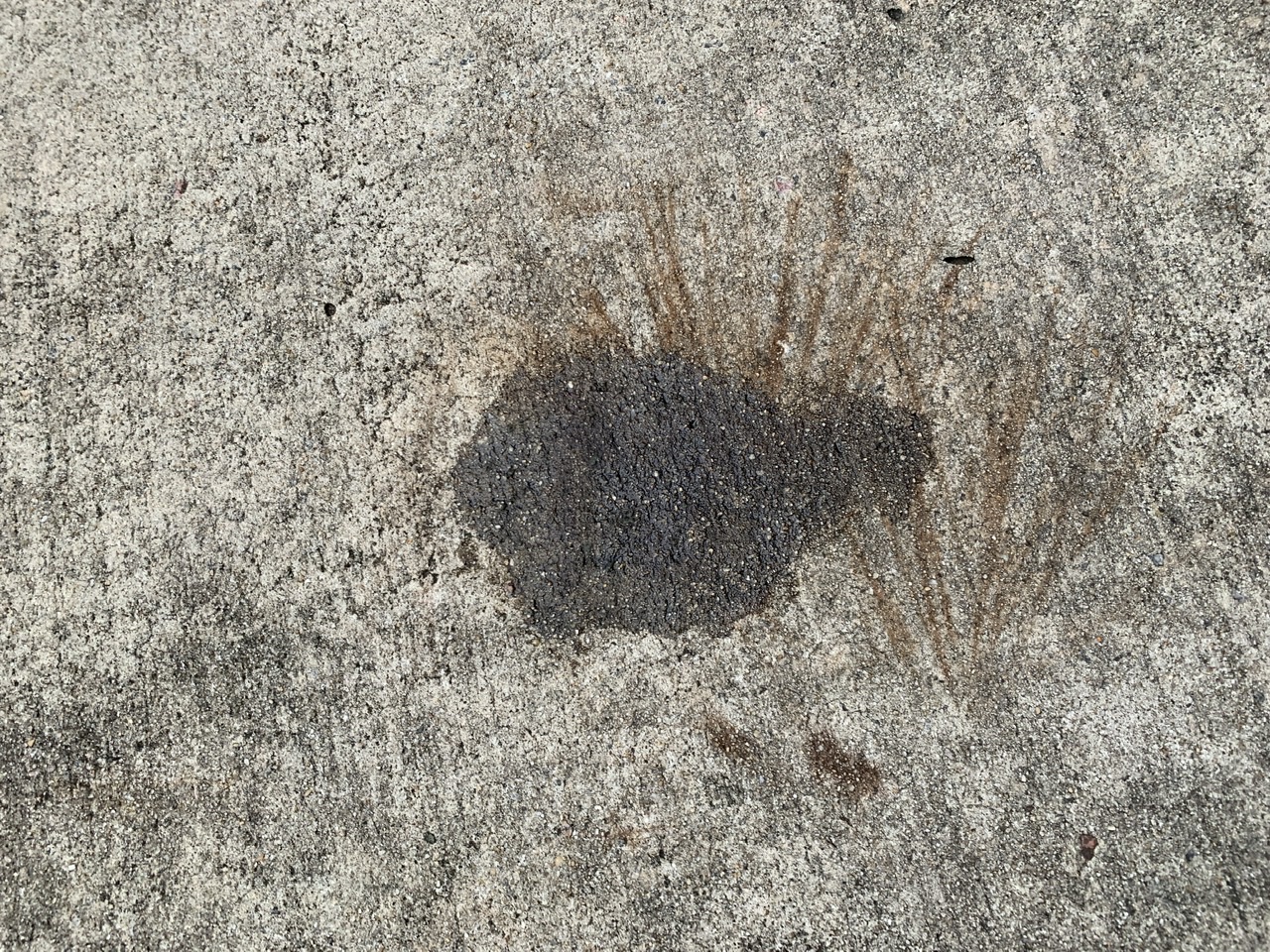

first test result: option#4- immediate pressure issue, idle and big oil leak. removed pvc and put it back to no pvc all other things same, normal perfect idle, have to burn off some oil now.
Phil
DRPHIL914
post Aug 18 2020, 06:53 AM
Dr. Phil
Posts: 5,876
Joined: 9-December 09
From: Bluffton, SC
Member No.: 11,106
BTW that was a big puddle before i soaked it up, and FAST! way too much positive crank case pressure! so i geuss thats a big no for me- back to stock '75 set up.

QUOTE(DRPHIL914 @ Aug 18 2020, 05:53 AM) *
Hmmm...
Sorry it didn't work for you.
Like I said earlier, I'm not sure what the plumbing on a '75 is supposed to be like. And, I don't know how your particular car was plumbed, or what you've changed to add the PCV. (IMG:style_emoticons/default/confused24.gif)
Out of curiosity, where was it leaking? Valve covers? Under what conditions? (I'm guessing WOT if it was an excess pressure problem...) Can you post a pic of the plumbing?
If the anti-flashback valve is plumbed right (to both heads and the airbox), crankcase pressure shouldn't exceed atmospheric pressure. That's the first placed that I'd look if you still want to experiment.
EDIT: If it was leaking at idle, there might be another possibility: The PCV valve should slightly *reduce* idle crankcase pressure over your prior setup. So, under normal operation, it may slightly change the way that the valve covers mate with the heads. If your leak was at the valve covers, it might just be a gasket problem that was masked before. Or, your heads or valve covers might be warped a little. (IMG:style_emoticons/default/idea.gif)
Usual disclaimers apply: YMMV. Enter At Your Own Risk. Good luck.

QUOTE(DRPHIL914 @ Aug 18 2020, 11:40 AM) *
of course all disclaimers understood,
2 things, but the biggest issue is i had not put the anti flashback valve in like the 73-74 have it shown, the 75’s just put the hose to the air box, - so i might try again but putting all hoses and flash back valve in place exactly as your diagram. leaks were not from the valve covers those are tight , so i have to look closer , might be push rod tube seal but i can tell you that before this try my motor was leak free, no leaks - i re torques the heads etc and put all new seals in 2 years ago and had been zero leaks . so i am also i tersted to see where the leak was. but after putting back to stock, no leak again.
Was it leaking at idle, wide-open-throttle, or something else?
Pushrod tubes is interesting. I imagine that it might leak there under both over- and under-pressure scenarios... (IMG:style_emoticons/default/idea.gif)

Sorry to hear that this caused a leak. It's always at the weakest sealing point. Hopefully, it's not a difficult fix.
There must be a reason that the manufacturer didn't engineer an pcv valve into this system. May be better left alone.

Interesting (IMG:style_emoticons/default/idea.gif) ,maybe that valve is designed to operate @ a different pressure and not matched the engine perhaps (IMG:style_emoticons/default/confused24.gif) would be hard to know unless you had a stock one to test against,IMO they need to be working @ the same range.
Maybe further experimentation would yield a good result ?
