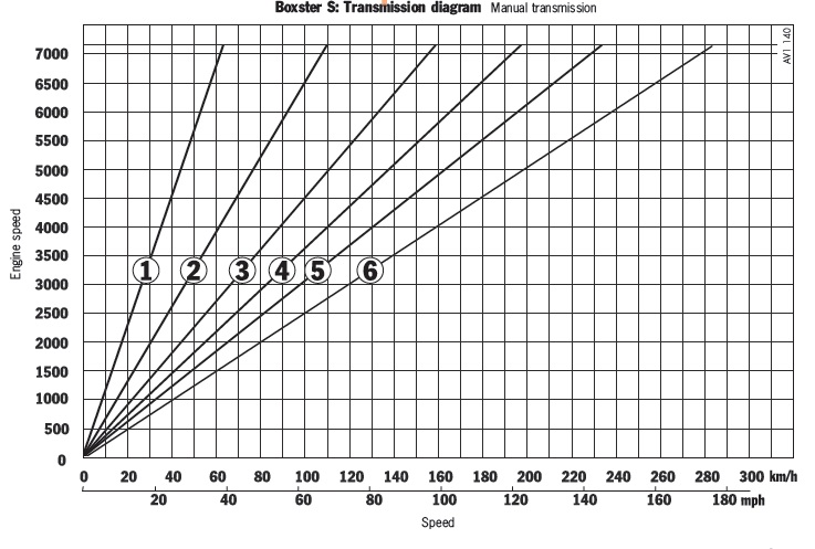

did I hear the 2nd gear in the boxster S tranny goes to 84mph? what is the top speed in 6th?

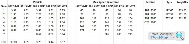

I'd have to dig into 986 gearing, but 981 gearing was a bit of a mess—to the point I wanted to have a shift knob made for my GT4 that said:
2-4-5
3-5-5
These figures for the 981 GT4 given match up with my experience:
1st = 46mph
2nd - 83mph
3rd = 118mph
4th = 150mph
6th = 183mph
The ratios were frustrating in the GT4, as there was no need to shift on the majority of backroads, and the GT4's shifter is one of the main attractions. They also seemed to really blunt its in-gear quickness 2-3-4. Meanwhile, 6th left you turning 3200-3600 between SF and LA where a 991 7MT drops the revs down to 2200, greatly increasing its comfort as well as its fuel range, while its 2-3-4 stack are really nice for a back road.
In a 914, the lack of a need to shift might be a bonus. Engine types matter, too.
I had a couple of 986 Boxsters, and preferred the 2.5 5MT gearbox to the 2.7 setup, as it was a bit shorter (in some ratios, I think) to make up for the 2.5's lesser torque. The 986 6MT was pretty nice on the street, iirc.
Supposedly, 987.1 6MT is:
1st = 30mph
2nd = 70mph
3rd = 99mph
6th = 172mph
EDIT: Found charts below, which may be helpful. The one on its own for "Boxster S: Transmission diagram" is for the 986 Boxster S 3.2

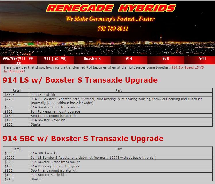

Several mentions that the KEP adapter and Renegade mount are Pricey. Pricey is a relative term, how about a rounded dollar amount?

http://www.renegadehybrids.com/
