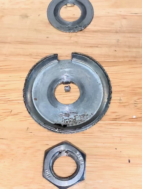

Been trying to track down a clunk from the driver front end. Car is a 74 with Koni adjustable insert/shocks on all 4 corners. Looks like its coming from the shock on driver side at the top. Something is loose inside the shock tube and/or cover which duplicates what I hear/feel while driving. I checked everything else on the arms/rack/torsion bars/ball joint and everything tight (since I just also recently replaced all bushings etc). So I wanted to remove the shock to take a look but could not remove the nut after loosening it (while countering with a pipe wrench). I suspect the tab washer (which usually locks the nut and prevent it from spinning) broke. I have read that maybe a impact wrench (I have a cordless and corded impact but not air impact wrench) may spin it loose but may also damage the shock internals so I have not tried that route? Any other ideas on how to remove the nut?

Grip the dished washer below the nut with some sliding jaw plyers to prevent it from turning and use and impact on the nut. It will come right off.

Yes I used a pipe wrench initialy which enabled me to loosen the nut. But as I continued to loosen it I noticed the threaded rod spun with the nut even though the dished washer was held in place by pipe wrench. Maybe the tab of the dished washer broke?

Bruce nailed it (IMG:style_emoticons/default/smilie_pokal.gif) ,most likely the locking tab is broken,had the same issue myself on one front strut,plan is to remove and weld the tab back on as I believe it could be tighter.

Update on this. Did not need to use impact. Looks like the tab on the dished washer broke. Maybe I overtorqued it during install? I was able to coax whats left of tab to bite unto the rod groove to get nut off. Next problem Im having is getting the rod to go down from the mounts so I can inspect the shock inside strut tube. Tried pulling from below with front of car lifted but no luck. How do I push from above?

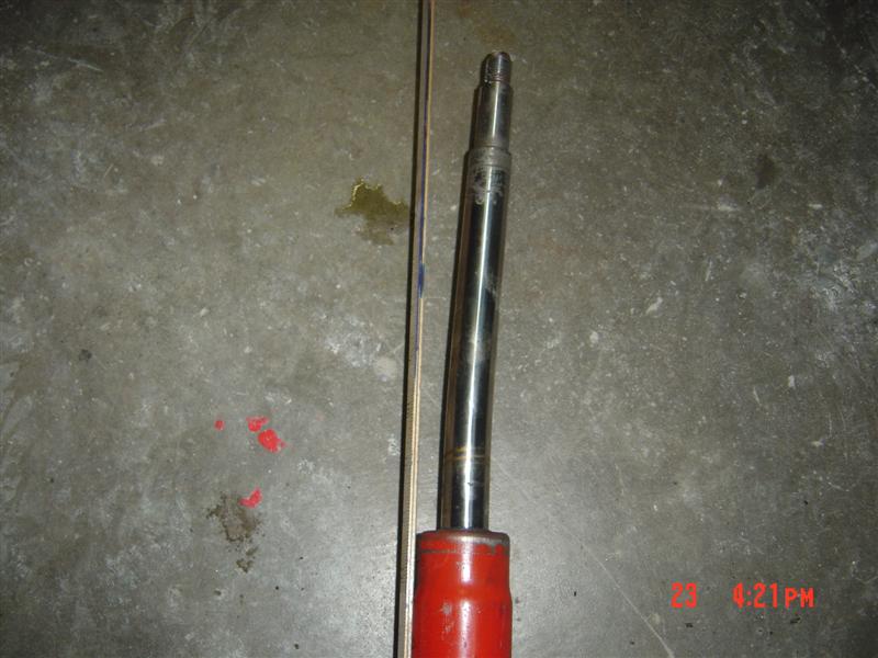

It could be bent.
I bent mine sliding into/over a traffic island.

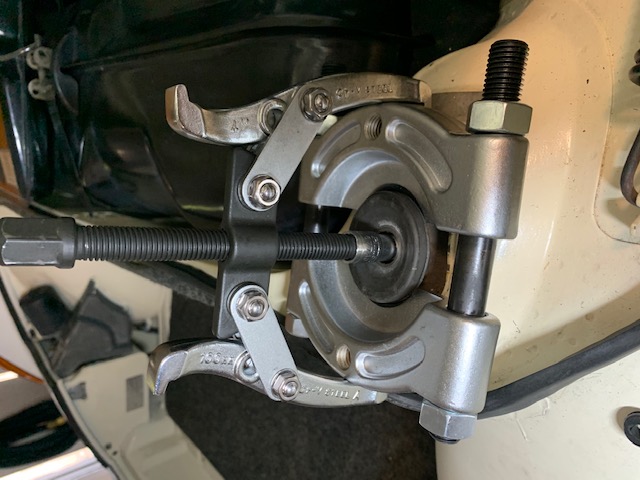

Have you pulled the shaft free of the bushing? Pull on the cover and fully compress the strut. You'll have to reef on the Konis a bit. After compressed you can pull it down and out to clear the wheelwell. Throw a towel over the fender first so you can protect the lip. Putting it back in compress it, let it go and aim at the bushing.

After much thought, had to improvise how to push that shock rod since pulling from under failed. Noticed that there was rust in the top hat where rod inserts probably caused it to bind. Will clean before reinstallation.

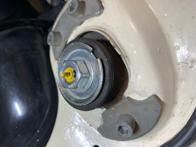

After lubricating the inside of the strut I replaced the shock and tightened the gland nut with a spanner wrench, no clunk now, but seems like theres still a gap? Should this be flush?

There’s a 2-3mm gap with bilstein inserts so the gap you have might be normal. I checked with Bilstein tech dept and they said they get asked all the time but it’s designed to have a gap rather than bottom out and still be a little loose. I did t know about other brands but they might be similar design.
