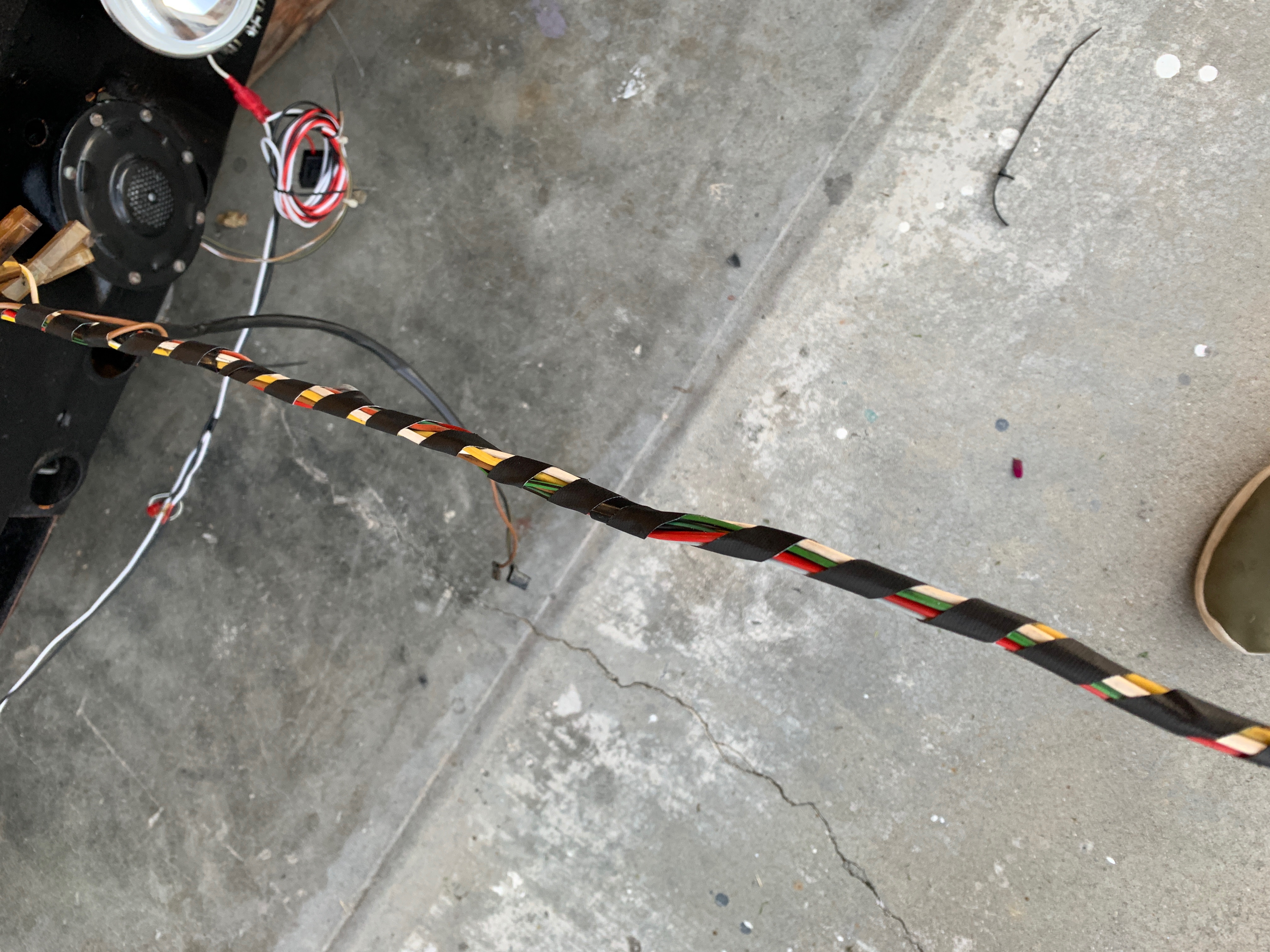

I just went through a similar project this last summer, where-in I took an adapted harness from a 75 - 3.6 and transplanted it into my 70'. Granted, you don't need to remove the harness so the whole process is pretty straight forward.
As other members mentioned, check for any splicing and rubbing and that the wires are flexible. This is a great time to un-tape certain sections, check underneath, clean and re-wrap. Though I eventually went a different route and applied 'safety sheathing', 914rubber.com sells a great tape that will leave the harness looking like new. (IMG:style_emoticons/default/bye1.gif)

Great stuff, photo of the tape here. Anything from 914Rubber is (IMG:style_emoticons/default/smilie_pokal.gif)

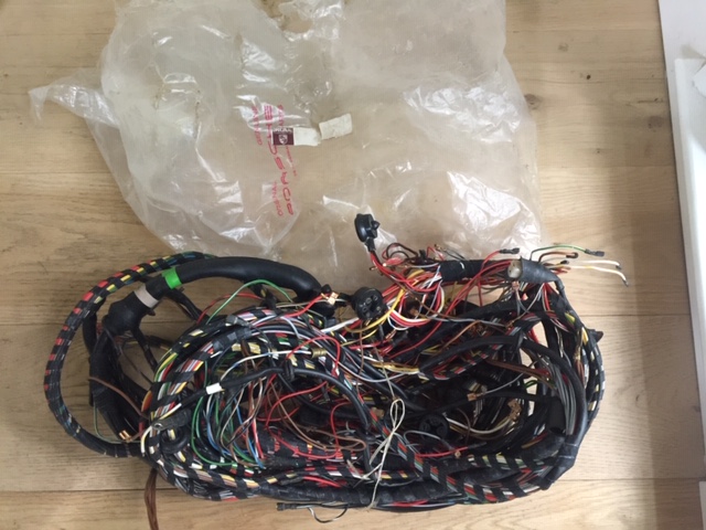

The very first part I bought for my 914-6 was an NOS wiring harness, still in the factory sealed bag and box from Porsche. I believe I paid $1,200. When it arrived I felt like God had reached his hand out and delivered the absolutely perfect harness.
If you have a questionable harness, the Germany MS-Bordnetze harness which if my math is corrects about $2,800 is actually not all that bad. Think of the hours you might save chasing wiring Gremlins or replacing parts that short and cause damage.
Finally, anything @JeffBowlsby makes and sells is going to be perfect- that is just how he is. So whatever harnesses he offers for your car, you would be foolish not to replace with his new ones. (IMG:style_emoticons/default/beerchug.gif)

I remember that was a great score for you. I bet a used six harness is worth that much.
When someone here pointed out a nos early four harness on German eBay for $850, I jumped on it. The wires are soft and flexible. Feels like new.
