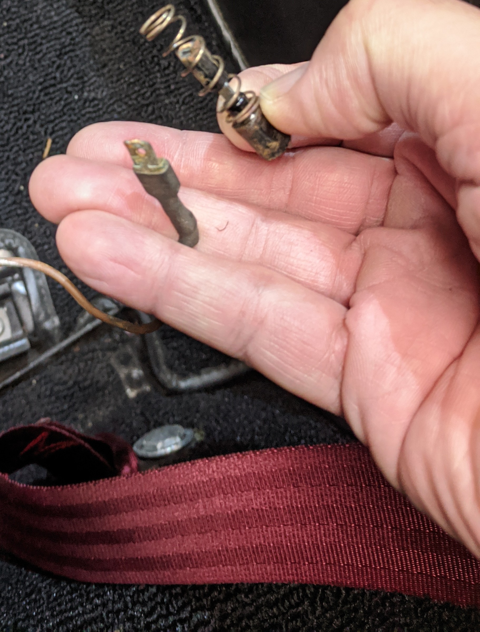

I removed the seat. The cable from the brake looked good. I wiggled it around a little and the brake works fine. Kind of concerns me so ce I didn't really do anything.
While under there I found this second wire, what is it? Fasten seat belt sensor? It wasn't attached to anything. It was just kind of stuck in the hole on the floor near the base of the brake. Perhaps it was interfering?

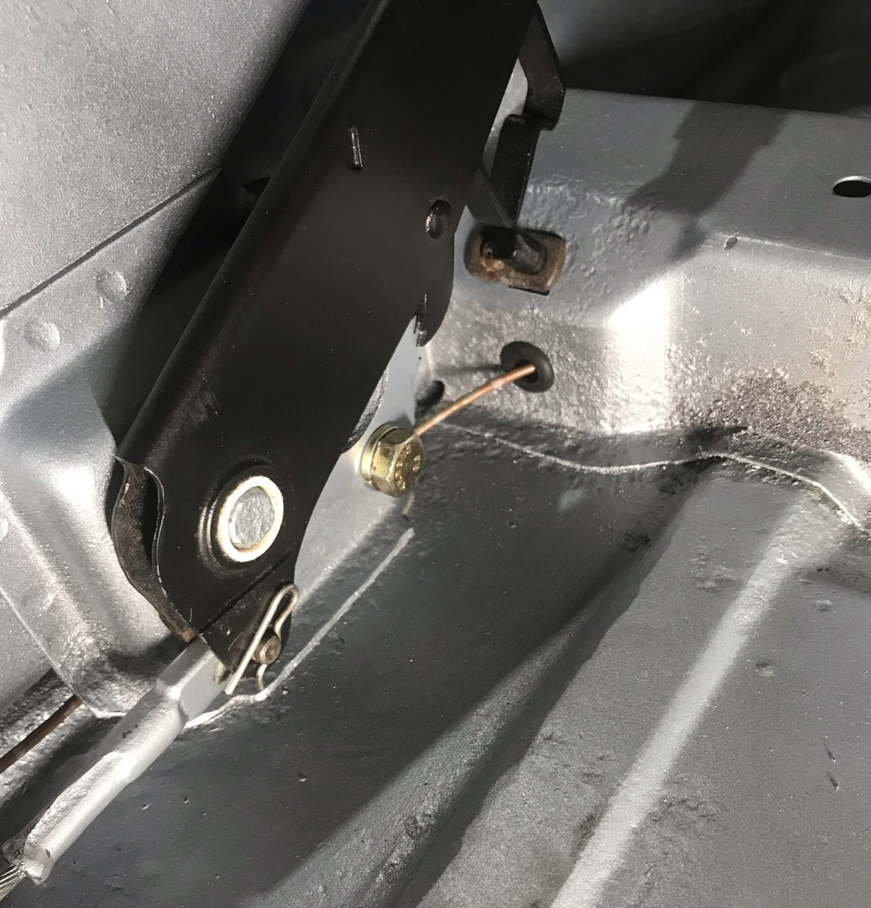

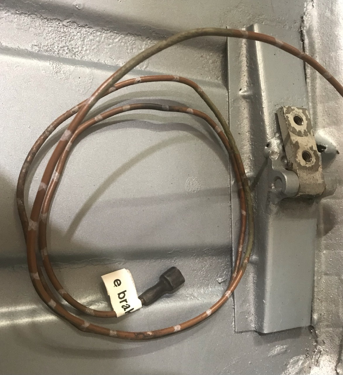

Dion
post Apr 9 2021, 04:41 AM
RN
Posts: 2,931
Joined: 16-September 04
From: Shepherdstown, WV
Member No.: 2,766
Visual aide

QUOTE(Dion @ Apr 9 2021, 05:41 AM) *
Visual aide
That is absolutely it. Mine is not connected. Seems to be broken. What issue will this create?

QUOTE(tsvo @ Apr 9 2021, 06:25 AM) *
There is a big red light in the left hand gauge that is supposed to flash when the park brake is engaged. That is the wire for it. It should go to a switch that gets depressed when you lower the handle.
It is the same basic switch as the door jam switches for the interior lights. They are inexpensive and can be picked up from your favorite parts pusher vendor.

BeatNavy
post Apr 9 2021, 06:30 AM
Posts: 2,967
Joined: 26-February 14
From: Easton, MD
Member No.: 17,042
If you look in Dion's second pic above you can see the switch is mounted right into that metal cross member on the floor pan and then grounded to the chassis. Get a replacement switch and insert it into that square shaped hole on the metal cross member. Then make sure the wire is grounded either by connecting it what's left of the original wire or doing it in a manner similar to what Dion did.
Just to be clear, the e-brake is a mechanical setup, though. In and of itself this isn't causing the original issue you described (unless pieces of your switch are interfering with operation somehow).
