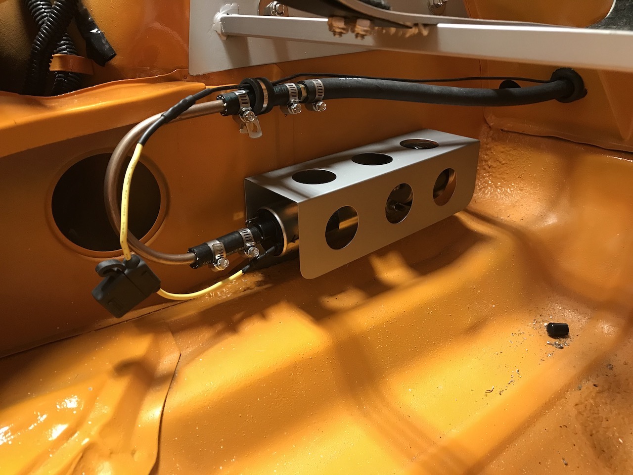

Joec, mine in a 914-6 GT Tribute for track but still streetable. For easy access I put the fuel pump in the front trunk. Best, MarkAttached Image

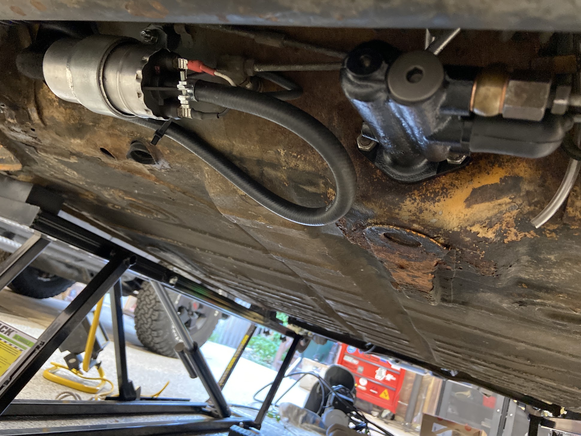

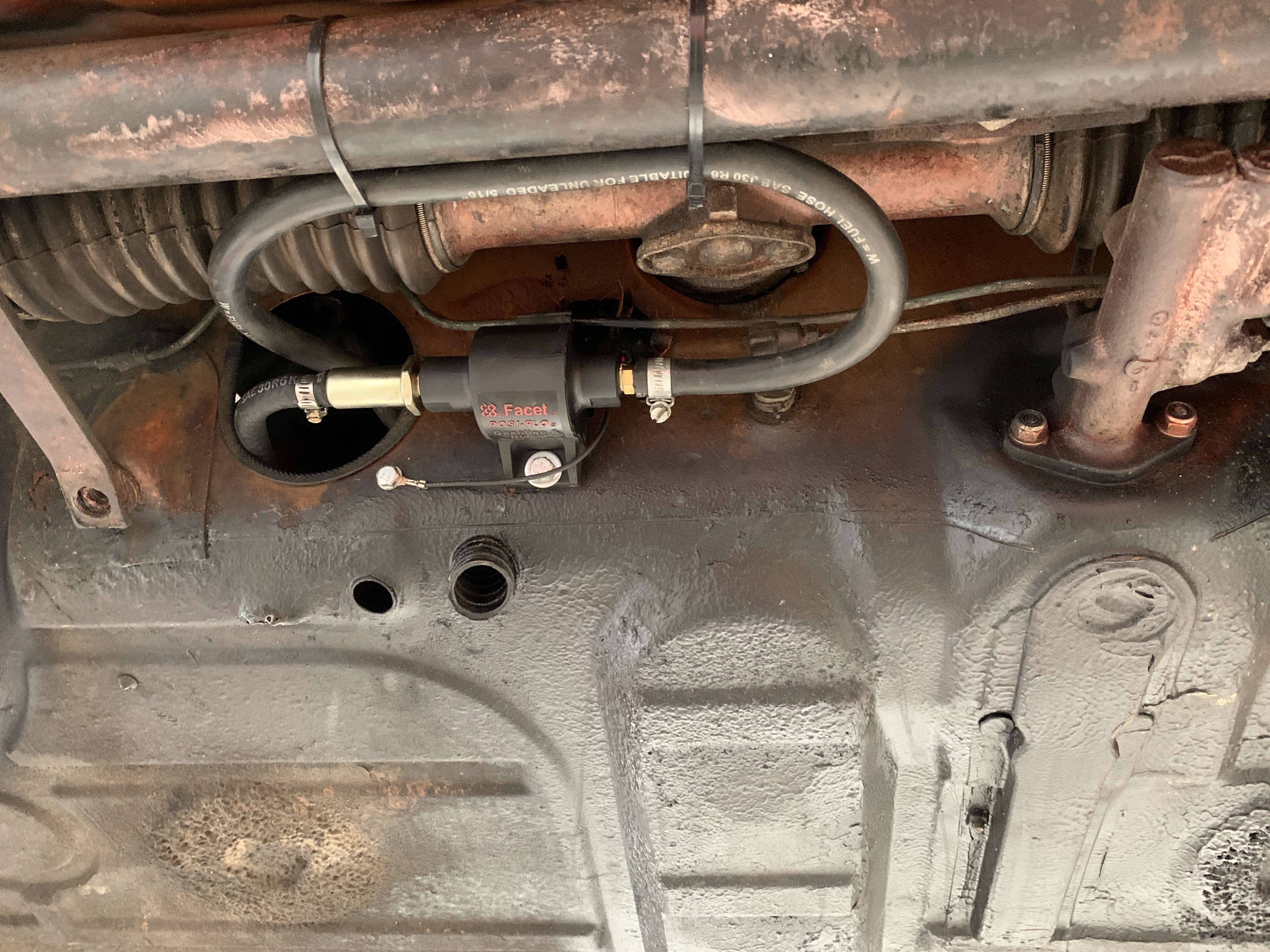

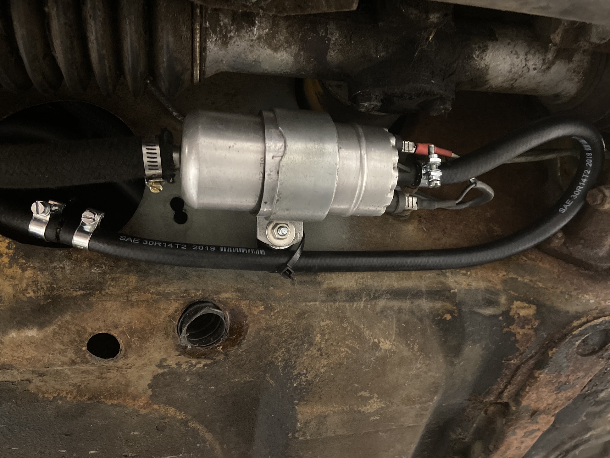

Just ran this gauntlet.
The 1971 I got--the lines were shot--in fact, I barely touched one of the old lines in the engine bay and it completely disintegrated. Another anecdote--was in Phoenix at a Porsche junkyard and it was full of stacks of burned up 914s. Oh, and the insurance on this 1971 came in higher than my 964...so yea...fires are a thing.
I bought the the lines from Tangerine Racing. They were hugely helpful. Also had the relocation instructions/bits from Dr 914 at AutoAtlanta. It was a bit of overkill, but gave me a little flexibility on the mounting at the front.
It took me longer than it should have because I didn't have a second set of hands to run the long lines through the tunnel..but with two people a bit of motivation, it's an afternoon if you have everything you need.
Couple pics...and while you have that cover off in the front--might as well check to see if you need to replace your master cylinder...
someone told me early on...spend the money upfront...or spend the money on the backend to fix everything--but just understand, you'll be spending the money. (IMG:style_emoticons/default/sheeplove.gif)

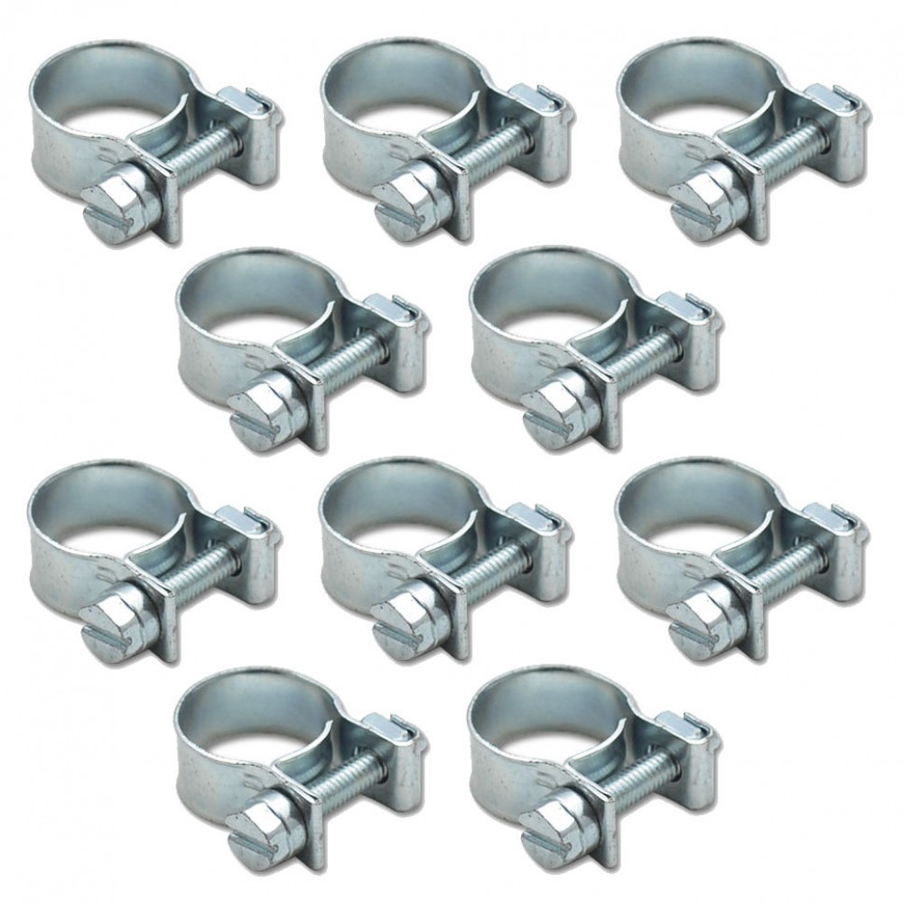

Member No.: 3,457
PLEASE do not use worm gear clamps on fuel lines. Use fuel line band clamps only

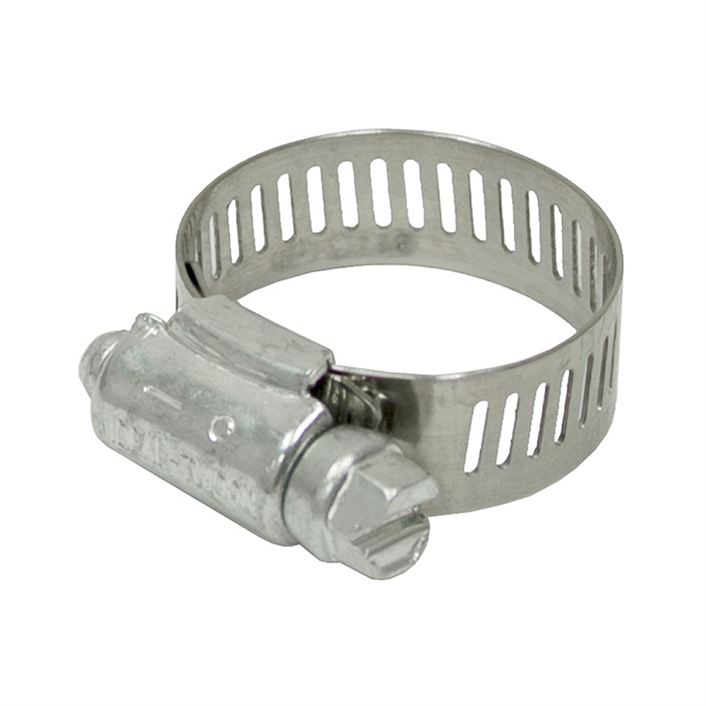

QUOTE(mlindner @ Jul 22 2021, 12:36 PM) *
People tell me that these kind of hose clamps produce leaks. To that I say it depends upon the kind of hose that you're using. I've used these kind of clamps for decades with no issues whatsoever.
windforfun

From: Blackhawk, CA
Member No.: 8,476
QUOTE(914Sixer @ Jul 24 2021, 05:04 AM) *
Nope. I disagree. The right fuel hose works just fine with those kind of clamps.
