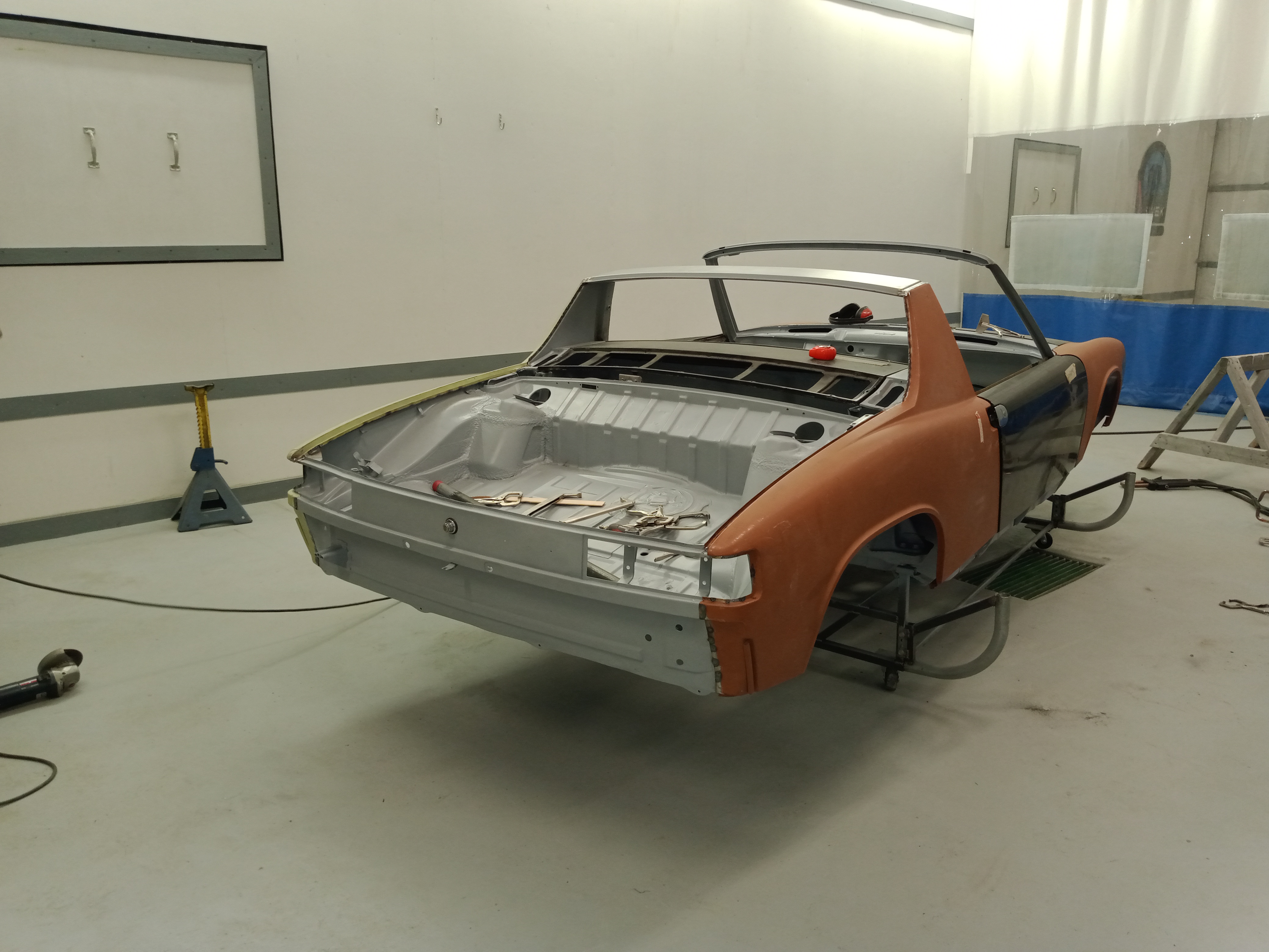

This factory 6 managed to escape the forces pulling it into a black hole never to be seen again. It was not without every ounce of thrust it could muster and it was not without suffering a considerable amount of damage. The crew patched it back together the best they could with primitive tools and scrap they found floating in space. fortunately they crash landed in easy reach of the secret facility known as Area51Werks. The owner is someone you may or may not know. Juergen Lives in Washington. The car will eventually end up on the other side of the pond. But for now it is on it's way to the final stages of completion. It was not like this in the beginning....

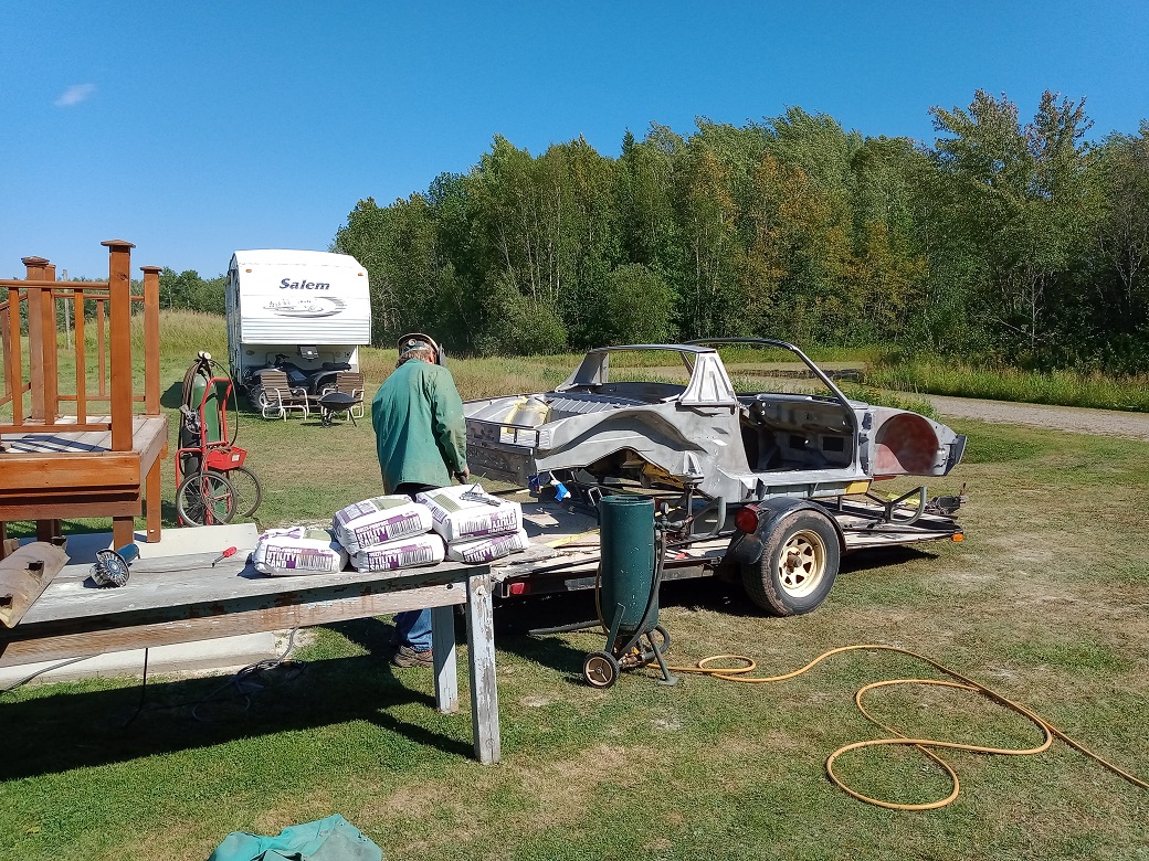

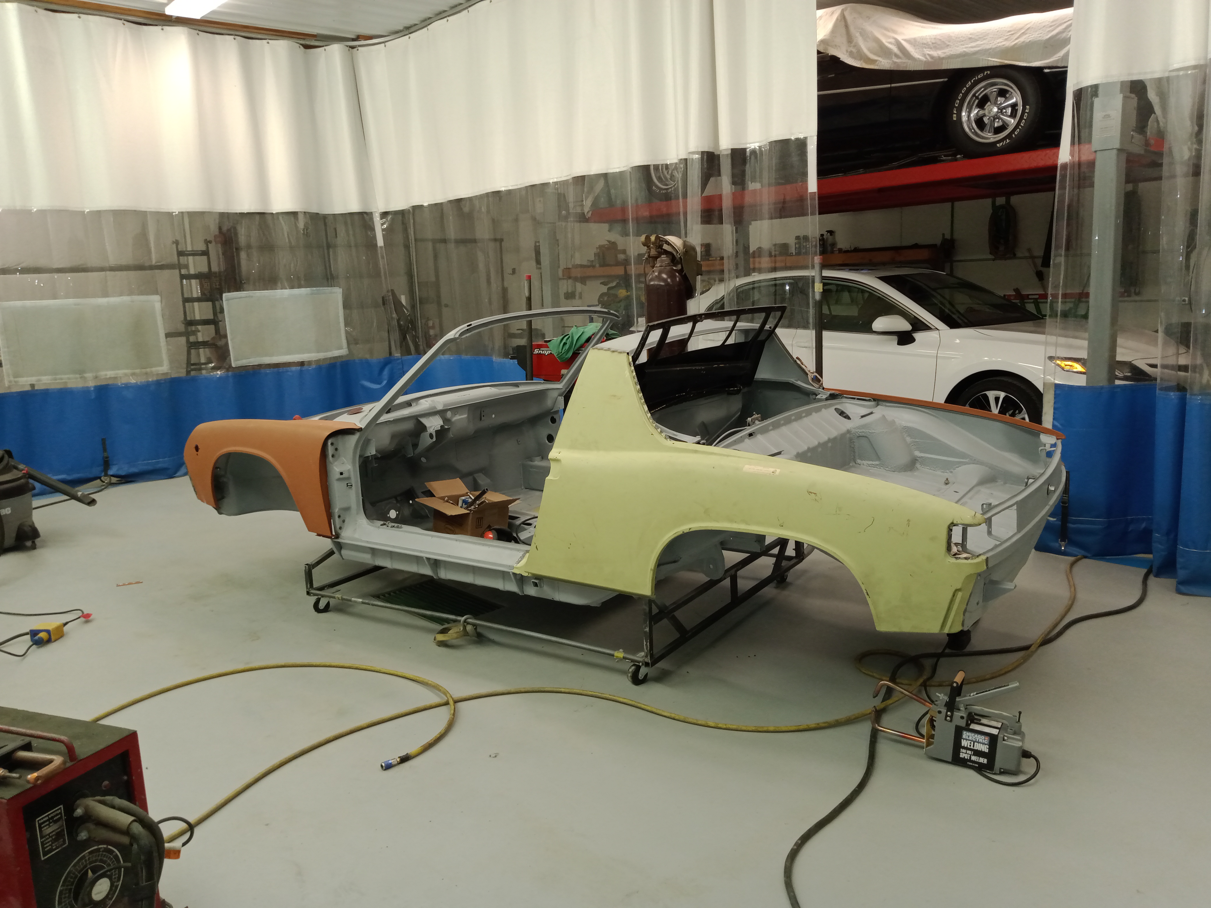

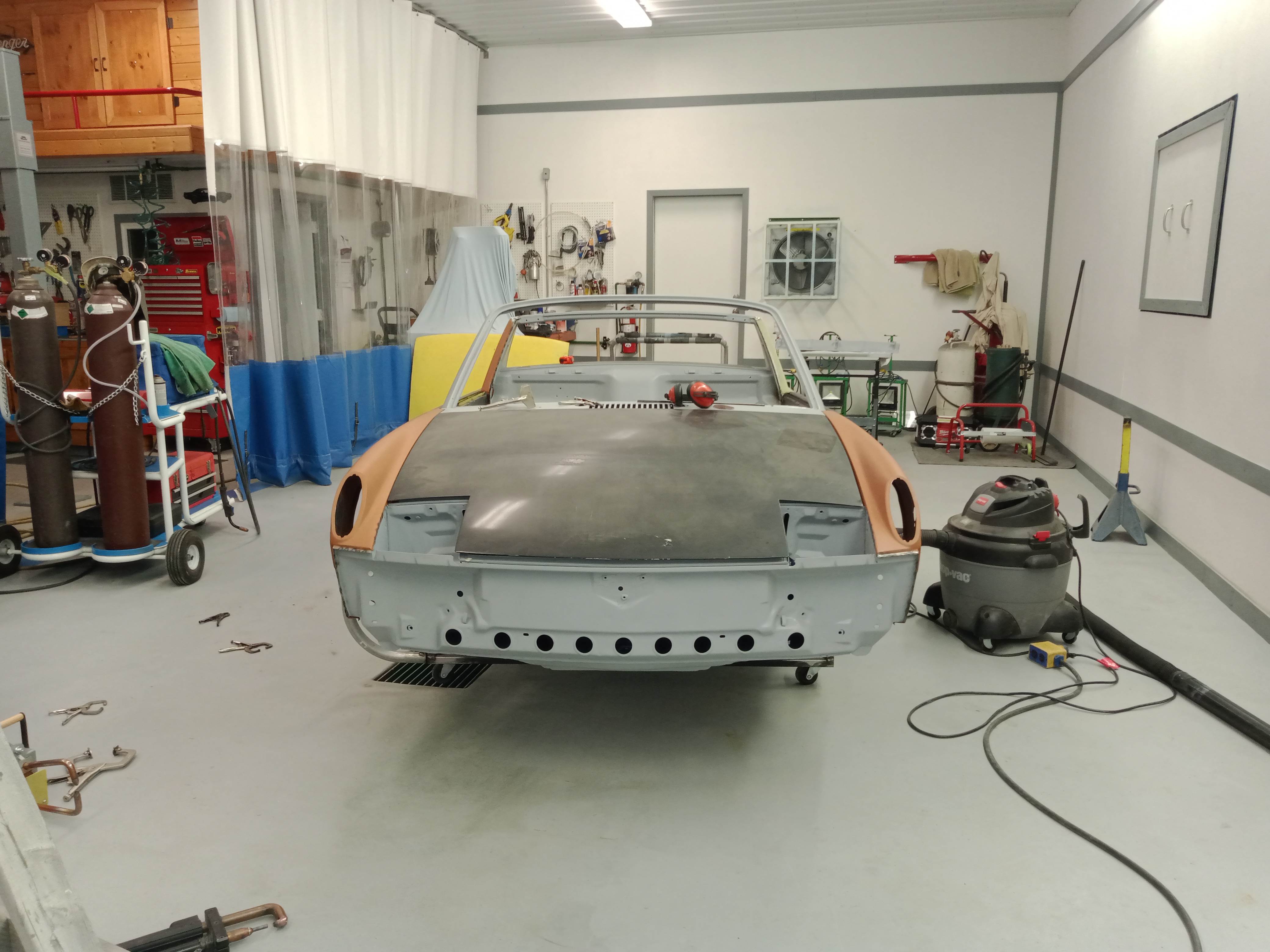

The location pictured is 50 miles from the base in a remote rural town called Kelsey MN. Hidden among the farming fields is a dream shop owned by a life long friend. He is the guy dressed like a little green man with a jet powered blaster cleaning the chassis to the bones.

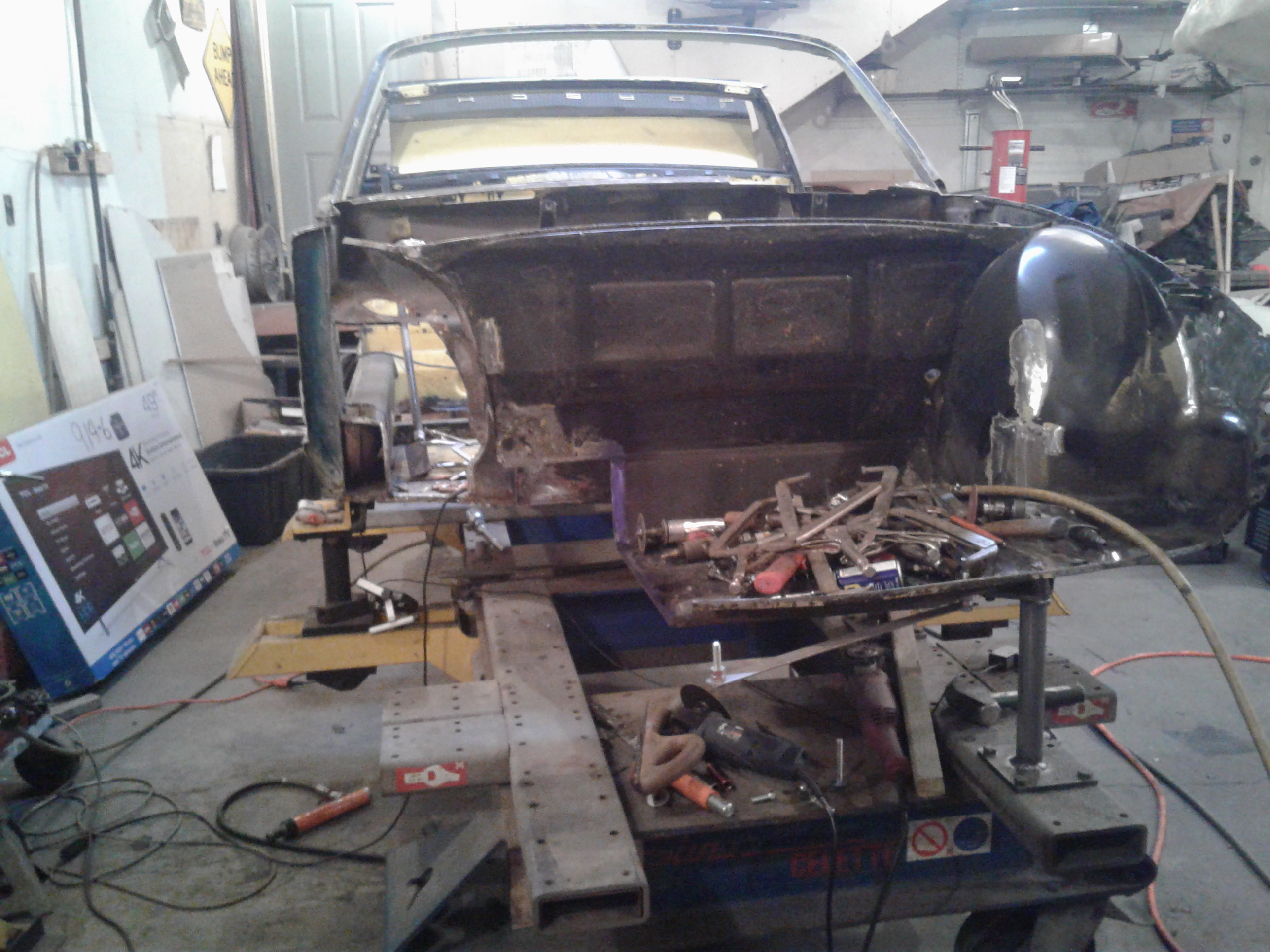

Now some scenes from the wreckage.
Never say Never. We can save her. We can make her better than new.

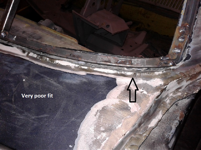

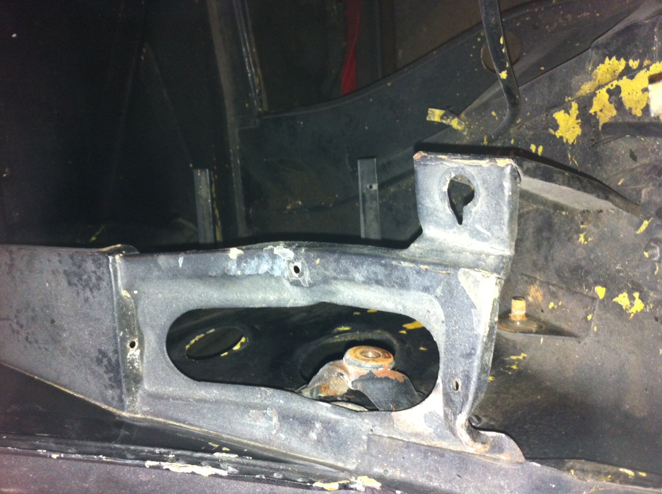

Some work from space where the early crews patch work was hidden under a layer of roofing tar. Or was it some nasty secretion from some unknown species.

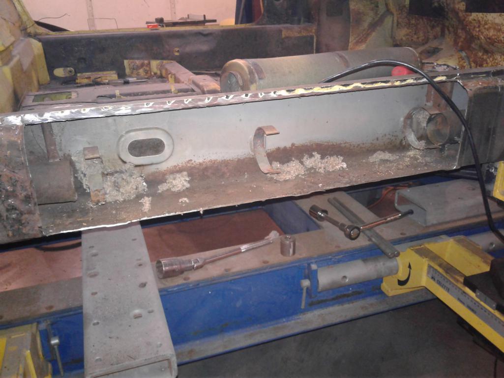

These do not belong on a 914. they were fashioned from scraps off the USS Enterprise. Her debris was found just outside the Milky Way.

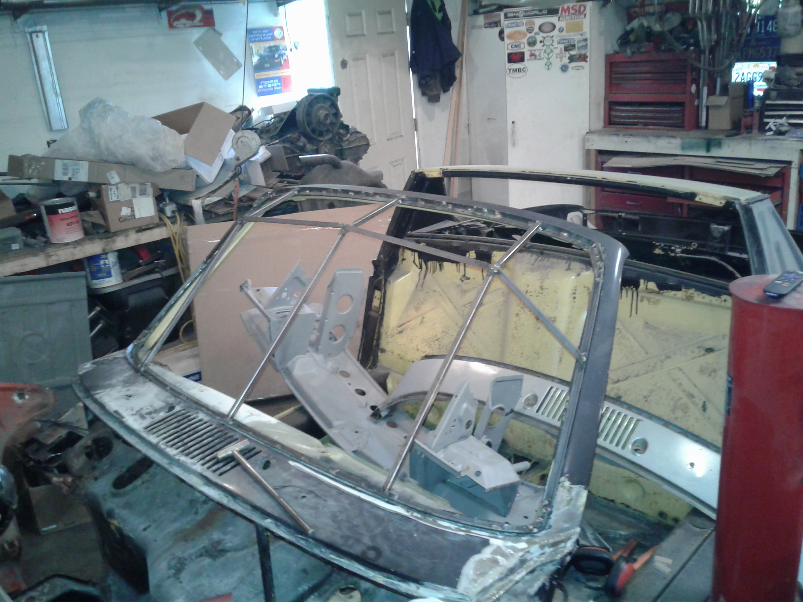

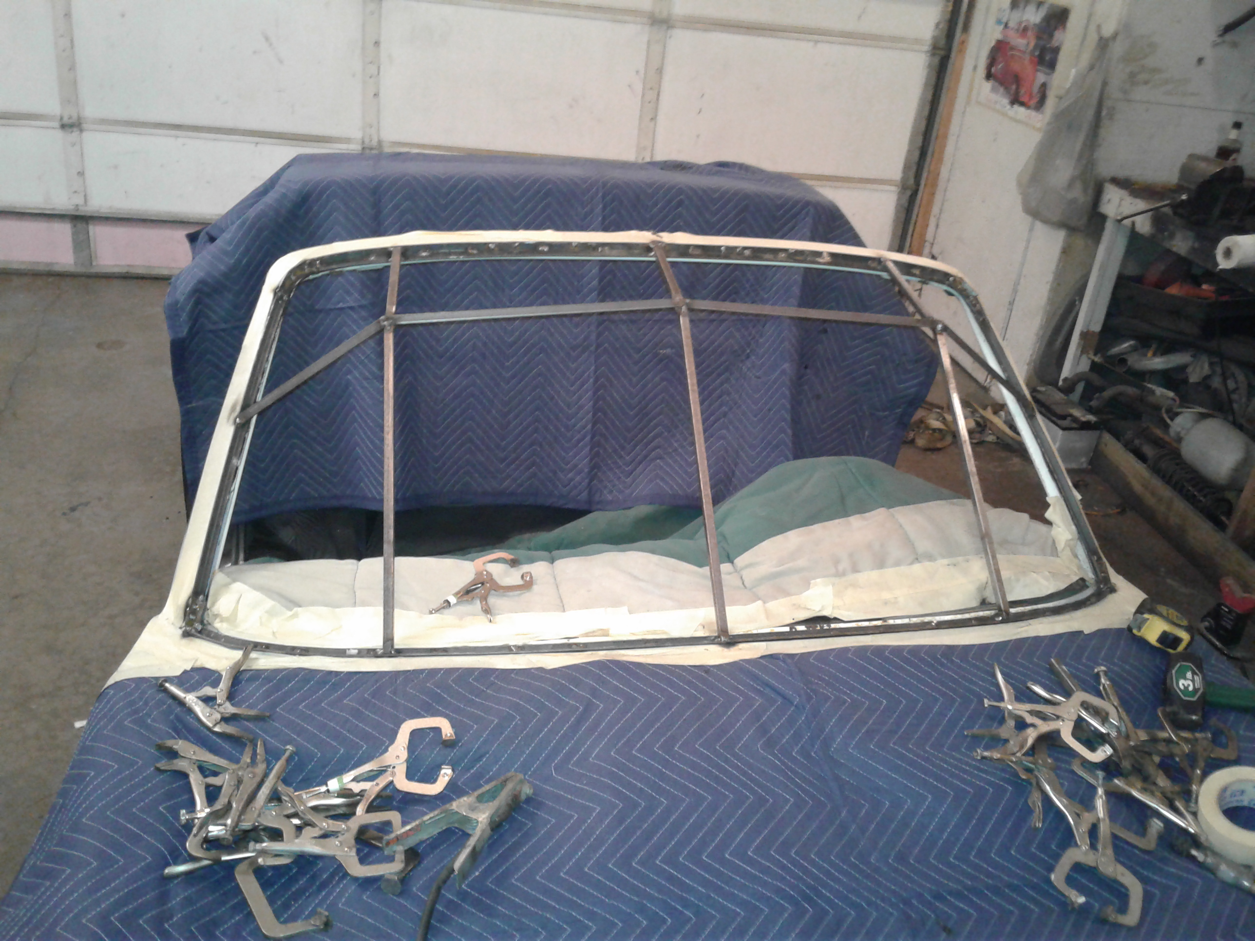

The Alien offered her windshield opening to fashion a fixture as the car from the black hole suffered some serious cowl top damage.

The Alien (IMG:style_emoticons/default/assimilate.gif)

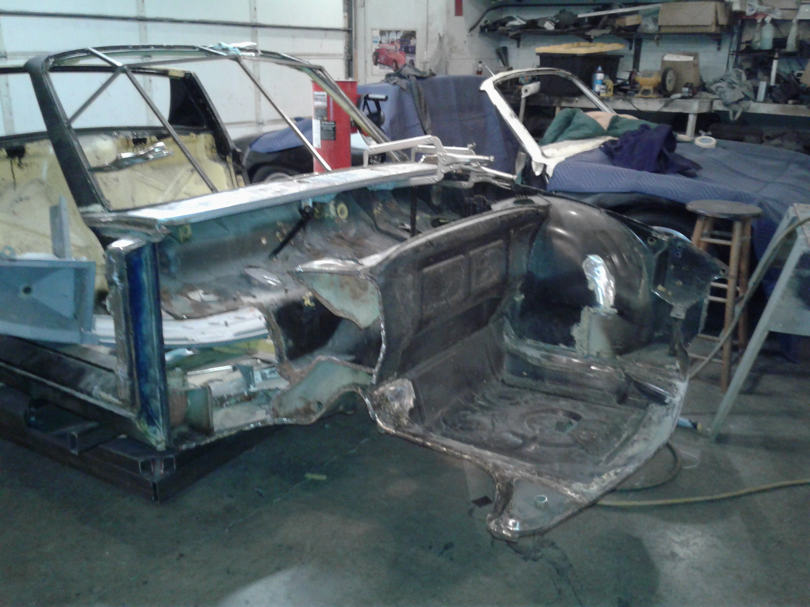

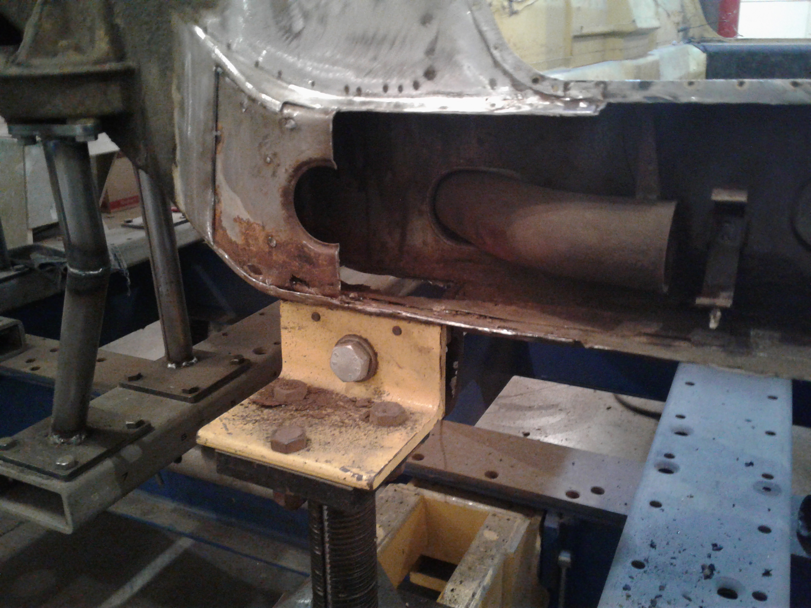

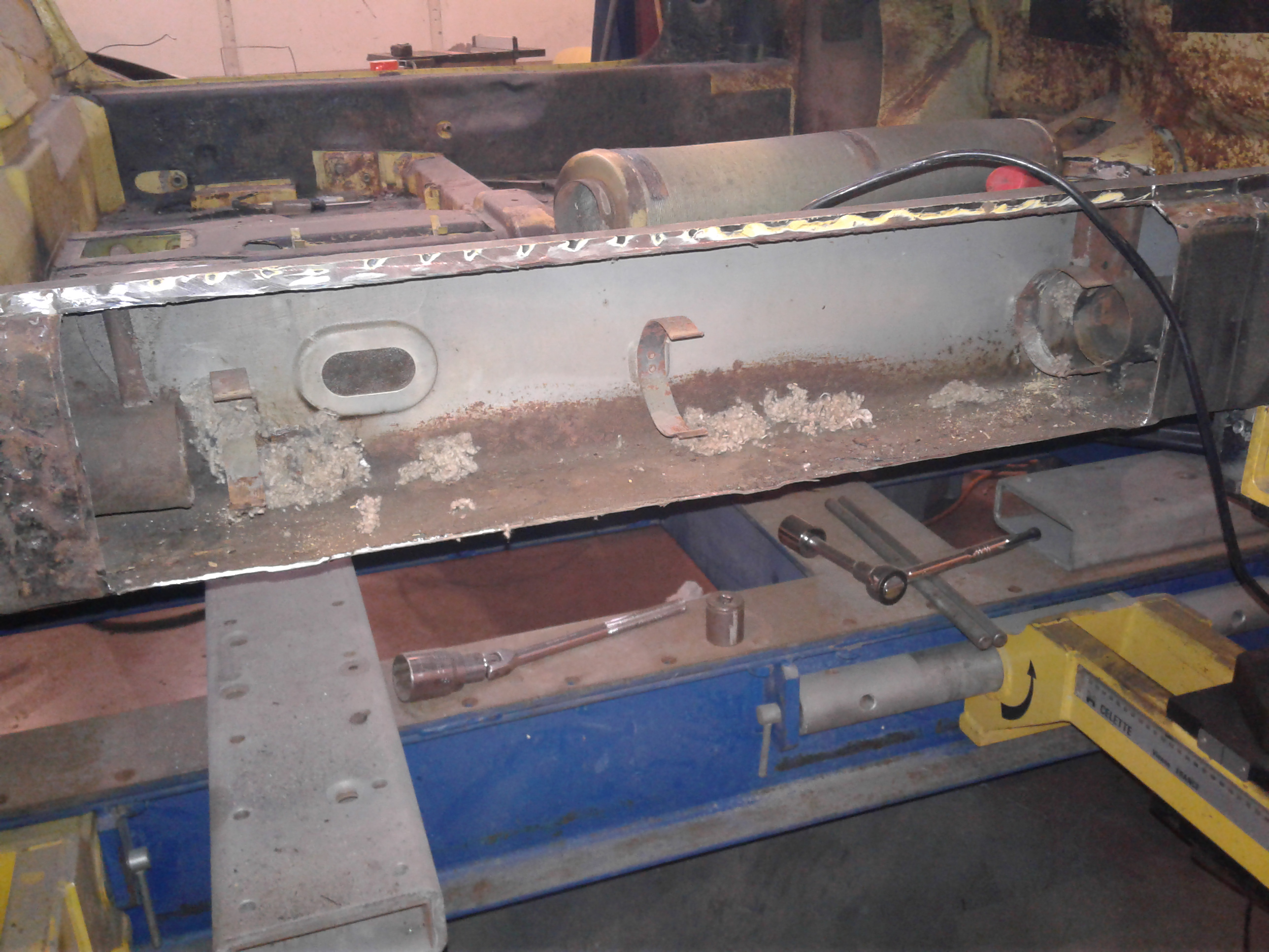

Hard to take it apart this far without fixtures. I owe a special debt of gratitude to McMark who fashioned a set of fixtures using his set as a way of the holding a straight car in his shop while building these for me. Mark is one awesome guy with loads of talent.

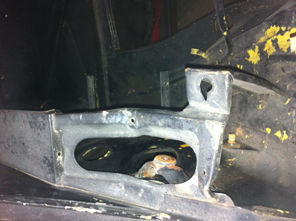

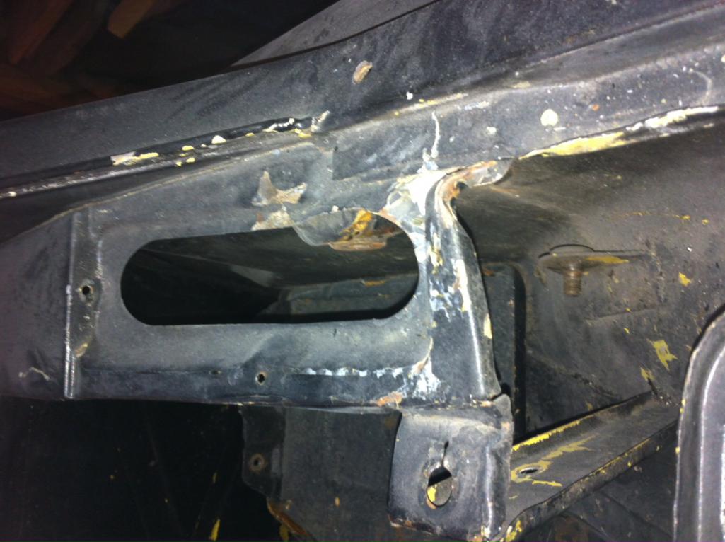

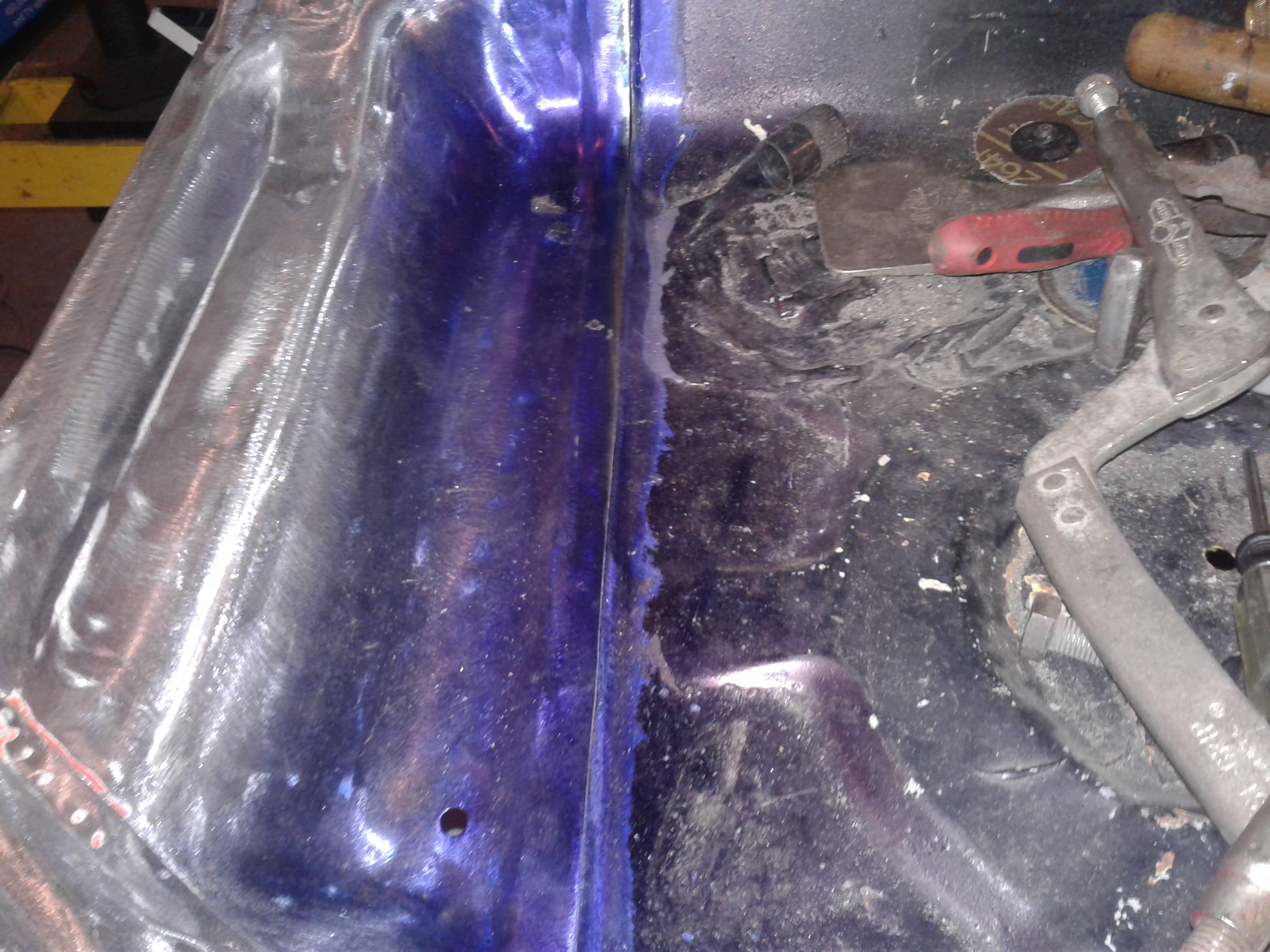

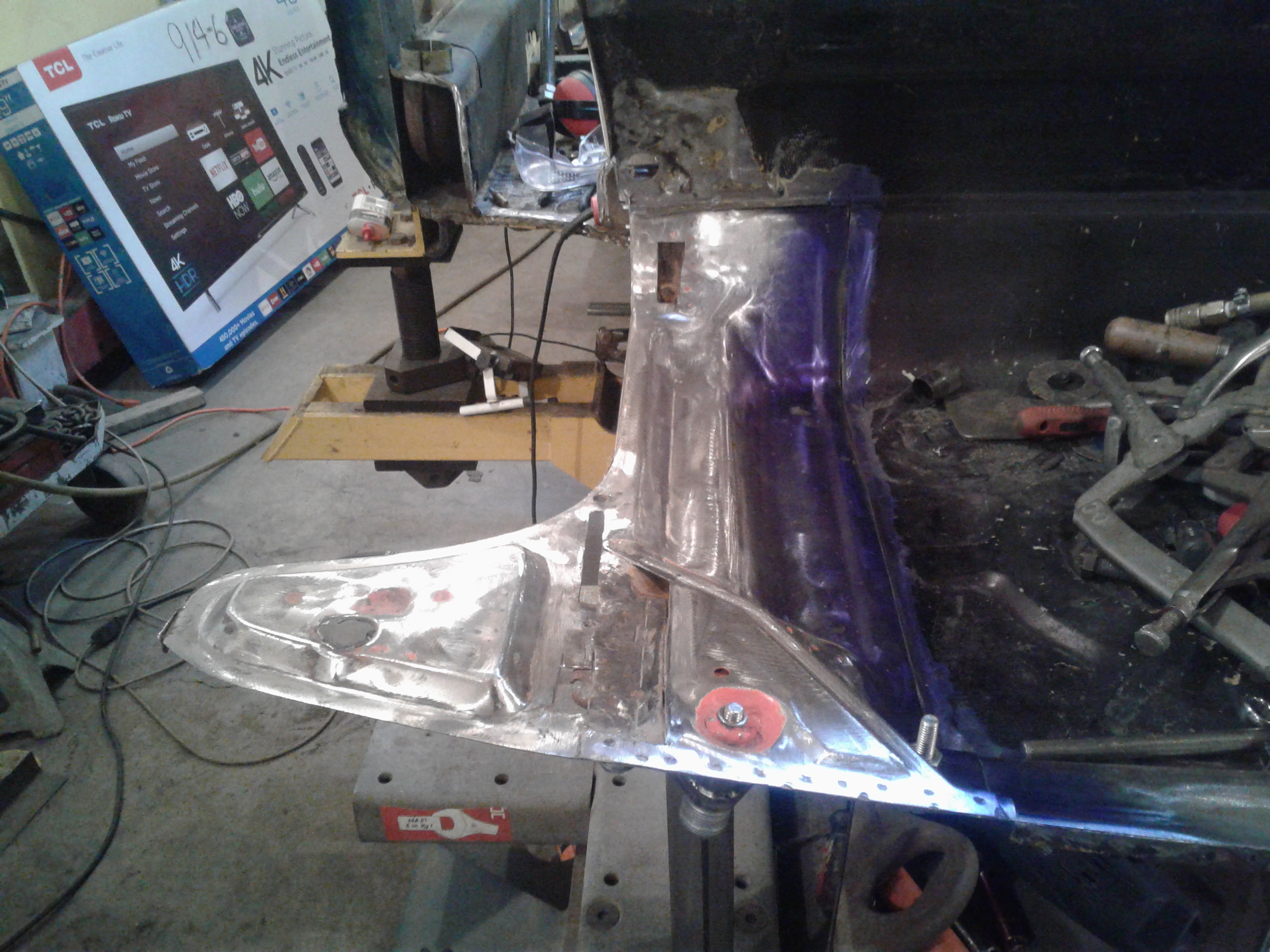

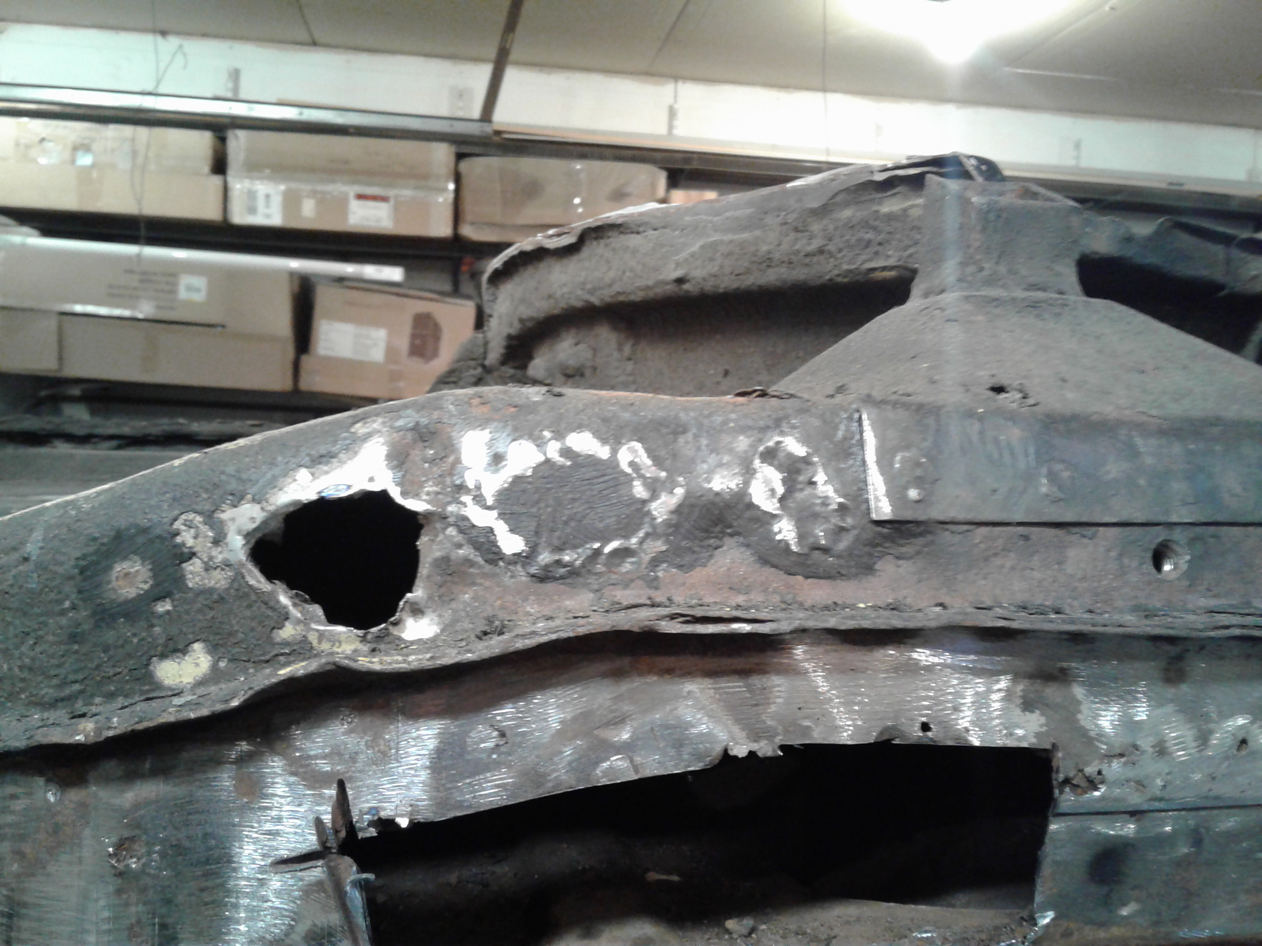

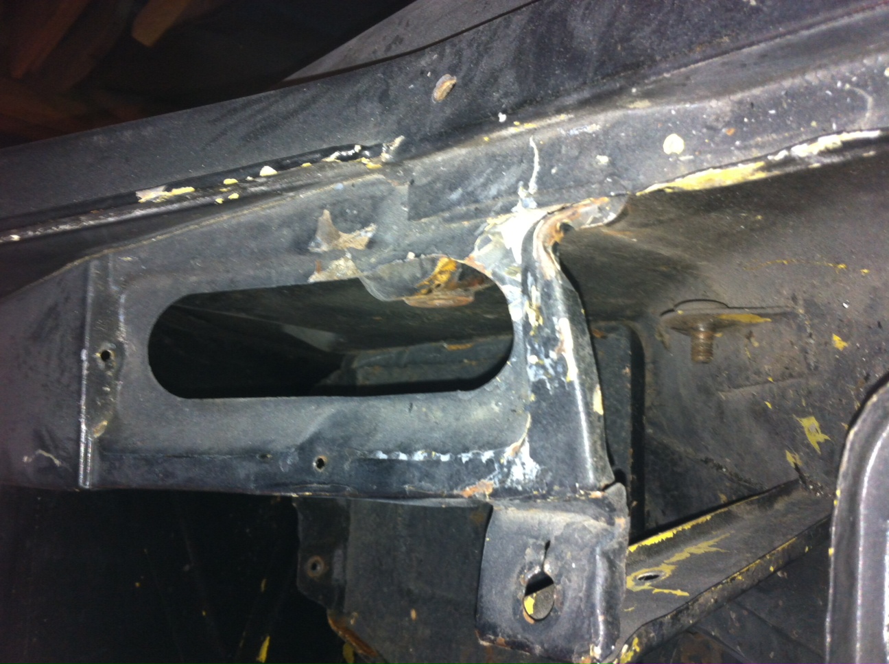

Starting to go back together. This right section was damaged and brazed all along the attachment flange. No other way to get rid of the mess without sectioning in a new part.

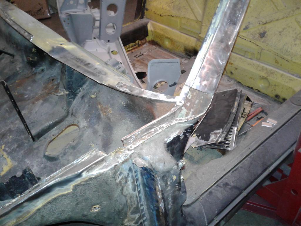

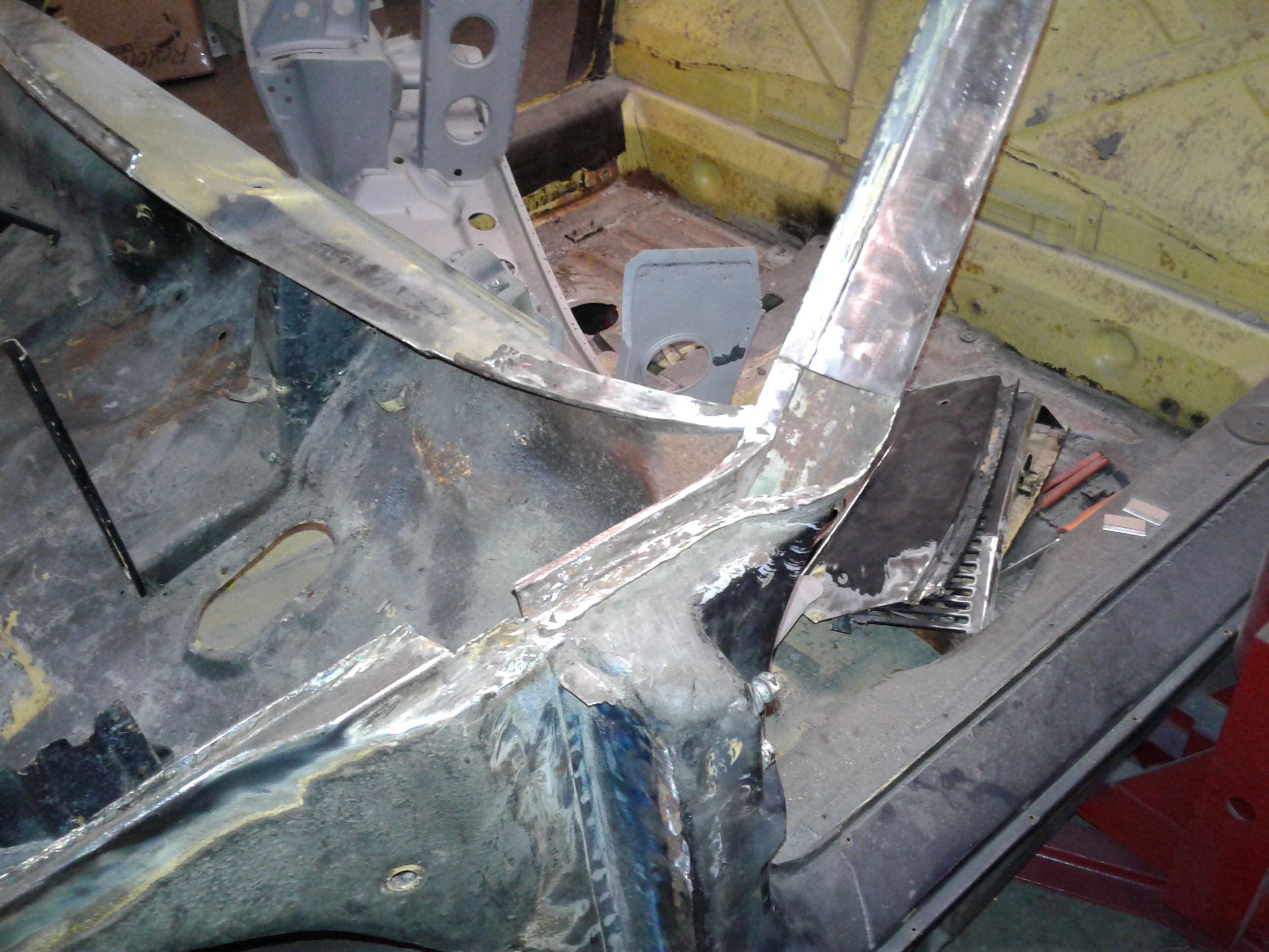

Sectioned Tig welded and metal finished

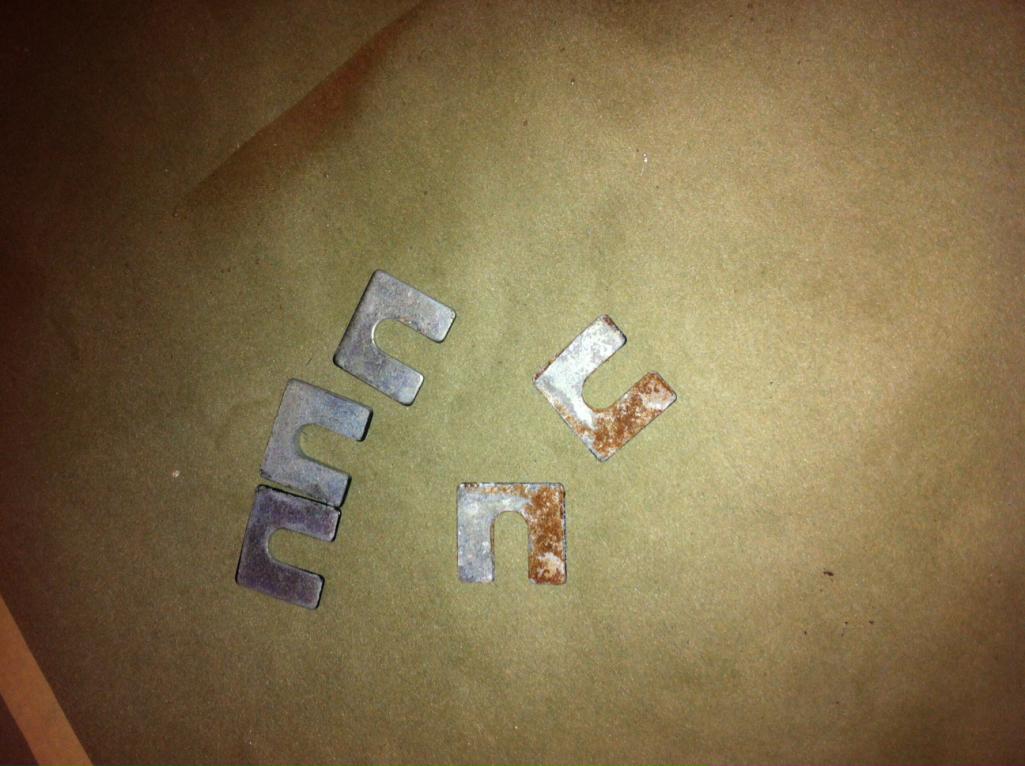

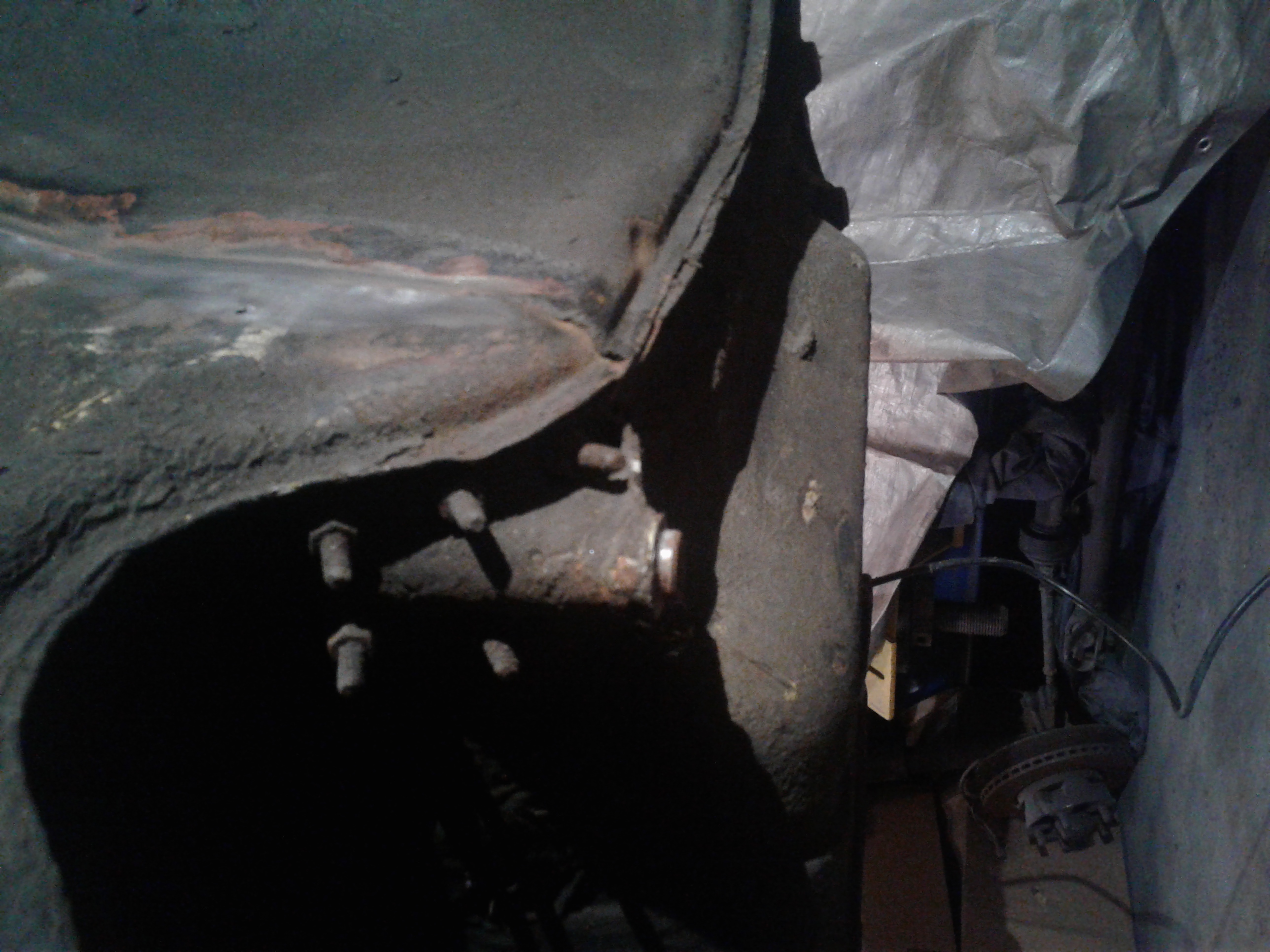

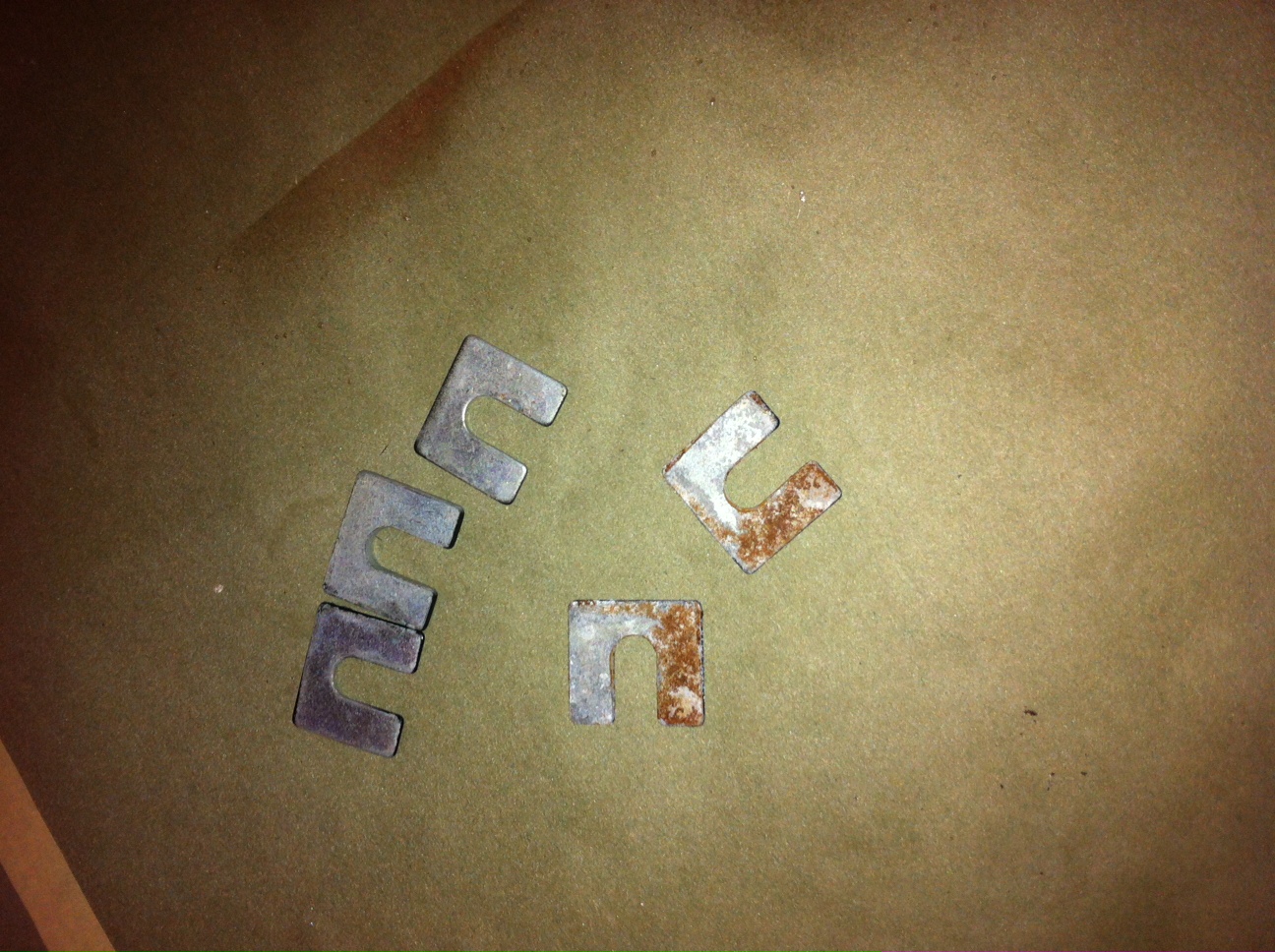

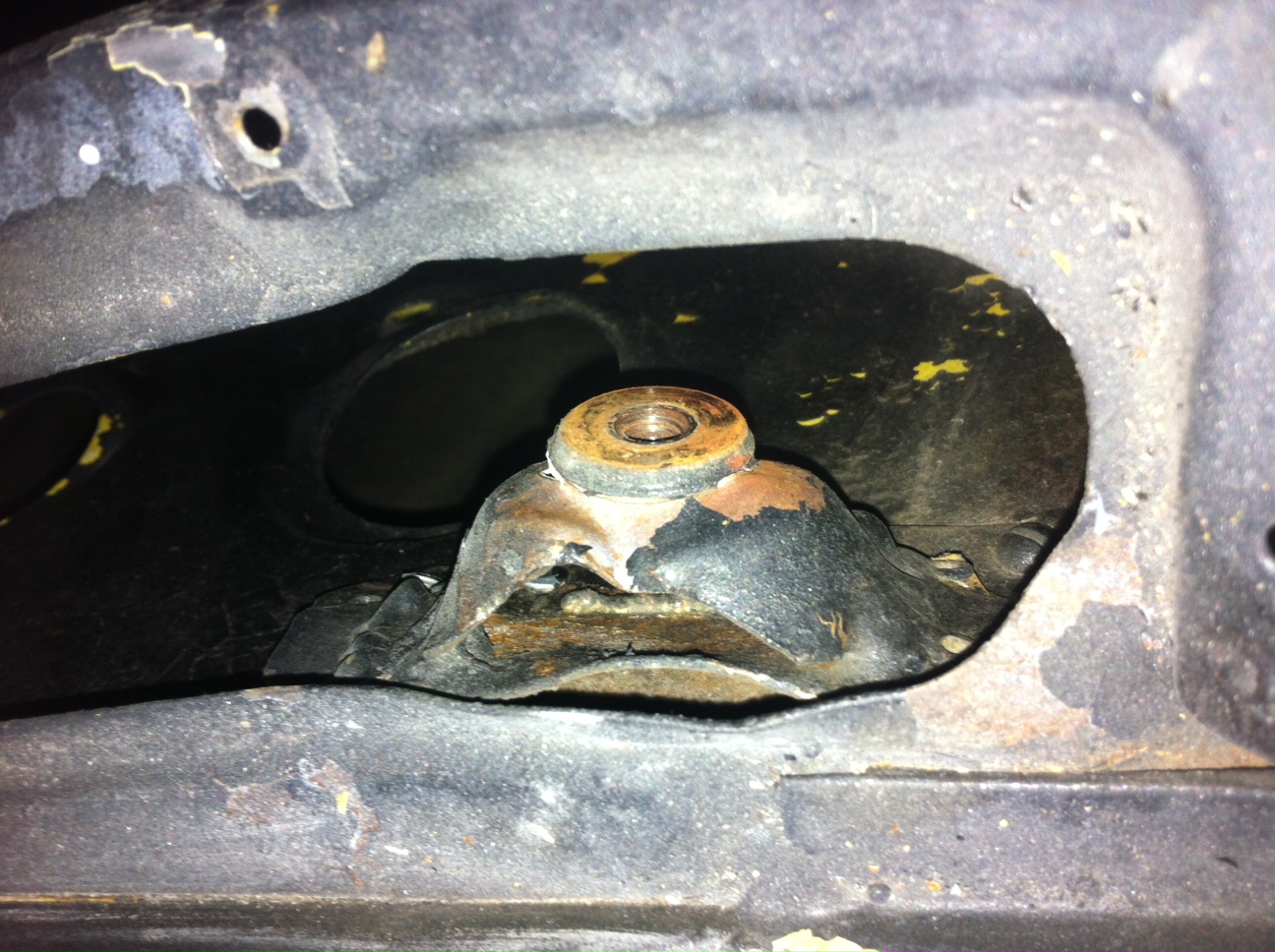

The Crew did their best with what they had. Hard to locate the correct length bolts in space. (IMG:style_emoticons/default/ricola.gif)
