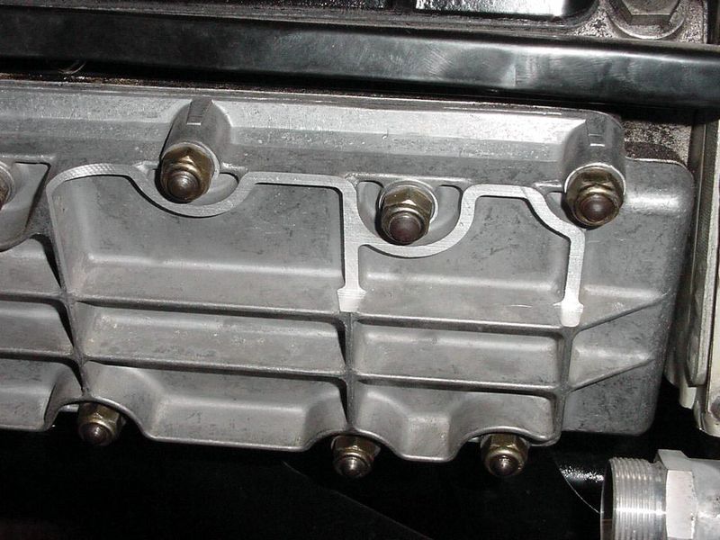

QUOTE(troth @ Jul 21 2024, 09:05 AM) *
This is a pretty typical issue from what I've heard. I think you can get away with milling down just one corner of the covers. See this post:
http://www.914world.com/bbs2/index.php?sho...p=2239420&#
(IMG:http://www.914world.com/bbs2/uploads/post-15674-1442626025.jpg)
(Not my picture)
Thanks for the suggestion. My covers have been milled. The interference I have is between the valve cover stud, the inside mate surface of the valve cover and the top of the heat exchanger.

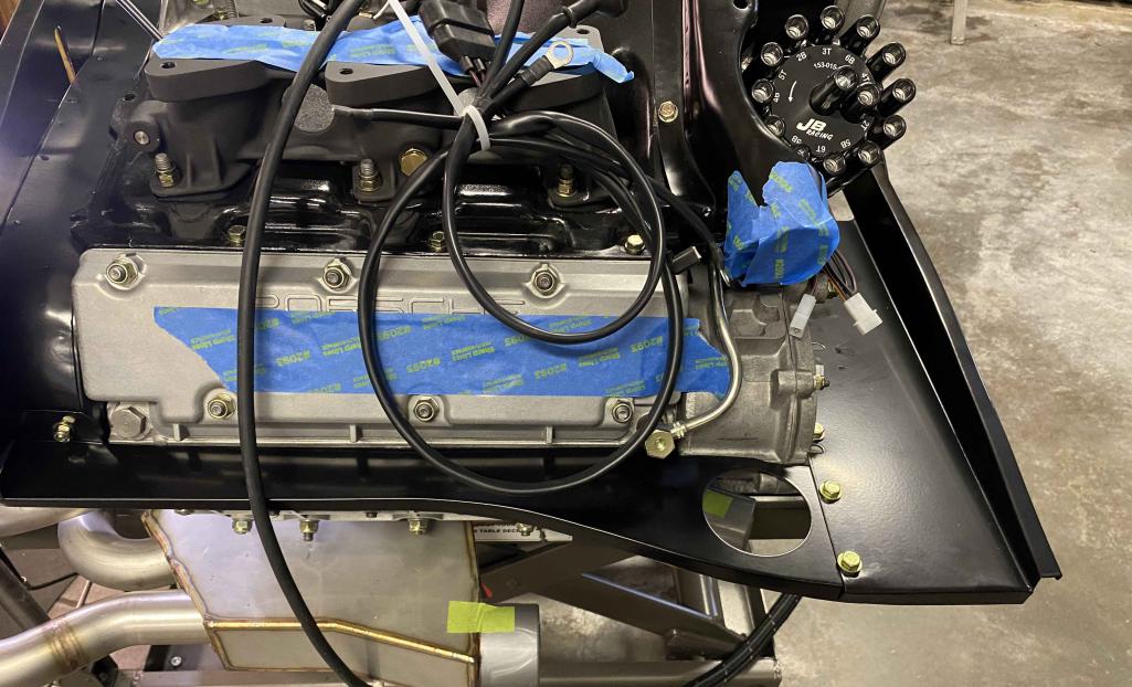

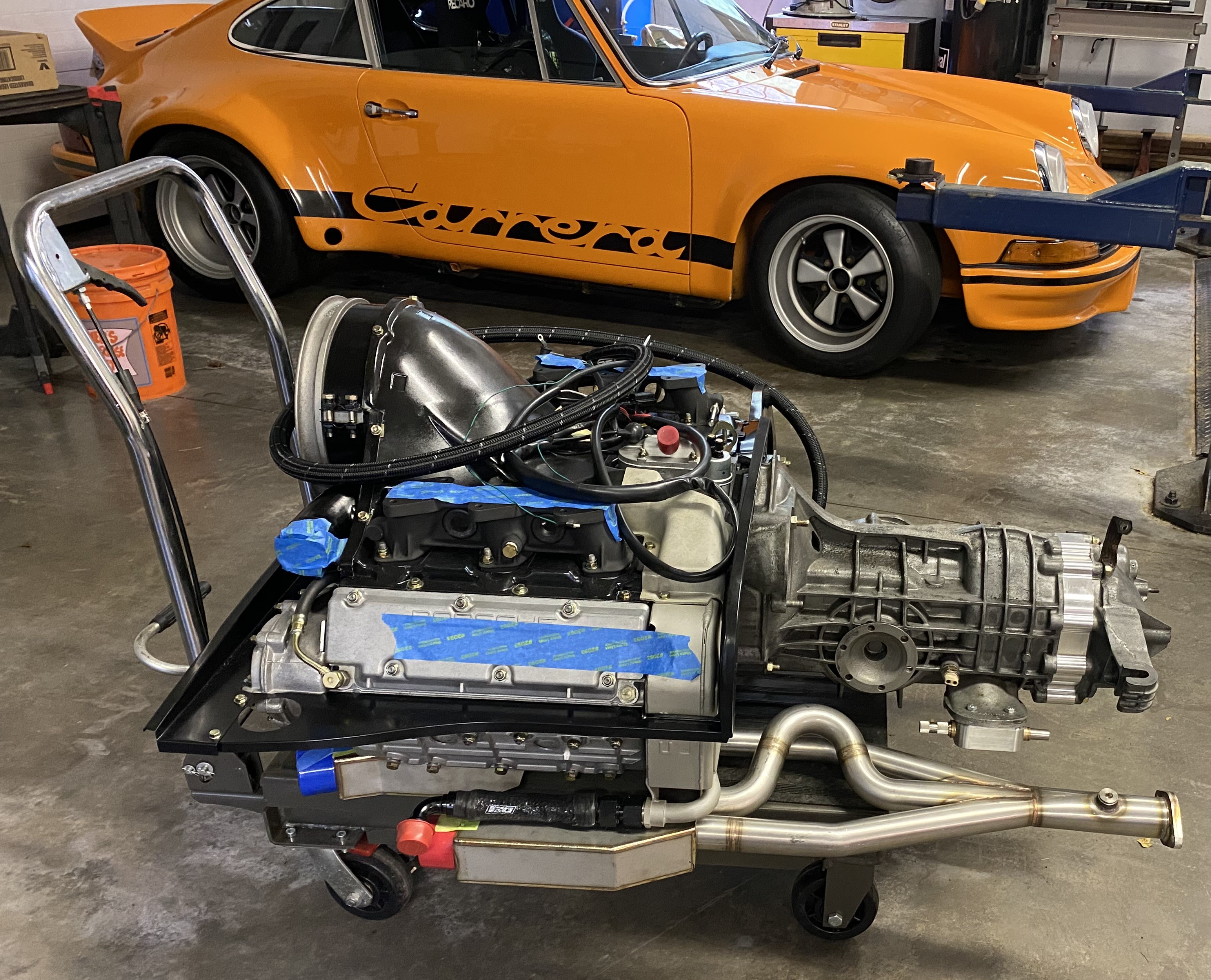

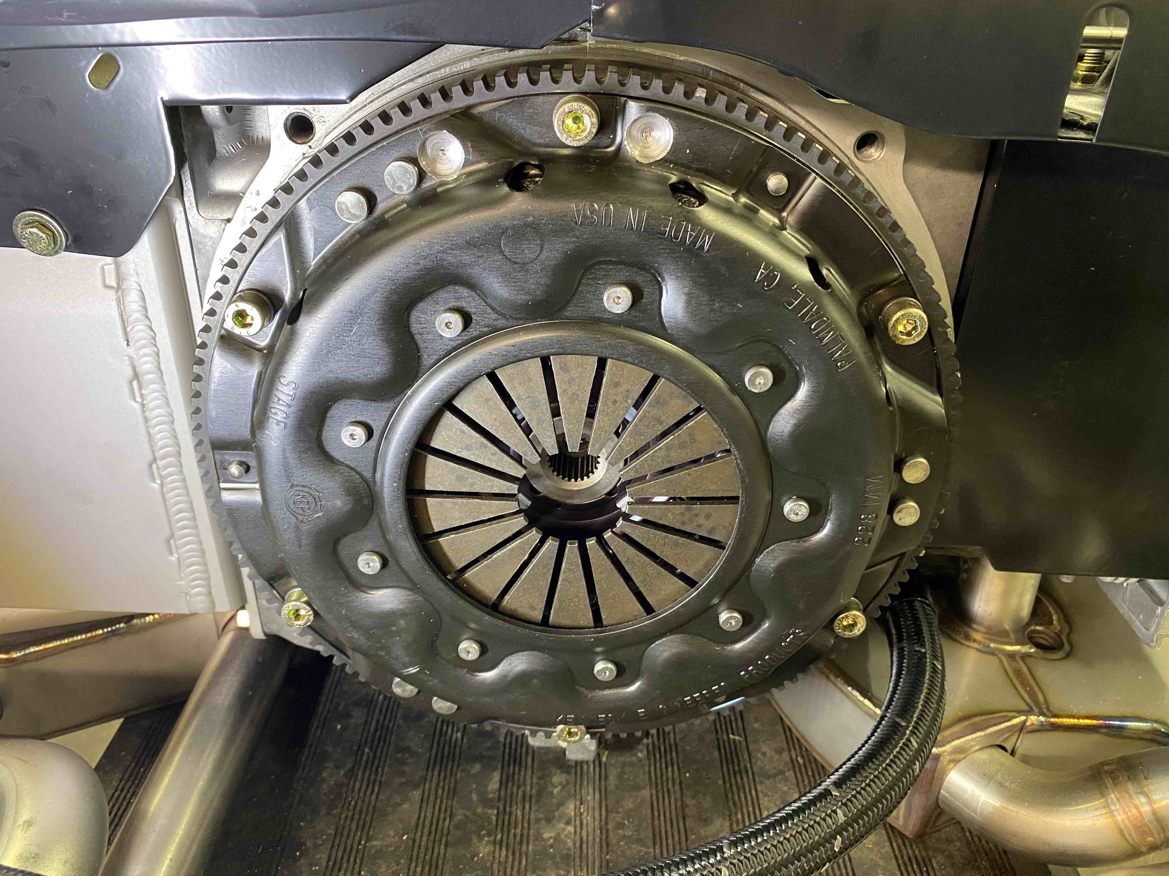

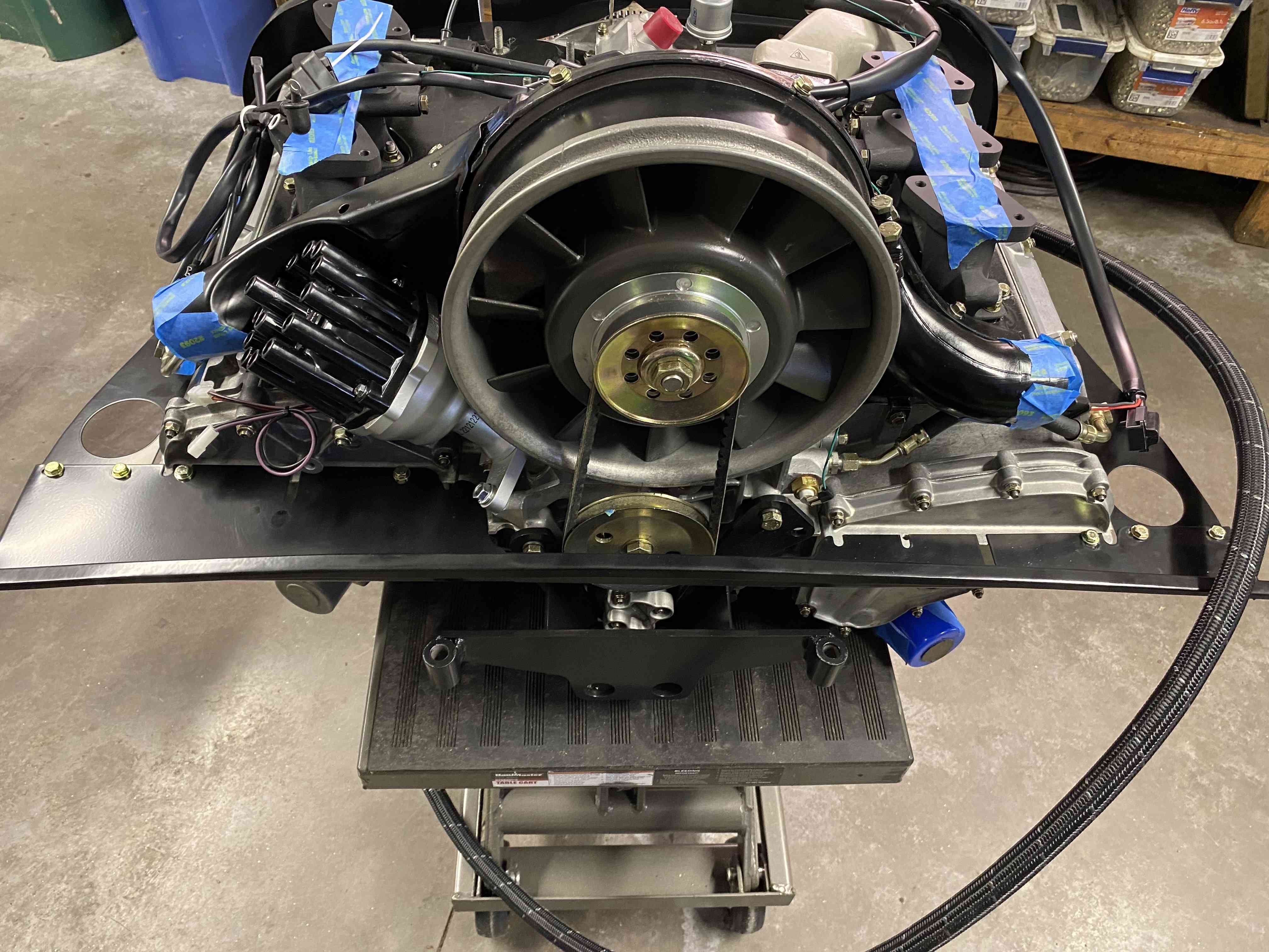

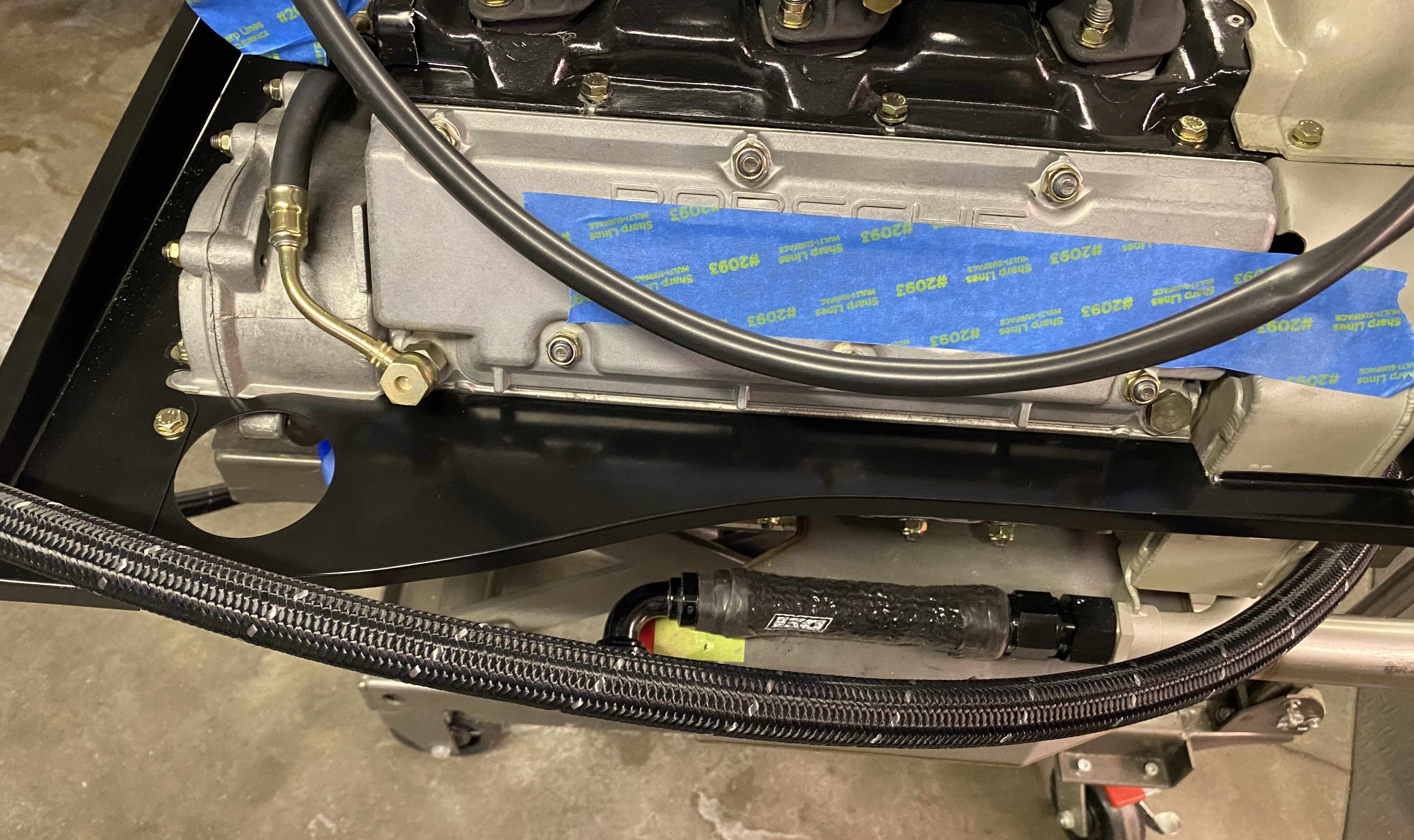

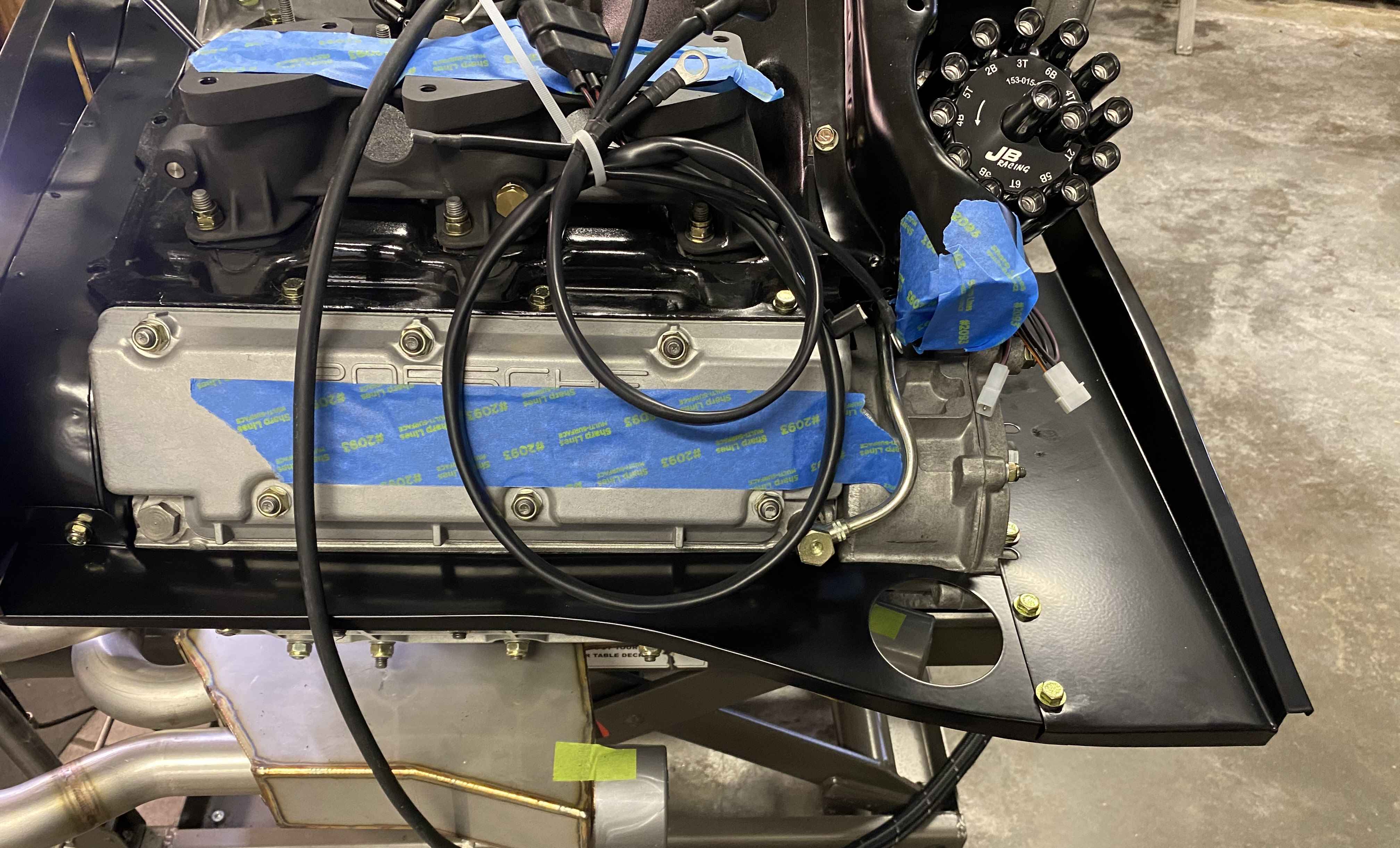

A bit more progress. I did a preliminary fit of the engine sheet metal. It took a little fiddling with some enlarging of the mount holes and some tin snip work but it seems to fit well. I'll still have to drill some through holes for the lower plug wires.

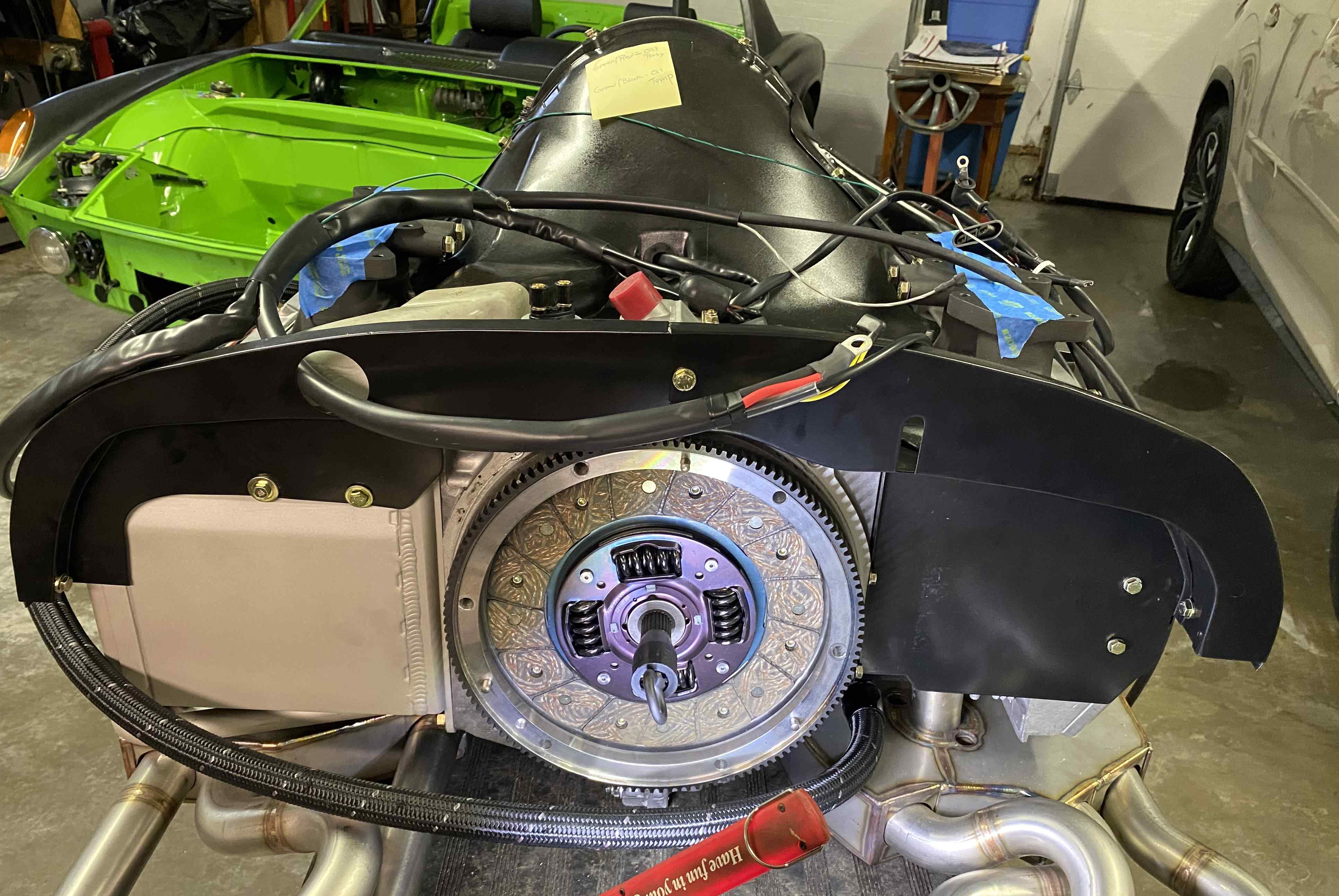

I also installed the Kennedy Engineering Phase II clutch kit that allows me to use the 3.0 flywheel with the 901 gearbox. All seemed to go smoothly.
Attached Image[

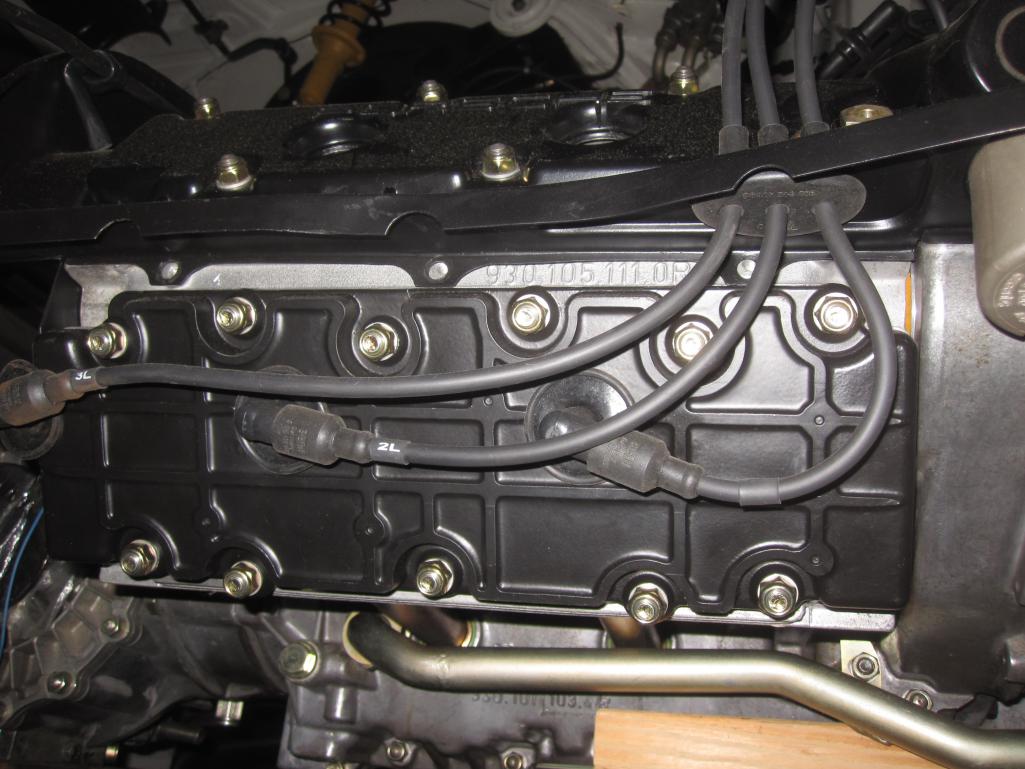

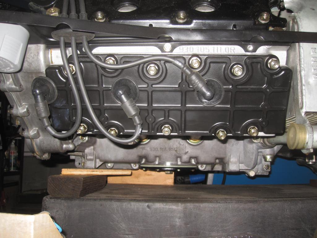

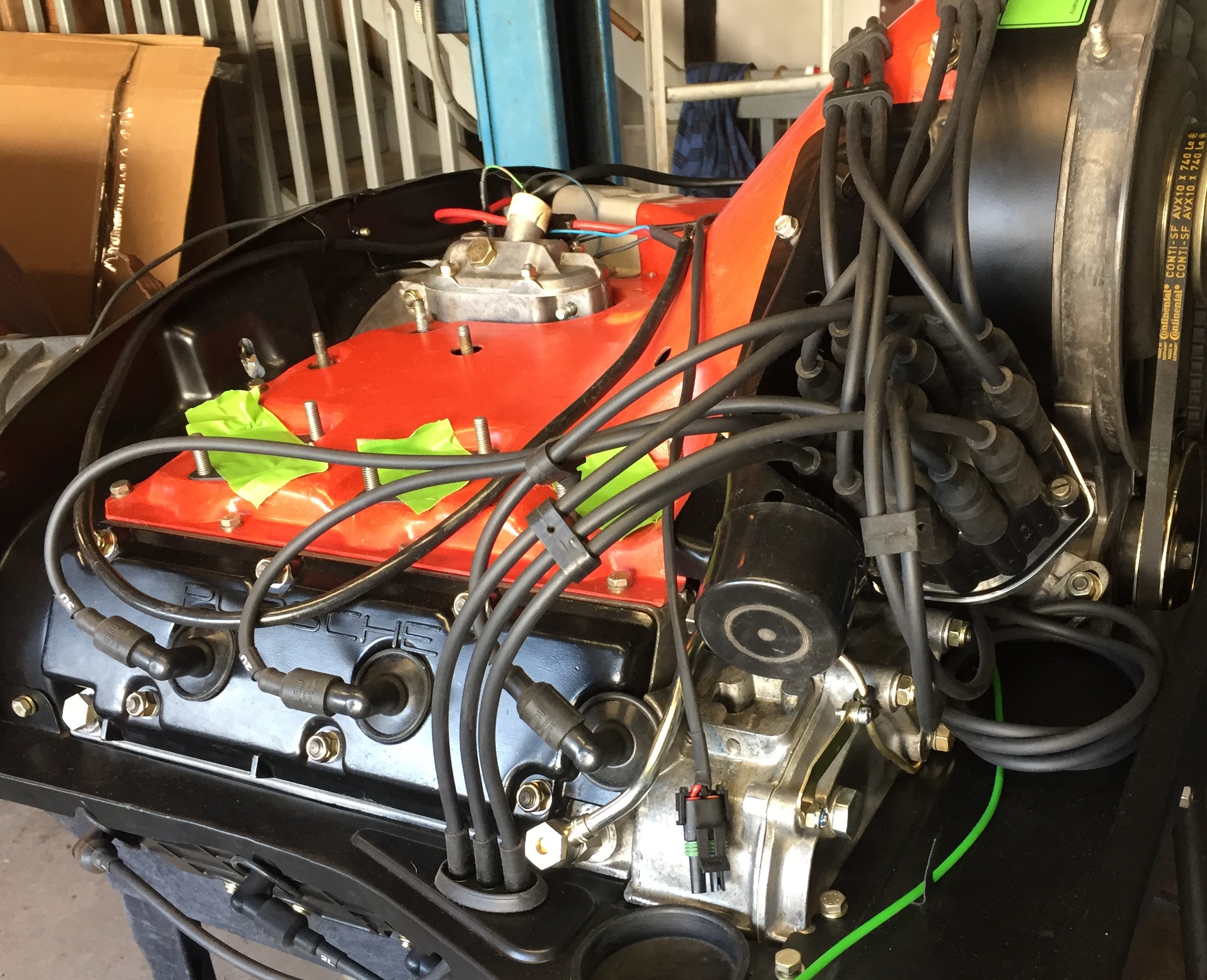

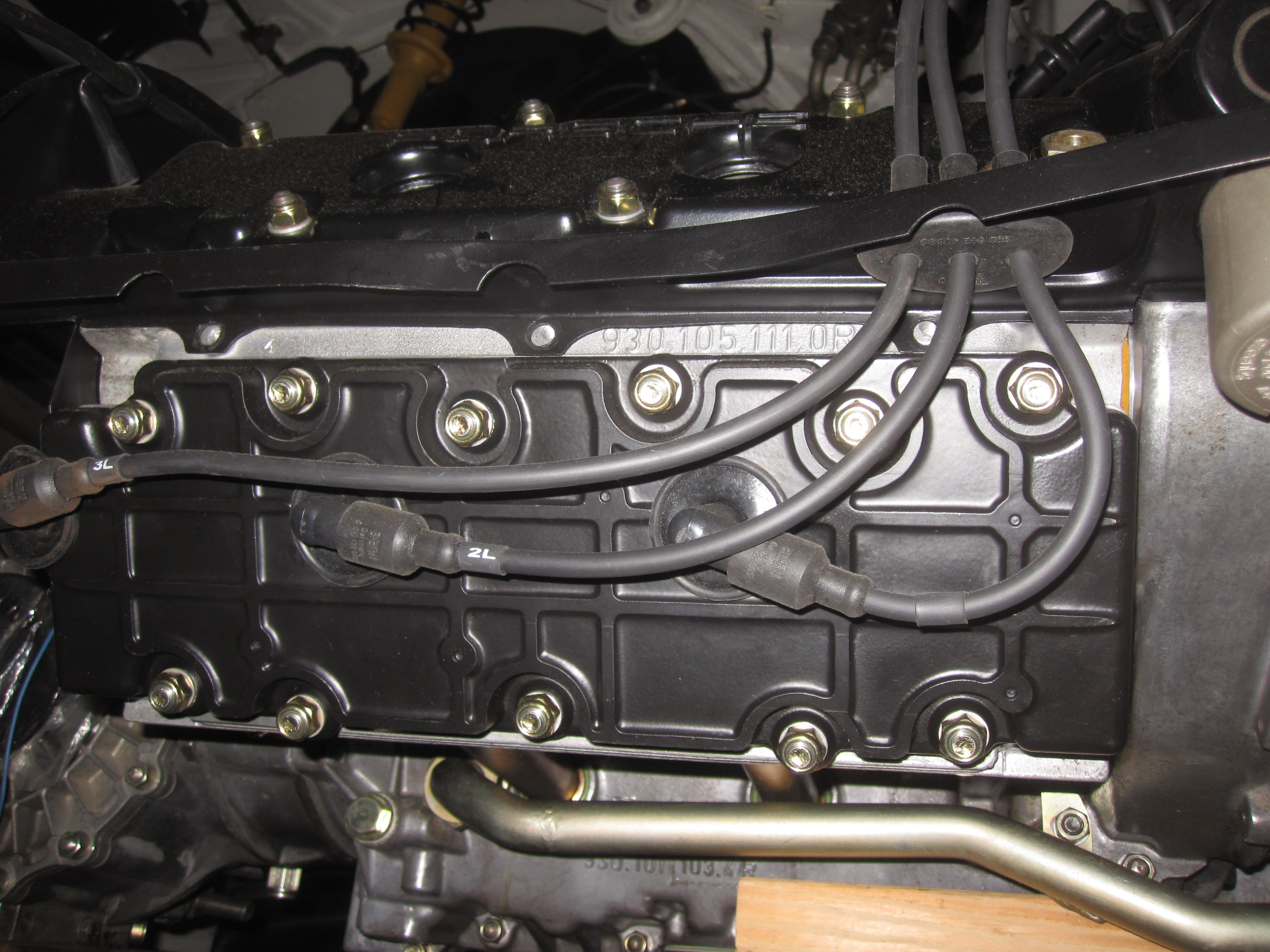

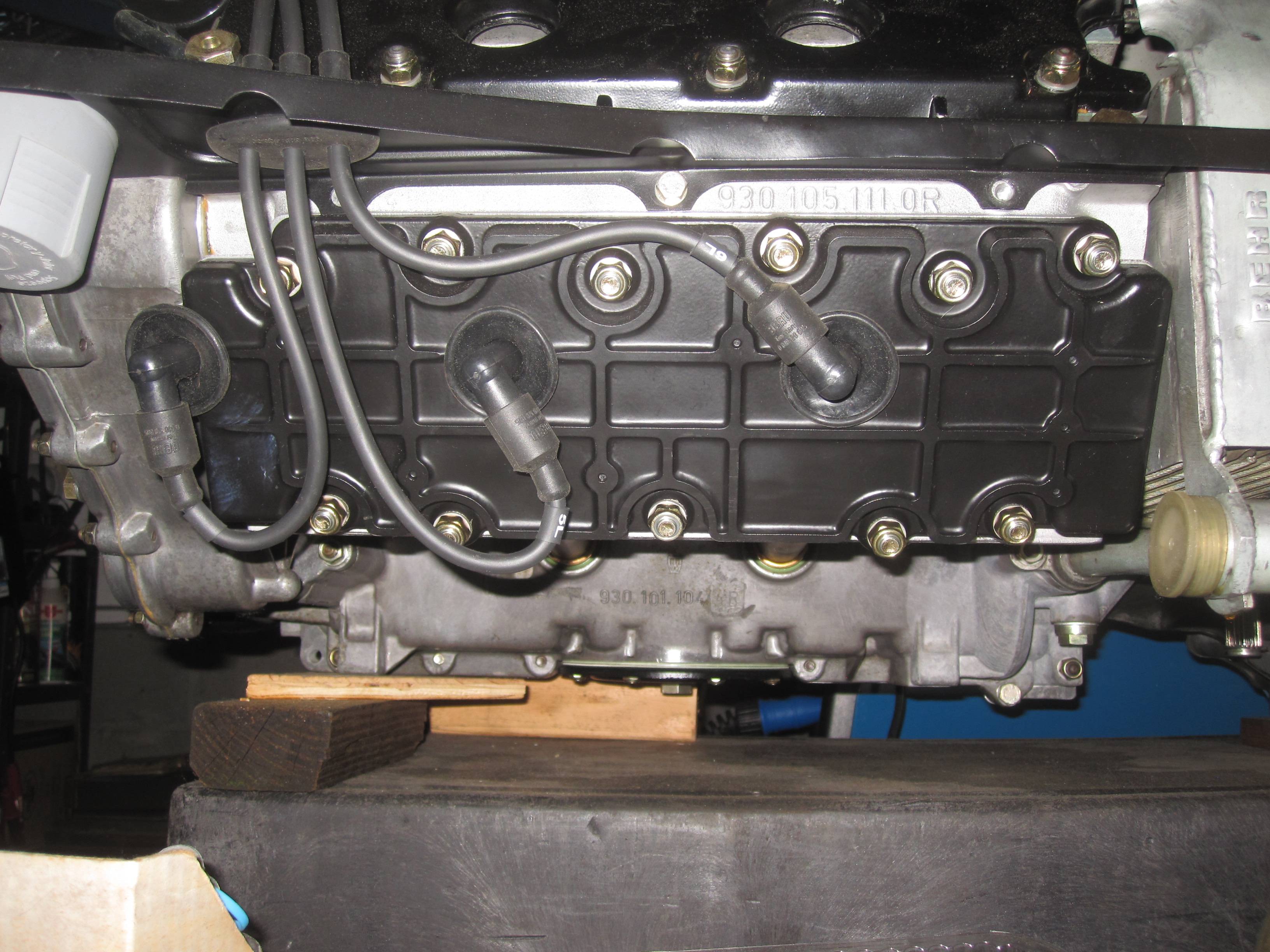

Hey Tom
Your project is coming along beautifully.
See pics of my lower ignition wire routing.
The grommits are 993 or 996 OEM
I'm away at the moment so can't provide the part #
Also, I used full size lower spark plugs and found the only plug wrench that would
work was the one included in '69-'73 OEM tool kits.
I also used 12 point cyl. head nuts for additional clearance.
The lower valve covers are milleded 996 items with the rubber perimeter seals.
TJB/914

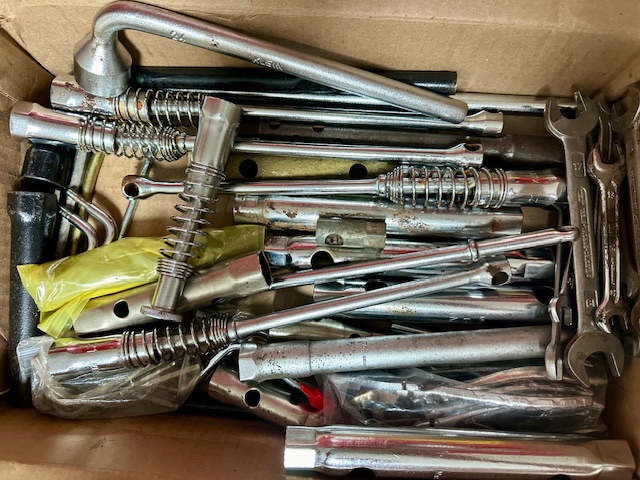

If you need any of these 911 spark plug wrenches, free if needed.
Tom MI

Tom that is badass. Wish I had some of those. They are not convenient then standard setups

Tom the pics were taken before I spent time to fully adjust the wire lengths,
especially over the top of the fiberglass.
Be carefull on the 4-5-6 side... leave enough length below the tin to remove plug
connectors

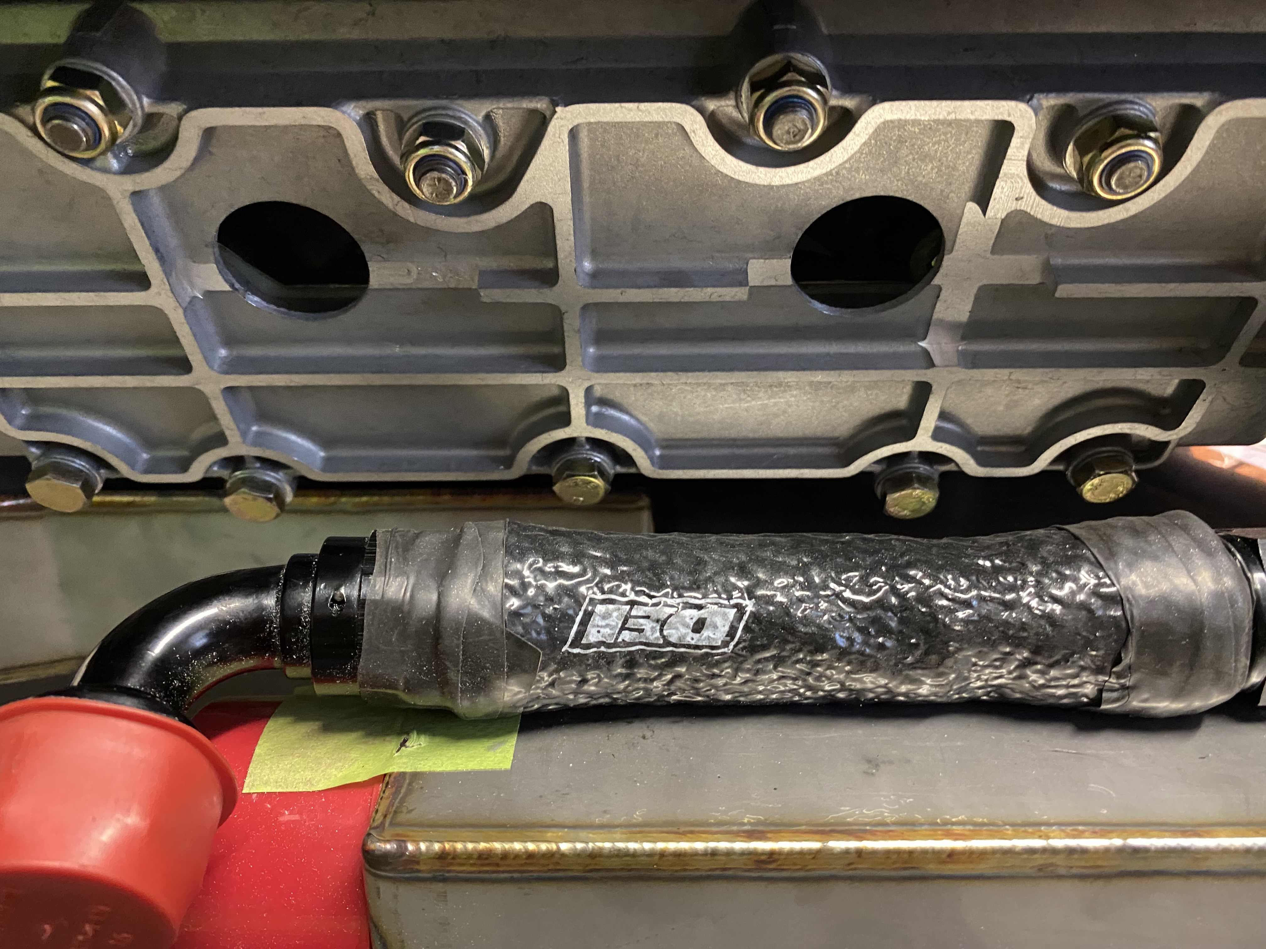

I replaced to lower studs on the lower valve covers with hex bolts. I kept the top studs as they make it easier to hang the valve cover and gasket for mounting. No more clearance issue with the heat exchanger or oil hose.

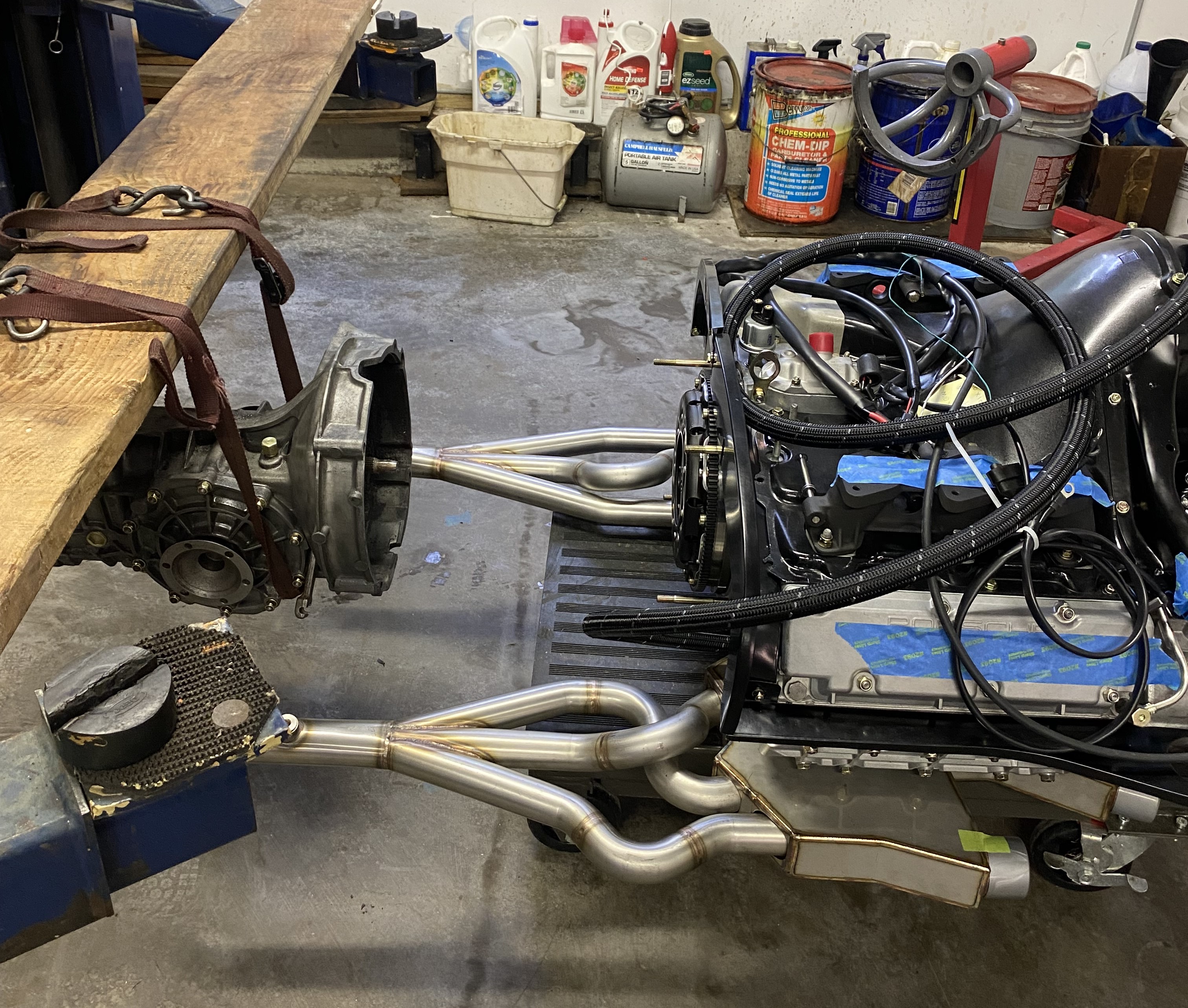

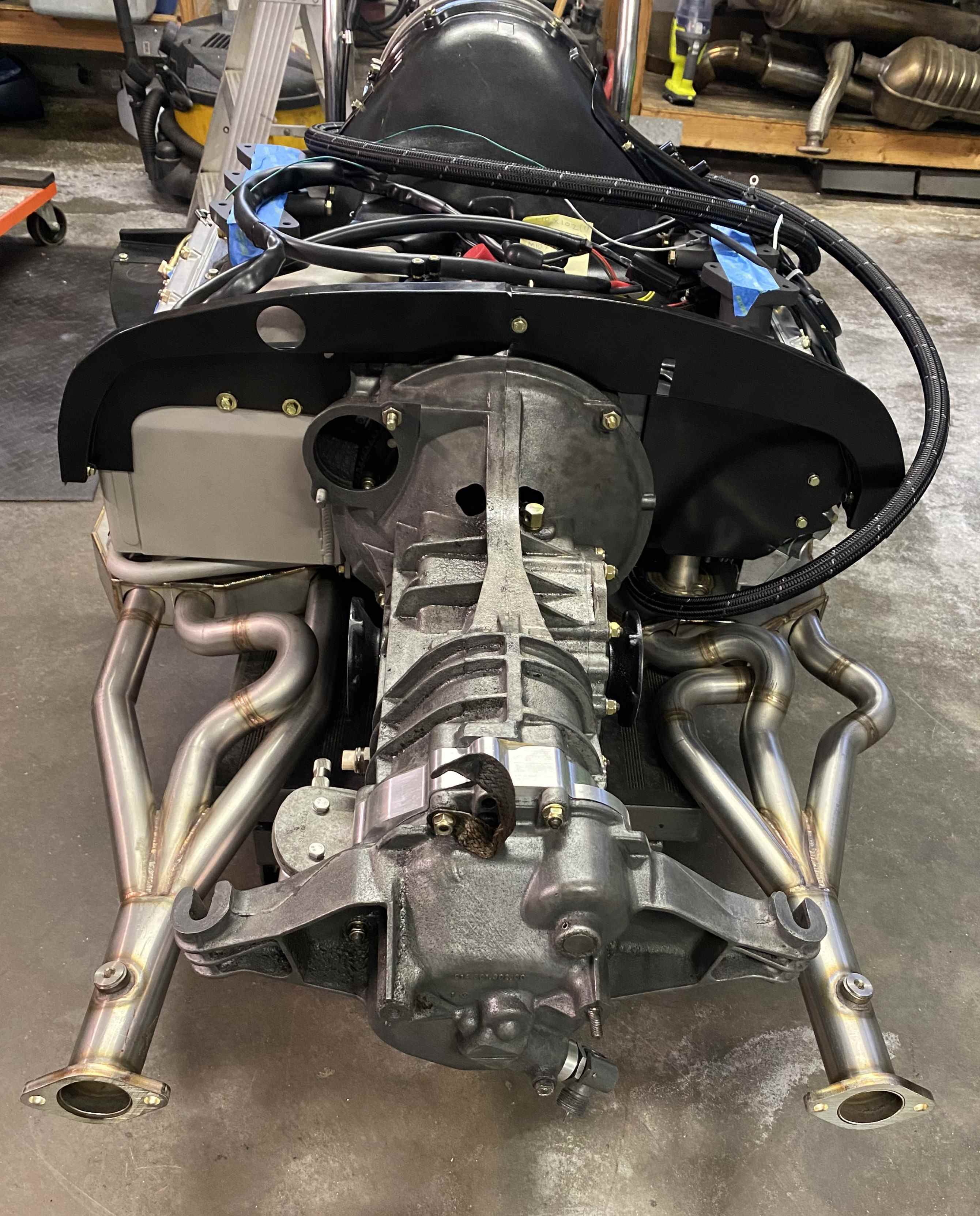

Yesterday I mated the transmission to the engine using my lift to position the transmission to slide easily onto the engine rear studs.
Tom1394racing
post Aug 1 2024, 09:31 AM
Post #399
Posts: 439
Joined: 25-August 07
From: CT
Member No.: 8,039

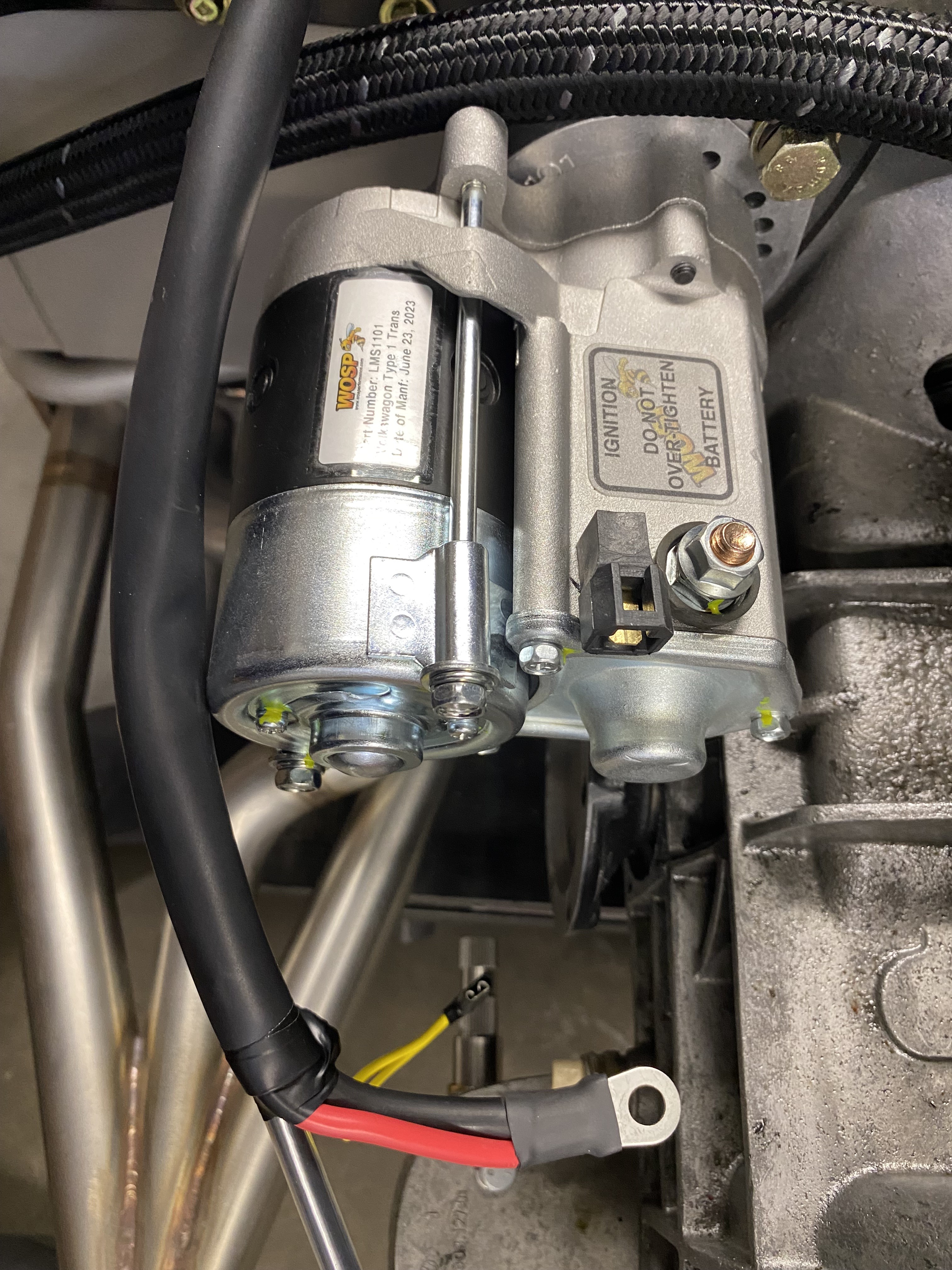

I mounted my new WOSP high torque starter after checking the position of the drive gear relative to the flywheel ring gear. The only way the stater fit was with the electrical connections on the top. Rotating it 180 deg results in interference with the gearbox exterior gusset. I am wondering if there be enough clearance between the top connections and the bottom of the rear trunk floor pan?

@Tom1394racing My high torque started is installed with he terminals on top like you have. It fits and the terminals can be accessed. (IMG:style_emoticons/default/beerchug.gif)
