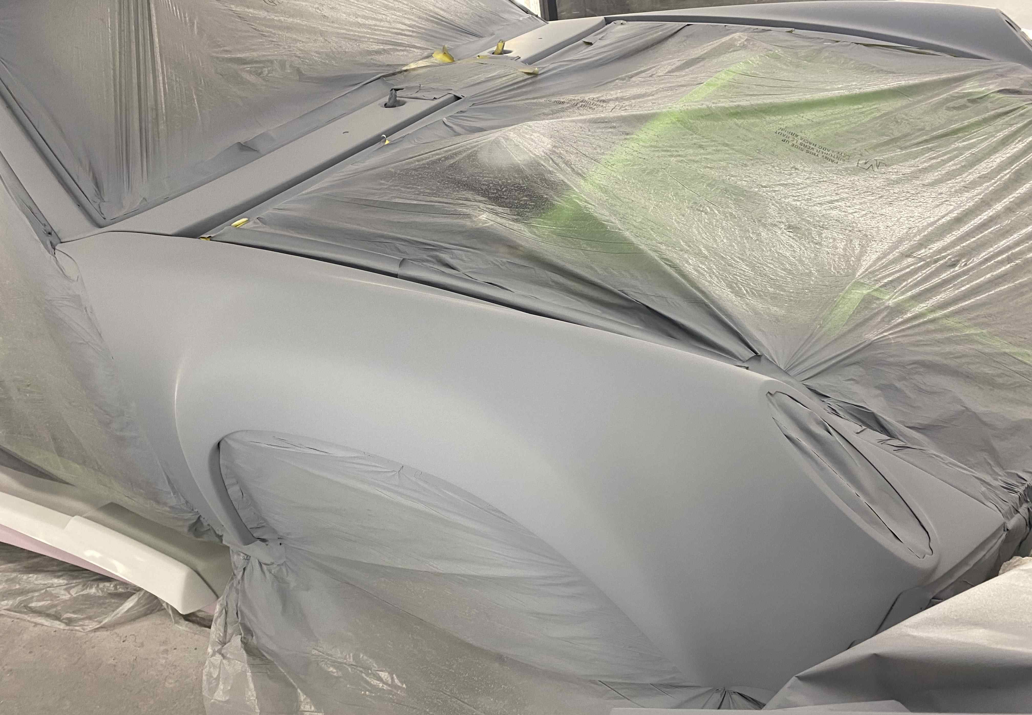

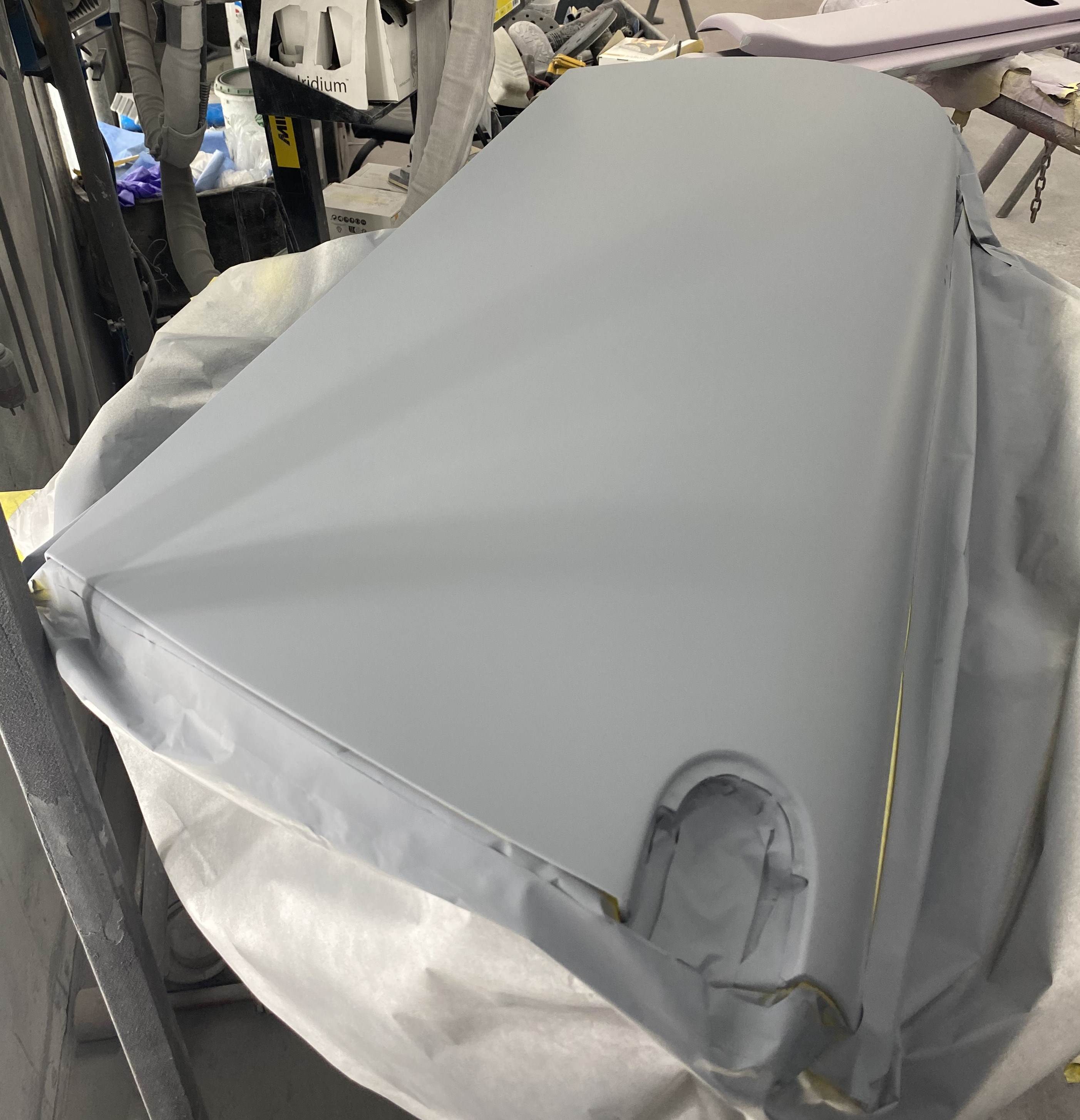

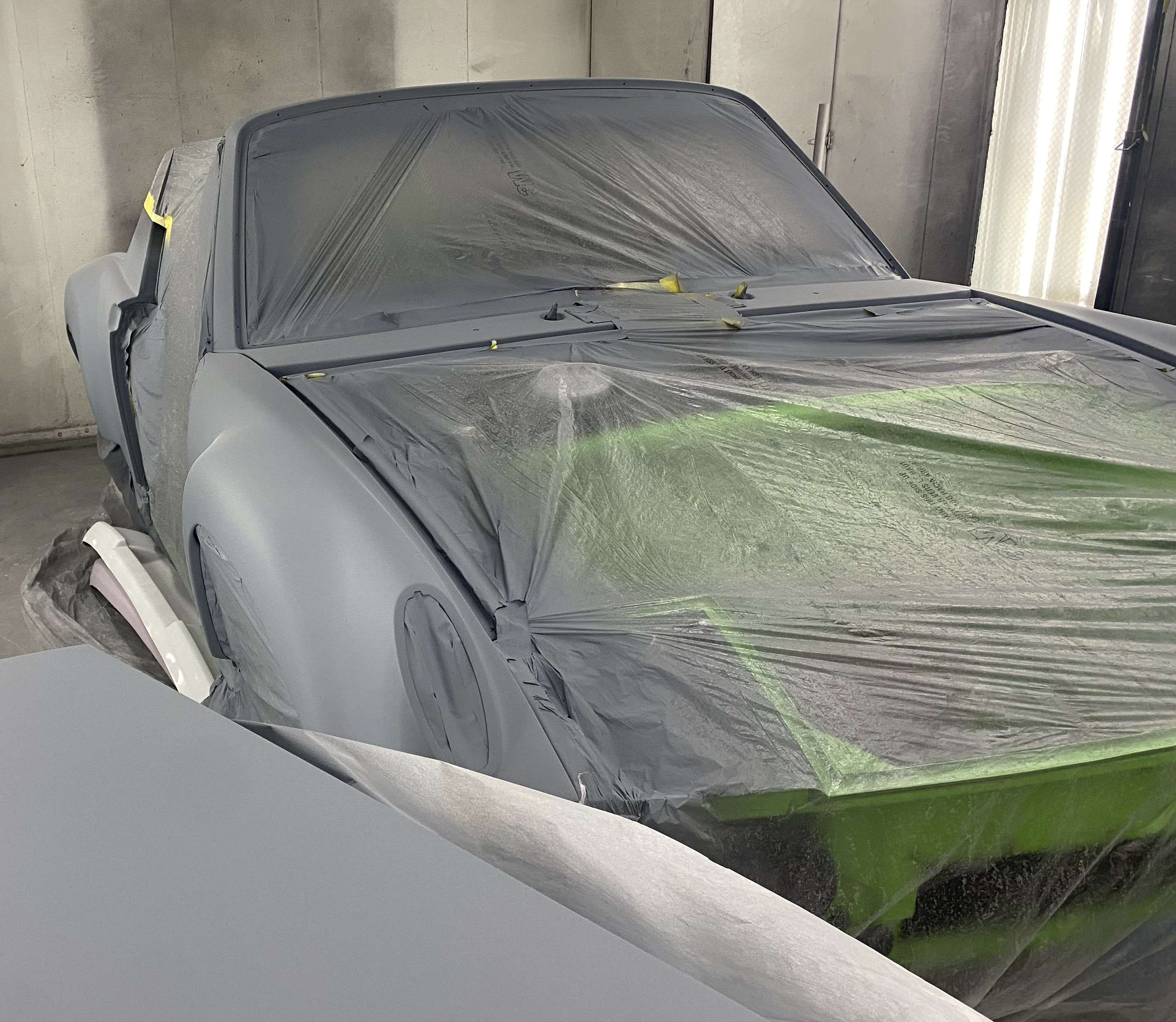

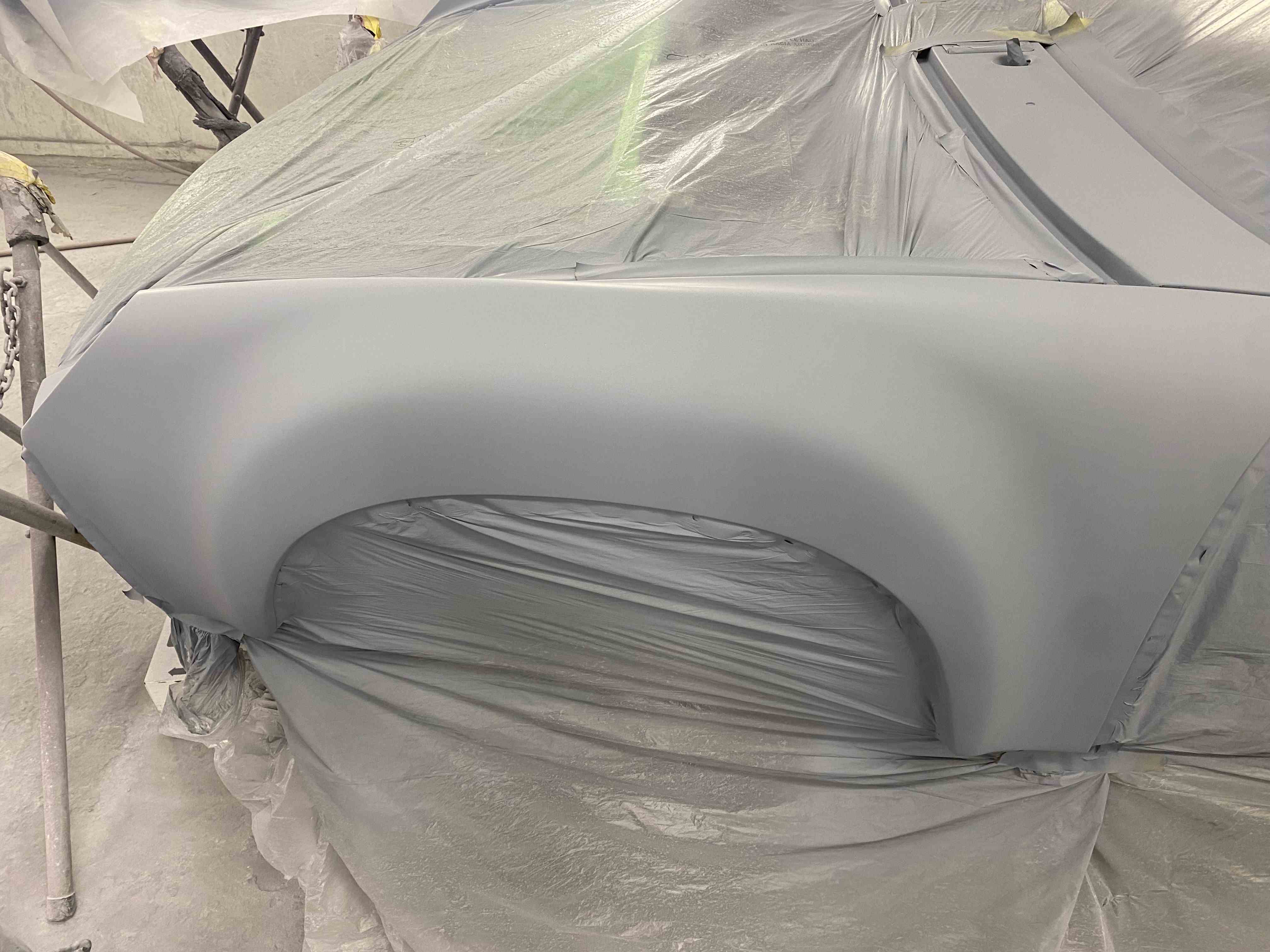

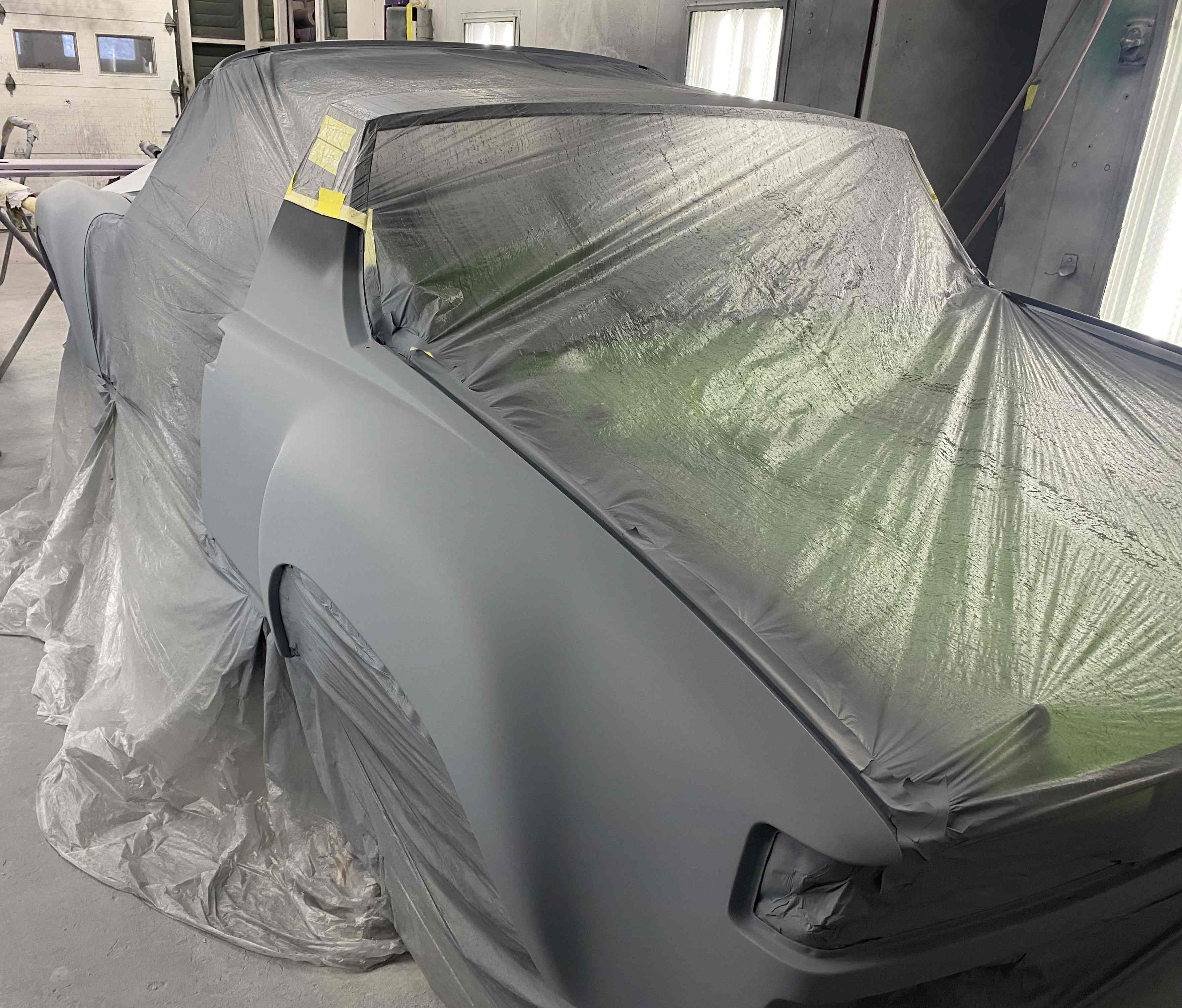

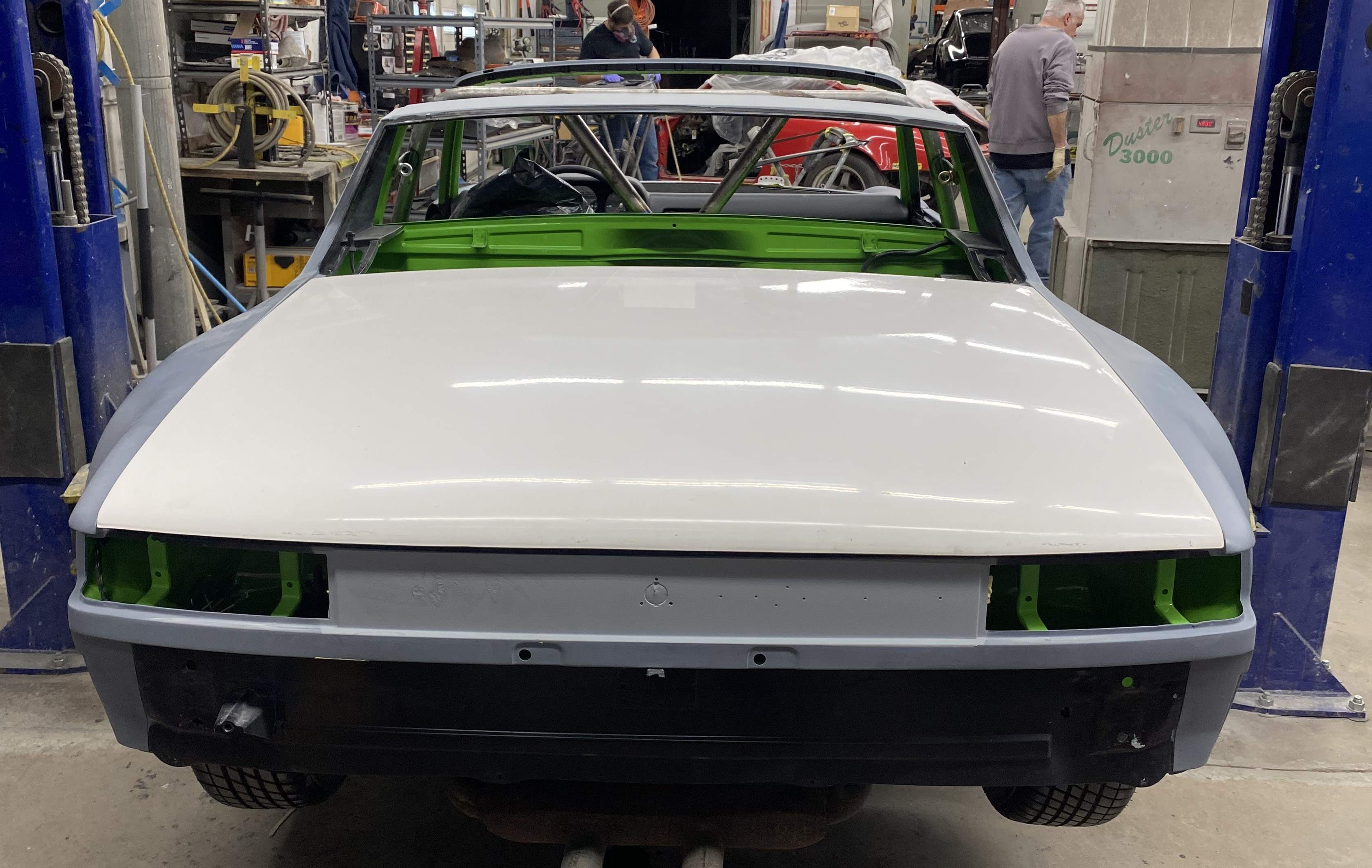

Made my weekly trip to Auto Associates to review progress today. All the body panels have been tweaked & fitted and the body is now in primer. Looks really good.

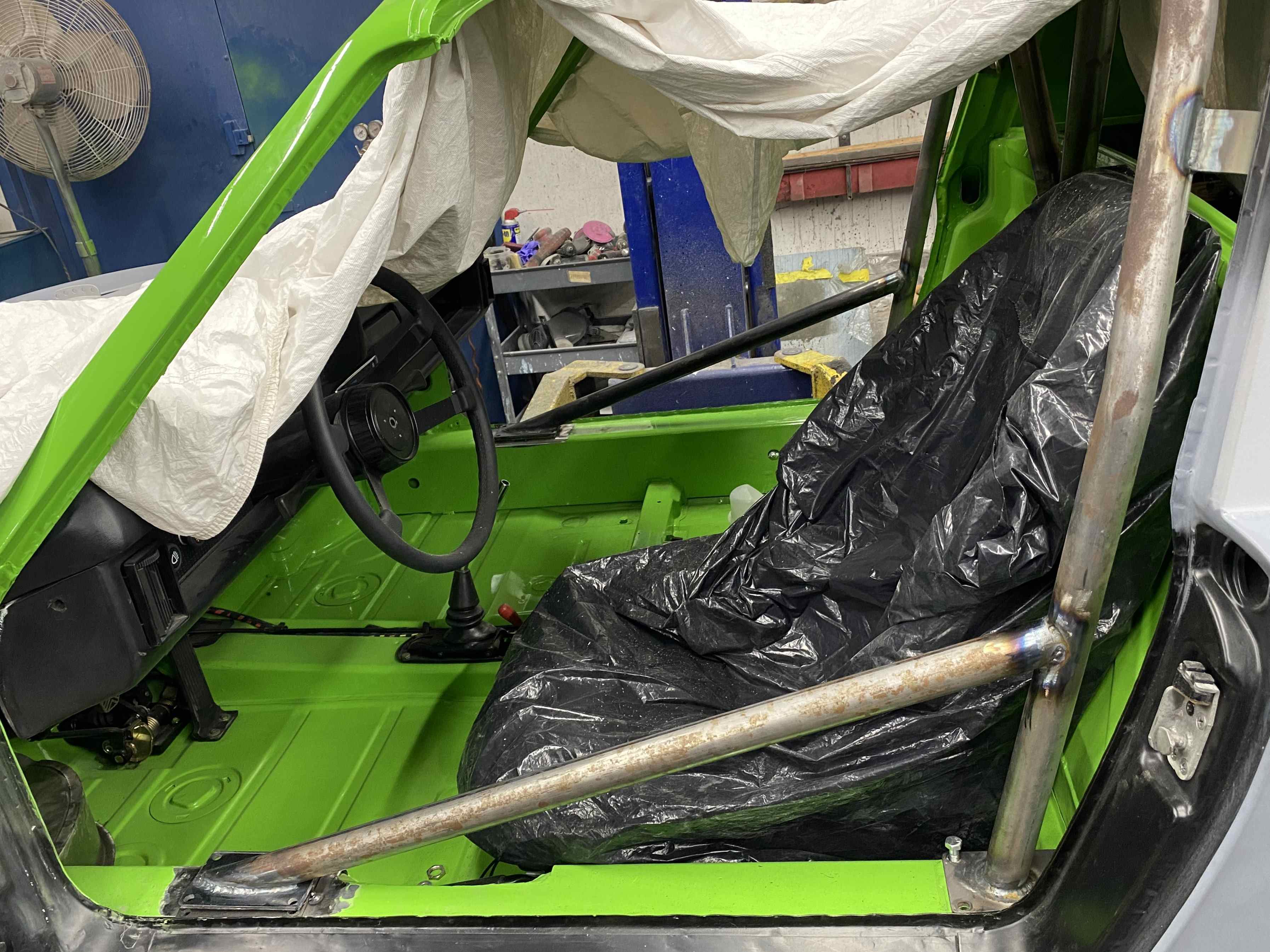

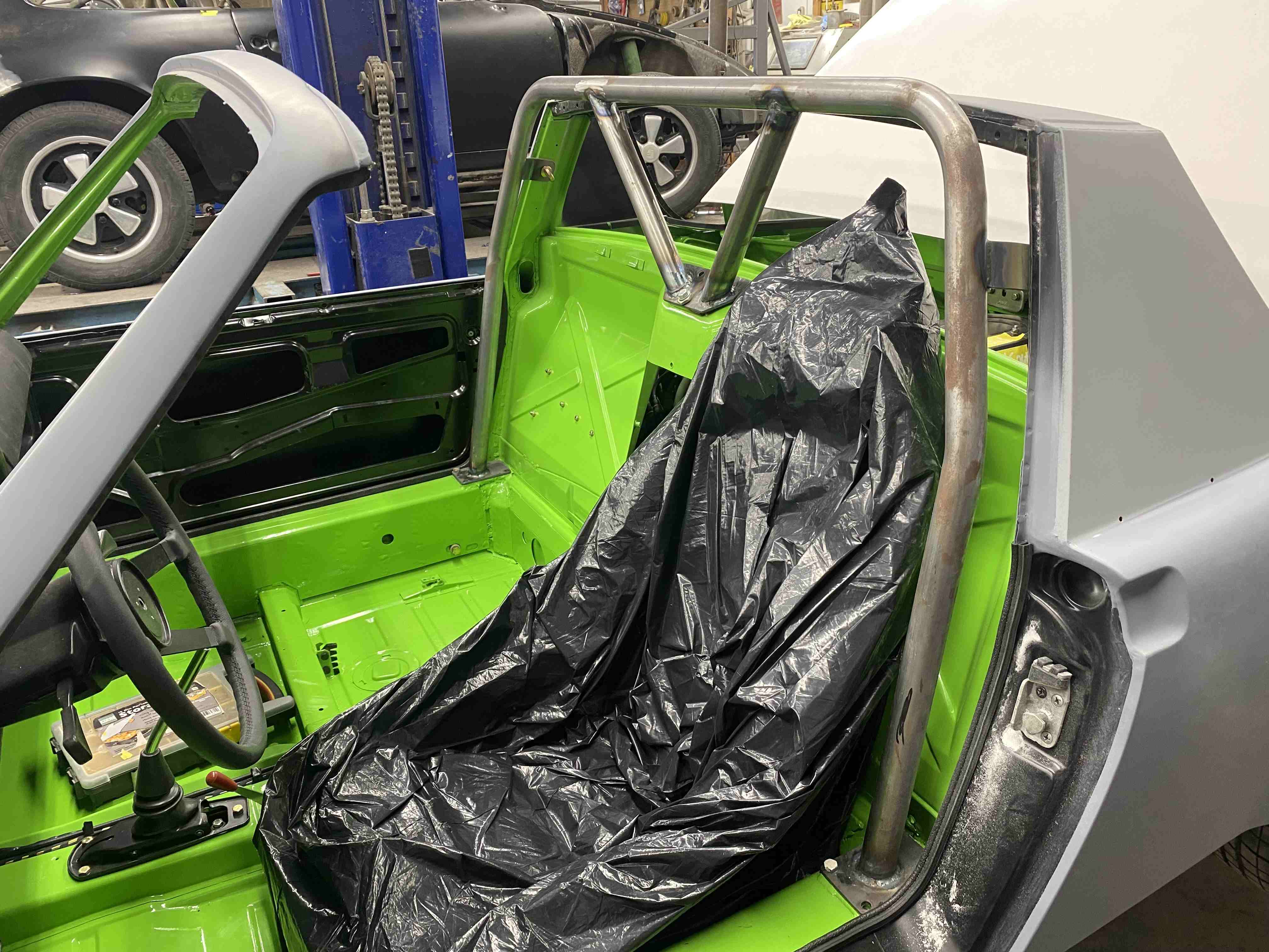

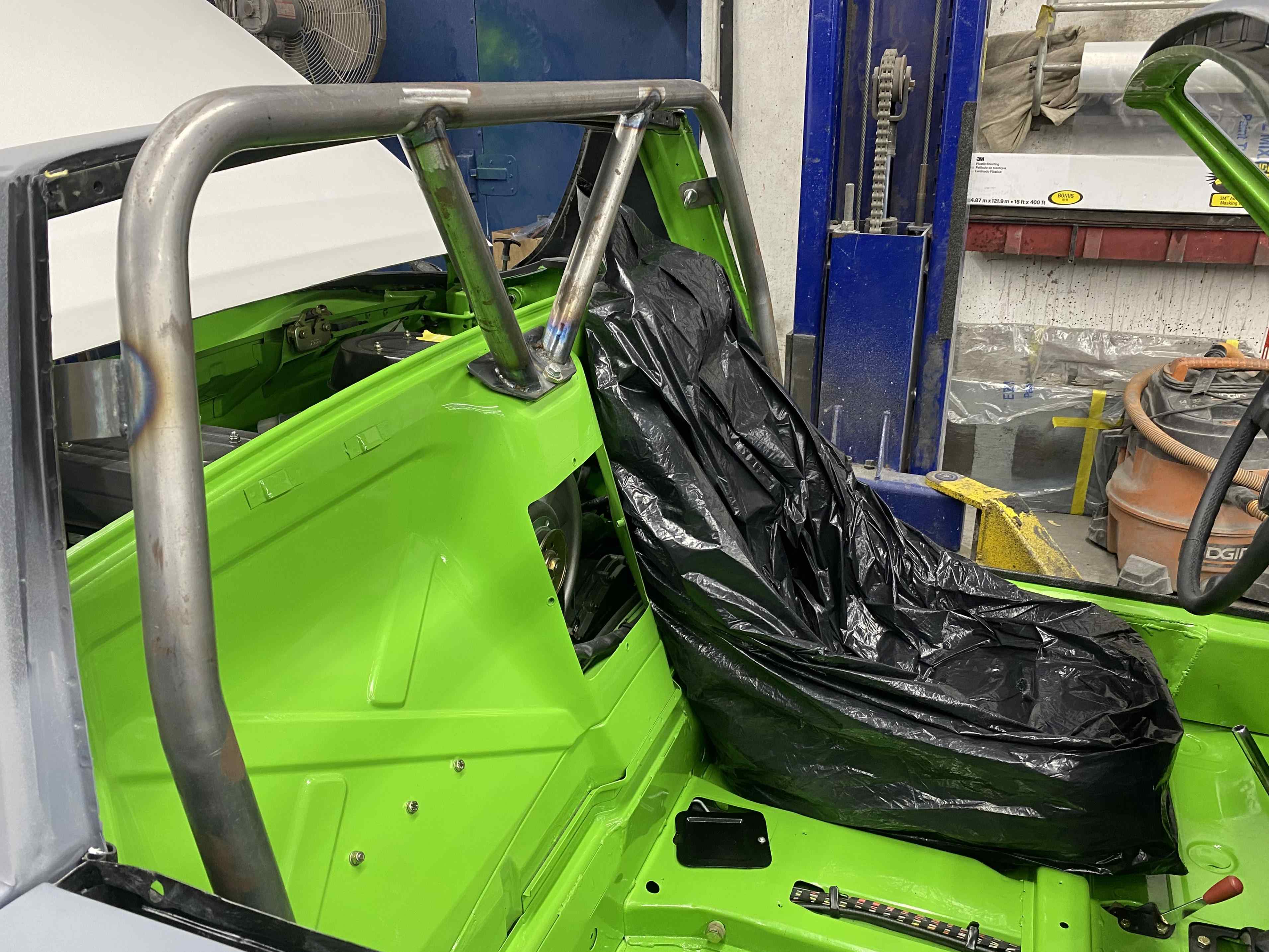

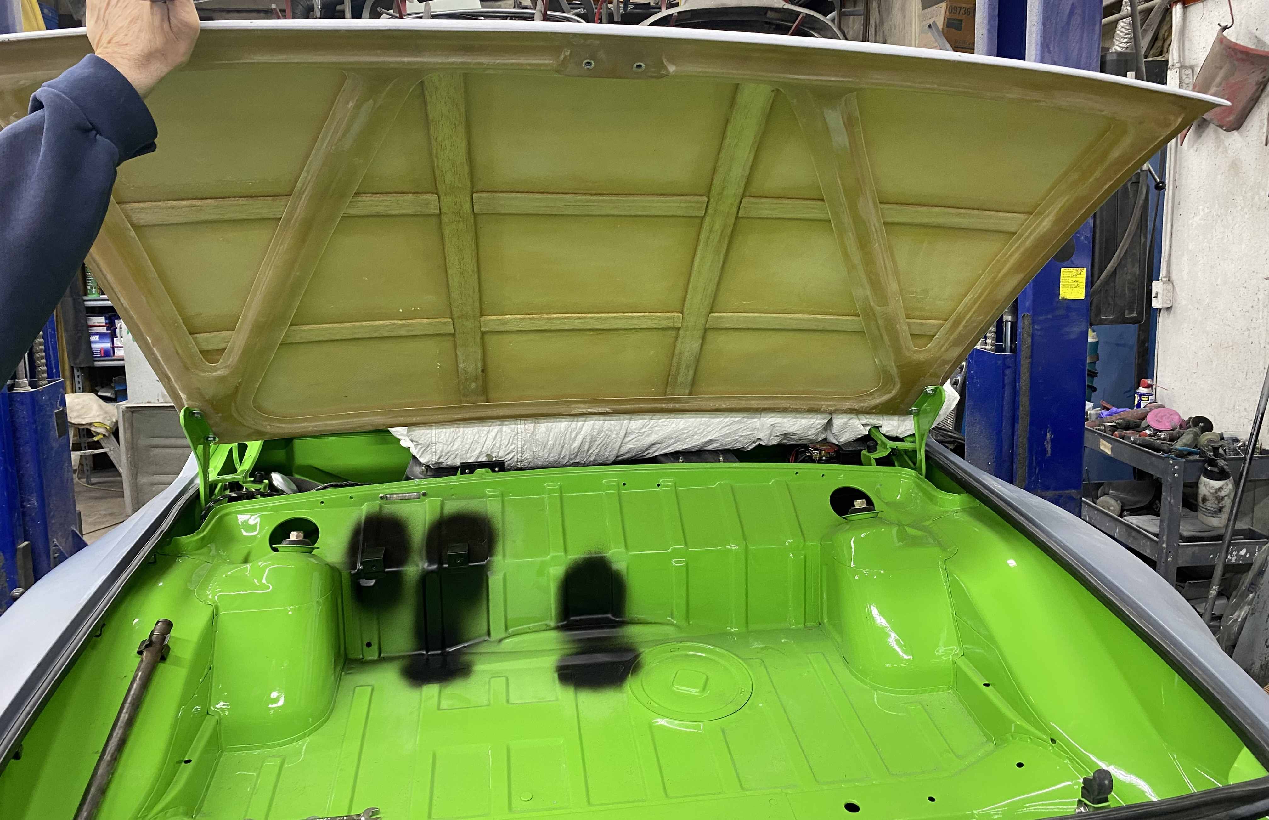

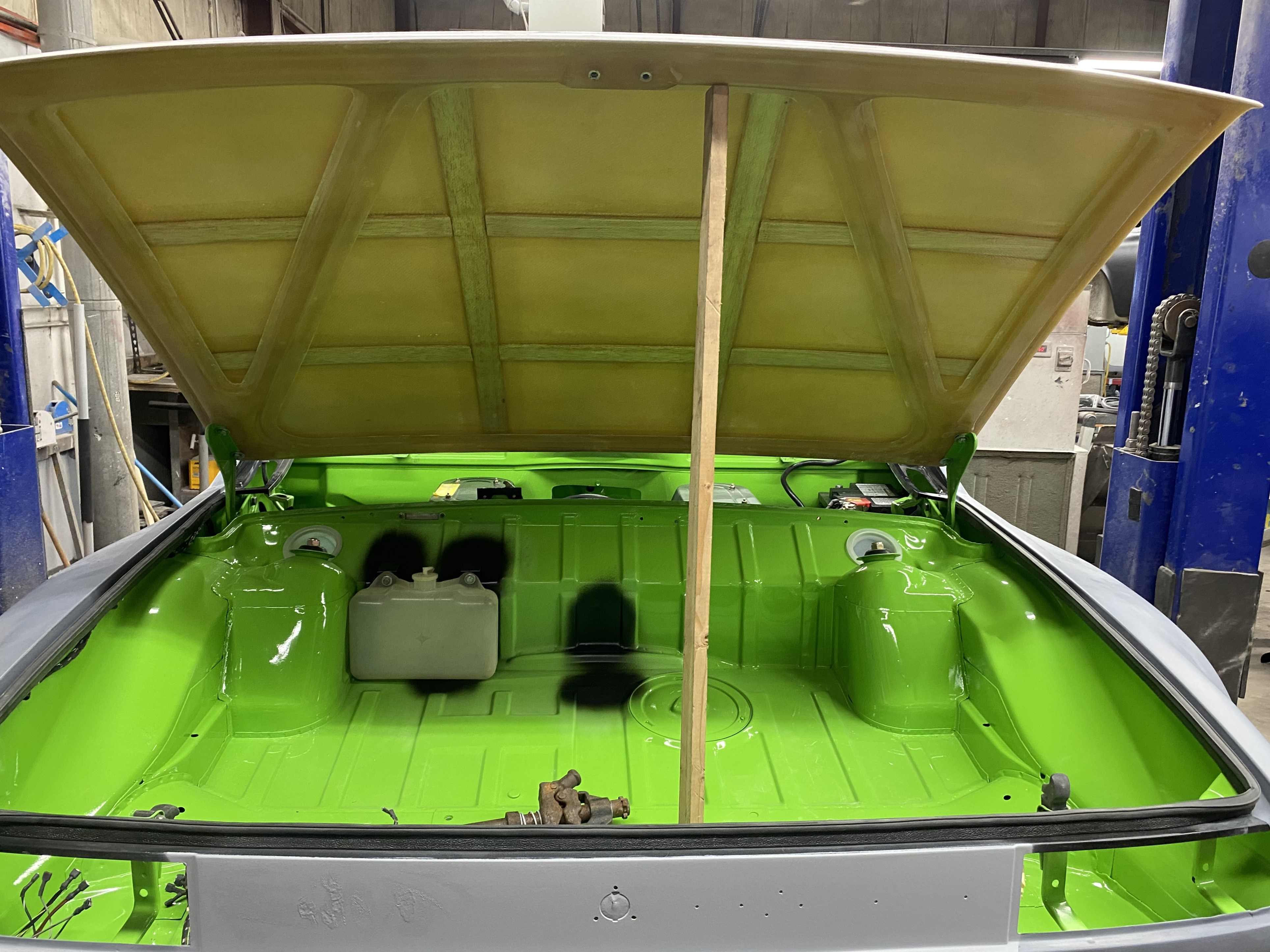

More progress at Auto Associates this week. Chris Foley's GT roll bar was fitted. I sat in the driver's seat to ensure adequate clearance between my head and the bar. All good there. We will add some high density padding to the bar on both driver's and passenger's sides. We also decided on the location of the diagonal side braces from the hoop to the longitudinals. These will provide side impact protection and some help for my aging body getting in and out of the car. The firewall, access panel and rear floor sections will get sound deadening. These along with the longitudinals will get RS style felt carpeting.

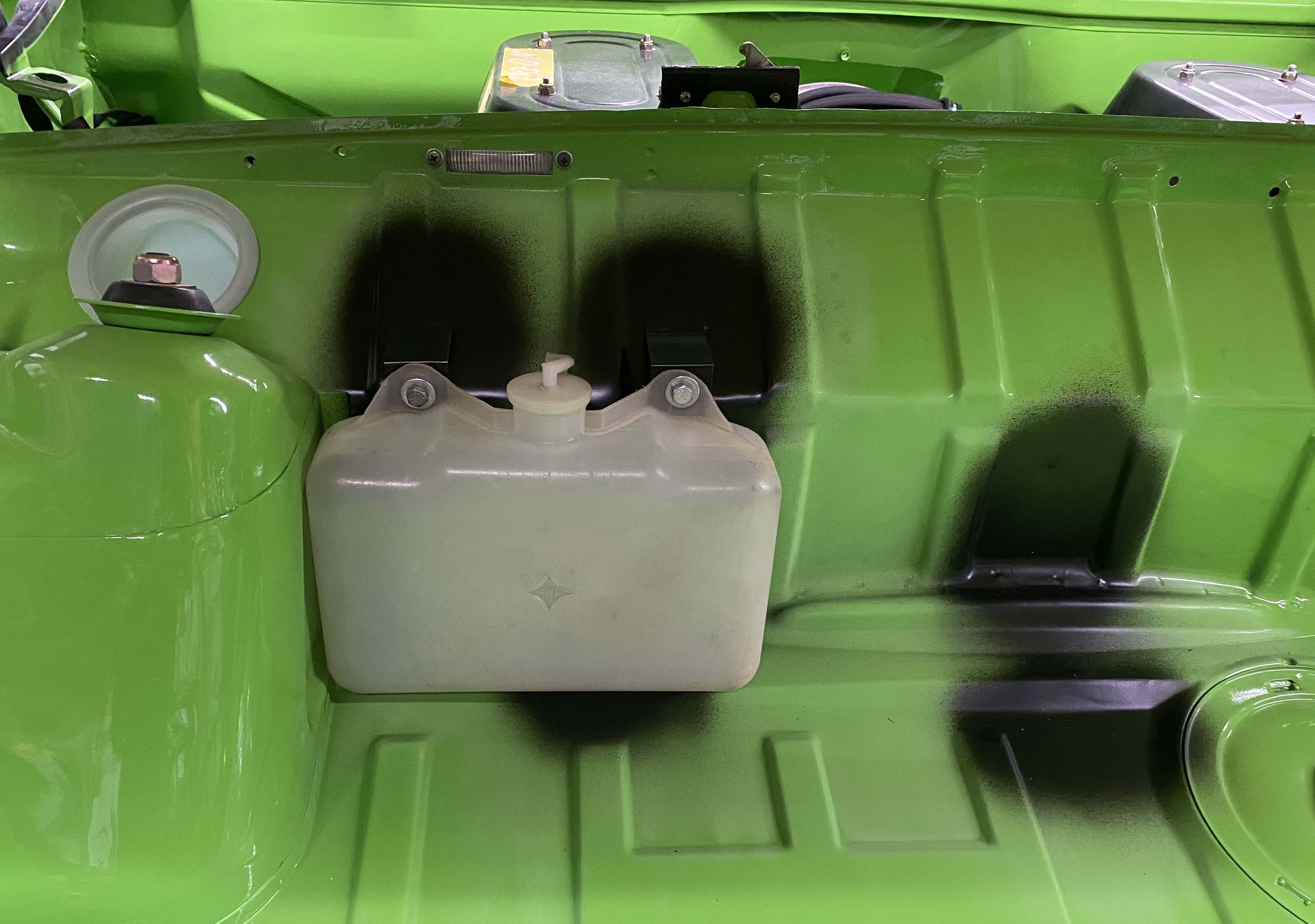

The oil catch tank in the rear trunk was added. The jack brackets will be related to LHS of the trunk like the early cars.

Will the roof fit on with the cage?

Yes, I have the same roll bar from Tangerine Racing and the roof fits fine.
Tom, I worked with Chris to put together some GT belt harness bars for the firewall. They worked great. Will you be using harness belts or normal 3 pointers?
Yes Ben...We test fitted the roof. It also seems like there will be room to close the rear Targa latches.

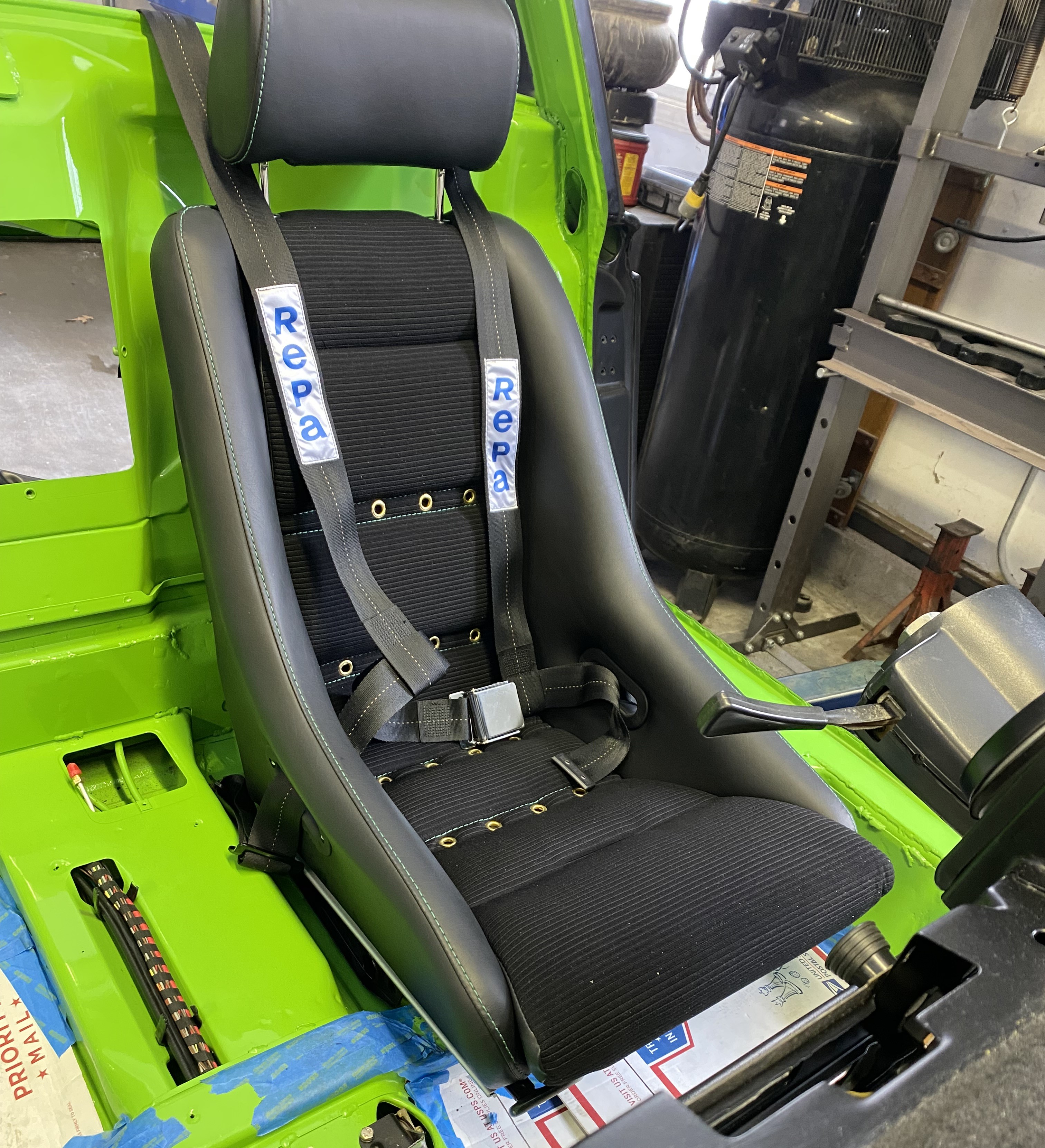

Hi John
I have a nice set of vintage 4-point belts from Stretch in the UK that we will be installing. Hardware for the installation is all ready to go. Thanks.

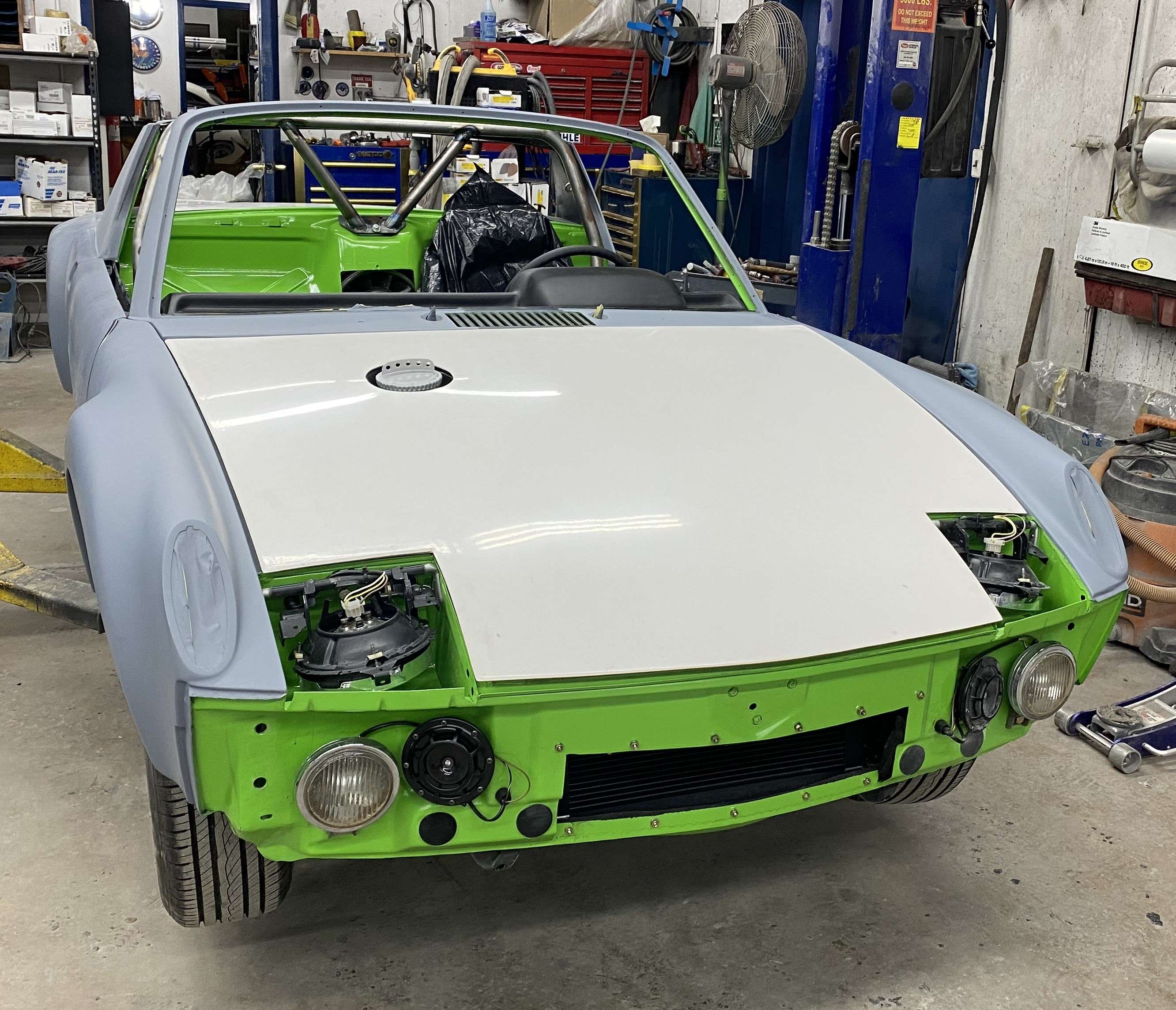

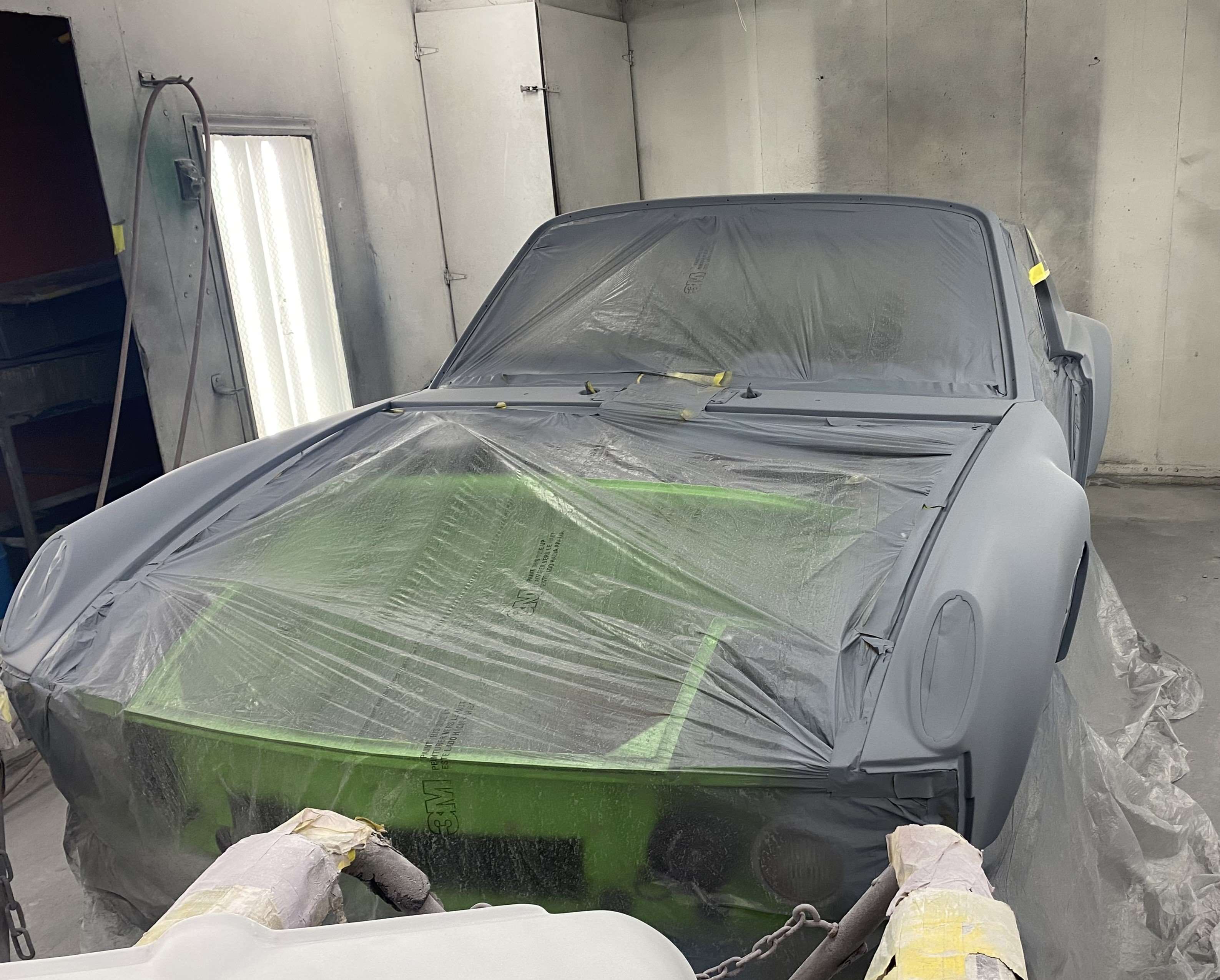

I took a trip back up to Auto Associates yesterday to deliver some parts and check on progress.
The car was in their mechanical section of the shop last week to fix an engine oil leak and test fit for wheels and tires. Scott and the team determined the leak was coming for the LHS cam drive. It turns out that the triangular gasket that seals the cam box at the drive end was distorted and leaking. A simple fix. They also found that the lower plugs were not firing. They rewired the MSD system and fixed the issue.

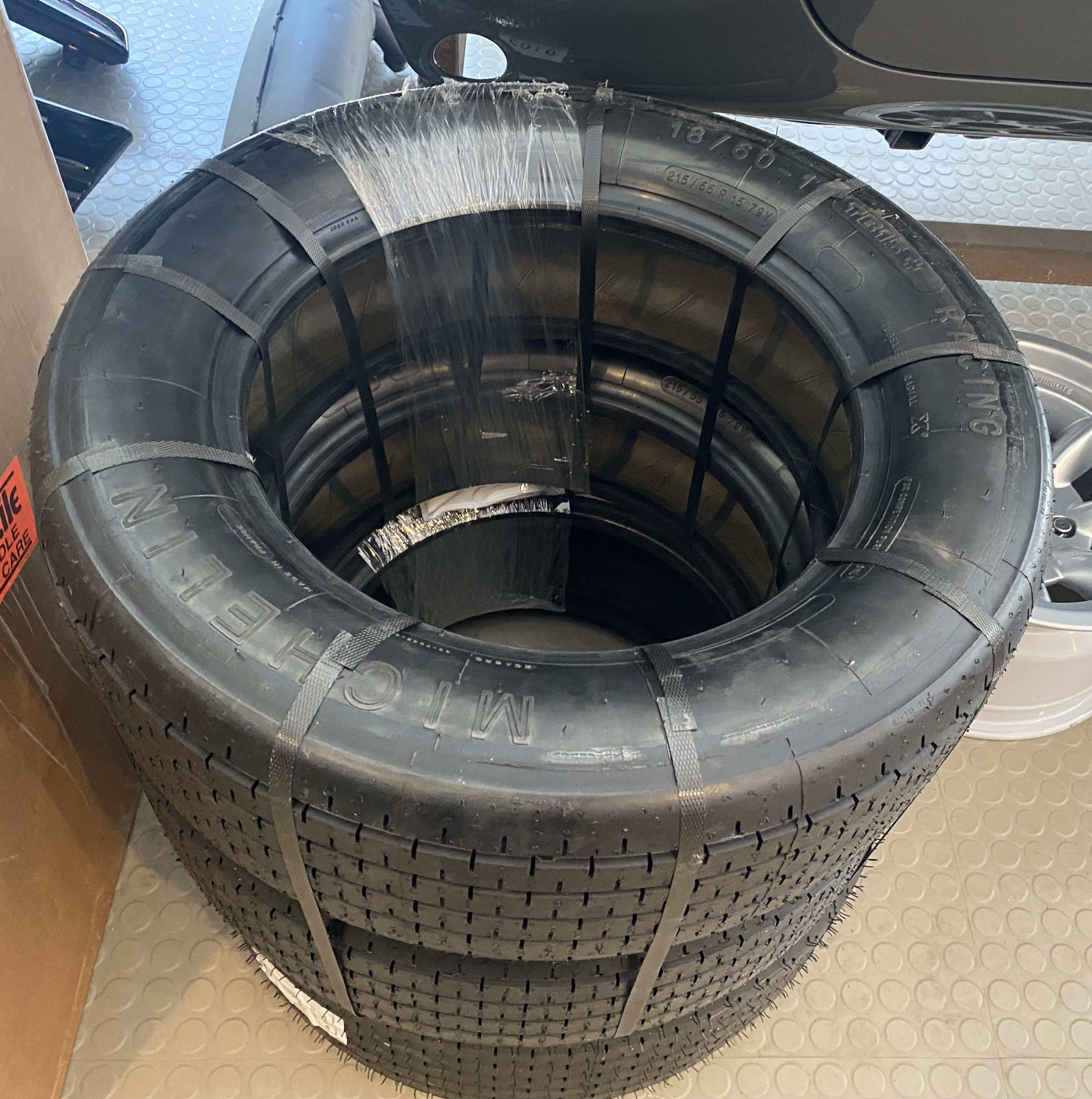

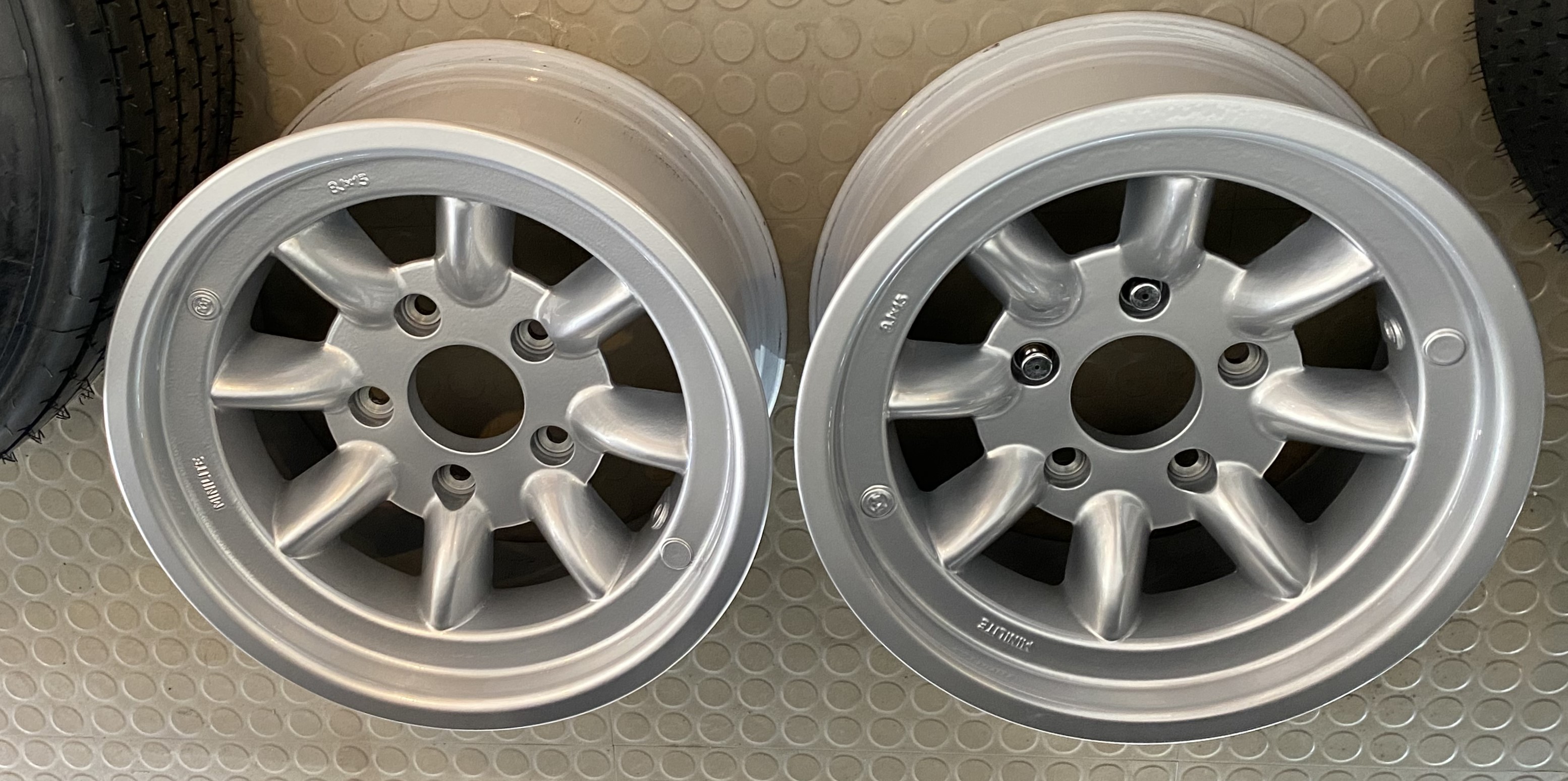

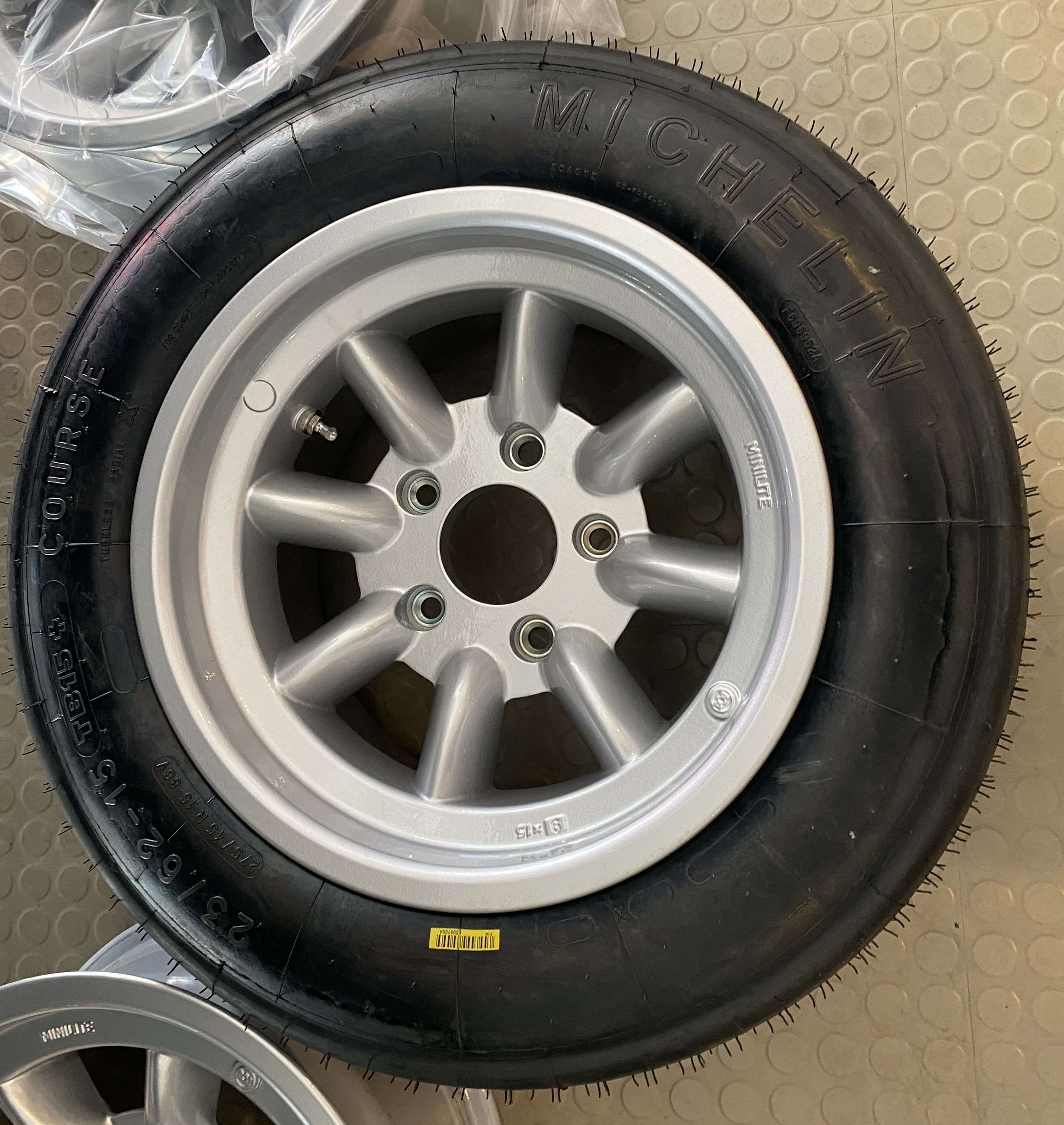

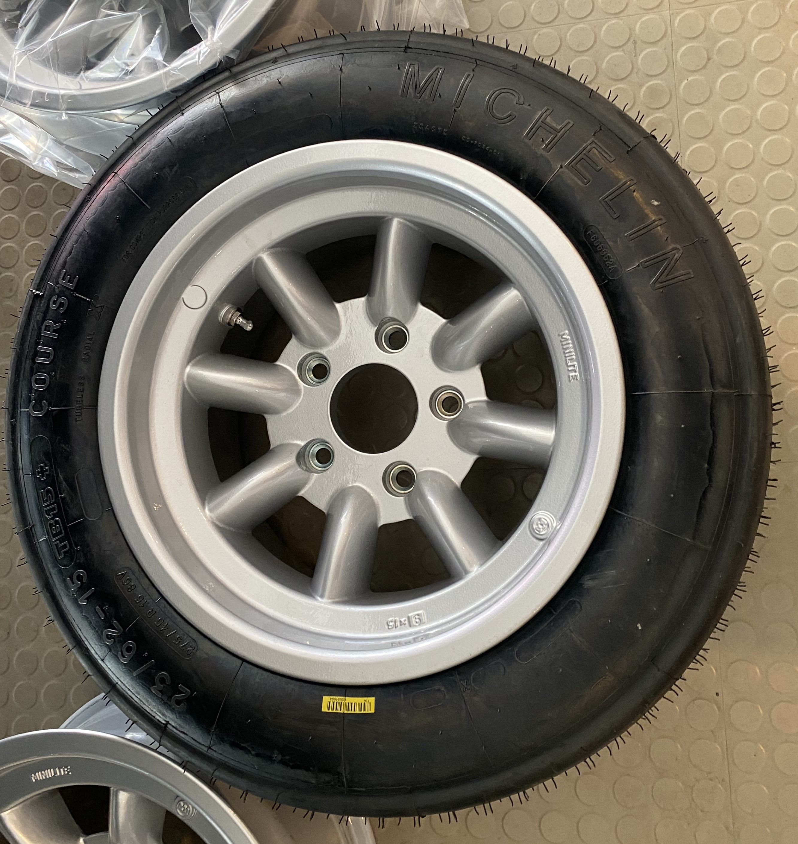

Scott also test fitted some wheels and tires. We settled on 15X7 in for the front and 15X9 in for the rears. The plan is for Minilites front and rear with Michelin TB-15 tires. Knowing the lead-time for the tires can be long, we went ahead and ordered them.

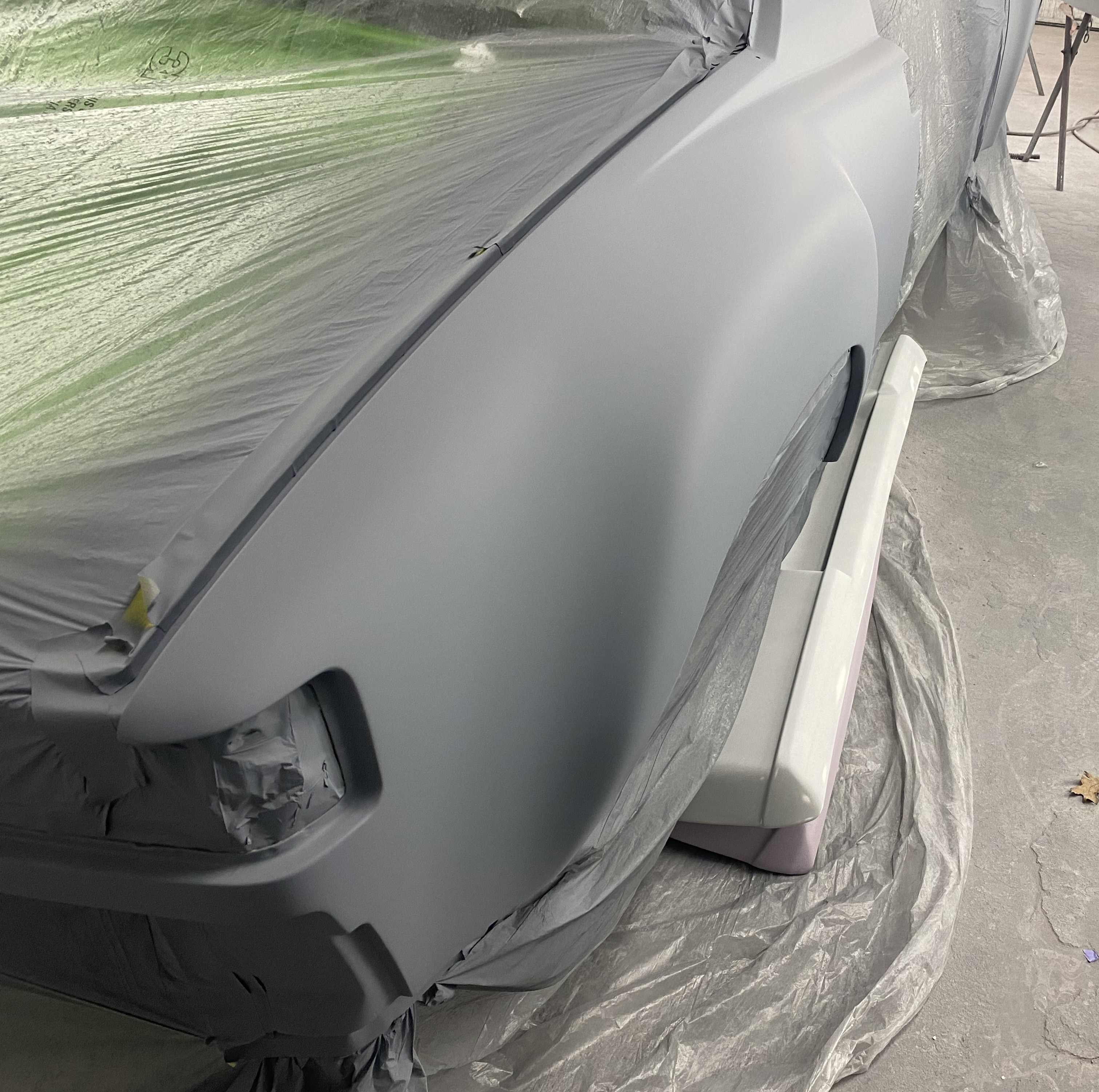

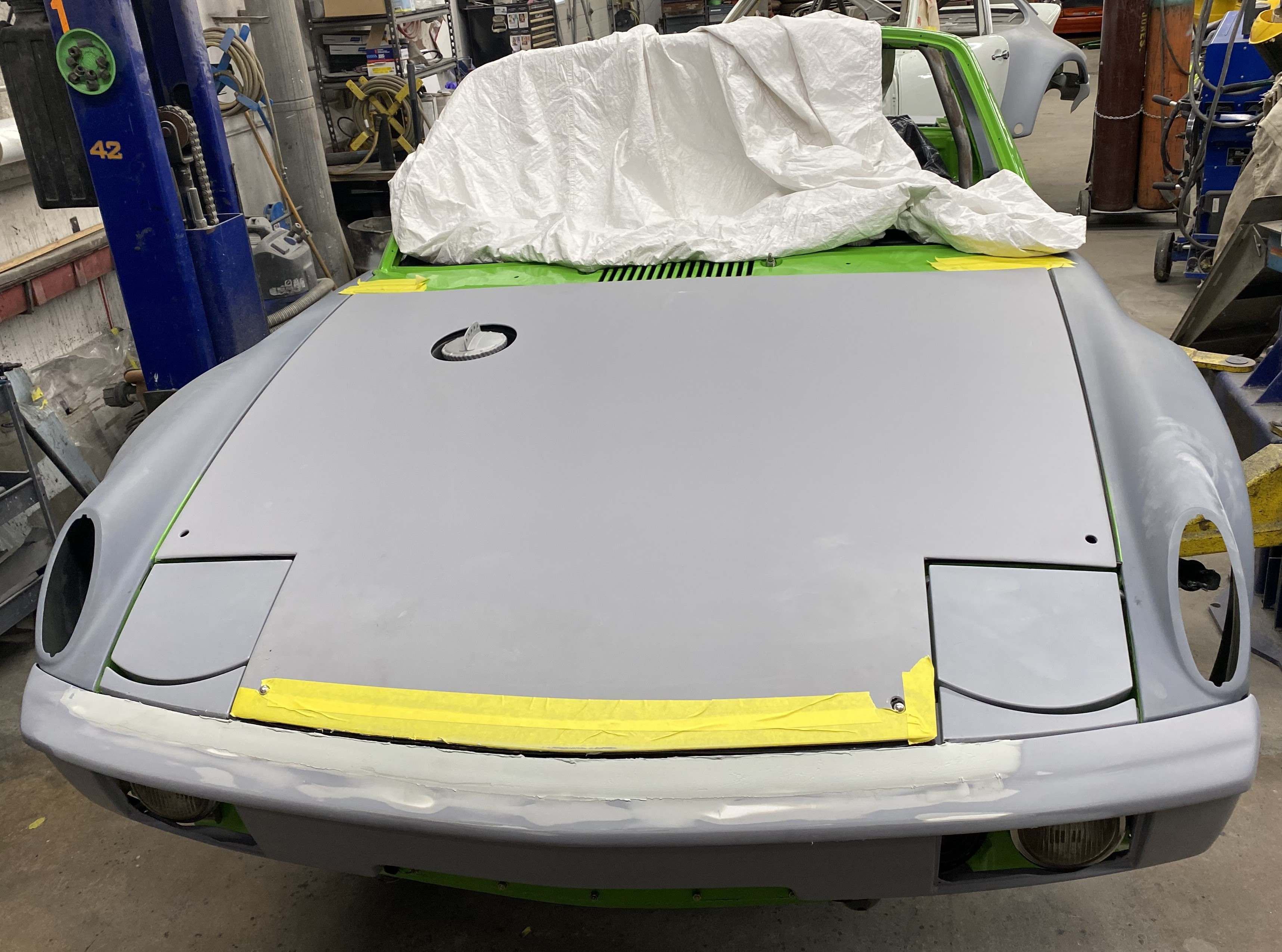

This week the car was back in the body shop for some panel tweaking prior to paint. We decided to leave the underside of the front and rear hoods unpainted like most of the factory GT's. The cross braces for the roll bar were added and the jack mount was relocated to the LHS rear trunk area.
Still projecting an early summer completion. Fingers crossed!

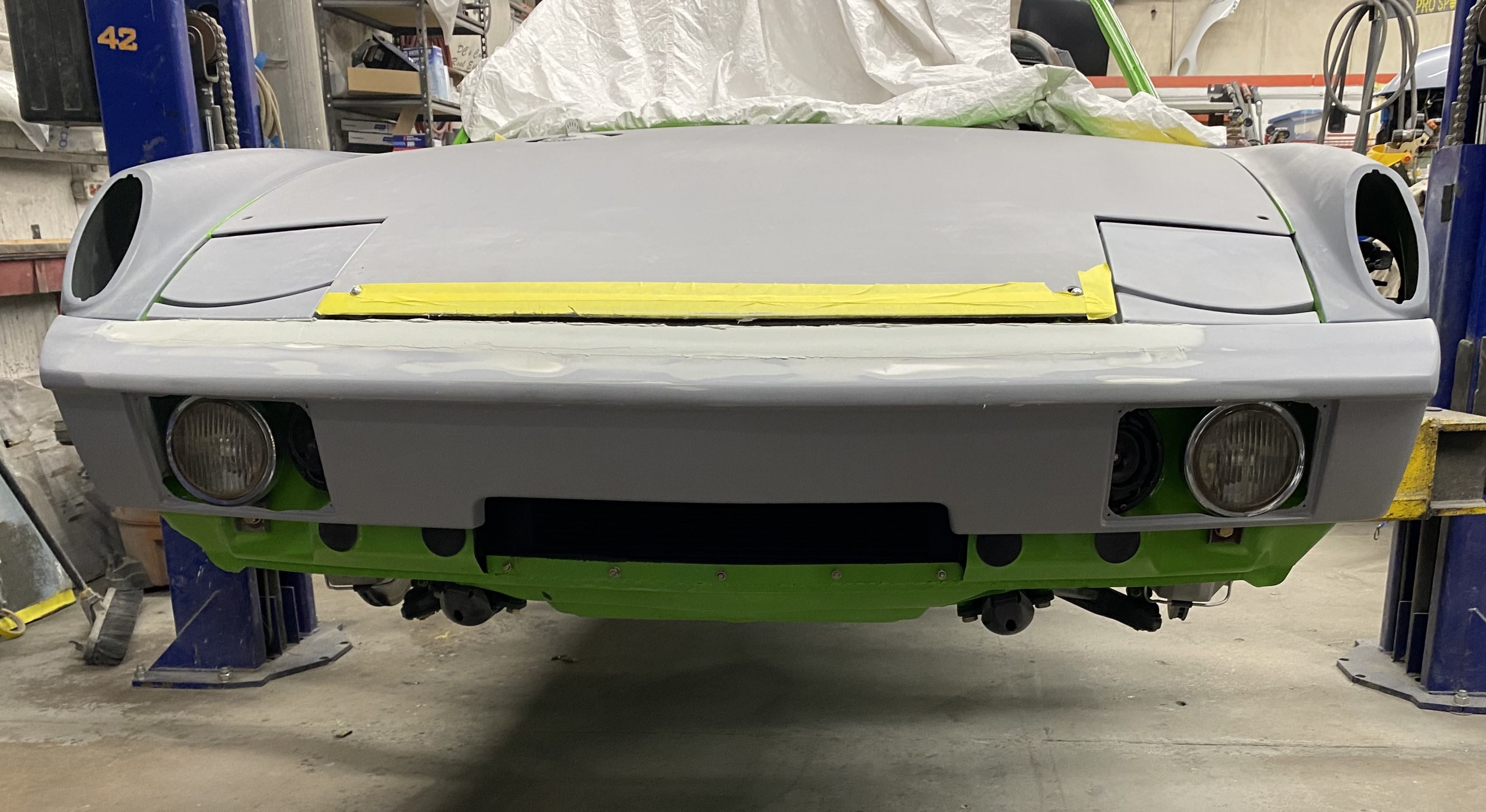

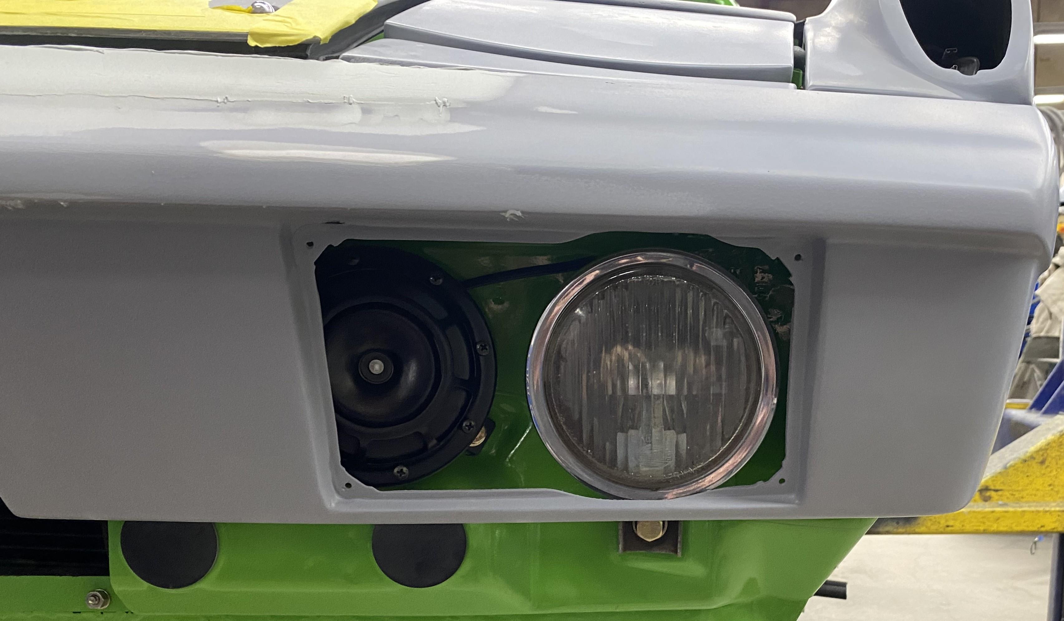

Are they 911 TTG fogs I see ? (IMG:style_emoticons/default/smile.gif)
Beautiful

Hmmmm
Beautiful
Looking great Tom
Rory
They are Hella TN-4. I think original to the 914-6
rgalla9146

is the back chrome/stainless or black ?

Black

The wheels and tires came in and the rears were test fitted. Minilite 15X9 with Michelin 23/62-15. No Issues. The fronts are Minilite 15X7 with Michelin 18/60-15. These will likely need spacers to properly center the tire in the wheel well.

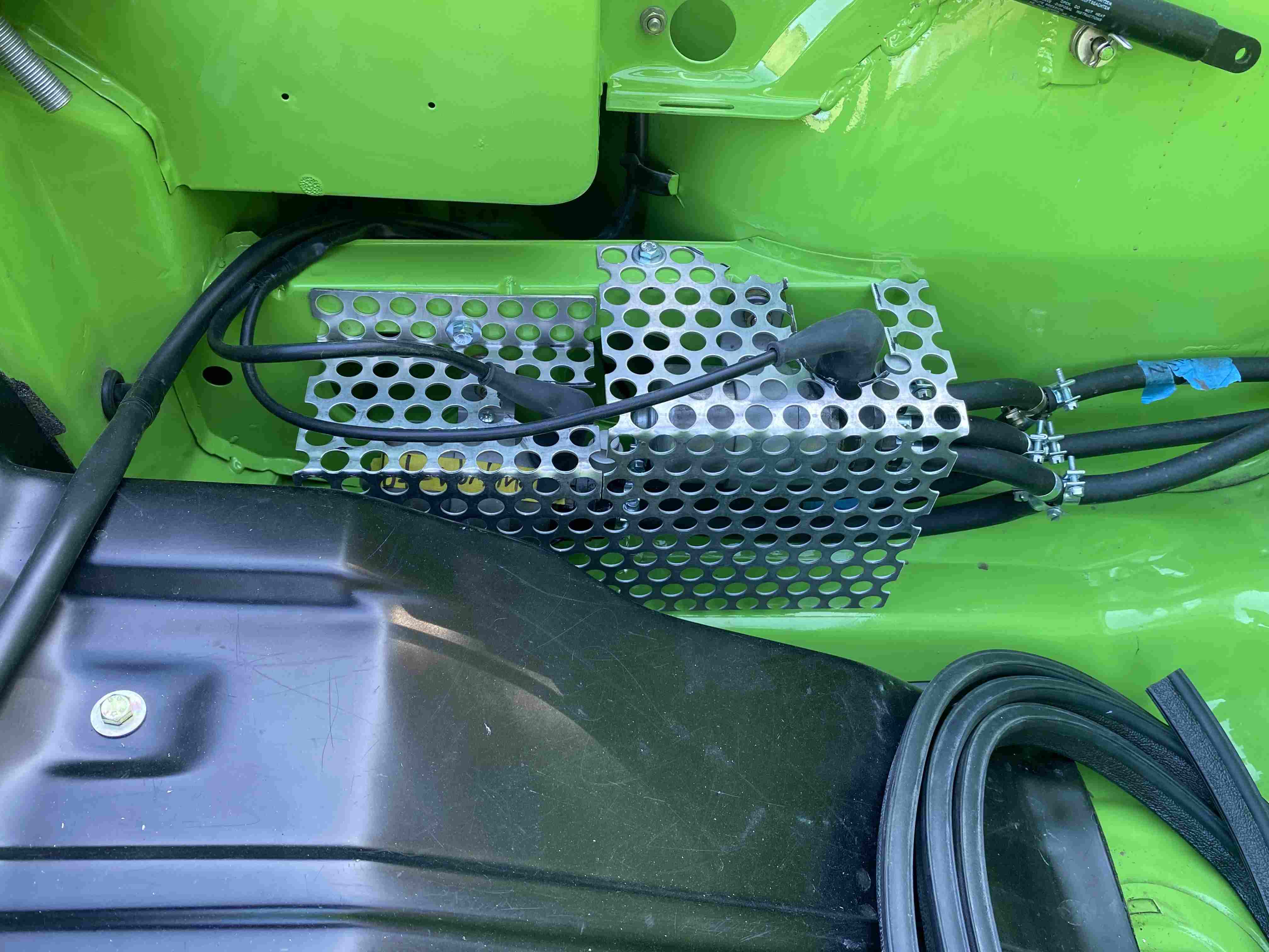

Ken's guy also fabricated and installed the fuel pump protective cover.
