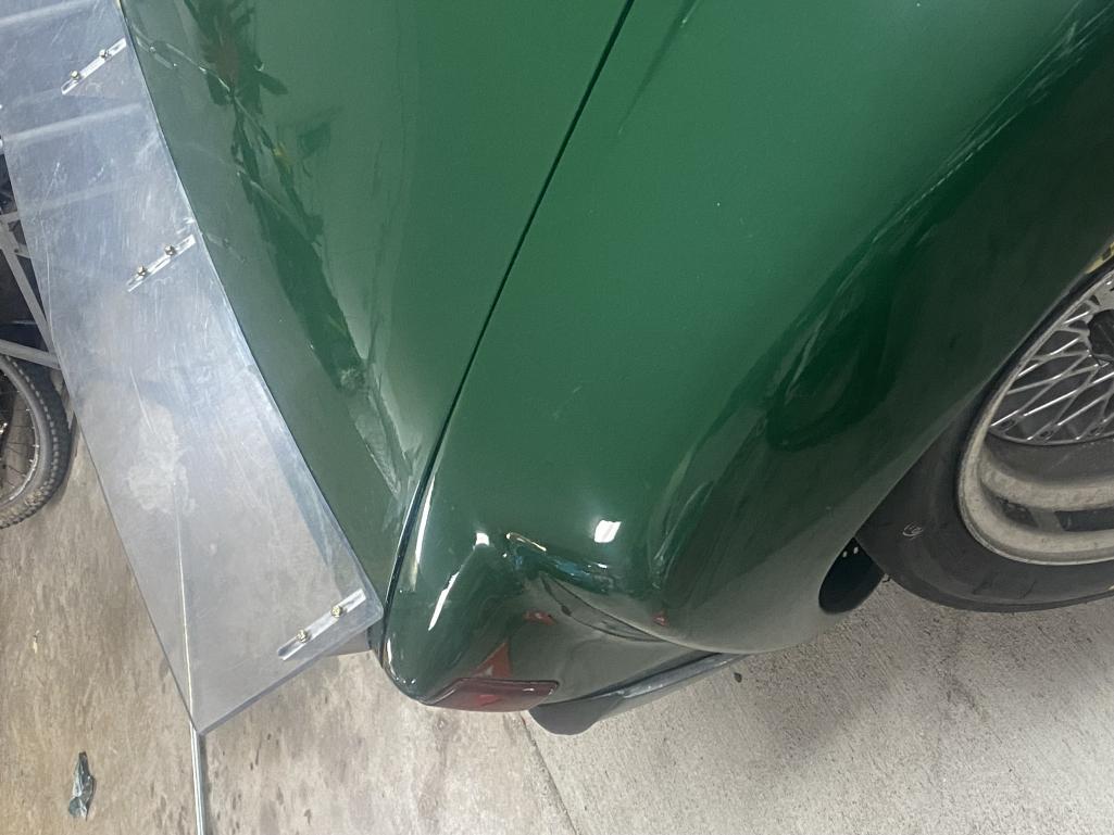

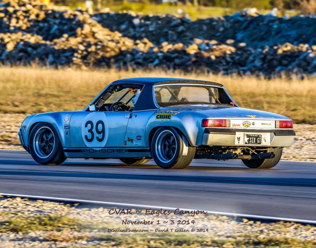

Does this tail even do anything?
Decided to run the car with air dam and “tail” at next weeks race.
Been running in standard GT configuration most times. (Recently repainted back to original green)
Attached Image Attached ImageAttached Image

Good looking car! I would think that the speed would make a big difference. There was a study a few years back that indicated that the outer edges of the rear were the best spots for downforce while having the center of the trunk area "spoiled" as well will reduce the straightline speed because of too much drag.

Yes a spoiler like that will be effective. A more vertical stance would be more effective, which might be what Brett was getting at. Air over the rear deck of a 914 is pretty turbulent, made worse by the sharp dropoff and void behind the roof. A spoiler helps direct the air and give moderate downforce.

I have been told as much by several people……but here’s a couple of points.
When buying the front spoiler from Sheridan he asked me how will I compensate out back. To me that meant I needed ( and had ) a wing. Secondly, from experience the car was much more stable in high speed turns….. ex: turn 9 at Road Atlanta is flat out
Without wing it would “dance” across the track whereas with wing it held the line even as the track drops down….
To me the down force (stability ) was worth the potential loss of top end……purely anecdotal but I guess seat of the pants can lie.
