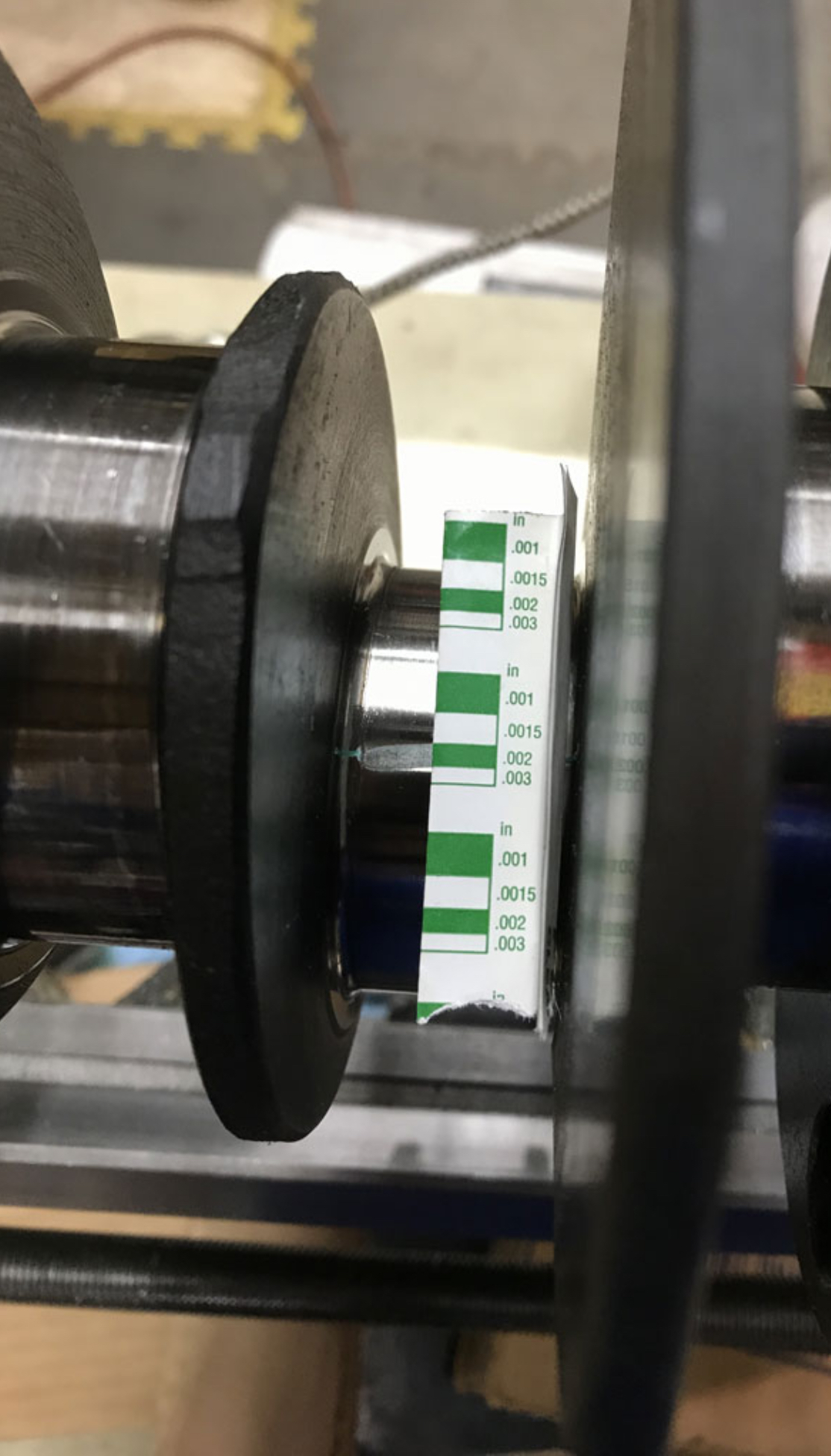

I went to my FLAPS and picked up PG. Since I'm checking the mains I needed to thread it in between the crank and the bearings (on all but #2 obvi) but I couldn't get it to go through without breaking. Perhaps there's some trick to "par-flatten" it just enough to get it in between the mating parts, but I couldn't do it.
So I called my local machinist and he said that he wouldn't take any material off the crank because it's chromoly and it'll lose some sort of protective coating. He told me to call the folks I got the parts from (AA Pistons).
Then I called AA and spoke to a very helpful person on the phone and he reassured me that the STD/STD Silverlines are the right bearings for the crank in the 2270 kit. He recommended I wet-fit it and "feel" if it spun freely and/or if there were any binding spots.
So.... I just did a wet fit and stopped futzing about ¯\_(ツ)_/¯
Here's the result:
(IMG:http://www.914world.com/bbs2/uploads_offsite/media.giphy.com-23760-1703800335.1.gif)
I mean... the darn thing spins that's for sure. I still have no idea whether I need to do anything to the crank/bearings/line bore/etc. since I don't have reliable measurements to backstop me.
FWIW my machinist really doesn't want to be bothered with this job so perhaps I'll call around for someone how does? I did want to do this myself (and learn in the process), but I'm just not sure what my next step is other than to send it and hope.

Google search "how to properly use Plasti-gauge.
You're doing it wrong...

I should have been more clear. You can only use Plastigage on the split bearing.
However, it is pretty reasonable to use that single split bearing as a proxy for the others while still being able to use it as a double check to your measurements.
Here’s the problem with assuming a free spinning crank equals success, too much clearance is as bad as too little clearance. Too much clearance results in low oil pressure.
Since you assembled and spun it here’s what we do know. You don’t have a zero clearance condition as your 2nd set of measurements was indicating.
What to do next?
I’d suggest going back and learning how to get your bore gage, micrometer measurements to agree with what Plastigage indicates on the split bearing.
I’d also spend some time measuring and Plastigage’ing the connecting rods.
At this point it’s just time to assemble & disassemble parts. The opportunity to learn here being the primary goal. The secondary goal is that you should eventually be confident that you know what your bearing and rod clearances are.

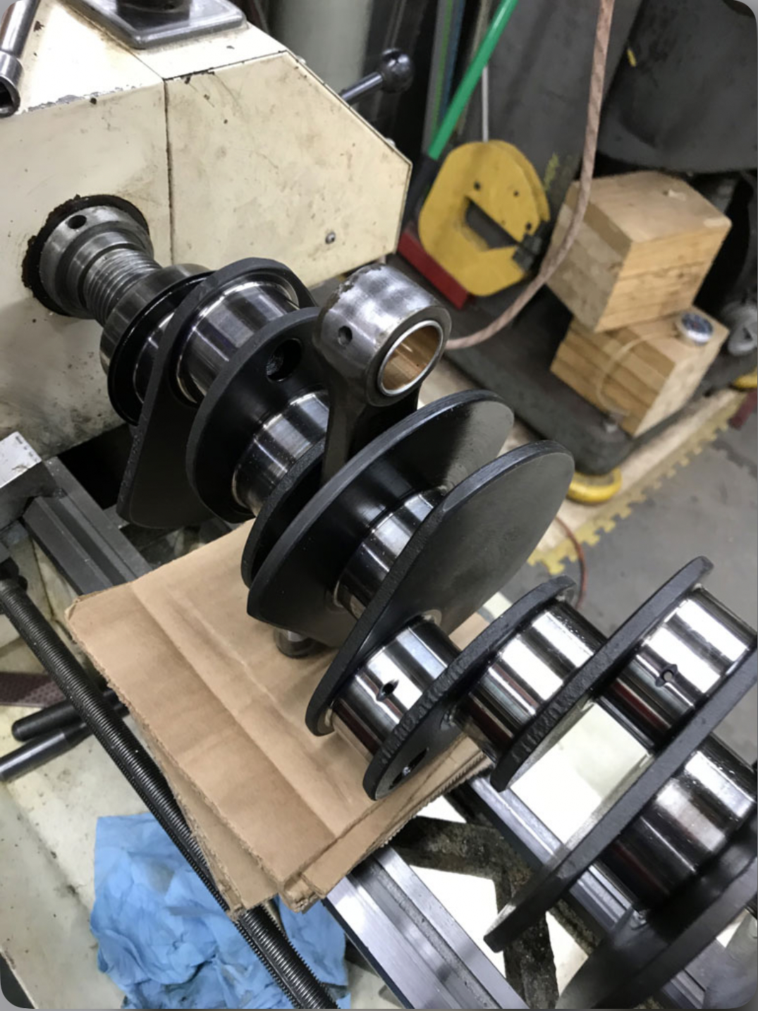

Attached Image the

First time engine builder here. Building a 2270 and I am about at the same spot. Got most of the parts. Working on oil galley plugs and sending parts off for balancing. Was reading Tom Wilson’s book and came across this section on using plastigage.

Plasti-gauge can only be used on split bearings. The single piece bearings have to be measured.
It's HARD to properly torque up a rod without moving it.
The tiniest movement destroys the accuracy.
They missed some important tips.
Make your length of plasti-gauge that you're inserting in the journal slightly narrower than the bearing width. It's best to have .020" (.5mm) on either side of the strip or you will have a harder time cleaning the PG off of the bearing and the crank. The radius corners squish the piss out of plasti-gauge; try to keep it out of the corners.
It is IMPORTANT to carefully remove the plasti-gauge after testing completely.
I use soft rags, WD/40, alcohol, and a soft touch. The inner surface of an engine bearing is extremely soft. You can scratch it with your fingernail.
Don't damage this surface when cleaning.

Much easier if done between centers where you can alllow the rod to sit against something to prevent inadvertent rotation on the journals. In this photo, I would allow the small end to rest on the ways which have cardboard on them to prevent damage to the rod while being torqued. Unfortunately I don’t have a photo in that position but I trust you get the jist of the setup.
Not a hint of smearing
When I did my first engine I didn’t have fancy tools. Just put crank on a soft surface to protect it (cardboard, shop towel, etc.). Assemble rod horizontally, while laying against bench top, again so the rod can’t rotate.
I’ve also had good luck doing it while case is mounted in engine stand, rods hanging down. Use something soft (wood dowel, cardboard, etc) to jamb the small end of the rod so it can’t rotate while torquing the fasteners.

I'm guessing you're like me and by the time the PG is being used we already know what our clearances will be...
Both you and I will always be able to overcome roadblocks in the technical world as we have the "gotta rip it apart" mental illness!
I've had it forever.
I'll have active projects in process when I die.
I'd bet you are similar.
And here's yet another shortcoming in the horizontally opposed engine design...
All my 4/6/8 cylinder builds that are not opposed are capable at PGing all bearings main and rod together with a single crankshaft install.
No blocking or limiting rotation needed on anything...
This is one of the reasons I advised the OP "stop and learn" as enough "T4s do it this way/everyone else does not" exist to be critical. The T4 is not really harder than others to rebuild, just has some "non-standard" strangeness to understand.
Today, with all the different oil pump diameters, I'll check my cases for proper oil pump bore/clearance as well as main and cam bores.
I've NEVER done that on ANYTHING else in my life!
If I have to have cases line bored, I'll request a specific oil pump bore diameter based on the oil pump I purchase. This is weird in my book...
Edit: WOW! that crank is dirty for taking measurements. I hope your cleaning off each individual journal before...

Ok we're in business and you guys are to thank. @cgnj you're right, my "spec sheet" was bunk. @Superhawk996 I ordered the Tom Wilson book - will be here in a few days.
Today I went to HF (I know, I know) to pick up a set of micrometers and a telescoping gauge set. I measured the main journals, and #1 bearing torqued in the case (all I had time for). I also plastigage'd #2 with the case torqued to spec. And I'm definitely in the ballpark.

I got:
  • Main journals came in at 2.361" for #1-3 and 1.574" on #4, which is right on-spec
  • Plastigage on #2 came in at around 0.076 (or 0.0029") which is within the 0.0012" - 0.0035" spec that @cgnj posted
  • My telescoping gauge measured #1 just over 2.362" which represents a gap of just over 0.002" which, again, is within the spec @cgnj posted of 0.0016" - 0.0039"
So all-in-all today's gut-check felt good. Thank you all again.
Also (I'll probably catch a lot of flak from you all on this) my stroker crank wasn't clearancing the case so I ground a bit of it off so that it clears ¯\_(ツ)_/¯
(IMG:http://www.914world.com/bbs2/uploads_offsite/media.giphy.com-23760-1703899586.2.gif)
I'm going to spend more time this weekend measuring the clearances on #2, #3, and #4, as well as roundness on all bearings in the torqued case with my dial bore gauge.
Once the Tom Wilson book arrives, I'll have some light reading to occupy my time :-)
Next step: More measuring, reading, and finding a machinist for balancing the rotating assembly!

Two comments, hoping you removed material from the case and not the crank to provide clearance and a machinist and a balancing tech are different skill sets generally not the same guy.

Even today I'll make three distinct measurements for a "am I doing this right" check.
I have a set of the inexpensive snap gauges too.
I found a problem with mine.
As you tighten up the lock they tend to get slightly "looser" in the drag feel they produce.
I barely lock them to combat this. I trust them less than my bore indicator.
You might check if yours do the same.
Maybe it's just a glitch in my tools.
I lubed the piss out of my set. Ran them in and out.
It helped a little bit, but I don't trust mine...
The lasts set of numbers are decent. Keep practicing your measuring technique.
