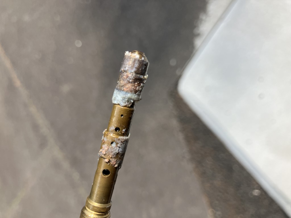

Ouch, what happened to this main jet/holder? Probably water (IMG:style_emoticons/default/screwy.gif)

QUOTE(930cabman @ Sep 16 2024, 09:11 AM) *
It cleaned right out; the holder, jets, and air correctors are fine.
The engine ran fine when I parked it in June. And though it lives in the garage since - no significant exposure to water except maybe sitting outside with Perry's umbrella cover* if it's raining and I need the lift - I had no reason to run it so it was just pushed in and out as needed.
Best I can figure, I didn't fully drain the float bowls when I shut it down** and the fuel in the float bowl evaporated, leaving behind these precipitates, same as salt water will leave behind salt if you evaporate it. When I turned on the fuel pump it filled the bowl, mixing those solids in there, and when I fired up the engine it got sucked into the jet ports and stacks. I removed the top of the carb and there was grey lead deposits in it, and after cleaning that out I blew through the passages and more came out into the main stack ports.
I purged the rest of the tank of all that fuel, and there were no contaminates in the system. The fuel filter was clean.
Avoid the lead if at all possible.
GA
*Perry's cover does a decent job of keeping water out of the grill, but it has to be stretched tight. I'm running Sergio's GT grill and there's no water tray. Also, the air filters are using Claude's aluminum cast tops so I really don't see that there was much way for water to get into the carbs. And there was no reasonable way for water to get into the fuel cell, which is mounted in the front trunk (I didn't see any water when I purged the tank).
**At the end of a weekend I will typically turn off the fuel pump and let it idle it until it dies, using throttle to keep it running as needed. The left side carb was fine, only the right one had these precipitates. So I'm guessing the left side ran out first and the right side was not cleared out when I let it die and shut it down.
