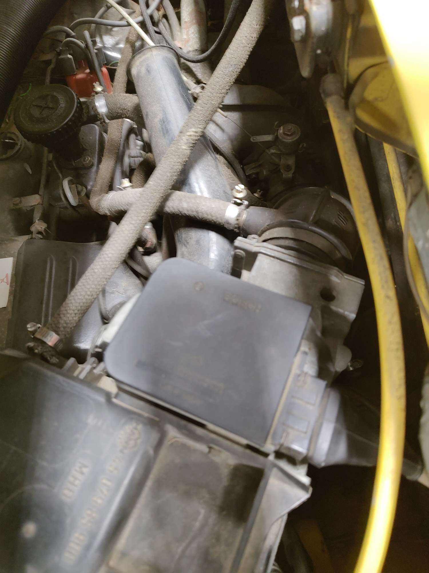

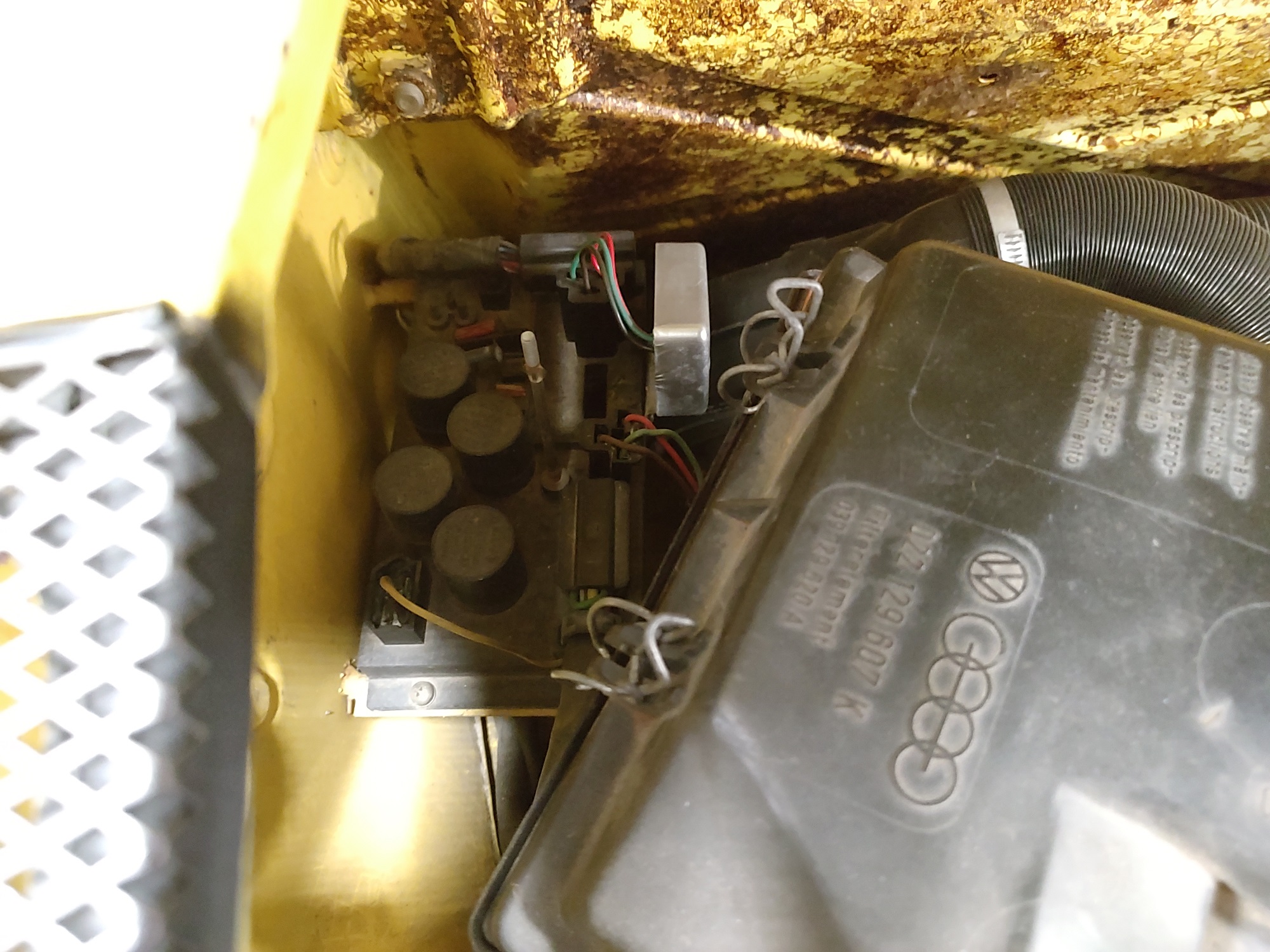

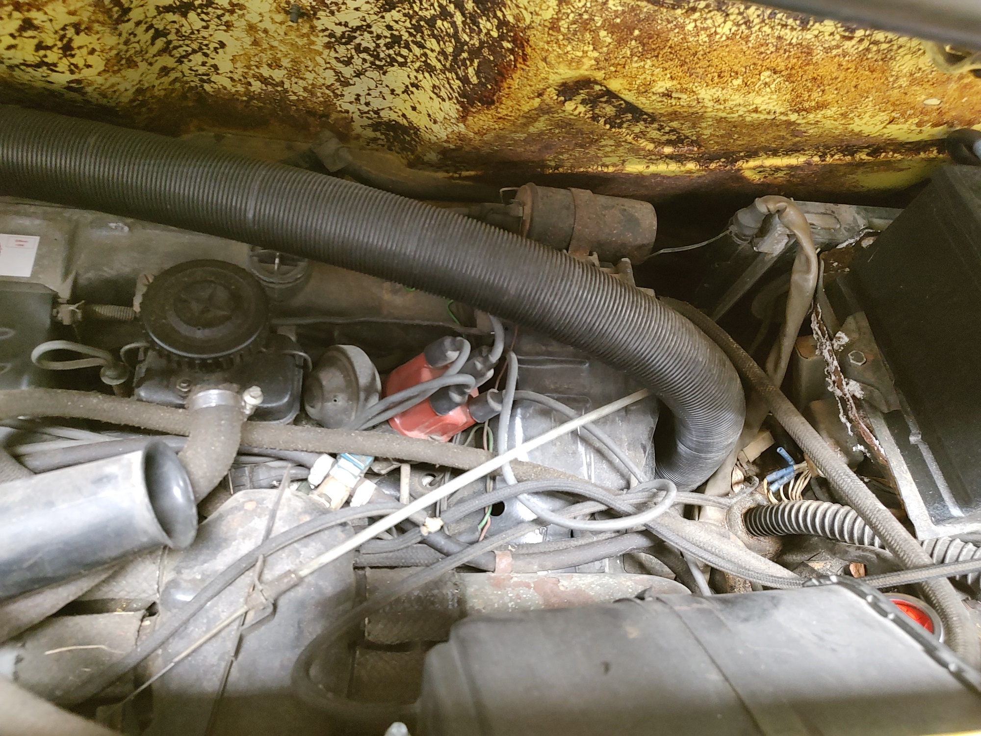

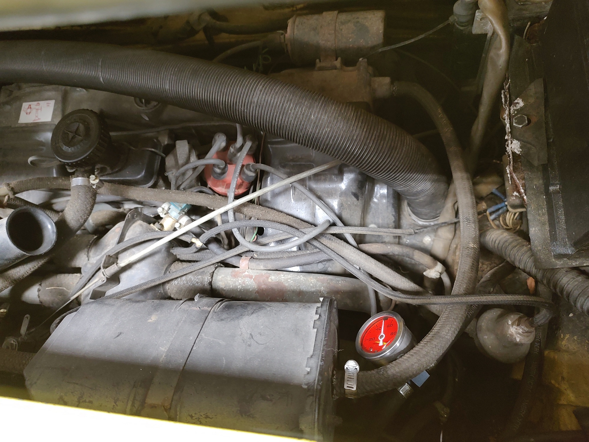

Here are some pictures of the engine bay. If there's anything I need to take in more detail, please let me know. Thank you!

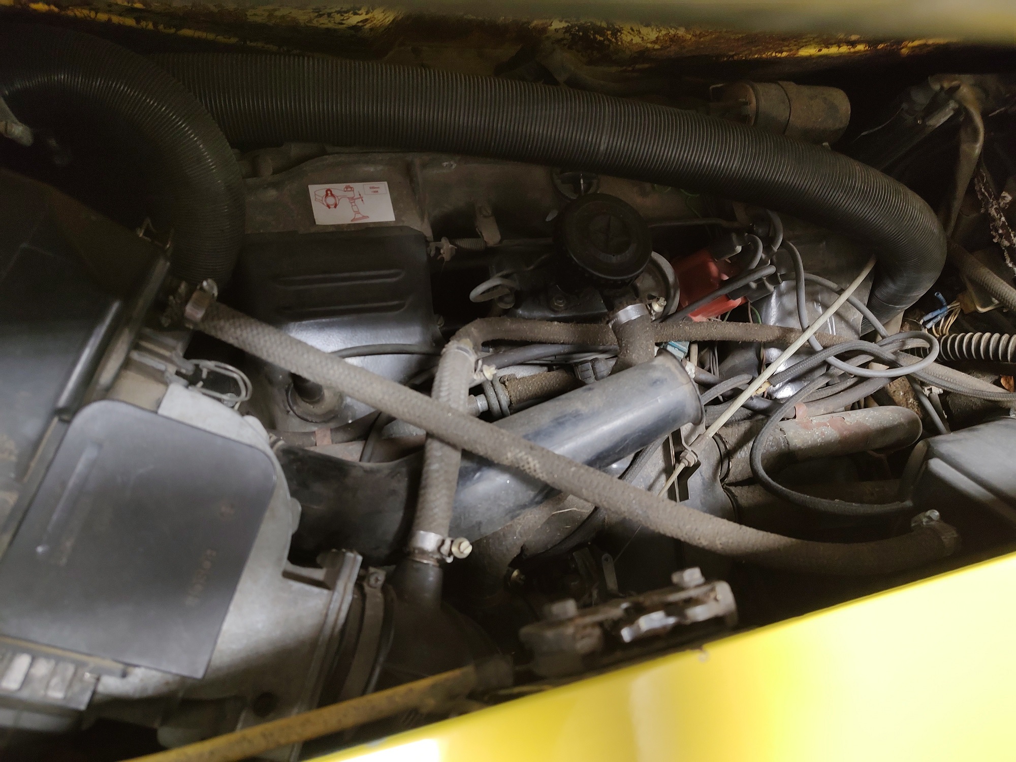

Last one:
wonkipop
post Oct 7 2024, 05:25 PM
Posts: 4,753
Joined: 6-May 20
From: north antarctica
Member No.: 24,231
@Nor.Cal.914
this link will get you started.
you can download the factory workshop manuals for the 914.
you only need group 2 four cylinder fuel injection volume.
http://p914-6info.net/Manuals.htm
it can be a bit confusing as all the D jet stuff is mixed in there.
the way these factory manuals worked i gather is they issued them at the introduction of the car and then as the model years progressed added sections in.
so the L jet stuff is scattered through out though it is mostly concentrated at the end.
there are some test procedures for each component in the L jet EFI.
but not everything is there.
i have some other stuff which is VW L jet troubleshooting guides which apply to the type 4 VWs. pretty close to the same system as in 914.
and i think somewhere else diagrams for testing the dual relays and ECU harness and plugs etc. but i have to dig them up.
will post later.
