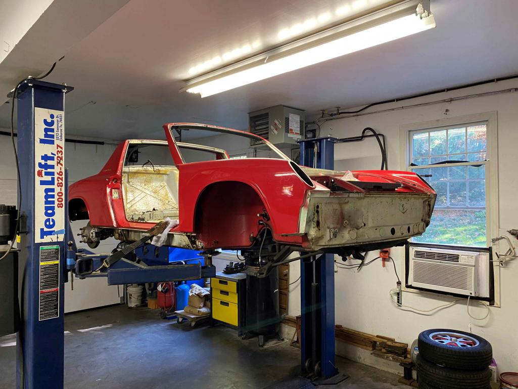

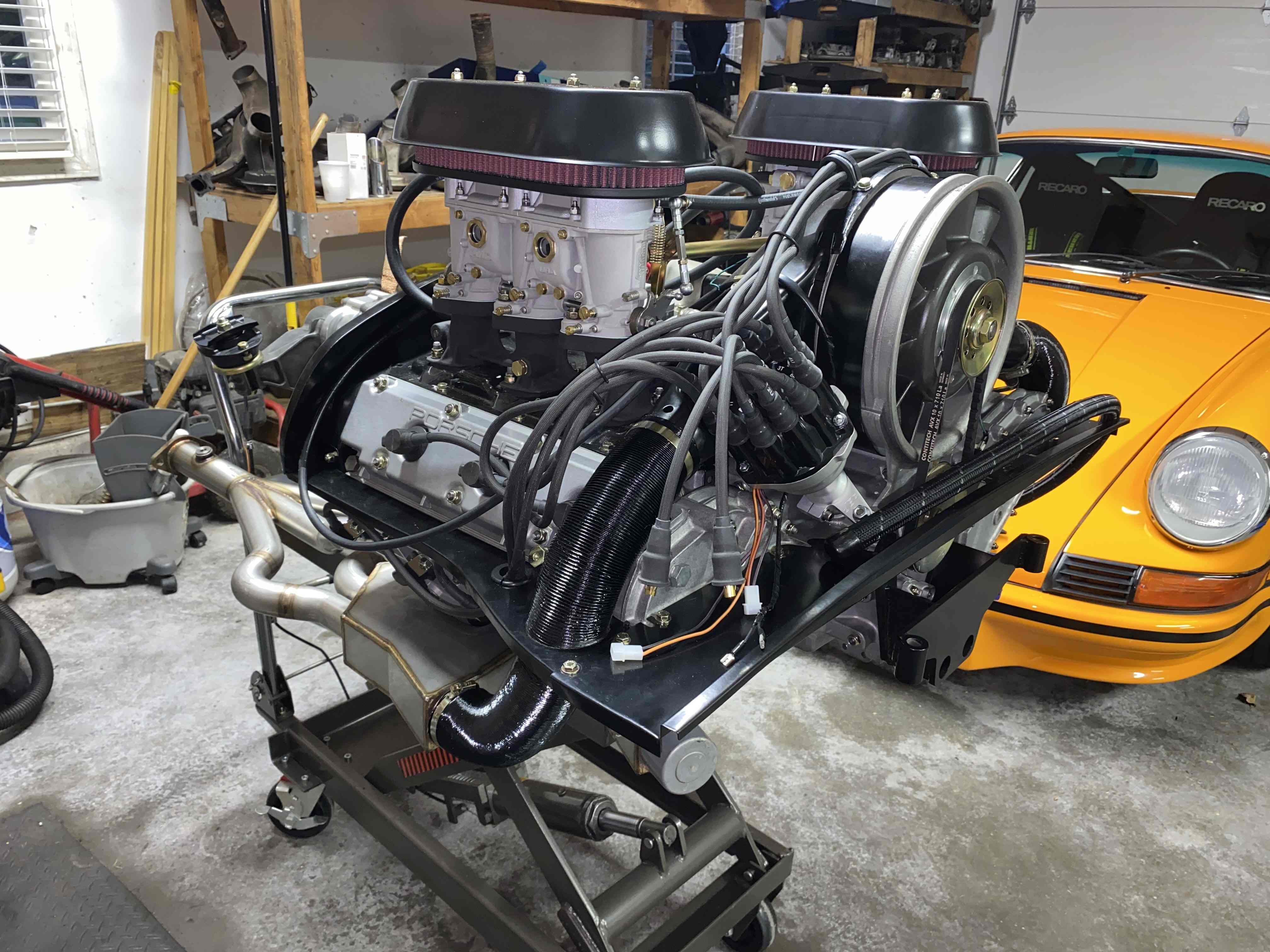

I am now ready for my first 914-6 engine install as I move forward on my -6 GT project.
http://www.914world.com/bbs2/index.php?sho...8279&st=420 I have the car on my 2-post lift and the engine on my lift table. I am using the Mad Dog Motorsport bulkhead engine mount. I plan to raise the engine on the lift table, lower the car on the lift and jockey the engine into position One of my concerns is the balance of the car on the lift as the heavy Aluminum case 3.2 short stroke engine is engine gets installed. I noticed that as I was disassembling the car on my lift that car was heavily weighted towards the rear before the engine and gearbox came out. I could almost tip the car backwards. I remedied this by running a jacking strap through the cockpit onto the arms of my lift to hold the car in place. I am thinking I need to do this again before attempting the -6 engine install. Any thoughts or suggestions? I plan to install the engine without the side tins and carb rain hats but with the heat exchangers and engine oil lines. My oil t-stat, twin coils/MSD boxes and fuel lines are all in place in the engine compartment. I plan to install the CV/axle assemblies, the side tins and the muffler after the engine install. Does this sound about right? Anything I am missing or need to look out for? |

Just keep the lift table in place (an inch or two under the engine) once the engine is bolted in the car and give the car a wiggle. You can also add some weight in the front truck. You can also make a deadman out of 2x4 and prop it under the rear trunk so the car can’t tip. I tend to go towards overkill so using more than one safety device isn’t being overly cautious, I think it’s smart. My large two post lift at the shop seems to place cars in the right spot for engine removals without any additional support. We pull 911 engines out daily and the cars are rock solid. |

I have this same setup. I used a 2x4 on each side of the motor on the lift table to keep it even. The tin always seems to hang up on the right side. You could just take the bolts out that side and let the right side tin hang down for easier install. Another goofy issue with the bulk head mount is that with a lift table you have to remove the front tin or it will catch on the mount. If you used a floor jack, you could tilt the motor back to get it over the mount. I would remove the bolts from the front tin and let it sit in front so you can flip it up during install. Otherwise it will be a major PIA to try and install it afterwards.

I’ve always had all the engine tins installed. I made some sheet metal guide plates to cover the inner suspension nuts , as it’s easy to hang up on them. It’s a more work but if you remove the carbs, you have more room to get everything in place. Don’t tighten the M8 fasteners on the engine and transmission mounts. I’ve never had a 914 tip off my 2 post lift.

Tom, it looks like you have the firewall bearing flipped around.
Pull out the shift rod and rotate the sphere so the flat side shows. |
