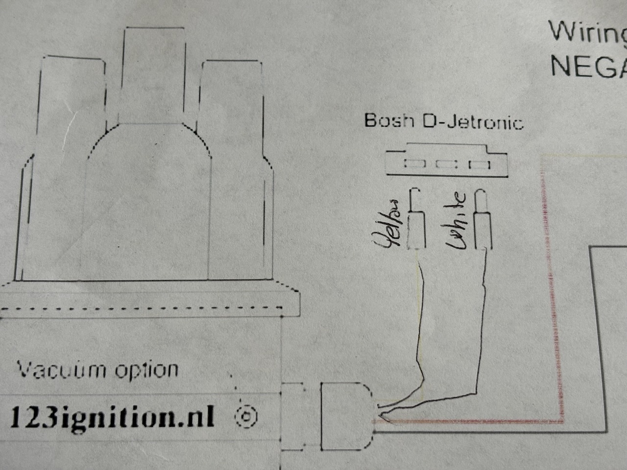

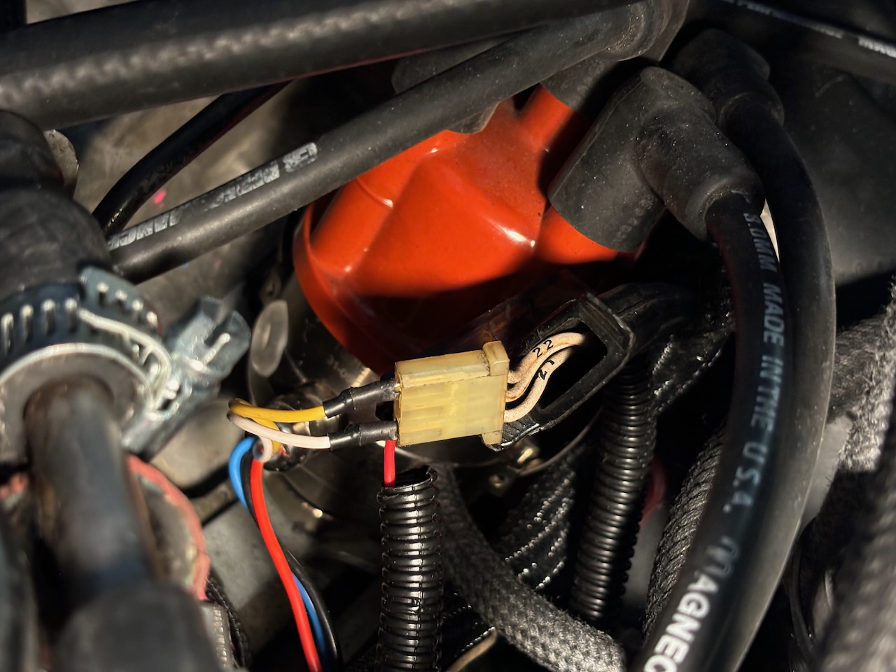

Post a photo of how the 123 wires are installed to the
FI harness connector please.

Here's a pic and a pic of the diagram from what I followed off of 123's website

Thx, that’s trigger points connection and looks wired correctly.
