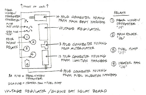

Check the fuses on the relay board - drivers side of the engine compartment. There will be two "slots" - you're interested in the rear-most one - closest to the round relay. Also check "relay 3" by swapping with "relay 4" (assuming your heater fan works)
Edit: added diagram

Brian- I swapped relay 3 and 4. It worked! Thank you.
