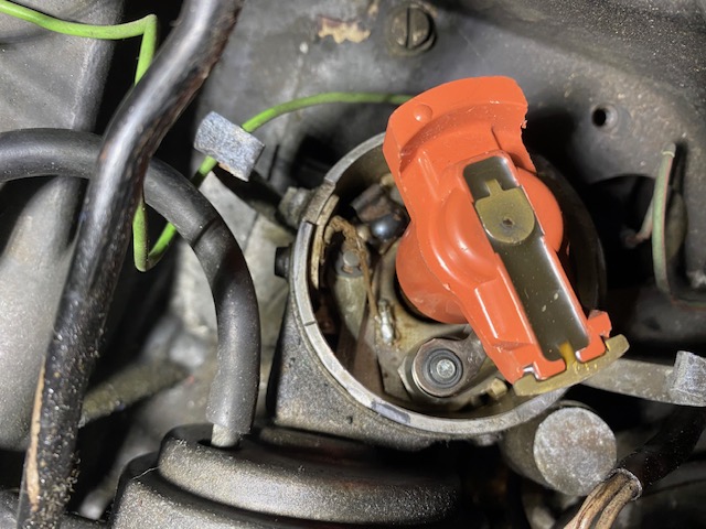

All i did was change my plugs and wires and now it won't start.. I checked the rotor seat, the cap is seated, the coil wire is on switched the wires on the cap so many times not sure where I am anymore/
Can anyone with patience please help me where to start re-running the wires 1-4-3-2
One of the biggest embracement's is my car is a 74 I thought 1.8 but now I'm convinced its a 1.7Attached Image

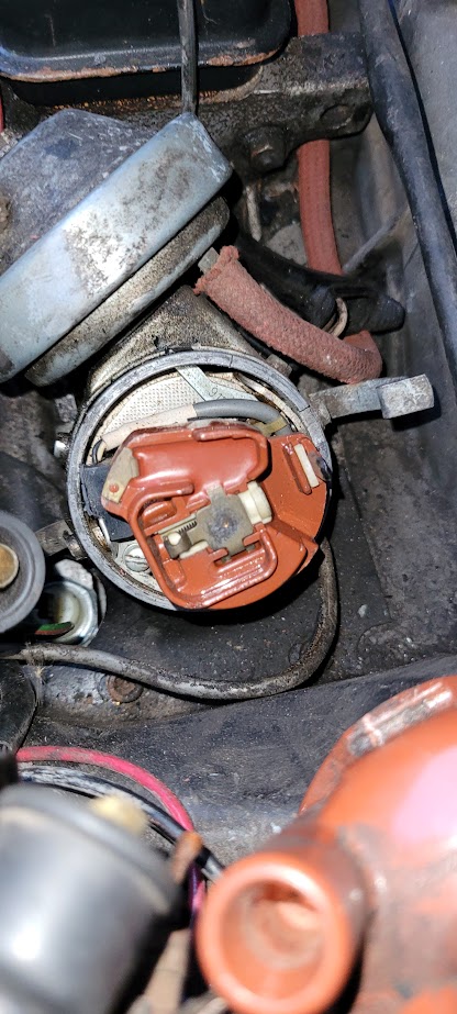

Here's a picture of my distributor. You can clearly see the notch for cylinder #1 at 2 o'clock.

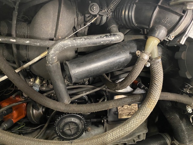

Some quick pictures of my engine bay. Hopefully you can see where the spark plug wires are running. I can get better pictures tomorrow if you need them.

My concern is that rev limiting rotor just doesn't seem to sit right down in there and maybe I just need to try again..

I do see what looks like D-jet trigger wires below the red vacuum hose, so it is likely to be a 2.0 or 1.7. No telling what has been done in the way of engine rebuilds in the last 50 years though... A zoomed out picture and/or the engine serial number will help us guess at what it may be, not that size will really help determine the issue.
However, one spot to check that is common to the area you're working with IS those white wires under the red vacuum hose that go to a connector in the bottom of the distributor. That connector can get worn and make poor contact. If that happens your injectors won't fire.
Another spot to check is the grounding point at the back of the engine. It is located on one of case bolts and should have a group of white wires on three different spades. Those can also can be easily knocked off when replacing plug wires if the spades are worn/bent. Those are the grounds for the injectors and will also cause them to not fire.

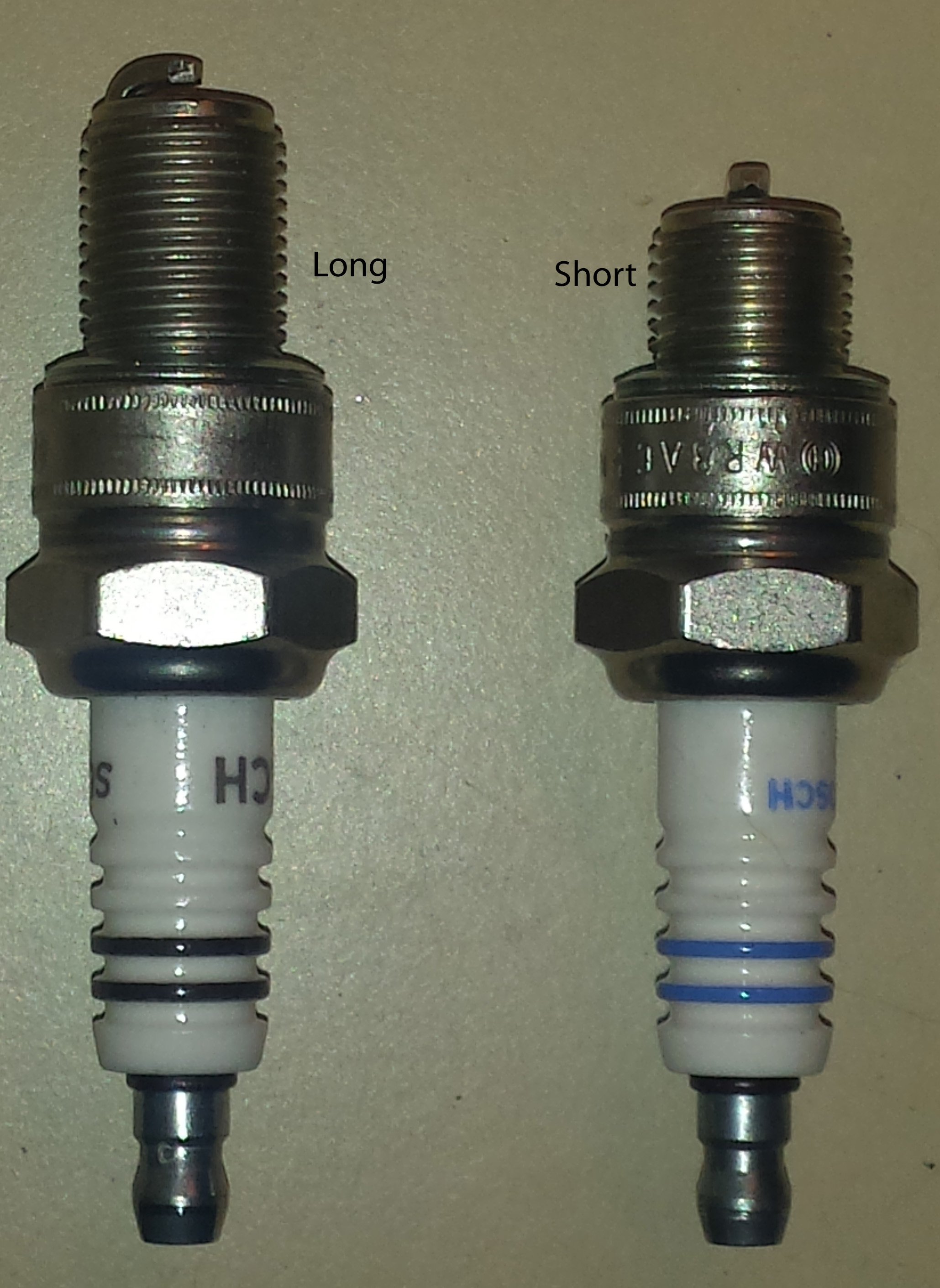

It looks like you changed the plugs. Hopefully, you got the correct plugs, as there are short-reach and long-reach.
After using the above posts to install the plug wires on the distributor cap (start at plug wire #1, then add the others in a clockwise manner looking down on the top of the cap, 1, 4, 3, 2) the tins have the cylinder number stamped in them above the spark plug access hole. Route the wires to the correct hole. If a wire won't reach, swap it for one of the longer ones. You can even take a sharpie marker and write the #s right on the cap.
These photos may help (IMG:style_emoticons/default/smile.gif). And, what every one else said.
