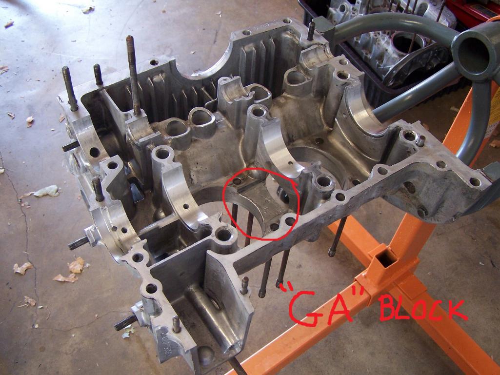

@technicalninja : I guess you lucked out on your GA engine block because mine is per video description and has the backside of the register thinner in the narrow area. See picture below:

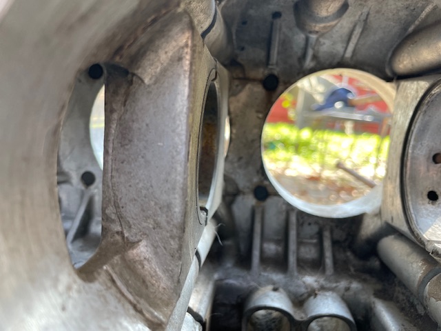

Now the "W" case look like this as shown in the video and yes the constant thickness of the register area seems to be about 29-30mm. Below is a picture of the register backside and thickness measurement. Unfortunately for the OP, this block is now sold. (IMG:style_emoticons/default/sad.gif)
Hopefully the OP will find what he is looking for and these pictures can help!

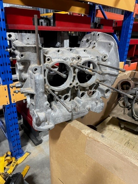

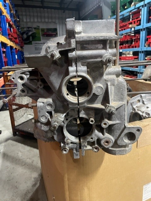

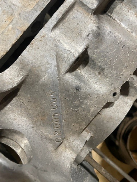

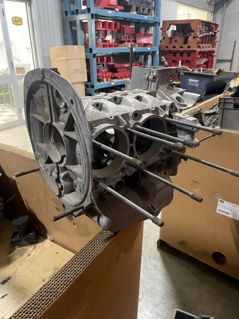

I have this case I can sell you. send me a PM for pricing

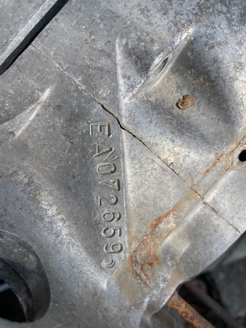

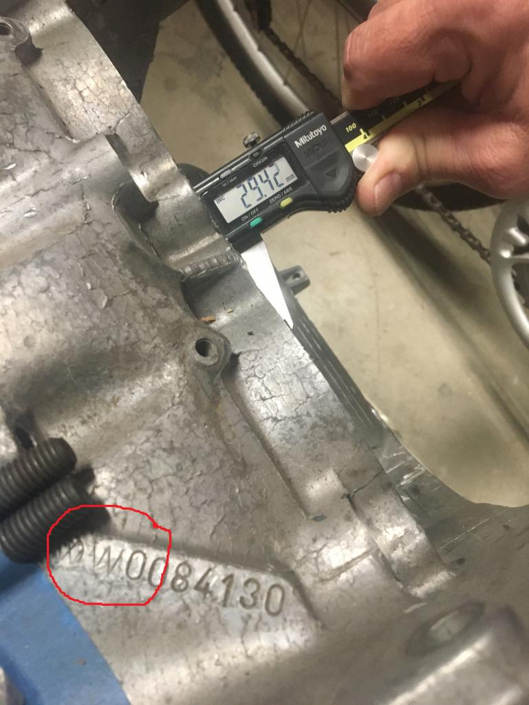

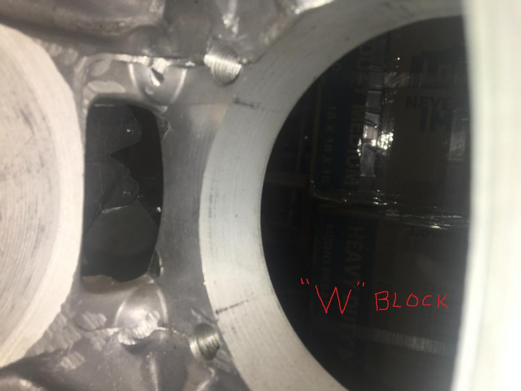

I have/had two 1.7 crankcases. One, which was a “W” block that I kept another was an EA block I gave to a buddy. I was over at his house the other day and decided to check the registers on his block. They are thick like the “W” blocks. Didn’t check for a windage tray but was surprised that there was no relief cut.

Just split the case--have the same as the "GA" block as shown by Montreal914 Not what you are asking for.
