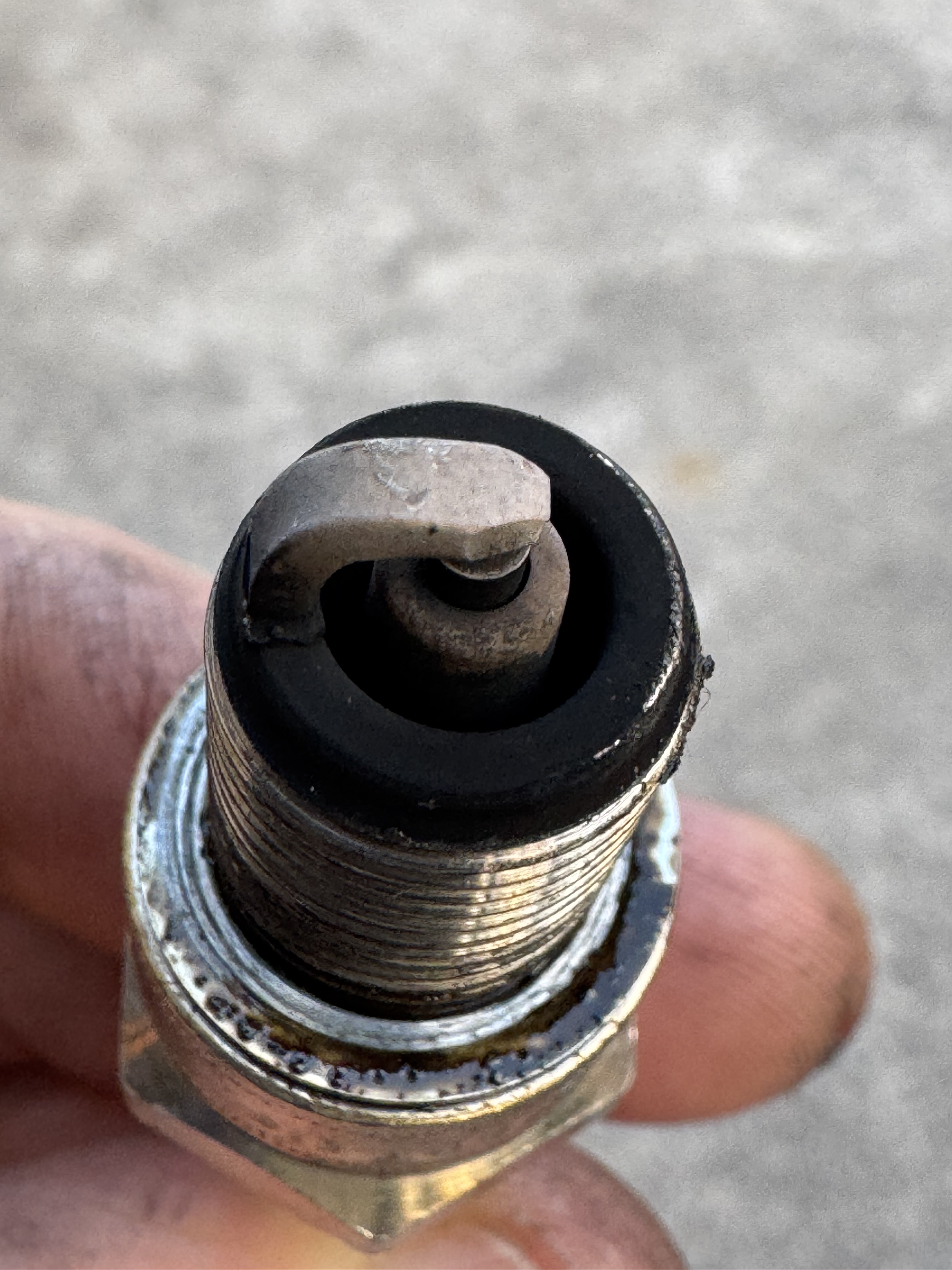

- Plugs look okay (see attached)

In photo of the plug - why does the compression washer look all wet and oily?
You say starting fluid doesn’t work when it stalls and dies. Elaborate on what you’re using (are you using starting fluid or some other crazy aerosol people seem to call starting fluid). Have you checked spark when the starting fluid isn’t working (ideally by pulling a plug). If it’s rich and flooded the plug should be soaking wet with gasoline. Is this the case when it won’t start at all?

QUOTE(Superhawk996 @ Mar 17 2025, 09:09 PM) *
Unsure why the compression washer looks wet and oil. The engine itself is pretty dirty/oily (weather has just gotten good enough to clean it). I have had the plugs out, but not replaced, since I bought it in November.
