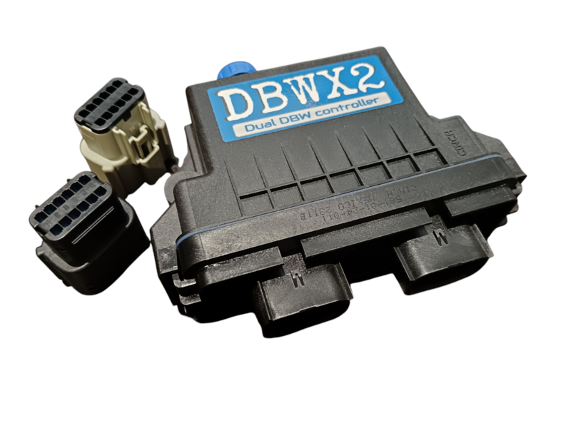

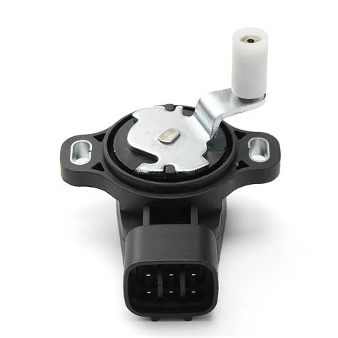

I am going with drive by wire for the flat fan conversion. I am going to use a Nissan 350Z throttle pedal sensor.
It will all be tied back into the MS3Pro for the ability to run traction control. So I can actually have a hope of driving it in the rain without roasting the tires.
But I am definitely adding a button to turn off the traction control in the dry.
I will take the roller off the arm, and add a Porsche ball stud. I will make a hole in the top of the tunnel behind the pedal box, and mount it there. I will use a rod to hook it to the stock throttle linkage. I will also add a throttle return spring between the pedal bellcrank and the chassis until I get the correct feel from the gas pedal.
Then I will add one of these to run it...
(IMG:http://www.914world.com/bbs2/uploads_offsite/shop.fullest.fi-1143-1743768550.1.png)
And at the engine end, I am using a pair of BMW M3 throttle actuators, one for each cylinder bank.
