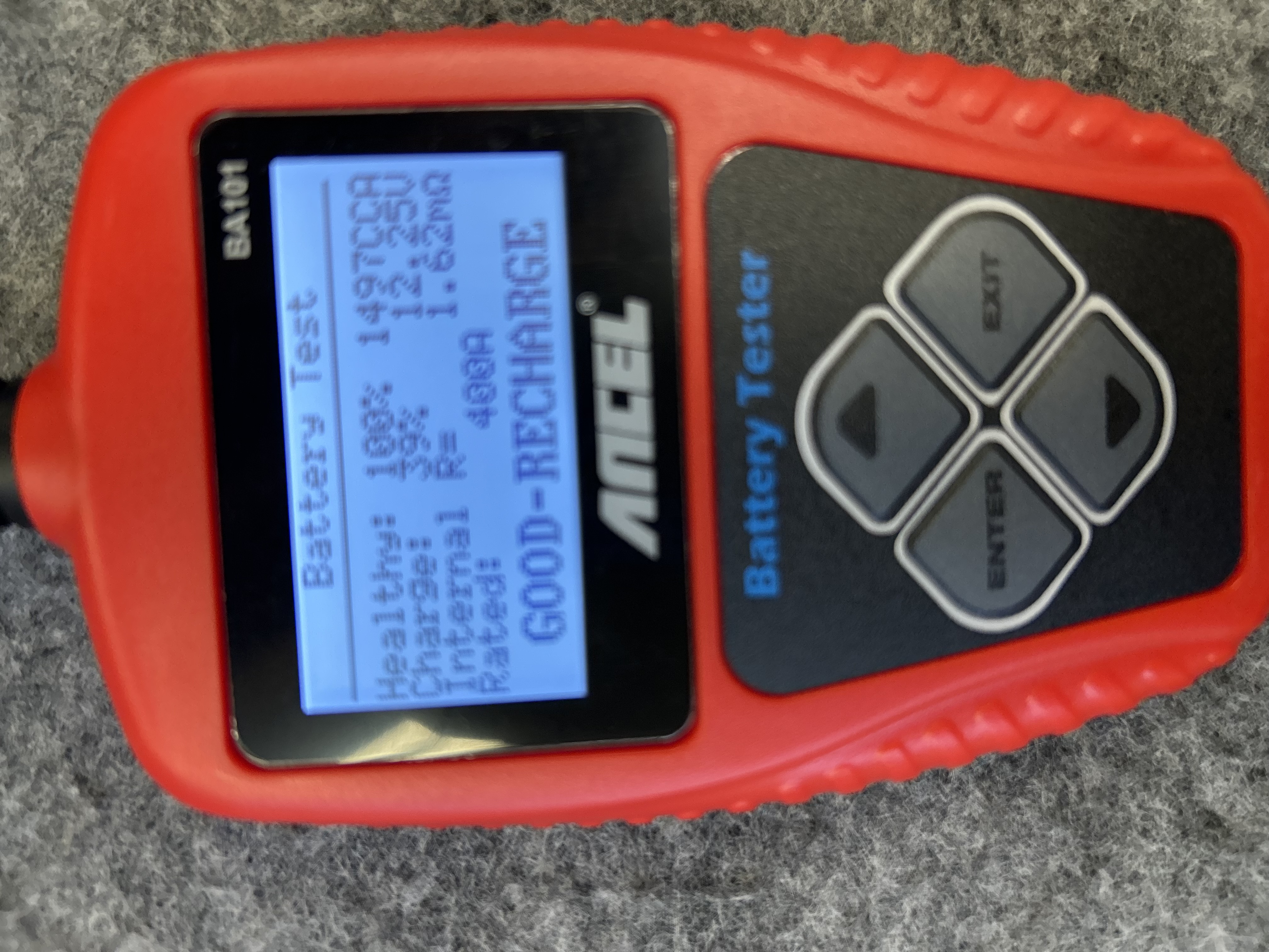

jim_hoyland
post May 14 2025, 05:31 PM
Get that VIN ?
Posts: 9,961
Joined: 1-May 03
From: Sunset Beach, CA
Member No.: 643
Got my battery tester today and made a their preliminary test:

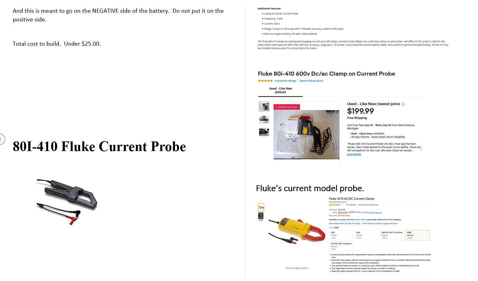

I made this for an Okteenerfest tech session. It works.
It is cheap, and will find that pesky draw in your car. Just install it, and hook up your DVOM. Then start removing fuses. If the draw is still there, start by disconnecting the 4 red wires from the positive battery post, Hook them up one at a time. When the draw comes back, see what still works to find out which circuit it's using.
I have the black Fluke current probe, and while it is very accurate, I find it always has dead batteries when I need it. I have put in the home made current shunt, and the Fluke amp probe to compare them. They are within 1% of each other when tested.
