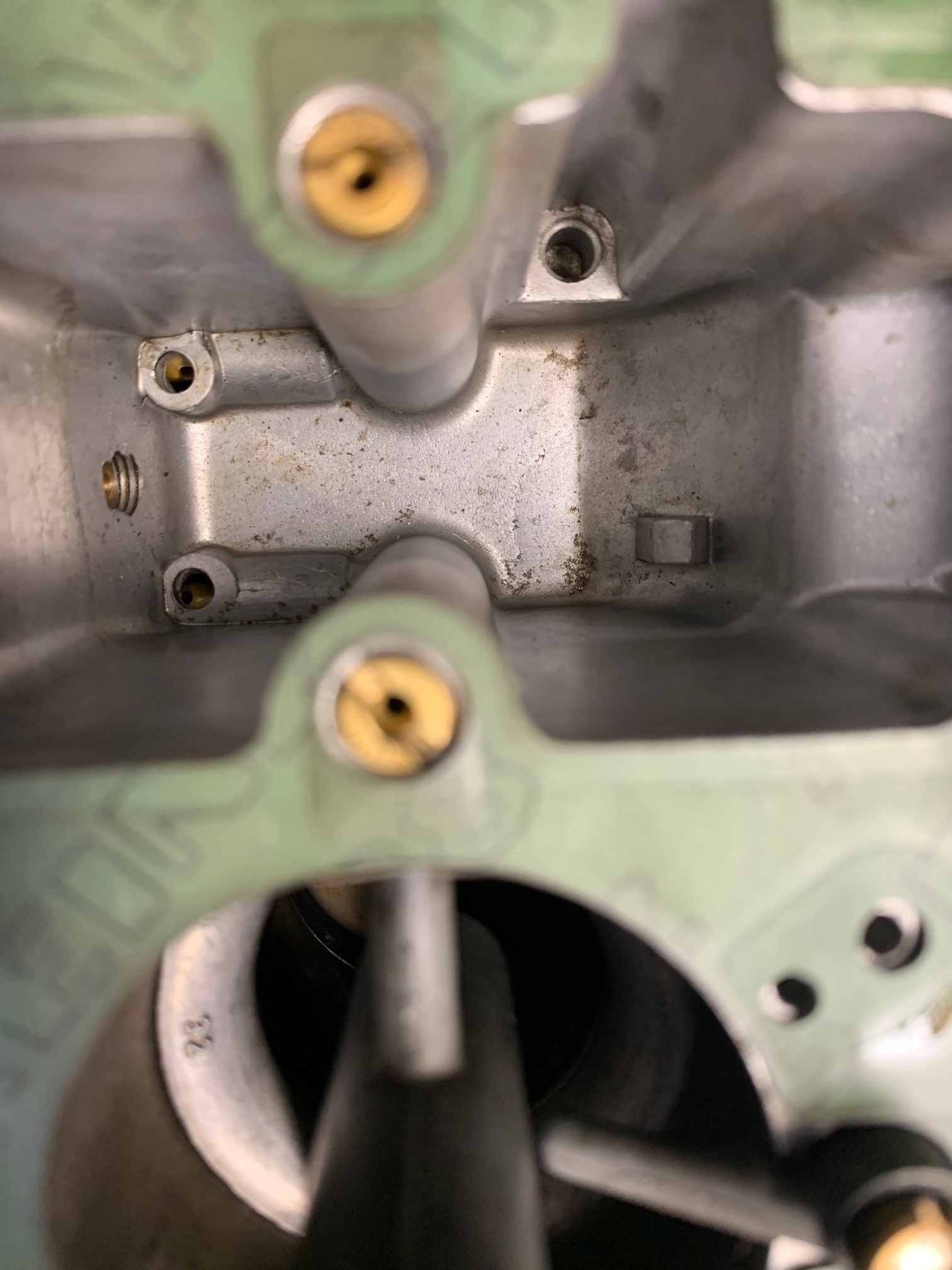

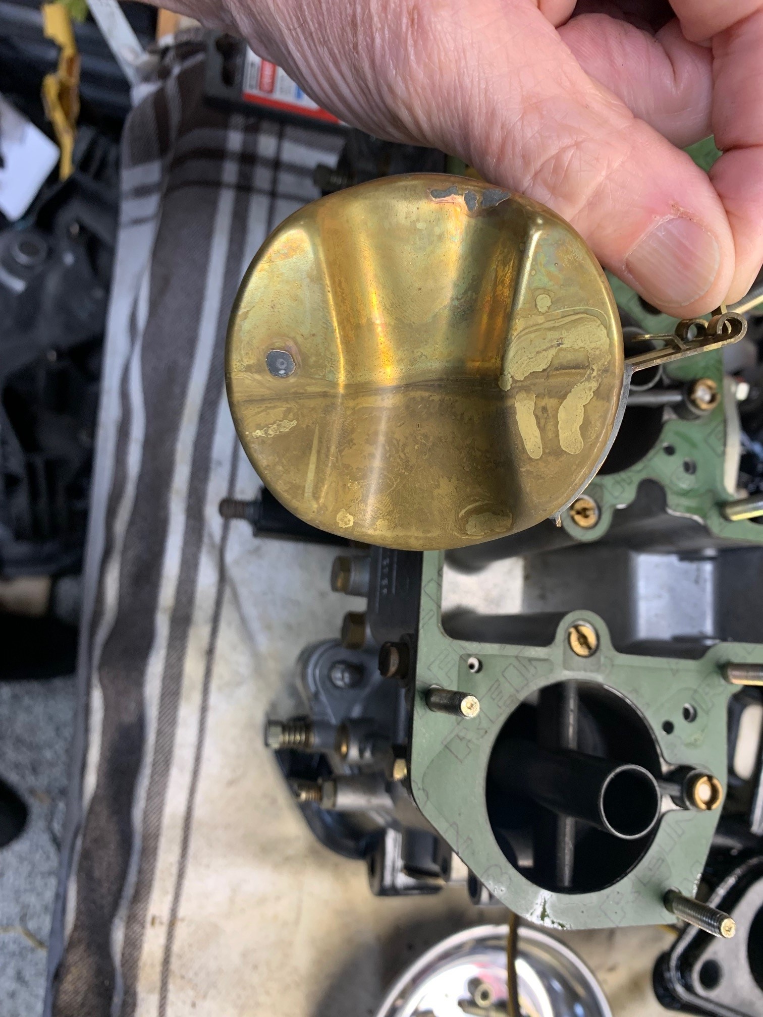

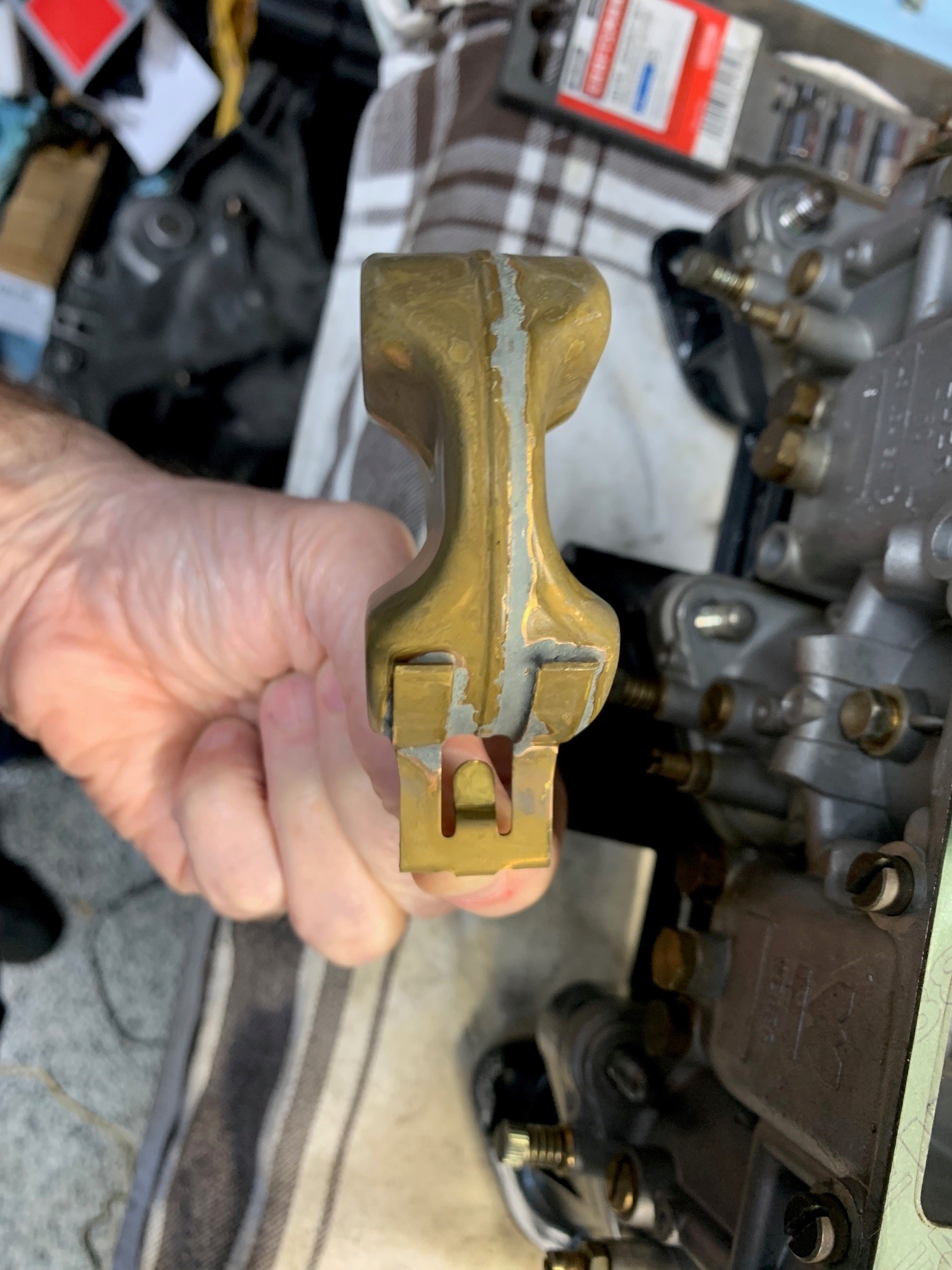

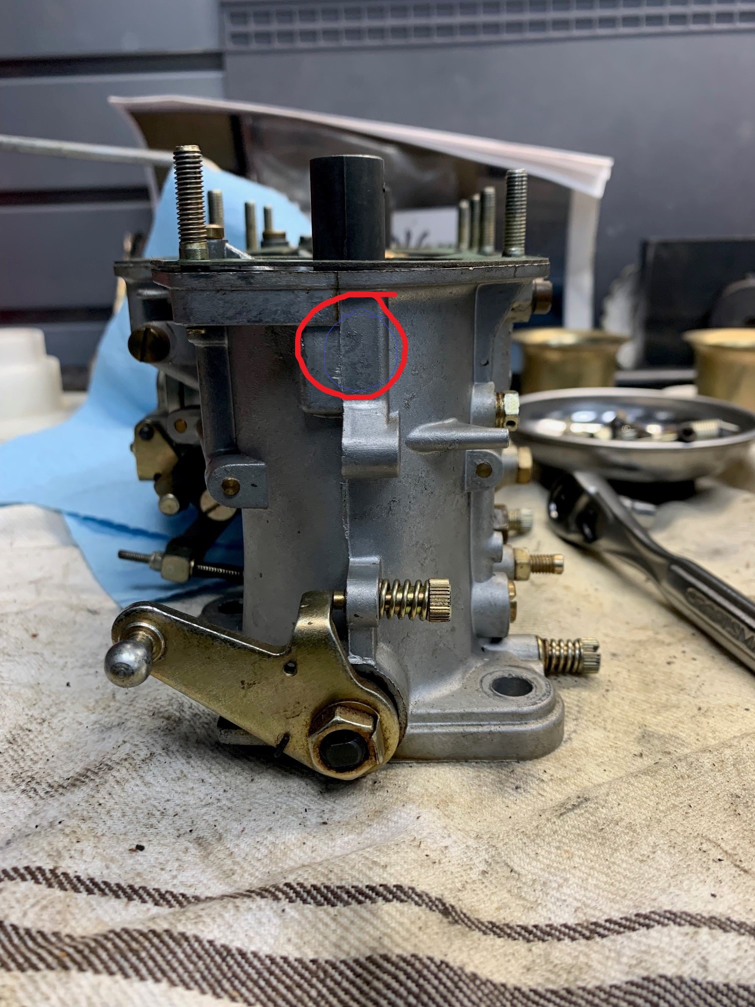

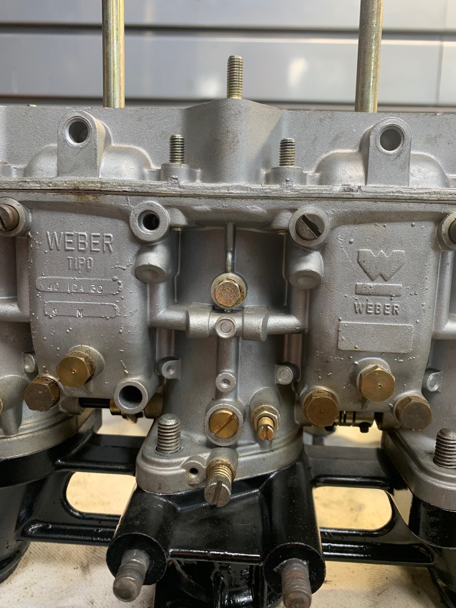

Here are the pictures I promised, first, here is the model stamps of the carb
there is some question as to the originality of the carbs - according to Carl at Klassic Automotive Training School, there is a stamp on every carb that goes through the Porsche Factory, it should be right here:
He talks about this and much more in one of his videos, all of which are very informative,
https://www.youtube.com/watch?v=p3qwIbRdcvE&t=60s

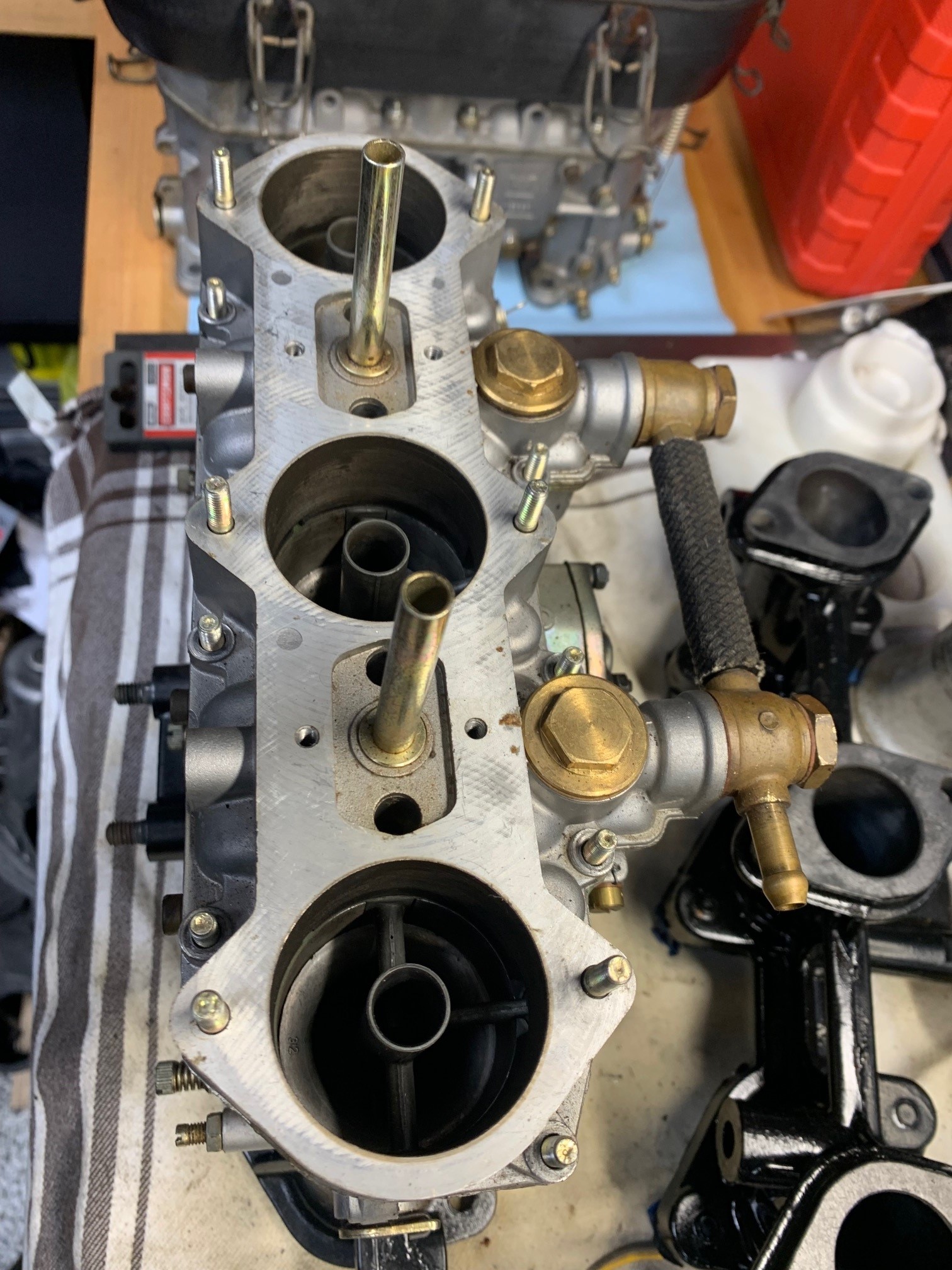

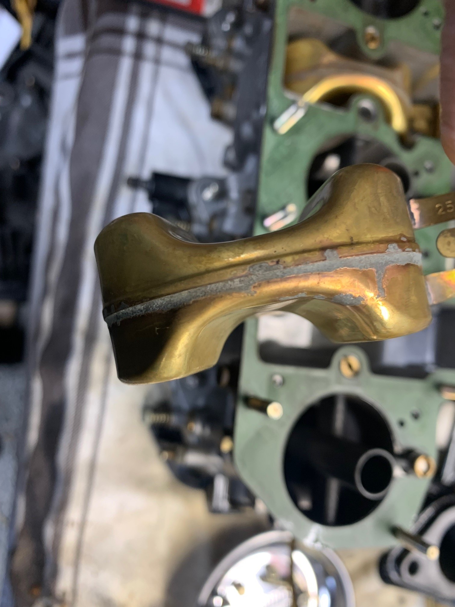

Inside is very clean, stained in a few places, but clean.
Floats are in perfect shape, did not use compressed air to clean them.....grin
When I opened the gasket seemed new and the interfaces were very clean.

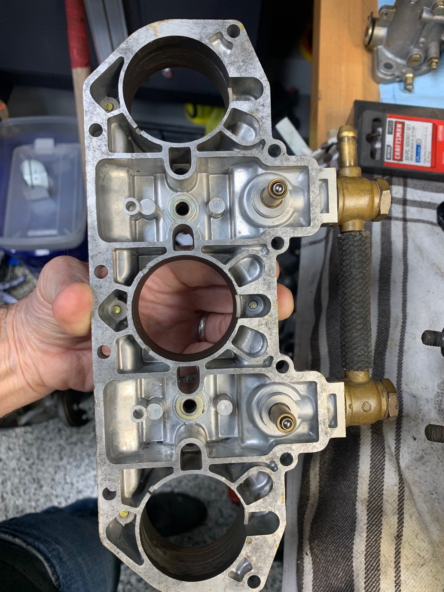

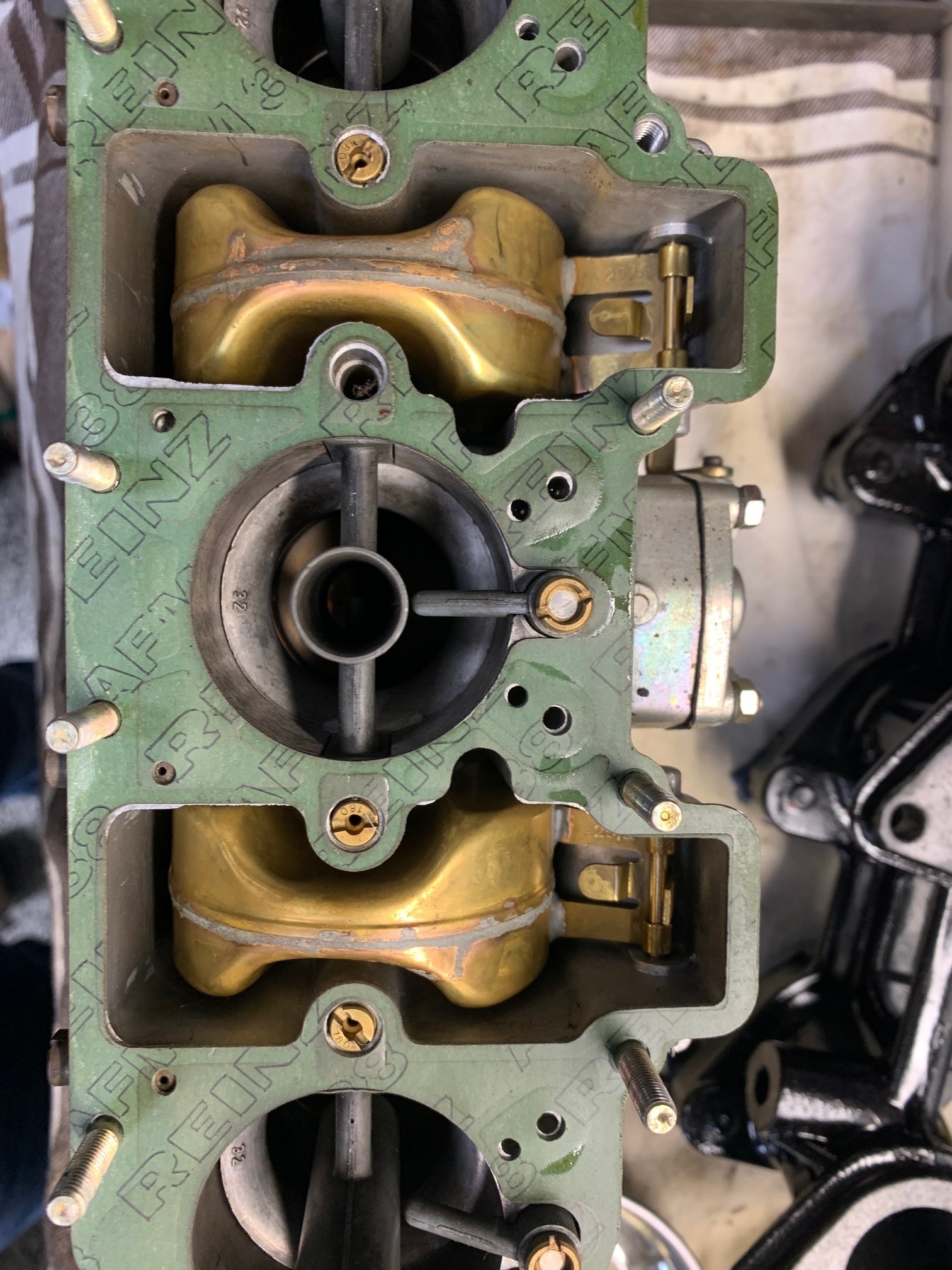

Inside of the carb is very clean, here are a few examples.
Question is where to start on a carb that seems to be in very good shape but needs to have all of the adjustments made.....????
(IMG:style_emoticons/default/confused24.gif) (IMG:style_emoticons/default/confused24.gif) (IMG:style_emoticons/default/confused24.gif)
sixnotfour
post Jun 1 2025, 07:41 PM
Posts: 11,120
Joined: 12-September 04
Member No.: 2,744
Not Even Italian....
Those are from PMO way back when ...Caution some had a depth problem for the Emulsion tubes,,There may be a small spacer under each E tube..

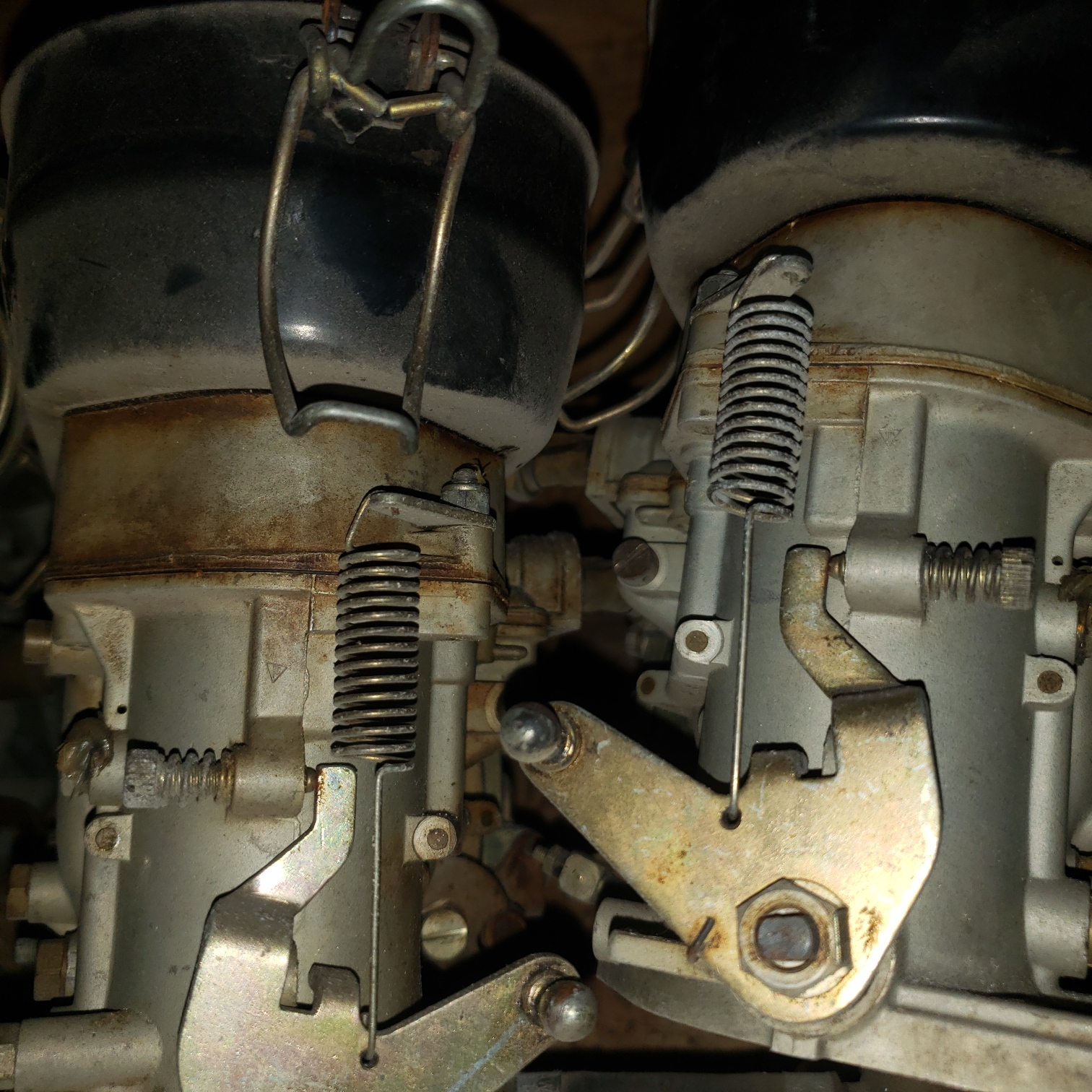

ctc911ctc
post Jun 1 2025, 08:24 PM
Posts: 1,307
Joined: 9-June 18
From: boston
Member No.: 22,206
QUOTE(sixnotfour @ Jun 1 2025, 08:20 PM) *
Almost matching…………huh……..are they off of the same car?

mskala
post Jun 5 2025, 06:16 AM
R
Posts: 1,935
Joined: 2-January 03
From: Massachusetts
Member No.: 79
I am not an expert but I remember hearing a lot of things about Webers from the
other forums.
For the 914-6, the originals would have said IDTP, not IDA. I think 1 side is IDTP 3C and the other is IDTP 3C1
Webers are almost infinitely adjustable. However, the IDA would have had at least one
port different from IDTP that is not just a replaceable part. I can't remember right now
what it was.
The Webers used on 911S had a separate enrichment tube not on the others.
I'm sure you can use the non-original carbs you have if they are in good condition.
