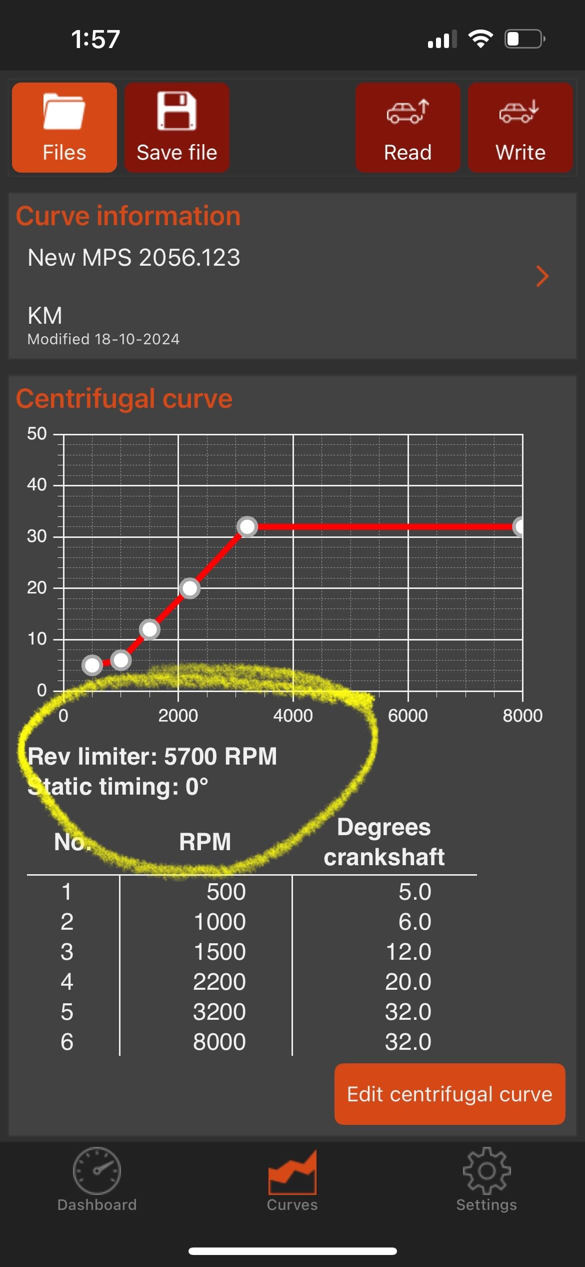

stownsen914   If you have rev limiter set (and it's actually...   Jul 13 2025, 10:32 AM
DC_neun_vierzehn   If you have rev limiter set (and it's actuall...   Jul 13 2025, 03:24 PM

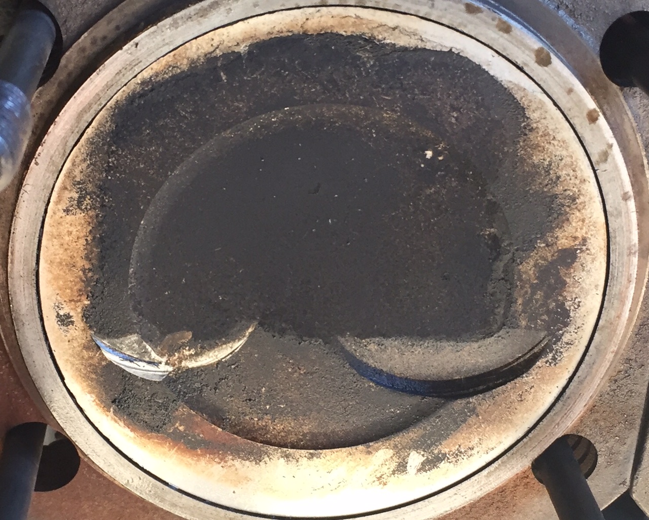

DC_neun_vierzehn   I decided to start with the scoping first. Here ar...   Jul 17 2025, 11:46 AM
emerygt350   I don't see anything that looks like damage, b...   Jul 17 2025, 12:06 PM
WFG   Could be a cracked piston at the pin. Happened to ...   Jul 17 2025, 12:59 PM
emerygt350   You localized the sound to cyl 4? Maybe time to r...   Jul 17 2025, 02:22 PM
