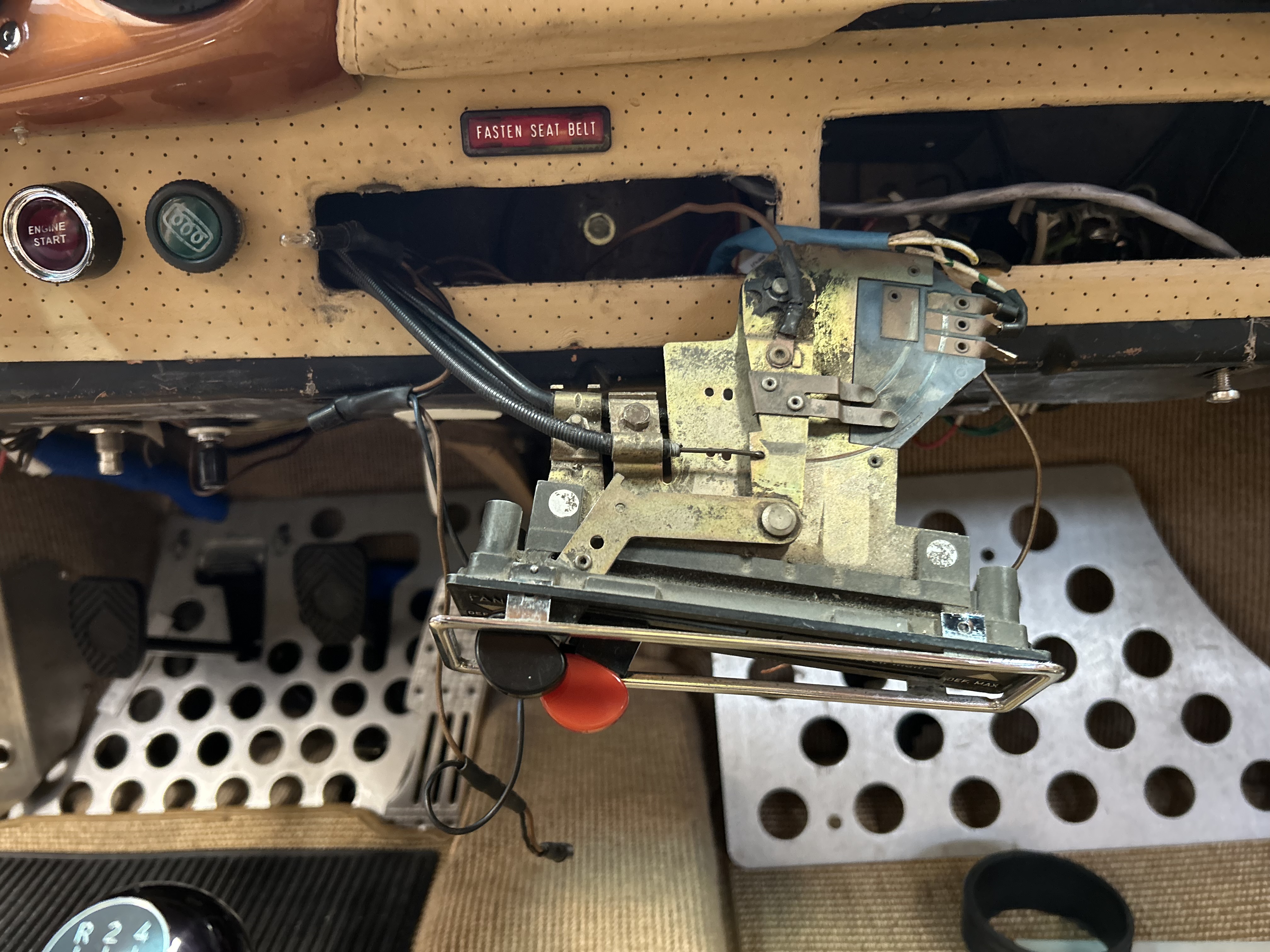

Definitely a slider issue; see if you can reach in and push down on a slider that’s not working. Not easy getting in there; I removed the radio and could get a better shot at it.
Unfortunately you can’t pull the vent control out unless the Bowden cables are released at the valves
Also, verify the three wires are attached to the three contact strips; I had one come off and thought the fan was going south….

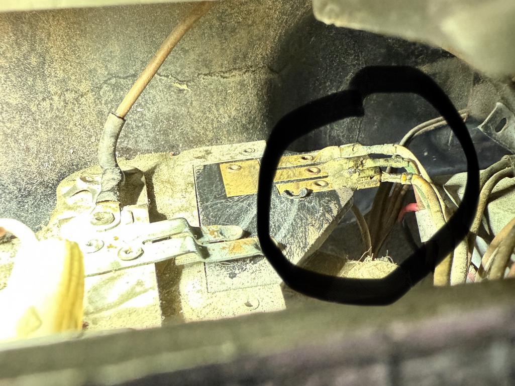

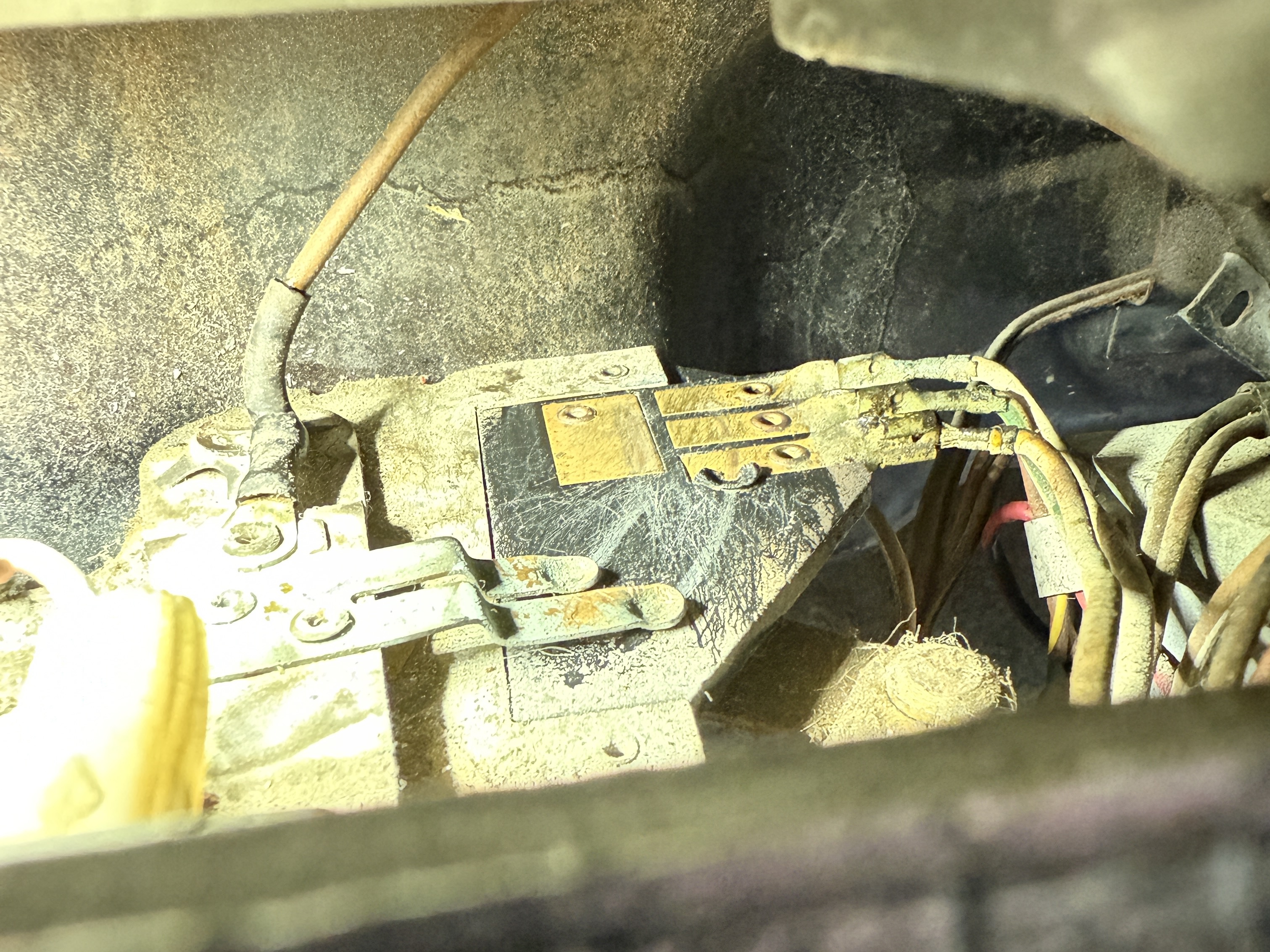

I just did this earlier today. Remove the ash tray and it’s easy. I used a wire brush and contact cleaner. Went from totally inop to all three fan speeds and the indicator light working. Before and after shown.

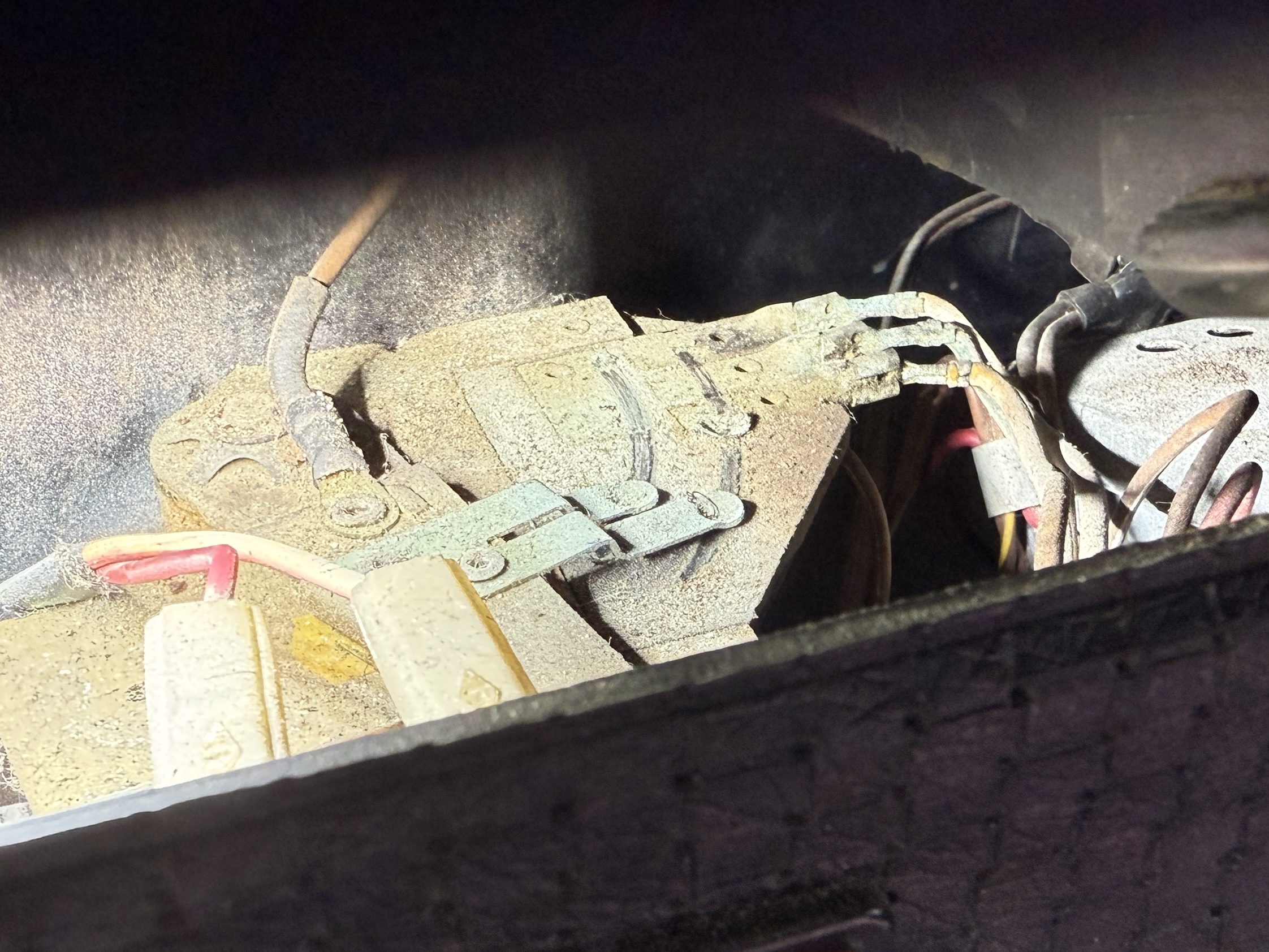

Check these connections. Mine had a tendency to slip off.
