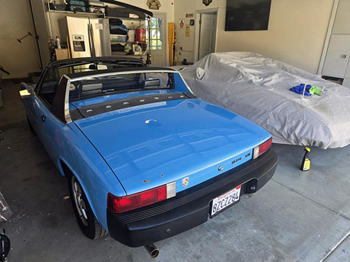

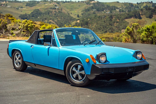

I just picked up my first 914 on Friday, August 8th, 2025. I have wanted a 914 for many years, came close to buying some needy projects in the past, but always seemed to pass for one reason or another. After a ton of looking around I finally found a good candidate for my next project.
The car was being auctioned off on Bring A Trailer but it did not meet reserve. The car was located about 45 minutes from my house so I ended up working out a deal a few days after the auction expired.
Here is how the car looked back in 2019 when it first sold on BAT:
Kind of interesting to see how it changed over the years.

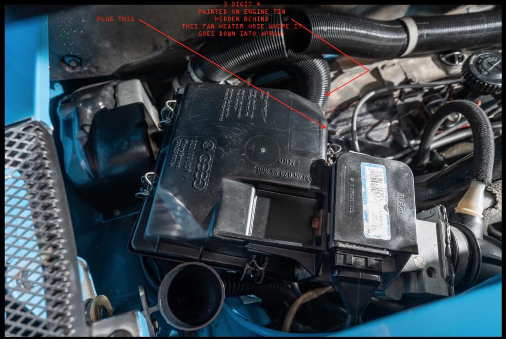

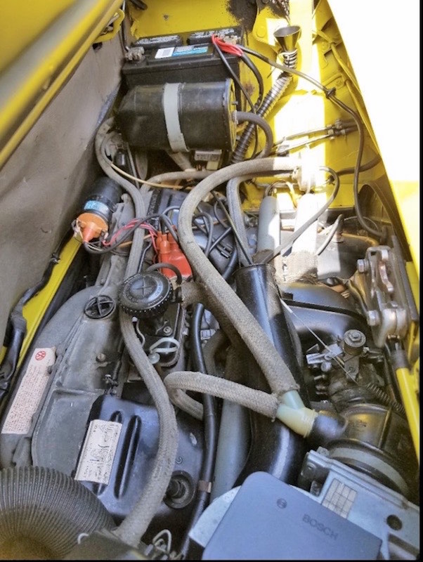

i checked out the engine bay photos when it was on BAT for L jet research.
noticed that its had its evap cannister and hoses removed.
not big deal.
but looks like the tube where the hose connected to air cleaner box has been left open?
its above the air filter element. means unfiltered air can be pulled in.
only small opening.......but. i'd cap it if its not already sealed.

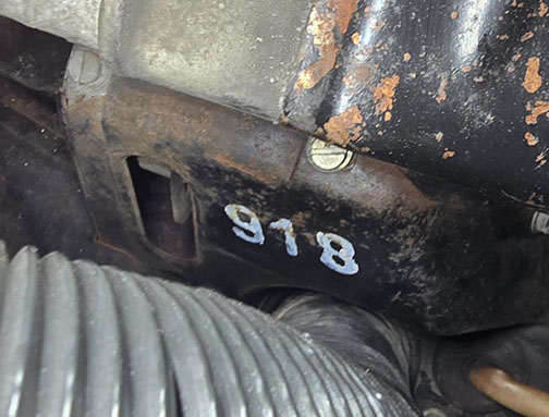

if you got time, there is a bit of data be useful for L jet research.
there is a three digit number painted on in white paint usually where i have indicated on photo. on LHS engine tin. hidden by the fan heater hose from view.
the engine tin looks all original and unrestored on your car so its probably still there.
if it is what is the number?
and if you know, was the car an original california car (sold first in cal) or is it a 49 state car.
enjoy the 914. fun. (IMG:style_emoticons/default/beerchug.gif)
ps - is that a boat tail alfa in the garage next to the 914? (IMG:style_emoticons/default/smile.gif)

Thanks for the info/reply. I will cap that portion ASAP. I do not know if the car is/was always a California car. I have paperwork showing it was in Canada, Oregon, and California in the past. It has 81k original miles and has remarkably little rust in all of the problem areas. I cleaned behind the side skirts / longitudinals today, removed about 4 lbs of dirt and crud. The longs look great.

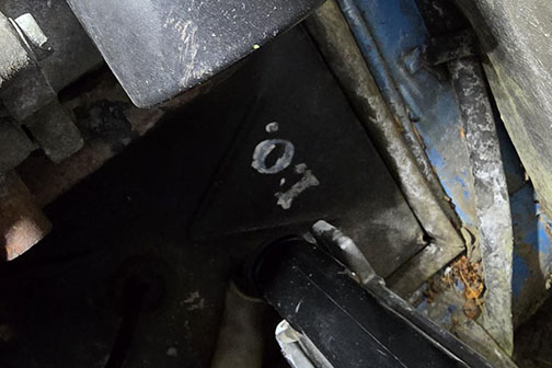

Here are a few photos of the white painted numbers you were asking about:
Drivers side
Passenger:
What do the numbers mean?

918 should mean this.
75 1.8 L Jet. 49 states.
Engine Famiy 15.
No oil temp sensor/sump plate.
No EGR.
IO means in order. or more strictly german Inordnung.
or in USA manufacturer language OK.
sounds/looks like an original car with original engine to me.
if so - its a non californian market car originally.
thanks for the info?
here is a link to thread with final table of all those markings for all the years.
all the various aircooled VW engines of that time had these coded markings.
http://www.914world.com/bbs2/index.php?sho...6668&st=140

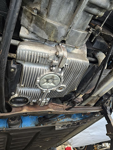

Along with cleaning out the sideskirts/longitudinals, I also cleaned/degreased the motor and trans, both were kind of gross.
Before:
After:
I hope some of the parts I ordered start to arrive soon or Im going to run out of stuff to do on this one.

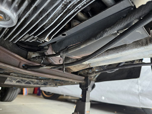

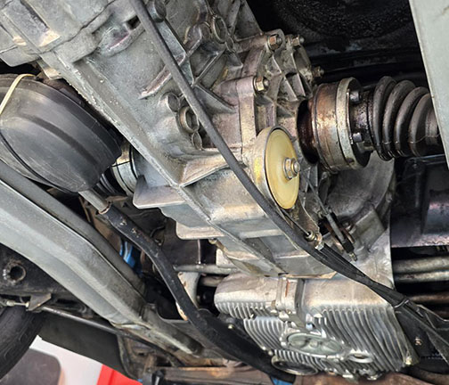

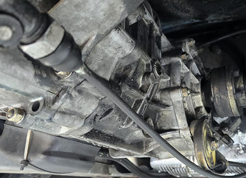

I noticed some odd damage to the these two lines/cables while I was cleaning the underside/motor/trans, it looks like the cable insulation has completed melted off in a few places.
Before cleaning:
After cleaning the motor:
@woknipop: If you check out the background of these two photos there is an obscure clue to help determine what's under the cover. (IMG:style_emoticons/default/wink.gif)

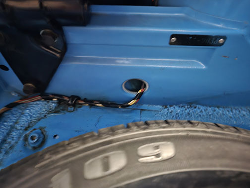

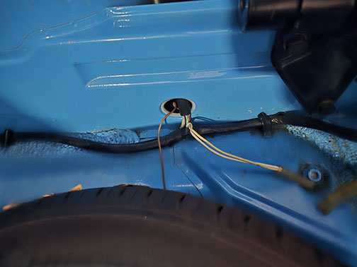

Okay, so I've looked at maybe 20 914s in person and none of them have had a grommet in these two holes, is there a grommet that goes in these holes? What should be there? It feels like there should be something to cap off that big open hole. I looked at 914rubber.com and couldn't find anything specific.
Thanks
Ted
Rob-O
post Aug 14 2025, 08:03 AM
Posts: 1,284
Joined: 5-December 03
From: Mansfield, TX
Member No.: 1,419
No grommets go there. Just what you have is what it came with. The white/clear plastic insert to prevent chafing.
