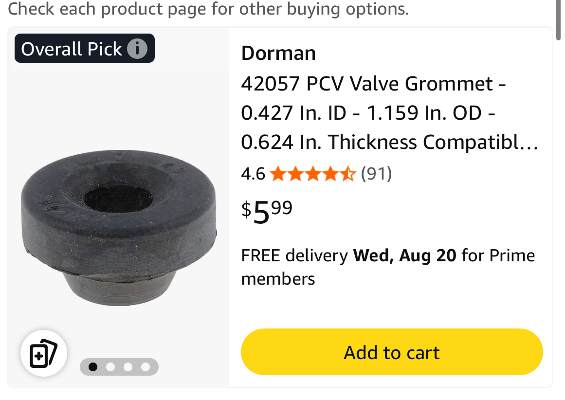

Direct fit. I replaced the PCV valve and the grommet at the same time.

Where did the grommet come from?
Ishley
post Aug 12 2025, 06:58 PM
Posts: 248
Joined: 4-October 21
From: Clarendon Hills Il
Member No.: 25,957
Amazon for the grommet.

No modifications needed?

A direct replacement, no mods needed.
