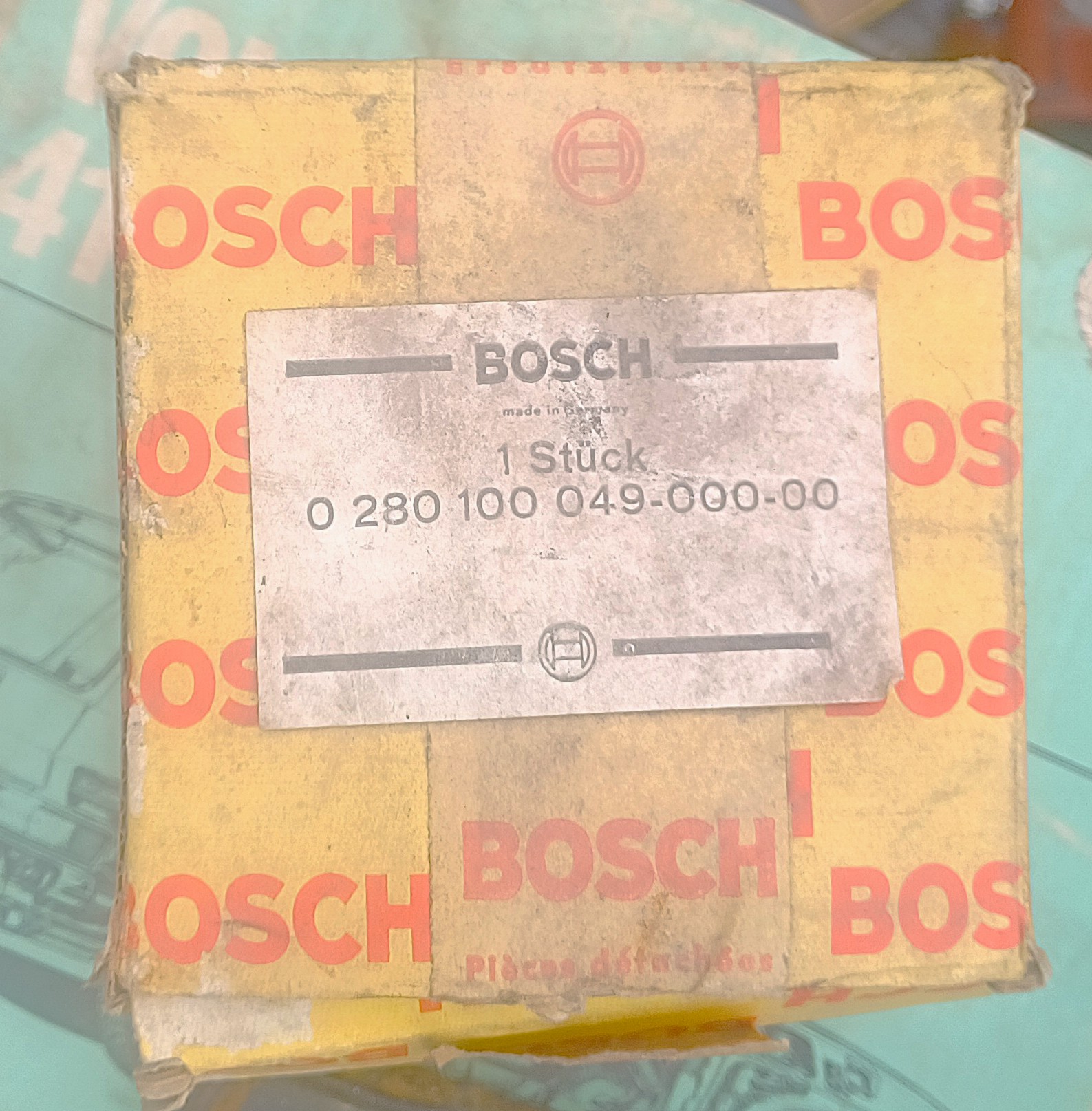

While cruising the swap meet section at a VW Show yesterday, I picked up an in the box NOS 049 MPS. (IMG:style_emoticons/default/dancinnanner.gif)
I did the :suck tongue" test and it passed. I'd like to test it with a pressure / vacuum tester to ensure it holds vacuum. I definitely don't want to overdo it and damage it.
What is a safe vacuum value to test an MPS?

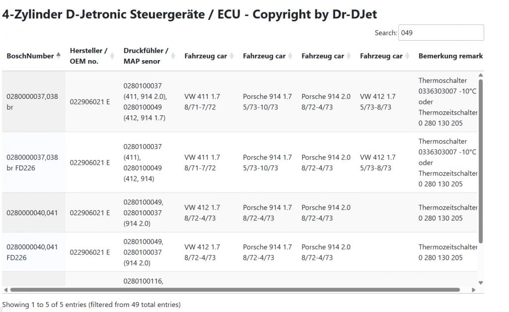

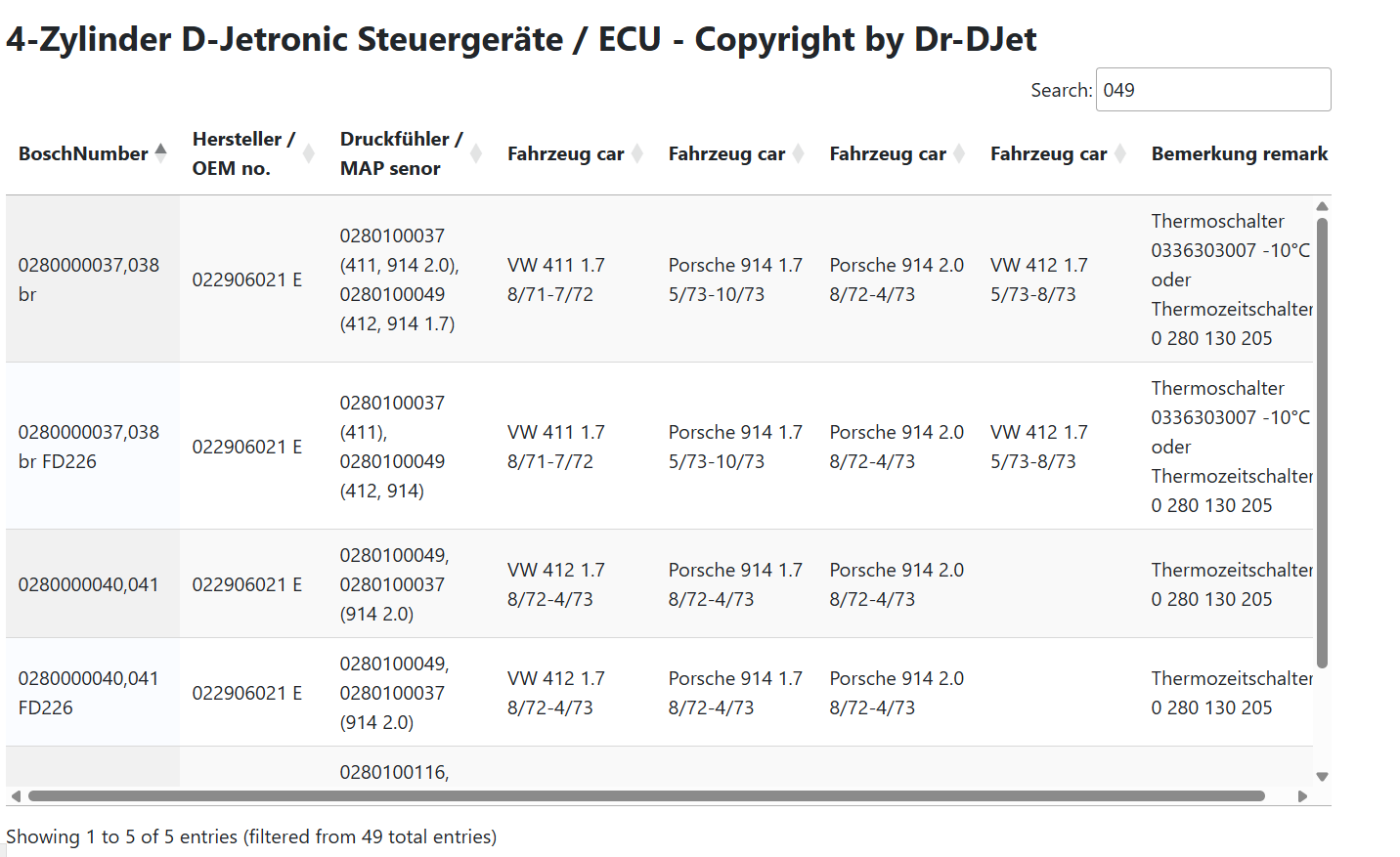

I found a cross reference chart on Dr D-Jet website below.
Q: can an 049 MPS be used on an 8/72 - 4/73 2.0 with the proper combination of ECU and MPS or am I reading the chart wrong?
