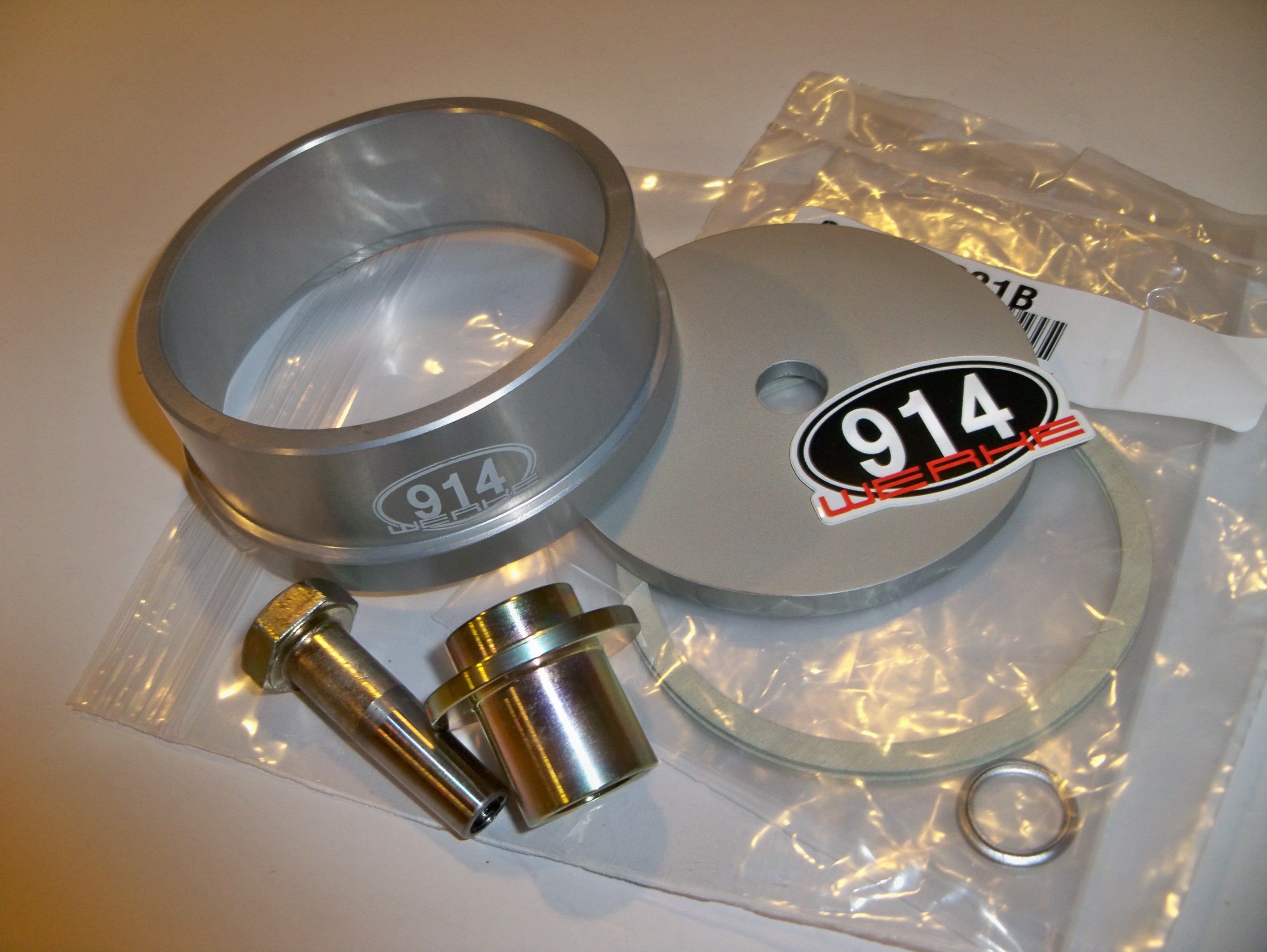

When Rich @914werke gets them back in stock, I'd happily recommend him and his products. https://914werke.com/shop/ols/products/mini-sump

914werke
post Sep 13 2025, 10:20 AM
Posts: 11,389
Joined: 22-March 03
From: USofA
Member No.: 453
I have them. in stock

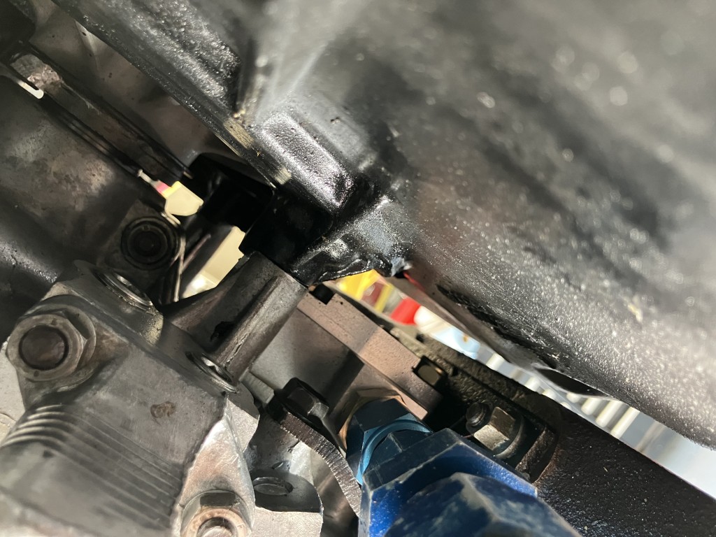

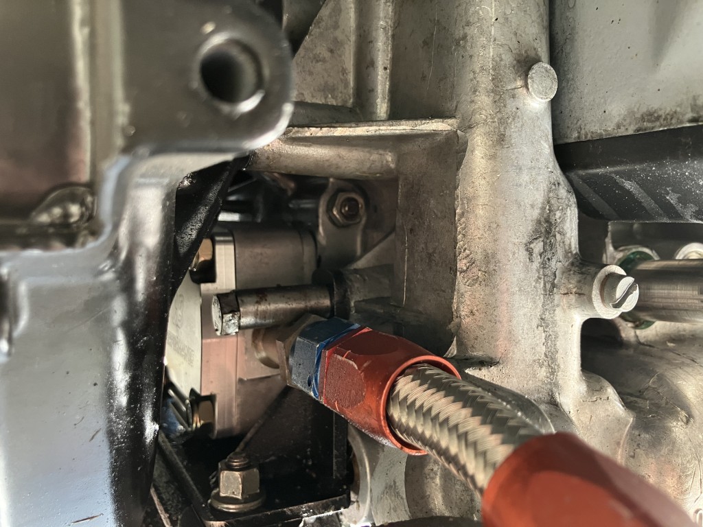

I snagged some (poor) photos of the pump with the car on the lift this morning. One is from the left side, with the (black) fan housing to the left; the crooked one is from the right side, with the fan housing to the right.
The left side hose is the scavenge stage, that takes oil from the engine and sends it to the tank; the right side hose is the return from the tank that supplies oil back to the engine.
In my installation, both lines run through the right heater duct into the cabin and then through the front firewall. The left one has a wider-radius u-turn to head back to the right side of the car.
If I were doing this on a street car that did not need a front cooler, I'd leverage a repro 914/6 oil tank and do everything on the left side, and keep it inside the engine compartment.
You can kinda see the front mount bracket that was fab'd by Chris for this installation. -GA
